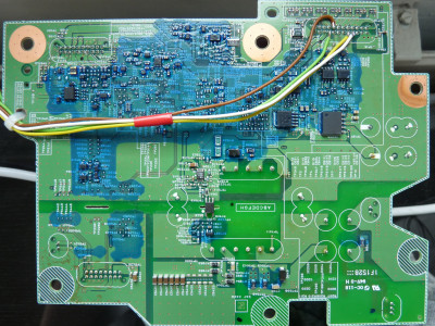

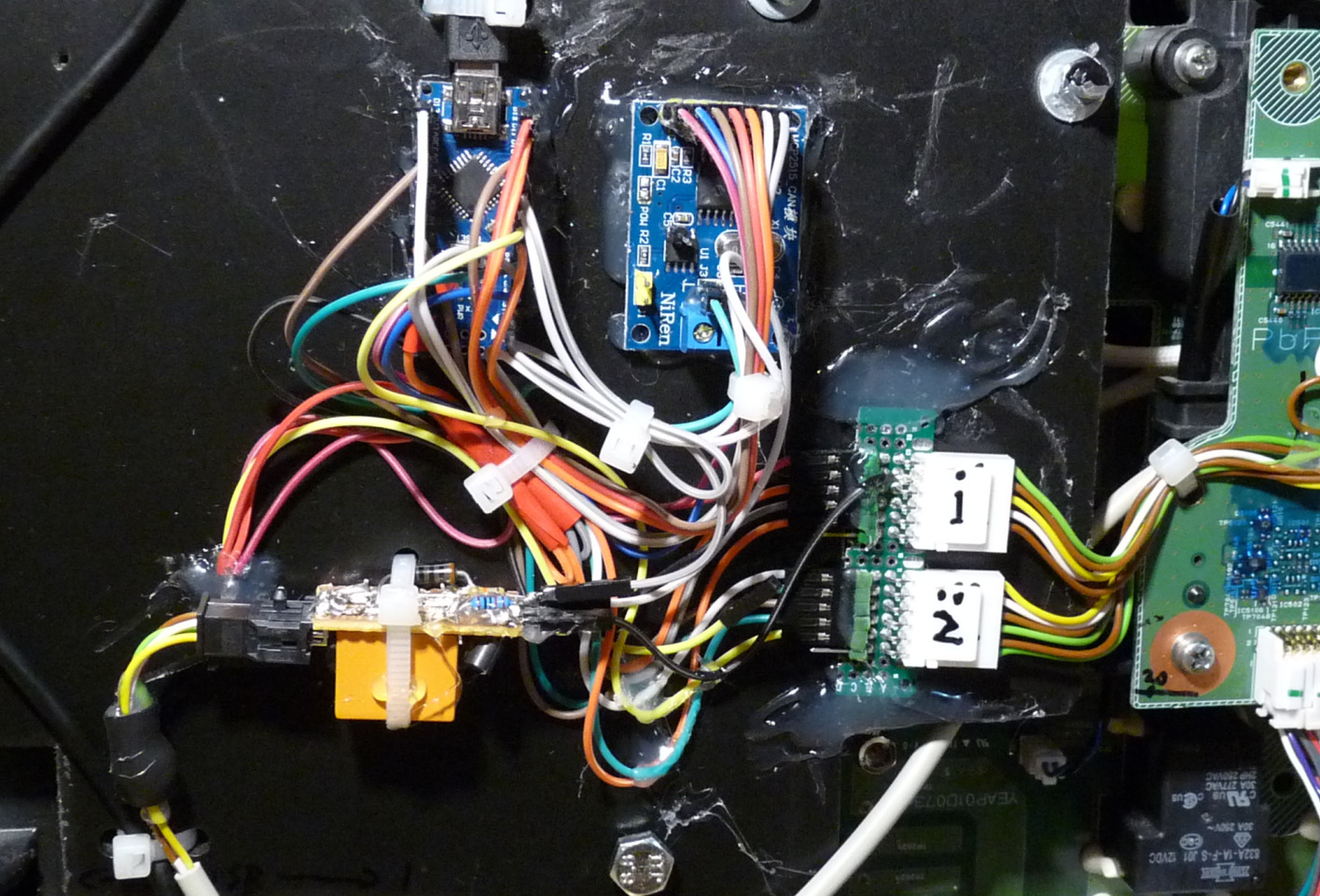

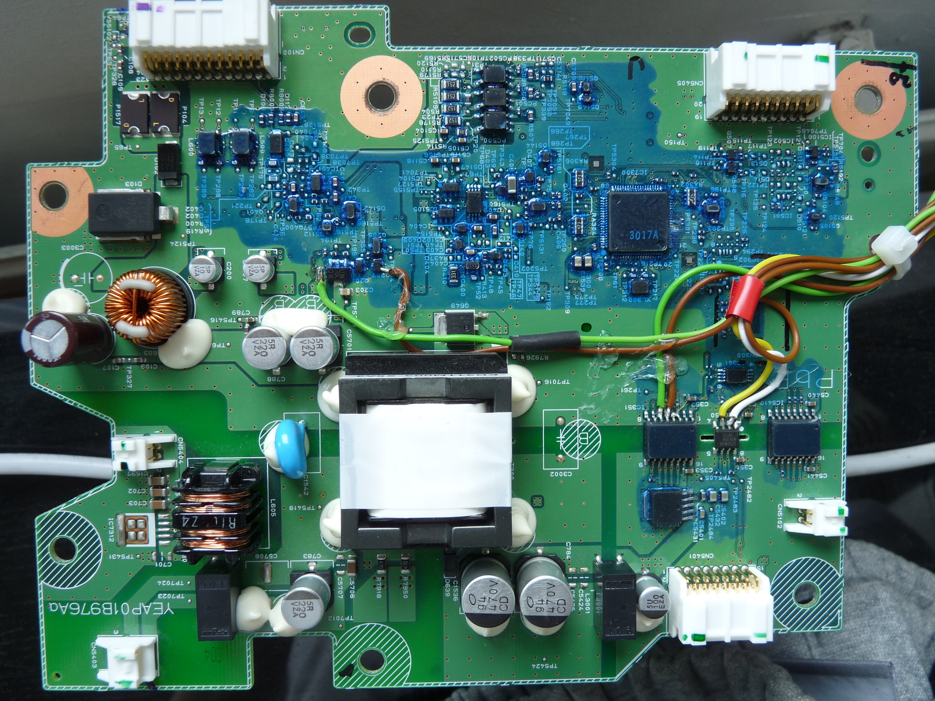

Hi, I will try to describe in detail how to force the ac-dc converter to work.
The first photo shows a general plan of the rear of the PDM.
For a successful launch, we need to modify the power control board.
https://ibb.co/txx1mzb
The second photo shows the main control board of the PDM, it is located in the upper part.
https://ibb.co/k15ZdB8
We remove the power control board and do the revision from the back. We solder the conductor to the gate of the field-effect transistor, an example in the third photo. If you pull it to the ground then the power corrector starts and the relay is turned on to supply alternating current to the rectifier bridge. CAUTION Do not apply AC power while the relay is on. you can turn on the power corrector only after preliminary charging the capacitors of the power corrector (this happens automatically through a powerful 10 ohm resistor when the AC is turned on)
https://ibb.co/rdVQbBP
Now we start the PWM. The fourth photo shows the revision for starting, in the same way we solder the conductor if it is pulled to the ground, the PWM will start, but there will be no pulse generation on the UCC2895 chip due to the fact that there is no voltage at the input of the error amplifier, it should be higher than 3.6 volts. Look at contact 20.
https://ibb.co/XZWQN90
I ask you not to pay attention to the many wires, I was experimenting)
The fifth photo shows the refinement in order to start the generation of pulses and successfully control the output current.
We need to raise the 6th pin of the MCP4728 microcircuit and solder the conductor to the printed circuit board for the 6th pin and be sure to output GND, since the unit is galvanically isolated from the power key control board.
Now when we supply voltages from 0 to 4 volts, we will change the current of our converter.
https://ibb.co/HxqqM6b
If everything is done correctly, we will see the generation of pulses on pin 18 of the UCC2895 microcircuit as shown in photo # 6
https://ibb.co/RP6GnT0

You can control the MCP4728 using I2C, there is a library in the arduino network) As I understand it, the inverter uses only 1 channel if you apply 4 volts, the inverter will work at full power.
In normal use, the processor gives a command via the I2C interface and the MCP4728 generates a voltage from 0 to 4 volts on channel a. I have not finished the hardware study of the inverter yet, but I'm sure that current and voltage readings are coming to the CPU!
In my project e-baggi will be able to power the consumer with a PDM with a voltage of 220 volts DC from the main battery) and charge too!
Good luck everyone and be careful with high voltage !!!!!!

I think a modboard could suit the PDM quite well. In these two photos are the connections that I used to make it work. This is for DC-DC operation and AC charging. No CHAdeMO. Some traces to the main MCU have been cut, I can't remember which ones, but I'm sure I2C at least.
I have wired an Arduino Nano to all this and it works but the code I'm running is kind of terrible and specific to my conversion.
The wires connected underneath directly to the connector:
- Brown: EVSE PP
- Green: EVSE CP
- Yellow: CANH
- White: CANL
The wires connected to the top side from left to right:
- Green: Constant 5V probably (don't remember)
- Brown: Input 5V to power the rest of the thing on (probably)
- Green: An on/off signal of some sort
- Brown: Another on/off signal of some sort
- (Next to brown): There's a solder blob to short the pins for some reason
- Yellow: I2C
- White: I2C
I documented almost all of the brain board connectors here altough it's in Finnish: viewtopic.php?f=11&t=151&p=1774&hilit=cn100#p1774
You can control the charger and DC-DC converter by just using the isolated I2C bus and the on/off signals going through the ISO7241C chips that are located on the brain board. You don't need a library for the MCP4728 DACs, it's very simple to control using raw I2C. There are a bunch of I2C ADCs on there that give voltage and current readouts. All those are listed in that link.
- Brown: EVSE PP
- Green: EVSE CP
- Yellow: CANH
- White: CANL
- Yellow: I2C
- White: I2C
