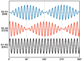

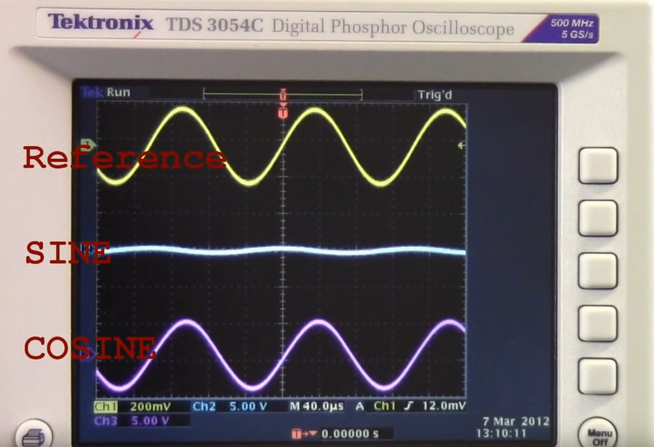

It is not possible to say if your sine and cosine feedback coils are connected properly because we don't know what angle the motor shaft is at and we can only see the sine and drive signal. The attached images may help to confirm you have the feedback signals wired correctly. Note that the second image is at zero electrical degrees. Notice that between 0 and 180 degrees electrical that the sine feedback signal is in phase with the drive signal. One thing that is assured is if the feedback signals are not wired correctly the algorithm that calculates rotor electrical angle will not be correct.
I would not think that reversed feedback signals would cause jitter like you are seeing. The common neutral point voltage for the feedback coils looks ok.
Have you checked the cosine feedback signal?

I assume you're using the sine firmware as it's an async motor. And I further assume that what you're seing is the slip frequency :) So temporarily set fslipmin to 0 and re-observe.
You resolver signals looks good to me
