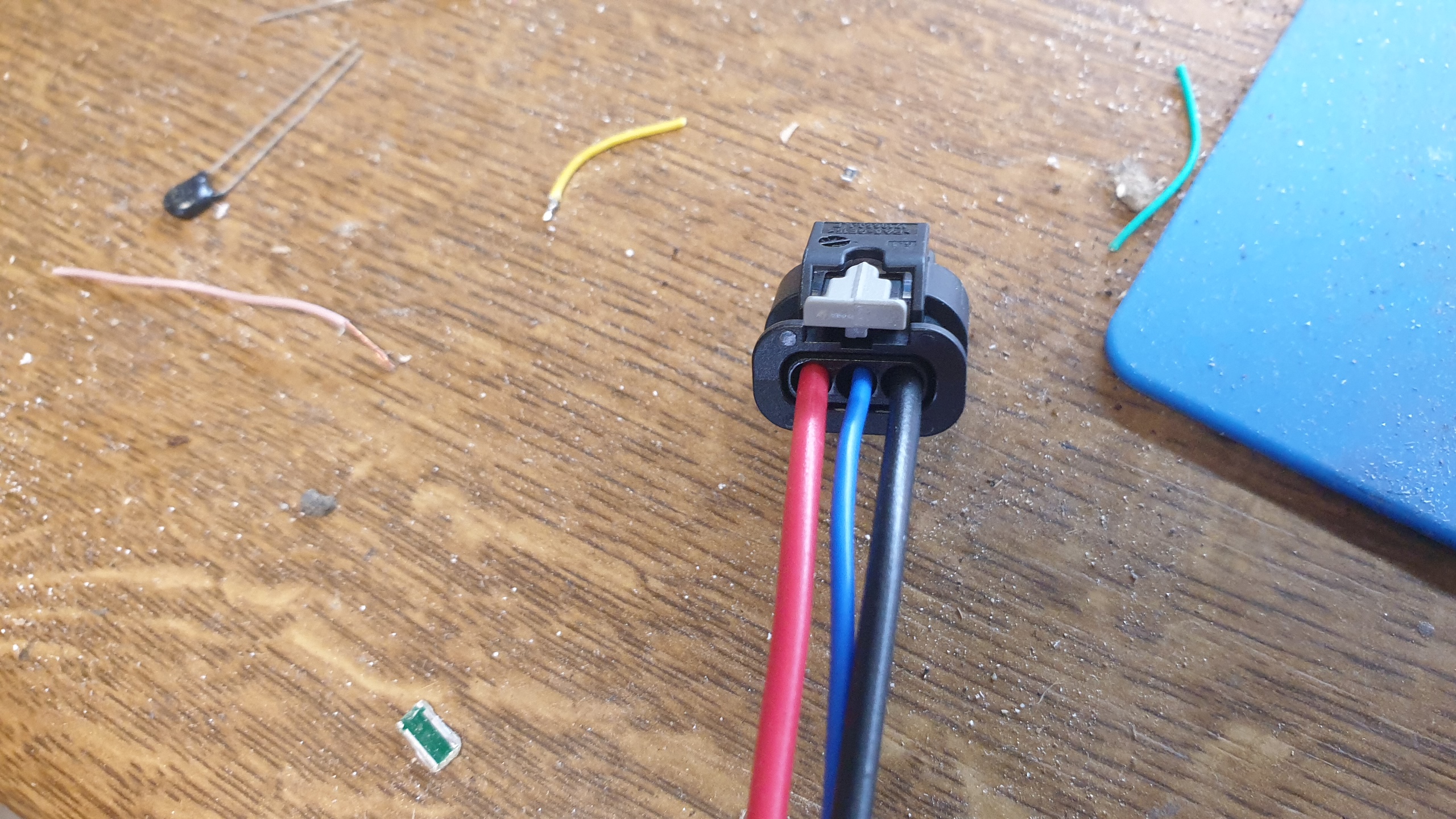

I had someone ask a few days ago about the oil pump pinout. Red = +12 , Blue=LIN , Black=GND.

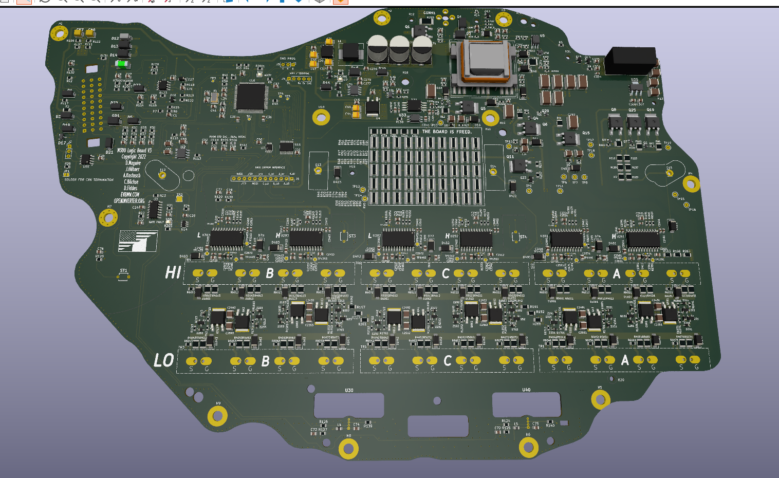

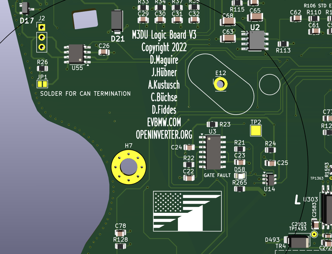

Ordered all the out of stock parts from JLC. Aiming to order 10 boards in approx 2 weeks.
Major changes on the V3 from V2 :
-HF Resolver
-Terminal 15 input and permanent 12v input. No more turning off a live inverter. Input is PA2 on MCU. MCU controls board power via PA15 and active discharge via PE12.
-Protection diodes on all inputs.
-Hole alignment fixed (fingers crossed).
-Added 2 more names to the board of folks who are and have done a LOT of hard work on this project.

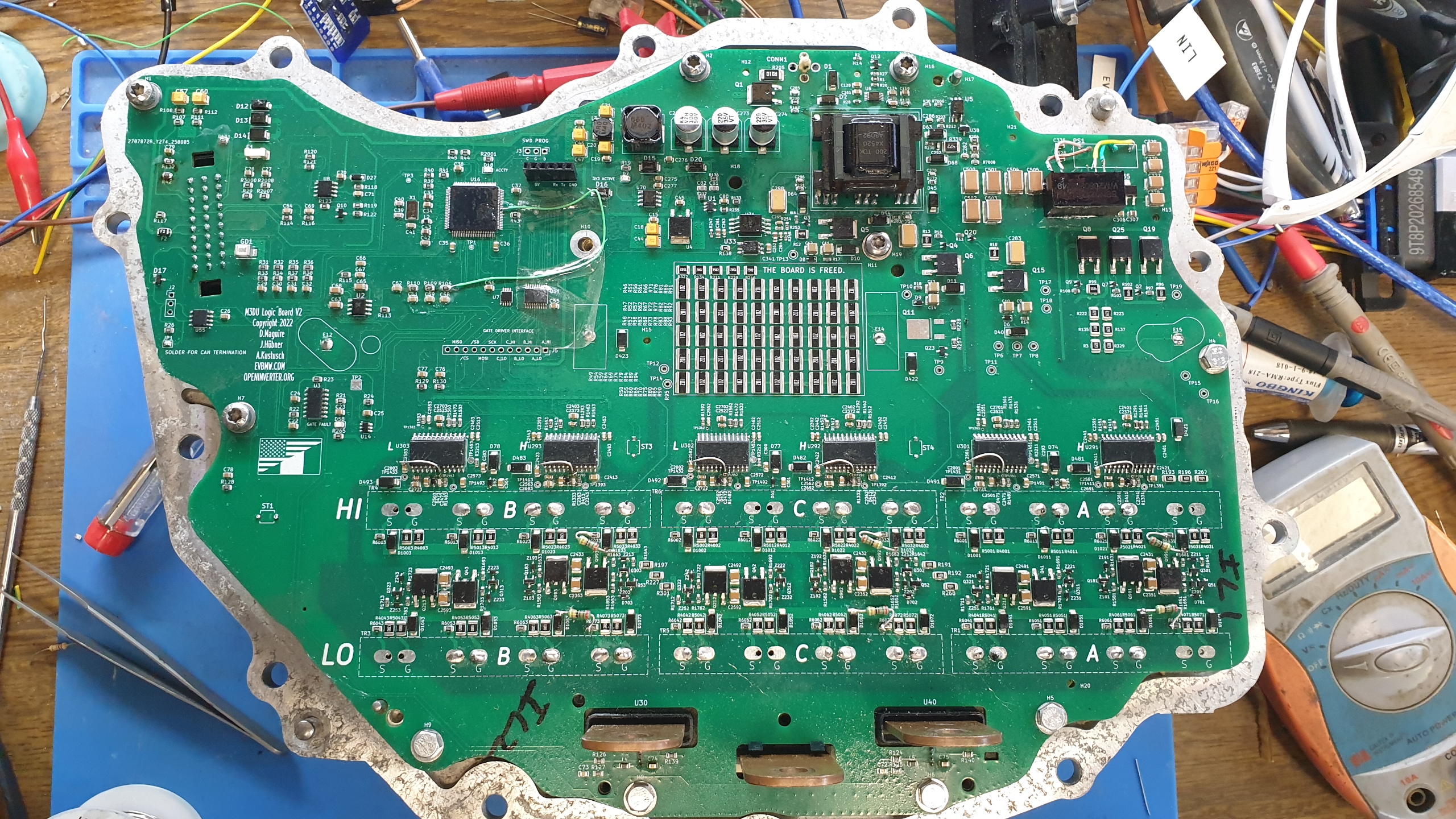

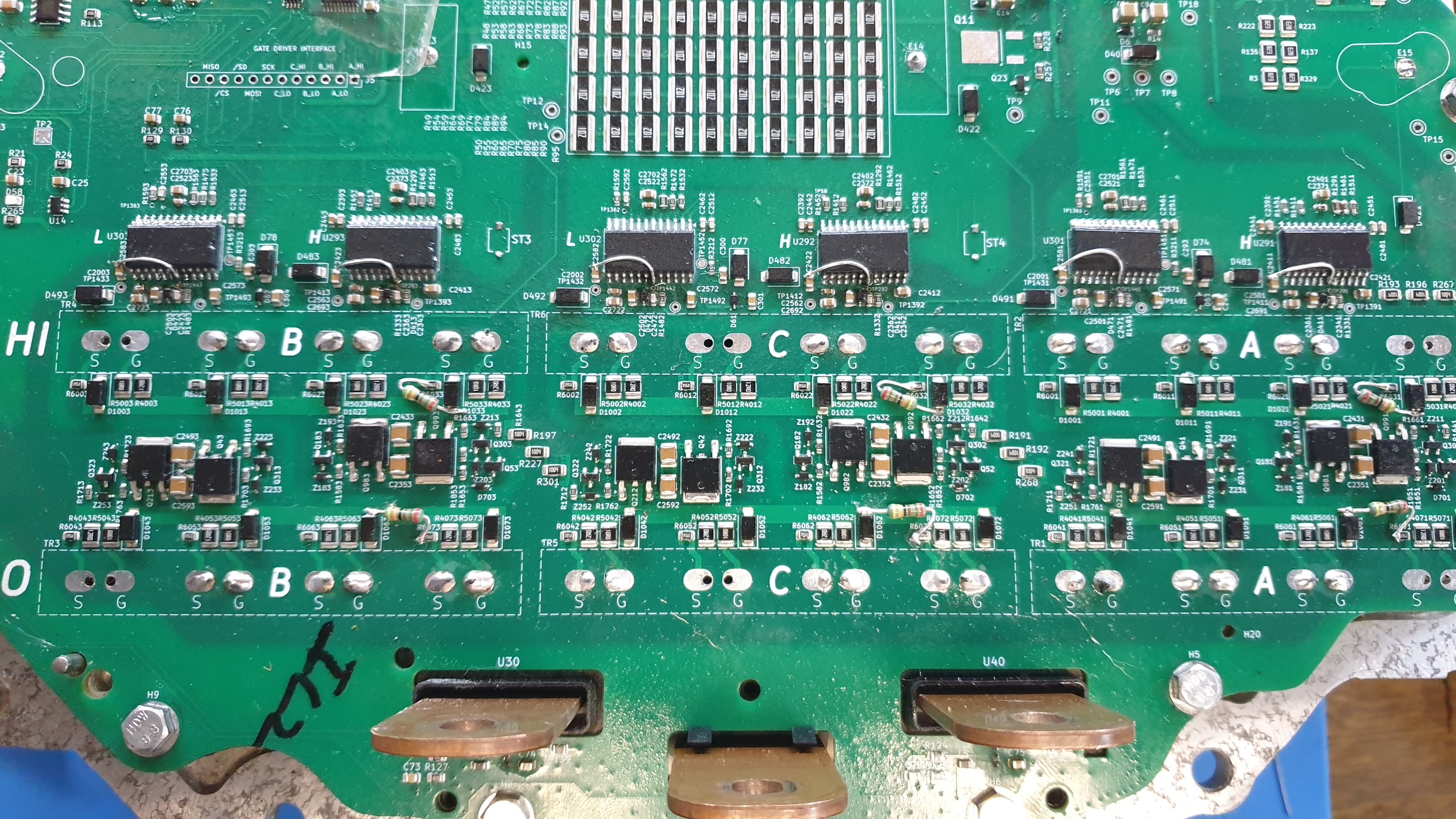

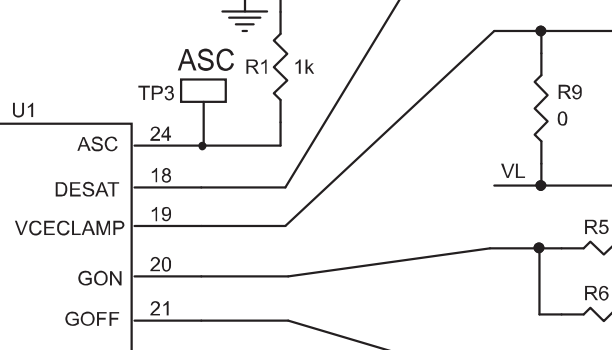

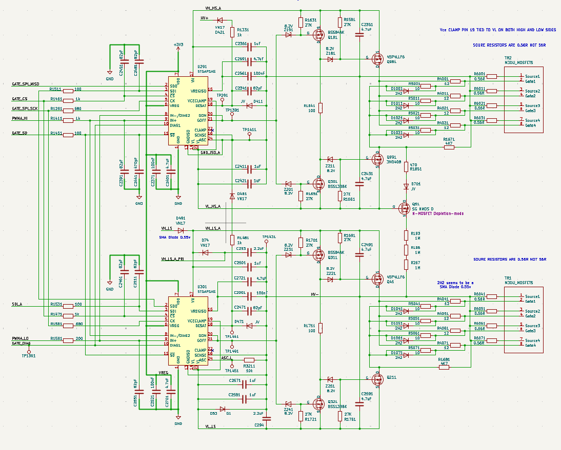

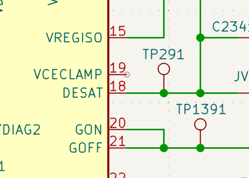

Well, I done screwed up again. Param changes made no real difference. Below around 80v inverter behaves fine. Much over we desat trip on all 3 high sides as soon as pwm even thinks about leaving the STM32. So I went back to the circuit diagram and probed a bit around the high side driver of an OEM board. Didnt take long to find the culprit. On the OEM board high side pin 19 is connected to VL. On the V2 (and V1) OI board pin 19 is floating. Best guess is once we got up on volts it started working the transistors enough to put some noise into that pin. I'll have to take the inverter back out of the car and put some links on to prove the point. Thankfully had not ordered the V3 batch as yet.
davefiddes
- Posts: 416
- Has thanked: 206 times
- Been thanked: 256 times
- Posts: 4000
- Been thanked: 1114 times

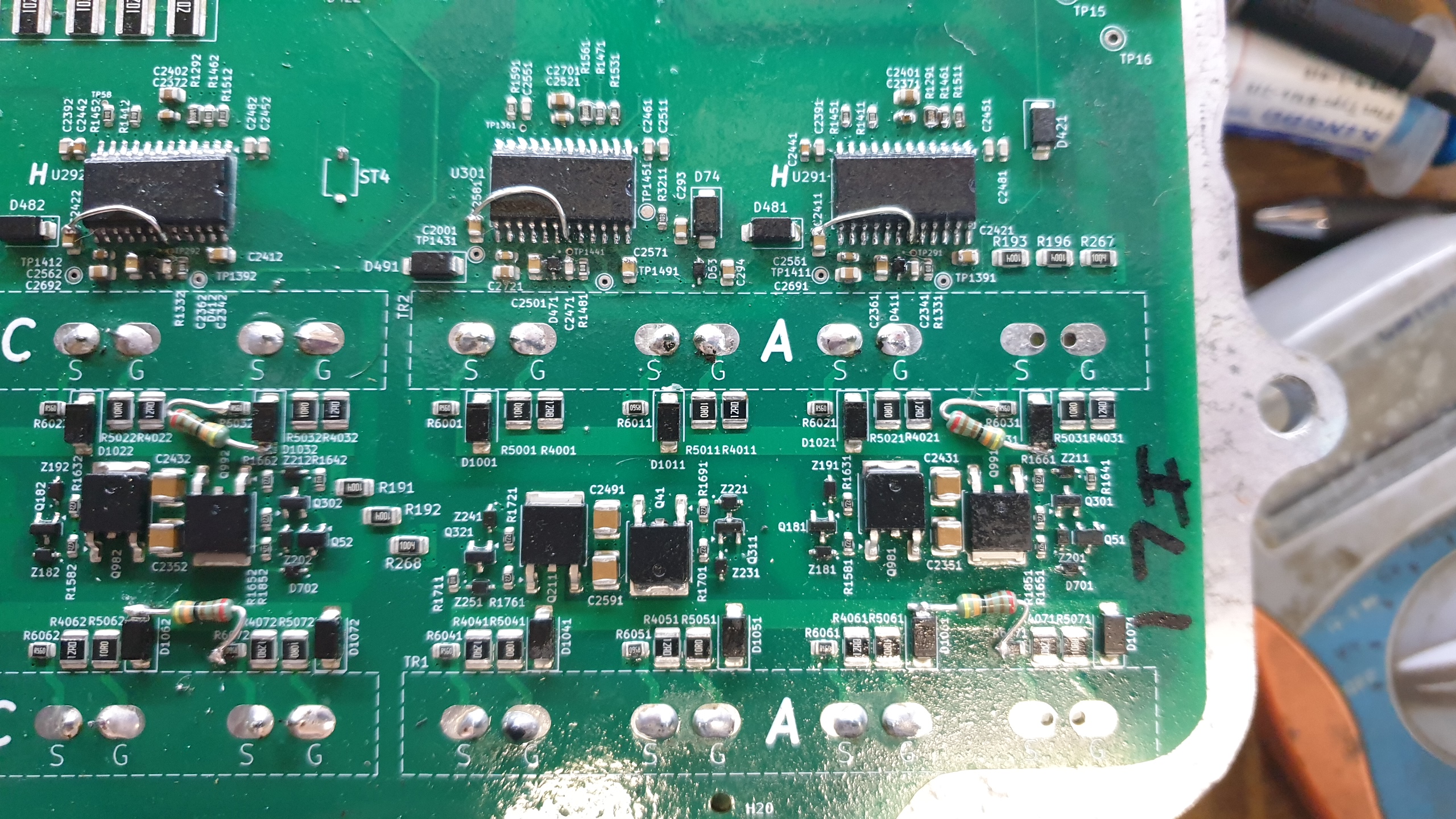

So found another problem on a re run through of the gate driver section. 4K7 resistors R1671 and R1681 in the attached were missed. At least now the diodes on the turn off resistors make sense. Confirmed after removing a high and low side driver chip that indeed pin 19 is tied to Vl on both high and low on OEM board. Gonna start the process of getting the inverter out of the car.
- Posts: 4000
Ok. Update time.Mostly good news but not all the way yet. Got the inverter out of the car and did the mods as in the circuit diagram above. Two things happened. All the spurious high side desat trips at hv voltages stopped and as an added bonus the deadtime setting can be wound right back down to almost nothing without any ill effects. So started testing with 180v. Tripped off on "DESAT" as soon as throttle pressed but this time its not coming from the power stage. Rather SOMEONE left the desat pin on the mcu floating and with added voltages on the board it started picking up enough noise or leakage to trip off. Remapped it to a pin with a pull up and problem solved. Motor spins. Up to 240v next. OVERCURRENT trips as soon as throttle pressed. Wound up the current lim and away we go. Perfect spinning. Up to 360v. More overcurrent trips as soon as throttle pressed but this time even with current limit on the moon it still trips. Have seen this before on the SDU. Super tired and pained but happy with progress. Also VERY happy the board can take 360v with no flashes.

The gate drivers are configured to have a deadtime of 800ns. If you go below this (deadtime param setting of 28 i believe) it'll start throwing DT faults and shutting down.

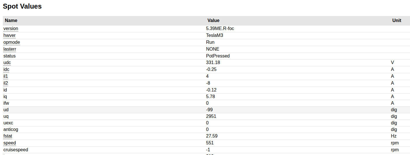

Well that was epic. Now running the M3 drive unit at full HV (sorry batt a bit low at 330v). Will give a propper update soon. Of course it wasn't just one problem but its now even smoother than before and spins up the motor with only 100mA.
- Posts: 4000
First tests with Regen and a 330V battery. No trips or judders. 1C temp rise on heatsink after doing this for about 30 mins.

V3 schematics and board layout now on Github. Review and board cleanup continues ahead of first real order.

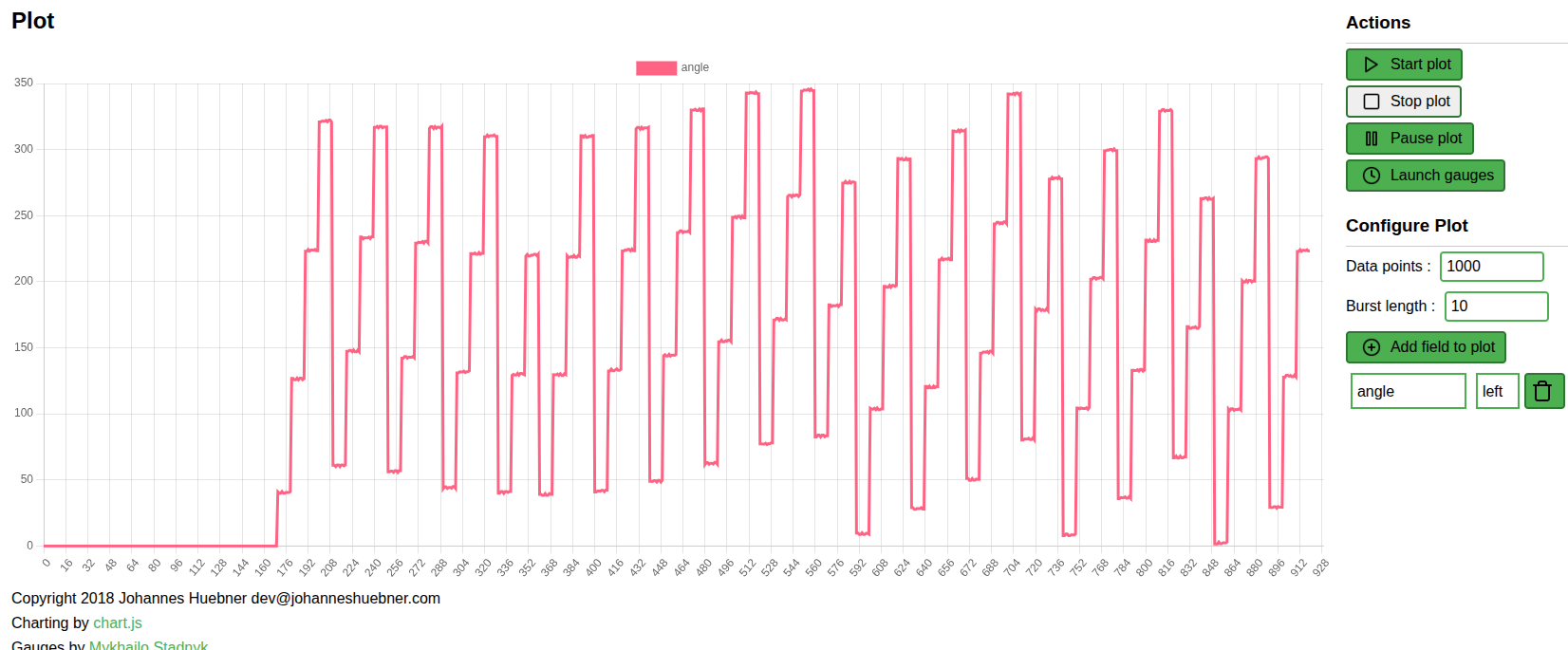

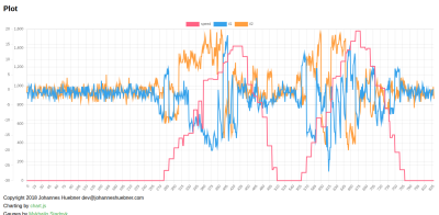

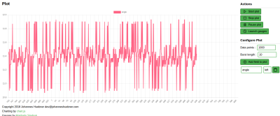

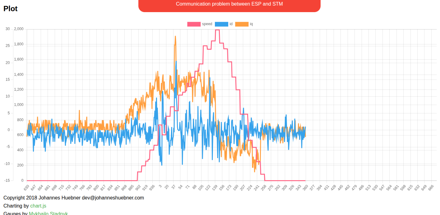

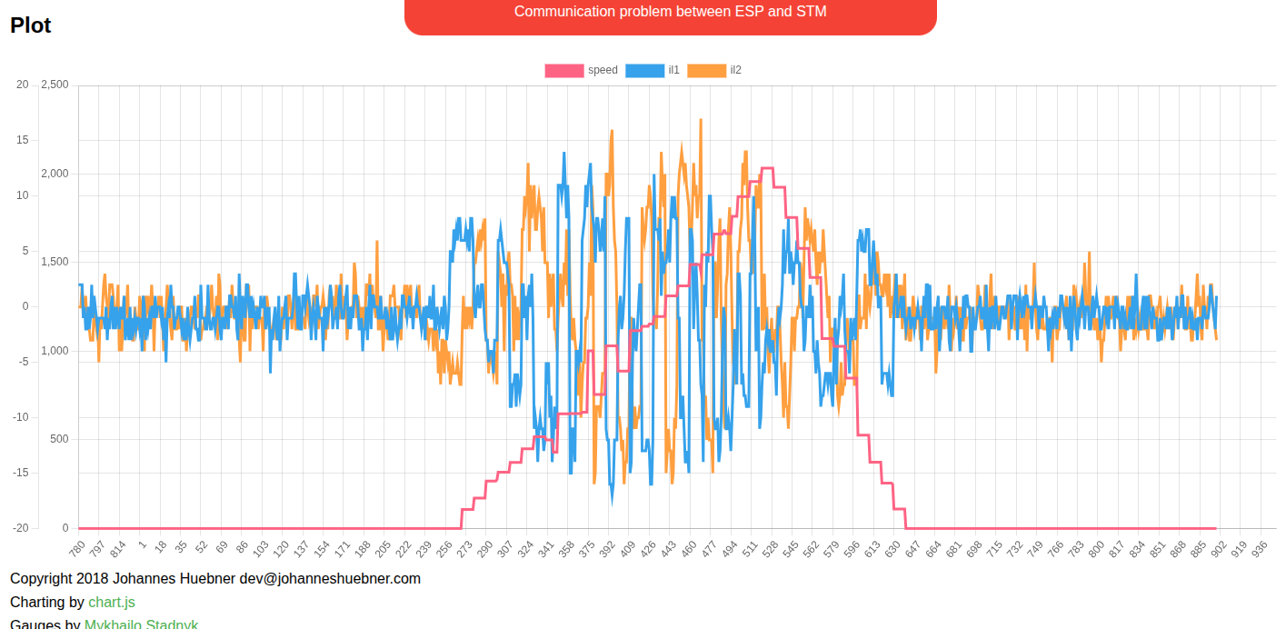

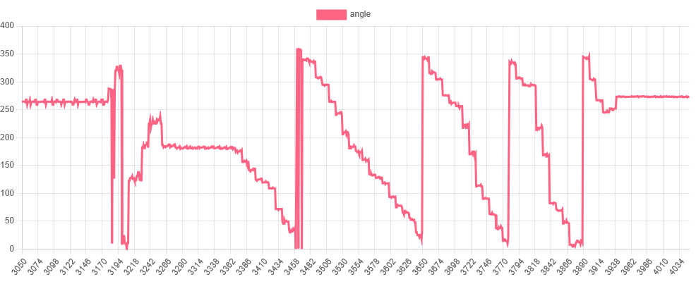

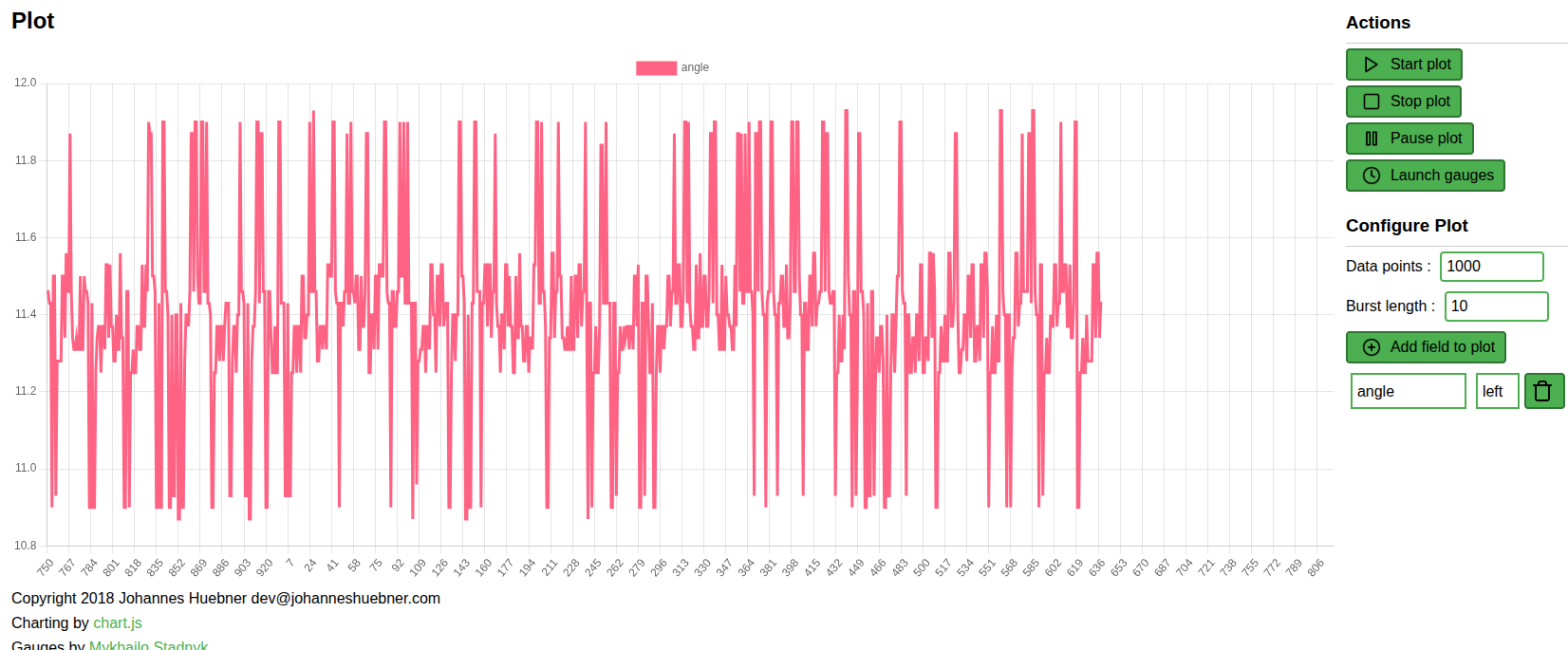

For fun and adventure I decided to hook the front drive unit up to the rear drive unit inverter and V2 board. Being a bit rusty on sine firmware I gave it gas. The inverter pumped 700 peaks amps into the motor , flash melted all 3 6mm sq leads into a pool, tripped desat and gave me the finger. Some new leads later it would seem the sine firmware thinks the rotor is turning when its stationalry. One plot is with sine and one with foc so looks to be a sw problem.
davefiddes
- Posts: 416

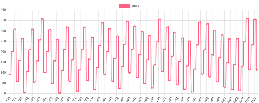

That's odd. It seems to be working for me:
This is what I get when I run my inverter in manual mode and run an uncalibrated nut round inside the resolver ring. This usually produces a much rougher signal than the official resolver rotor but still a stable angle that reflects the position/movement.
Can you provide your parameters? I think I had to change the encmode to HFResolver after I installed the sine firmware. I'm running with polepairs = 3 and respolepairs = 3.

I'll post the params tomorrow. Can you try run mode? I did not try manual today but can do tomorrow.
davefiddes
- Posts: 416
Ooh, that's wild!
Should have tried normal run mode before...in my defence the button for manual mode was just there waiting to be pushed. I'll look into that tomorrow.

This is how it's supposed to work
https://openinverter.org/wiki/Parameters
Motor rotor angle, 0-360°. When using the SINE software, the slip is added to the rotor position.
This is not the physical angle, but a "virtual" angle. E.g. if your motor has four pole pairs (motor and resolver), then per one physical revolution the "angle" will change four times between 0 and 360°. Discussed here: viewtopic.php?p=71253#p71253
