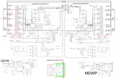

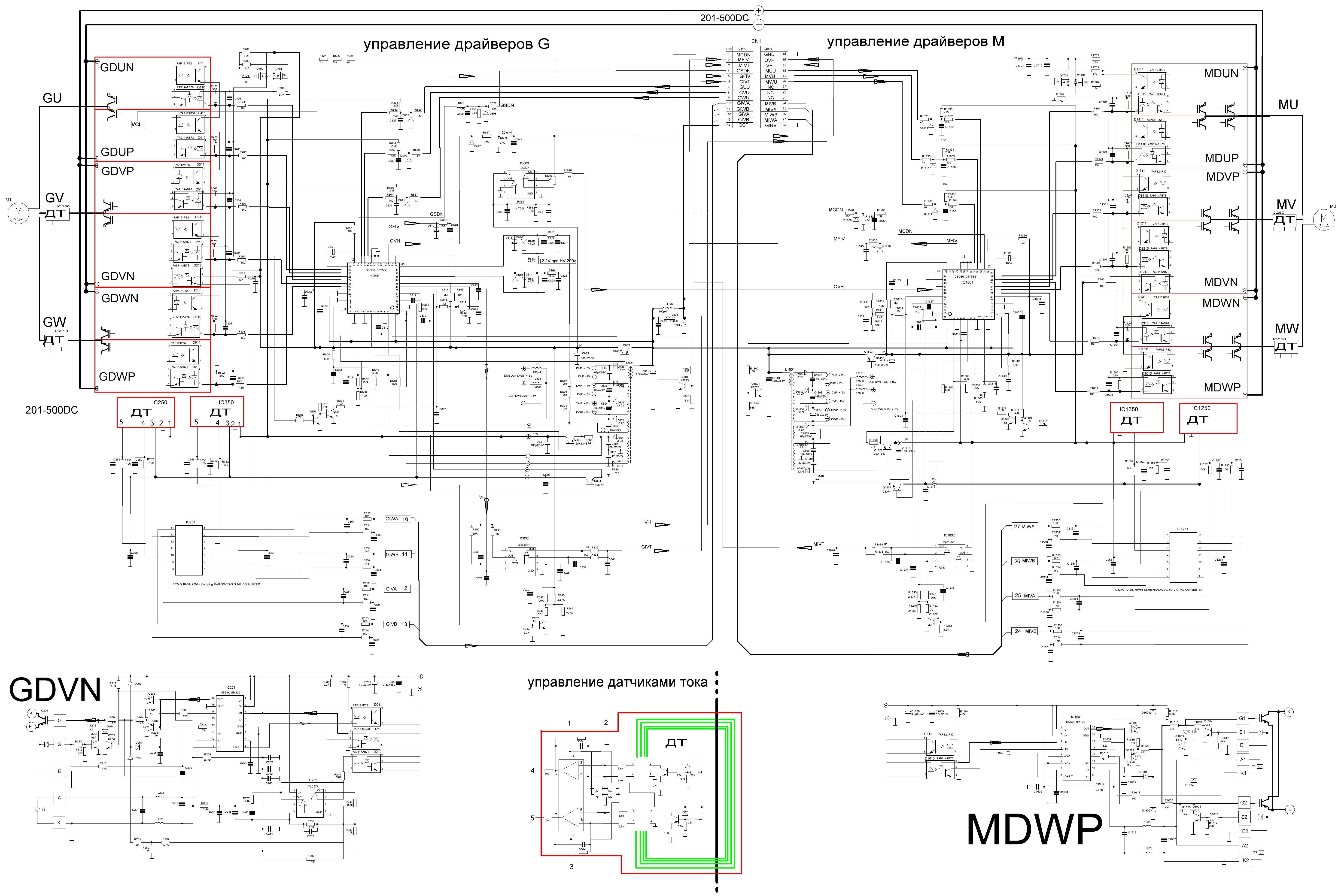

Post by dron_skm »
My friend, this is a schematic diagram of an inverter ( though without a booster) . made by hand, small errors are possible. I think this will make your project even better.
EDIT by admin: this post was reported as the diagram was first posted here: viewtopic.php?f=14&t=906
Bassmobile
Posts: 94
Location: USA
Has thanked: 7 times
Post by Bassmobile »
dron_skm wrote: Mon Jun 14, 2021 4:26 pm My friend, this is a schematic diagram of an inverter ( though without a booster) . made by hand, small errors are possible. I think this will make your project even better.
Wow. Awesome work, but would it be possible to get an English version? lol Not many of us read Cyrillic Russian.
Posts: 1080
Has thanked: 478 times
Been thanked: 308 times
Post by MattsAwesomeStuff »
Wow! Amazing! Thanks for putting the effort in! I'm sure this will come in handy in the future.
