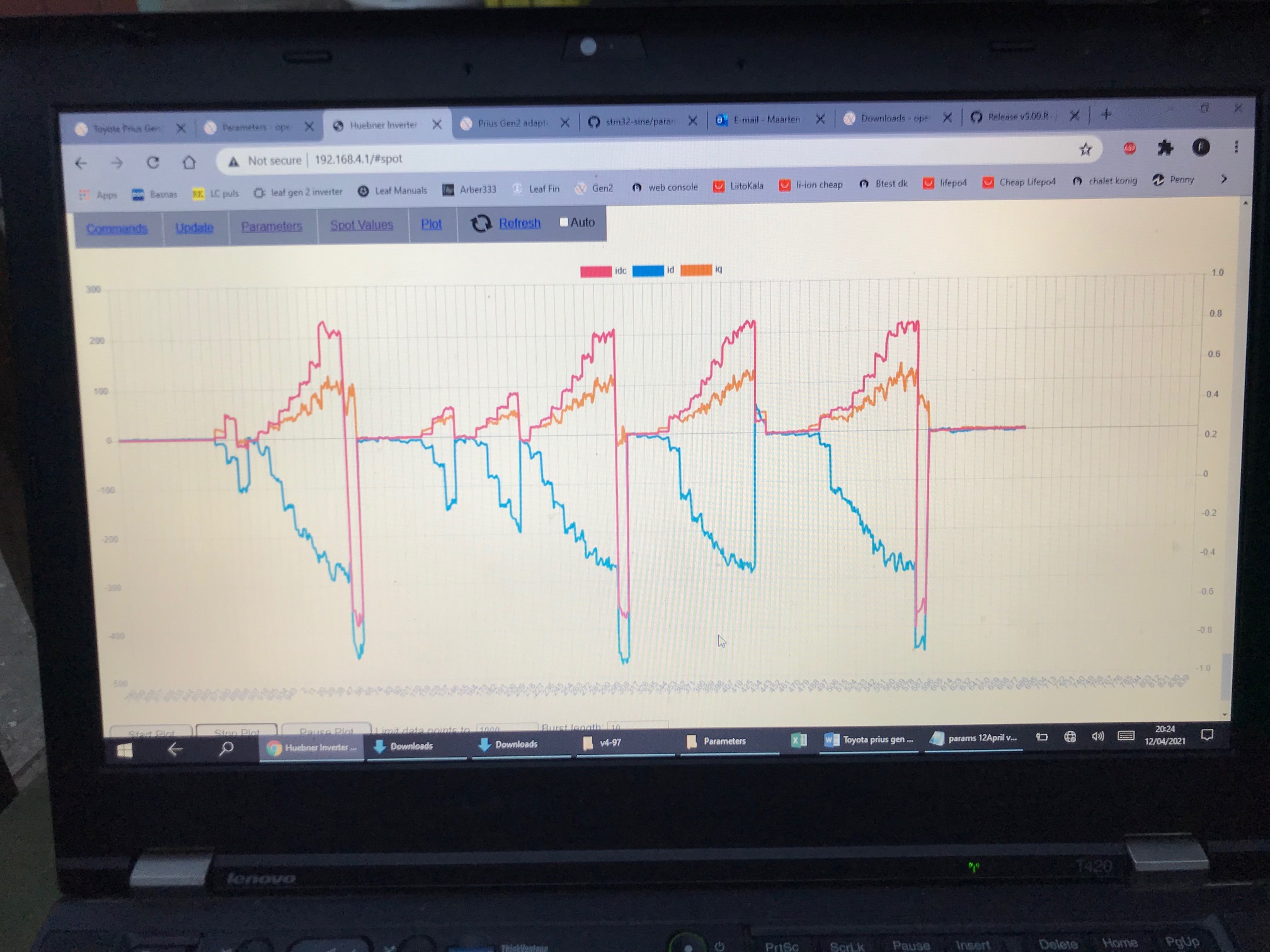

Hi guys,
After a first run on the road, I have an issue (VW Polo with a Prius Gen 2 inverter and outlander rear motor)
when accelerating until approx 200Hz you can play with the speed, and remove you foot from the throttle instantly without problems. But once on a higher speed and remove foot from the throttle massive push back (regen or blocking), without load as in this movie, but also while I was driving with a higher rpm once remove the foot from throttle (no brakes) massive push back, like an emergency break. not good for my gearbox and motor.
tried to minimize the regen setting and "throtmin", but no effect
what could cause this?

Posts: 3795
Been thanked: 411 times
Bram wrote: Sun Apr 11, 2021 7:23 pm Hi guys,
Yes... this is why i went Lebowski route for my immediate conversion.
Where is your max RPM point? Can you extend that to 600Hz? You may also change "idcmin" to 0 to try to get rid of regen.
Been thanked: 1913 times
Uh lets not send people to another system but rather solve the problem here.
What version are you running?
I remember that issue from way back.
Only parameter that is different from mine is curkp=64, I have it at 32.

arber333 wrote: Sun Apr 11, 2021 7:44 pm Yes... this is why i went Lebowski route for my immediate conversion.
I tried the idcmin to 0, and unfortunate that didnt work.
When I plot 'idc' while turning, it still created a -300Amp when letting go the throttle.
How can i turn off regen completely?
You turned it off completely, already by setting brkmax=-1. idcmin essentially just limit brkmax.
So it is some controller overshoot that still causes unwanted regen. I'm assuming it is just a surge and than tapers off?
Parameters you can play with, one at time:
- curki - increase/decrease by 2000 digit and see if it has an influence
- curkigain - +-5 digit increments
- fwkp - +-10 digit increments
Flash this firmware: viewtopic.php?p=26076#p26076 (will be released regularly soon anyway)

johu wrote: Mon Apr 12, 2021 8:27 pm You turned it off completely, already by setting brkmax=-1. idcmin essentially just limit brkmax.
to answer your question; I'm assuming it is just a surge and than tapers off?
please check this picture, pretty radical and steep, http://breitt.nl/images/IDC-ID-IQ%20plot.jpg
I hope this helps
EDIT by johu: attached plot
Ah that was you :)
I wonder if something is not tuned right. Sure about syncofs? What happens with fwkp=0? Try the other suggestions also.

After days of testing, swapping and swearing we have results!
The car drives very smooth, and seems pretty efficient too. I'm still driving with a 100A fuse (72S Li-ion), but this will probably die fast, once we gonna try some fast 0-60Km/h :-)
The trick;
I lowered the curkifrqgain from 50 > 0 and Curki from 20000 > 2000
it seems pretty radical compared to the defaults, do you believe this could do any harm?
Background
I have 3 Gen2 inverters first I tried number 1, he had this "regen/overshoot" issue per above, first after tweaking i couldn get it smoothed out, so I replace the inverter with number 2, he reacted different, no overshoot so i thought this is good, different is good :-) but he started not perfect as number one 1, tweaked him in closed loop, but noway he could start loaded (wheels on the ground), only shaking etc. cost me 8hours of work, but now know what a bad inverter is (probably)
Tried the 3rd one, reacted exactly the same as the first, so the overshoot is not a borken inverter/IGBT's then!? that was cleared out. I had to listen to Damien "you cant kill a toyota inverter" even after fedfing the inverter 14.5V (closer do 15v saturation?? you become disperate if it doesnt work, sorry for that) instead of car battery 12V, the igbt screams a bit louder, but now difference.
I've learned a lot, at the end lowering curki's did the trick for me, probably I will tweak more coming days, but just wanted to share this.
It's surprising, but I do think curki is somewhat motor dependent. So why not. It won't do harm as in breaking something, you just have to check for good performance and behaviour at different speeds and torque requests.
