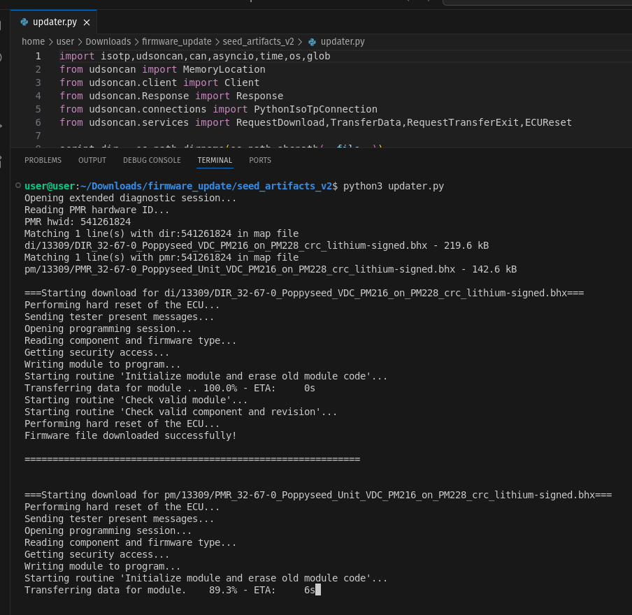

In progress. Now it's possible to flash any version of Tesla firmware via CAN, change the motor config, etc.

Working on a new CAN architecture of M3/Y and it's quiet interesting. They removed party can bus, hvil and firmware files became lighter. Also there is no physical connection with gas pedal and its state is transmitting via can. What about immobilizer? It's still there, but VCSEC module is now integrated with one of the body controllers. So what can I say? I liked work they've done. Drive unit can be controlled just with 4 wires (+12V, ground, CAN) and everything looks now more elegant and minimalistic.
Made a script that is searching matching firmware and after flashing it into the drive unit.

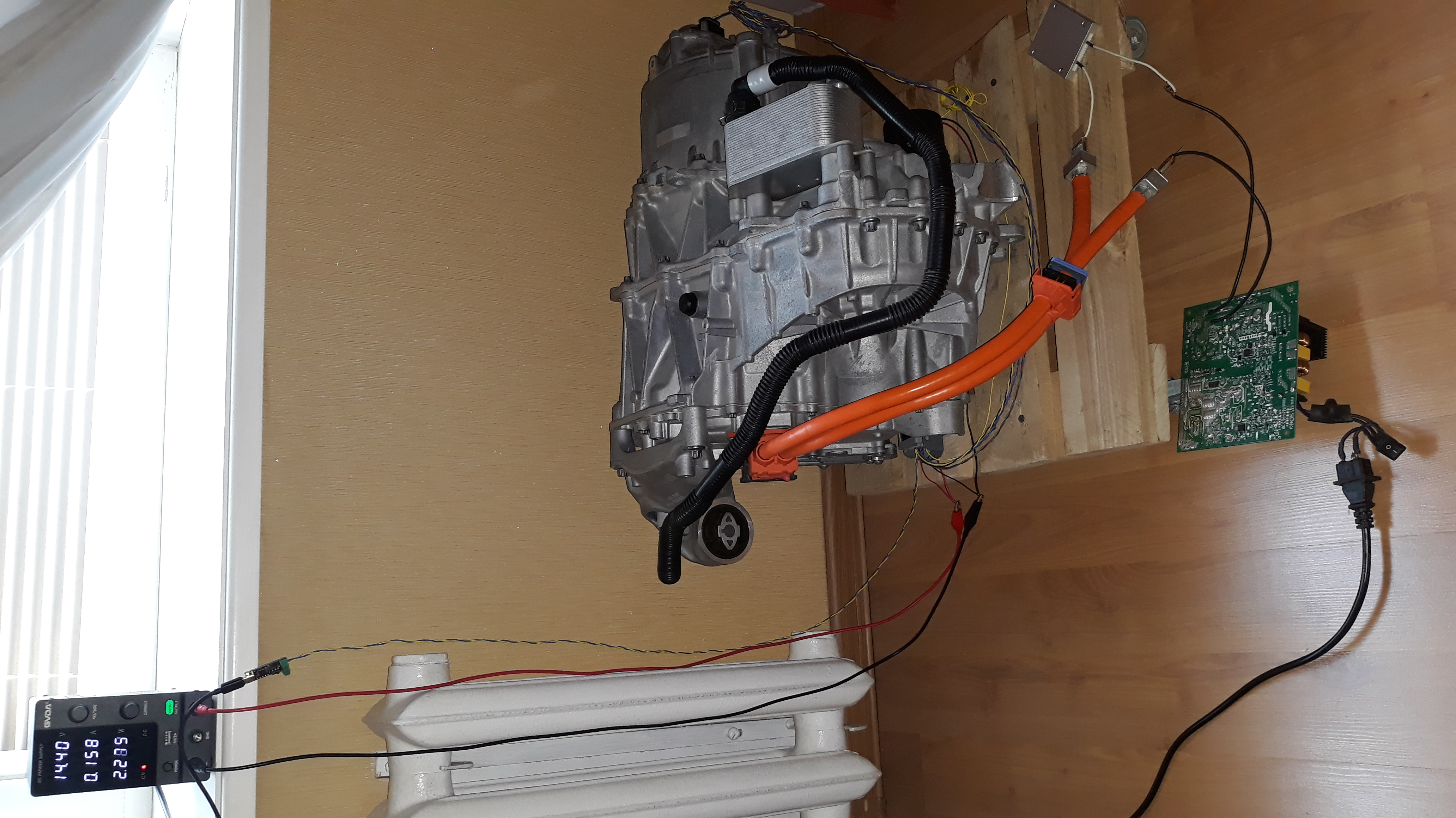

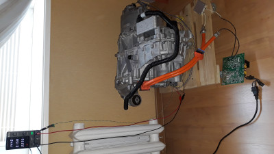

So, it took three working days to get the drive unit running on the M3 Highland firmware version from 2025. As you can see, it works. There are still a few details to tweak.
Posts: 4000
Been thanked: 1116 times
Re: Trying to run Tesla M3/Y Rear Drive Unit via CAN
You have a WAY more tidy workspace than me :) I notice your drive unit has no temp sensor on the resolver side. O the 3 I have only one has a temp sensor. More reduction I guess.

It's turned out that new architecture is a bit more complex than expected, but that only made it more interesting. I'm still trying to figure out how to enable R. However, everything is perfect in CAN, and the drive unit has zero errors.

Managed to find R. Also thanks to the new architecture turned out that it's possible to spin the motor in reverse at the same speed as in drive (approximately 260 km/h).
Of course all tesla's protections works automatically (overheat protection and much more).
I'm still need to do some work. Have to write a script for adjusting regen force, cruise, speed limit etc.

Drive unit spins on 2025 software with the original accel pedal. On this version motor is noticeably quieter than on the previous from 2023. Apparently, Elon improved something (well done).
