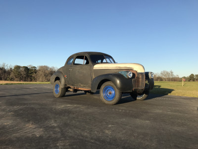

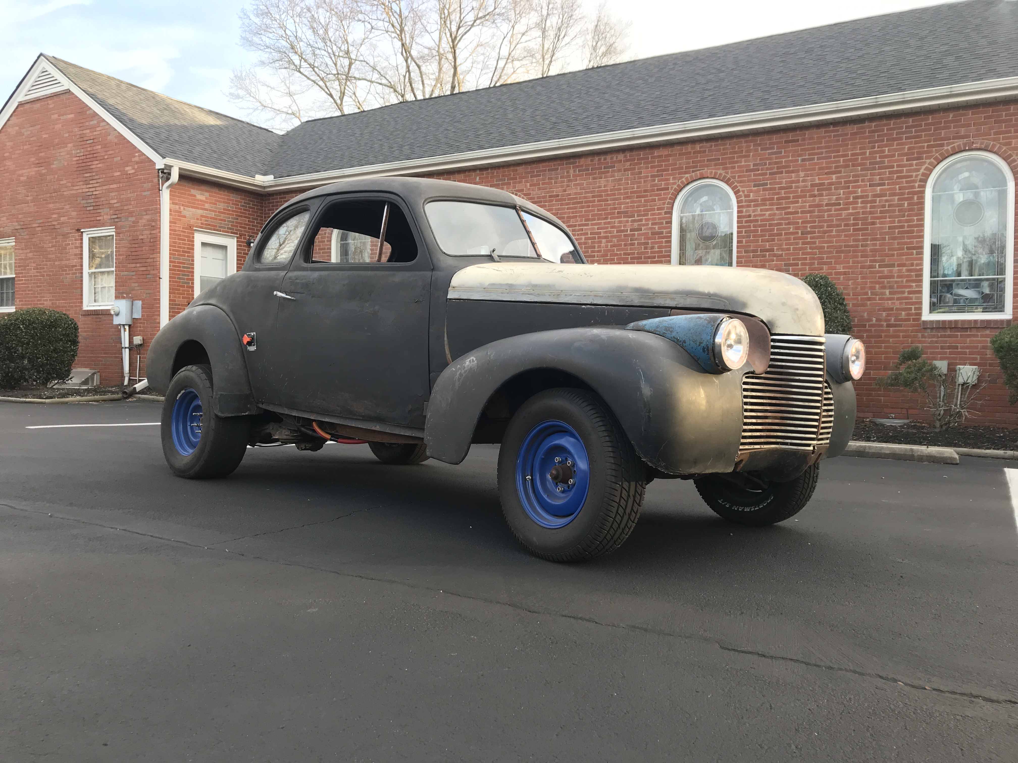

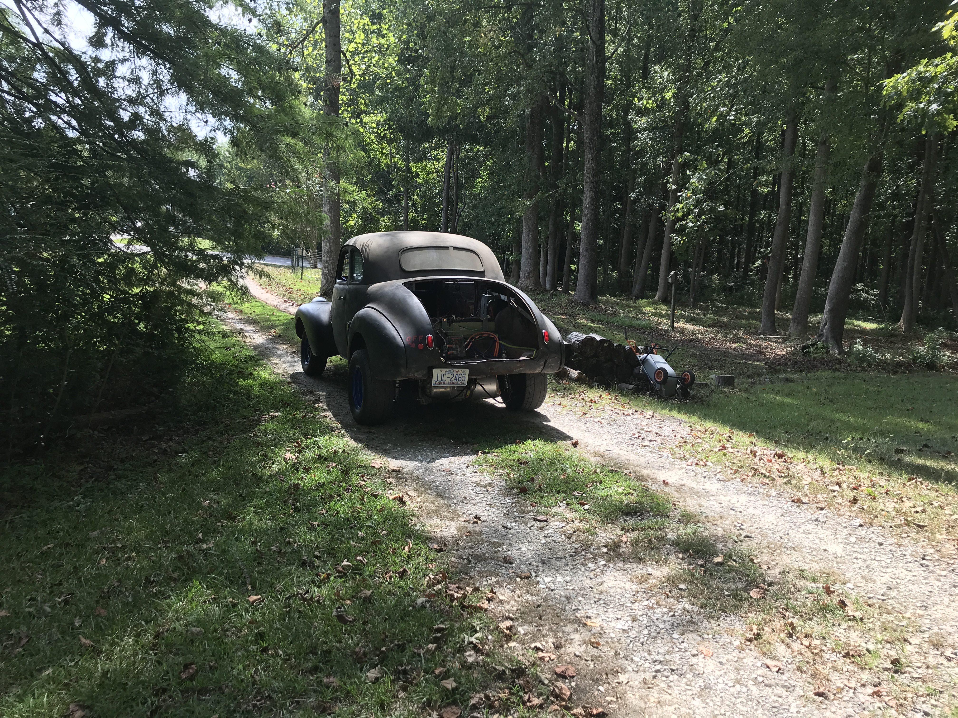

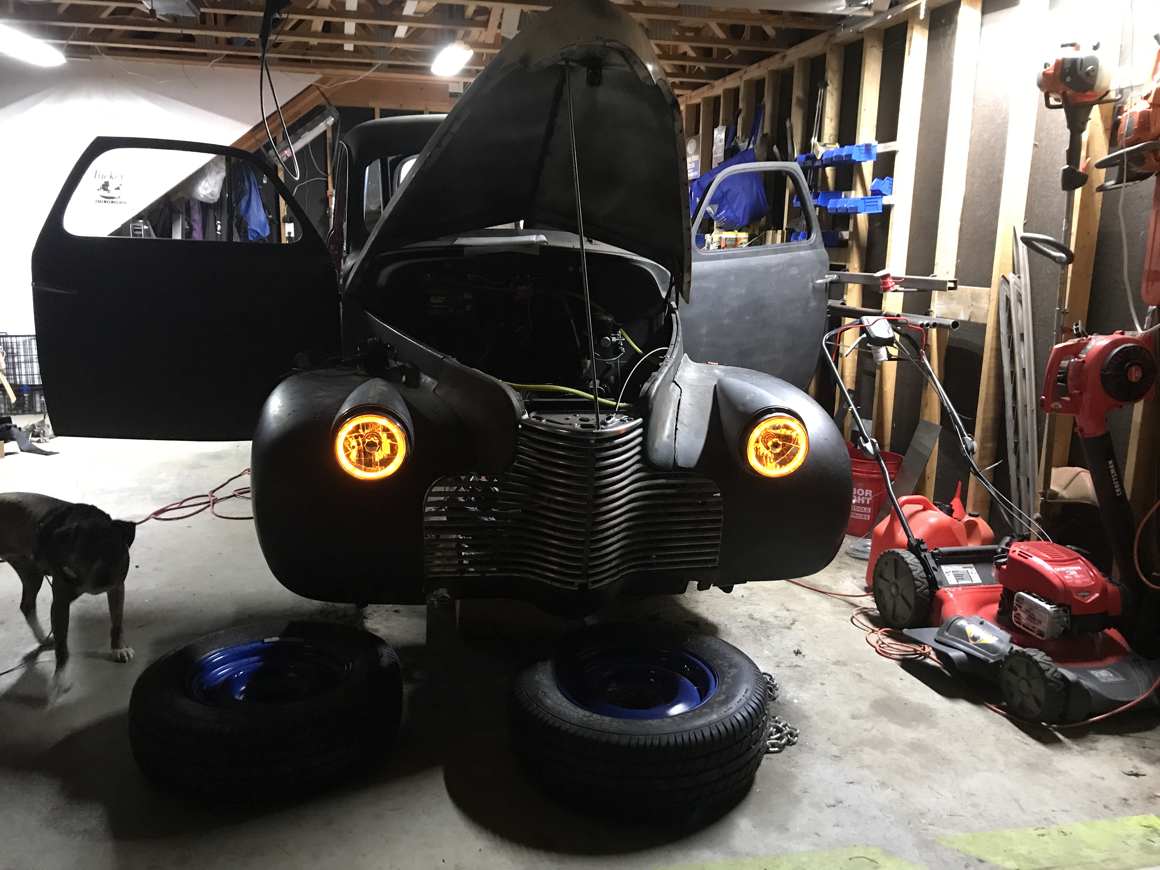

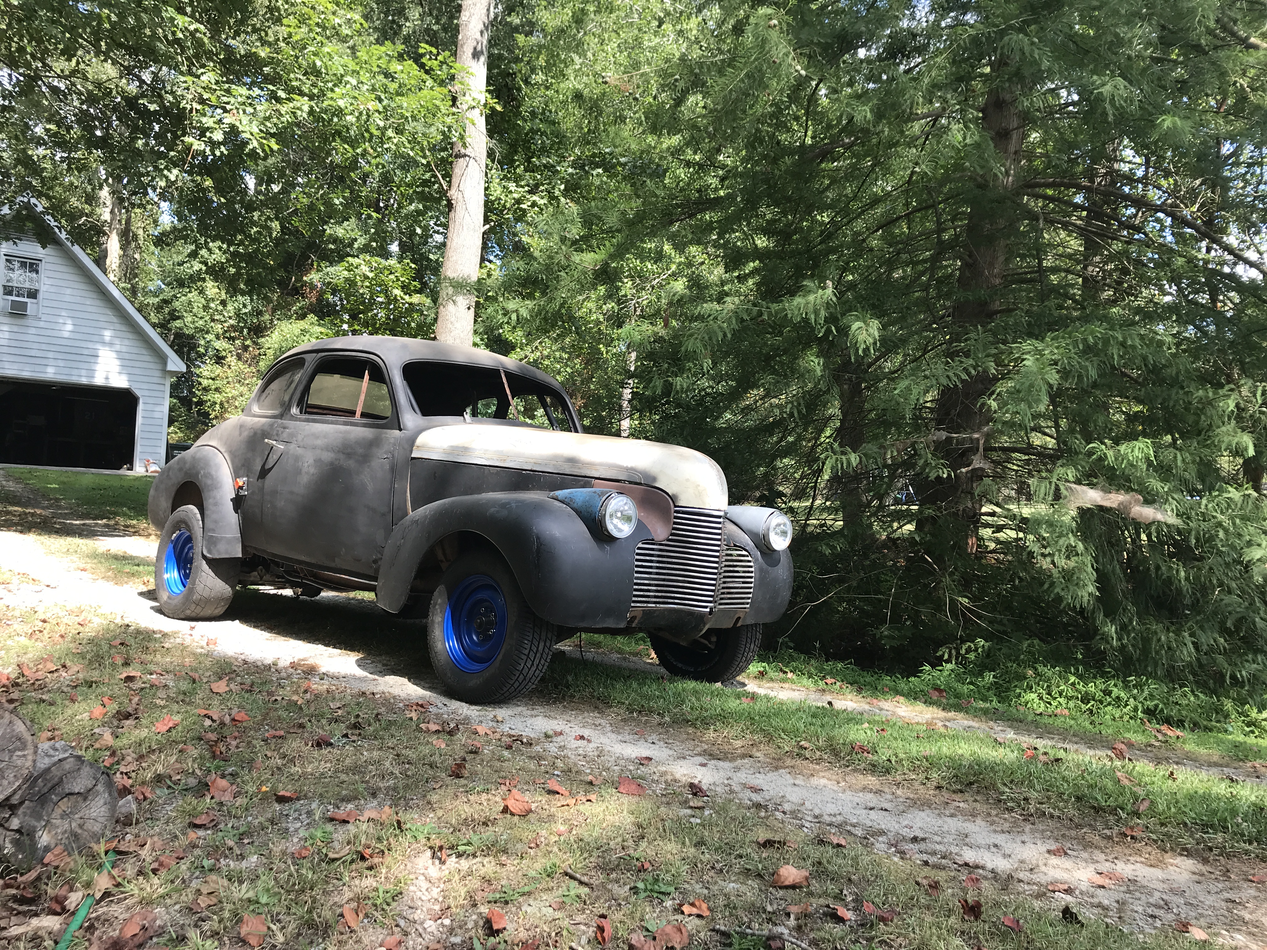

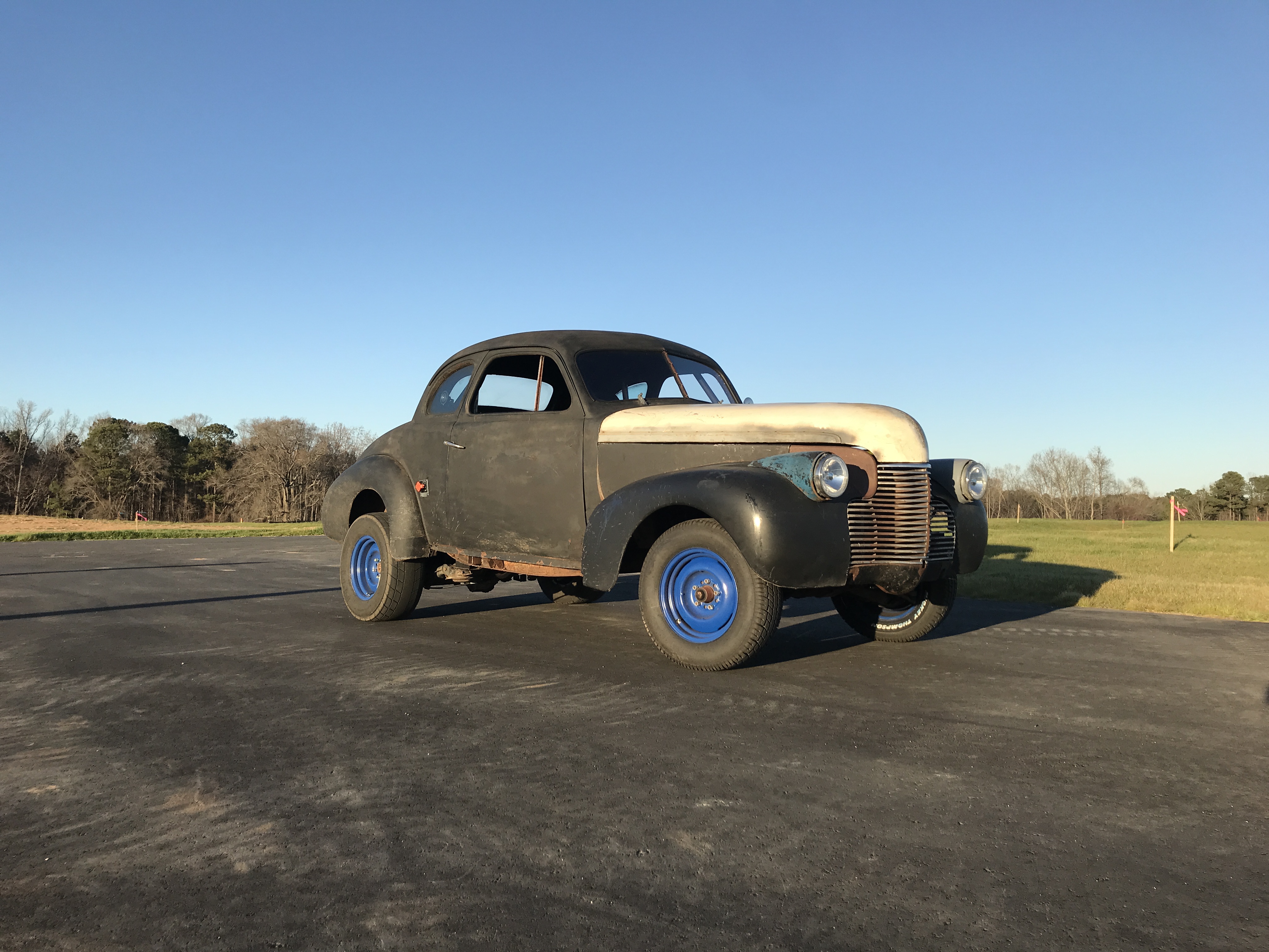

I figured it was time to post some more images of the car.

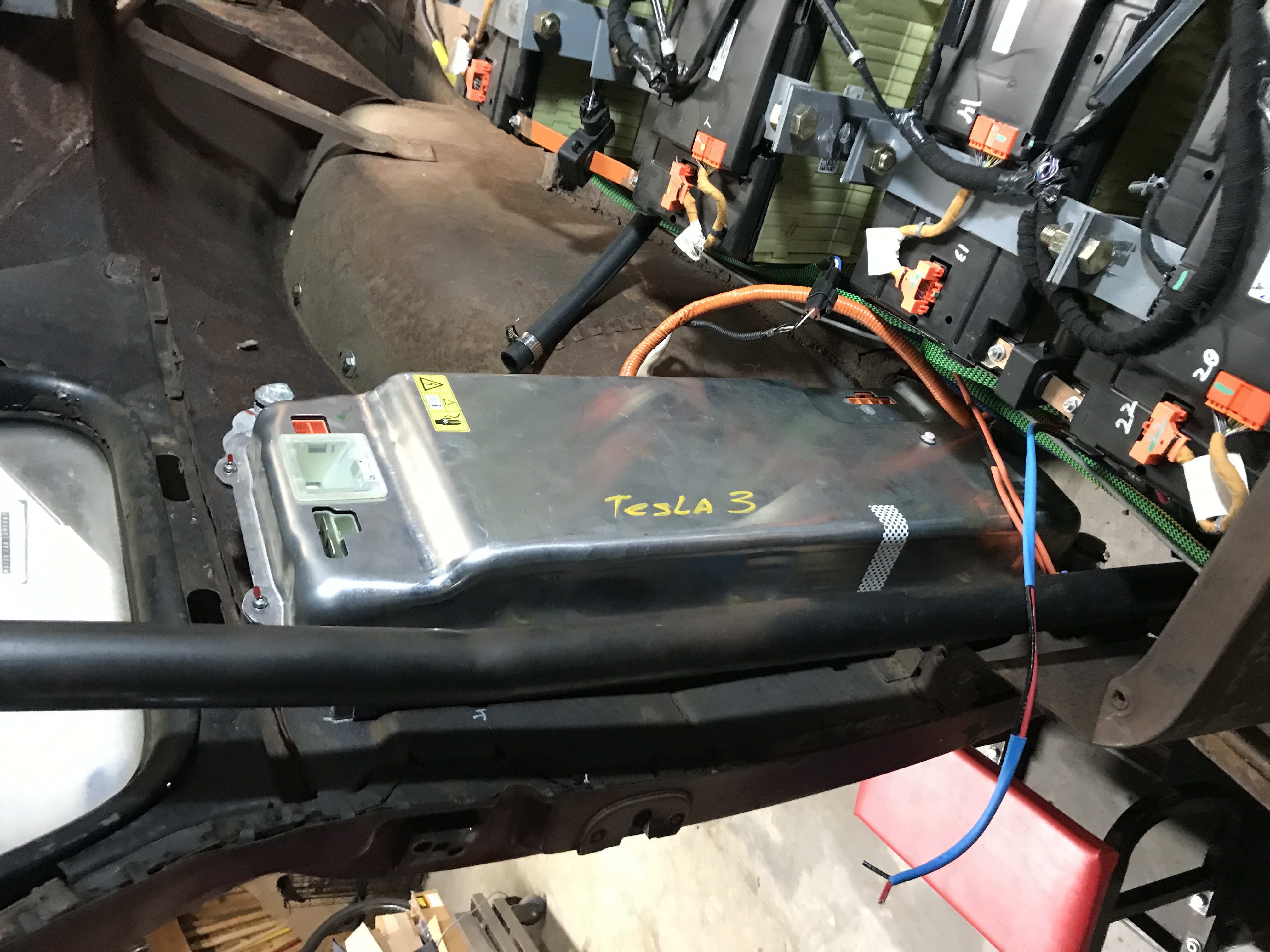

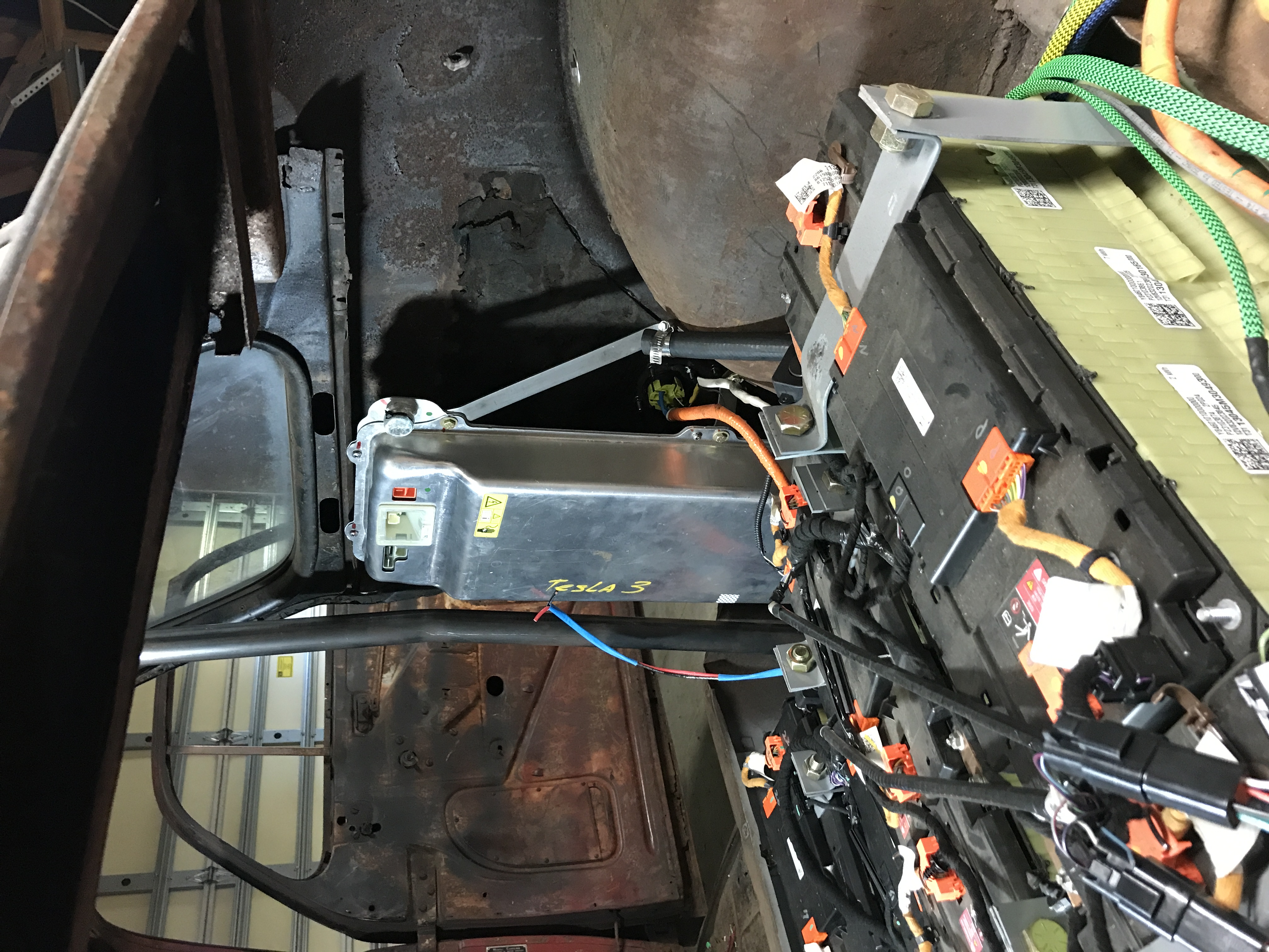

Also, I've decided to move to a Model 3 charger to solve my charging and DC-DC issues. It's physically mounted in the car, still working on connections.
Edit: not sure why the images rotated, but if you click on them they are correct.

A brief update:
The PCS is installed, wired, and communicating with the control board. However, it appears there is some sort of firmware issue limiting communication, and the PCS is failing to actually start the DC-DC or charger. I'll be trying a new firmware this week, to see if that helps.
I need to have the car fully/mostly functional by the first full week of February, when I'll be headed to Florida to compete in the inaugural Sick Week, put on by Tom Bailey's Sick the Mag. Assuming my range guess-timations are right, based on the routes provided I should have just enough range to make it work.

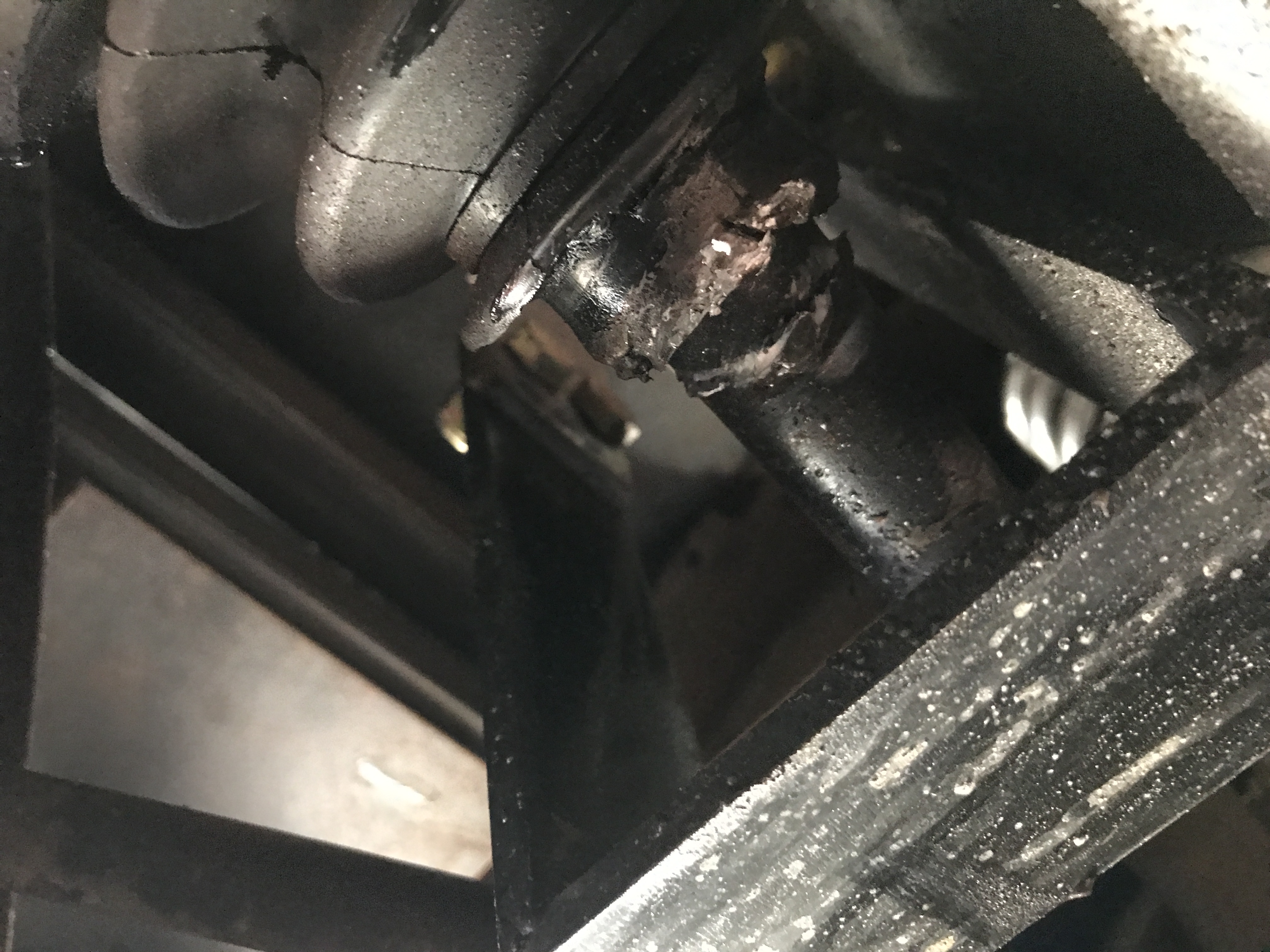

Lots to update:
I didn't get the car done for Sick Week, but that turned out to be a blessing in disguise.
I'm still struggling with the PCS control, and the CHAdeMO implementation also is just shy of functional. I added a Thunderstruck EV 2500 to level 1 charge just to keep the project moving, but that'll get removed when the PCS is functional.
All of that kept me from finishing the roll cage and firewall, so I missed the event. I did have a nice relaxing week at home playing with the car and doing some work, but as I began tweaking settings, I began to slam into an overcurrent on full throttle. Long story short, I believe that I partially broke an axle, continued to push the car with the broken axle, and then finally destroyed the axle this past weekend. I'll take the axle apart to verify this coming weekend, but hopefully this means I don't have a weird/bad inverter.
I had a plan ready for upgrading the axles, now I just have to implement it..... except my daily has been in need of suspension maintenance for about 2 months, so that's got to come first.
Broken Axle
My favorite picture of the car, about 12 hours before the broken axle

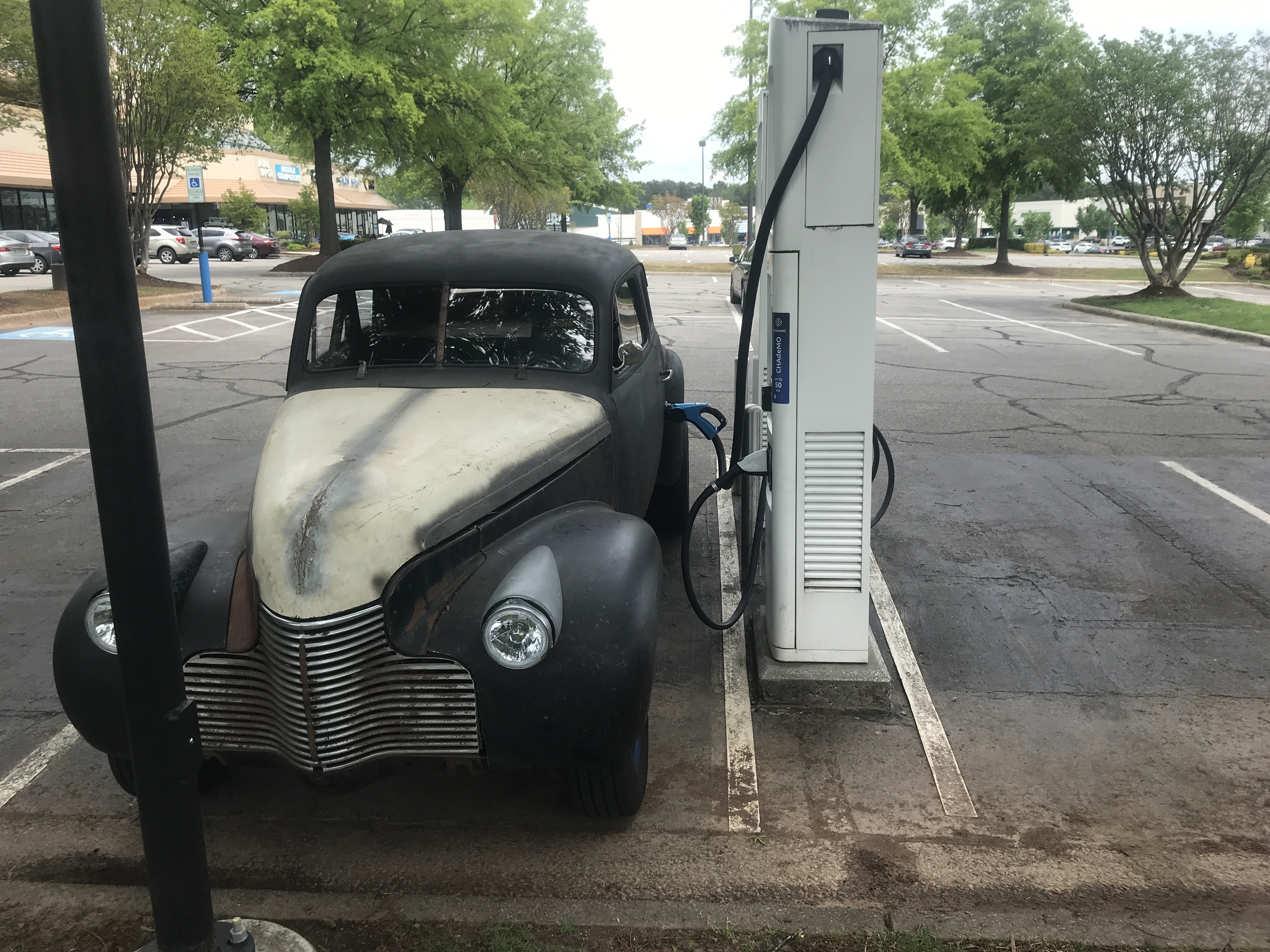

This weekend's (mis)adventure:
Friday evening and this morning, I installed a Prius inverter cooler after my existing cooler in an effort to improve cooling. Seems to be a bit better but I need to test more.
I intended to perform a true range test today, but things went sideways. The original plan was to test at several chargers enroute to a charger almost exactly 50 miles from my house. Then I would charge to 100% and attempt to drive home. Once home I'd plug in and use the kWh supplied by my charger and the shown battery percentage when I arrive to determine wH/mile, estimated range, shown %/mile, and so forth to get a real understanding of range.
The first part of this went well, the chargers worked flawlessly, were open when I got to them, the weather was nice, all good. Then, I went to leave the last "test" charger before getting to the final one. I made a stupid error, and tried to unplug before ending the charge session. Should have been no big deal, end the session on the charger, then come back and unplug, and be on my way. However, when I attempted to unplug, the button on the charge handle stuck in, and no amount of messing with it by hand (after ending the session) would get it to release. Several (quite frustrating) calls with EVGo later, and they decided to send out a tech. ETA: 2-4 hours later. After stopping in a nearby grocery store to cool off, get a phone charging cable, and use wifi to ask the forum if I could do anything else carside (answer: no, the station has the lock), I waited by the car. And waited. and waited. and waited. After 3.5 hours, I was frustrated, tired, and just wanted to go home (still 38 miles away).
By this point, the other charging stations had cleared out. I finally turned on my engineering/hotrodder brain, and started examining the other CHAdeMO plugs, and realized the lock was just the part on top, which meant I could sort of get to it. I also played around with the button and realized that it didn't seem like it should be stuck in like it was. I remembered that my emergency kit had a flathead screw driver, and I then used the first to attempt to push the latch down (no luck) then tired to free the stuck button. It popped free with barely any effort applied.
I was free, and could head home. I hadn't charged to full at that station, so I intended to stop on the way home (I did not want to stay there any longer). One station was packed, another was down, but I finally got one that had an empty stall, got a charge. Then it was smooth sailing home.
Lessons learned:
- I still love driving this car.
- Wing windows and cowl vents are great when you are moving, but a flat black car gets hot quickly when stuck in traffic.
- When something goes wrong at a charging station, don't panic, use your !@#$%ing brain.

lsh3rd wrote: Sun Apr 30, 2023 3:54 pm I love this project... if you ever get so adventurous as to drive it to Atlanta, let me know... I bet the car would get a lot of attention at Caffeine and Octane or even one of the drive electric week events we have here.
Thank you!
I will be attempting Hot Rod Magazine Drag Week in September this year, and day 4 is Carolina Dragway near Augusta, which is the closest to Atlanta I'm currently planning on taking her. I may do Sick Week next February in Florida, and have considered stopping by Atlanta on the way.
I also am a partner in a business based in Atlanta, and long story short may need to spend more time there in the next few years, so it's not out of the question that I might bring her down that way; I agree that Caffeine and Octane would be fun.
