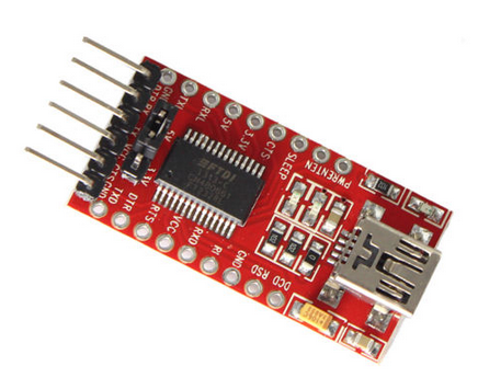

You could also take advantage of the hard work done by member Dima and install his windows based web interace:
viewtopic.php?f=5&t=255#p2756
Installs on Windows 10 but have not tried earlier versions. Ir avoids the need to install Apache web server.
It is a very nice interface with a lot of extra and useful features. I am using one of these FTDI usb to ttl converter set to 3.3 Volts.

Ahh, neat. Well since I can't find my FTDI converter, that's a solid plan B.

Understood. But not the handy web interface, you'd be spitting commands one at a time using terminal, (unless you're using Dima's work that Kiwifat linked to above), and, you'd still need a UART-USB converter, which is actually more expensive than a little ESP8266 board, and less convenient.
Because I didn't have either a wifi board or a USB-UART converter, and didn't know that one or the other was required back when I ordered parts months ago, I was hoping to find a "Can I just make it work right now?" solution for my 2-month/end of year goal.
