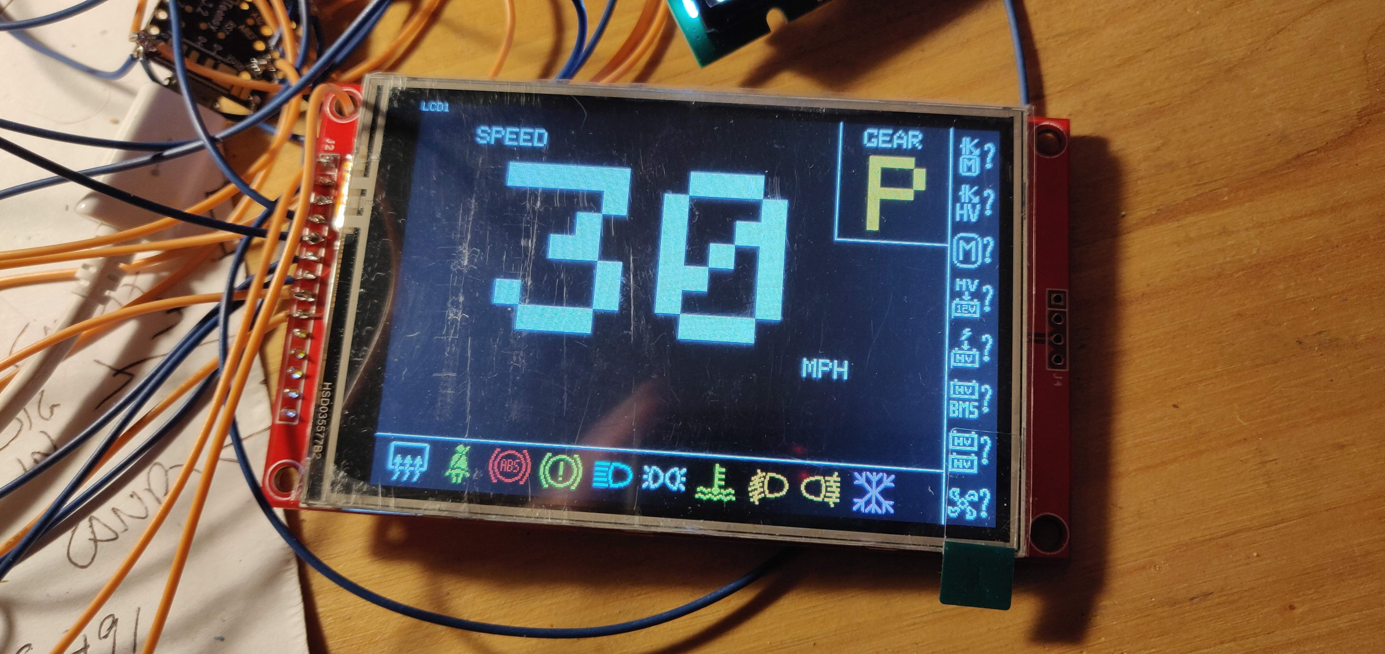

xp677
- Posts: 442
- Location: UK
- Been thanked: 15 times
Re: Communicating with the Lexus GS450h Inverter/Converter
My system is currently back in pieces for mounting into the car, I'm also revising my control PCB. My previous work was just a proof of concept. Hoping to have the motor running at 600v in the car within 3 months.
Reverse should work, make sure your accelerator pedal function is returning negative torque when in reverse. I also had a line to disable MG1 in reverse.
Damiens code differs from mine in this regard, my code has a load of accelerator pedal checking and mapping, as well as gear selection, engine braking, creep, and cruise control, which is specific to my project, so did not make it into Damiens version of the code.
I'm currently working on a digital dash to complement this controller, based on cheap ebay LCD screens.
And also loads of other side projects including an intelligent cooling system, AC controller, BCM for the car, etc.
- arturk
- Posts: 148
- Location: United States, MD
- Has thanked: 7 times
- Been thanked: 4 times
I appreciate response.
really weird.
Perhaps I am doing something wrong although it does not seem to be complicated.
I fear that there could be an issue with my Camry Inverter however my understanding is that reverse engineering was done using Camry, RAV4 and GS450/600 so I am hoping this is just silly mistake on my part.
Anyways, some of the features you describing (gear selection, engine braking, creep, and cruise control) sound interesting to me as well.
Would you share some of your code with me so I could try to isolate problem?
I do realize more tweaking is need to get everything running smoothly but I really need to be able to move my project car in an out of garage since it is too crowded. For this I need reverse
Your dash looks really great, nice work on all of those icons!
