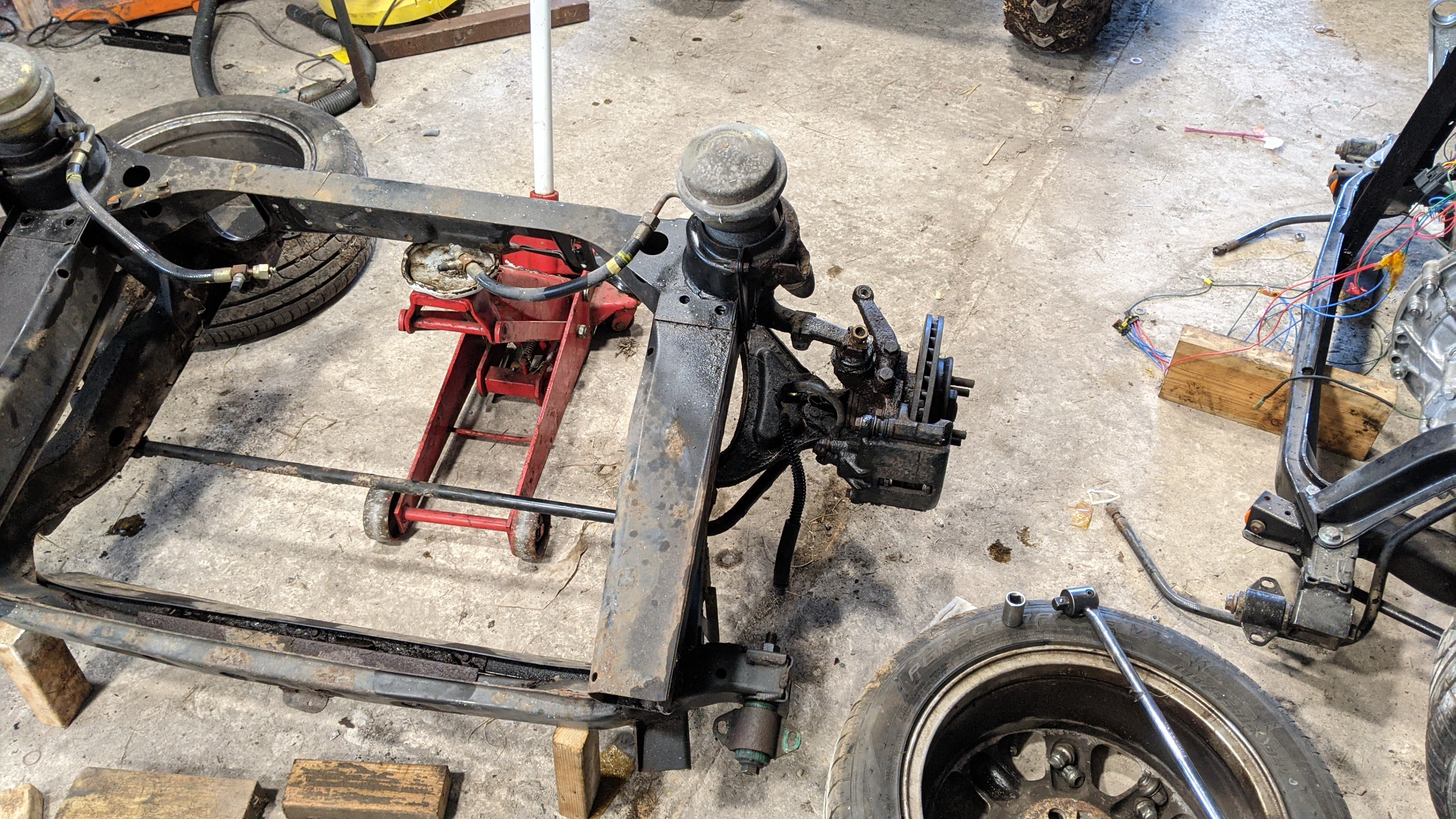

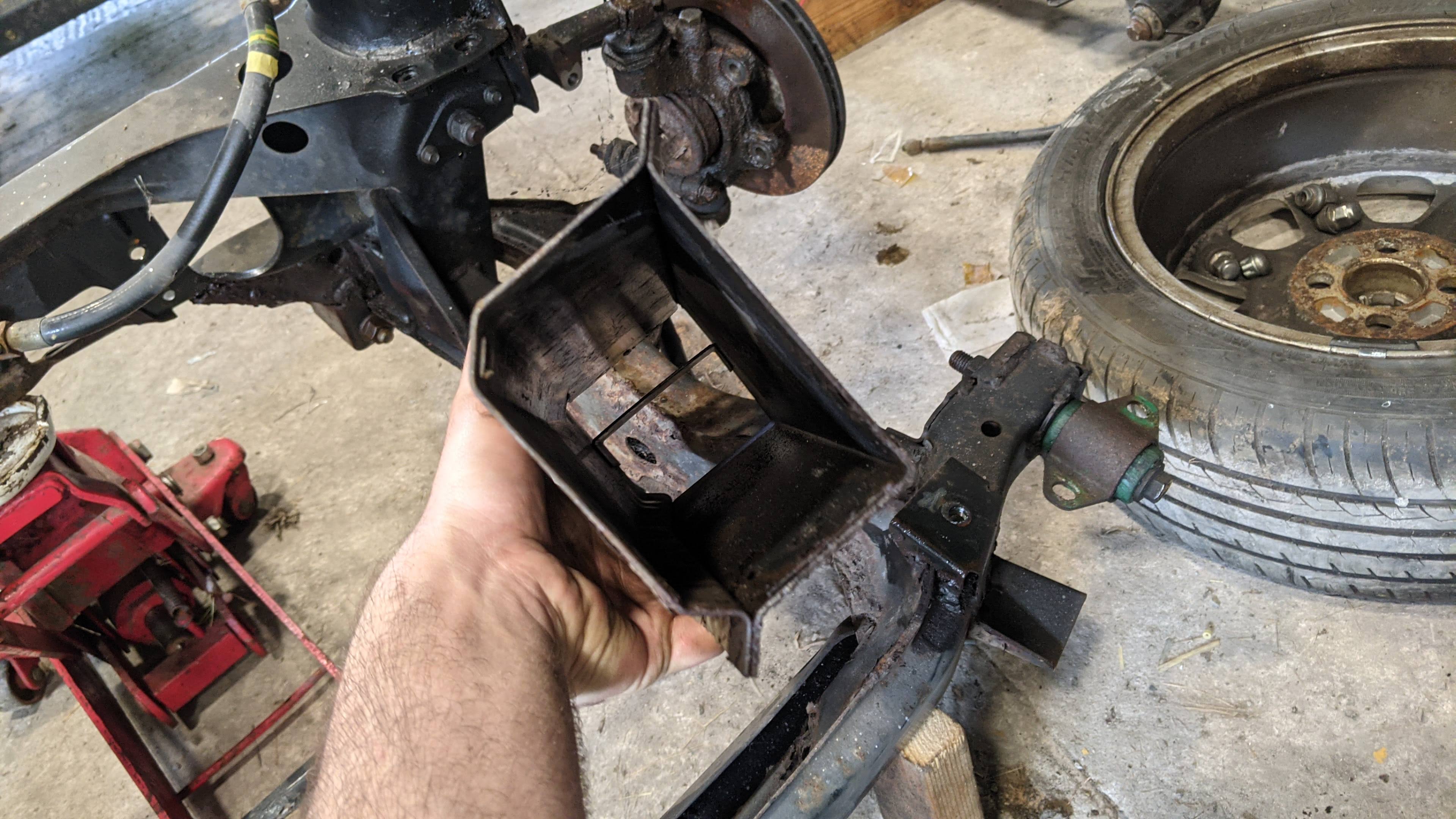

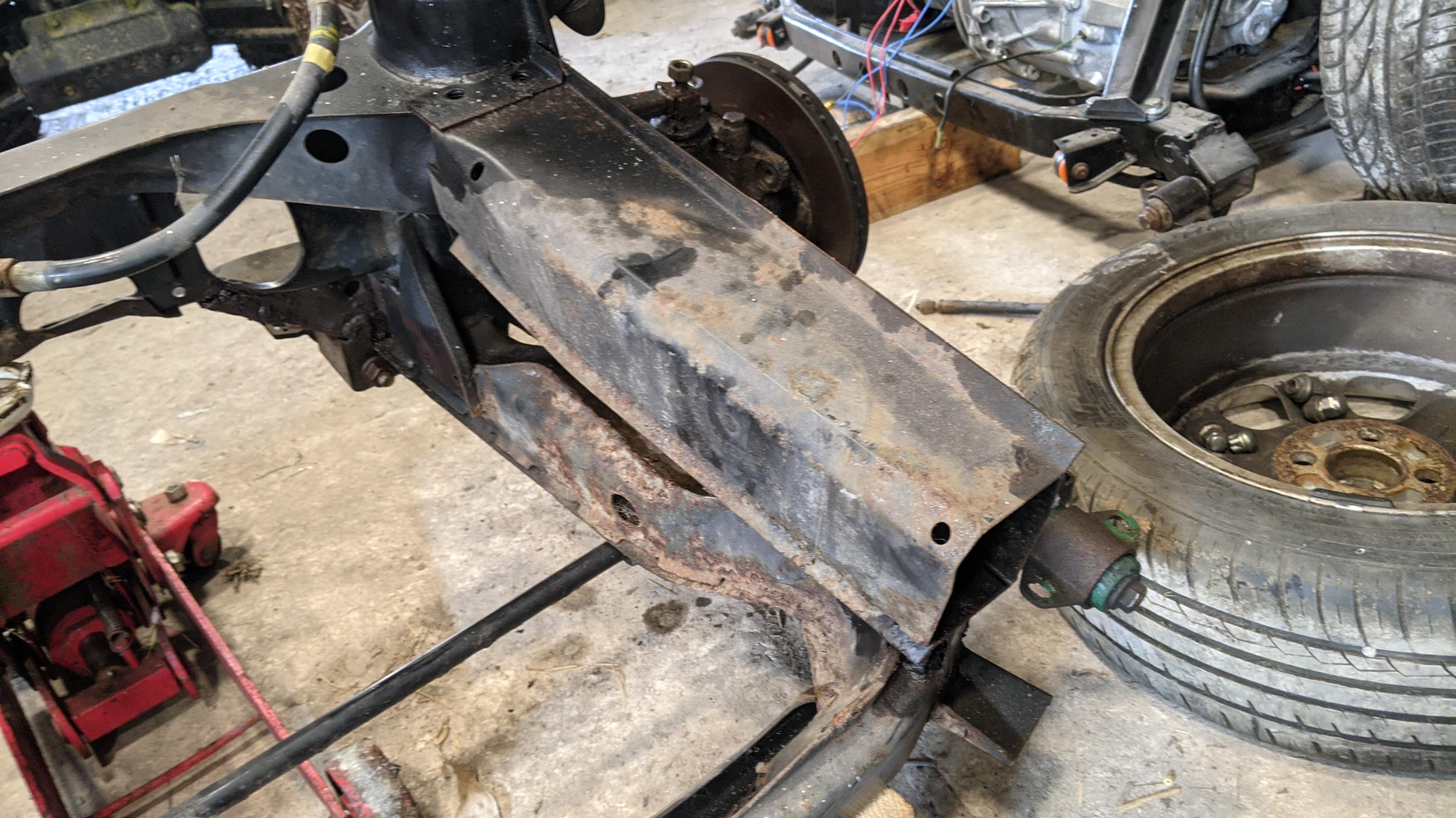

I got the front subframe off the car today and started to take it apart for a bit of a brush up. One of the suspension spheres was loose which doesn't seem ideal. I'm thinking I might look at getting these all reconditioned while they are off the car, kind of makes sense to do now at 20 years old. I will definitely be adding individual valves to each sphere at least, especially now I am adding 100kg+ to the front.
Edit: I might not be adding individual valves. Still need to research the details for that.
The rest of the subframe seems pretty good. There are some pretty light weight sections of box steel along the sides where the engine mounts would have gone in a Metro I would assume.
So plan is to make up some new mounts to replace these box sections. Then mount the battery box on those.

It's been a while since I pumped up an F but I believe some folk cut and sealed the pipes then added a second Schrader valve for each side to enable individual corner adjustments. I'm not sure how hard it is to do.
Can you get the spheres reconditioned so they have the correct amount of gas in. Was it nitrogen they used, like I said it's been a while.
If you need one I still have my pump for the suspension but it's been so long since I used it I couldn't promise it still works.

Alibro wrote: Mon May 31, 2021 10:35 pm It's been a while since I pumped up an F but I believe some folk cut and sealed the pipes then added a second Schrader valve for each side to enable individual corner adjustments. I'm not sure how hard it is to do.
I've done a bit more research on those now and I think it's worth me get them reconditioned and regassed at least. I did look into doing that DIY. But that's the sort of thing I will easily mess up and ruin the sphere, then end up paying someone else to do it anyway.
Individualising the spheres does make sense due to the extra weight at the front. From research it will reduce comfort a little bit but improve handling, would be nice to get a level car at least.
I'll see if the chaps at the MGF Register have any insights on maybe using Metro front spheres as per Rob Bells suggestion.
Thanks for the offer of the pump. I have one as well for topping up the fluid. I might need to visit a local garage the first time as I think I need a vacuum initially to get the fluid in the right place.

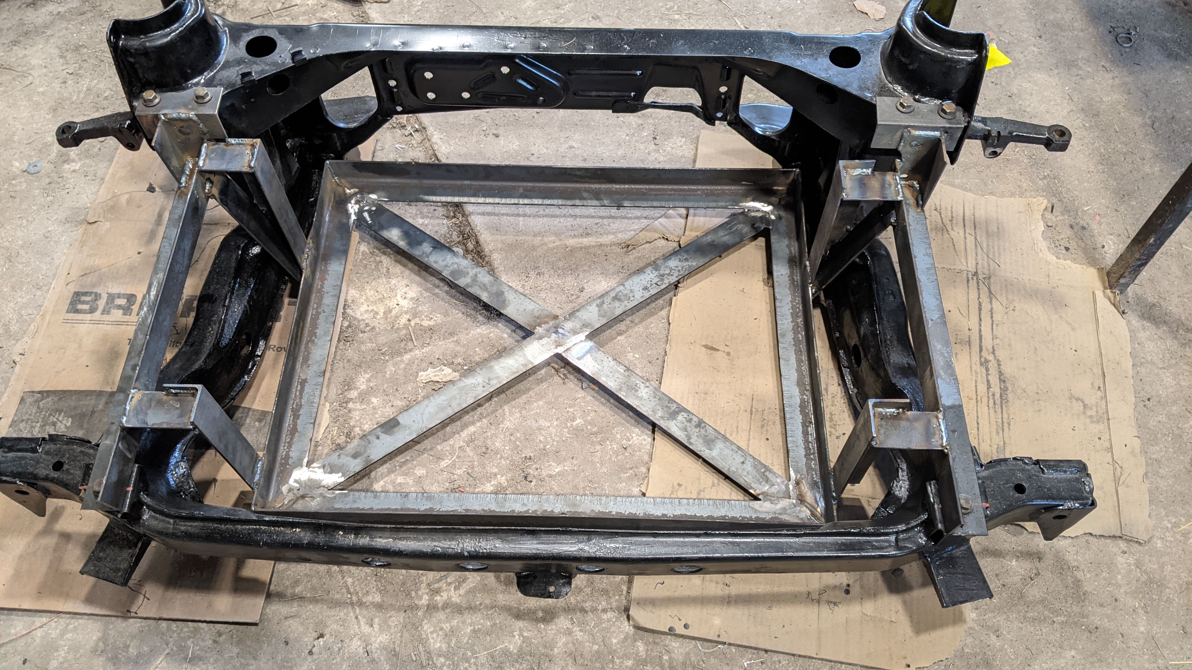

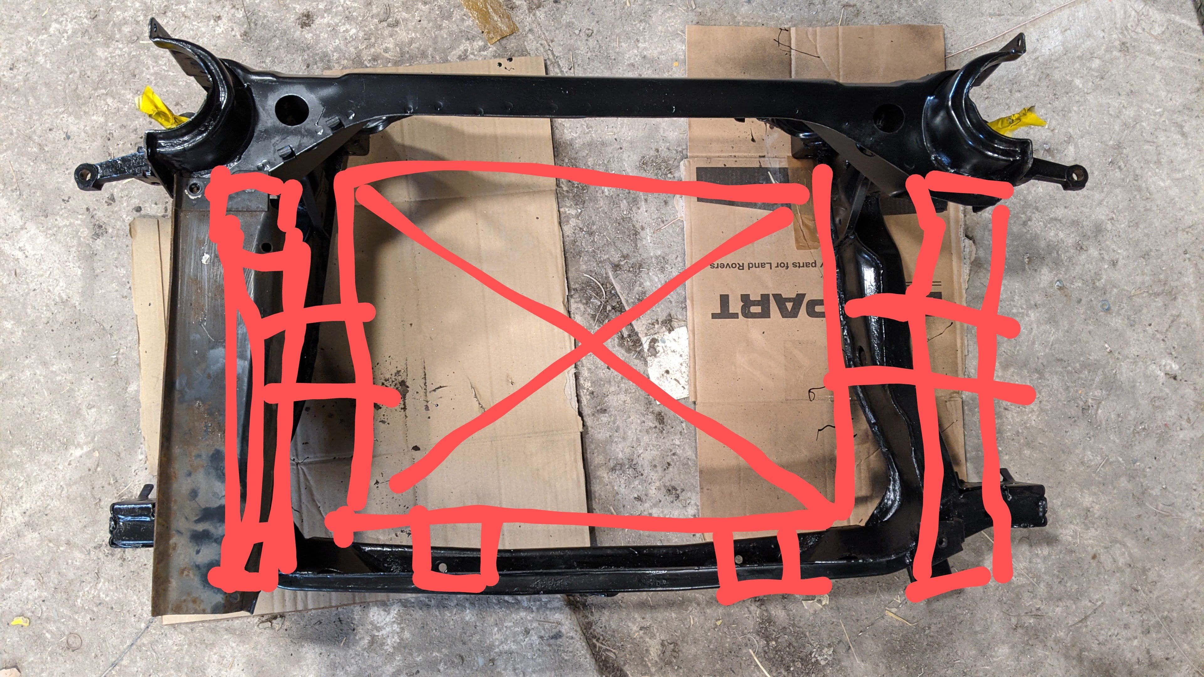

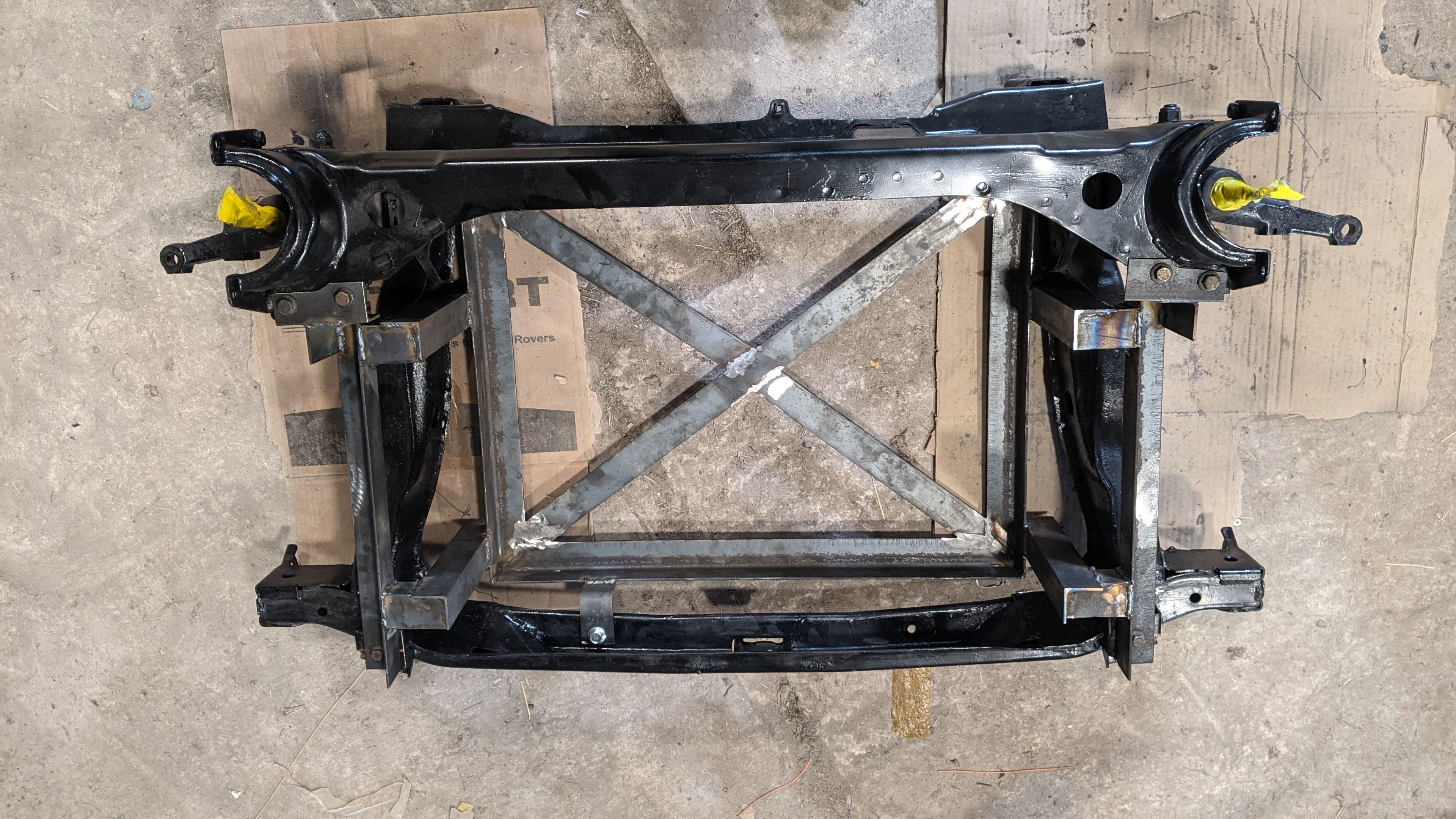

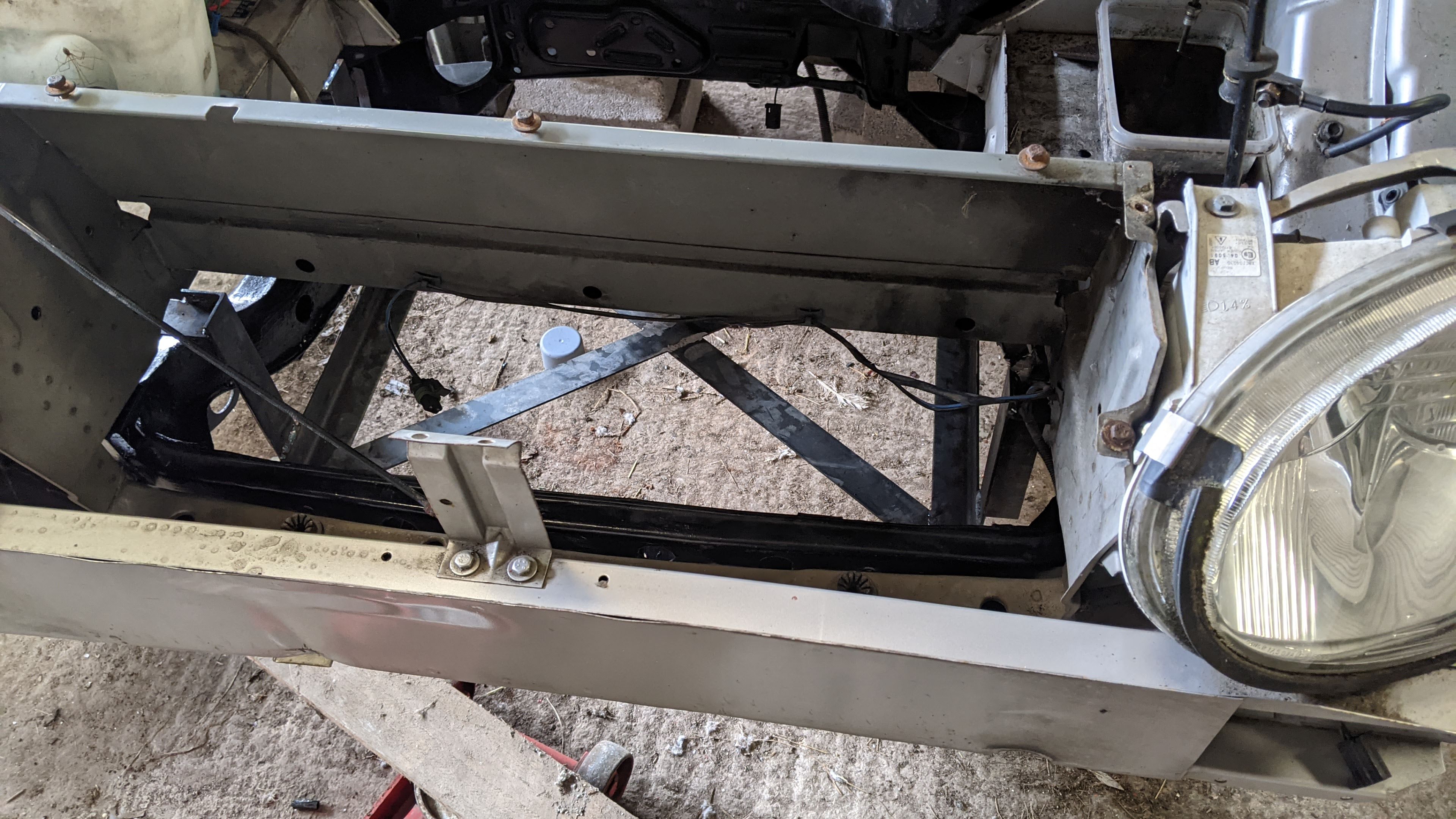

Stripped and cleaned the front subframe and given it all a nice bit of paint. Now on to the tricky part of battery boxes and how to attach.
The current plan is to make up the tray onto which the box will sit. I figure if I make up the tray as big as I can it should give me some margin for error when fitting the box, it's going to be pretty tight anyway so I expect the box will be made to fit the tray.
Rough plan is as below. I will make up some brackets on the sides of the subframe, from which the battery box tray will hang down. This tray will also be attached to a couple helpful holes in the front of the subframe just as extra points of contact.
Thinking about 40x40x5mm angle for most of it with 40x5mm flat for the cross in the bottom. Might be a bit overkill I think. So those might slim down a little bit when I get to buying metal.
Battery wise, still undecided on having the kokam cells on their flats or stood up as I got them. Stood up would be the easiest way so I might just end up doing that. A little concerned about some cells being thicker towards the bottom. But it sounds like they fail safely and I have spares.
I will have to start looking into a BMS soon, I'm planning on the OI BMS. Don't fancy using Orion BMS at that cost.

I've made a start to one of my battery boxes but I'm using a mix of 40x40x3mm and 30x30x3mm angle for the frame but my modules are encased in steel boxes so it's easy for me to support them from their edges. I plan to close it in with 1.6mm sheet.
What are you making the box from? Can you use fiber glass?
Maybe fiber glass would be a bad idea as it's very flammable. :o

I'll probably use 1-2mm sheet for the box. Then line it with something not conductive before placing the cells in.

Battery tray is pretty much done. I can stand in the middle and it barely flexes at all. So it should be pretty solid with less weight than that spread across the whole thing.
Just need to do one more bracket on the bottom then paint it up.

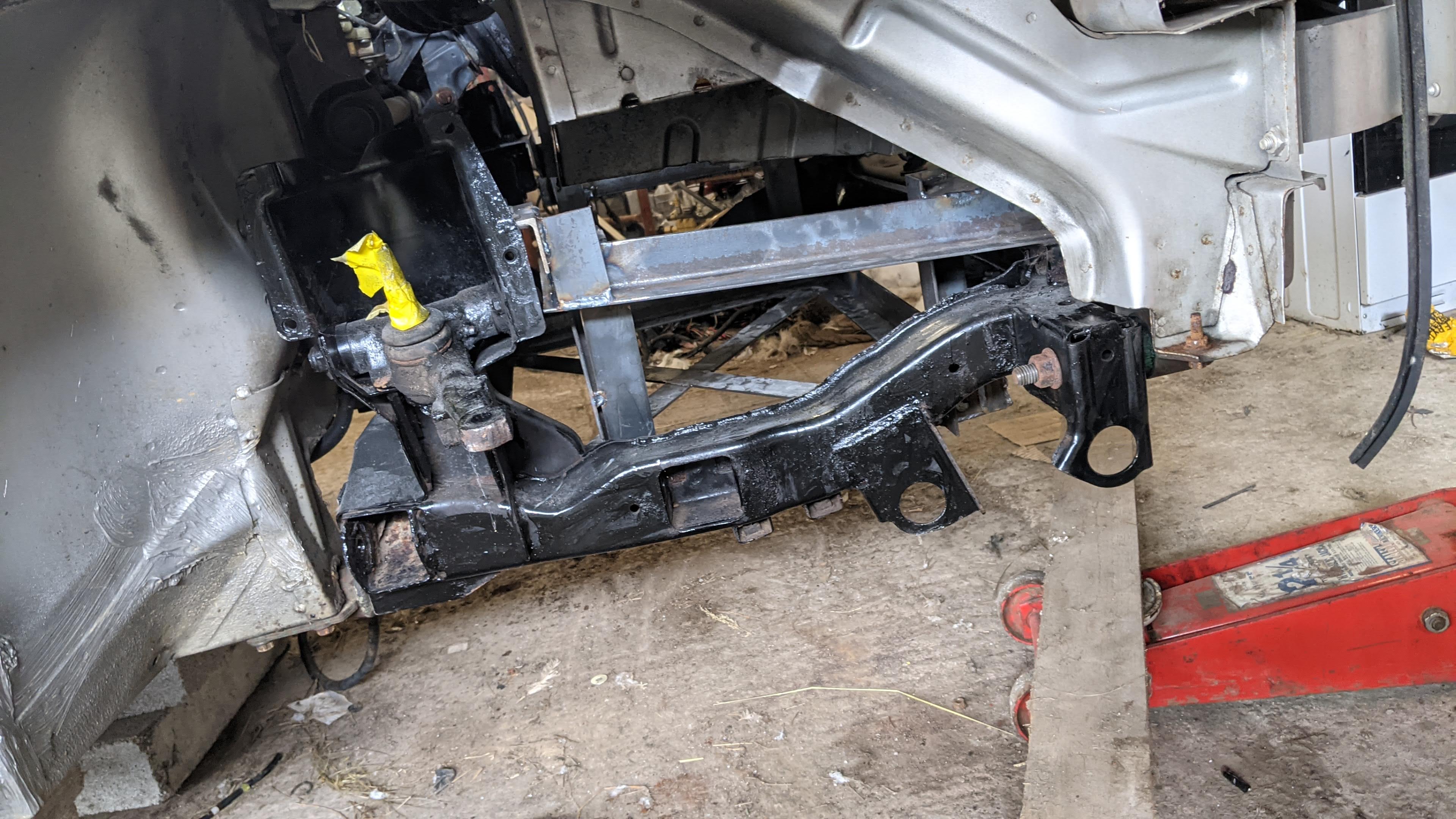

Finished the tray off today and put the subframe back in the car. It fits which is a nice start.
Confirmed that I will have about 26cm of height. So that's about 3 cm higher than the cells in which I need to fit in the connectors, then top and bottom of the box. I'm going to get the box made up as I don't have the capacity for that sort of precision or a metal sheet bender.

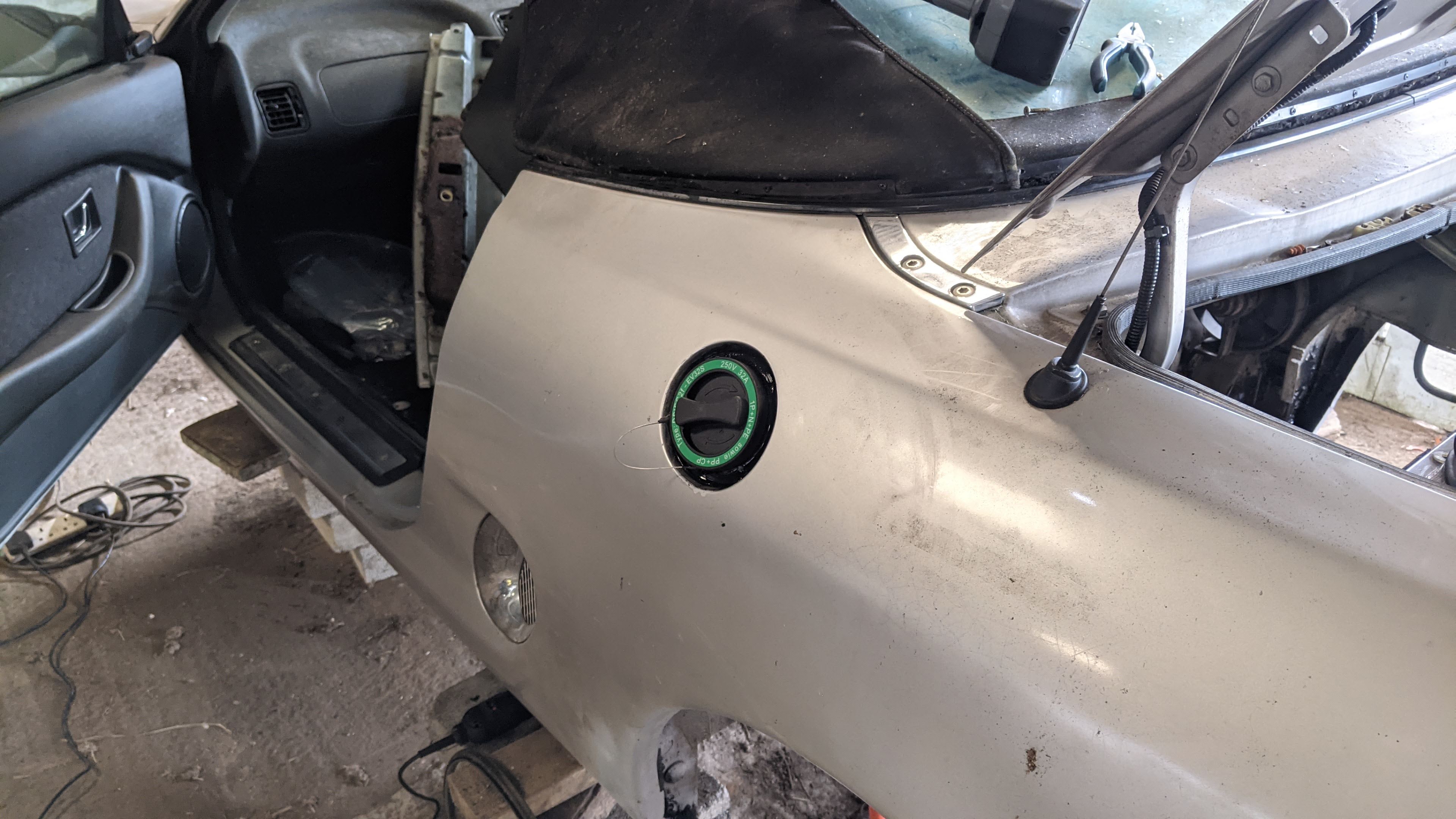

Charge Port
I ended up putting this in the fuel cap. The space available wasn't great, but it works for now.

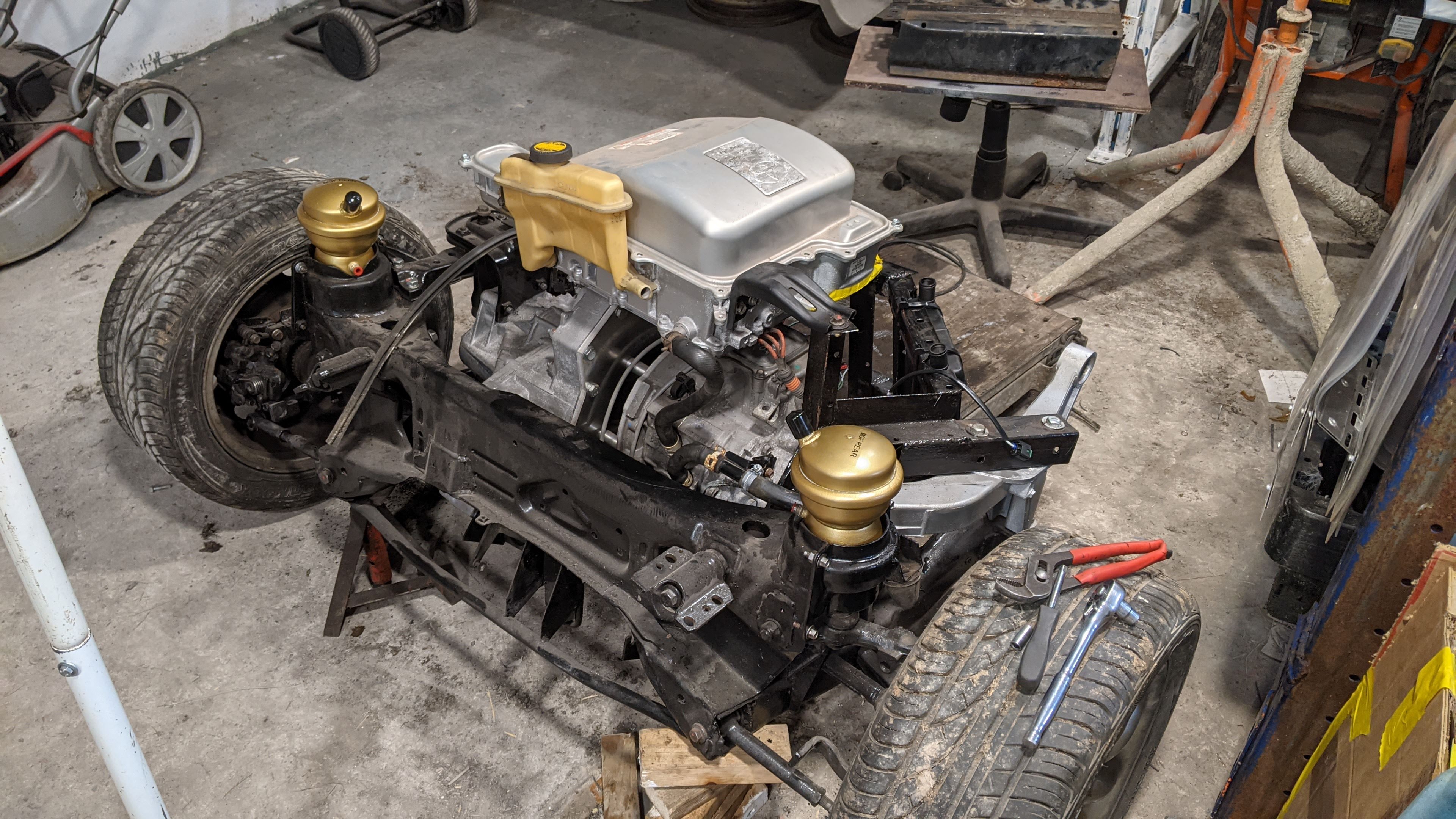

Rear subframe:
Still some work to do on this before it can go back into the car. I have installed some refurbished suspension spheres and I pushed the boat out a little to get some new shocks as well. I'm waiting on parts to finish the coolant lines, I need to add in one more motor mount support and redo the wiring loom from the inverter to the OI control board.

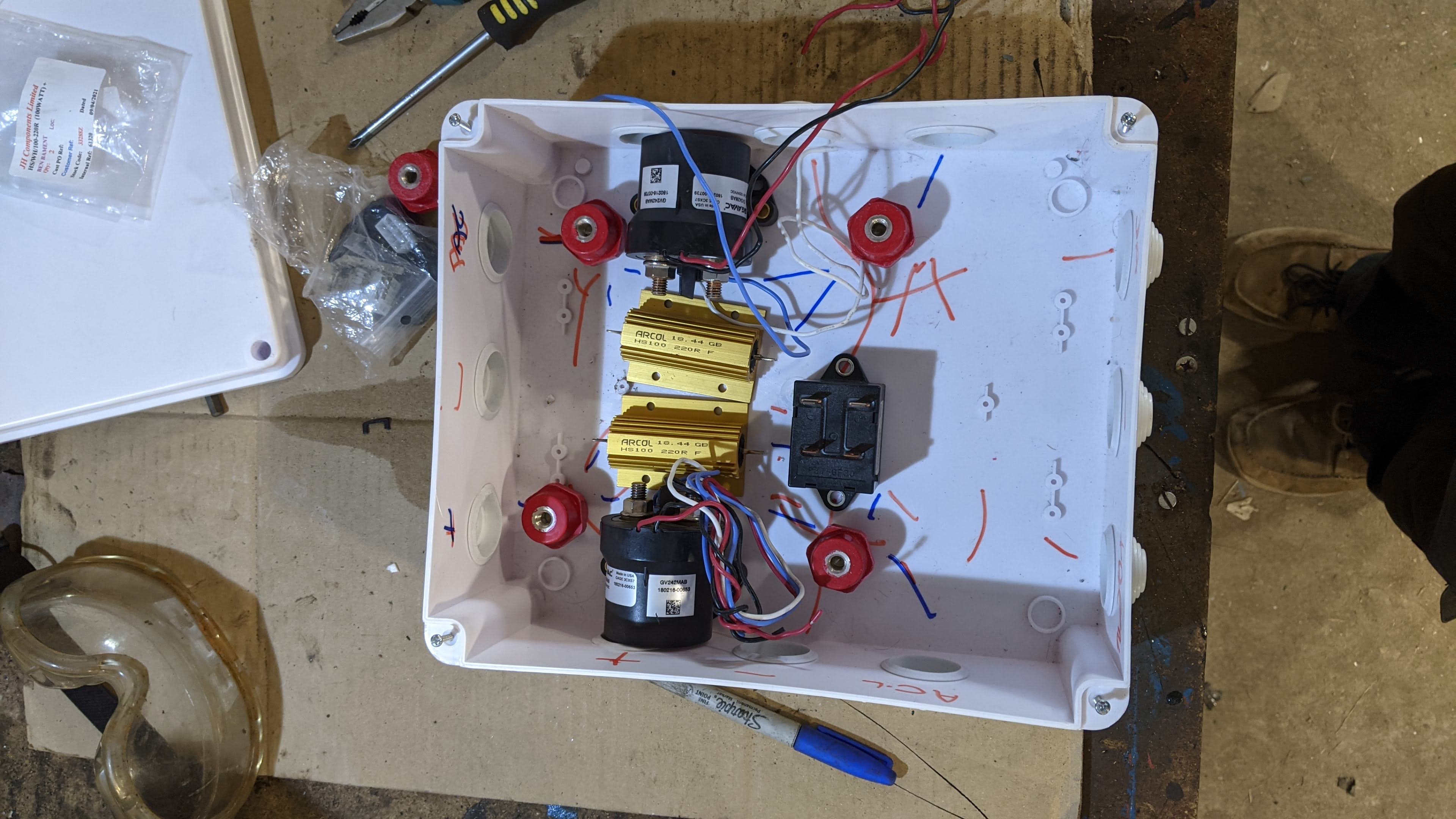

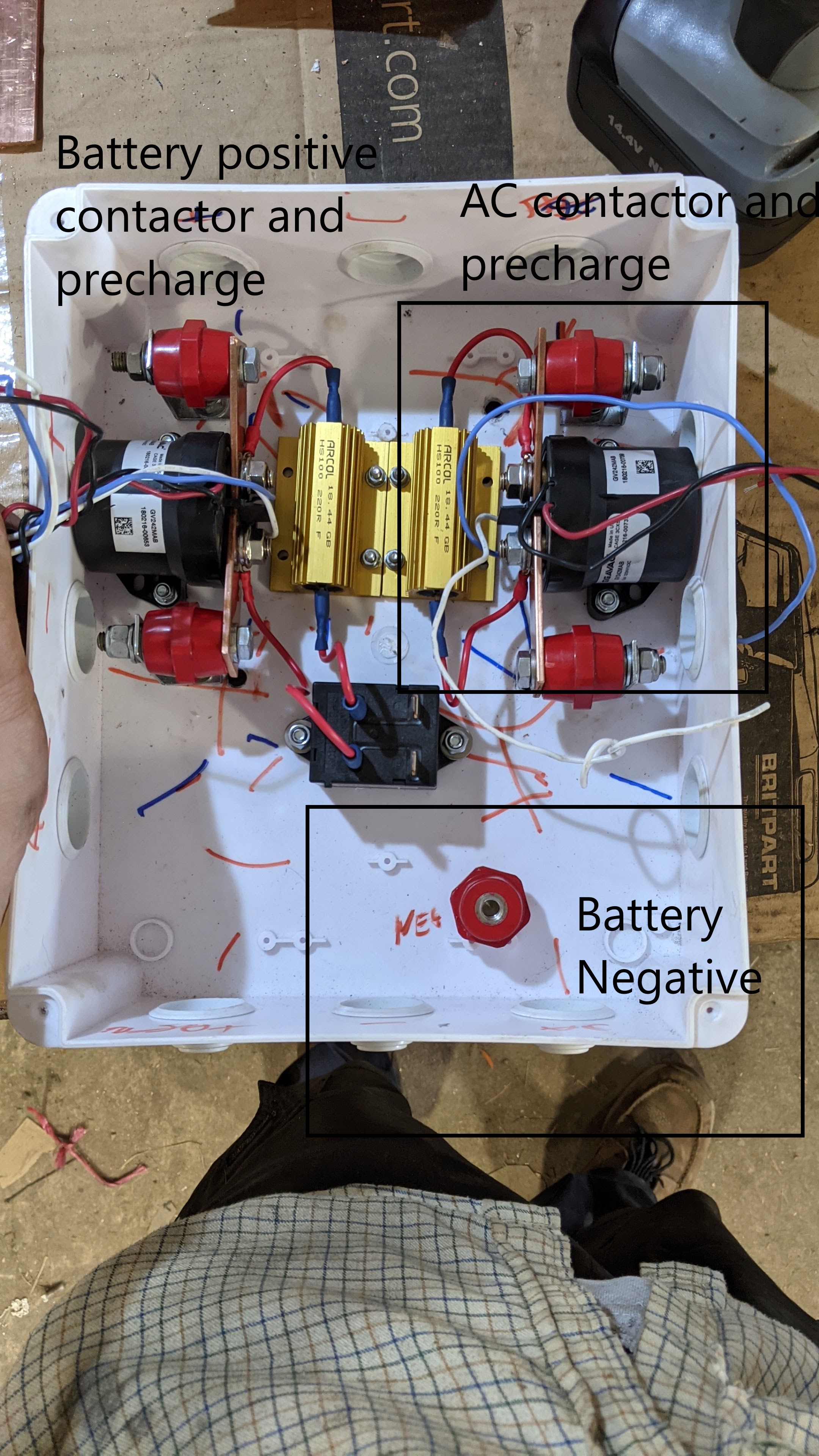

HV junction box
Made a start on this. This is roughly how some of it will look. Positive line on the left with precharge contactor. AC line on the right. Fuse and Negative contactor will be in the battery box. The negative line will come through this box but just be a standoff connector.

Great update, loving the refurb spheres and the motor looks like it belongs there.

Got some way with my junction box recently. Then realised those busbars are probably not needed.
Battery negative contactor will be in the battery box and the fuse will be mid pack, which is why they are missing here.

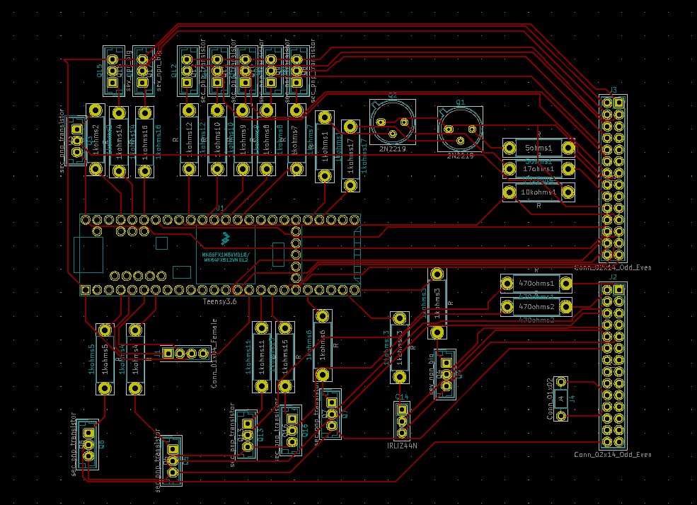

Made a start on programming the VCU that will control dash gauges, contactors and charging. Made some good progress and tested it with the inverter on the bench sending messages. Will run some more tests on the bench to confirm that the contactor signals are correct before I try it with a real battery.
Currently it's only setup for one Canbus ID. I think I will probably have to fix that as there is only so much you can send on one message.
https://github.com/Wonk6677/MG-F-E-VCU/ ... _F_VCU.ino
I think the coding will be the easy part. Putting all this into a pcb design will be a bit trickier. The OI pins soon mount up, I can understand why car manufacturers like to throw everything onto a CANBUS.
The rest of this week has just been sorting out smaller things on the car, making progress putting the front subframe assembly back together and doing all the small things that need doing on the rear subframe before it goes back in.
LRBen
Posts: 608
Location: Somerset, UK
Has thanked: 122 times
Been thanked: 290 times
Re: MG F - Outlander Rear differential with Prius Gen 2 Inverter.
Post by LRBen »
Finished the coding for the most part now and moved onto the PCB Design. This has been another steep learning curve!
Ended up with 30 odd pins at one point so decided to use the same 56 pin enclosure that the Zombieverter uses since it's pretty cheap and available.
Done a first draft of the PCB just to get the hang of things in KiCAD. Still need to mess around with the footprints, especially for the header connector. Also need to thicken the traces that will control the main contactors.
I'm planning to have the whole board with through holes, then mount the components myself. That way if I can easily swap out a transistor or resistor if I have specced something wrong.

Post by rstevens81 »
I'm by no means an expert or even know that much than yourself 🤪, from what I have been doing and what I have learnt on the open source spaceballs (simp BMS copy) board that I have worked on .... ( If it's of any use to help have a look at it https://easyeda.com/jamie84.jj/simpbmsvw but it still a work in progress)
it's worth adding a ground plane and 3.3v plane as the cost difference is negligible and will reduce noise an another oddities in an automotive environment (based on Damian's videos).
Also I couldn't see how you are actually powering it, it's worth stealing the dcdc from johu's designs to power it.
I'm surprised you didn't add a can transceiver sn65... Or mcp2515 as could be usefull for future requirements.
Finial word or warning the teensey is fragile and will die quite easily , I have killed one bigpie has aswell and so has Bobby come lately all at the breadboard stage and none of us know how we do it it just stopped working! (It looks like issues around the voltage regulator).

Thanks for the feedback it's very much appreciated!
I'll look into the ground plane and 3.3v plane.
I'm going to use an external 12v-5v converter then feed in a steady 5v to power the teensy, the 5v will also control the prius dc-dc level as well.
I do have a Can transceiver, it's a through hole one, so Ill have that on one of the four hole footprints then the two hole footprint near the header is the CAN low and high wires.
I'm already well experienced in killing teensys. The only reason this 3.6 isn't a 3.2 is because I killed my 3.2 somehow on the breadboard stage.

rstevens81 wrote: Tue Aug 24, 2021 7:28 am
This is why i use DUE. It seems more robust. Still i use a shield so i can quickly replace DUE if needed. I had to replace 3 since i overextended poor 5V regulator in the past. I am now on V4. Here i use a diode on 12V input and i only use 3V3 and 5V for logic. 12V is used to run relays and transistors on the output are al NPN darlingtons or mosfets.

It drives! Had to move sheds so I decided it would be nice to move it under it's own power.
Used 20s kokam cells, with the light bulb precharge and big switch from the bench test. No brakes of any kind so had to be careful.
Throtcut was at 1 for the video, I was full throttle going up the slight hill but it didn't seem to struggle. Later changed Throtcur to 4 and I could pull away on the flat in 3rd gear.
Still allot of work to do on it, both front and rear subframes need to be dropped again. Front for the batteries to be fitted and rear mostly because I snapped a bolt taking it out and never had time to drill it out. Planning to put up a two post car lift now as I'm not going through pain of jacking the car up two feet with jacks and blocks.
For now I can work on putting brakes back on though. Might pick up a Prius battery for future testing until stm32s become a real thing again for the BMS.
