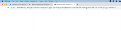

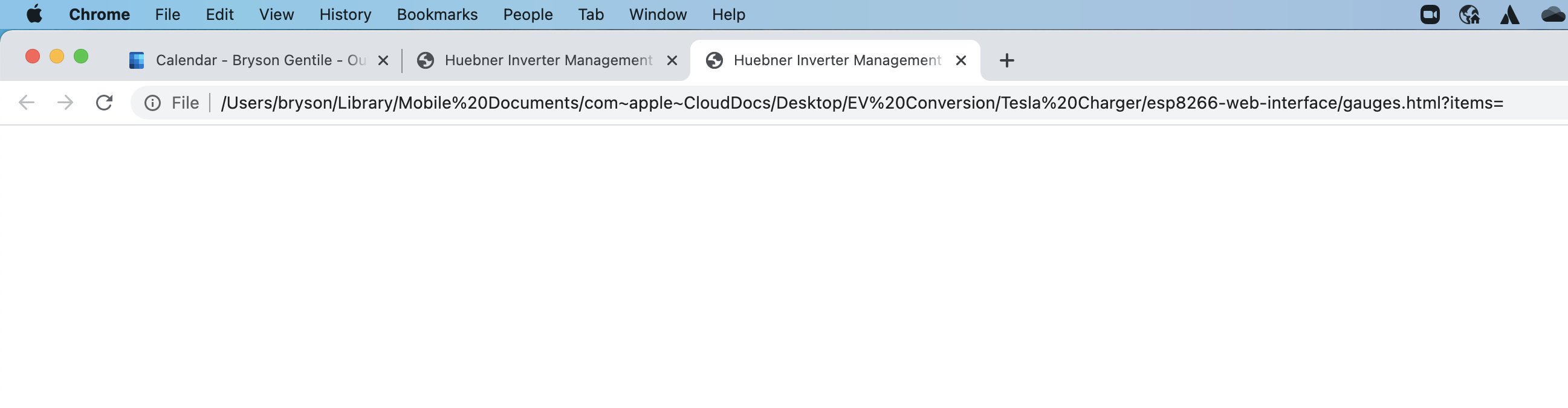

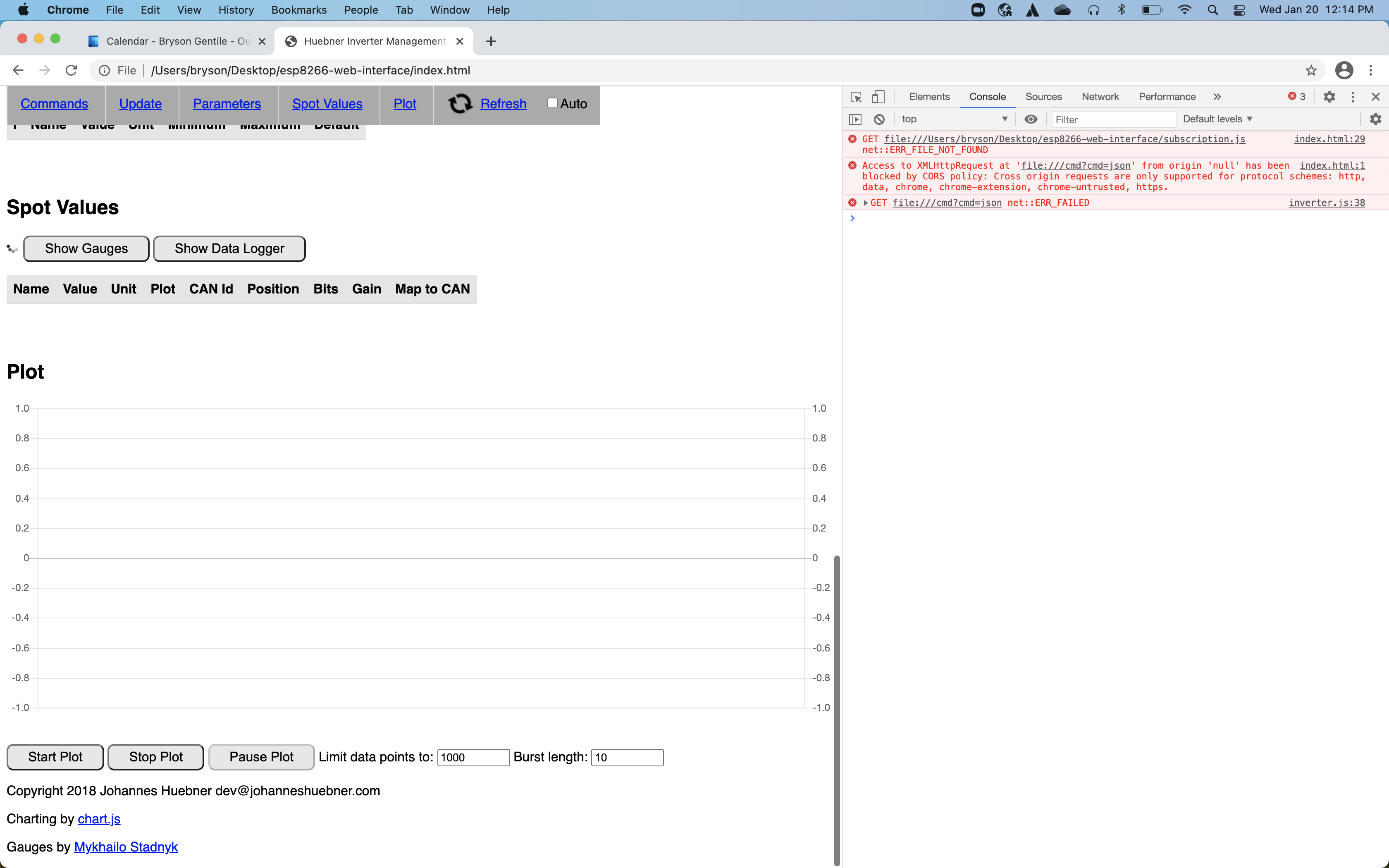

Thanks. I unpacked the file and it begins with a lower case ‘c’ already. I repacked it and sent it to my home computer for uploading when I’m back.
When I run index.html from my desktop in both safari and chrome, I don’t see anything on the page. I’m on my work Mac right now, JavaScript is indeed enabled, perhaps it’s time to try a windows machine.

No gauges.html generates dynamically but index.html should show something. I have seen it working on Safari, not sure what the deal is.

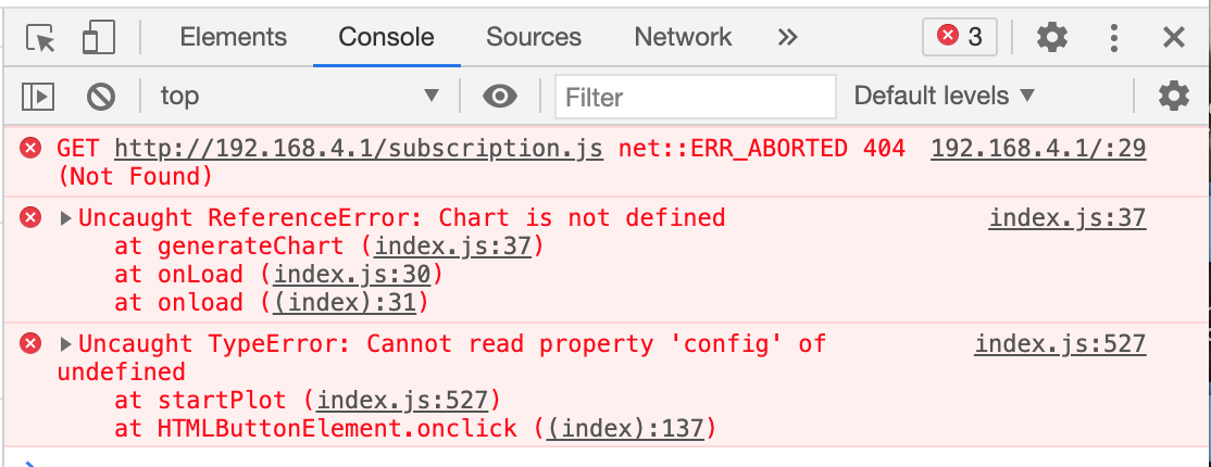

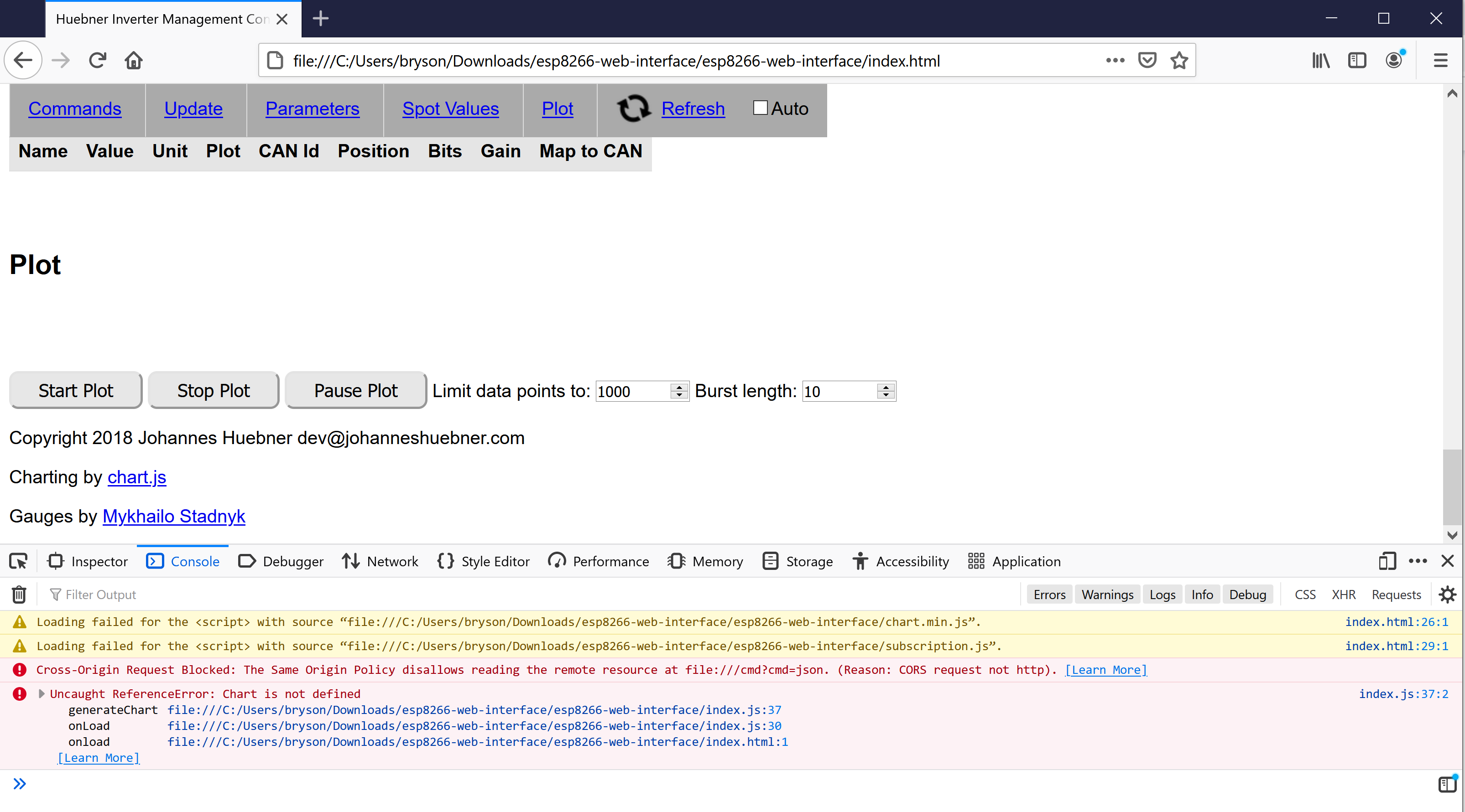

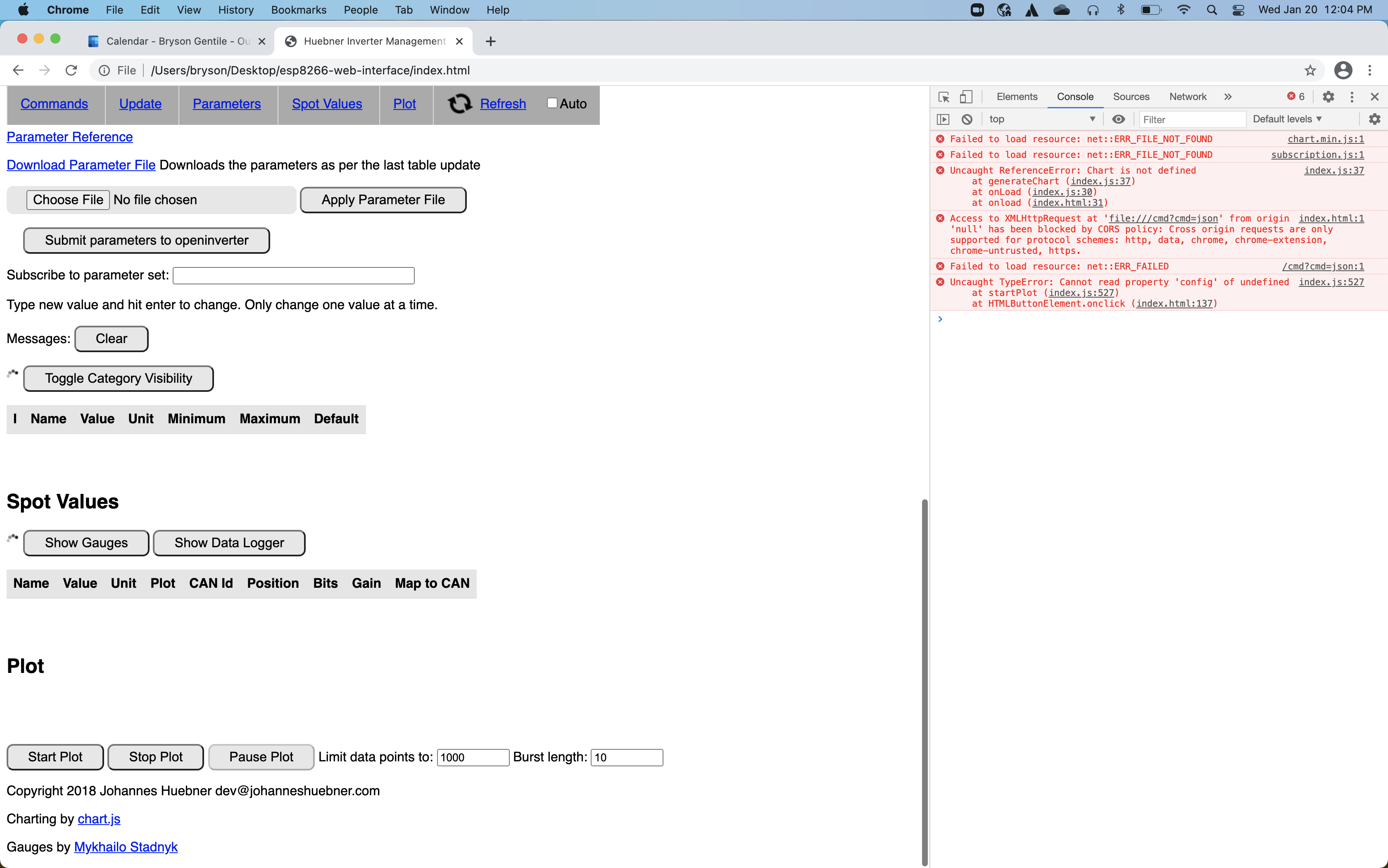

Screen grab with error log from Chrome. Should I just load the unpacked file directly? The plot chart shows up when I unpack within the same directory and reload index.html

ok, same as here. The other errors are just because its not running on the webserver.

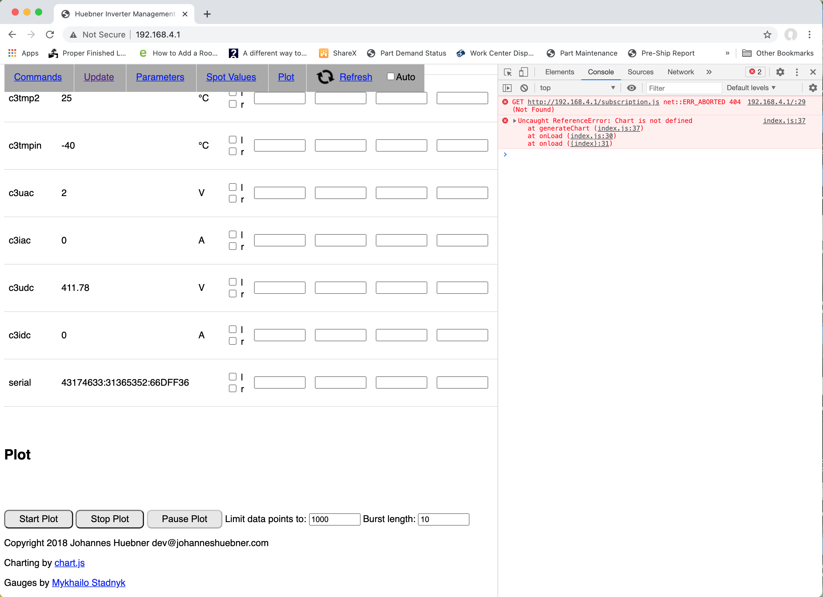

What does the error log show when opening on 192.168...?

Javascript errors when connected to the ESP:
And after pressing Start Plot:
- Been thanked: 1913 times
Re: Tesla Charger alternative firmware
No error message about loading chart.min.js but then it doesn't find the "Chart" class.
Not finding subscription.js is normal when you're not subscribed to anything. Maybe add it as an empty file, see if that helps?

Troubles continue. I tried loading locally from a windows machine using Chrome, IE and firefox with the same net results:
- unpacking chart.min.js.gz in the local directory gets the plot to show (but doesn’t work when I load the unpacked file to SPIFFS)
- same errors from the console log in Firefox on my PC: At this point I’ll start investigating different ways of loading that source file, as it seems that’s where the immediate problem is. Maybe I can persuade a software dev at the office to help me out..
edit: GOT IT. I reprogrammed the ESP and it's working as designed now, finally. My guess is that I must not have left enough room for the file system in the flash. I went with 512KB for the filesystem this time around.

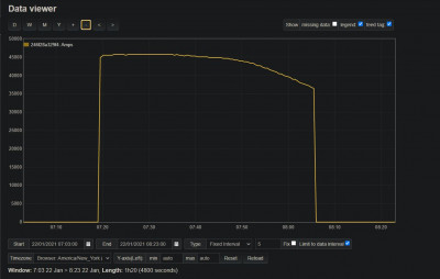

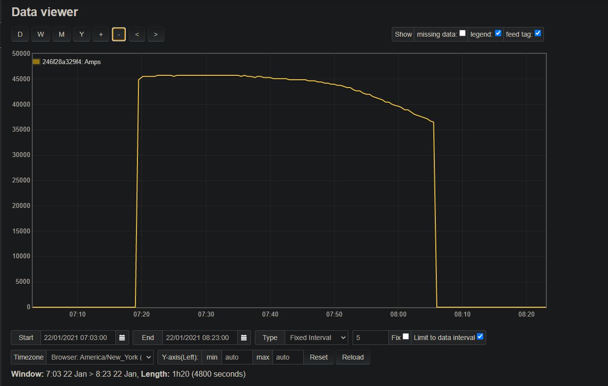

Re-configured my garage wifi extender. The log doesn't seem to show any drop out. The sample interval is every 10 seconds, so it may miss something.

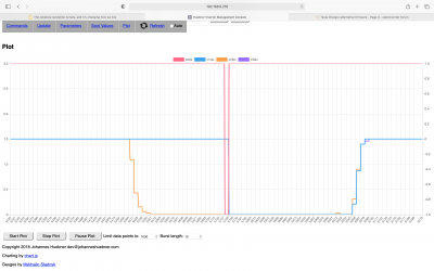

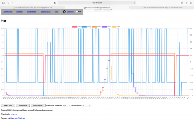

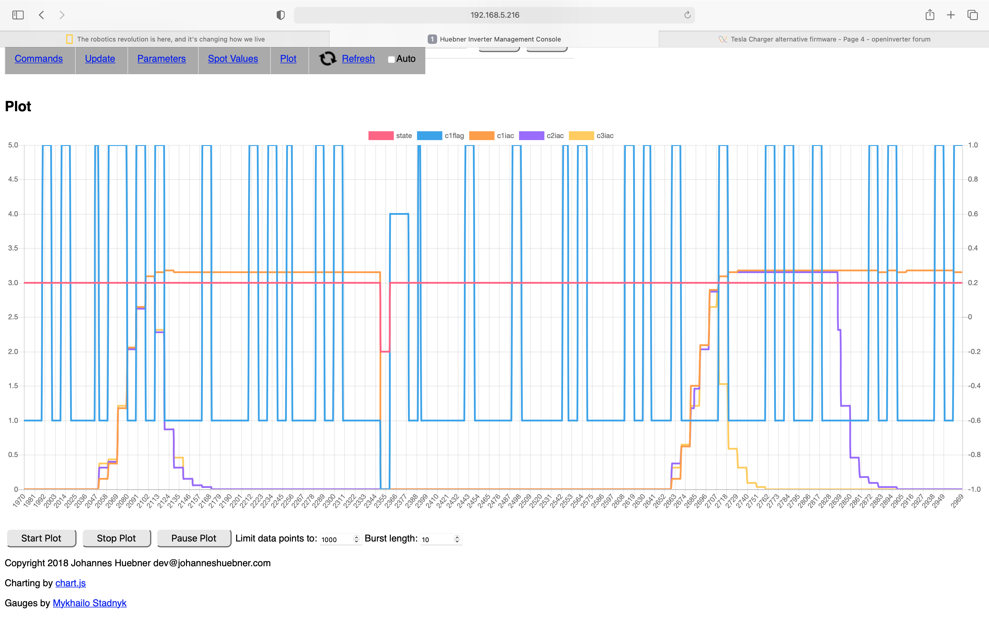

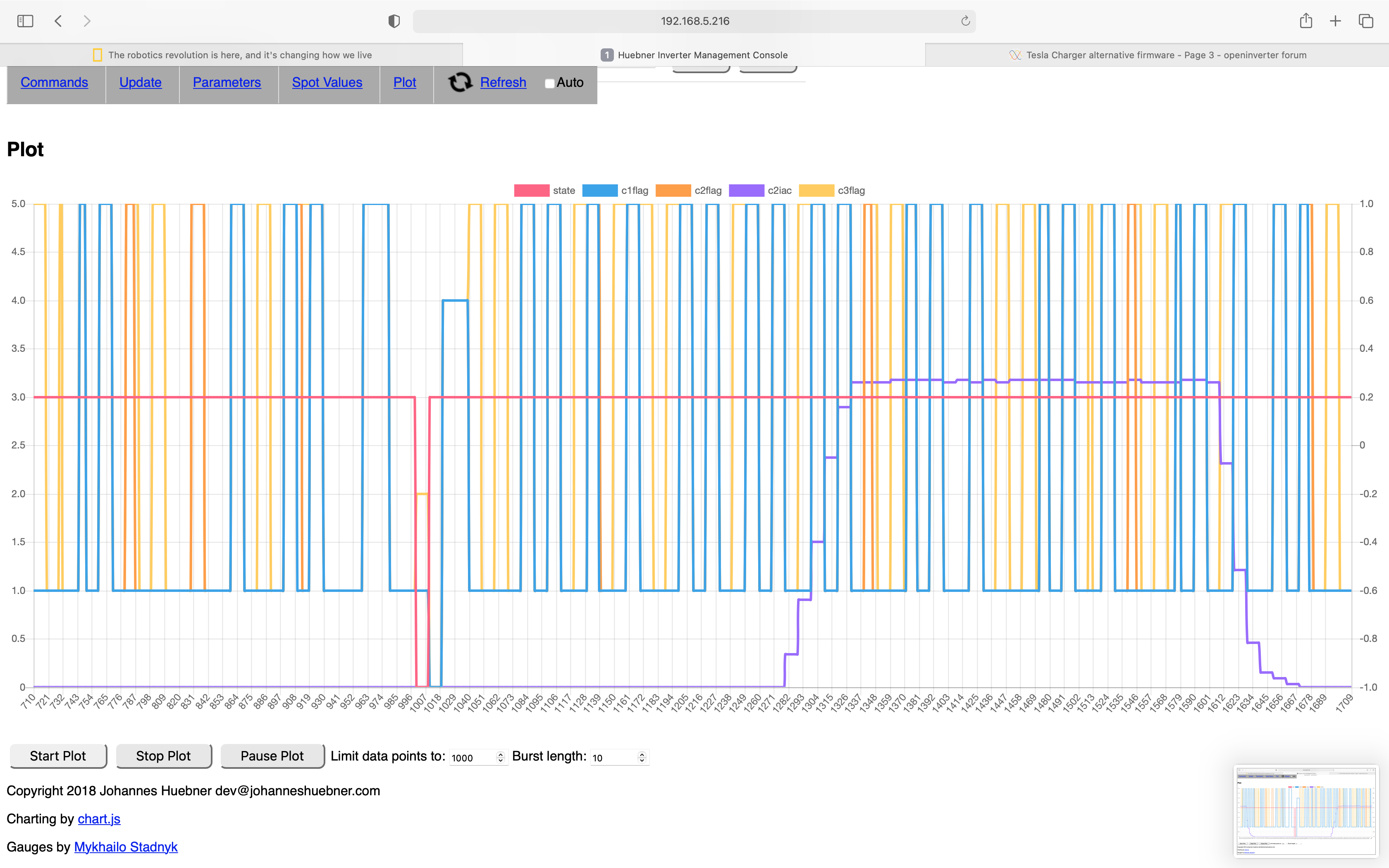

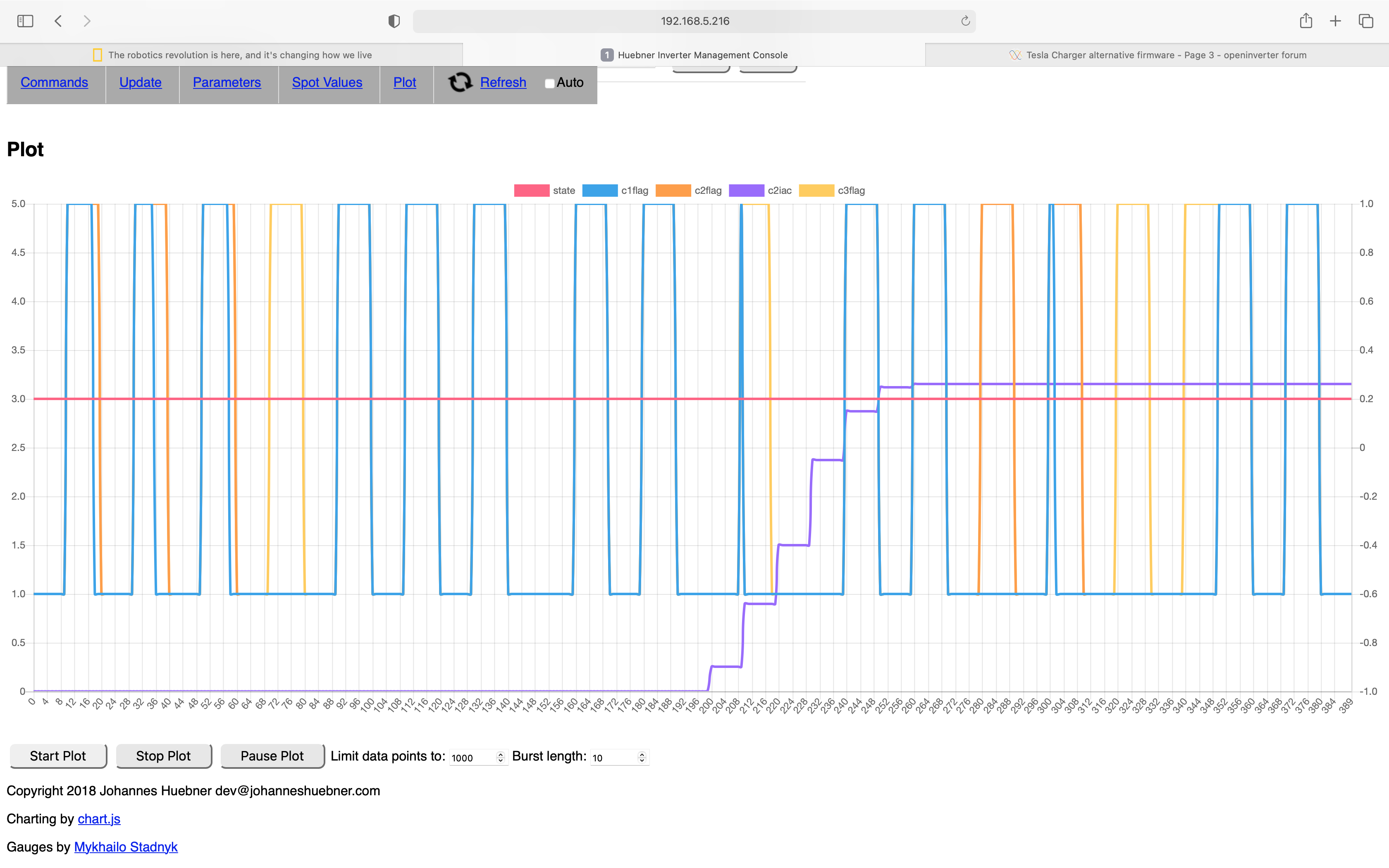

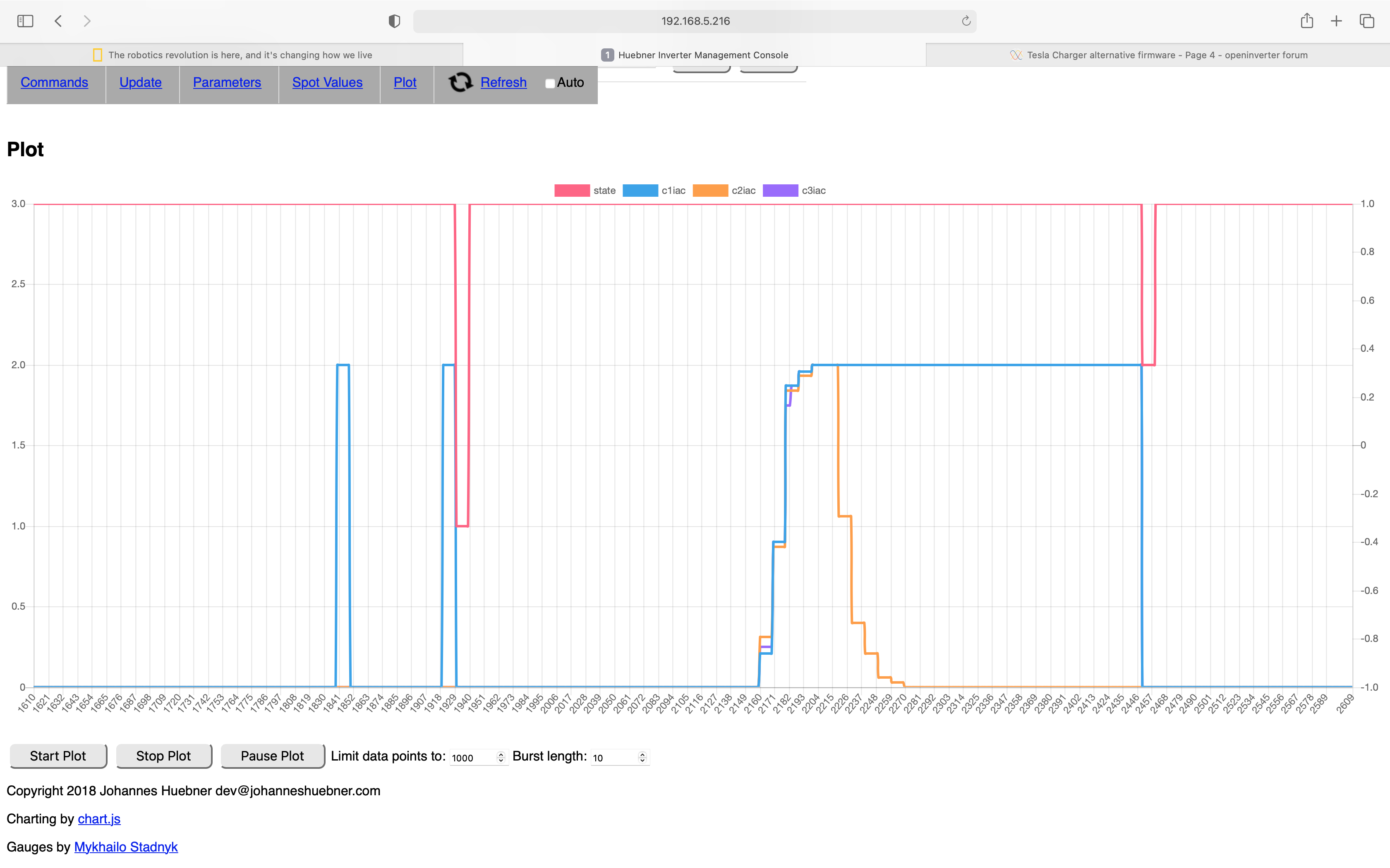

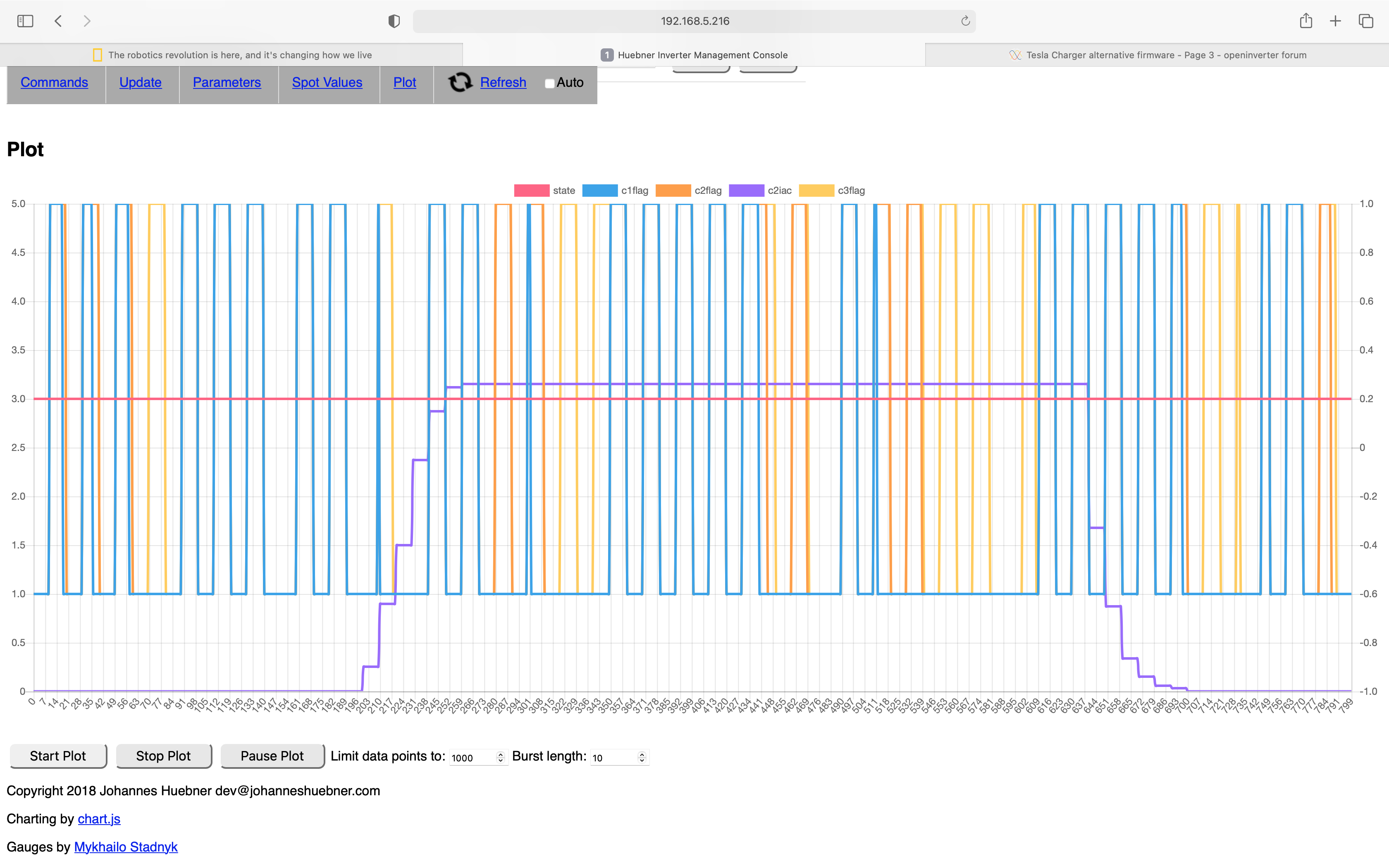

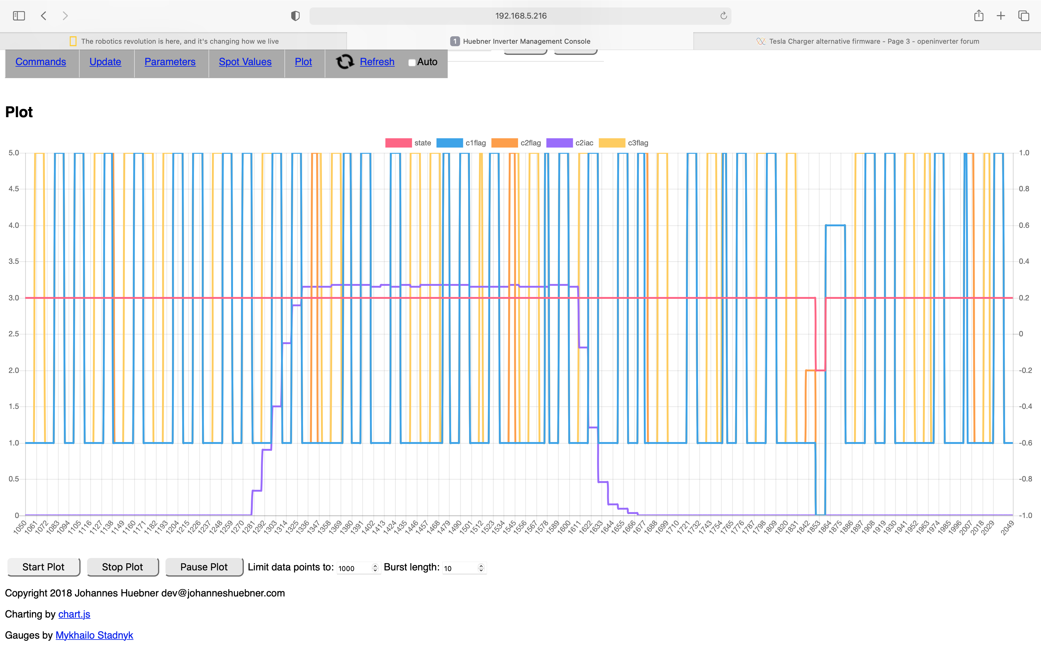

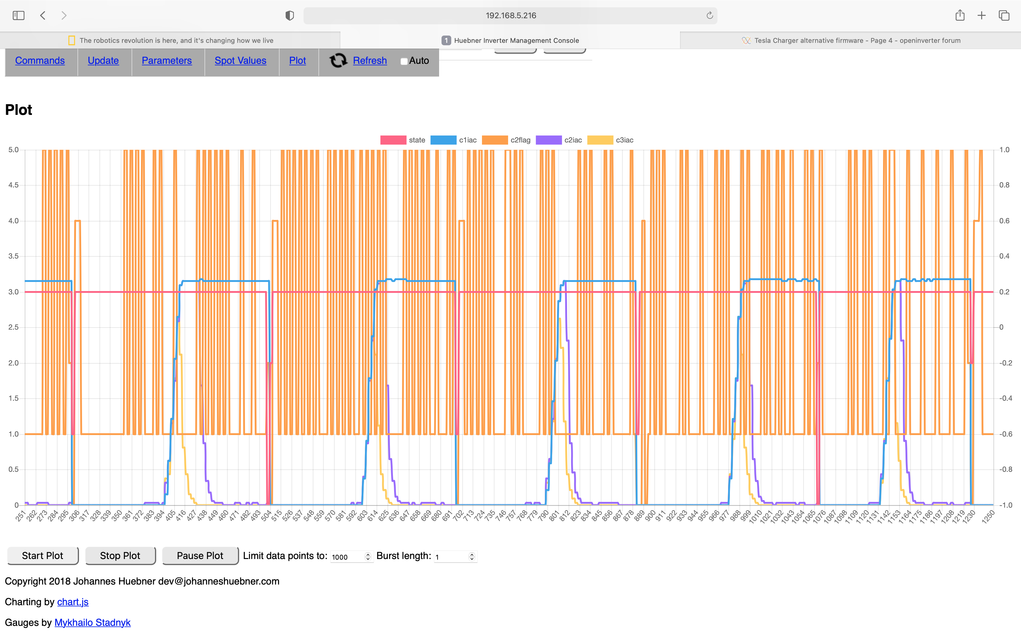

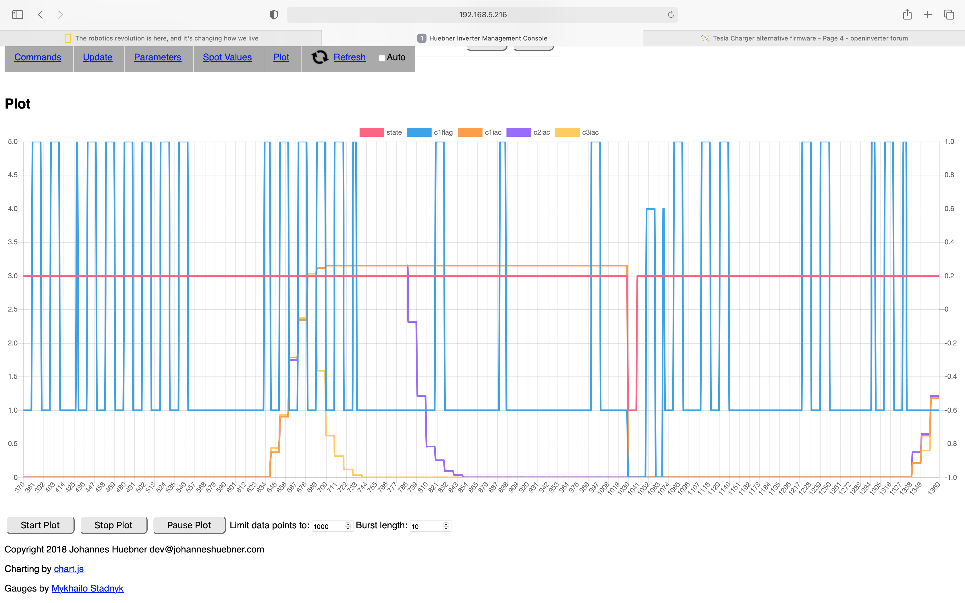

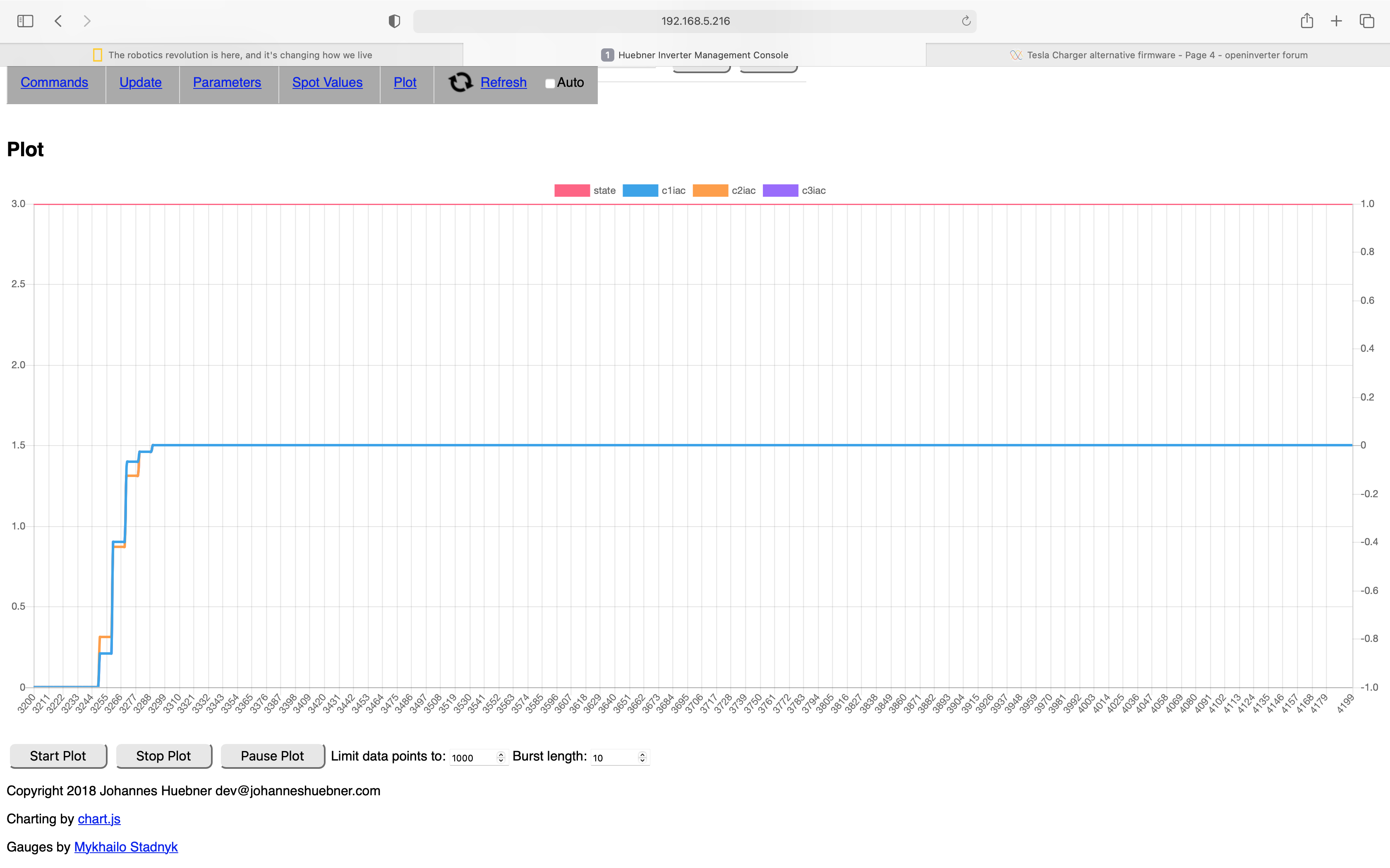

Johannes, a couple plot logs attached. I only logged phase 3 current to keep the plot a little cleaner: And logging state vs the three phase currents:
ah, it worked

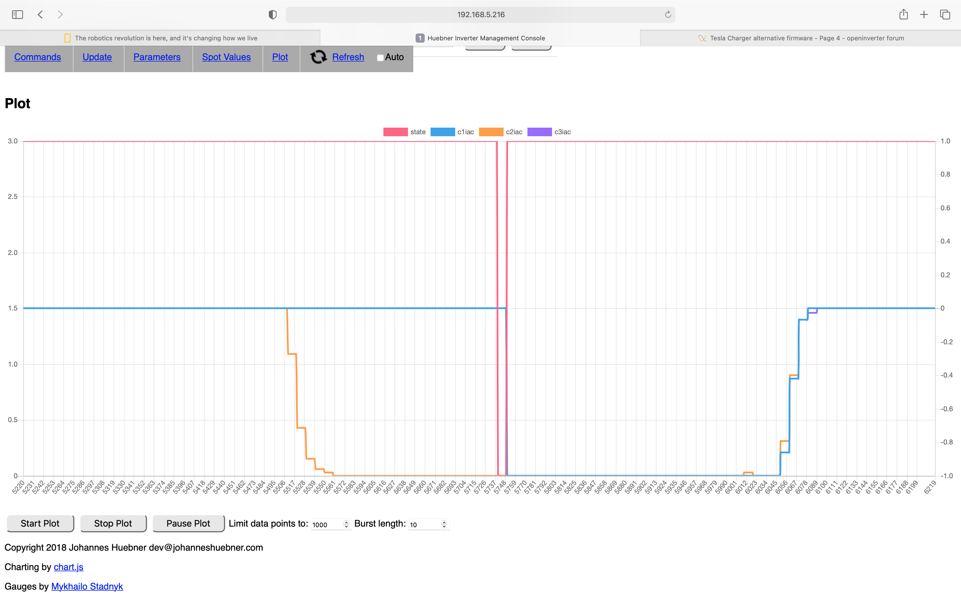

So what we see in the top plot:
It charges 3A (presumably 9A total). The flags toggle between 1 and 5. Firmware adds 4 every 100ms and checks if the next CAN message resets it back to 1 (or 0 or 2). Timeout check. All normal so far, no timeouts, for that it would need to stay at 5 for 2s.
Then the current tapers down quite controlled and about 1-2s later charger 2 signals an error. State machine drops out of run mode, restarts all chargers and cycle begins again.
Next plot almost same but charger 3 signals an error, next plot also charger 3. Last plot doesn't show errors, must be outside of plotted range. Only charger that never shows an error is charger 1. Can you try enabling only charger 1? Type "set chargerena 1" into custom command. set chargerena 7 to enable all again.
What have you set udcspnt to? Could it be reaching that and actually it is not a set point but an over voltage limit? Can you

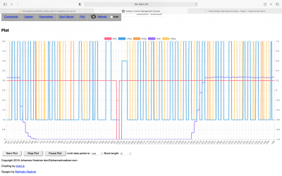

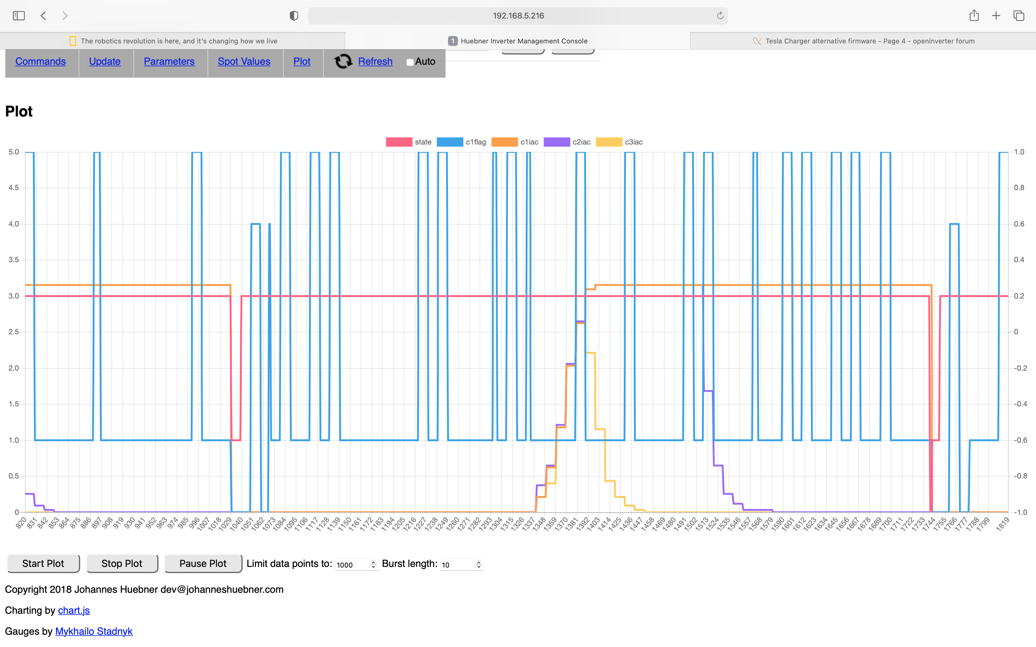

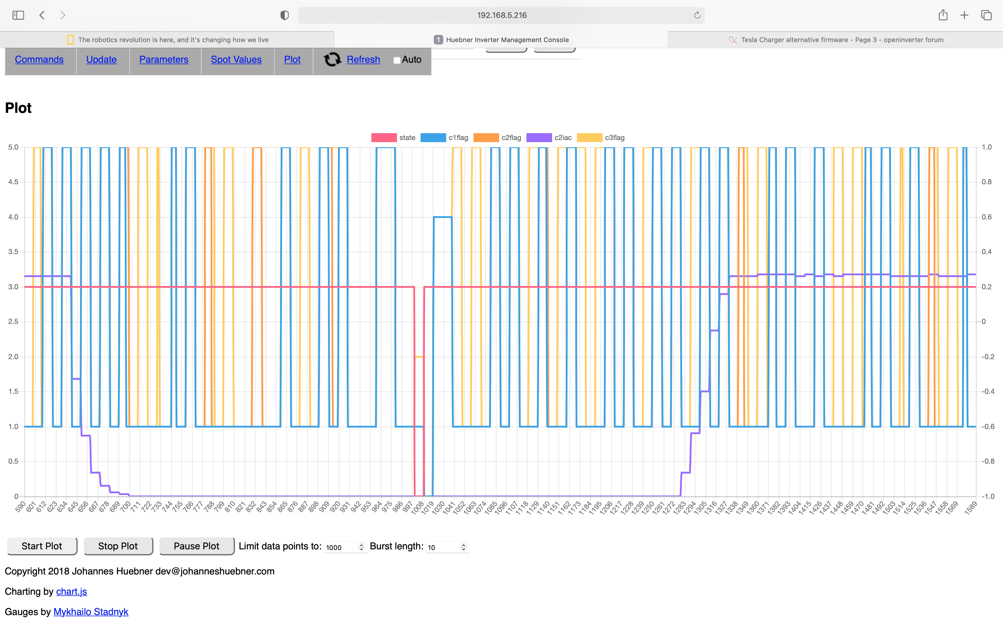

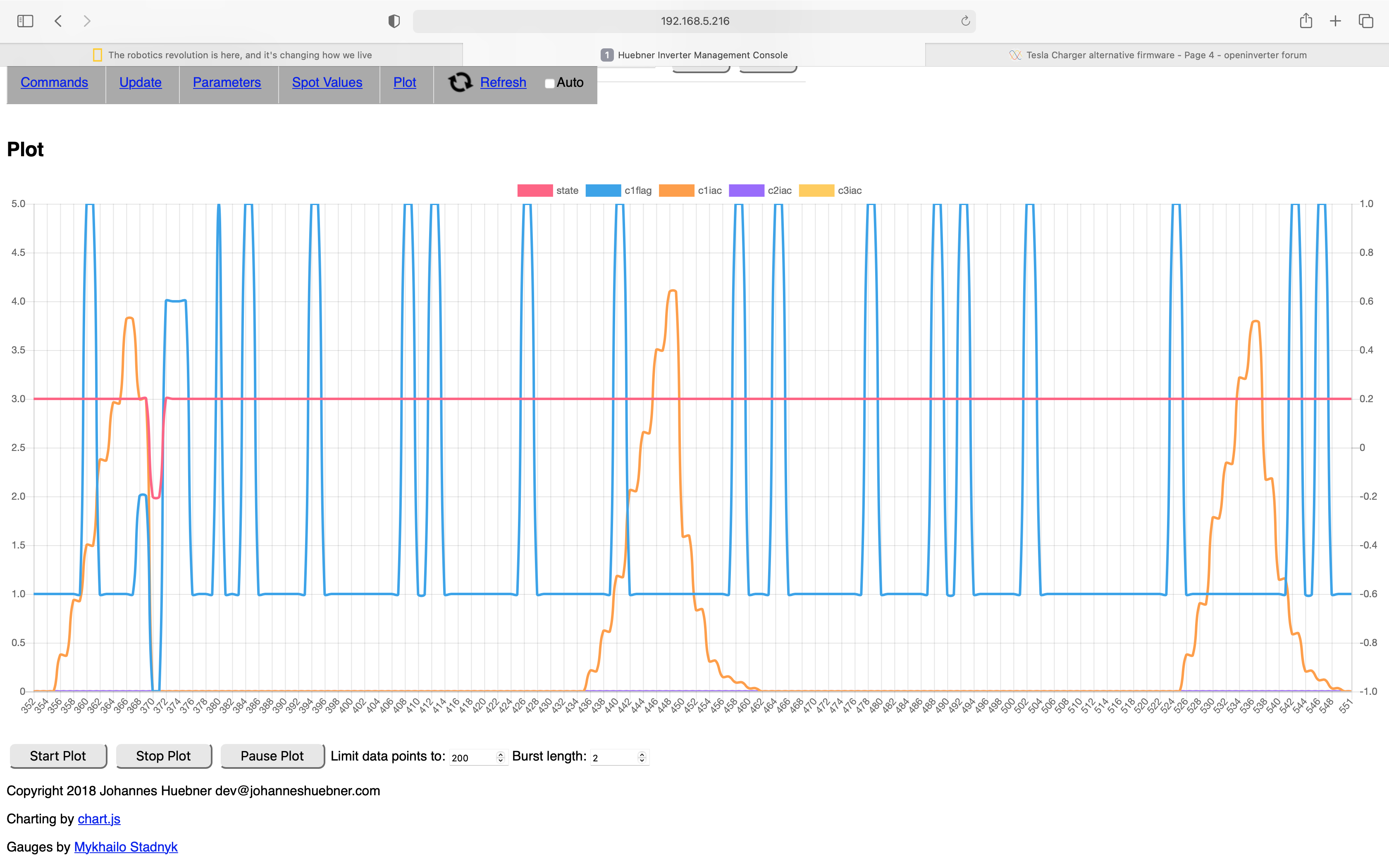

Aha, more plots
So yes it seems charger 1 works good while the others drop out for some reason. Maybe it would be good to disable modules as AC current drops below x A. They might not be happy to charge at too little current?

udcspnt is set to 430V, was 426V, I'm seeing udc on phase 1 get up to 425V via the plot before it ramps back down. I've also set udclim to the same 430 for now. Pack is currently sitting around 410V with no charge activity.
I agree with your suspicion about turning on fewer phases deliberately at lower current. The odd part is that it seemed to work fine when I had iac set to a lower number previously when I had the max stuck at 16. Here's a plot with just phase 1 turned on:

The flag does drop to 0 with chargerena=1, that would mean I’m still getting an error, right? Left side of the above plot
