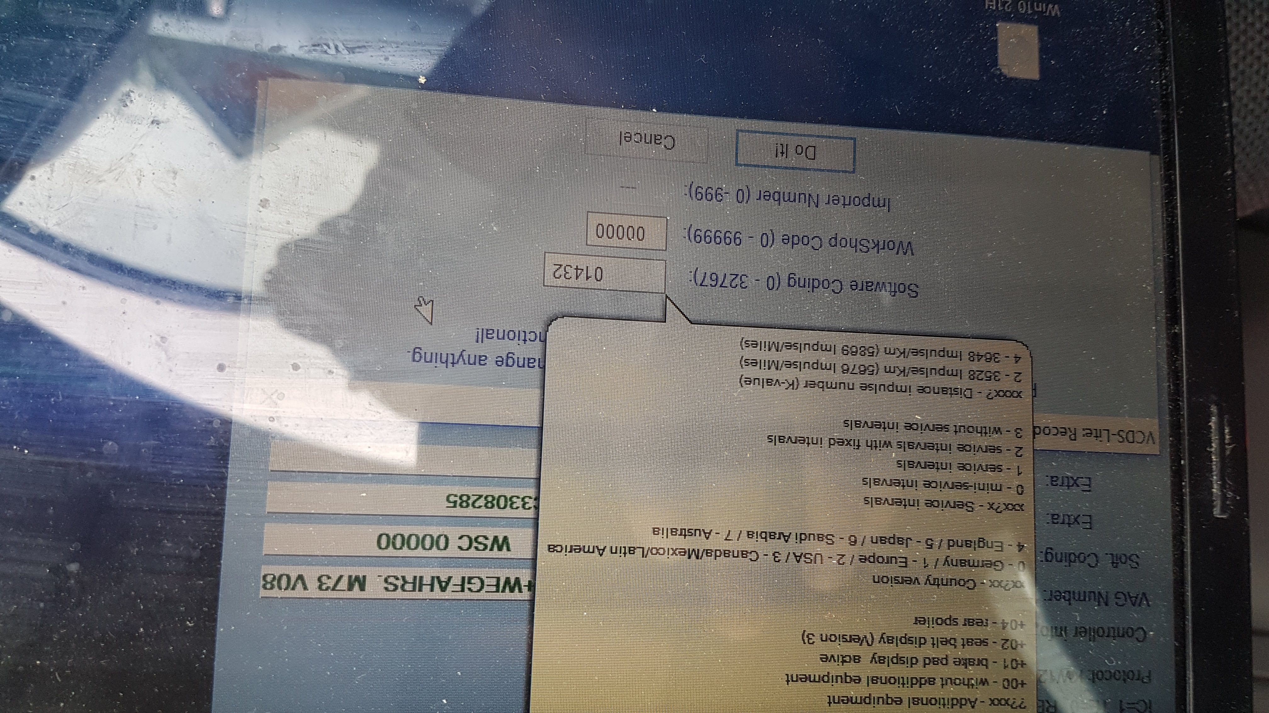

Thanks, managed to disable it, it was a little different to Johannes in that I had to change to softcode instead of adaptations.
Changing the second to last value to 3 did it. No Service intervals.
Still got a few more issues to chase on the car errors front but that's one ticked off.

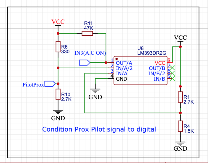

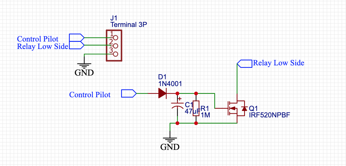

I'm going to use the CP signal with a diode and a IRF520 with a capacitor to switch on a relay to power up the VCU, Simpbms and inverter, with diodes to prevent powering up the rest of the ignition. A comparator for the PP pin for pulling AC present high in SimpBMS.
That's the plan at the minute anyway.

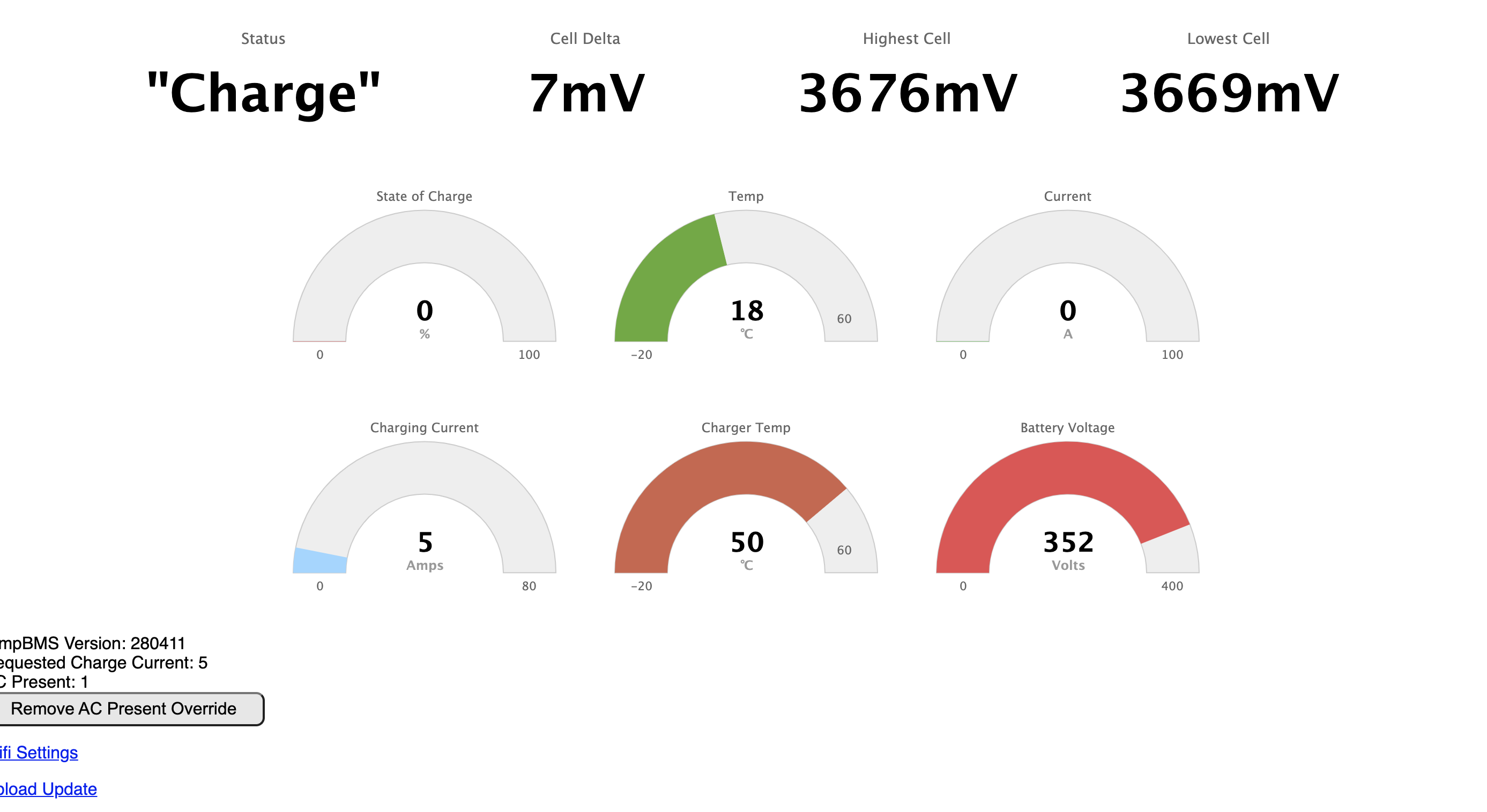

It's getting some Beetle Juice now, only at 5 amp for now. Still got a few bugs to squash in my SimpBMS Web interface but it's looking good.

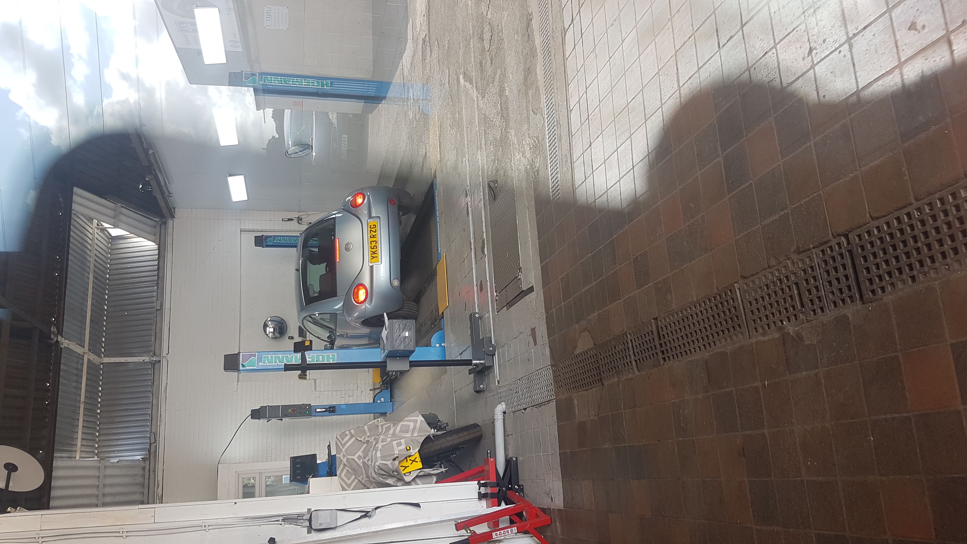

MoT test passed today :D Got a nice print out of the axle weights too.
