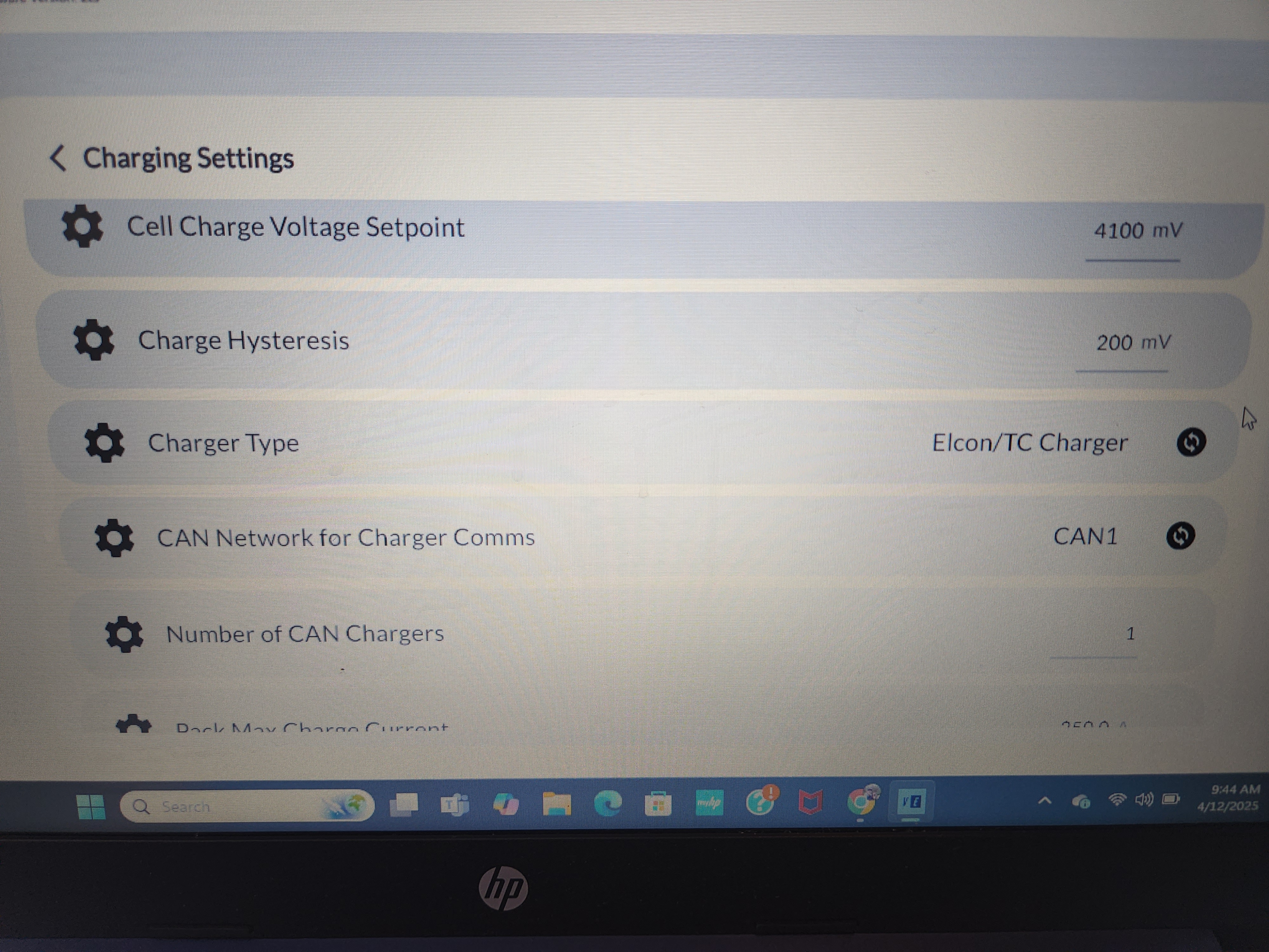

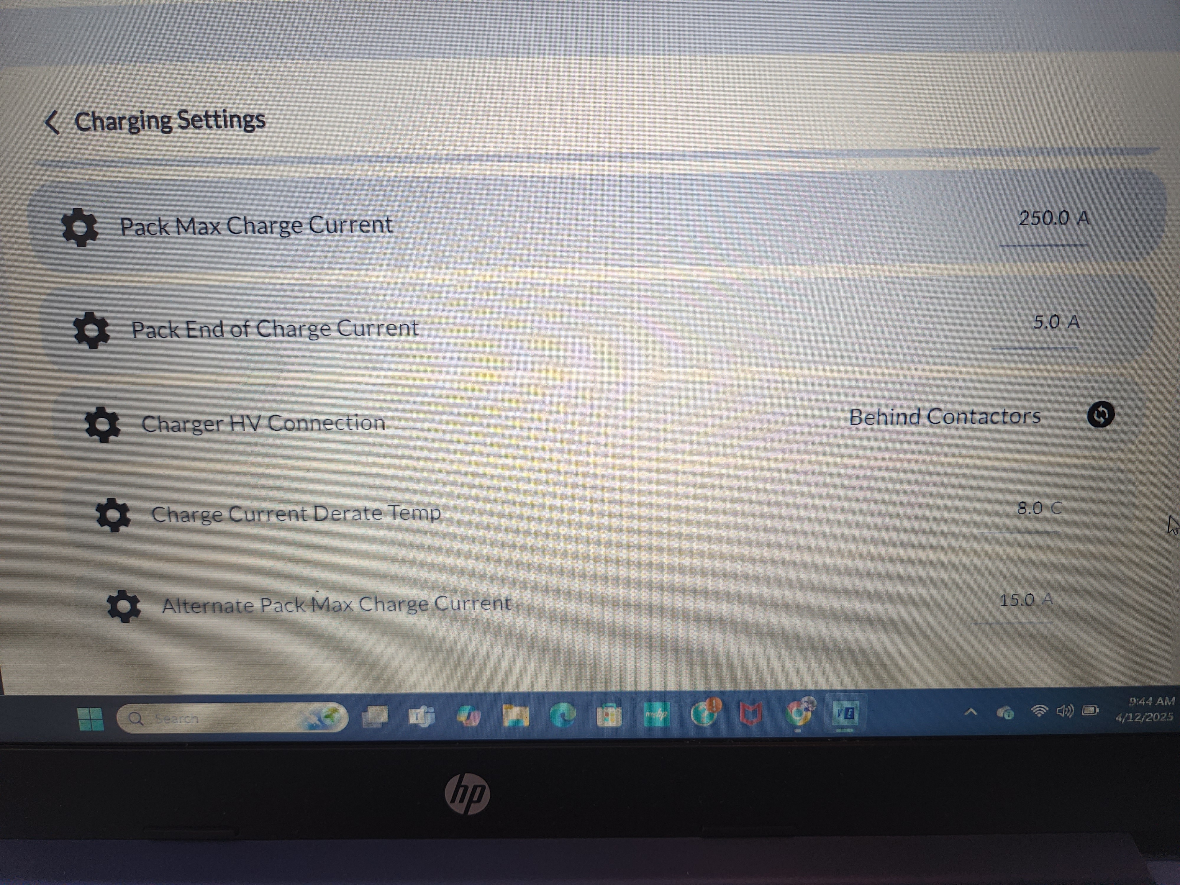

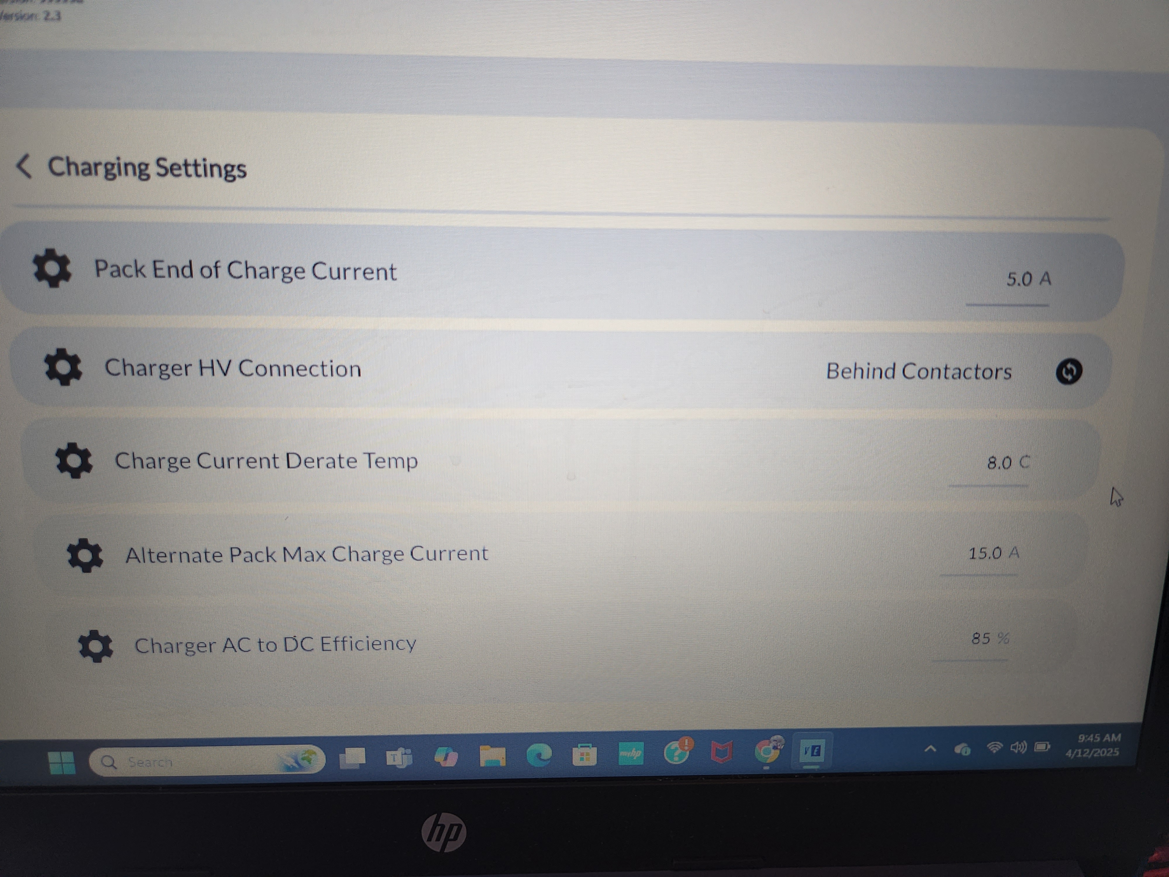

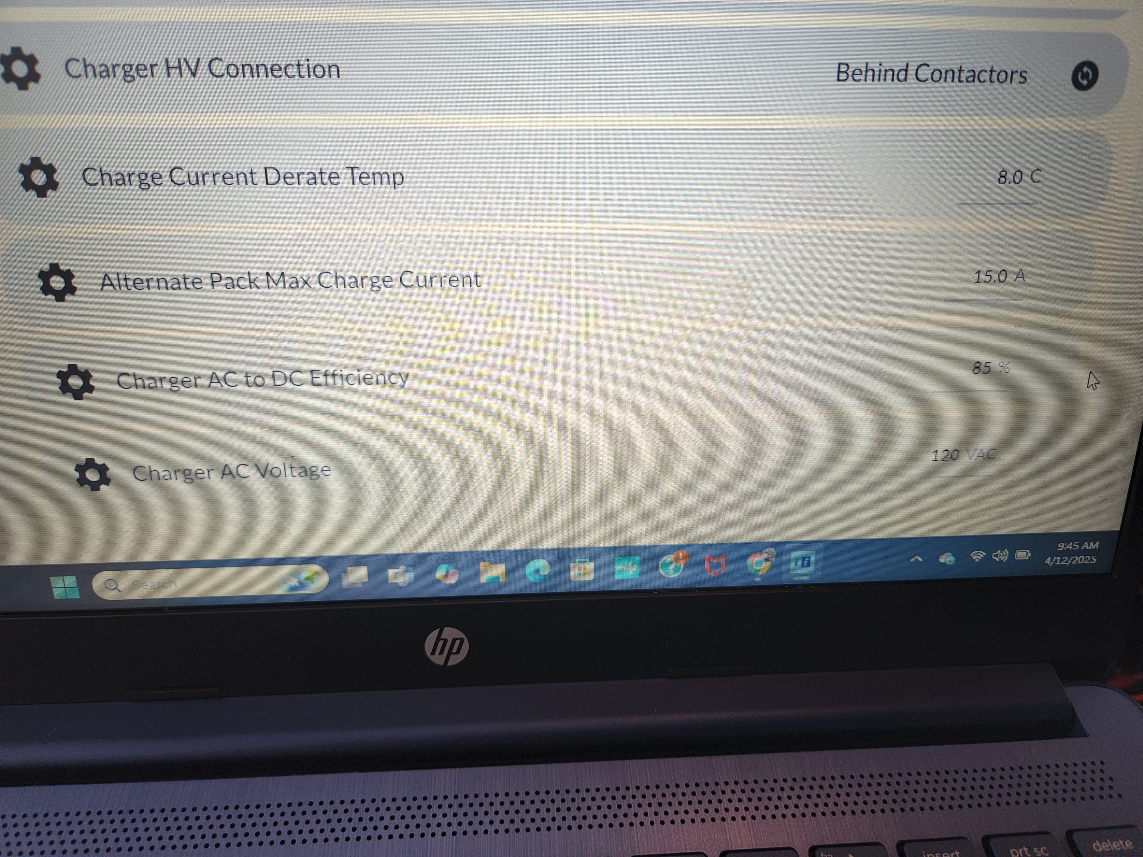

ImageHi I am having an issue getting my car to charge. I'm using the simp bms v2 and a simp charge. I have an elkon 6.6 charger. I have the charger wired behind contactors.
Please see the current settings on the dashboard. Let me know if you see anything I'm missing.

? post some more info on you issue.

When I plug In the EVSE it indicates ready on the EVSE. Nothing happens, no fan, no charge. I have 12volts at the simp charge, good ground. All connections are secure. I have the proper resister in place as well. I was wondering if any of my parameters need to be adjusted in the photos above

This is not the SimpBMS but Vero-BMS I believe reach out directly to them. https://veroelectric.com/product/vero-bms-v2
