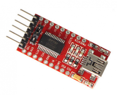

c) Get USB <-> UART adapter, install a web interface on your local machine
Bear with my ignorance, there's not a lot of answers when someone is asking the wrong questions..
I have the ST Link thing. Some places, in ways I don't understand, say that you can use that as UART. Others say no.
How/where/what do I use as a USB-UART adapter? Might I have one of these already? (I think I bought something like this, once upon a time, to try to program an ESP8266 but then I gave the ESP to someone else who needed it and never replaced it...).

I highly recommend going with a).
I did b). and c). and d). Lost a lot of time on that..
You will need to tune your motor in your car "on the road" also , not only on the bench..

I prefer Wifi interface to usb cable and Linux interface. For one a lot of EMI goes on over those cables specially when motor starts.
I would also like to adapt the code to another wifi module which does not use soldering for flash programming jumper.

I think I'm going to order a CH340 USB-UART or somesuch thing from somewhere local so I'm not waiting weeks. I think I want to go with option C, to do the wired version, but to use the web interface. I'm a bit confused about whether that requires me to have a linux machine or not.

You could also take advantage of the hard work done by member Dima and install his windows based web interace:
viewtopic.php?f=5&t=255#p2756
Installs on Windows 10 but have not tried earlier versions. Ir avoids the need to install Apache web server.
It is a very nice interface with a lot of extra and useful features. I am using one of these FTDI usb to ttl converter set to 3.3 Volts.
