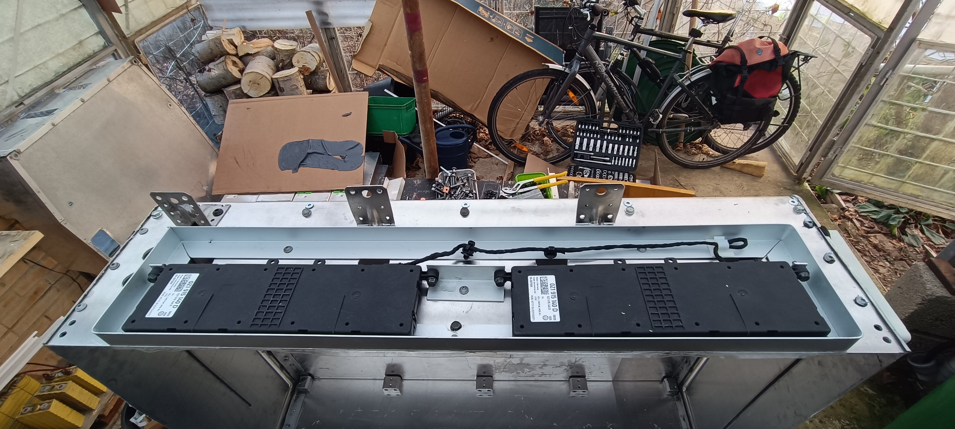

The amazing Dan Gelbart, in his MIT Prototyping for Engineers class he filmed but had the plug pulled on him, says that people who do R&D spend so much of their career doing and undoing fasteners, that you should use cases with keyholes and slots and spot welded captive hardware as much as possible because of how much time it saves. He says you'll spend about 1 year of your life doing and undoing fasteners, which is the same amount as your life is lengthened by proper exercise and diet, so eat whatever you want and just make sure you use captive hardware and it's the same quality of life difference but much simpler
Dunno if your battery box was thick enough to tap holes, or if you could weld or epoxy nuts on the far side (maybe plus tapping the case holes), to not have that issue of being unable to disassemble it later.
I complain about my lack of garage and having to borrow people's garages to get work done, and here you are out in the snow under your car. That would sap my motivation so quickly, bitterly cold aluminum on my fingers, wet and cold.

The battery pack came with some self-tapping bolts. These hold on amazingly well even to the 1.5mm side angles that I used for fastening the side walls. And in the 3mm main box anyway. But yes I emptied 20 Makita batteries into this projectMattsAwesomeStuff wrote: ↑Wed Jan 31, 2024 5:43 am Dunno if your battery box was thick enough to tap holes, or if you could weld or epoxy nuts on the far side (maybe plus tapping the case holes), to not have that issue of being unable to disassemble it later.
Got used to it over the years. At least I get to breathe some fresh air contrary to sitting in front of my computer.MattsAwesomeStuff wrote: ↑Wed Jan 31, 2024 5:43 am I complain about my lack of garage and having to borrow people's garages to get work done, and here you are out in the snow under your car. That would sap my motivation so quickly, bitterly cold aluminum on my fingers, wet and cold.

I noticed German/EU engineers obviously spend several years with fasteners. I remember we studied them to the hilt in my engineering daysMattsAwesomeStuff wrote: ↑Wed Jan 31, 2024 5:43 am He says you'll spend about 1 year of your life doing and undoing fasteners...
Now with all those slots and buttons bolts are becomming obsolete. However just try to reuse those snap fit things, they will ruin your day...
Myself i tack weld nuts under the steel boxes all the time. It is really easier on my fingers when i need to assemble that...

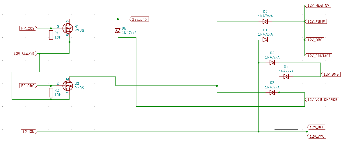

I just drew up my 12V ratsnest for my own reference and thought I should share it here
I use the PP pin of both ports to pull down 12V and thereby turn on a PMOS. The various circuits are diode-ORed with 5A Schottky diodes.

The contactors are not enabled in CCS mode because the CCS contactors branch off before the "car" contactors.

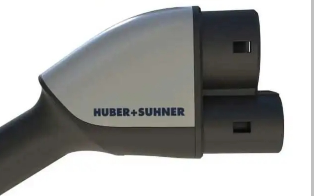

I have two charge ports because as of yet I was too lazy to wire up the AC part of the CCS port to the OBC. Might change later.I use the PP pin of both ports to pull down 12V and thereby turn on a PMOS. The various circuits are diode-ORed with 5A Schottky diodes.
Re: [DRIVING] VW Touran powered by Nissan Leaf
Did you use some special software to draw the "ratsnest"?
I am redoing all the wiring on my project from scratch and looking for options...
Thanks!
Thanks!

Not super special

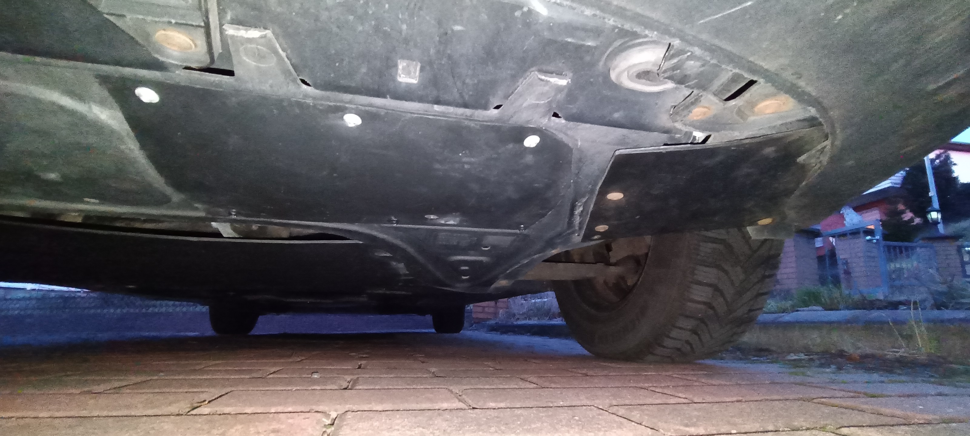

What I should have done: make a lid for the BMS box
So what I did instead Aeromods!
Closed of the two ducts for brake cooling because who needs that when you have regen. And also the duct for transmission cooling. And finally cover the complete underbody rather than just half of it like to stock undertray. Oops. left a little hole. Will close later.
I might also buy moon disks that completely close off the wheel to further reduce turbulence.
with the battery already in the car. Not fun.So what I did instead Aeromods!

Have you ever attempted to use keyhole pems or spot welded hardware in production? These both shift the time savings to an operation of installing these things to a person or a machine that likely also needs to be programmed.MattsAwesomeStuff wrote: ↑Wed Jan 31, 2024 5:43 am The amazing Dan Gelbart, in his MIT Prototyping for Engineers class he filmed but had the plug pulled on him, says that people who do R&D spend so much of their career doing and undoing fasteners, that you should use cases with keyholes and slots and spot welded captive hardware as much as possible because of how much time it saves.
Then there's the struggle of using the keyhole pems, warped pieces not grabbing them, no lead in to get them started, rattles, etc. Basically all the ones I've tried suck. Production can move too quick and strip / rip them out then the part or assembly is junk.
Pems nuts are ok but still time to install and can be stripped out / popped out.
It's definitely quicker using self threading screws. The coarse, wood looking screws meant for sheet metal with a blunt nose are my favorite if it's a minimal # of times it gets used and there's a torque limiter used to tighten them.
Weld studs can really suck if the welder doesn't know what they're doing or their capacitive discharge equipment is shot. Their welding can be incredibly inconsistent too. They feel ok then break away. They like to fall off at very inopportune times leaving no easy way to fix them.
Clip nuts / push nuts or hex rivnuts if they need some extra strength are my favorite lighter duty and replacable threaded fastener options.
Christmas tree clips, the plastic clips with the push in lock cylinder, or the ball stud and rubber cup work well and are quick too.

A flat floor has been on my to do list for far too long. It should make a real difference
- Posts: 6709
- Has thanked: 368 times
- Been thanked: 1536 times
Yes will see how things develop in summer time. Today I drove 31 km and used 9% of the battery. Consumption display was 130 Wh/km. 10°C ouside temp.
Does the German TÜV care as long as everything is secure and not protruding too far down or outside the car?
My friend who converted his Triumph Spitfire said adding a "skid pad" to front of his car made a measurable difference...
