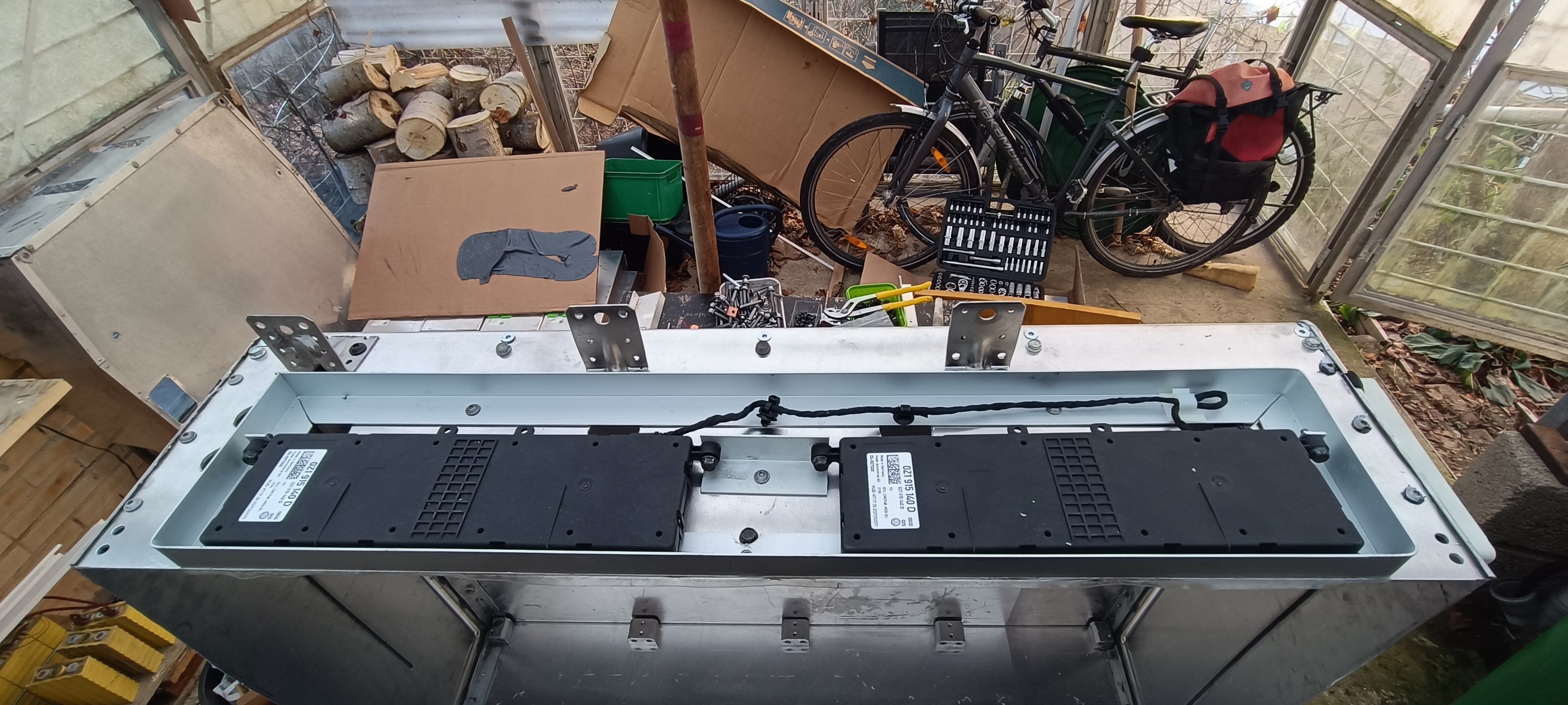

Dunno if your battery box was thick enough to tap holes, or if you could weld or epoxy nuts on the far side (maybe plus tapping the case holes), to not have that issue of being unable to disassemble it later.
I complain about my lack of garage and having to borrow people's garages to get work done, and here you are out in the snow under your car. That would sap my motivation so quickly, bitterly cold aluminum on my fingers, wet and cold.
- Been thanked: 1913 times
Re: [DRIVING] VW Touran powered by Nissan Leaf
The battery pack came with some self-tapping bolts. These hold on amazingly well even to the 1.5mm side angles that I used for fastening the side walls. And in the 3mm main box anyway. But yes I emptied 20 Makita batteries into this projectMattsAwesomeStuff wrote: ↑Wed Jan 31, 2024 5:43 am Dunno if your battery box was thick enough to tap holes, or if you could weld or epoxy nuts on the far side (maybe plus tapping the case holes), to not have that issue of being unable to disassemble it later.

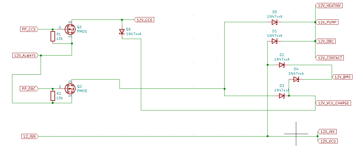

I just drew up my 12V ratsnest for my own reference and thought I should share it here
I have two charge ports because as of yet I was too lazy to wire up the AC part of the CCS port to the OBC. Might change later.
I use the PP pin of both ports to pull down 12V and thereby turn on a PMOS. The various circuits are diode-ORed with 5A Schottky diodes.
Use cases
CCS charging
Turns on
Turns on
Turns on
The contactors are not enabled in CCS mode because the CCS contactors branch off before the "car" contactors.
Use cases
CCS charging
Turns on
- CCS controller via Q1
- VCU in charge mode via D6
- BMS via D4
Turns on
- Coolant Pump, OBC, heater inverter allow, and contactors 12V side via D5
- VCU in charge mode via D3
- BMS via D3 and D4
Turns on
- Coolant Pump, OBC, heater inverter allow, and contactors 12V side via D1
- VCU in drive mode
- Inverter

Did you use some special software to draw the "ratsnest"?
I am redoing all the wiring on my project from scratch and looking for options...
Thanks!
Thanks!
Not super special

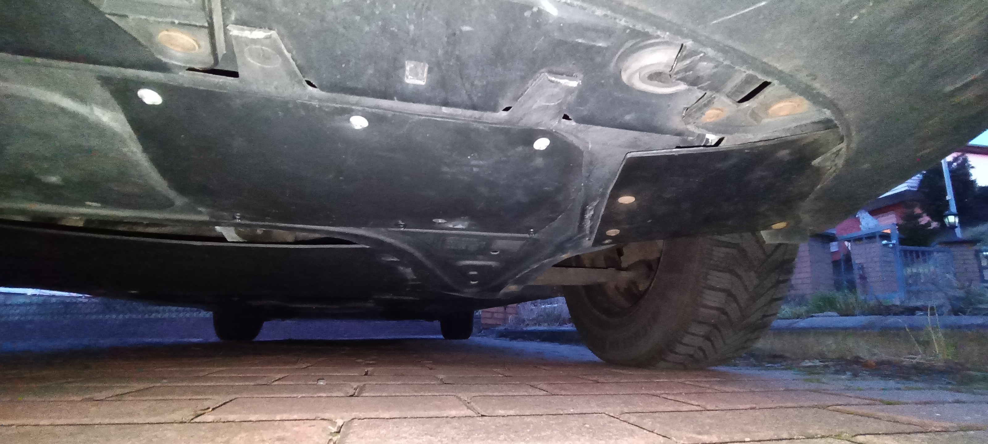

What I should have done: make a lid for the BMS box
with the battery already in the car. Not fun.
So what I did instead Aeromods!
Closed of the two ducts for brake cooling because who needs that when you have regen. And also the duct for transmission cooling. And finally cover the complete underbody rather than just half of it like to stock undertray. Oops. left a little hole. Will close later.
I might also buy moon disks that completely close off the wheel to further reduce turbulence.

A flat floor has been on my to do list for far too long. It should make a real difference
Yes will see how things develop in summer time. Today I drove 31 km and used 9% of the battery. Consumption display was 130 Wh/km. 10°C ouside temp.
Does the German TÜV care as long as everything is secure and not protruding too far down or outside the car?
My friend who converted his Triumph Spitfire said adding a "skid pad" to front of his car made a measurable difference...
