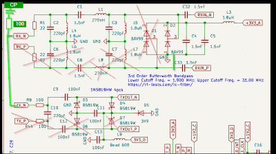

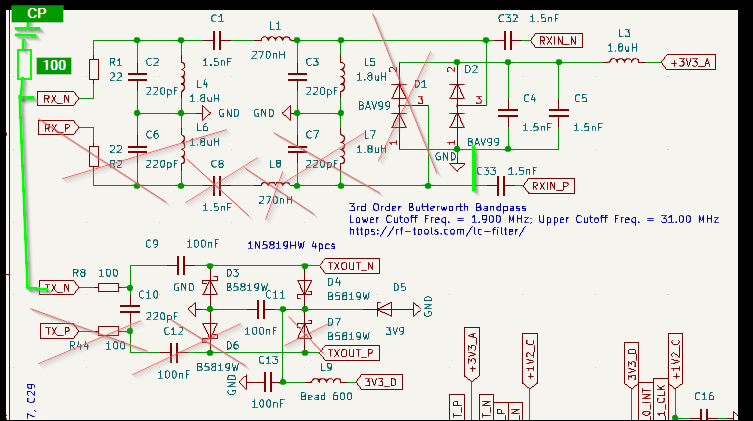

Re: Develop a QCA7000 board?
Made some measurements to compare the original Foccci V5 (including transformer) and a transformerless patch of it.
As expected, the transmit power lowers a little bit, which can be partly compensated by decreasing R25 from 150 ohms to 100ohms. The receiver sensitivity does not show significant difference.
The only concern is, that the transformer was also a "first line of defense" against low frequency high power disturbances. The remaining protection with the diodes is good, but is only the second line of defence. Maybe we should add additional diodes at the front end.
This makes sense. But the currently used TVS SMAJ18A has a capacitance of some hundred pF, which would kill a lot of RF. How to find a TVS with lower capacitance, I think below 50pF would good, because 50pF have already ~100ohms at 30MHz. If available, I would prefer the 10 to 20pF range.

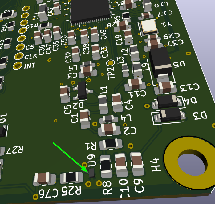

Done with https://github.com/uhi22/foccci/commit/ ... 362a79e89f which is a pre-version for 5.2.
Ready for review and comments.

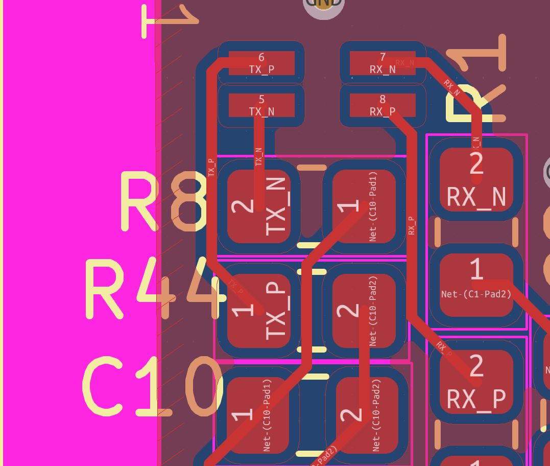

A lot of this you might know, none of it is a knock, just a second set of eyes and the short version of what I see.
A quick design review:
- Do J3 & J5 have enough room to the box for clearance? If you want you can set a components keepout on the edges where the box lips are - if it has them.. I think the front courtyard area is purple to try to keep stuff out of those sections. Or just for bench testing?
- For the C77-C80 + area there is 1 thin ground for a string of 9? capacitors & resistors. I'd suggest bumping them over a bit and adding a top local thermal relief GND plane with a bunch of stitching vias to gnd. I always try to stitch ground pads to the inner ground plane just to avoid issues.
- You have +3V3 & GND in the 2 inner planes but use a bit of a spiderweb of a plane on top to connect things. It can get hard to track whats going on for good connections using the woven top method. Rules check will see things connected even though it might be a very thin trace, a lot of heavy items on it, or a long convoluted path. I'd suggest using the inner planes as +3V3 & GND and routing the high speed lines on top of the inner ground plane. Dropping vias everywhere they're needed locally.
- Y2 / Y3 backup crystal footprint - Is it still necessary?
- If you leave the planes off the top and bottom layers you can use small sections of planes for ground, power, etc. on the top or bottom layers to connect groups. It takes a bit to remember you have the power and ground pretty much everywhere for you but it helps simplify things a ton. You can likely eliminate the planes on the top and bottom and start there if you want. I usually do one trace and via to power / ground for a pad then just copy / paste that trace and via everywhere its needed.
- the inner power plane can have a trace for the 1.2v line. You can make the 3v3 a U shape around it if you're worried about making a loop. Whats there gets thin and makes some loops around C40.
- via in pad is ok if you are doing filled & capped vias, otherwise theres a chance it ends up a dry solder joint from the solder wicking into the via hole or toumbstoning if the hole is on the edge of the pad. You can put the vias off the edge of the pad, past the solder mask and not worry about the solder going anywhere. The soldermask will block it.
- Pin 1 dots next to ICs help fabrication breeze through the assembly and troubleshooting. I know there are other methods but they are all less quick and clear, at least for me.
- Design Rules Checker (DRC) helps find important and less important issues. There are some footprint overlaps to bump a bit and silkscreen overlaps if it matters to you.
- plane minimum size can be adjusted to flow a bit better between pads and things. JLC is fine with .2 plane sections between items, that's usually all it takes to not have fingers of the plane flow almost touching.
- I usually try to do +3V3 or gnd on an inner layer, via up, capacitor pad, then pad. I try to keep the capacitor pad as the connection between to keep it clean. If it drops back down to the inner planes then up again its hard to say its decoupled well still. Almost every datasheet says to keep the capacitor as close as practical to the pin.
- D13 is close to the main connector screw boss. It should work but could likely move a bit.
-Temp1 male pin pokes through the connector housing. The J2 & J4 connectors look to be an extra though, so maybe it doesn't matter for your use case??
-focci icon has an extra miso / mosi / reset / etc label under him.
- the ground pour on the bottom might be unnecessary. Removing it only sets 1 item as not connected. It shouldn't hurt to leave it there.
Wow, many thanks, this is a lot of helpful stuff to improve my skills and to improve the product.
[Edit] Created an issue for further tracking of these findings: https://github.com/uhi22/foccci/issues/7
Regarding the pin headers which are colliding with the connector and housing: They populated only if the board is used without the Deutsch connector/housing. So a "dual purpose" board, to offer flexibility without having two board variants. Could the DRC be configured to know such an exclusive-OR-population?

Short update: made some layout improvements, considering the valuable feedback. Planned to order a set of boards, but jlc again changed the orientation in their data base for multiple components, so it looks like this:
Is there a way to keep a stable orientation for more than half a year?
