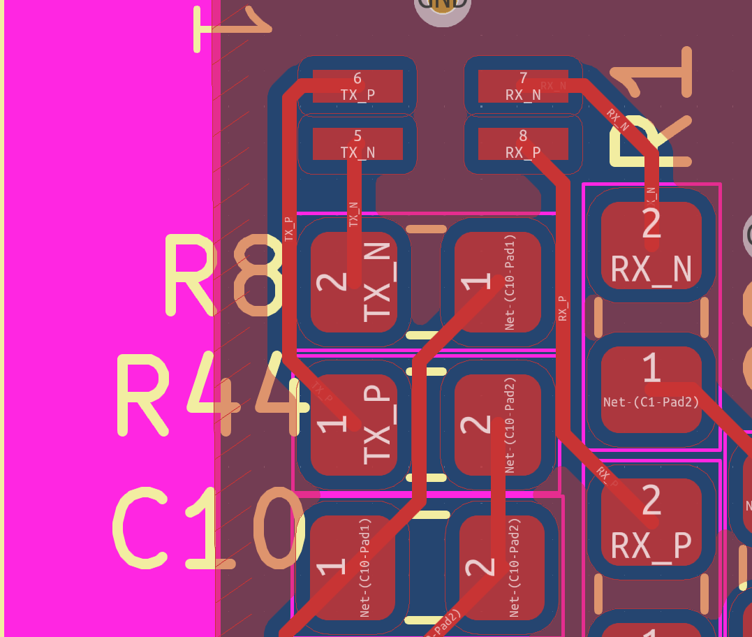

A lot of this you might know, none of it is a knock, just a second set of eyes and the short version of what I see.
A quick design review:
- Do J3 & J5 have enough room to the box for clearance? If you want you can set a components keepout on the edges where the box lips are - if it has them.. I think the front courtyard area is purple to try to keep stuff out of those sections. Or just for bench testing?
- For the C77-C80 + area there is 1 thin ground for a string of 9? capacitors & resistors. I'd suggest bumping them over a bit and adding a top local thermal relief GND plane with a bunch of stitching vias to gnd. I always try to stitch ground pads to the inner ground plane just to avoid issues.
- You have +3V3 & GND in the 2 inner planes but use a bit of a spiderweb of a plane on top to connect things. It can get hard to track whats going on for good connections using the woven top method. Rules check will see things connected even though it might be a very thin trace, a lot of heavy items on it, or a long convoluted path. I'd suggest using the inner planes as +3V3 & GND and routing the high speed lines on top of the inner ground plane. Dropping vias everywhere they're needed locally.
- Y2 / Y3 backup crystal footprint - Is it still necessary?
- If you leave the planes off the top and bottom layers you can use small sections of planes for ground, power, etc. on the top or bottom layers to connect groups. It takes a bit to remember you have the power and ground pretty much everywhere for you but it helps simplify things a ton. You can likely eliminate the planes on the top and bottom and start there if you want. I usually do one trace and via to power / ground for a pad then just copy / paste that trace and via everywhere its needed.
- the inner power plane can have a trace for the 1.2v line. You can make the 3v3 a U shape around it if you're worried about making a loop. Whats there gets thin and makes some loops around C40.
- via in pad is ok if you are doing filled & capped vias, otherwise theres a chance it ends up a dry solder joint from the solder wicking into the via hole or toumbstoning if the hole is on the edge of the pad. You can put the vias off the edge of the pad, past the solder mask and not worry about the solder going anywhere. The soldermask will block it.
- Pin 1 dots next to ICs help fabrication breeze through the assembly and troubleshooting. I know there are other methods but they are all less quick and clear, at least for me.
- Design Rules Checker (DRC) helps find important and less important issues. There are some footprint overlaps to bump a bit and silkscreen overlaps if it matters to you.
- plane minimum size can be adjusted to flow a bit better between pads and things. JLC is fine with .2 plane sections between items, that's usually all it takes to not have fingers of the plane flow almost touching.
- I usually try to do +3V3 or gnd on an inner layer, via up, capacitor pad, then pad. I try to keep the capacitor pad as the connection between to keep it clean. If it drops back down to the inner planes then up again its hard to say its decoupled well still. Almost every datasheet says to keep the capacitor as close as practical to the pin.
- D13 is close to the main connector screw boss. It should work but could likely move a bit.
-Temp1 male pin pokes through the connector housing. The J2 & J4 connectors look to be an extra though, so maybe it doesn't matter for your use case??
-focci icon has an extra miso / mosi / reset / etc label under him.
- the ground pour on the bottom might be unnecessary. Removing it only sets 1 item as not connected. It shouldn't hurt to leave it there.
Of note:
KiCad added teardrops in version 8. Its not a huge deal but teardrops can be added to all or specific types of areas if you want. Can help the trace connections to vias and other things long term.
No need to reply to this but feel free if you want or need clarity on my gibberish.

Wow, many thanks, this is a lot of helpful stuff to improve my skills and to improve the product.
[Edit] Created an issue for further tracking of these findings: https://github.com/uhi22/foccci/issues/7
Regarding the pin headers which are colliding with the connector and housing: They populated only if the board is used without the Deutsch connector/housing. So a "dual purpose" board, to offer flexibility without having two board variants. Could the DRC be configured to know such an exclusive-OR-population?

Short update: made some layout improvements, considering the valuable feedback. Planned to order a set of boards, but jlc again changed the orientation in their data base for multiple components, so it looks like this:
Is there a way to keep a stable orientation for more than half a year?

I would be surprised if JLC changed their reference of the rotation / orientation, but they reference the packaging rotation (i believe...) That can differ with the same component but different packaging (for the pick and place machines) so could be inconsistent that way. Sometimes you get the same component in JLC with multiple packaging methods, same part number besides packaging with different LCSC #s because of the packaging.
KiCAD is a mess with this, the way components are supposed to be laid out in KiCAD is the #1 pin is in the top left corner but even the components in KiCAD libraries do not always follow this. This follows IPC orientation recommendations but those can be murky and weren't consistent over the years. Other methods follow the datasheet which follow?.. And to add to this, the multiple orientation conventions, EIA, IEC, IPC and its not surprising this is a cluster. This is old, but see, https://forum.kicad.info/t/jlcpcb-bom-a ... ce/19016/7
*Edit* See also, https://ohm.bu.edu/~pbohn/__Engineering ... raries.pdf
So to avoid the confusion (but not the consistent effort) always add a reference dot for pin 1, helps you and the assembler avoid all the nonsense and be able to see clearly the correct orientation.
The JLC KiCAD Fabrication Toolkit plugin rotation data can get erased if you change the component, even to the same one. You can pull up old CPL files to see the rotation offset but have to work backwards a bit.
You could save a JLC footprint with corrected rotations but then you have multiple footprints to pollute the which one is right efforts.
No matter which way you try to go it can be a struggle. Its just part of the tail end of ordering from JLC and part of their cheap board fab. They will correct the rotations for you but I try to not dump extra effort or chance to make mistakes on them. Other board houses will correct the orientations before making boards but they still need the pin 1 references to check.
Also of note, JLC's file viewer / browser interface has a bug / a cache issue where it can keep old versions of your uploaded files and can show old rotation info - even though you upload a new one.
You have to:
- delete the old file from JLC file manager
- close the browser
- reopen the browser
- then upload the new version to JLC.
This was my mention of going in circles with JLC wen I was doing the Gen3 Leaf adapter board. I'd rotate a part, save new gerbers & files but get the same rotation issue on JLC, most of the time..
Theres also a JLC viewer bug if non ascii characters are used in descriptions in the bom or cpl files. It can shift whole sections of components in their rotation / orientation view for some reason. Sometimes you'll get a symbol in a description that geeks it out.
Lots of oddities, just part of doing these designs unfortunately. I usually need to start a fresh day working through these or I just make too many mistakes or am too tired to pay enough attention.
