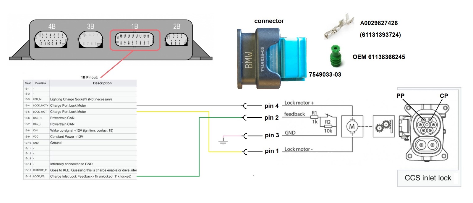

Hi. I have tried to read all the 670 posts in this thread, but could not find the i3 CCS port locking actuator pinout. I see the schematic in the wiki and that is clear. Obviously feedback/gnd may be measured, but the polarity of the locking motor is unclear. If someone has this sorted already, this detail is appreciated.
Many thanks!
Many thanks!
- Posts: 2962
- Has thanked: 328 times
- Been thanked: 847 times
did you manage to locking actuator wired properly?
Could you please provide the pinout information and connection information to the LIM, this can then be added to the Wiki.
Yes, after first some wrong ones, the correct diagram was found.did you manage to locking actuator wired properly?
The wiring diagram is like this: I may try to update the wiki, if I learn how to do it.
