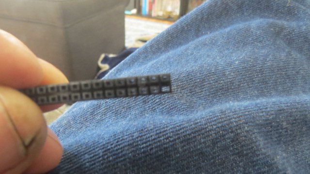

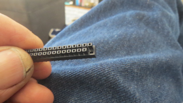

I just received my newest Gen 2 board. Couple questions. Is the new firmware in it? The other question is about the 30 pin connector. I ordered the suggested part number but when receiving it the number 1 terminal has been deleted. Damien uses the number one pin so can I just flip it around so the missing pin is on the opposite end? It looks like there's no connections there if it's just a 2 layer board.
EV_Builder
Posts: 1205
Location: The Netherlands
Has thanked: 18 times
Been thanked: 37 times
Post by EV_Builder »
Yes that's correct. You flip it.

Post by catphish »
Roadstercycle wrote: Tue Nov 16, 2021 9:00 pm I just received my newest Gen 2 board. Couple questions. Is the new firmware in it? The other question is about the 30 pin connector. I ordered the suggested part number but when receiving it the number 1 terminal has been deleted. Damien uses the number one pin so can I just flip it around so the missing pin is on the opposite end? It looks like there's no connections there if it's just a 2 layer board.
Yes, see this image from the wiki, pin 30 is not needed:

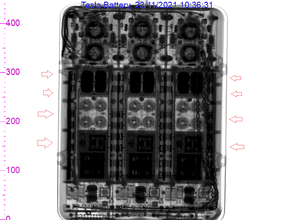

We considered drilling and tapping an extra bleed screw into our Gen2 charger because of our positioning (sideways & upright & high in the cooling circuit).
So we X-Rayed one!
Added picture to the wiki: https://openinverter.org/wiki/GEN2
Been thanked: 1913 times
Interesting! So current flows top to bottom I guess. Grid filter (2 common mode chokes) PFC stage (two more chokes), TO-247 transistors mounted on the side of the module. Then capacitor bank, transformer, output filter.

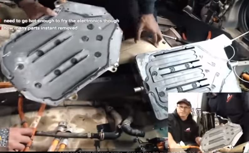

joromy
Posts: 371
Post by joromy »
janosch wrote: Mon Nov 29, 2021 1:54 pm We considered drilling and tapping an extra bleed screw into our Gen2 charger because of our positioning (sideways & upright & high in the cooling circuit).
Not so easy to see the waterflow.
I found this
janosch
Posts: 329
Location: London, UK
Has thanked: 98 times
Been thanked: 106 times
Post by janosch »
joromy wrote: Mon Nov 29, 2021 4:37 pm I found this
Wow this is great! Do you have a link to the video? Who is the guy in the picture?
joromy
Posts: 371
Post by joromy »
janosch wrote: Mon Nov 29, 2021 4:45 pm Wow this is great! Do you have a link to the video? Who is the guy in the picture?
Not sure i snipped it a while ago. But if I'm not wrong it was "Rich Rebuilds" on YouTube
