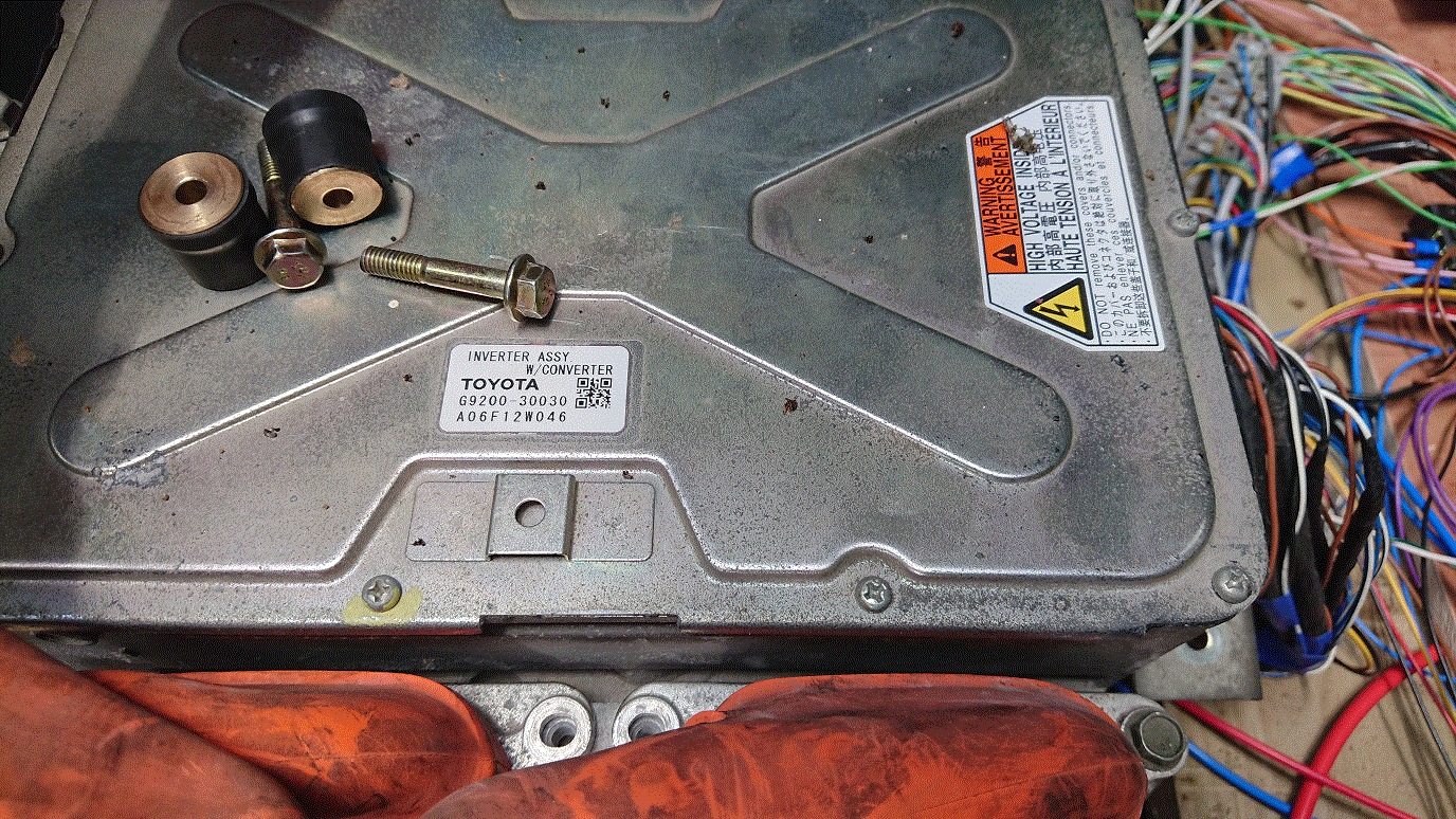

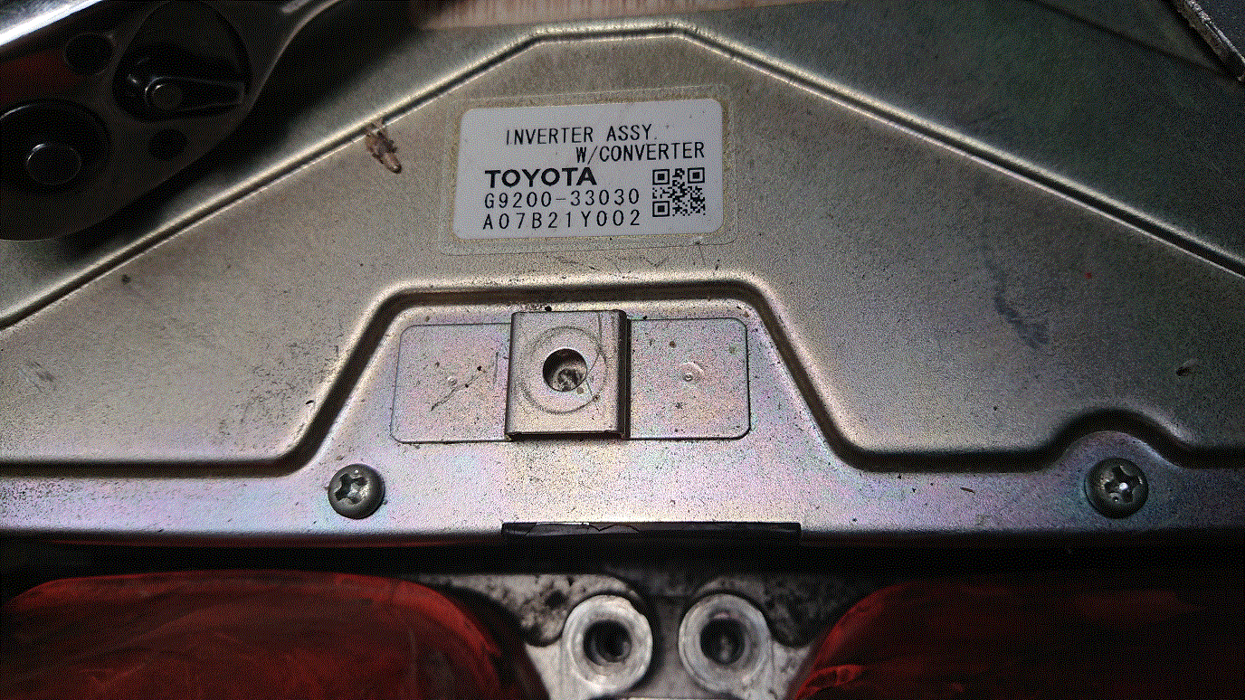

Just coming back on a previous discussion re Camry inverters. Previously I had issues running a 2007-2011 G9200-33030 inverter with the V2 VCU. Recently connected it back up (two parallel systems are a GS450H gbox + inverter, GS450H gbox + Camry inverter) and surprisingly all works 100% now and both setups run identical using the same VCU. Only change is using a BMW pedal for both rather than a Transit pedal on the Camry setup. But I suspect it was one of my wiring connections that was the original issue.Bassmobile wrote: ↑Sat May 15, 2021 10:44 pm So it seems there is a lot of confusion about using CAMRY inverters for this platform. My assumption is that users who have failed to get good results with the inverter are using the G9200-33020, from a 2007-2011 Camry NAFTA vehicle. This is the inverter that is recommended at the time of this writing in the Wiki. This should probably removed form the wiki, so other don't end up wasting time and money on an inverter that won't work.
Hi guys, does anyone know the pin outs for the resolver connectors, specifically which ones I need for the vcu?
Also is the shunt required for testing or just when using in a system with batteries.
Because this gearbox is too big for my project, I was going to try to get it working on the bench and then sell it as an ongoing project with a majority of the fab and electric work completed.
