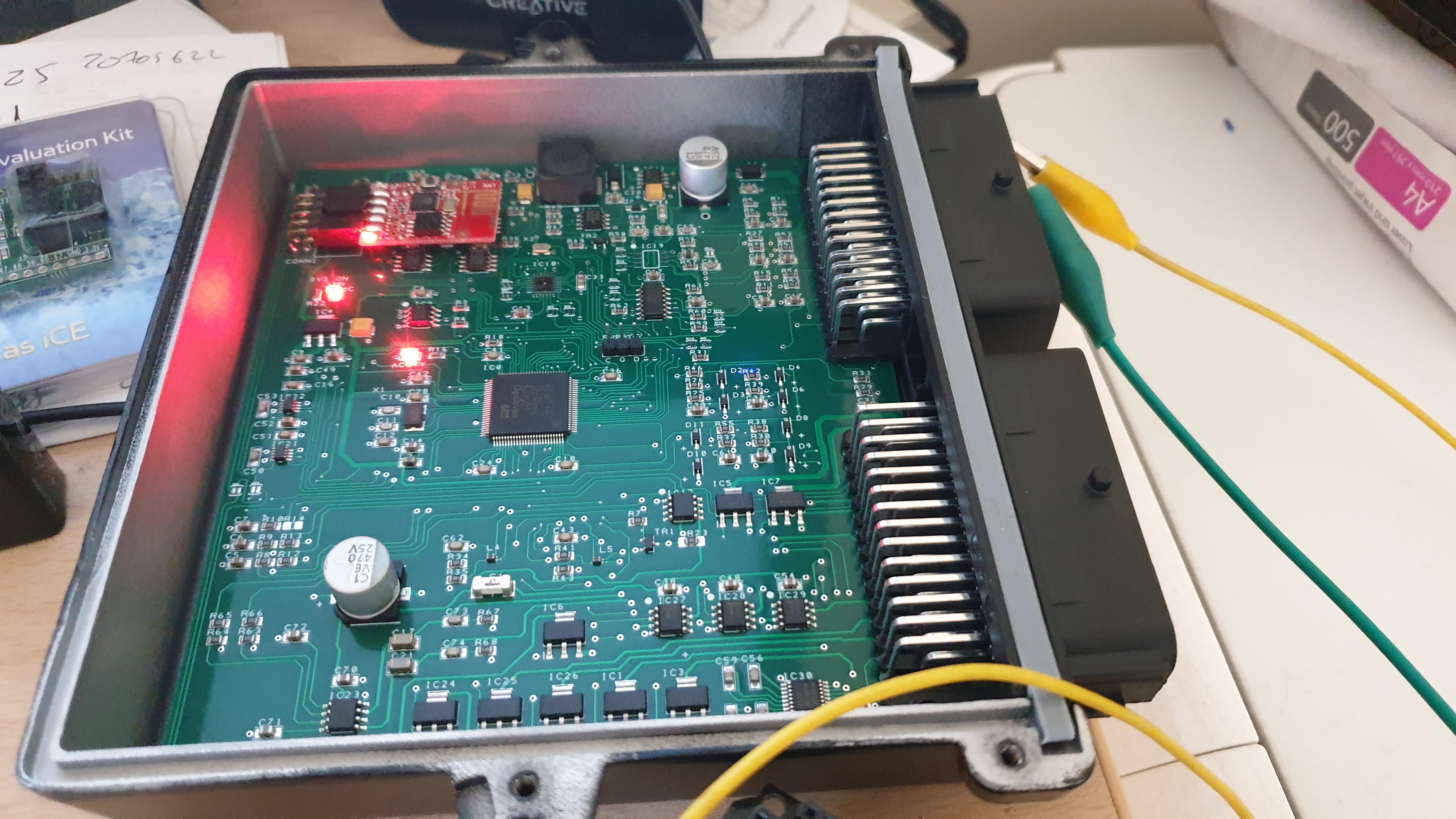

Ah the joys of GigaDevices. As some of you may have already figured out I'm using the GD32F107VCT6 on the vcu. Its very close to being an STM32F107VCT6 but not quite...
Johannes had figured out one problem so got code running on the vcu and bench tested the following :
Digital inputs
Analog inputs
Toyota hybrid coms
Pwm timers(tim1 so far)
Usart3 (wifi)
Then hit a brick wall with CAN. No tx and no rx. Tx was a damien special. Not using remapped pins in the setup routine. Only took a day for brains here to relalise that... anyway now we have tx on both CAN channels. Yay....but still no rx..
Another day and about 25 emails to Johannes later I blunder my way to the receive routine and find that GD handle the CAN fifos differently to ST and thus the libopencm3 routine was only executing once. I bodged a work around and we have can rx.
Pushing this to the repo now so folks have something to test with. Attaching the GDF1 refference manual as only took an hour to download ...

On the subject of Arm, bout time I fired this baby up:)

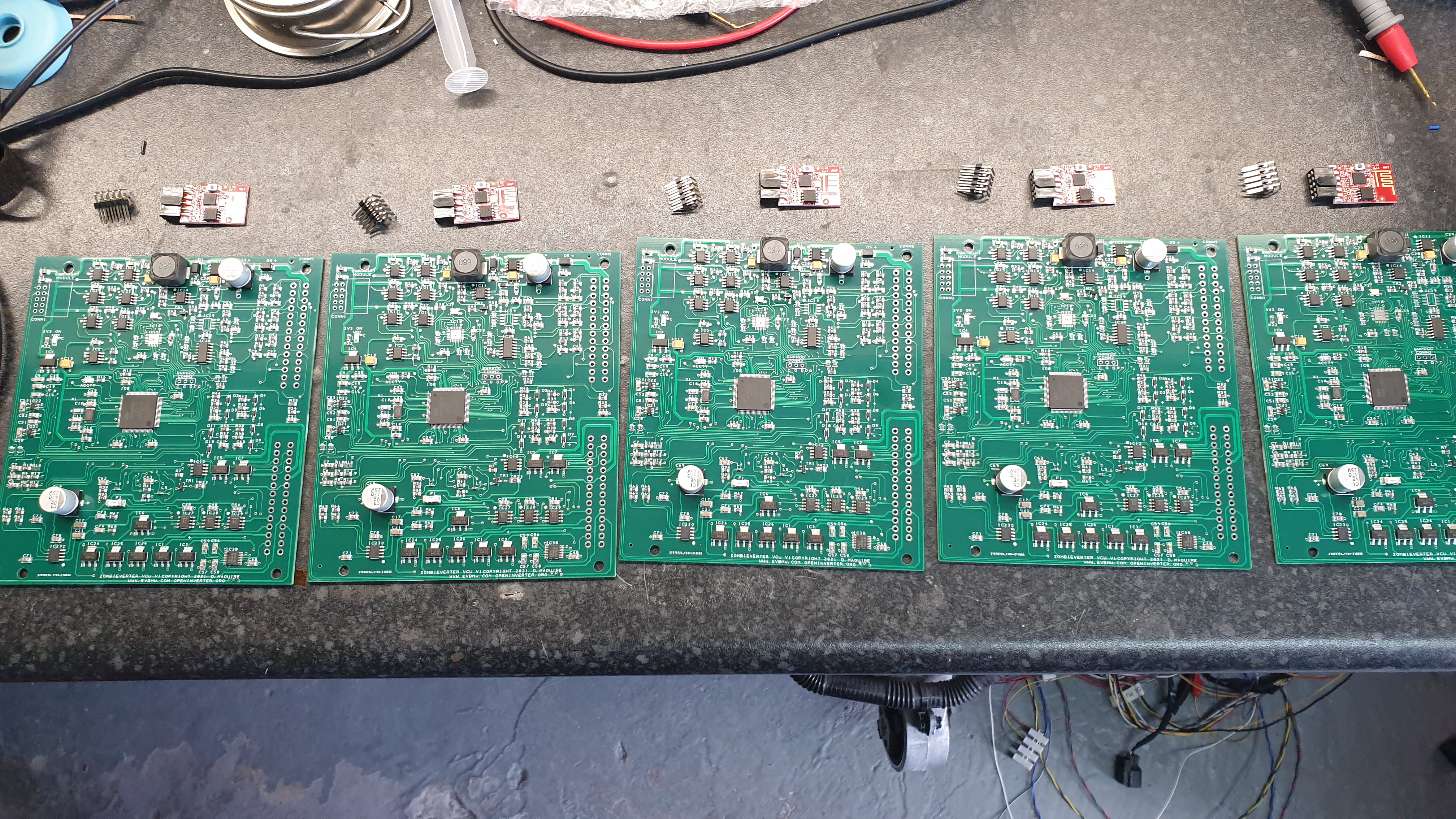

First batch of boards on their way to beta testers:)
Thanks, one just landed here, I will look at how the Toyota protocol will run on the giga device and see if the same approach from the stn32 will work or needs updates.

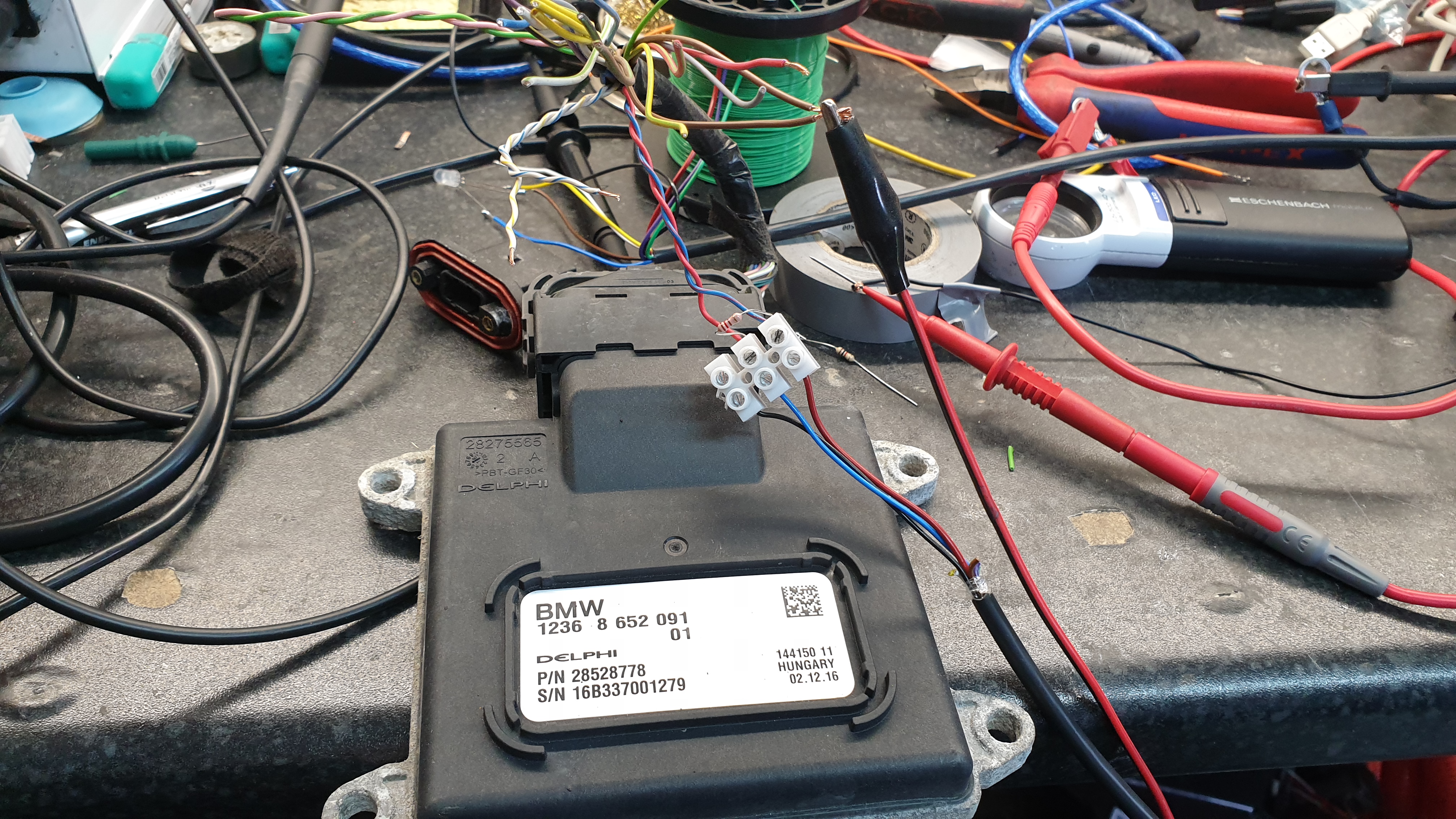

Little bit of overlap here from the i3 ccs thread. This is a BMW i3 EDME. Basically their version of a VCU that control the drivetrain, battery , cooling etc.
Here is the BMW blurb :
EDME: Electrical Digital Motor Electronics
The EDME control unit acts as the master control unit and coordinator for the primary functions of the drive control.
Before a drive torque is implemented, the EDME must be checked to see if the driving readiness has been produced.
The EDME queries if all the subsystems of the electrical drive control function trouble-free, which is a requirement for allocating the drive torque. The EDME control unit regards the available electrical power for the electric motor, which is primarily determined by the state of the high-voltage battery. Via the corresponding Bus telegrams, the SME control unit communicates the state to the EDME control unit.
As a result of these checks, the EDME determines if and in what scope the drive torque can be provided. In the event of fault states or restricted availability, the EDME outputs a Check Control message on the instrument cluster.
The EDME control unit is supplied with terminal 30B and terminal 15 wake-up.
The EDME control unit is connected to the data buses of the FlexRay, PT-CAN and PT-CAN2.
The following components are connected to the Electrical Digital Motor Electronics (EDME):
Accelerator pedal module
Intelligent battery sensor via the LIN bus
Front electric fan
Electric fan of engine compartment
2 temperature sensor in the rear engine compartment (for Range extender OE only)
Electric coolant pump
Radiator blind drive (active air-flap control) via LIN bus
Shutoff-capable expansion valve
The EDME control unit contains among other things the logic when the parking lock should be engaged or disengaged. Via the PT-CAN, the EDME control unit transmits the corresponding commands to the electrical machine electronics (EME).
It behaves similar with the drive positions "R" and "D". Here too, the EDME control unit calculates the function logic. The electrical machine electronics (EME) is responsible for the execution, to for example activate the electrical machine in accordance with reversing or drive.

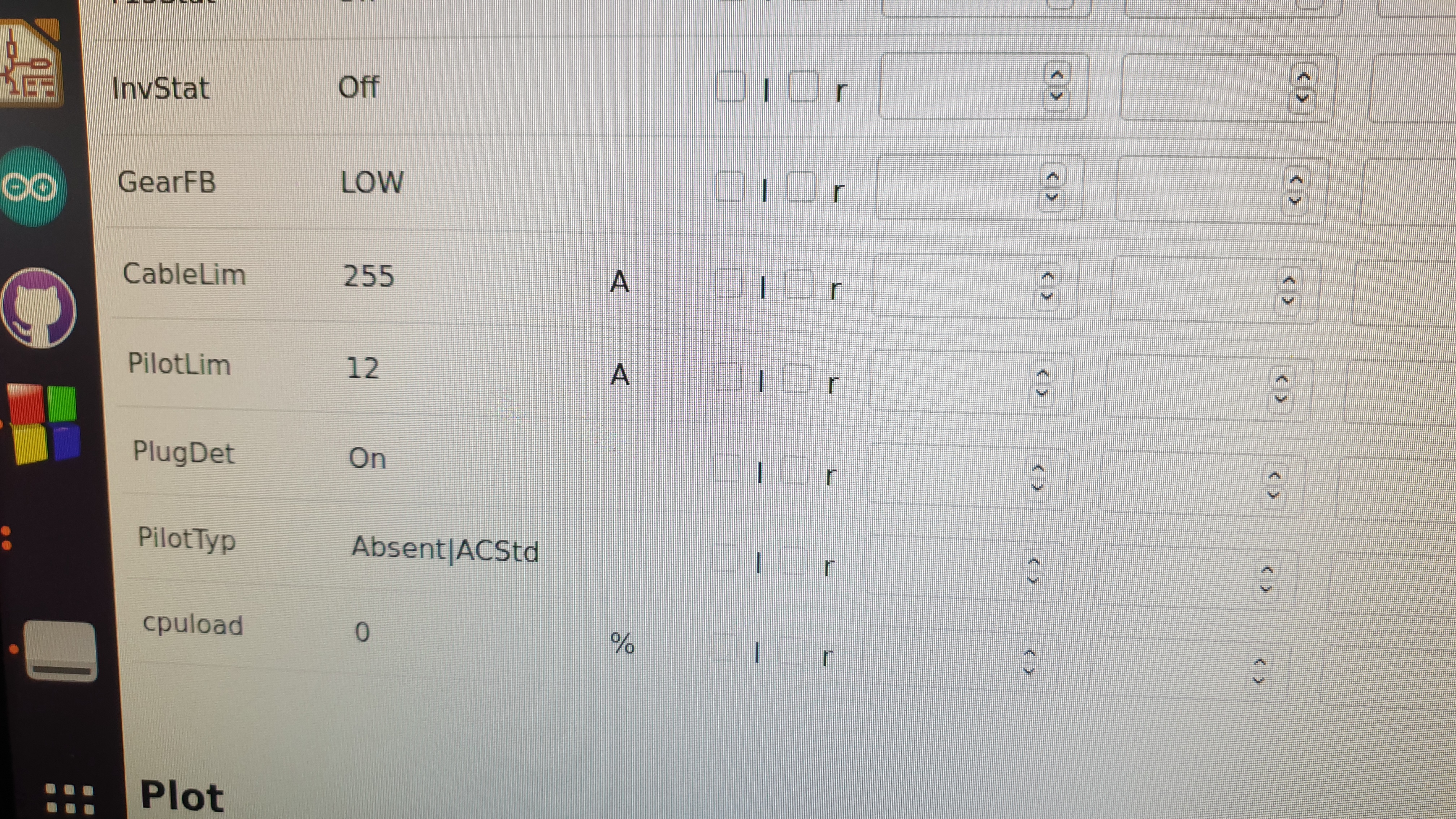

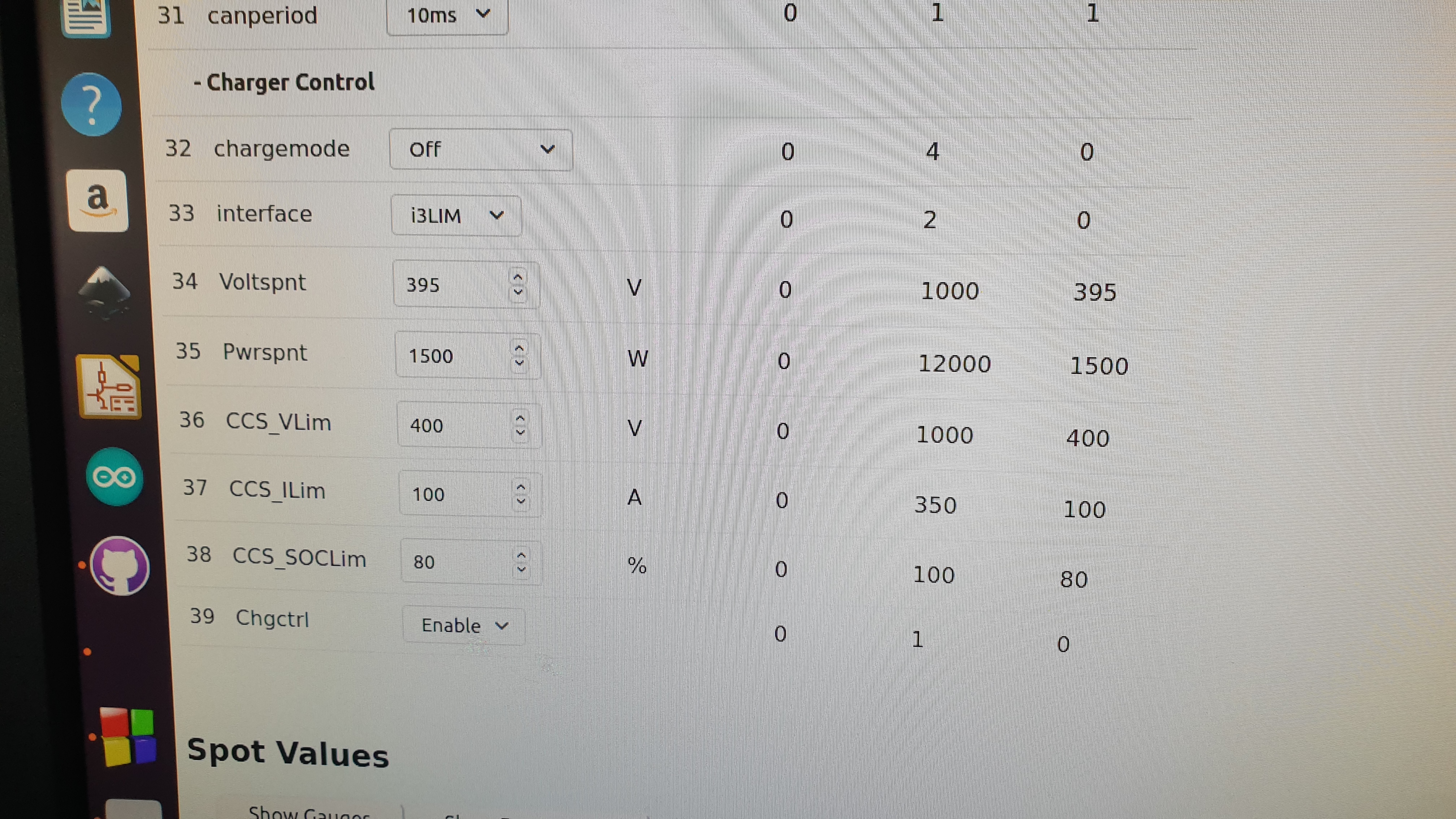

So,anyone interested in writing a LIM class for the VCU or just adding to the charger class?

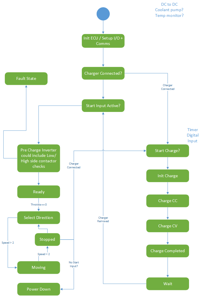

I wouldn't mind helping out, but i'm also thinking about how to make this generic for the various different chargers that people are using etc...
See attached my first attempt at drawing up a state diagram for the system including a charger.
