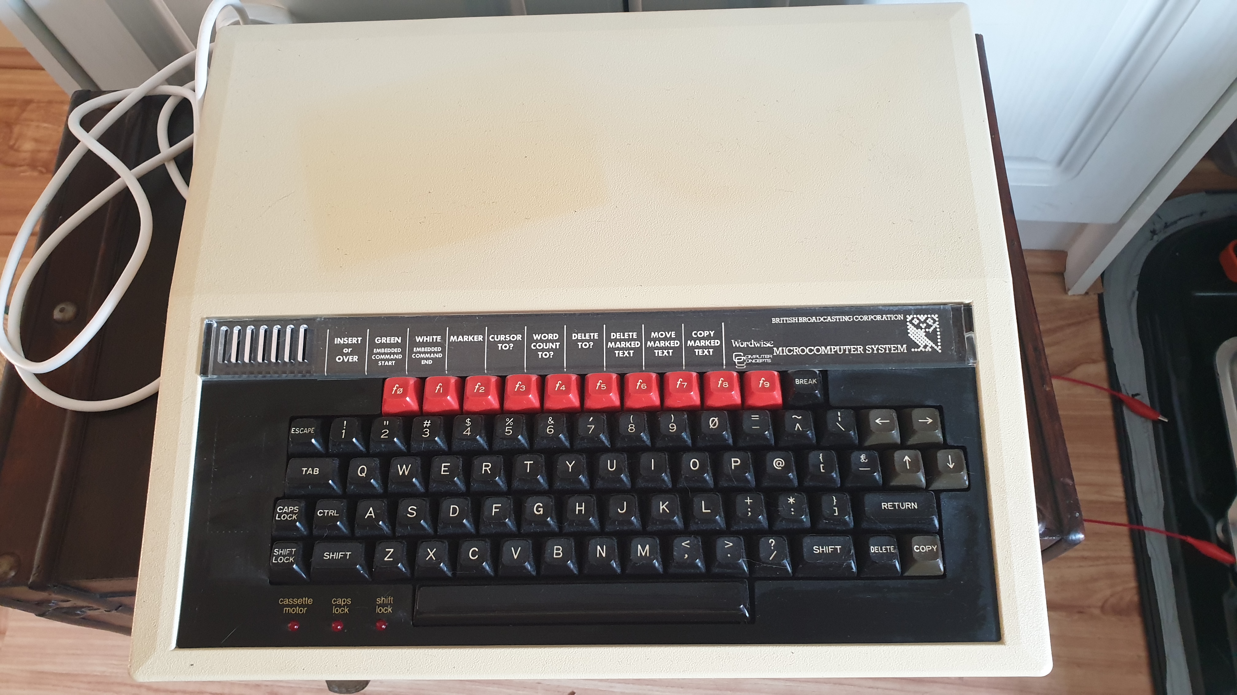

On the subject of Arm, bout time I fired this baby up:)
- Posts: 981
- Location: Northern Ireland
- Has thanked: 368 times
- Been thanked: 221 times
LOL, a very long time ago I repaired them for a local education board.Jack Bauer wrote: ↑Sun May 16, 2021 12:58 pm On the subject of Arm, bout time I fired this baby up:)
Unfortunately I was a bit rubbish at it. Mostly swapping chips to see what would happen.

Some auto repair shops just change parts that may get the car running, so business as usualAlibro wrote: ↑Sun May 16, 2021 4:30 pmLOL, a very long time ago I repaired them for a local education board.Jack Bauer wrote: ↑Sun May 16, 2021 12:58 pm On the subject of Arm, bout time I fired this baby up:)![]()
