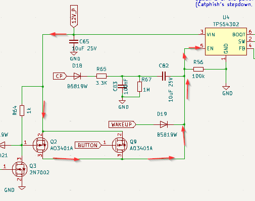

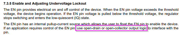

Found the reason for increased supply current: The enable pin of the steop-down is specified to be max 7V, and not intended to feed voltage into. When adding a 10k in series to the enable pin, the unexpected current is gone. Even better could be a diode.

Good thing you found it before I ordered the new batch. How hard is it to add the series resistor?
Diode would have to be Zener type. Diode to 5V rail would probably inhibit wake up

I think uhi22 meant a diode in series. No? To only allow current to flow out from the EN pin.

Adding the series resistor is just scratching some copper and wiring the resistor, this is no problem for the five parts on my desk.

Hmm, the wakeup is based around pulling the EN pin to 12V and basically overriding the internal pull-up with the external 100k pull down.
A cleaner solution would be a part with internal pull down and EN pin designed for 12V

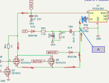

Yes, the idea with the diode is exactly this. The diode and the pull-down resistor provide the functionality "low by pull-down, and driving to 12V enables the regulator"
The point A is nearly 0V during sleep, because the ~2µA pull-up current inside the IC is not sufficient to over-rule the 100k+diode. When applying anything between 5V and 20V to the supply, the point A follows this, and the diode prevents feeding the 20V to the IC. The internal pull-up current of the TPS pulls the EN to high (no matter whether this is 2V, 5V or 7V). Everything fine.

Any proposal for a small footprint Schottky diode?
- Been thanked: 1913 times
Re: Develop a QCA7000 board?
This one is used already: https://jlcpcb.com/partdetail/9093-B5819WSL/C8598
This one is in the smaller SOT-323 https://jlcpcb.com/partdetail/Guangdong ... WS/C191023
- uhi22
- Posts: 1244
- Has thanked: 245 times
- Been thanked: 684 times
Thanks. Used the smaller one. Schematic and board updated (including the R52 and R64). Also fixed the rotation issues.

Added a 1 ohm shunt at the enable pin to measure the current, depending on the supply voltage.
supply voltage [V] | current [mA]
7 | 0
8 | 0.4
9 | 0.8
10 | 1.4
12 | 3.4
13 | 19.2
14 | 41
15 | 61 Hot, touch longer than one second hurts. No smoke yet.
Did not further increase to avoid damage.
I see these solution options:
(A) If the DCDC never provides more than 14V, just live with the small heat. (Most likely the DCDC will provide more than 14V.)
(B) If the sleep/wakeup is not needed, just remove the two transistors, the diode and the 100k pull-down. This leads to "always on".
(C) If sleep/wakeup is needed, just live with the heat and hope that the regulator will survive.
(D) If sleep/wakeup is needed, cut the copper to the enable pin, and solder a diode (or a 10k resistor like I did on the V5 boards).
I'd propose B or D, these are the technical clean solutions. For just experimenting also (C) is okay, but no long term recommendation.

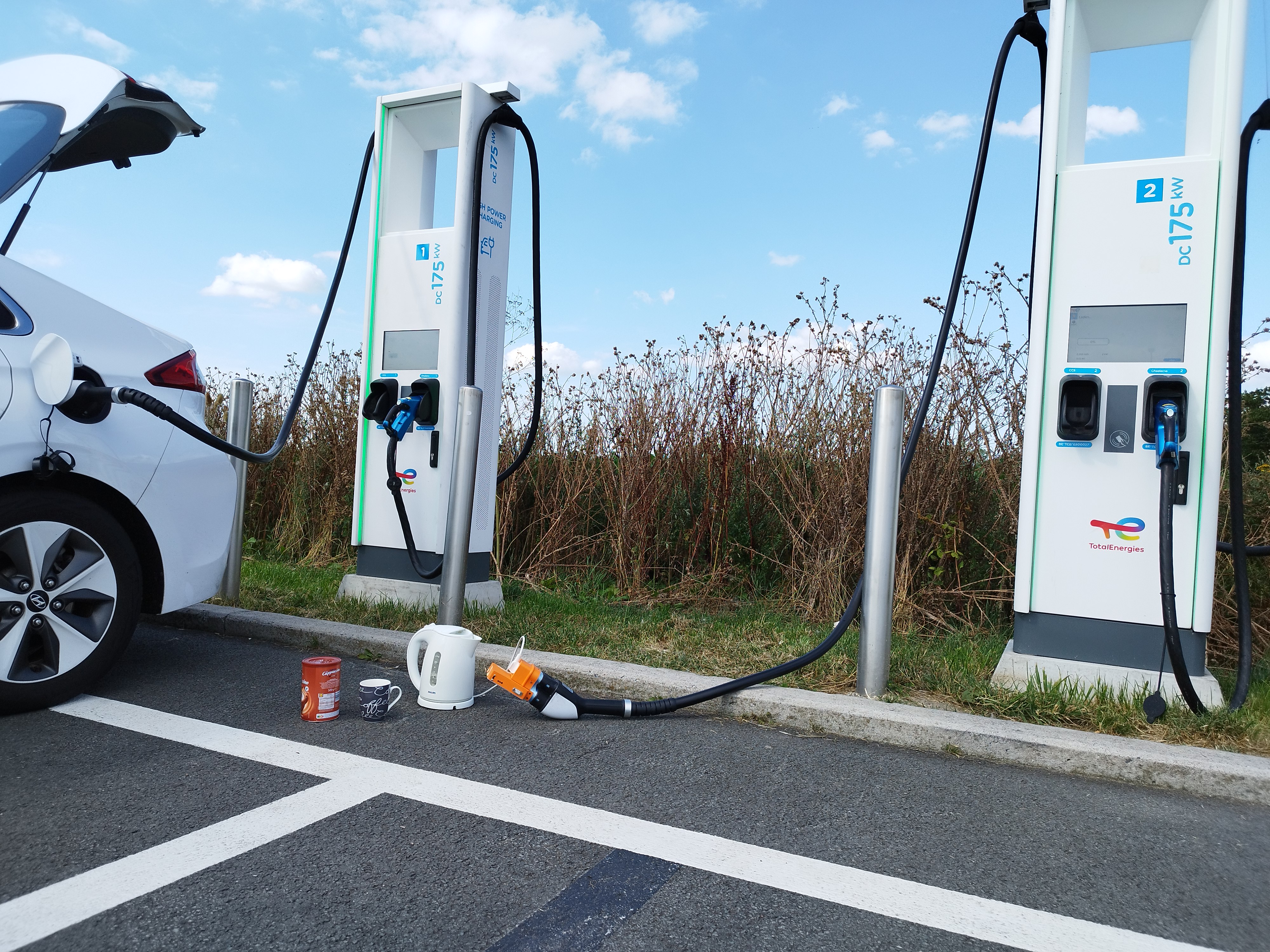

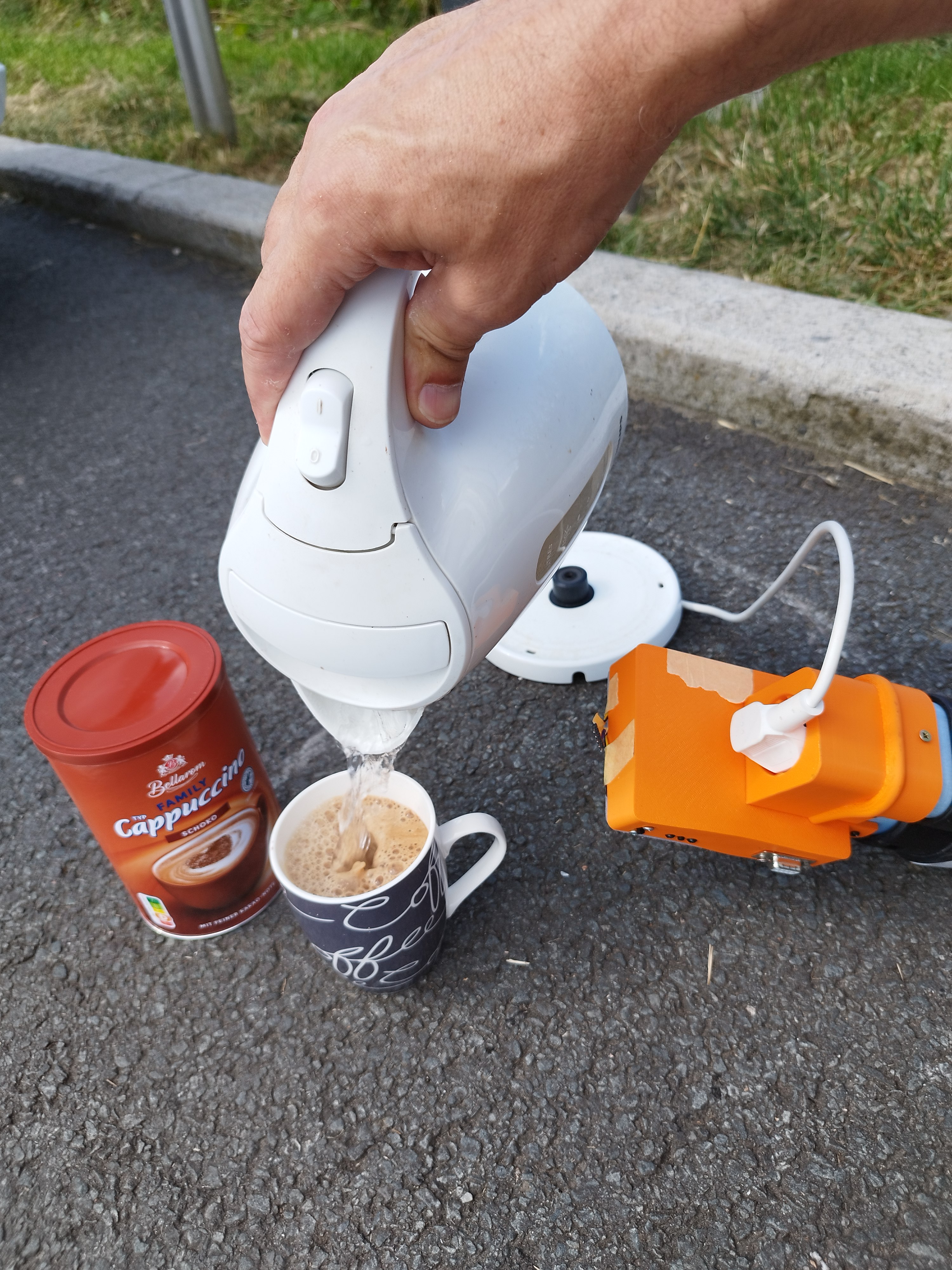

Why there are two chargers? Well, one for the Ioniq and one for the Cappuccino
Worked with the ABB, but did not for the Wilbert charger. Unfortunately no laptop for logging at hand.
