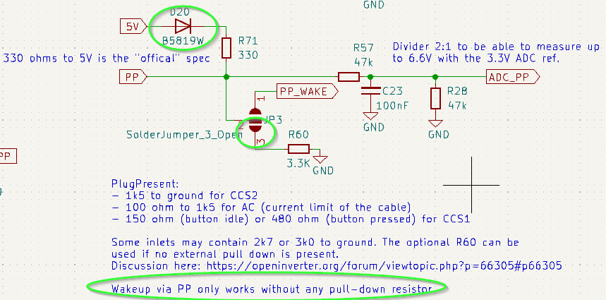

Another improvement: There was confusion regarding the PP variant. Now added a pick-list, which hopefully makes the selection easier.
The detailled check revealed, that the former conclusion "ppvariant=1 is fine for Foccci 4.5" is wrong. Because, as long as the solder bridge is not closed, there is NO pull down. So variant 2 is the right one. Updated the wiki regarding this. (And to be precise, in 4.5 there is the additional diode, which would need a small adaption in the calculation to be fully correct.)

And to be even more precise Johannes replaced the 3k pull down with a good enuff standard 3k3 😉
But yeah, precision isn't so important here as the cable current steps are far apart

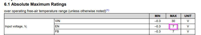

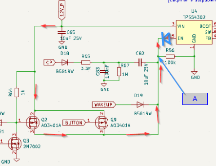

Found the reason for increased supply current: The enable pin of the steop-down is specified to be max 7V, and not intended to feed voltage into. When adding a 10k in series to the enable pin, the unexpected current is gone. Even better could be a diode.

Good thing you found it before I ordered the new batch. How hard is it to add the series resistor?
Diode would have to be Zener type. Diode to 5V rail would probably inhibit wake up

I think uhi22 meant a diode in series. No? To only allow current to flow out from the EN pin.

celeron55 wrote: Tue Jul 09, 2024 7:41 am I think uhi22 meant a diode in series. No? To only allow current to flow out from the EN pin.
Exactly.

Hmm, the wakeup is based around pulling the EN pin to 12V and basically overriding the internal pull-up with the external 100k pull down.
A cleaner solution would be a part with internal pull down and EN pin designed for 12V

Yes, the idea with the diode is exactly this. The diode and the pull-down resistor provide the functionality "low by pull-down, and driving to 12V enables the regulator"
The point A is nearly 0V during sleep, because the ~2µA pull-up current inside the IC is not sufficient to over-rule the 100k+diode. When applying anything between 5V and 20V to the supply, the point A follows this, and the diode prevents feeding the 20V to the IC. The internal pull-up current of the TPS pulls the EN to high (no matter whether this is 2V, 5V or 7V). Everything fine.
Been thanked: 1918 times
Re: Develop a QCA7000 board?
Now I get it, perfect!
Can you make the change?

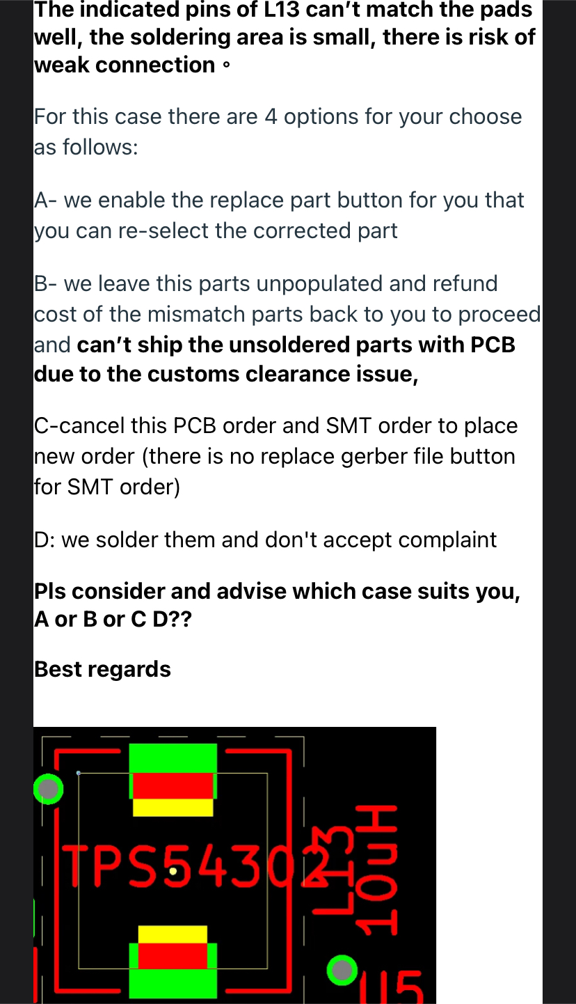

On a whim, I ordered 2 populated foccci’s yesterday (I am far from ready to seriously think about CCS - but the project is just too cool :) )
Anyway, FYI, JLCPCB was picky about the footprint of L13 - see image. They would have placed it, but “without right to complain”
I have not the means to make a pull request - zero skills in that regard - but thought it might be useful info, in case i got lucky and was the first to get that feedback from jlc …

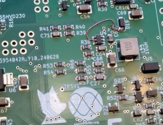

johu wrote: Wed Jul 10, 2024 7:11 pm Will the regulator overheat from this? How many mA go into the pin?
Added a 1 ohm shunt at the enable pin to measure the current, depending on the supply voltage.
supply voltage [V] | current [mA]
7 | 0
8 | 0.4
9 | 0.8
10 | 1.4
12 | 3.4
13 | 19.2
14 | 41
15 | 61 Hot, touch longer than one second hurts. No smoke yet.
Did not further increase to avoid damage.
I see these solution options:
(A) If the DCDC never provides more than 14V, just live with the small heat. (Most likely the DCDC will provide more than 14V.)
(B) If the sleep/wakeup is not needed, just remove the two transistors, the diode and the 100k pull-down. This leads to "always on".
(C) If sleep/wakeup is needed, just live with the heat and hope that the regulator will survive.
(D) If sleep/wakeup is needed, cut the copper to the enable pin, and solder a diode (or a 10k resistor like I did on the V5 boards).
I'd propose B or D, these are the technical clean solutions. For just experimenting also (C) is okay, but no long term recommendation.

Landsi wrote: Wed Jul 10, 2024 8:23 pm JLCPCB was picky about the footprint of L13 - see image. They would have placed it, but “without right to complain”
That's funny. I orderd the V5 two weeks ago, and there was no complaint at that time. I added the topic on the todo list.
