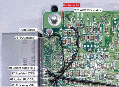

I have been thinking about your precharge relay/resistor issue.
Have you done this:
viewtopic.php?f=16&t=186&start=40#p6938
If not the IAA module could command the power steering and DC/DC to start and draw power before the HW aux relay has closed.
This will burn the precharge resistor after a while. (I burned mine this way)
This happens because the IAA module has almost immediate startup, much faster than the BMS!!
Now I start (ign. in) the IAA with the BMS relay output, and the IAA is closing the HV aux relay.
Have a look at the connections in Ranger_setup_new_8 - Schematic.pdf here:
viewtopic.php?f=16&t=186#p1869
I have done mods internal in the IAA module, then I don't have to route new outside wires.
I use pin 26 as the "new" IAA enable, and cut the outside wire from ignition pin 97. Also cut the "cut trace 26" and put a wire from "42 aux relay control" back to the "26 aux relay status" (this is so the IAA knows that the aux relay has closed)
NB! you don't need the diode at pin 26.

Hi joromy,
It's been a long time old friend. It's also exciting to see you have new fine-tuned parameters that I am anxious to try out.
When I finally got around to opening my contactor box about a month ago I found a blown up pre-charge resistor. The issue you mentioned here
viewtopic.php?f=16&t=186&start=25#p6725
and here
viewtopic.php?f=16&t=186&start=25#p6938
and more recently here
viewtopic.php?f=16&t=186&start=50#p11207
in which I believe this:
"IAA module could command the power steering and DC/DC to start and draw power before the HW aux relay has closed.
This happens because the IAA module has almost immediate startup, much faster than the BMS!!"
is what happened to my precharge resistor.
We may have never made the IAA mod you suggested but I will do so this time around before installing a another OEM contactor box to replace the blown up one.
Where are all the wires routed through the middle hole in the IAA board in this photo terminated? On the connector pins then routing back your BMS?
and here
