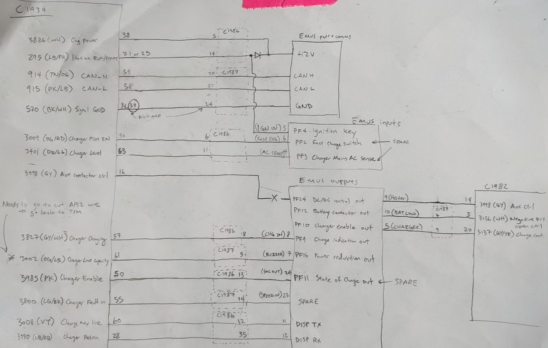

Complete diagram with Simp BMS, inverter, Tesla charger, battery, IAA and more.... updated 11-May-20:
Ranger_setup_new_8 - Schematic.pdf
(153.89 KiB) Downloaded 1262 times

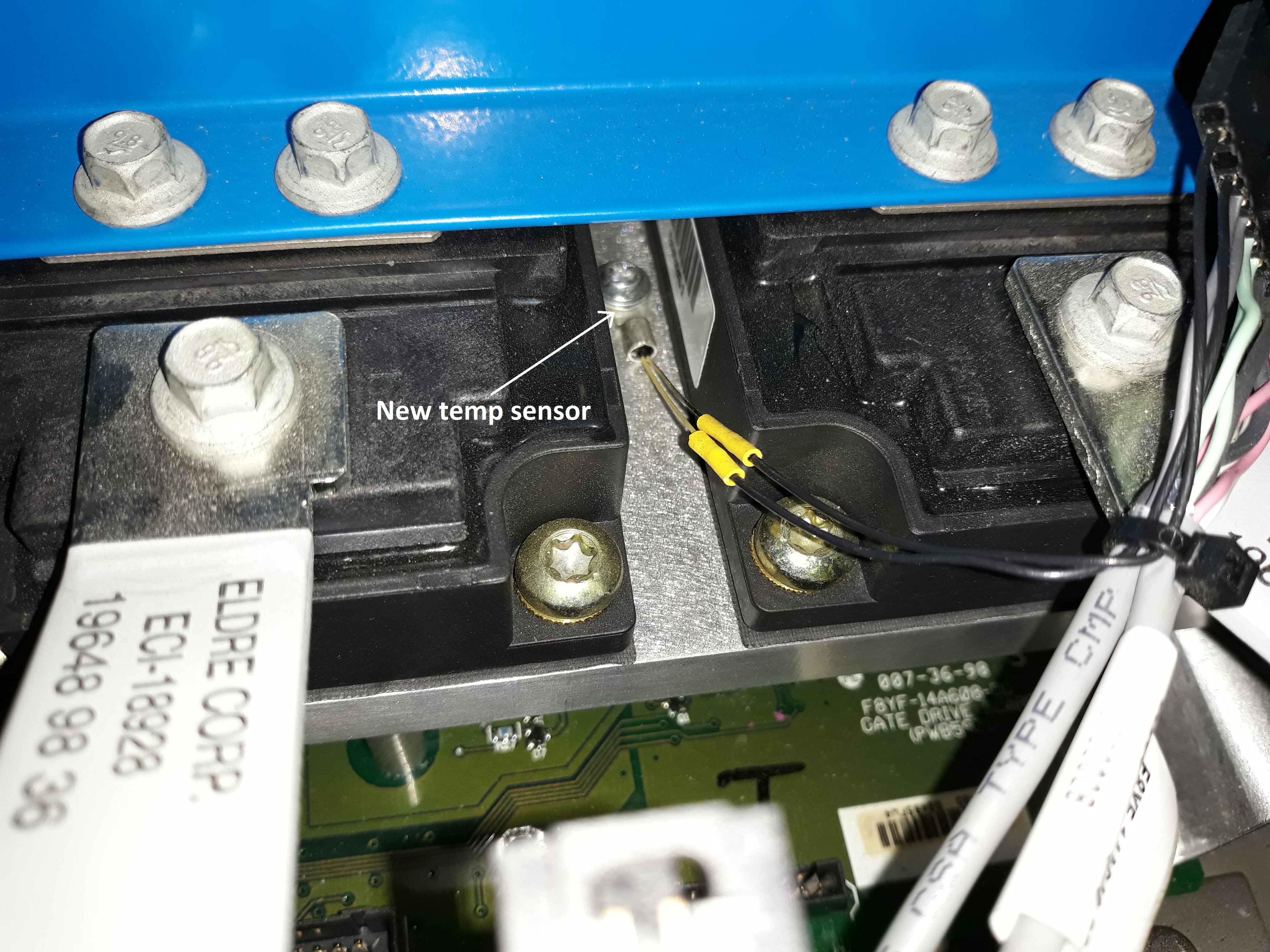

The motor temp sensor is KTY84, it's about 5C to high. Don't know why. But the temp sensors on the Ford (Siemens) motor often read to high temp. But the Ranger EV is 20 years now.
The temp sensor in the inverter must be changed, to the type you use. BTW what type is that, it is sealed and has a ring terminal. And does it have polarity, I see one lead has a fade orange color?
EDIT: It does not have polarity, its an NTC!
I will need to order some of them.
The only change is the PWM out, that goes to servo steering and speedometer. I dont know if this is a feature that is kept in newer versions?
Still using the version you made with speed PWM.
joromy
Posts: 371
Re: Ford Ranger Inverter board Support Thread
Post by joromy »

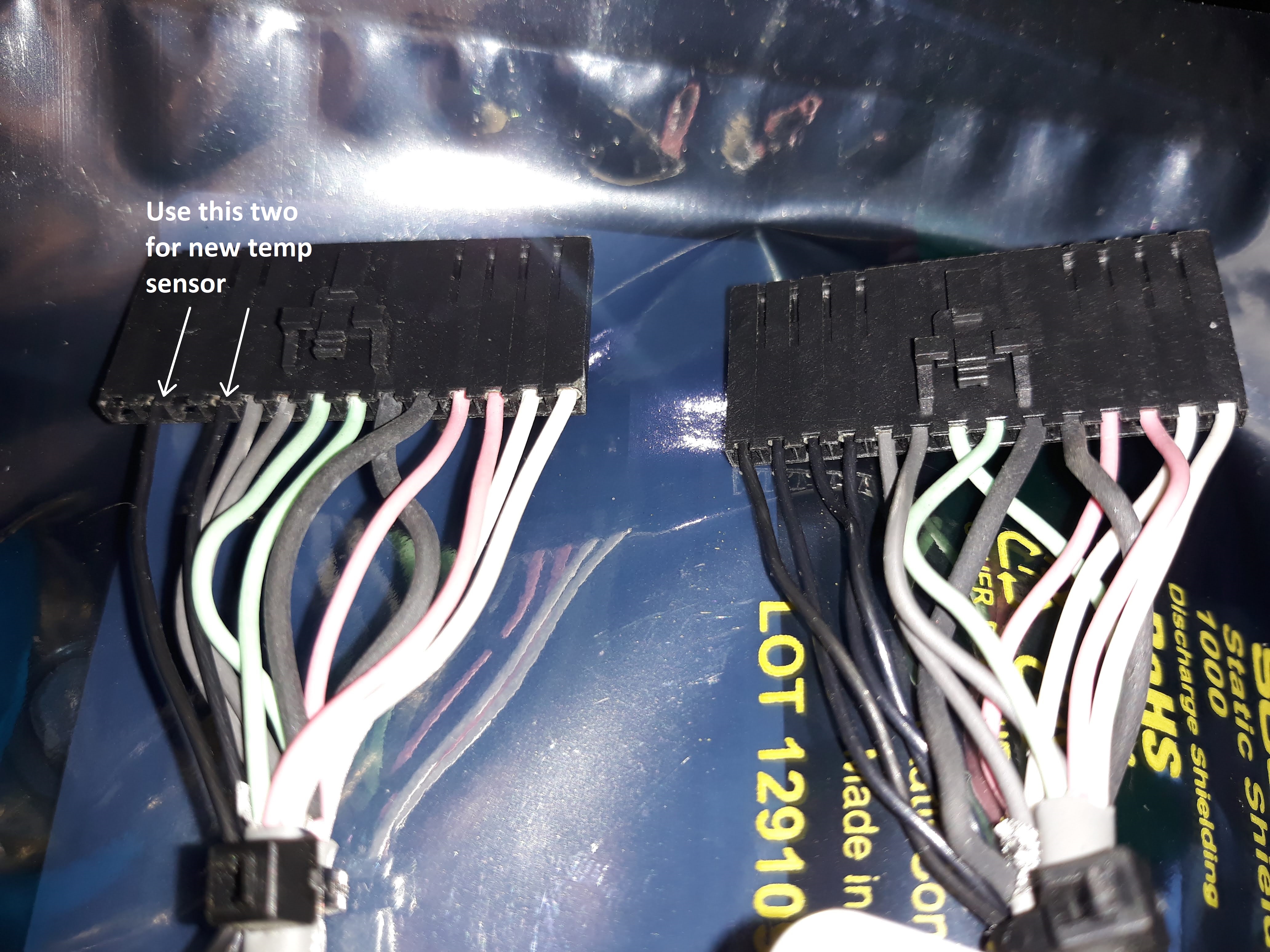

For next boards sent out, the temperature sensor is included!
You must remove old temperature sensors, use the two wires to solder on the new temperature sensor:
New sensor mounted:
Been thanked: 1913 times
The part number of the sensor is NTCALUG02A103G

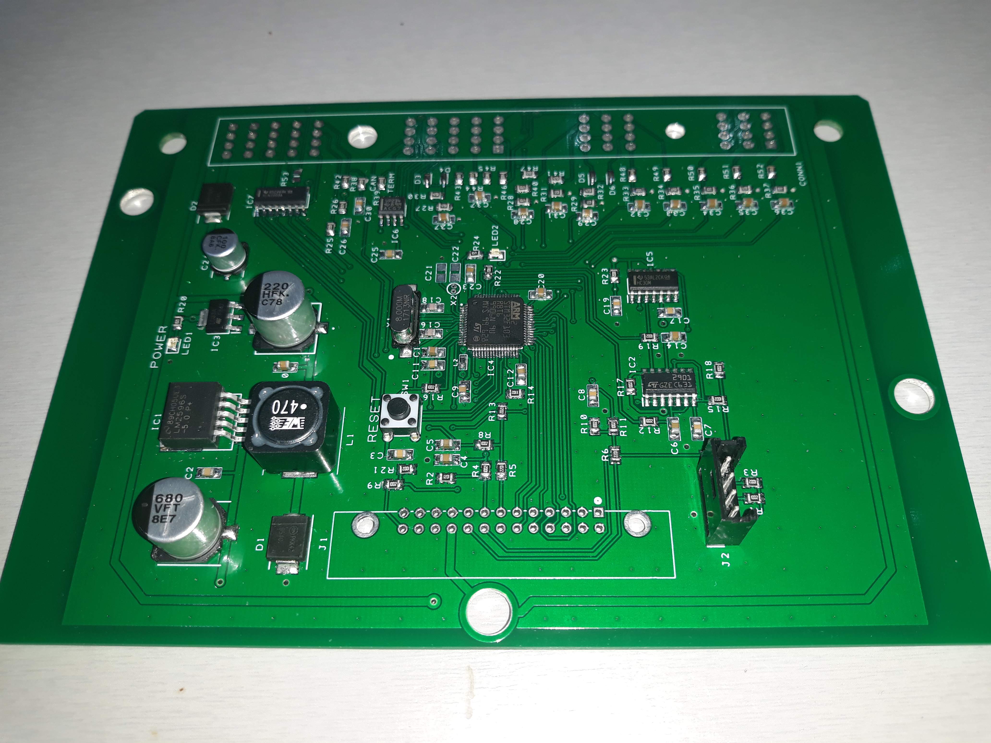

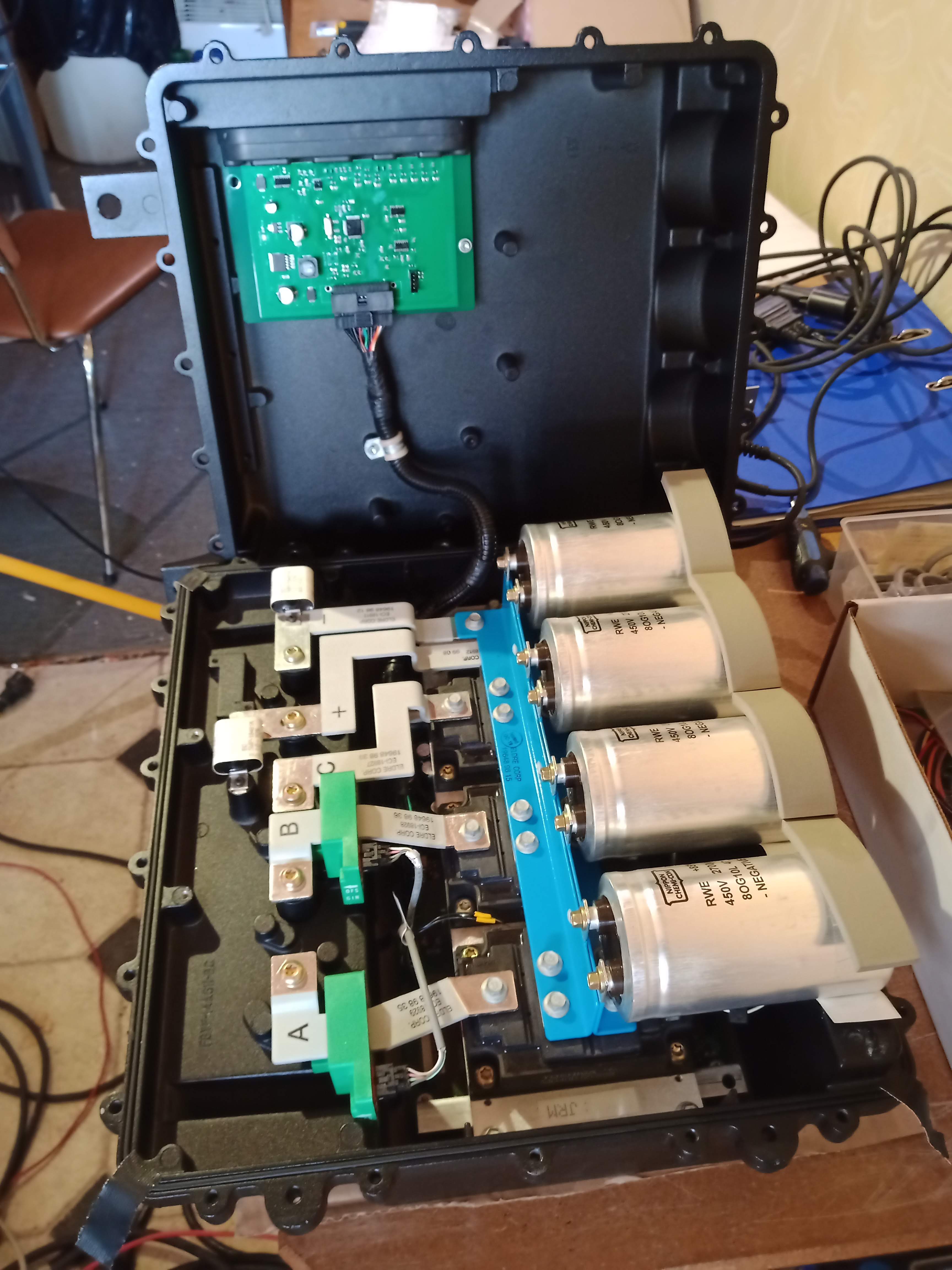

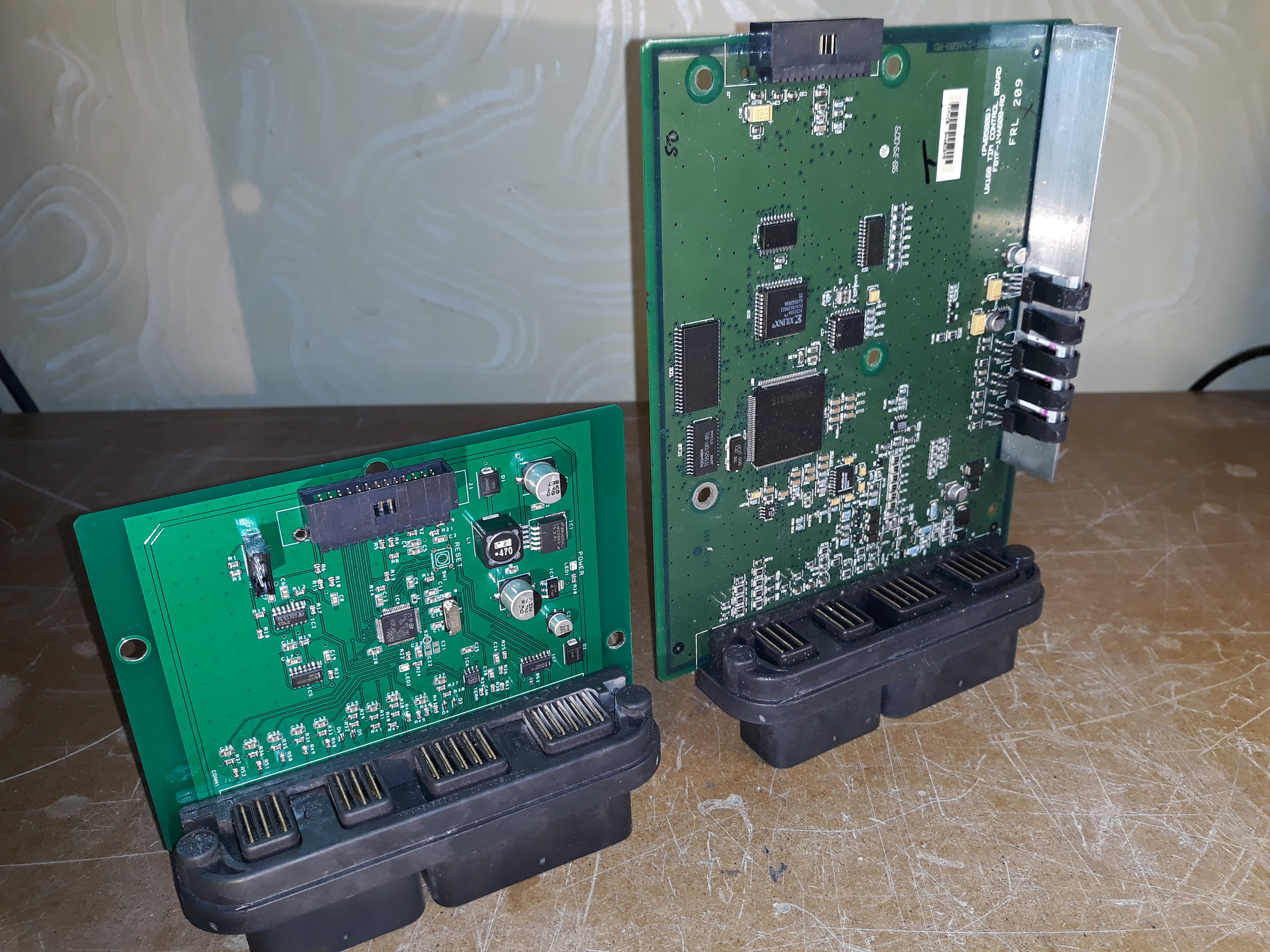

Mounting the new inverter brain board.
You must remove the cable clamp and mount it again.
Nice!!!

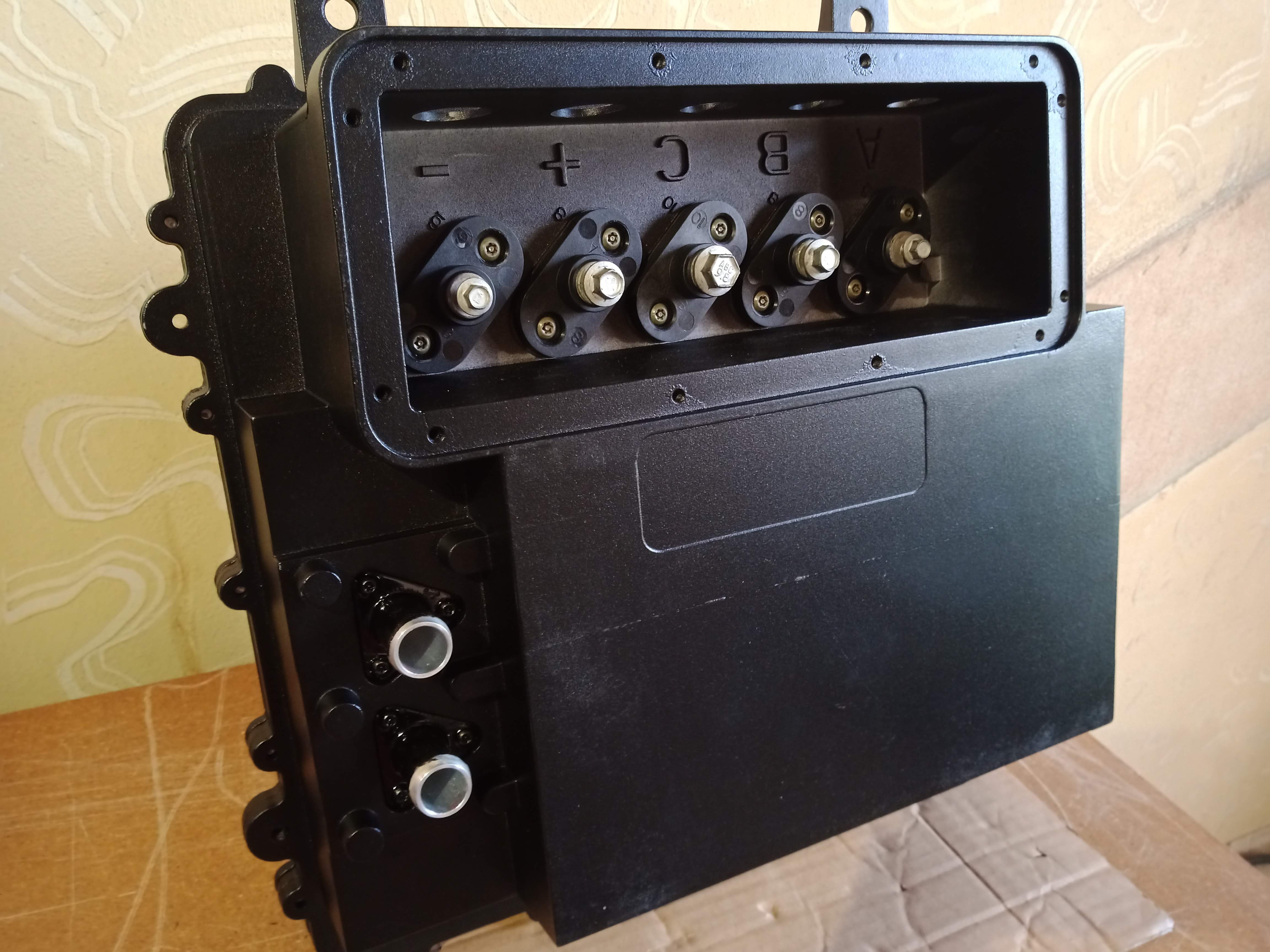

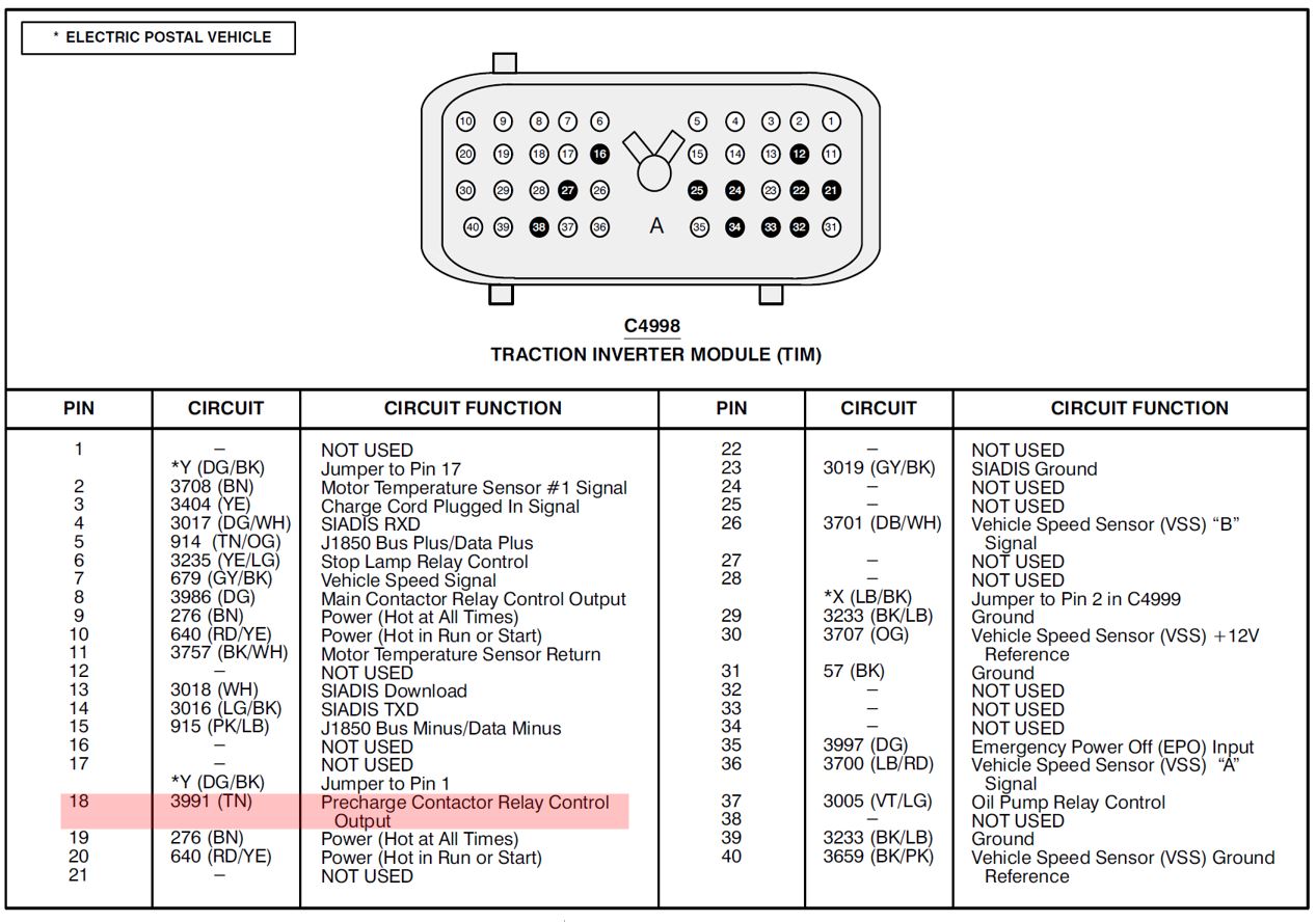

Reuse of the TIM connector
This is one of the most challenging task, with building the inverter.

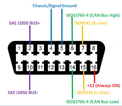

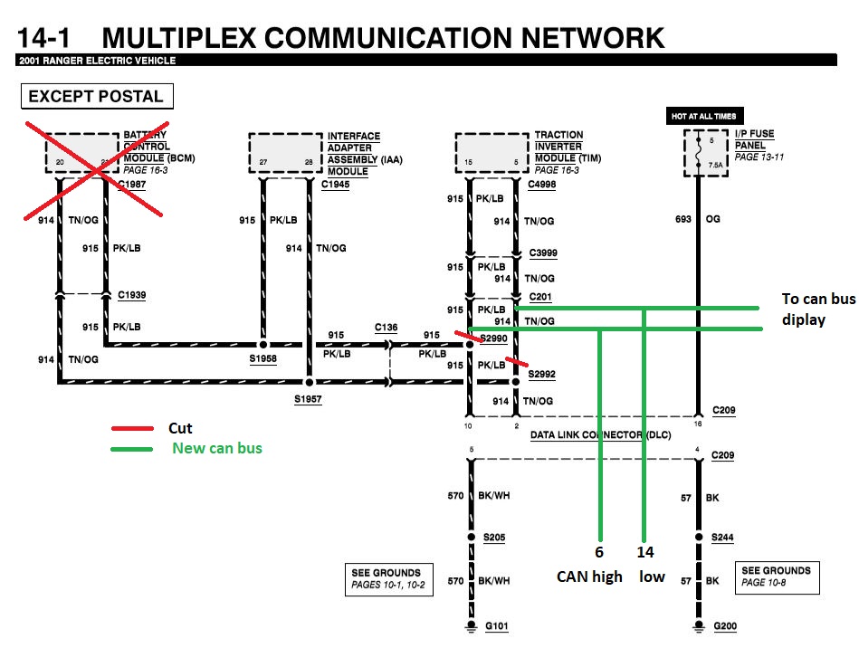

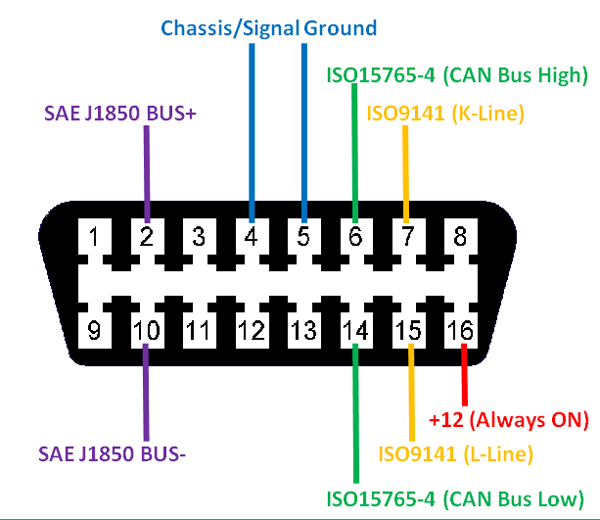

Mod J1850 bus to CAN bus.
Cut the J1850 wires, connector C136 (big 40 pin just over the parking brake pedal)
and connect to OBD and CAN bus display.
If you cut it here you can access/diagnose IAA module from the OBD (DLC) port and from your new BMS.

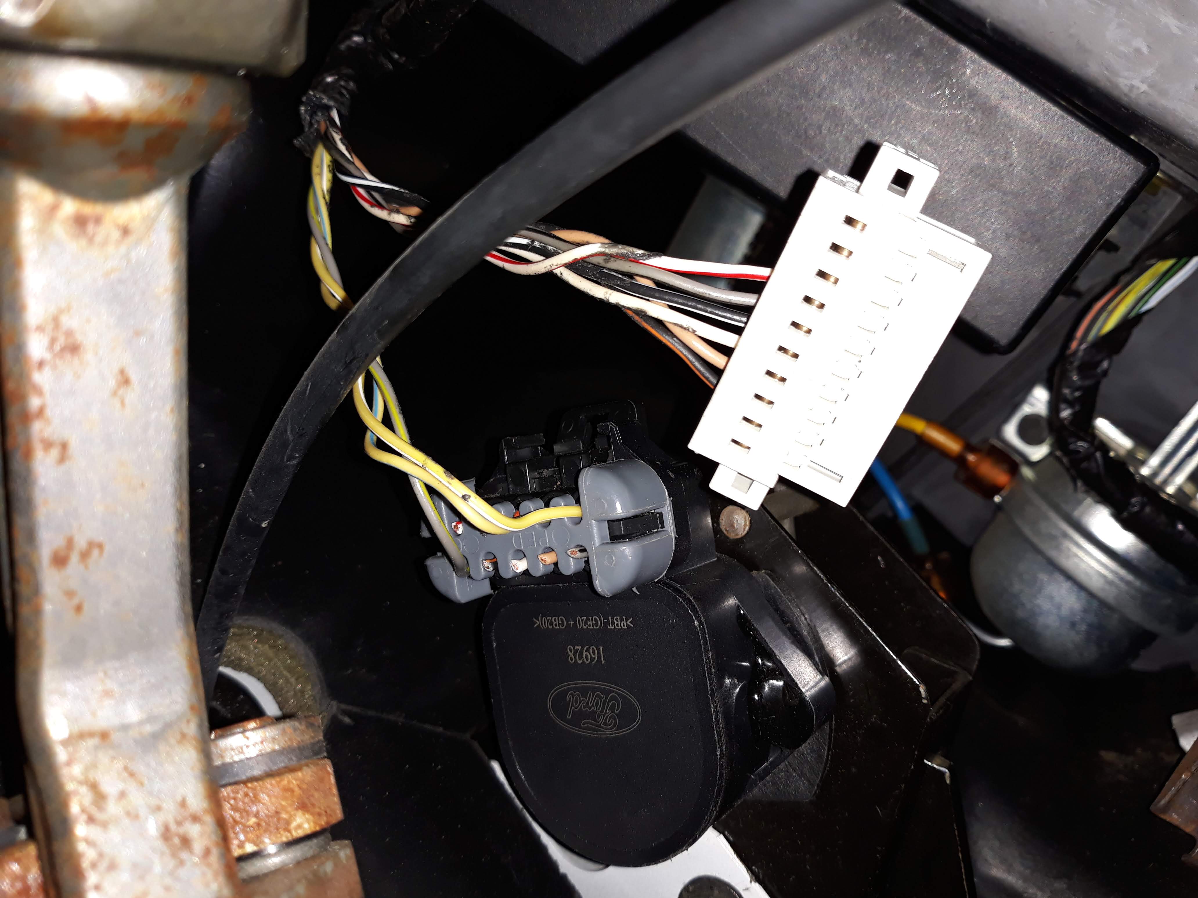

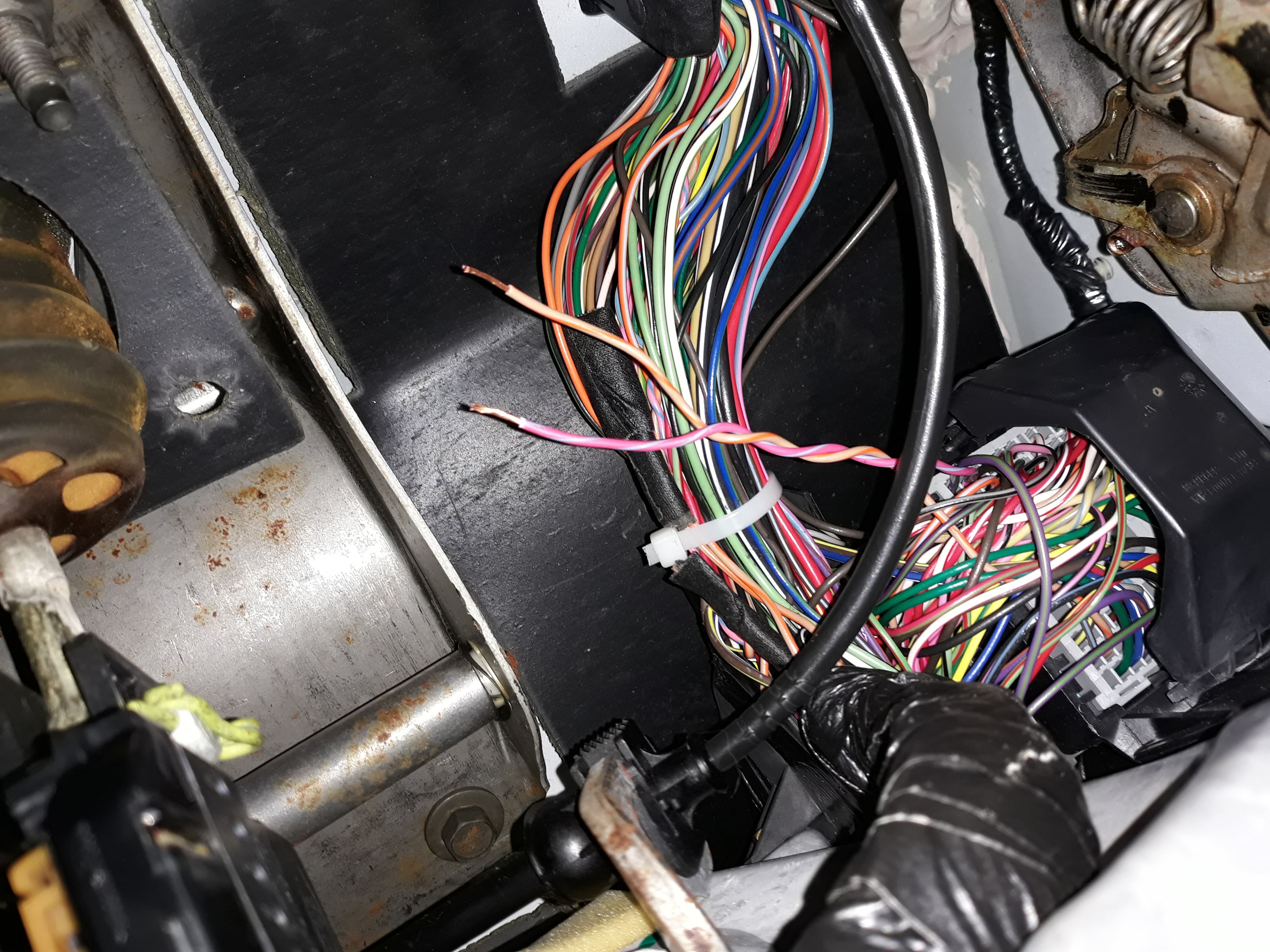

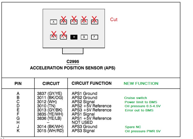

Mod to the accelerator.
The new TIM only use one pot for the accelerator.
This way you can use the other wires for the new functions, no need to route new wires.
These wires go directly from TIM to C2995 and are easily accessed.
Edit: "Power limit to BMS" is actually "Power limit from the BMS", to set the inverter in low amp draw/regen.

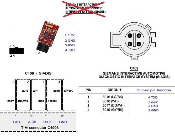

Using wifi interface:
pin 4 and 14
pin 13 and 23 is 3.3V GND
I guess you are testing it on the bench, or have you mounted it inside the TIM?
When mounted in the truck, the wifi is plugged into the "SIADIS" connector (was used for diagnostic/programming on the original TIM)
Will take a picture of the "SIADIS" plug
joromy
Posts: 371
Post by joromy »

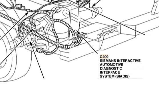

Connecting the olimex wifi module.
Connector C409 has a dummy plug, use a plug salvaged from the battery box, and connect like this:
Save the dummy plug, for water protection.
Connector C409 is placed on cable coming from the TIM connector C4998
joromy
Posts: 371
Post by joromy »
riii wrote: Wed Oct 09, 2019 1:13 am Looks like you're using the wifi interface on the browser. I bought an Olimex MOD-wifi-ESP8266, and that might be easier to use. Which pins on the board should that pug into? Does the wifi interface need tot be configured before hand?
If you got it from the openiverter shop, it's already programmed.
If not you must do like this:
viewtopic.php?f=5&t=8

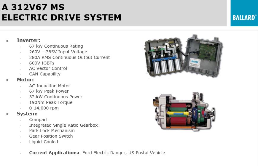

ajbessinger wrote: Tue Jan 21, 2020 6:24 pm But with the BCM removed could I run a 96s (390-400v) pack without running into issues? Or some the components not set up to take that kind of voltage?
Hi, and welcome!!
According to Siemens specs (Ballard) it can handle up to 385V.
The IGBT's are 600V and the capasitors are 450V

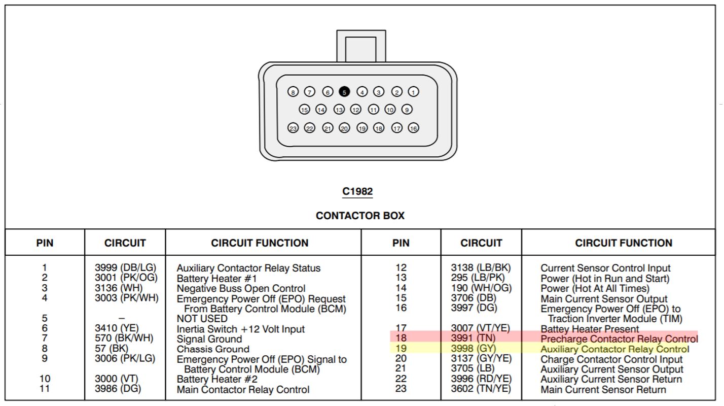

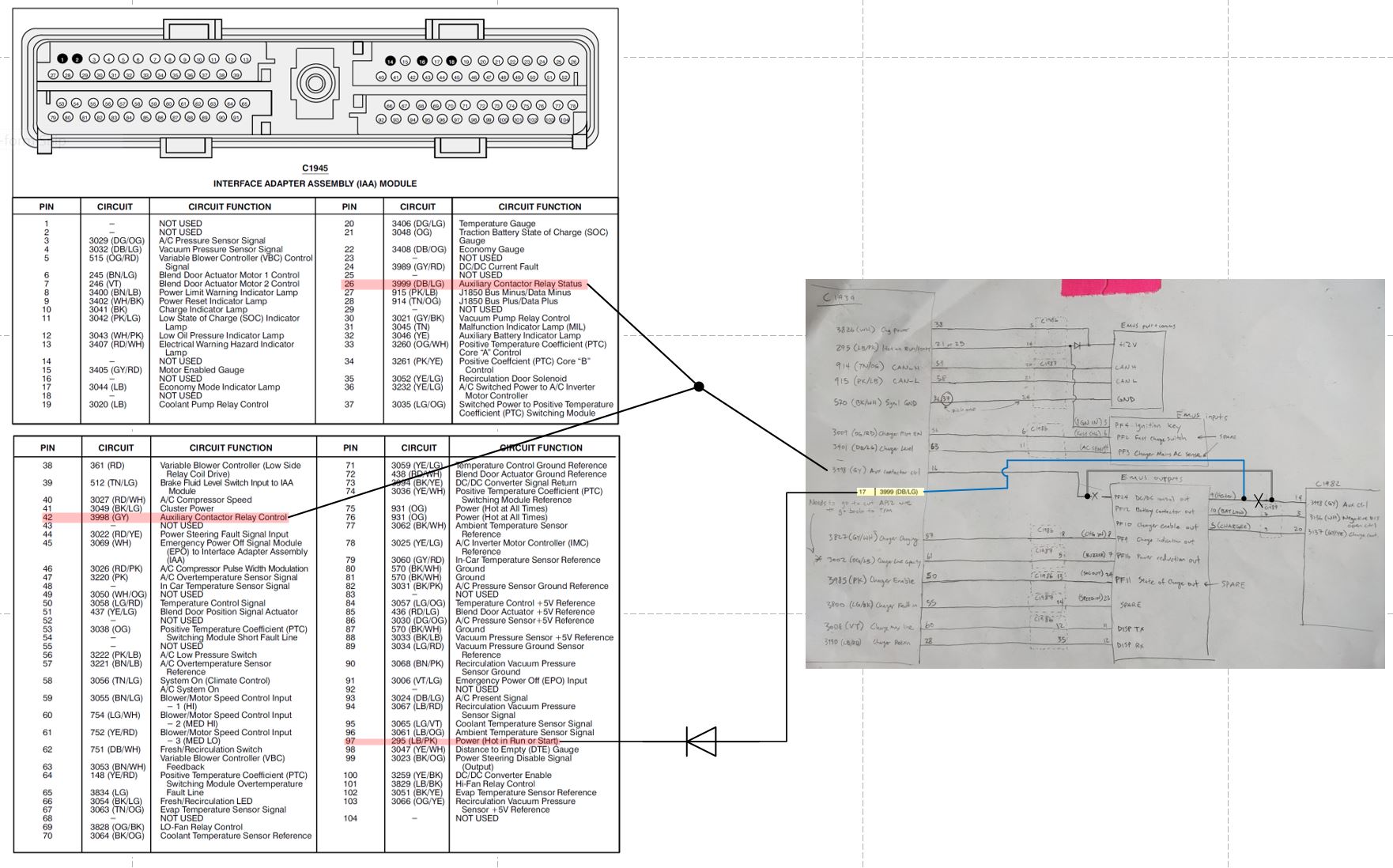

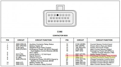

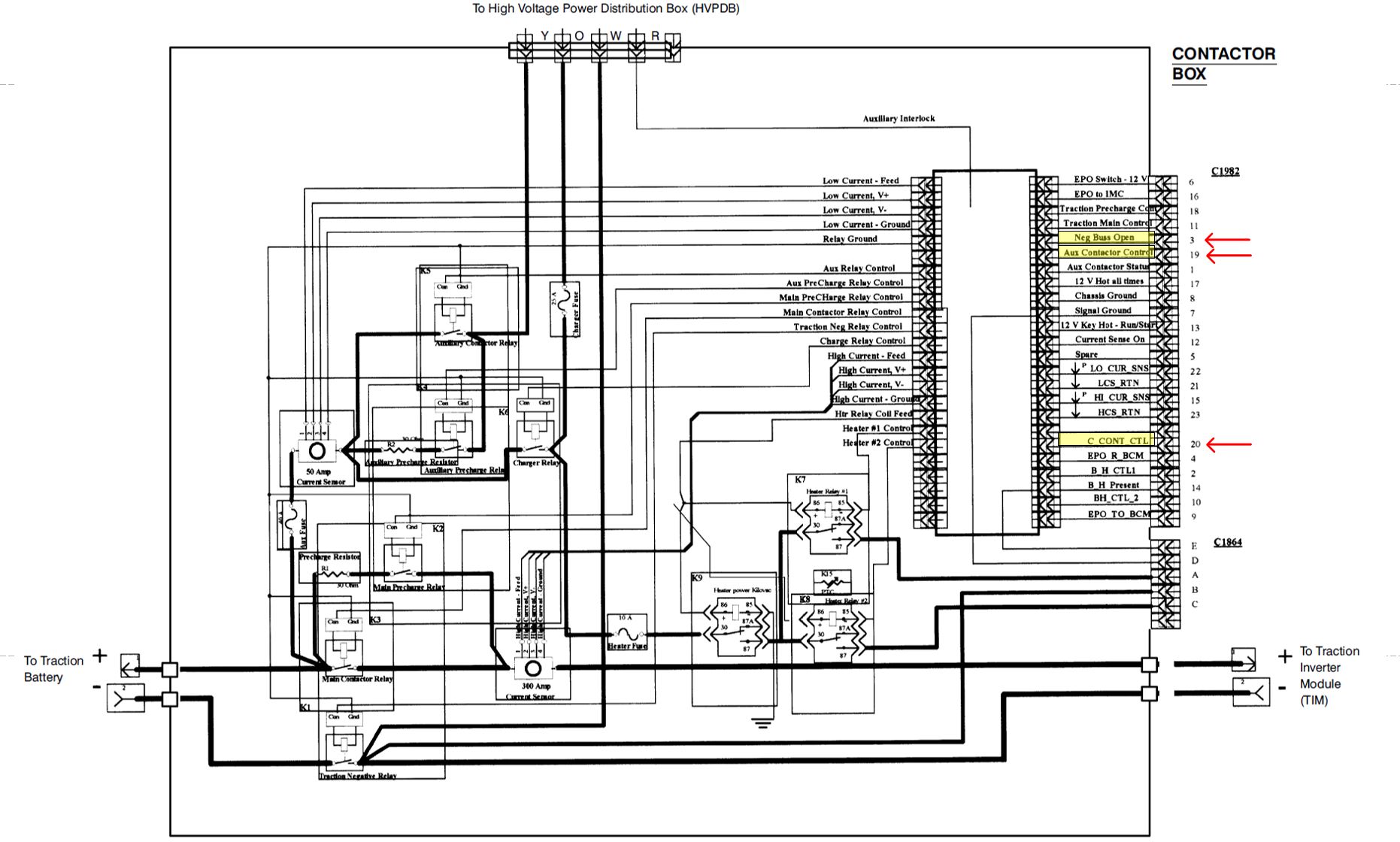

Cut one wire going to the gear shift switch, use for 5V to the oil pressure sensor.

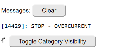

We are getting a HW over current error after ignition is started and the brake is released.
Do we actually need more amperage? Any other suggestions?
Thanks kindly,
riii
Posts: 21
Joined: Tue Jul 30, 2019 2:18 am
Location: Oakland California USA
Post by riii »

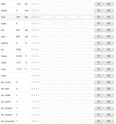

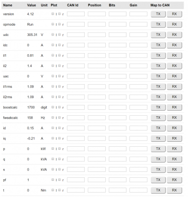

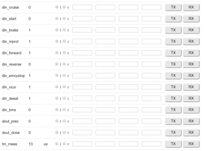

Hi Johannes,

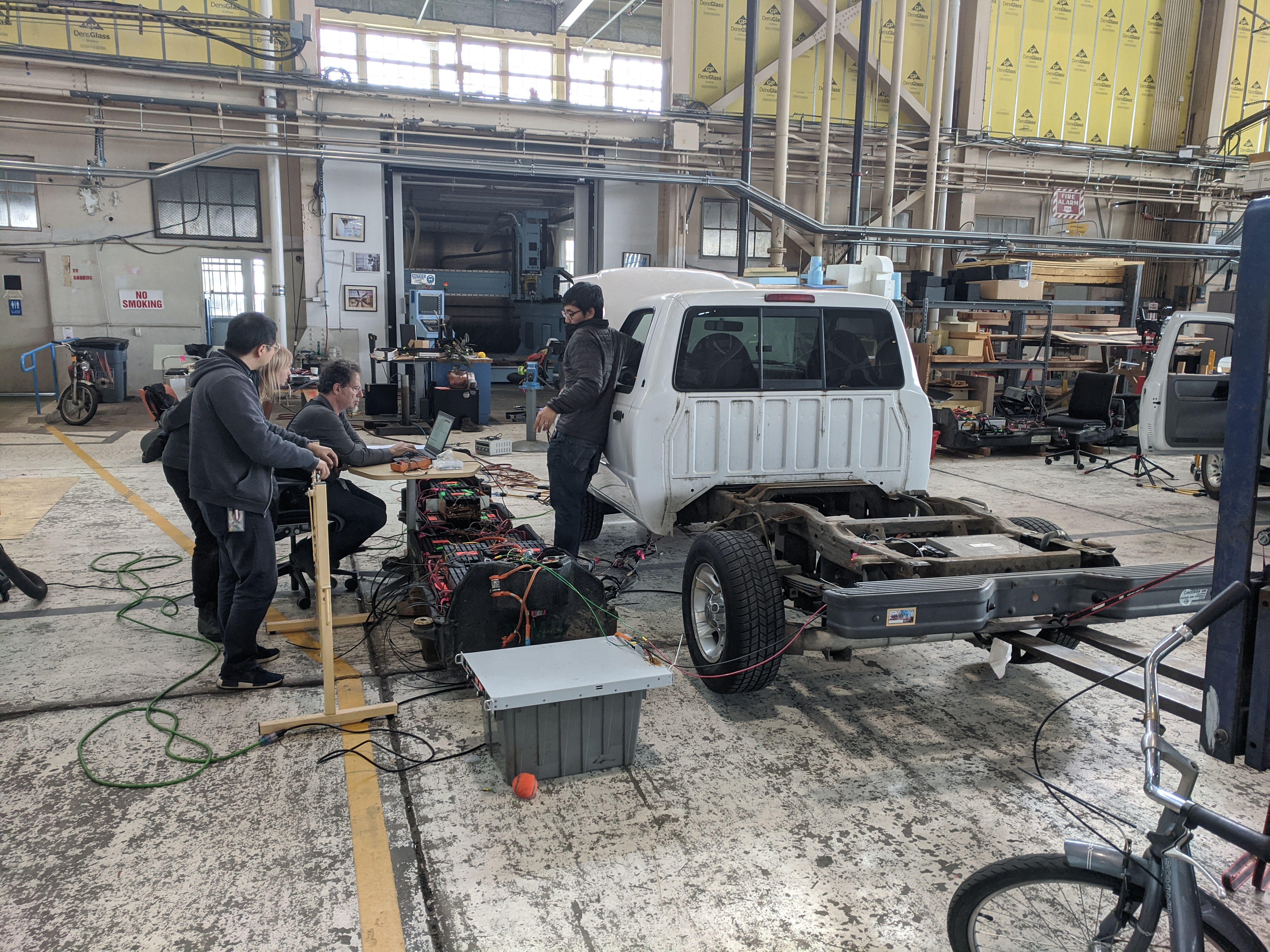

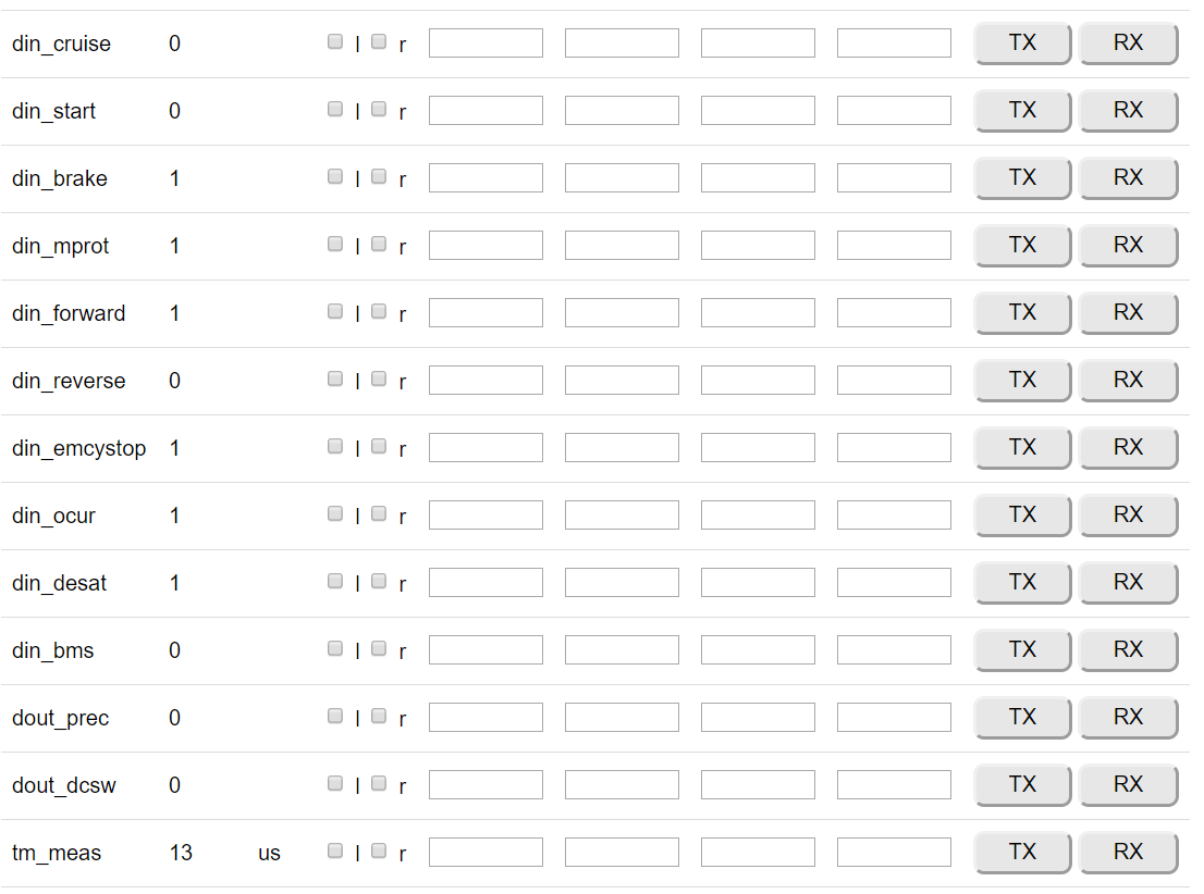

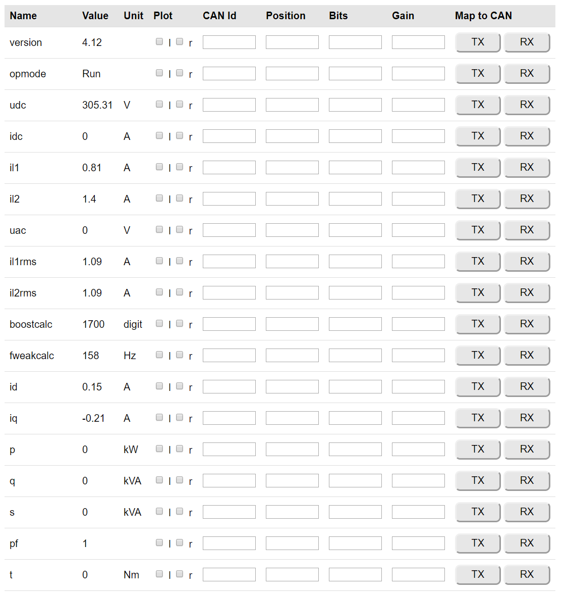

Just wanted to add some details about our setup and the problem we're having:
- We've modified the ranger's contact box and verified that the TIM can control all the relays properly. Our power supply is connected to the contactor box and we've tried up to 300V limited at up to 1.5A. The TIM is able to successfully precharge. If we switch ignition to "start", the TIM will go into the "RUN" opmode and close the main DC contactor.
- With the brake depressed, we can shift into drive and see that the inverter begins switching and delivering some current to the motor. This was visible in the web interface and we verified using current meters on an oscilloscope (the 8.8kHz switching frequency was visible).
- As soon as we let go of the brake, the TIM will error out and open the DC contactors. The error is hardware overcurrent. Oscilloscope shows that switching stops suddenly, with no spikes in motor AC current or DC current to inverter.
- Both trucks are experiencing the same issue.

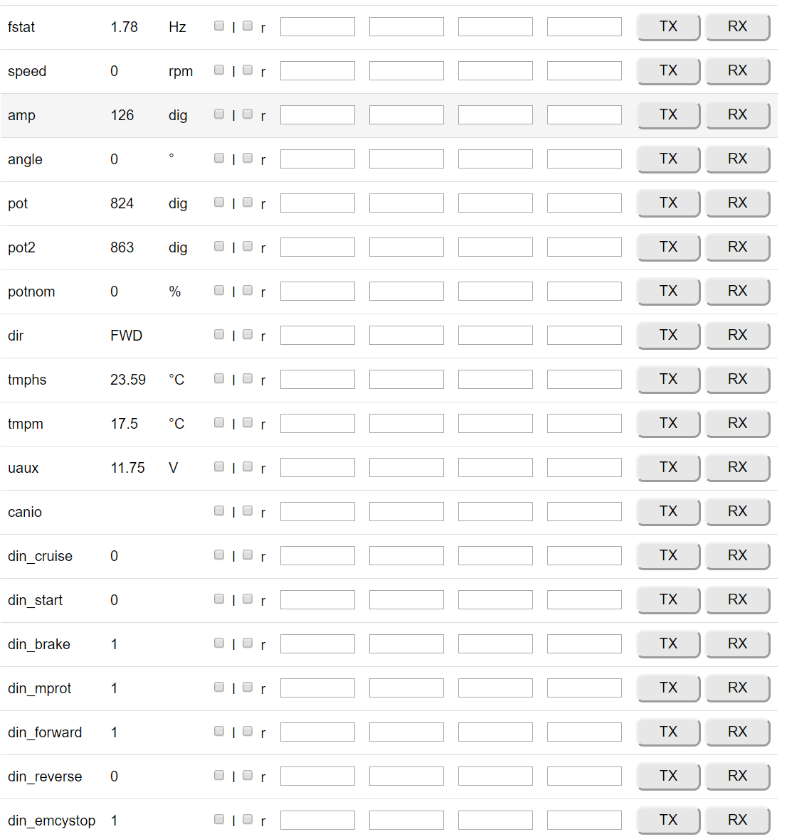

TIM telemetry notes (web interface screenshots attached):
- DC voltage measurement is working.
- Motor speed sensor is working.
- pot measures accelerator pedal correctly (ranges from ~830 at minimum to ~3600 at maximum).
- pot2 measures brake pressure correctly. Your documentation specifies pot2min and pot2max to both be 4095. Should we change this to reflect the actual min and max values?
- "dir" indicator reflects gear selector position accurately (NEUTRAL, FWD, or REV).
- tmphs reads inverter temperature correctly.
- "tmpm" reads motor temperature correctly.
- "din_brake" is 1 when brake is depressed, 0 if not
- "dout_prec" and "dout_dcsw" always seem to show 0 even though the contactors are being controlled correctly.
Additionally the motor oil pump doesn't seem to be running. As I understand, the oil pump relay is controlled by the same signal that controls the main contactor, which is working. Is there a harness or other modification we need to make for the oil pump to run?
Thanks,
-Johnny
