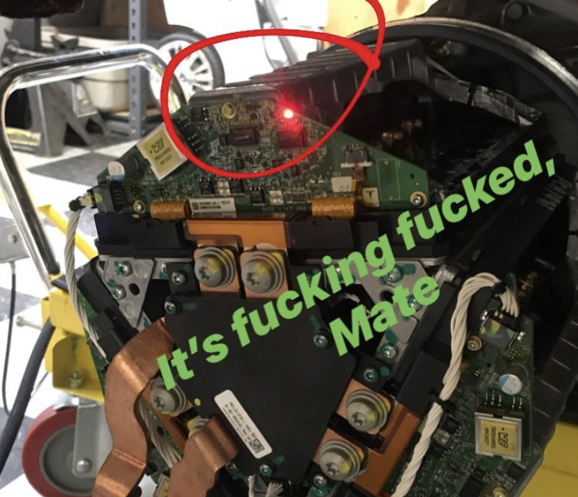

- Posts: 6968
- Has thanked: 454 times
- Been thanked: 1771 times
Yes the LDU board is not very precise in what caused the error. So actual over current as detected by the comparator is thrown into one pot with desat errors from the gate drivers. I reckon the gate driver detects the shorted IGBT and throws the error
There’s a light on each Tesla phase gate driver board that will illuminate during a desat fault. That’ll tell you for sure it’s a hardware issue. I don’t have a photo immediately handy.
EDIT. Found my old pic from Instagram.

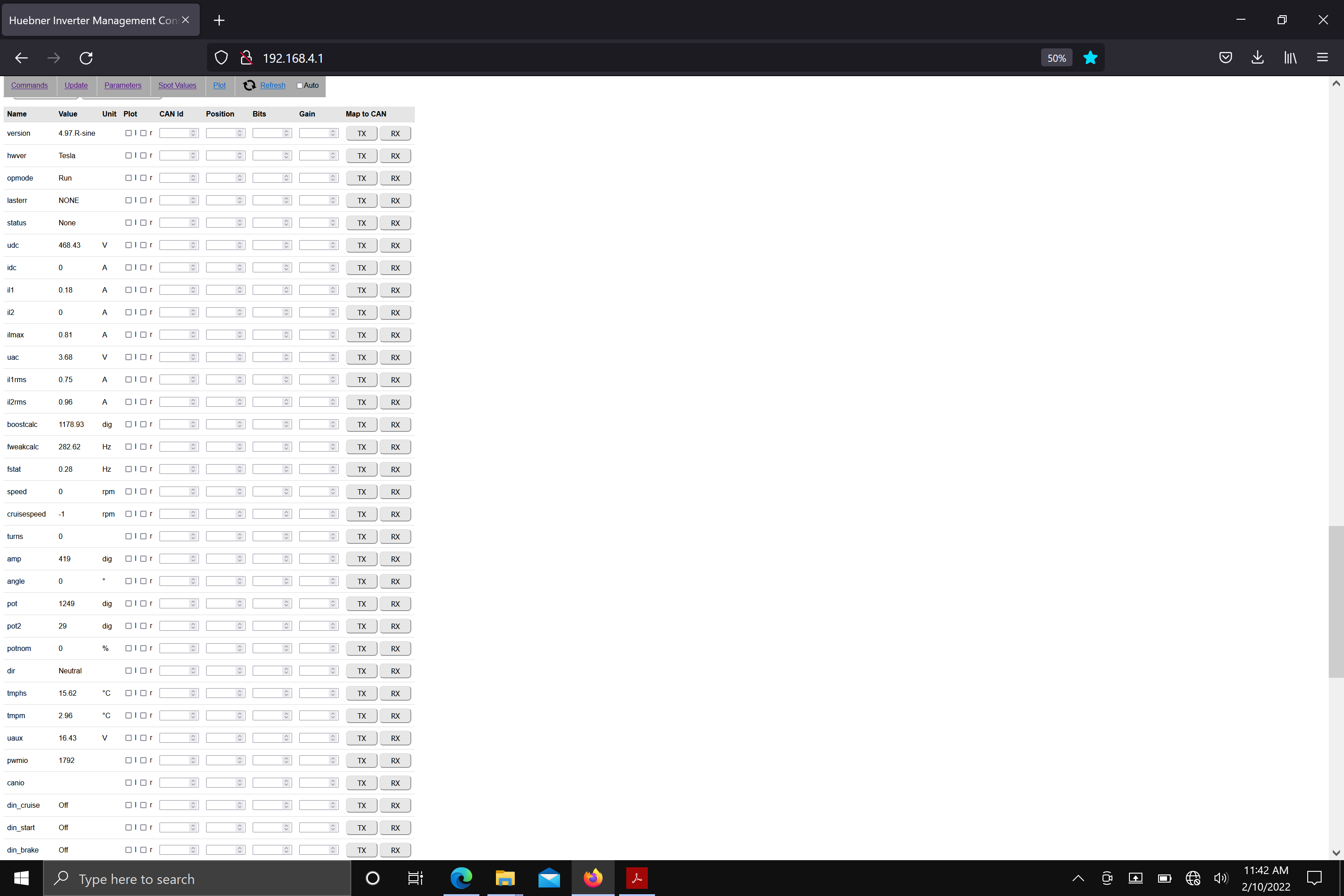

I had a new and disturbing fault show up and I'm hoping someone else has seen it.
I was working on cleaning up some wiring, and so I tested the car on jack stands. For some reason, when I come off throttle, not only does regen not kick in, but the motor continues to accelerate.
I've checked the parameters, and cruise/idle is off.
I watched the spot values, and the inverter is definitely seeing both the throttle position (pot value matches what I'm doing with the throttle) and its seeing the revolutions (rpm value changes).
This may be related to a different error where I don't seem to get regen until the pack is at 60%ish. Pack is currently at 95%.
EDIT TO ADD: the motor will come to a stop when the brake pedal is pressed.
Attached are current parameters and screen shot of spot values without the pedal pressed.

- Posts: 6968
udc is 468 and therefor above udcmax of 426V. Probably udcgain off. 0 throttle can result in minimal propulsion when there is no resistance

I re-tested *without* HV. The light did *not* illuminate, but something did generate an OVERCURRENT fault on openinverter. I didn't try with HV connected.
By disassembling the inverter, I have now identified my fault. One phase output is shorted to battery negative, so there must be a failed low side IGBT on that one phase. I will need a single replacement power stage.
