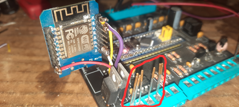

Long time no bump...
Having an (old) problem, that's probably not specific to this board, but I don't know where else to ask it.
When I connect to 192.168.4.1, it has started more and more often not showing the parameters. It seems to load the webpage fine, but none of the data.
Ex)
Now, just trying random things in the past, I think this was maybe the result of the TX/RX lines being a bit flakey, or maybe the wifi connector not pushed in well. I was using those square Dupont jumper cable things, which I figured maybe were getting a bit rounded out after a couple years of being moved around the bench. In the past, when I just reseated these, it'd start to work better again.
But, I haven't been able to get it to load the parameters at all in a while now, even after a bunch of refreshes.
So, I said screw it, and desoldered the terminals, and just soldered right to the board.
... no improvement.
I've double-checked the schematic and made sure the TX on the Wemos Mini connects to the RX on the BluePill, and vise versa.
At the moment, the inverter isn't connected, but, that shouldn't matter, right? This is just the Wifi module talking to the inverter, right?
Bluepill has a heartbeat, Red LED on solid, Green LED flashing. And when I first power up, the Wemos D1 Mini has the blue LED blink once. I think that's been normal.
It's drawing 60mA (no inverter connected).
... any idea what's going on? What's wrong?

MattsAwesomeStuff wrote: Wed Oct 18, 2023 9:14 am Long time no bump...
Have you tried removing these?
They might be acting as antennas and jamming up signals / the mcu.
Posts: 1040
Has thanked: 427 times
Been thanked: 267 times
Re: Toyota Prius Gen 2 Inverter Controller
Post by MattsAwesomeStuff »
jrbe wrote: Wed Oct 18, 2023 12:35 pmHave you tried removing these? They might be acting as antennas and jamming up signals / the mcu.
Those are just the screw terminals for the contactor control wires, which I've shoved some empty pins into to gator clip onto. Not much different than having the actual wires doing things.
The wifi signal itself is fine, I can connect to it and load the page. But the Wemos D1 Mini seems to not be communicating with the blue pill. Actually I suspect it would do the same thing if the blue pill was absent entirely.
Posts: 1040
Trying to be more helpfully helpless:
- I programmed the Blue Pill myself, 4 years ago. I presumably have the ST-LINK around here somewhere, and the software to use it, if that is useful.
- I think I programmed the Wemos D1 Mini myself too, 4 years ago. I don't even remember how, or what I did to connect it (USB? RX/TX?).
- I do have a scope, if there's anything I could scope on the board that would tell me if something was/wasn't trying to communicate, or wasn't getting through, or, what it should be showing. Any procedure of Check A, Check B, Check C, I could probably follow if dumbed down enough.
- I haven't connected the inverter (while troubleshooting, it was working fine). IIRC you should at least be able to see parameters and such without the inverter being connected, but let me know if I'm mistaken on that.
Posts: 1040
AHA!
I got parameters back!
'Twas a fucked Wemos D1 Mini.
4 years ago I ordered 2 backups, I've now used both, but, for whatever reason, the previous WeMos shit the bed.
Dug up Arber's excellent tutorial on programming the Wemos, followed it like a monkey with no understanding of why, soldered it up to the board, and it's serving up parameters.
Oh thank god, I was not in a mood to find my ST-Link and learn how to re-program that, and desolder all 32 connections on an already-desoldered board with quesitonably-abused solder pads.
... how to prevent this from happening again, I'm not sure, but I guess I should order some new D1 minis.

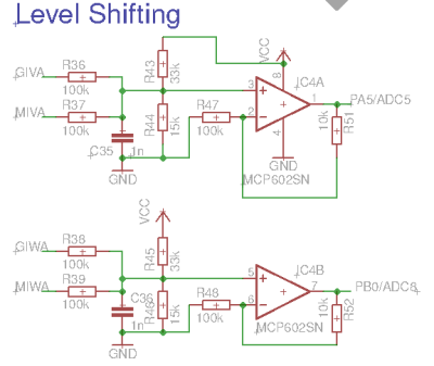

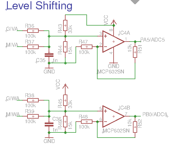

Since I now have my driveline in the car "complete" and have gotten tires rolling manually, it's time to rip out the temporary stuff and start planning on wiring it all properly.
I'm moving on to learning how to connect the encoder. Following Johannes' advice from 4 years ago, these are apparently "SuperSeals", and a ~25 piece kit of them ("380+" kit if you count the pins themselves) on Prime was only $15. Ha! I was thinking I'd be paying $15 apiece for them. Now I'll have a bunch extra I can use around car rather than sketchy spade connections.
And while I'm ordering parts, the last thing I'll probably need this thread for (I'm all of perhaps 2 people who ever followed this board/design through to its conclusion), is figuring out what to order to fix the current sensors.
Background: Damien hadn't really looked into the current sensors much when he spun off these early boards. So they're not set up to read the current sensors correctly. Johannes has since designed his control board (which maybe does this or maybe reads resolvers directly?), but, no one's ever updated the wiki or this thread with an actual circuit and actual components to use. Several people seem to have figured it out, but I'm stumped.
Starting around here in the thread...
Scirocco says: "The Gen 2 IPM current sensors are bipolar output, so with both boards, you need an interface circuit. "
Arber says: "What you need to sense current is conversion into 0 to 5V with center at 2V5 and then reduce this to 3V3 signal.
Usually 5V sensors float at 2V5 and i had great success directly using them with 3K3/6K8 resistor divider on signal line with 1nF decoupling cap. One important detail was to use 4K7 pulldown on sensor line directly on signal entering my board. From then on i only needed to reduce it to 3V3 with my divider."
Arber says: "Damien uses 1K resistors with some caps on Bluepill board. You could replace both resistors and use your sensors with 3K3/6K8 divider and 1nF cap."
Scirocco says: "A non-inverting summing amplifier with a gain of less than unity will do the job in one go."
KiwiFiat says: "And the gen2 current sensors are 15Vpp so you would need to change R2 and R4 in the daycounter schematic to 22k and it would be preferable to use a 1.65V reference. Cheapest option is to use a 3.3V reference followed by a precision 50:50 resistor divider as 1.65V references seem ridiculously expensive."
Scirocco says: "The ADC uses the 3V3 supply rail as its reference and the current inputs are assumed (in the code) to be zero at pwm startup. The offset voltage source need be no more complicated than a 1/2 supply rail divider followed by a buffer amp."
I understand some of these words and concepts, but can't apply any of them into anything useful in terms of what to buy or build.
Could someone help me out? I need to know what parts to order, what circuit to turn them into (I'll probably just dead-bug them and epoxy in place), and what if anything I need to remove from my through-hole board I bought from Damien?
And just in general, thanks for everyone who's helped carry me this far. Rounding the home stretch!
Posts: 6968
Has thanked: 454 times
Been thanked: 1771 times
I think in the end someone designed the circuit for me and this is what I made of it:
You can omit the GIVA/GIWA inputs for the MG1 sensors
Posts: 1040
johu wrote: Mon Nov 27, 2023 8:19 pmI think in the end someone designed the circuit for me and this is what I made of it:
Okay, so to really dumb it down, for anyone no smarter than me...
We have to do some surgery on the original through-hole board, because Damien originally had a different circuit there:
And just to confirm, PB0 and PA50 are pins 28 and 31 on the Blue Pill. Yep.
And, many ways to skin a cat, we could cut just take a dremel and cut either side of of the traces to Pin 31 and TB3-6, and Pin 28 and TB3-7 and replace them with Johannes' circuit. But, to keep fewer components dangling in the air above the board, we can desolder and replace 6 of the components that happen to be in the same layout as Damien's with new ones of the correct values, and then we have fewer pieces we'd have to insert. Still have to do some cutting:
And then in a physical sense, end up with something like this:
Only have to make the 2 cuts with a Dremel (will have to check if that's the top or bottom of the board).
In reality what I'll actually do, since I'm desoldering those 6 components anyways, is just not connect the leg of the new components that go to the traces that lead to Pins 28 and 31, leave them in the air, and then use one of their former solder pads to connect the end of the circuit back to the BluePill. I don't like the idea of Dremeling up a 4-layer board. Also 2 are just grounds, so, those'll just get tied together. It's not going to actually look like the diagram.
There's a handy empty spot on the board right next to the Blue Pill to dead-bug the MCP602 onto with some silicone.
This'll become clearer when I do the surgery and stop mixing PCB layouts with schematics.
Question:
- On Johannes' circuit, it has VCC. ... Which VCC? 12v? 5V? 3.3V?

Parts arrived. The opamp was waaaay smaller than I was imagining. Clumsy chisel-tipped soldering iron. Need a gameplan.
It'll go something like this...
... except the opamp is 25% the size and the resistors are 200% the size.
No matter, epoxied it down...
chef's kiss
Voila! Magnifique!
... haven't tested it yet.

Now that I've got my current sensor circuit ready, I was about to connect it tonight and then I had a moment of hesitation because I know the diagrams have been wrong before.
There are 8 total current measuring wires in the Prius wiring harness.
4 of those are for MG1, 4 are for MG2, so that's easy.
But for each motor, there's 4 wires. The V and the W current, and the A and the B for each of those:
7 MIVA MG2 Phase Current V LightGreen-Black Green - Cable 3
8 MIVB MG2 Phase Current V Purple-Yellow White - Cable 3
23 MIWA MG2 Phase Current W Grey-Green Red - Cable 3
24 MIWB MG2 Phase Current W Grey-Red Black - Cable 3
The wiki diagram says to connect 7 and 23 (MIVA and MIWA) to the inputs on the controller board. Those are the "A" circuits for both V and W obviously.
What do you do with pins 8 and 24, the "B" circuits? Just leave them unused or do I ground them or send them to 12v+? What's the purpose of the B circuits? Is it the other half of the connection (i.e. you need to connect to both A and B?)? Is it just redundant (in case one fails)? Should I connect both 7 and 8 to the same spot, and both 23 and 24 to the other same spot?

MIVB and MIWB can just remain unconnected at the inverter end.

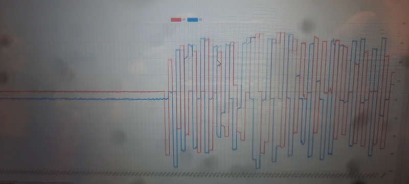

- I told it to graph IL1 and IL2 when spinning a few hz.
Ta da:
What's odd is that one of them when "off" isn't at zero...
Bigger problem, having the encoder plugged in seems to have made it act wonky.
- I changed the polepairs param to 3 (it's a 6-pole motor).
- I tried the default encoder setting, and the next one down on the drop-down menu (AB?).
In the default setting, it was not cooperating. I'd tell it to spin at zero hz and it it was just acclerating slowly off into orbit.
In the 2nd setting (AB?) it was... clunky. Cogging almost. Was definitely not spinning at 1hz.

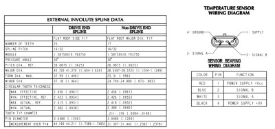

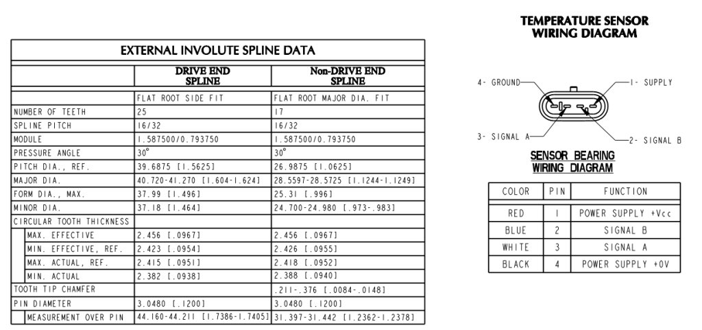

Far as I know I wired my encoder correctly:
