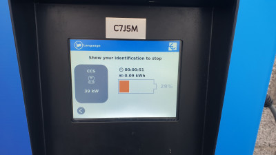

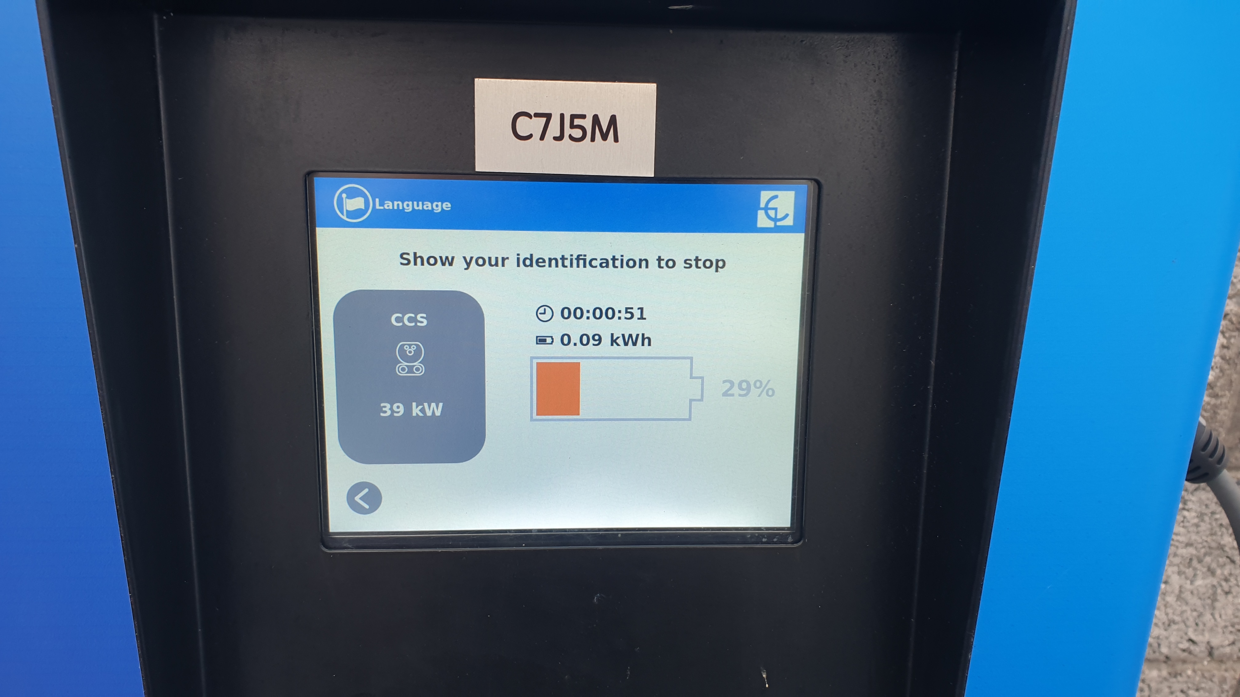

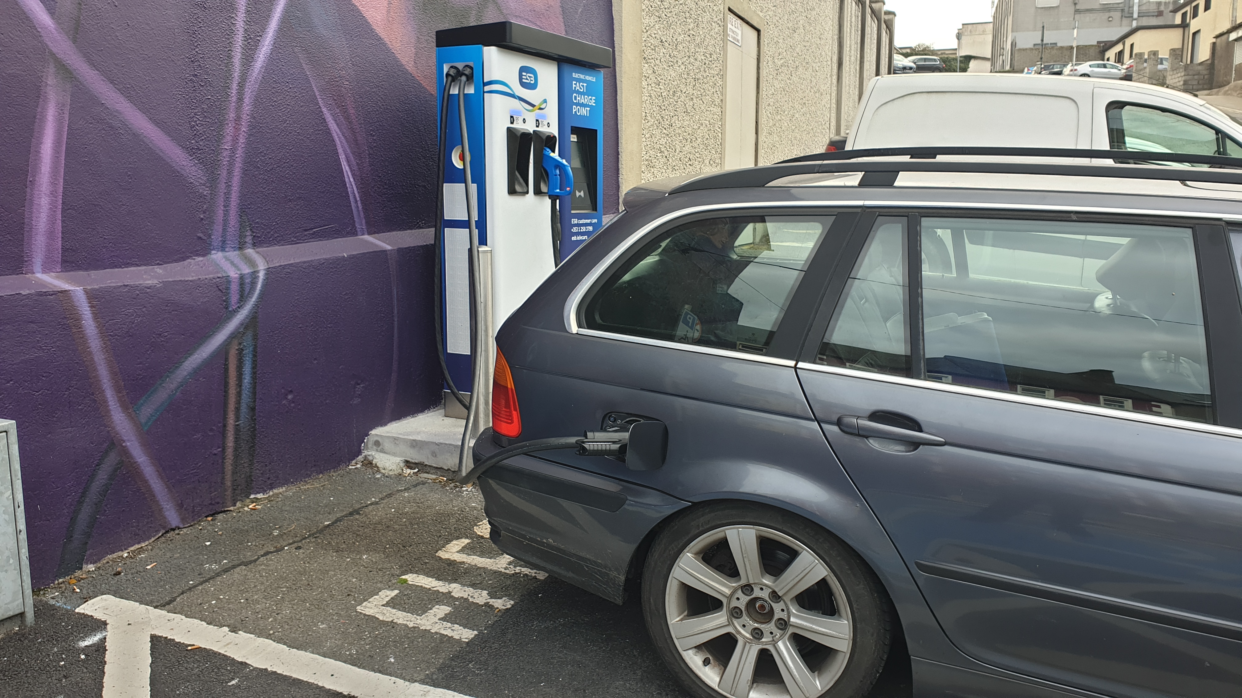

Do you have canlogs of both events?Jack Bauer wrote: ↑Sat Aug 21, 2021 2:33 pm Road trip! Went on a 160 mile jaunt today to collect some parts. 3 CCS stops.
1)Circontrol. No problems got full 125A available.
2)Efacec. No charge constantly failing around state 1/2. Modded the state machine so state 0 is "standby" for 2 seconds. Problem solved. Full power.
3)Efacec. As above. Worked fine with mod to state 0.
Not bad for a 22kwh Zoe pack in an E46 touring...

Found my (latest) problem. Because I'm an idiot who can't tell his left shift from his right turns out when I thought I was asking for 125A I was asking for 126A. Not a problem as we respect the current and power limit flags until we hit a station who implements the standard differently and shuts down if you even think about asking for more than the posted limit! Great to see in the CCS game that even the same make and model of station implement the standard in different ways. Keeps me interested if nothing else I suppose. Now to find out what I'm doing that annoys ABB stations....

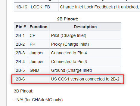

But the wiki (https://openinverter.org/wiki/BMW_I3_Fa ... LIM_Module) says that the US version LIM module has a jumper between 2B-2 and 2B-6 connections.

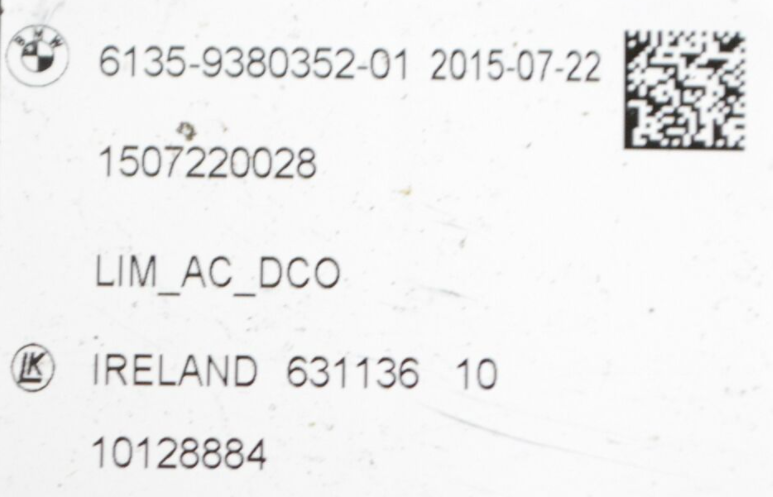

My LIM module have just arrived from IRELAND, so it got me wondering....
Anybody had success with the CCS1 here yet?

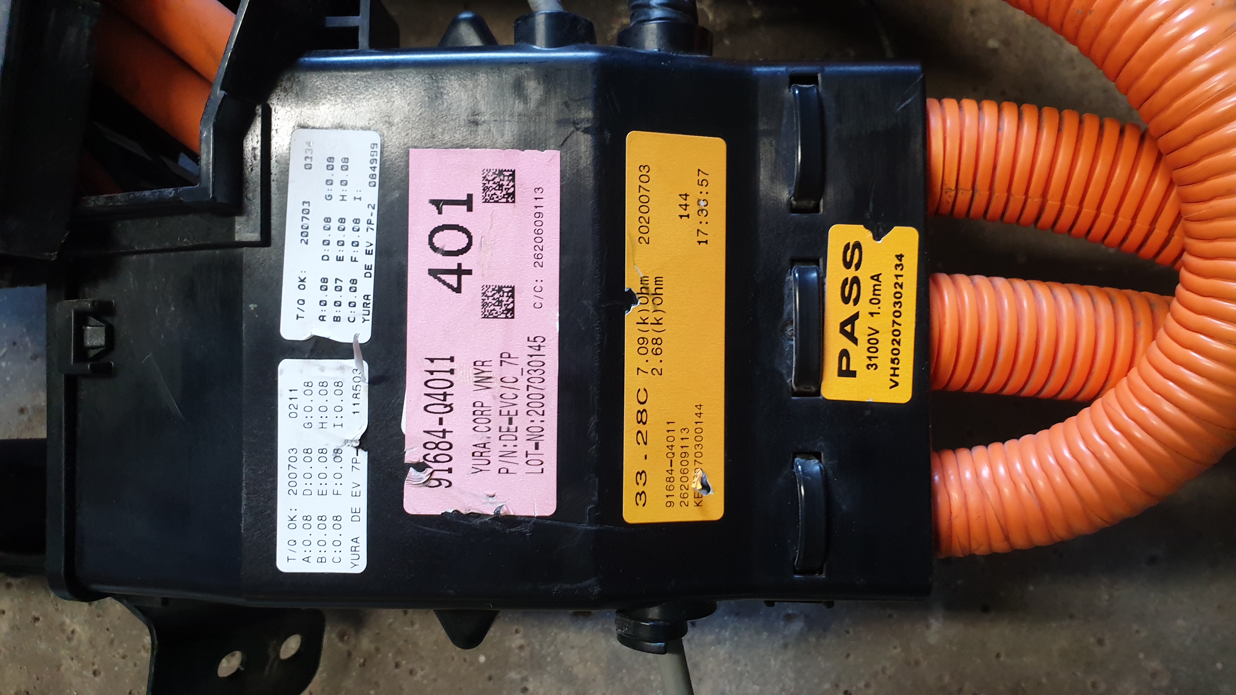

Back on the road again. Seems my favorite ccs stations in the whole world have had a sexy software update. The good : Nice display of charge power, The bad : station reported voltage is now wayyy over that recorded in the car. The ugly : yep you guessed it! fake "over voltage" shutdowns.
In other news got me a KIA CCS 2 socket to play with. Spent a half day trying to understand why it wouldn't work with my Leaf Gen 3 pdm. Guess what? It has a 2.68k resistor between PP and ground and a 7.06k resistor between CP and ground. Helpfully they even have a label on the back with these values listed. Now, somebody please tell me where this is specified in the CCS standard?

PP to ground (R5) 2.7K looks correct but the CP to ground resistor is weird.Jack Bauer wrote: ↑Thu Oct 14, 2021 2:46 pm In other news got me a KIA CCS 2 socket to play with. Spent a half day trying to understand why it wouldn't work with my Leaf Gen 3 pdm. Guess what? It has a 2.68k resistor between PP and ground and a 7.06k resistor between CP and ground. Helpfully they even have a label on the back with these values listed. Now, somebody please tell me where this is specified in the CCS standard?
Maybe they use it to detect the inlet and have a slightly higher resistors (R3) in the KIA charge controller.
To indicate state B (EV connected) CP should be connected to ground with 2.74K. If they have 7.06K in the inlet they may have ~4.5K in the controller.
But If the resistor has no diode (D1) in series the negative side of the PWM signal would be slightly pulled down too. (~ -10.5V) https://en.wikipedia.org/wiki/SAE_J1772#Signaling

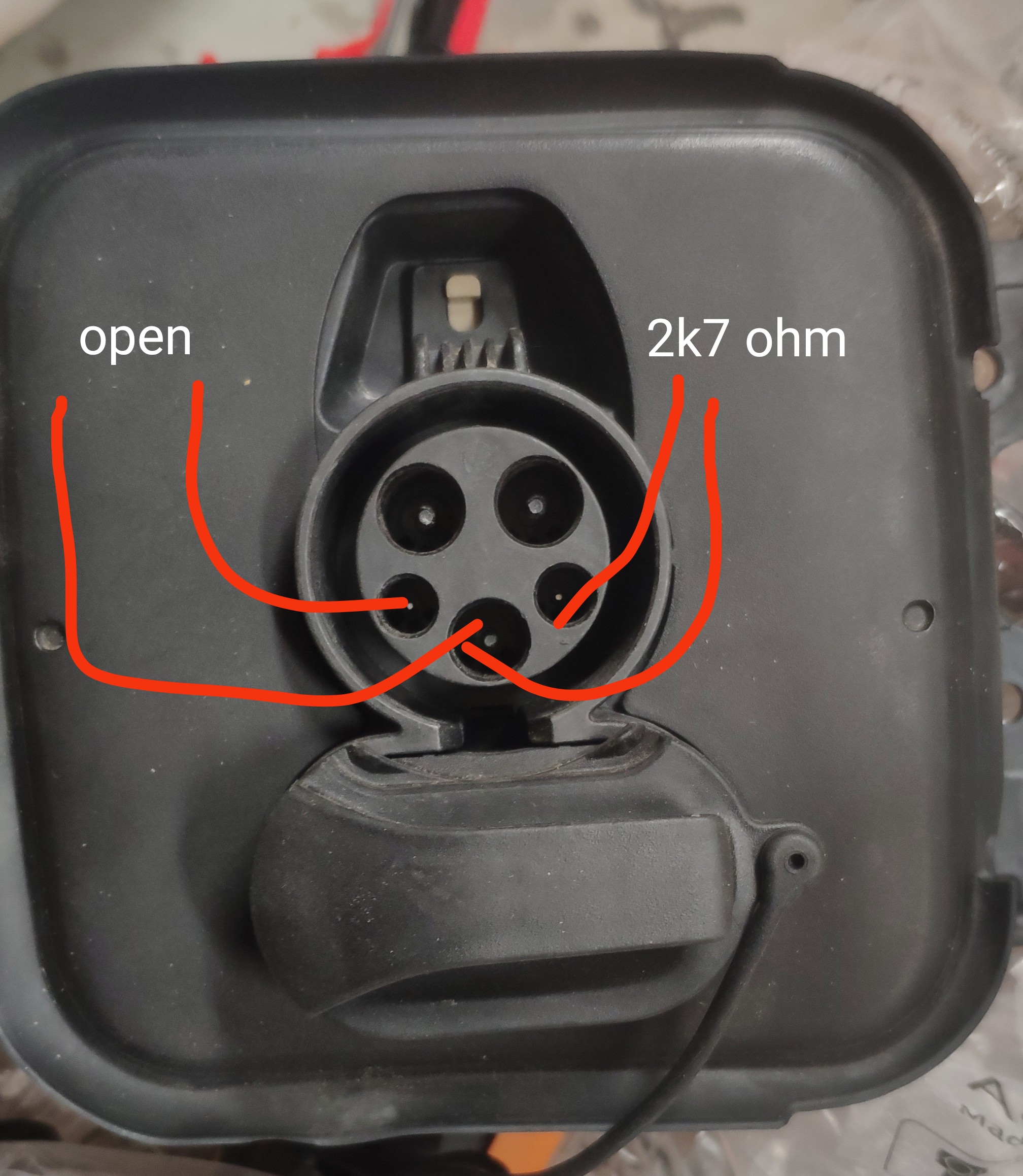

Could someone with an i3 charge port check if it has any resistors?

Would it be possible to check this on the car? If it's as simple as "walk out to the driveway and poke the J1772 port with a multimeter" I'd be happy to help.Jack Bauer wrote: ↑Sat Oct 16, 2021 5:36 pm Could someone with an i3 charge port check if it has any resistors?

That's exactly whats needed. A DC voltage measurement between the ground pin and PP will do the trick.

Got my charge port early! Yay!alexbeatle wrote: ↑Mon Oct 18, 2021 7:23 pmMine is arriving early November. Will post if nobody else has it by then.Jack Bauer wrote: ↑Sat Oct 16, 2021 5:36 pm Could someone with an i3 charge port check if it has any resistors?
It's a CCS1 charge port, from Feb 2018 - BWM part number 61126840439.
There's an open between PP and gnd. 637ohm between CP and gnd.

Sorry folks, there's been a mistake.alexbeatle wrote: ↑Sat Oct 23, 2021 1:15 amGot my charge port early! Yay!alexbeatle wrote: ↑Mon Oct 18, 2021 7:23 pmMine is arriving early November. Will post if nobody else has it by then.Jack Bauer wrote: ↑Sat Oct 16, 2021 5:36 pm Could someone with an i3 charge port check if it has any resistors?
1. I mentally swapped the pin out of the plug vs. socket.
2. Working on another project, I discovered that my meter isn't functioning well.
I bought a new meter and tested it.
CP to gnd - open. PP to gnd ~2k7 (2696 ohms to be exact). This seems to correspond to what the wiki shared here earlier is showing.

Ok that makes sense. Now we just need someone with a type 2 ccs socket to measure.

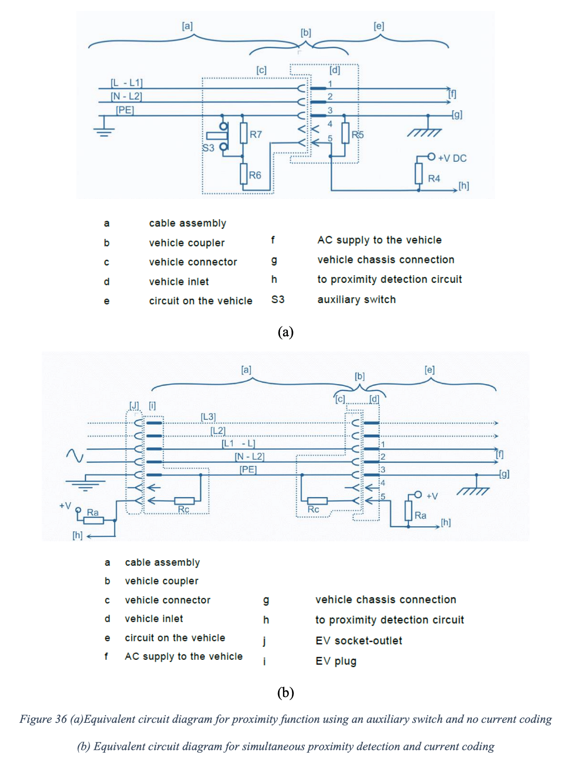

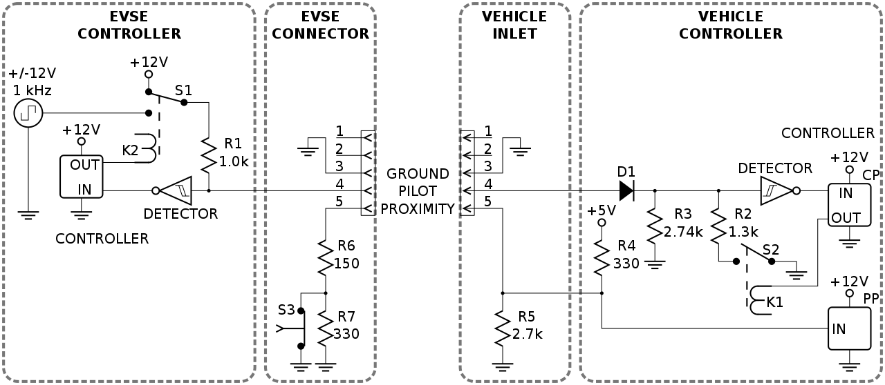

Page 35 shows a J1772 (Type 1 plug) PP circuit used in the US on top and a IEC 61851 (type 2 plug) circuit used in Europe on the bottom. https://www.researchgate.net/publicatio ... _Standards
This would mean there is no PP - PE resistor in the type 2 charging port.
- muehlpower
- Posts: 807
- Been thanked: 186 times
Phoenix Contact specifies for Type1 inlets 2k7 and for Type2 4k7 between PP and GND, regardless of whether it is AC/DC or just AC.
