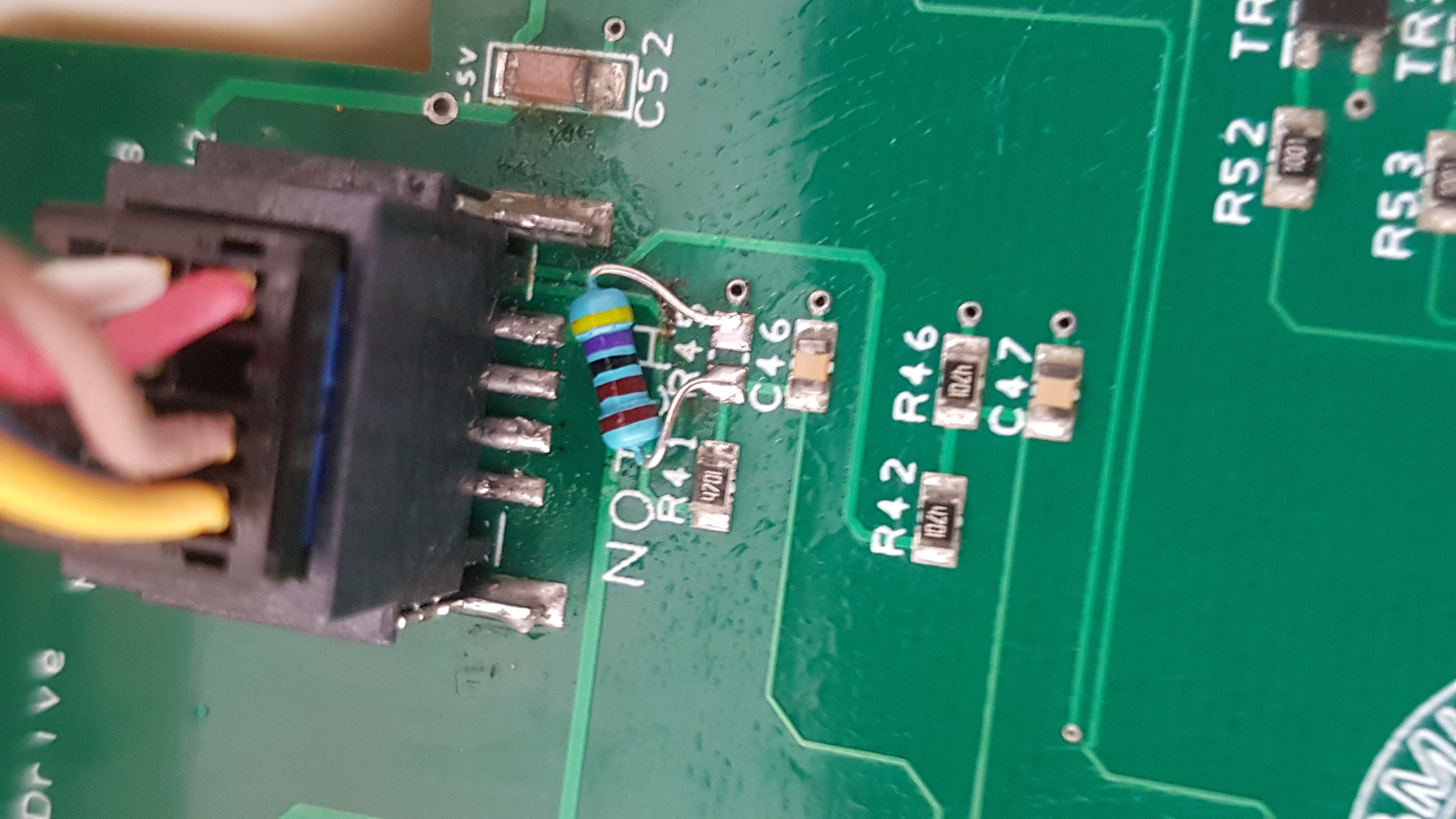

Check the 26v supply to the current sensor.

25.7v with and without the current sensors plugged in.

Oh sorry I meant see if its getting to the wire on the sensor (red i think from memory) just in case you have a bad connection on the socket. The current sensors need to see +5v , -5v and 26v.

Red is 25.8V, Brown, Yellow, White, Green and Purple are 5V and Blue is -5V

Hmmm.....its getting the correct voltages so.

It's got me stumped, not that it takes much, I can't see see why. Only thing I can guess at is R41 being shorted out or maybe R45 being open? But that's only based on my basic understanding of resistor dividers.

Thanks I've measured the resistances of R41 (4.7k) R45 (infinite) R42 (4.7k) and R46 (4.7k)
R45 isn't looking good.
I guess it needs replacing, I've only got through hole to replace it with but I guess it'll do for now to prove or otherwise.

Sorted. Getting 2.5v now as expected.

Wow that weird. was it a duff resistor or solder joint?

Resistor it seems, can't get a reading from it. Glad it was easy to find.

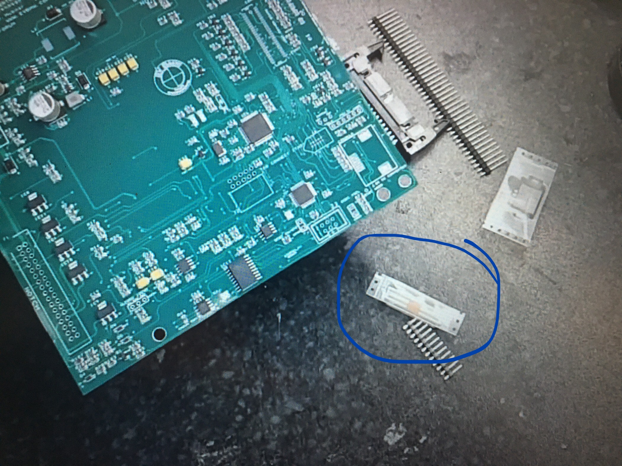

Just about to start soldering up the partially built v1d board today. The missus very kindly “tidied” the office. I asked what happened to the tyco connector that a gentleman in Ireland very painstakingly removed from the original inverter logic board. She said, did you try looking in the vacuum / bin / cat? insert horrified meme here
In the BOM it says this connector can only be recovered from an existing Prius inverter logic board. In the Logic Board Installation Video which Damien made, he has a pre-packaged connector. Does this mean this connector is now obtaneum and does anyone have a part number for it please?

You mean bm50b-shlds-g-tft?
Check the diagrams on Damian's github
There are Chinese copies available from eBay:
https://www.ebay.co.uk/itm/333122786729
I cannot confirm how good they are as I have brought some and have had issues.... Fitted one and am getting spurious voltage readings from the Arduino, tried to tidy up my bad soldering and made it worse! Tried on a second board didn't put enough solder on it put pulled off a couple of traces! Currently trying to find a solder guru! As I don't have many spare connectors or boards!

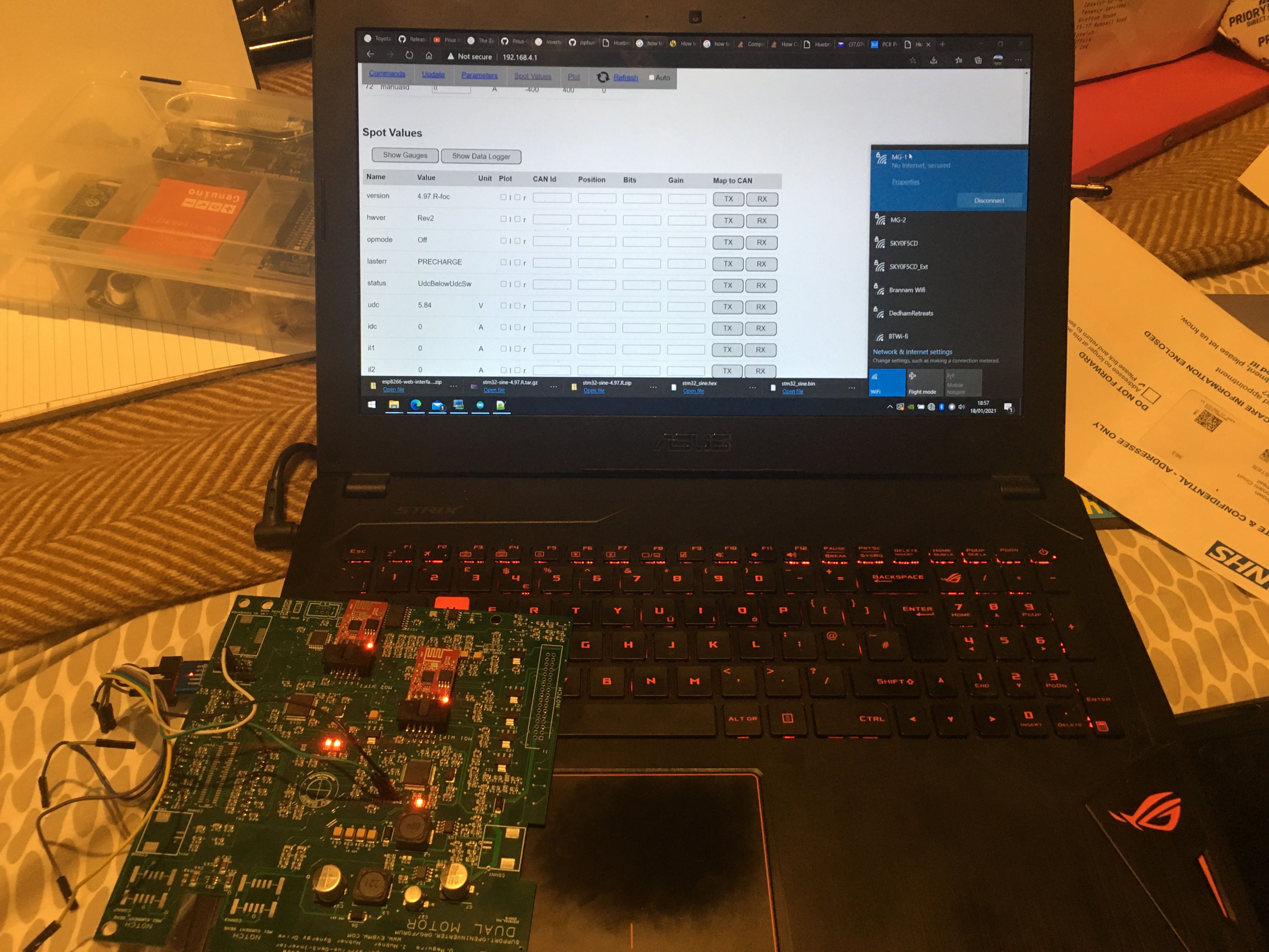

Bit stumped here. After I blew my pre-charge resistor, I switched to the Sine firmware for some testing. Noticed that even on start-up, fslipspnt was set to 0.53hz and ampnom was set to 9.53%. Tried setting them to zero. Fine. But as soon as I refreshed the page, they went back to 0.53/9.53. Tried saving the parameters. No change.
Removed the wifi module and hooked up serial cable. Tried manually setting those parameters. It says 'set OK' but when you ask it for them, they're still the same.
After some head scratching and with @Bigpie's input I wiped the chip with STLink and reflashed it with an older version of the firmware. Same result.
Anyone have any suggestions?

Hit restore default parameters button up near the top. You may have something like ampnom set too high.

Sorry should have mentioned that I tried that too. They still stay the same.Jack Bauer wrote: ↑Tue Jan 19, 2021 6:21 pm Hit restore default parameters button up near the top. You may have something like ampnom set too high.

I noticed these exact same values today as well. Will go after it.
