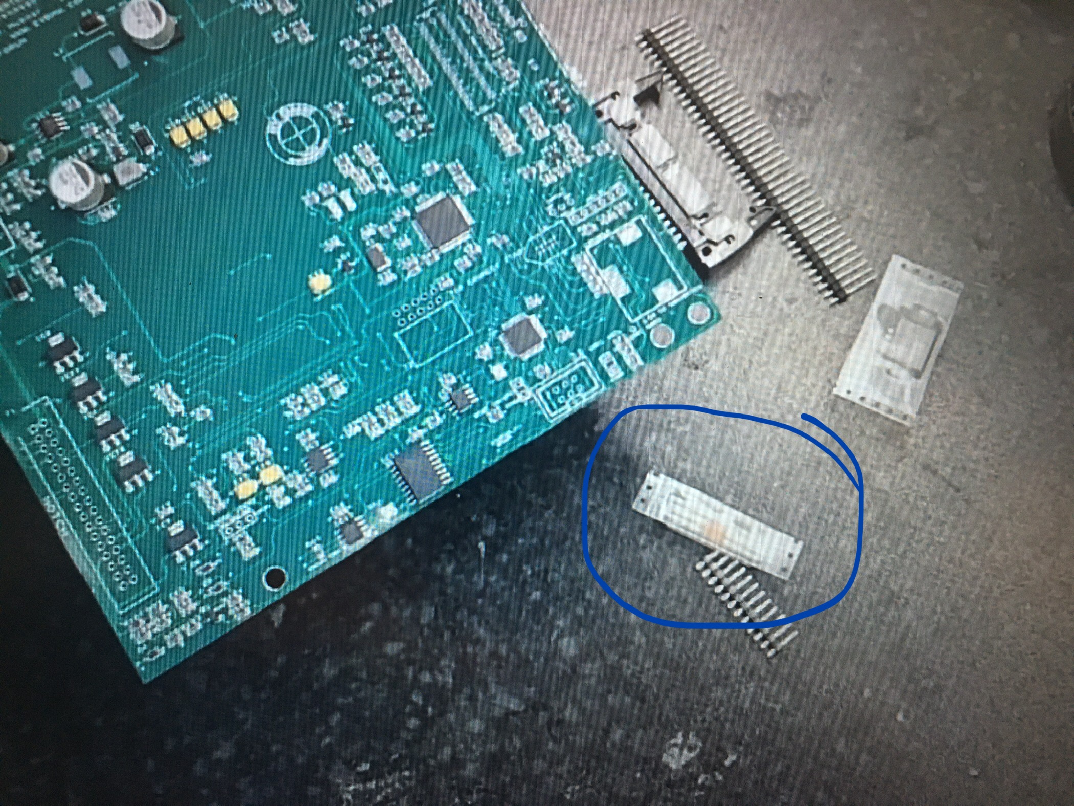

Just about to start soldering up the partially built v1d board today. The missus very kindly “tidied” the office. I asked what happened to the tyco connector that a gentleman in Ireland very painstakingly removed from the original inverter logic board. She said, did you try looking in the vacuum / bin / cat? insert horrified meme here
In the BOM it says this connector can only be recovered from an existing Prius inverter logic board. In the Logic Board Installation Video which Damien made, he has a pre-packaged connector. Does this mean this connector is now obtaneum and does anyone have a part number for it please?

You mean bm50b-shlds-g-tft?
Check the diagrams on Damian's github
There are Chinese copies available from eBay:
https://www.ebay.co.uk/itm/333122786729
I cannot confirm how good they are as I have brought some and have had issues.... Fitted one and am getting spurious voltage readings from the Arduino, tried to tidy up my bad soldering and made it worse! Tried on a second board didn't put enough solder on it put pulled off a couple of traces! Currently trying to find a solder guru! As I don't have many spare connectors or boards!

Awesome, thanks a million I’ll get one of those now and give it a try. Can’t pretend to be a solder guru but I have a soldering station and a pretty steady hand. Will let you know how I get on.

Would recommend the zoom glasses that Damian used in the video, despite that still managed to singe some of my hair!
Also very fine tip end for the iron is definitely needed.

Brilliant! Just ordered a bunch of the chineseum connectors so that’ll come in handy when they arrive thanks. Made some progress on the programming front. V4.97 running on both MG1 and 2 and flashed the Olimex modules. The videos and wiki info have made it a lot simpler!
