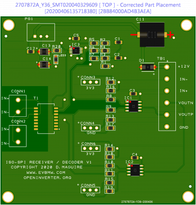

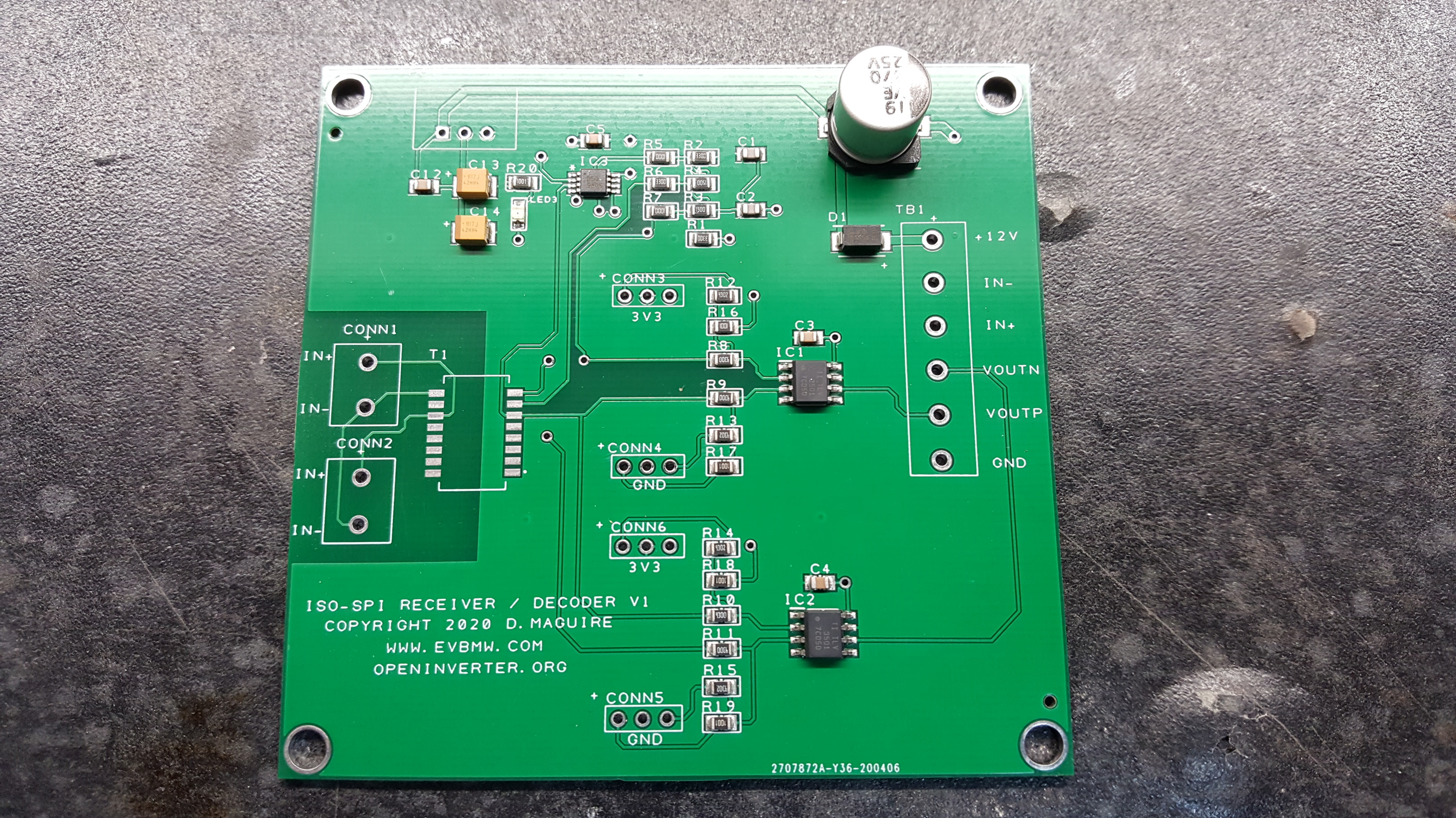

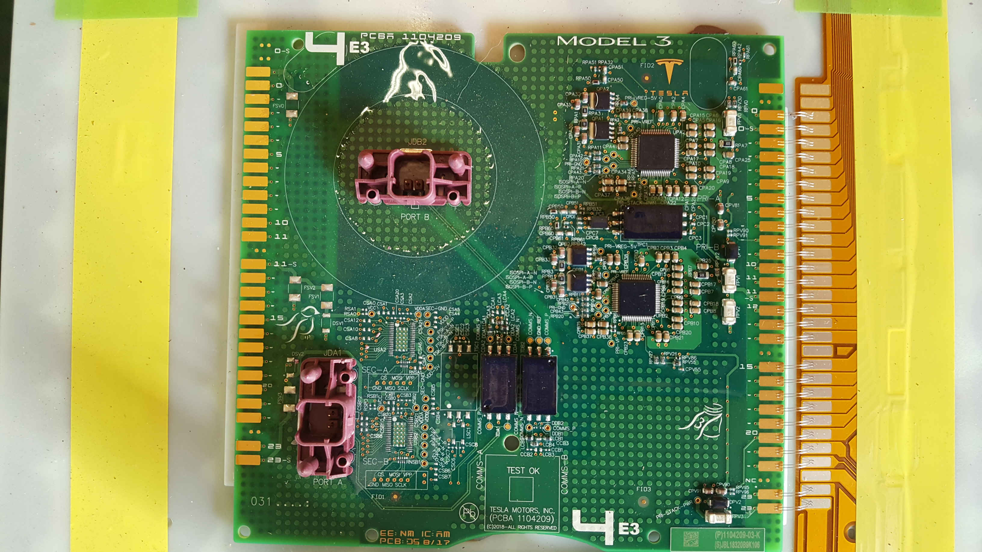

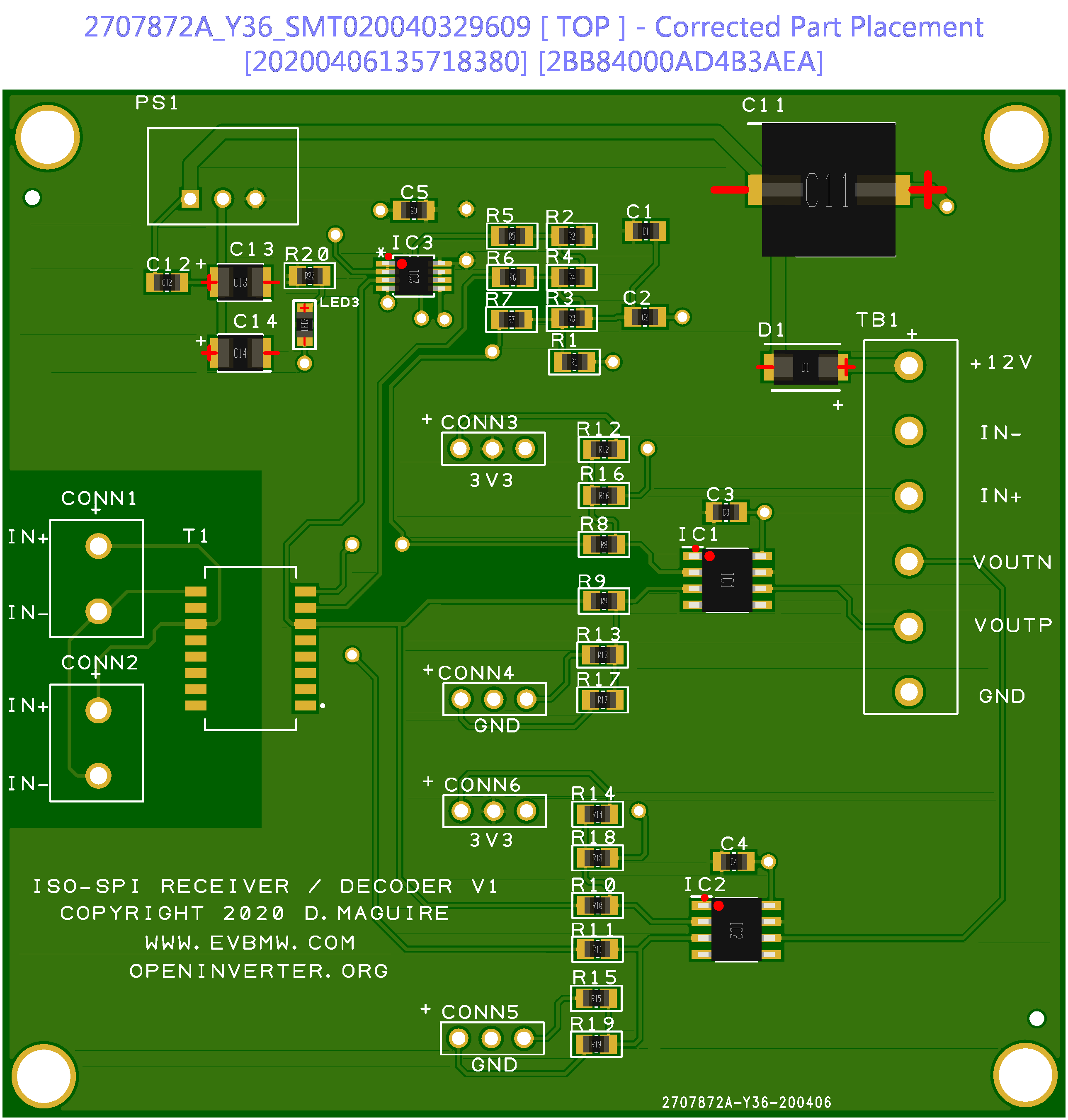

Analog front end for the isospi decoder in production at JLCPCB.

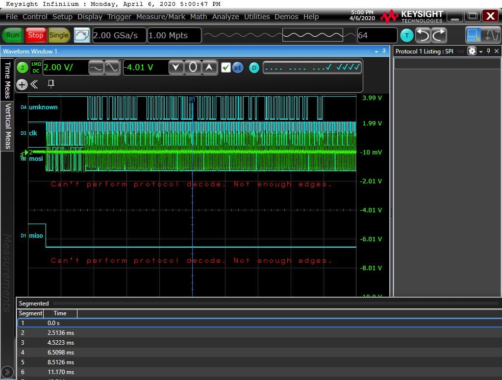

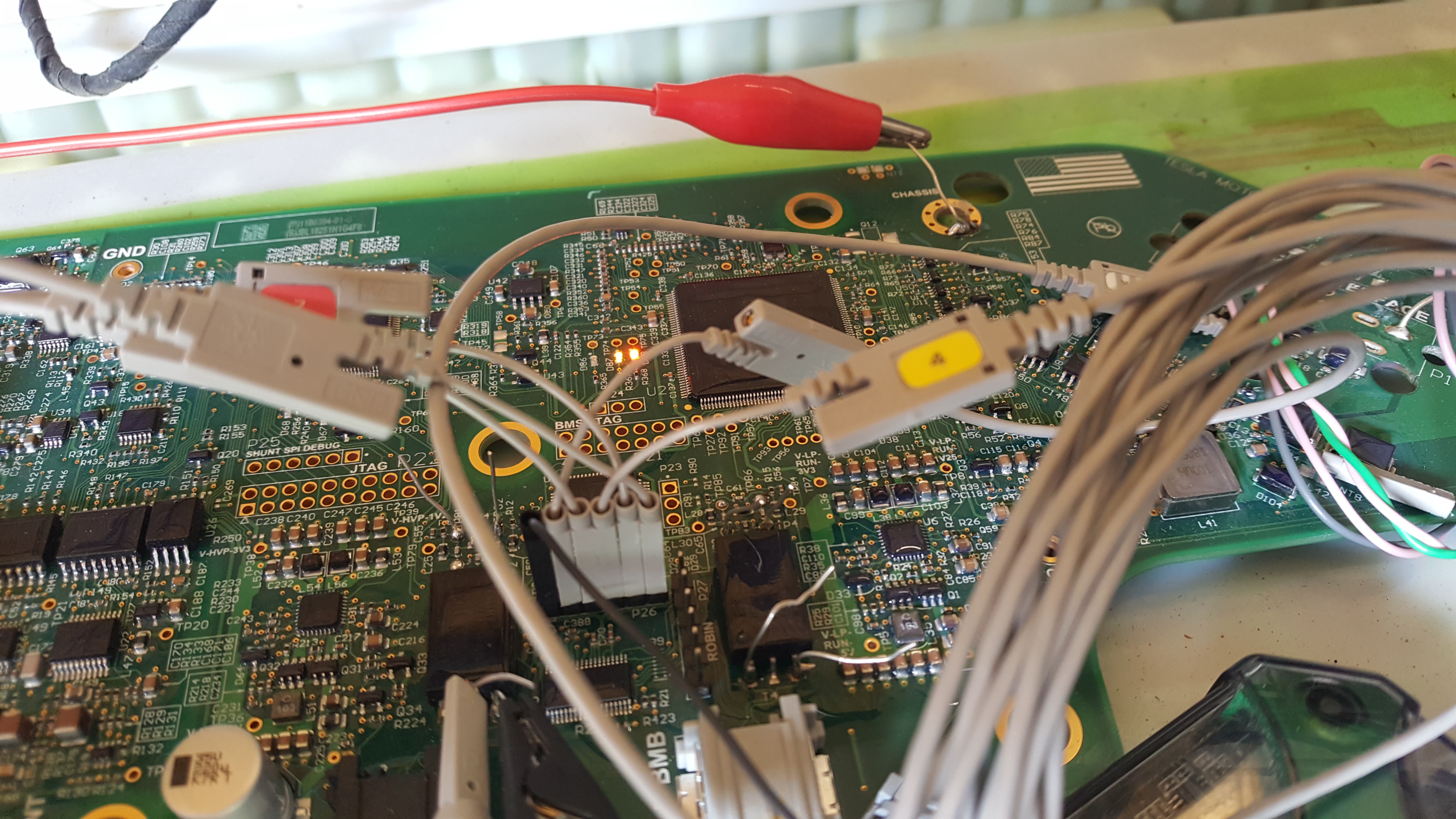

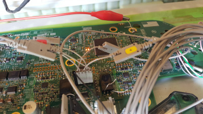

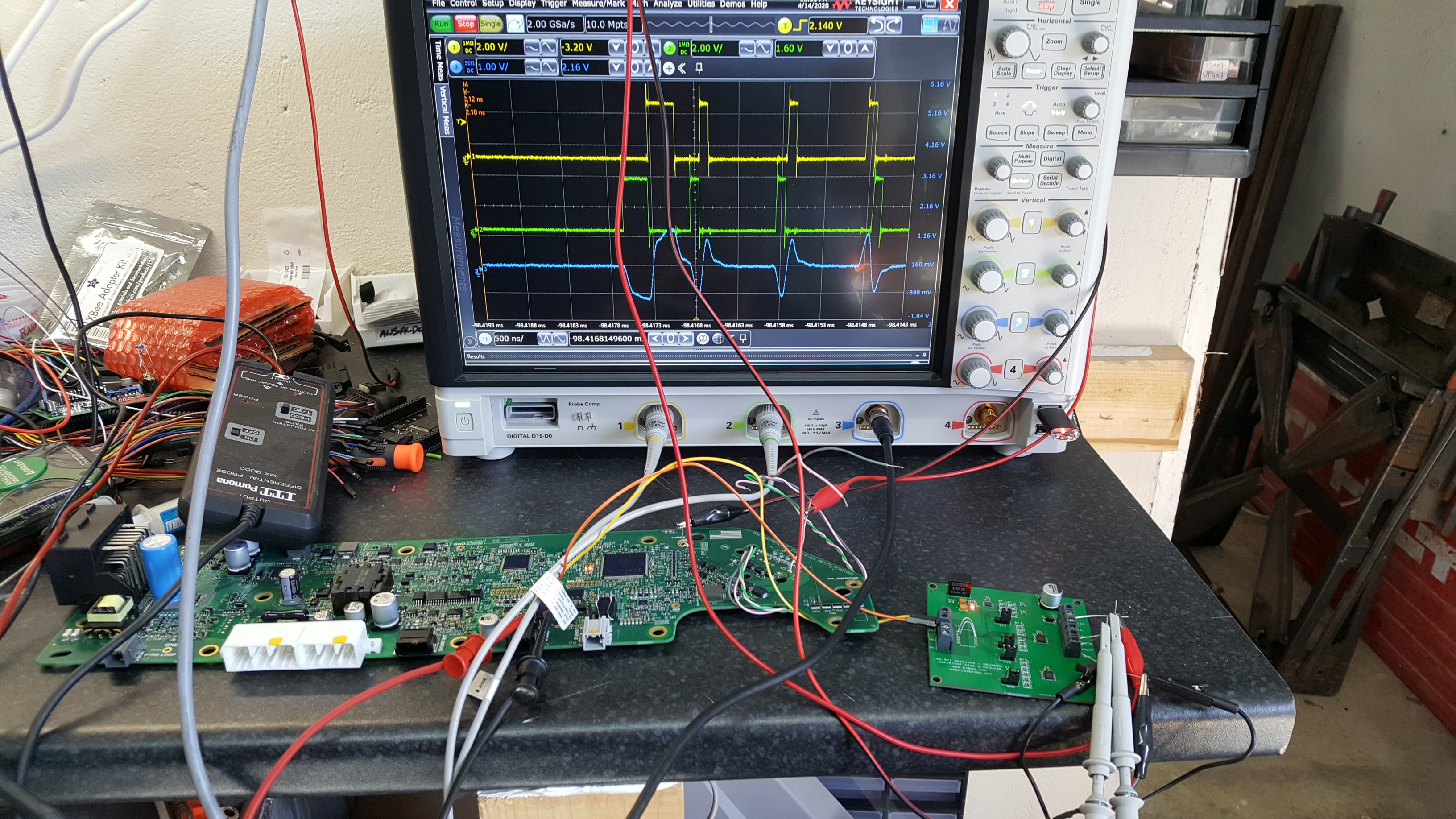

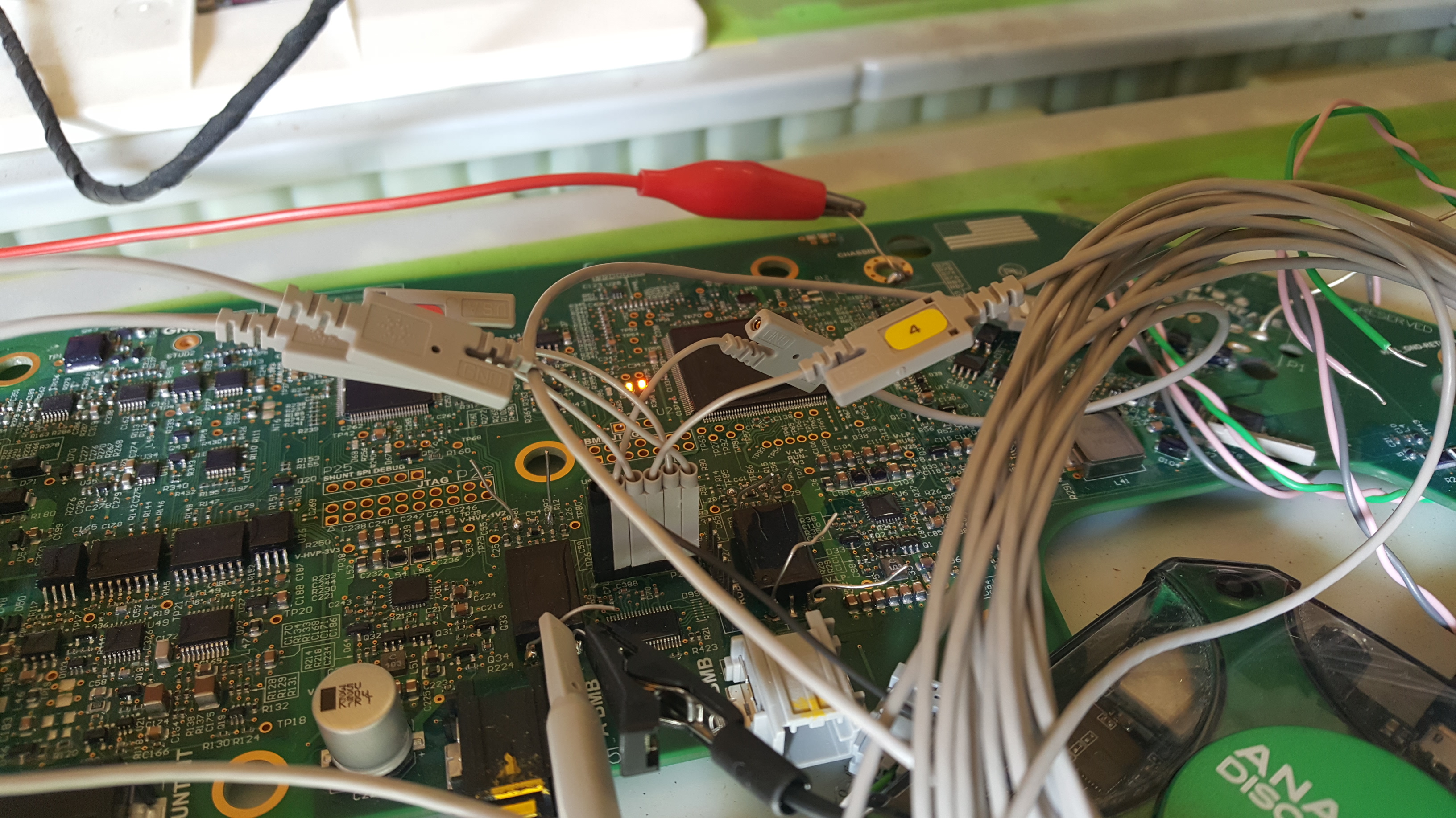

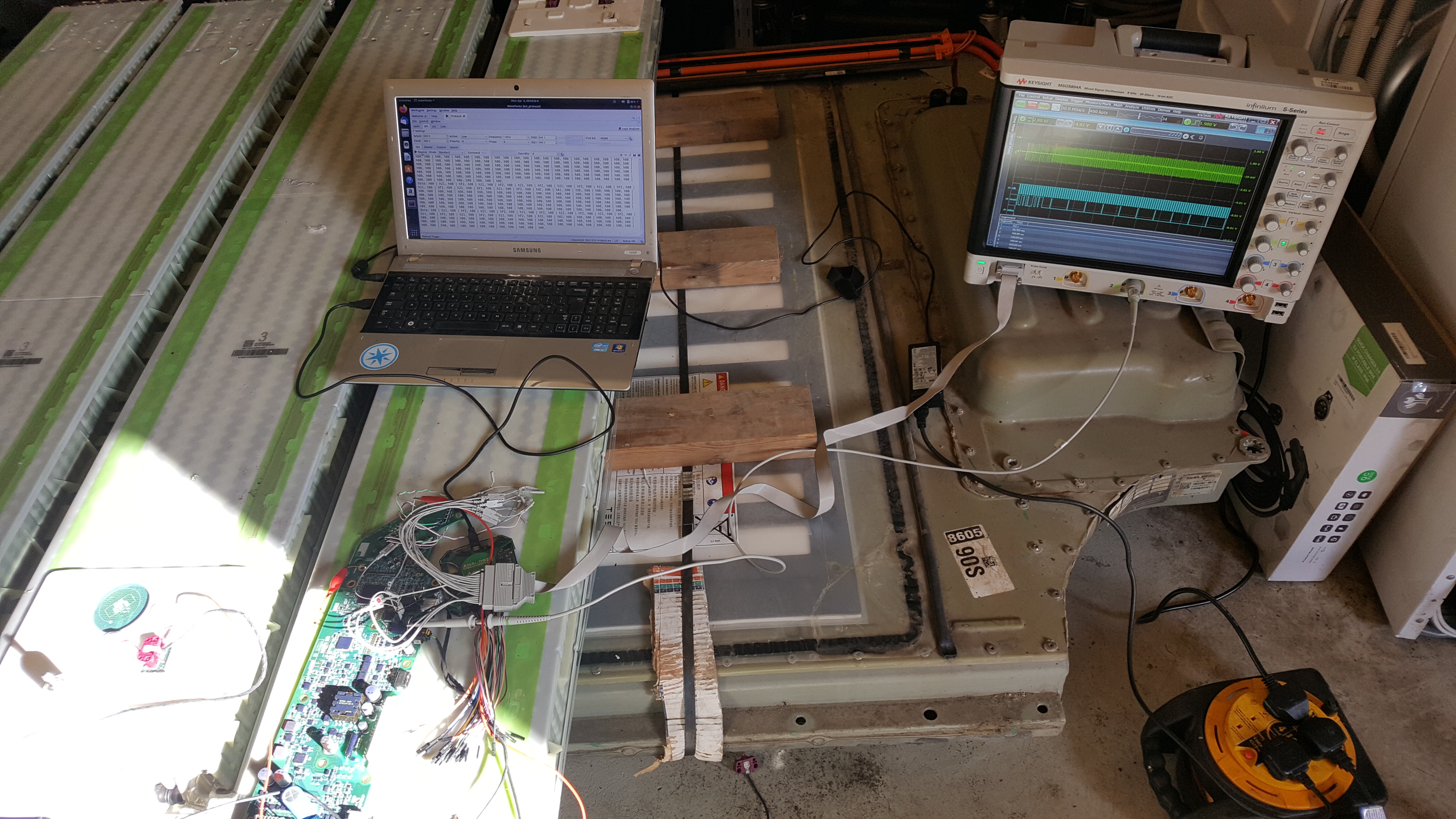

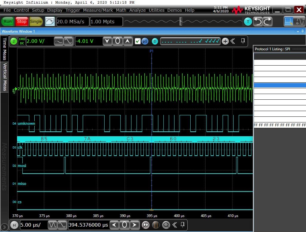

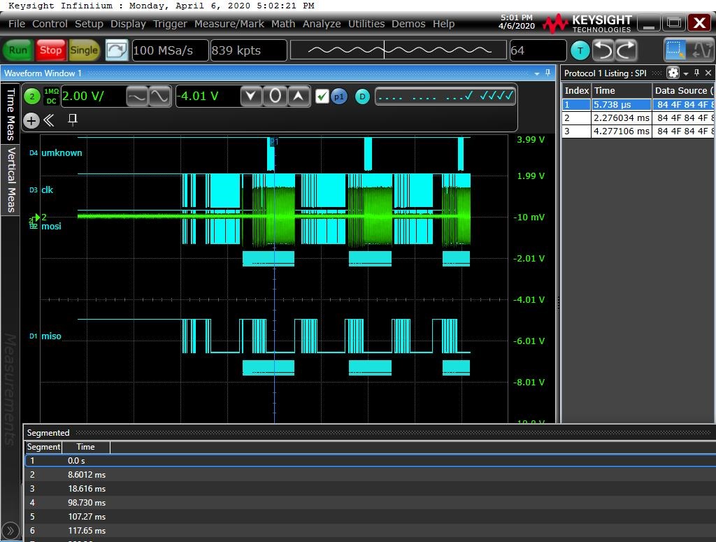

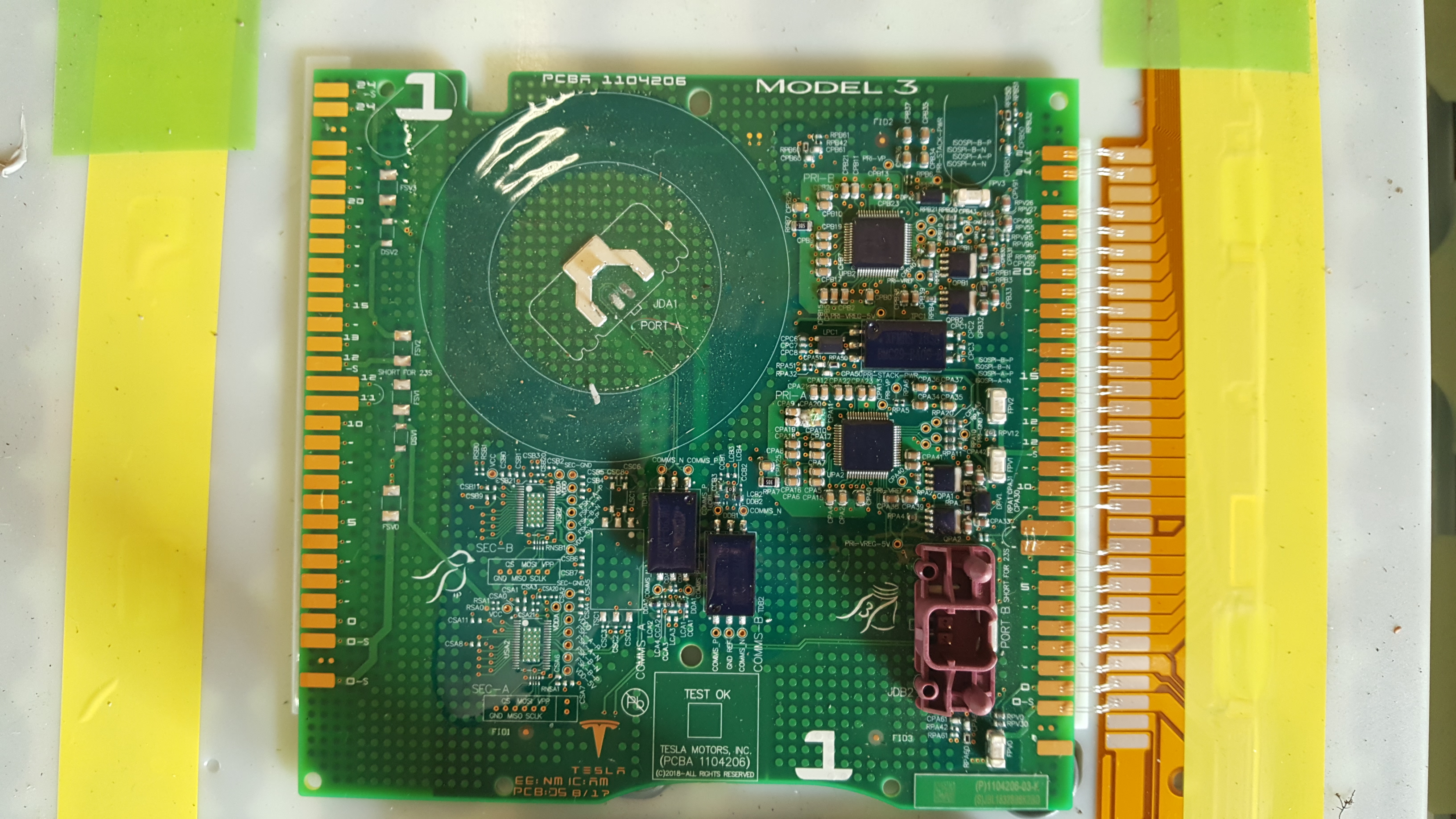

Got a chance to visit the battery today. Made some progress.
Test setup : hvcontrol pcb as before with logic analyser / scope on the batman header.
Connected to one port of one bms board at a time. At first nothing happened. No sign of data change on the analyser but could see extra data appearing on the scope. Then remembered I was not probing one pin (with test lead 4 in the pictures) as I had assumed it was just a 3v3 supply. Wrong as usual. When connected to a bms board this pin wakes up and squirts data.
Logic analyser files of this pin on the repo:
https://github.com/damienmaguire/Tesla- ... /OneModule
I'll upload the scope captures later. Log files taken with a Digilent Analog Discovery 2 and Saleae Logic.

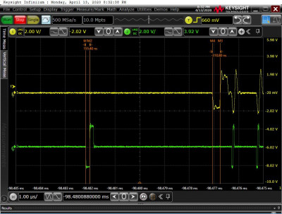

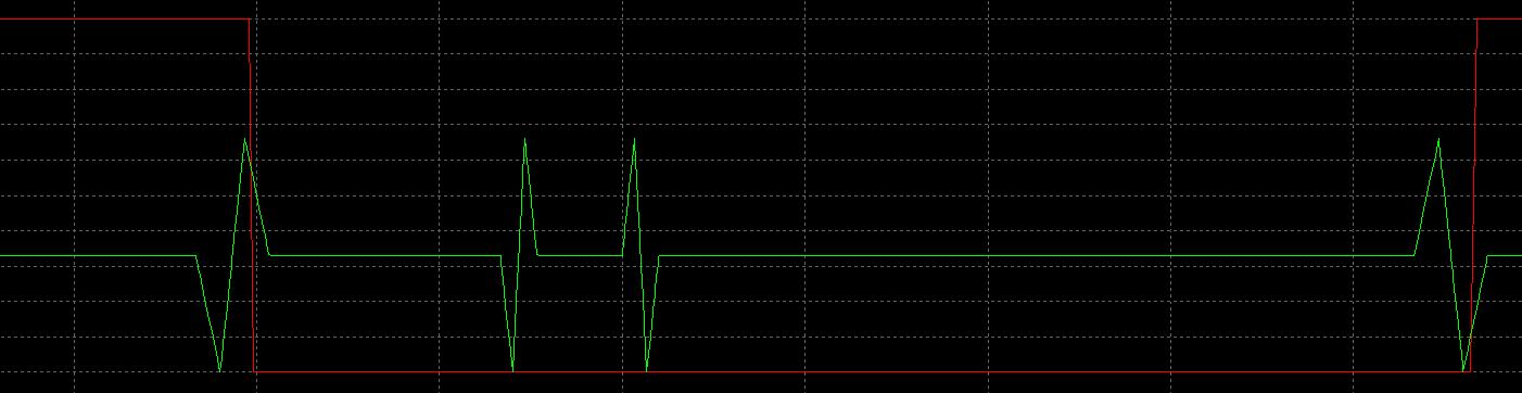

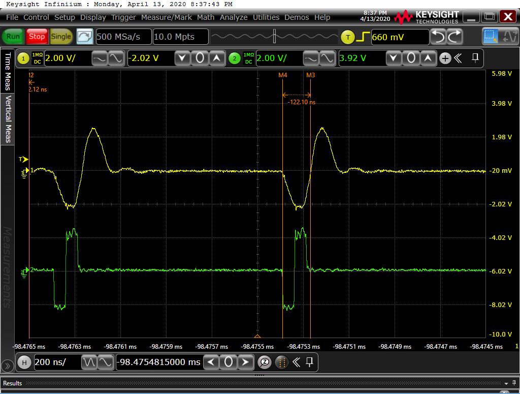

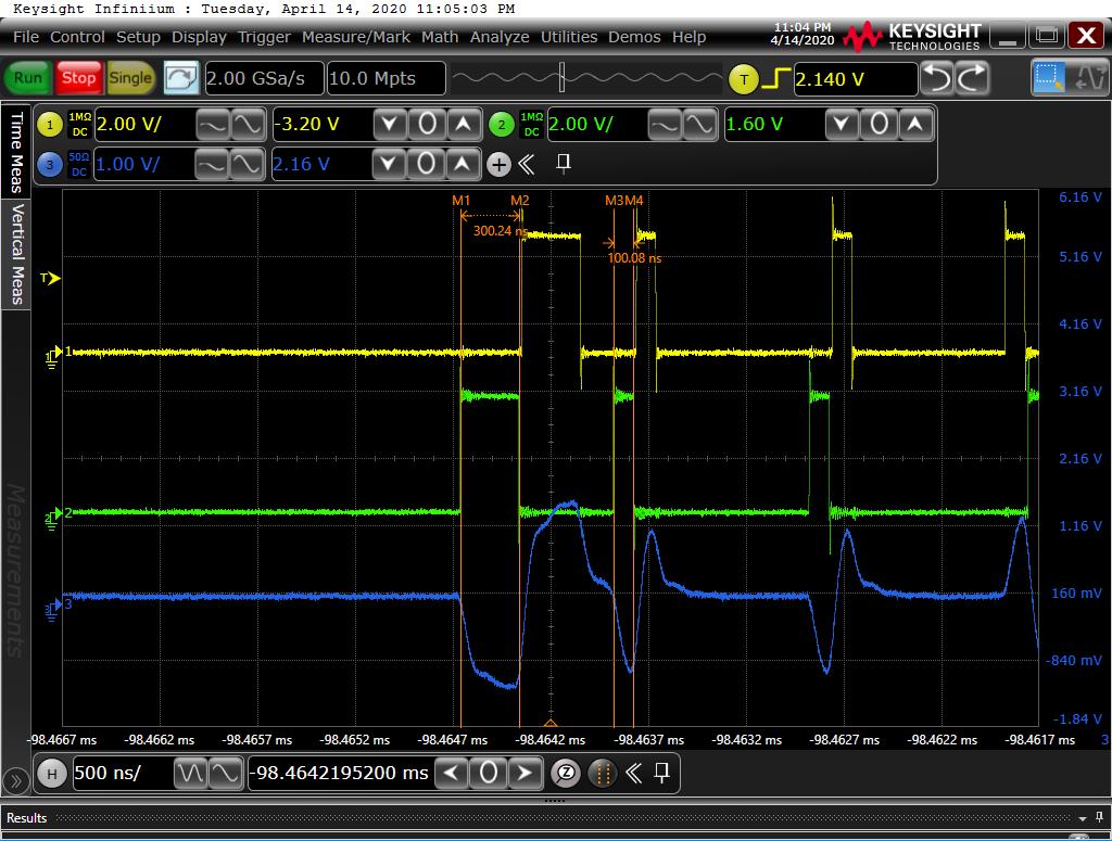

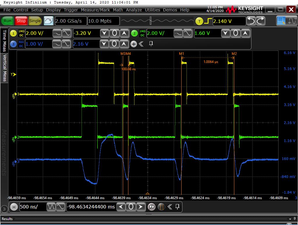

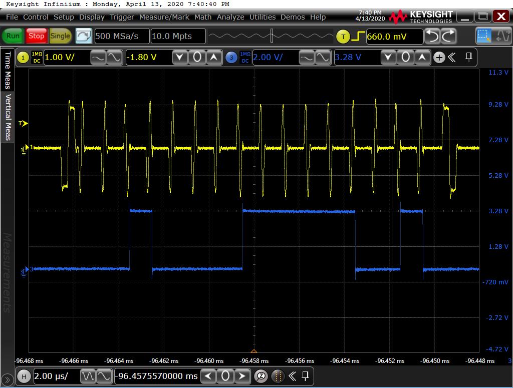

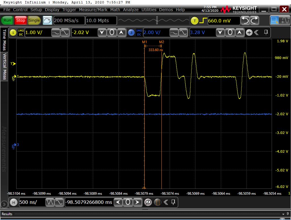

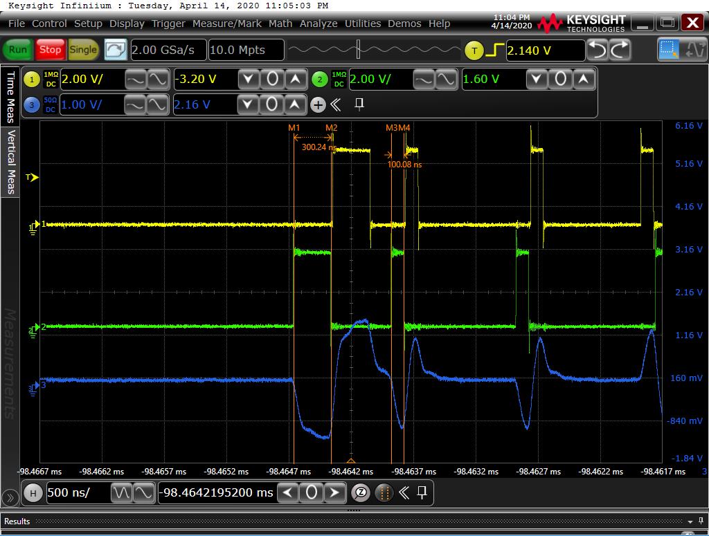

Scope captures. "Umknown" is the pin 4 from above that wakes up when a bms module is connected.

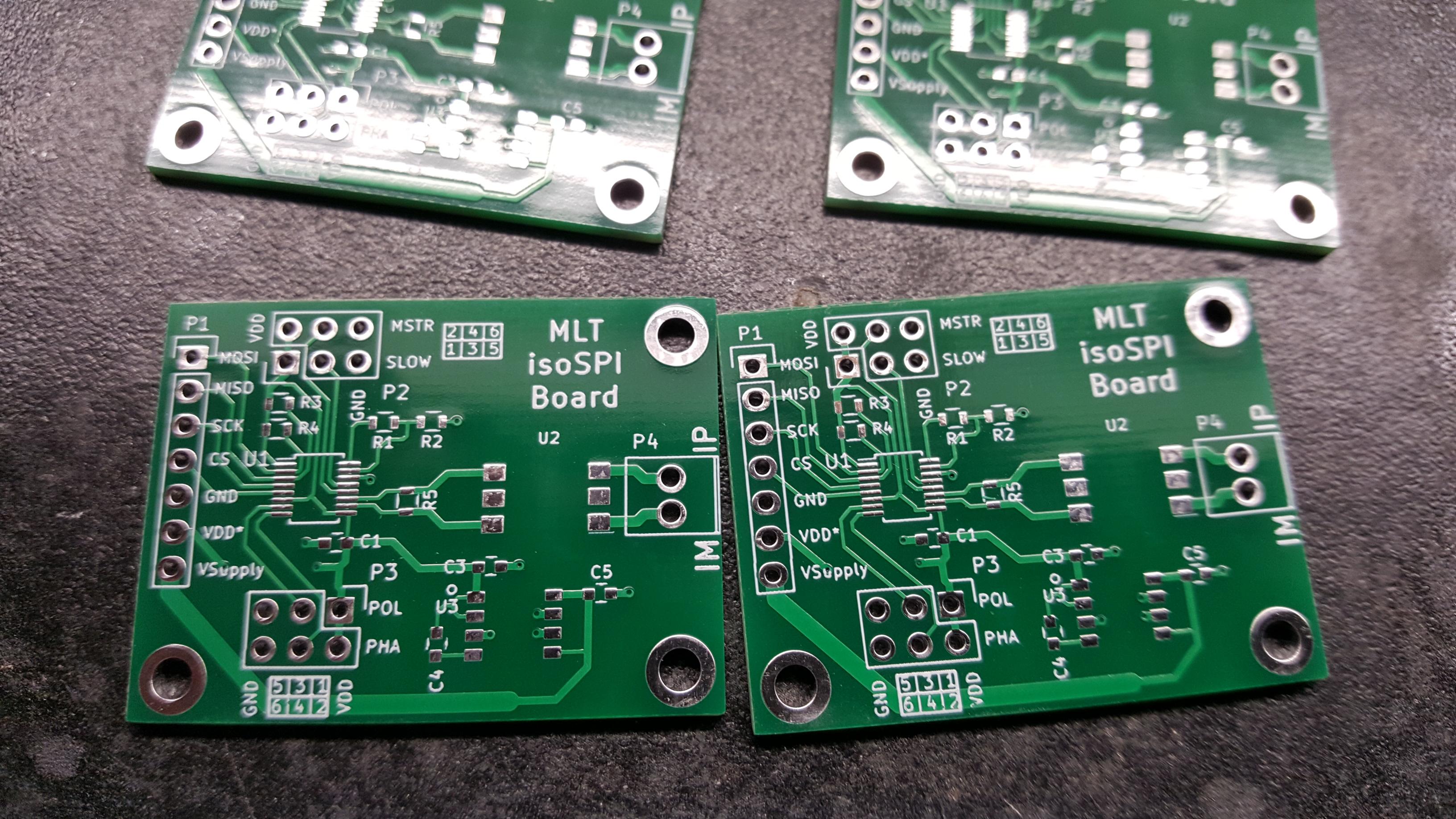

Another delivery from jlcpcb. Let's find out if the LTC6820 speaks the same lingo.
Posts: 4007
Been thanked: 1139 times
Re: Tesla Model 3 Battery Hacking

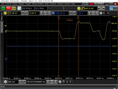

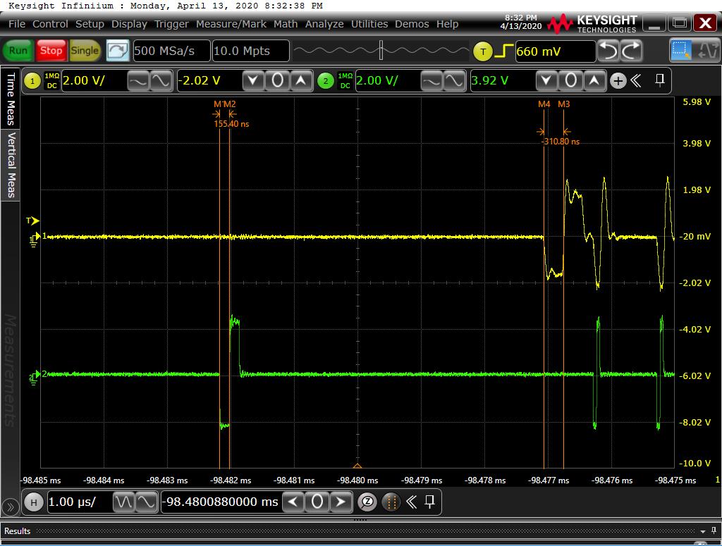

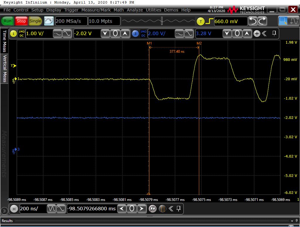

So, I think we have an answer. Short version : The Tesla version of ISO-SPI uses chip select and data pulses with widths far outside of the spec for the LTC6820 so off the shelf LTC hardware will not work with Tesla Model 3 battery modules. Very boring video on the way explaining the findings.

It's interesting that the BATMAN delay you measured on chip select (~5us) is similar to the LTC6820 start up time tREADY (8us max). I wonder if BATMAN is expecting slaves to be in idle mode and waiting for them to wake up? Figure 15 in the LTC6820 data sheet looks interesting and maybe the EN pin has some significance :?
"Figure 15 demonstrates a simple procedure for waking a master (MSTR = 1) LTC6820 and its connected slave (MSTR = 0). A negative edge on CS causes the master to drive IBIAS to 2V and, after a short delay, transmit a long +1 pulse. (If CS remains low throughout tREADY, the LTC6820 would first generate a –1 pulse, then the +1 pulse when CS returns high). The long pulse serves as a wake-up signal for the slave device, which responds by driving its IBIAS pin to 2V and entering the READY state."
Posts: 4007
The pulse widths are the issue. The LTC6820 will reject the Tesla pulses as they are so far outside of spec. Chances are the tesla chips will do the same as the LTC pulses are probably far outside their spec. To talk to these things We'll need the analog front end board above (due from JLC this week) and most likely an fpga.

Very well documented Damien, hats off. I gave up when the LTC6820 solution turned out to be a none starter, did not dig into why.
If they literally increased all the pulses by a factor of 2 I wonder if any of the SPI data still holds true. But then again reverse engineering it will still be possible.

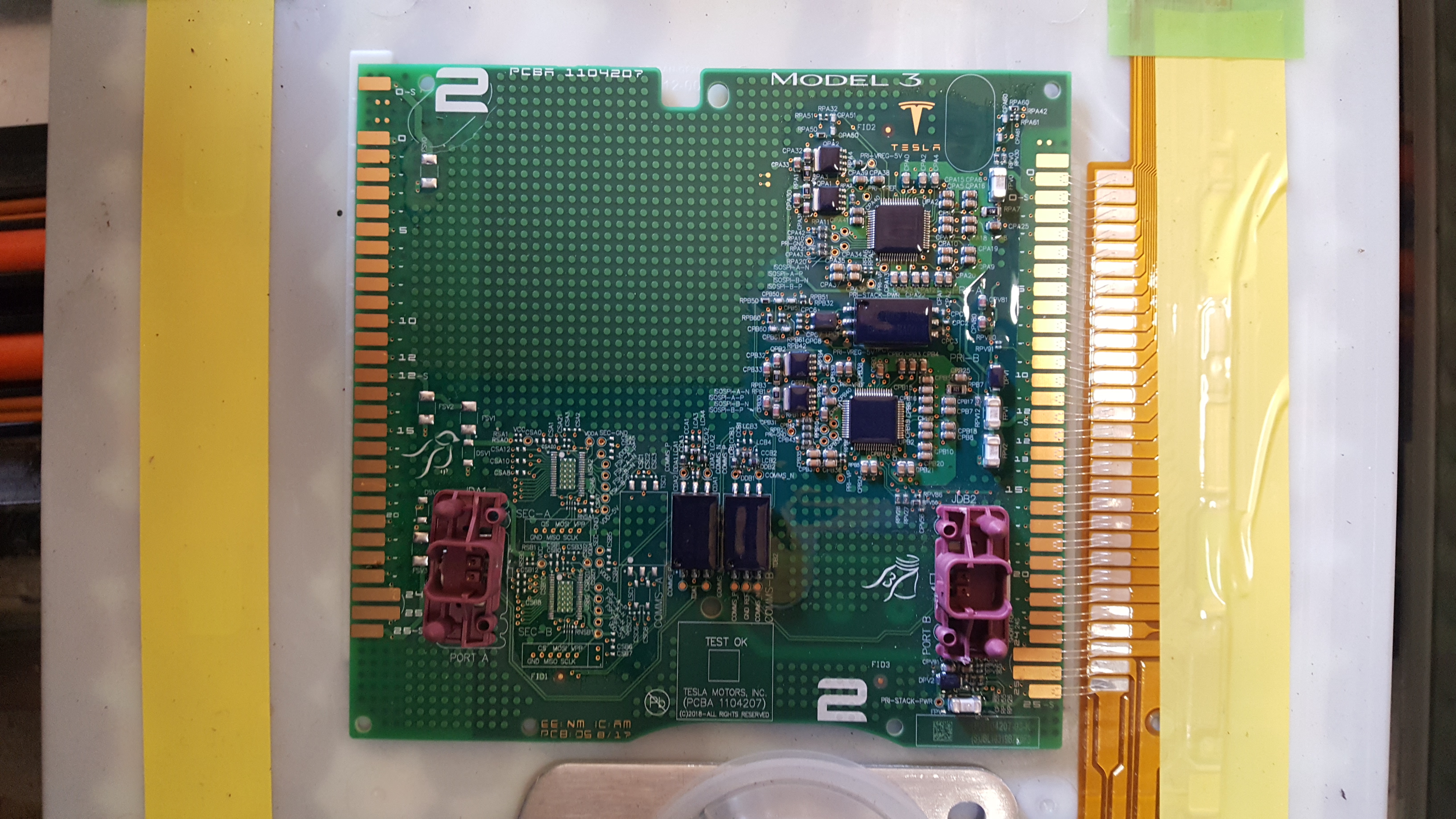

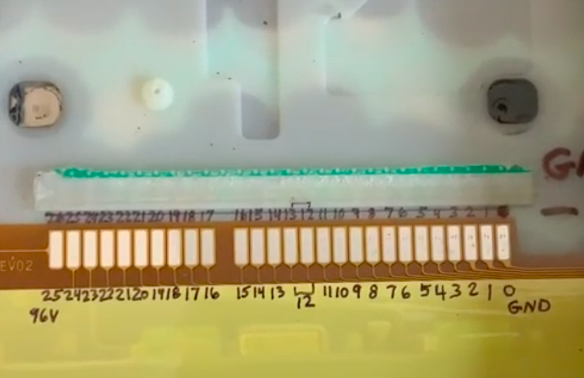

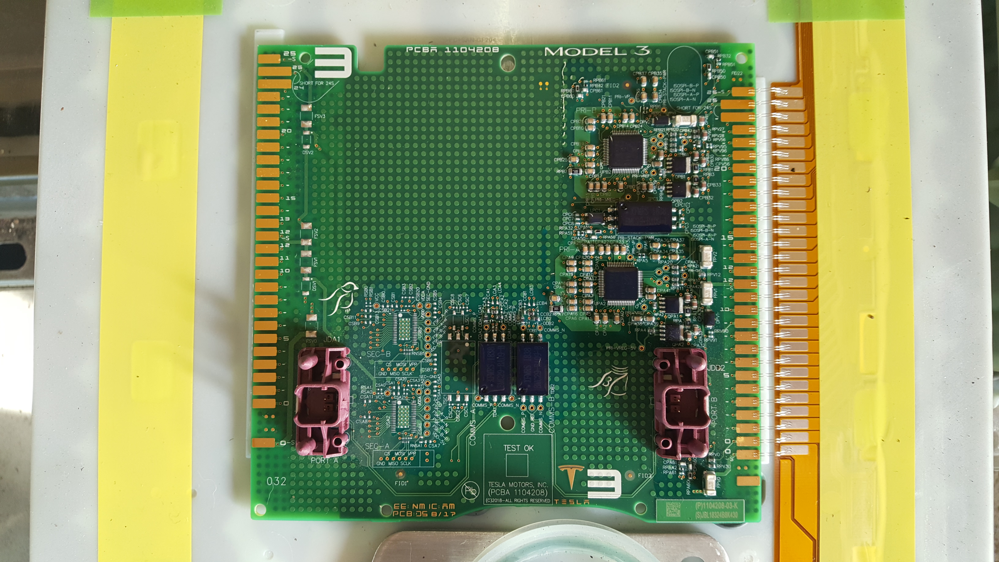

Tesla BMS connector cell count 8-)

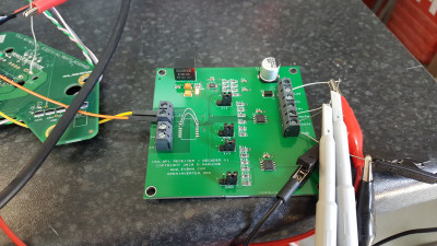

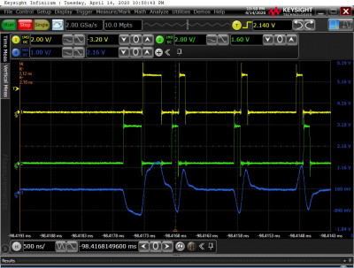

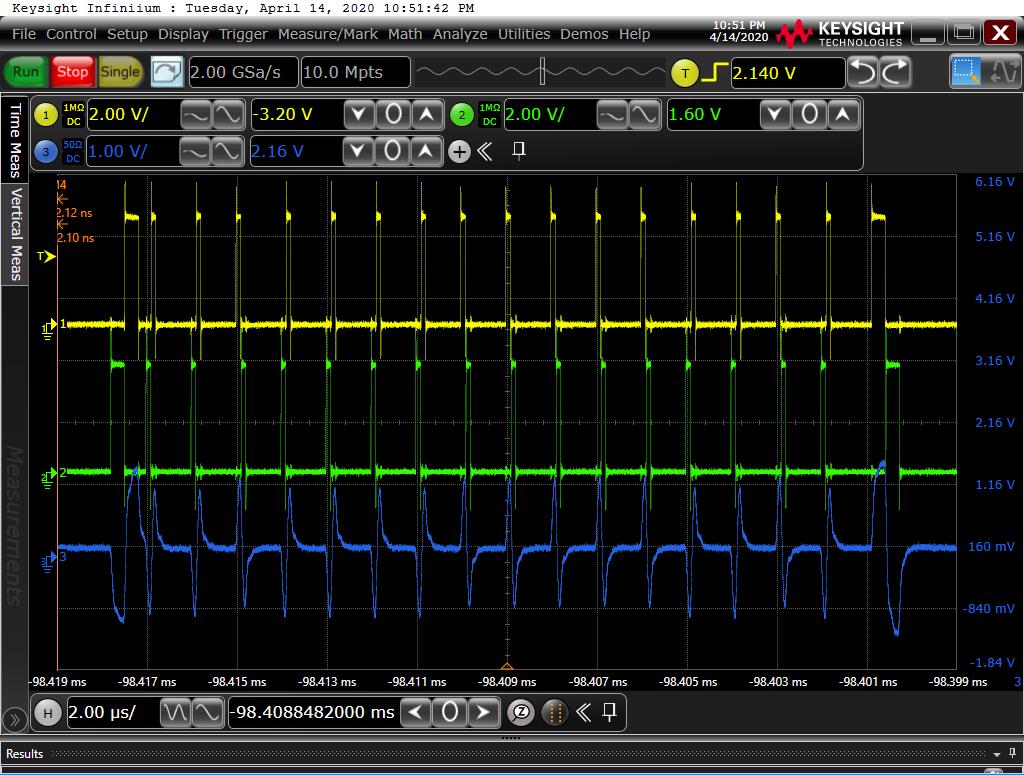

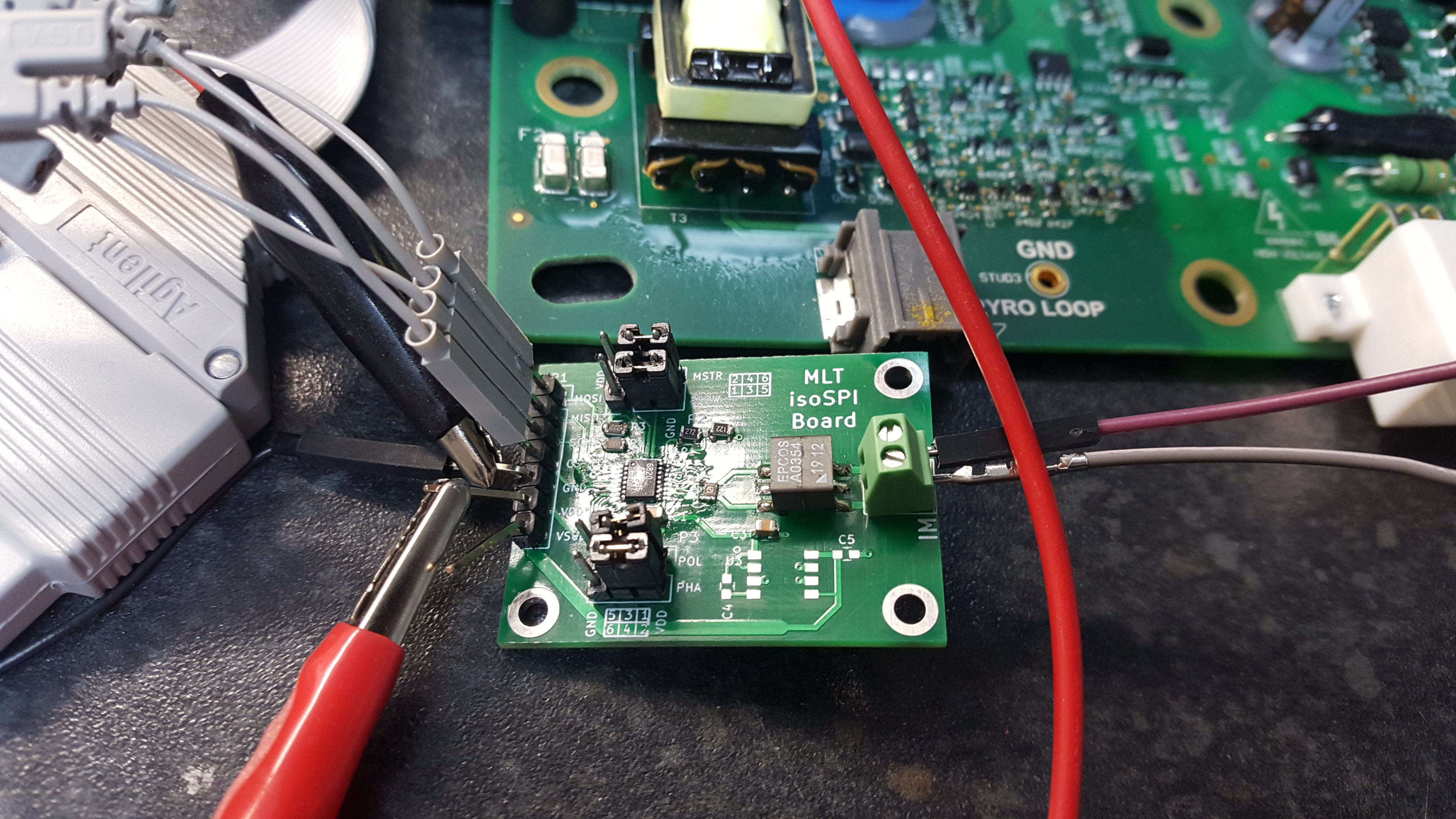

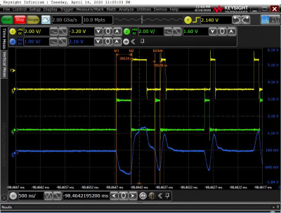

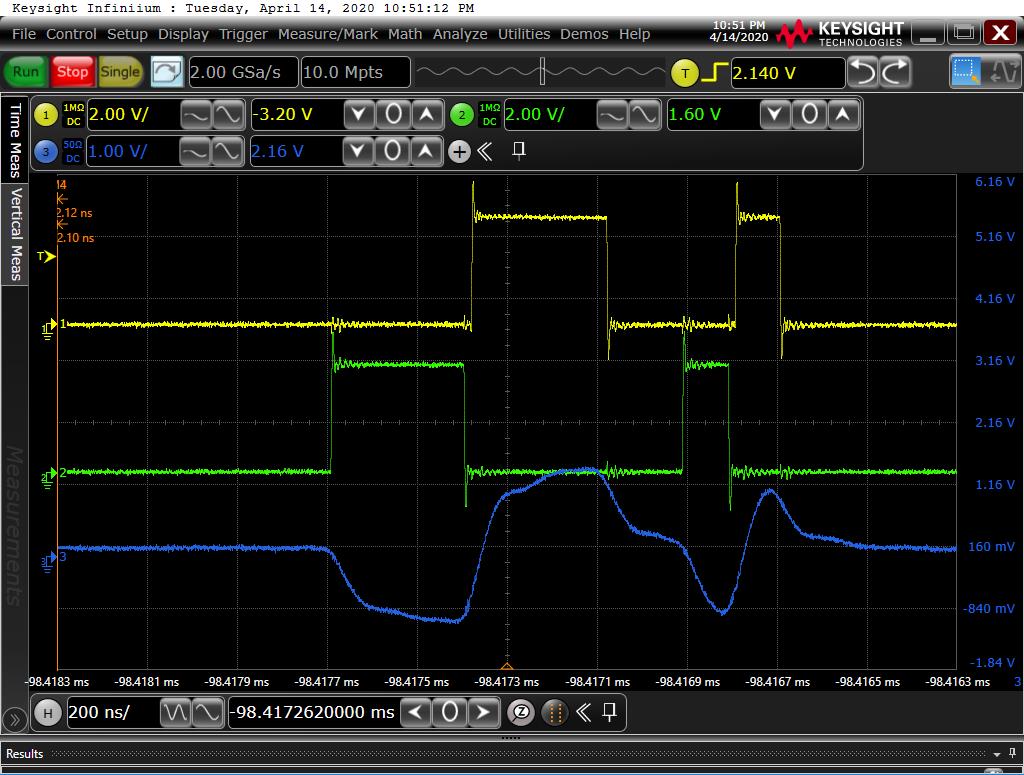

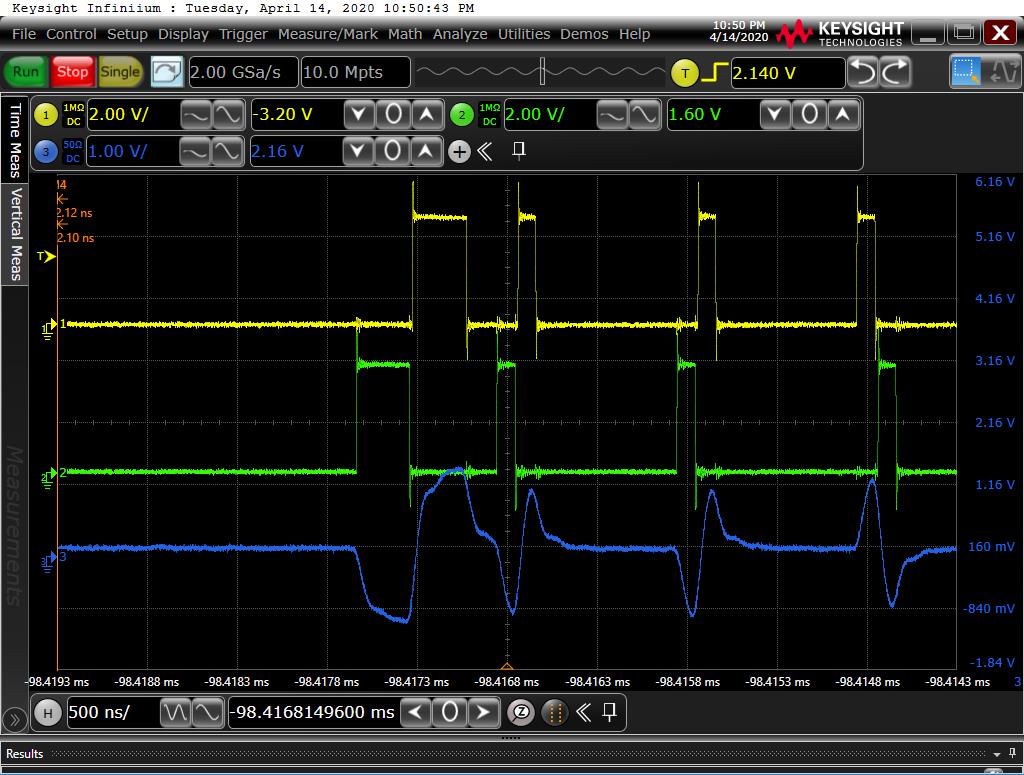

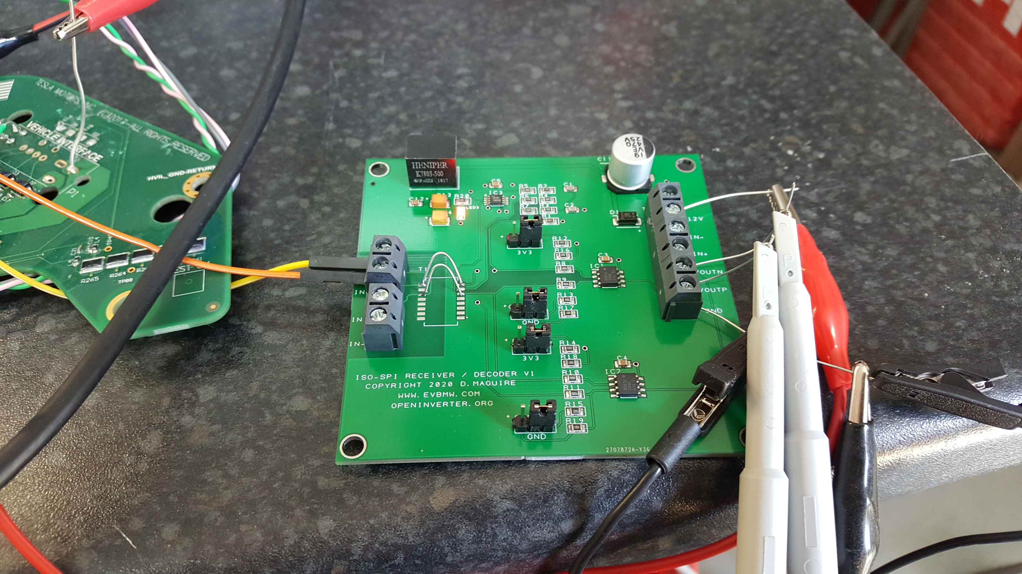

Got my little analog front end boards in from JLC. To my amazement they work:) We can now translate Musk-spi into 3.3v pulses ready to feed into an fpga or micro for decoding into data.

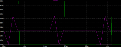

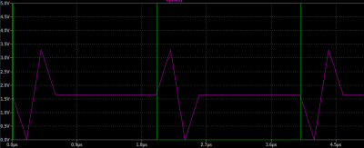

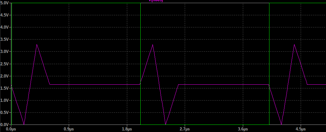

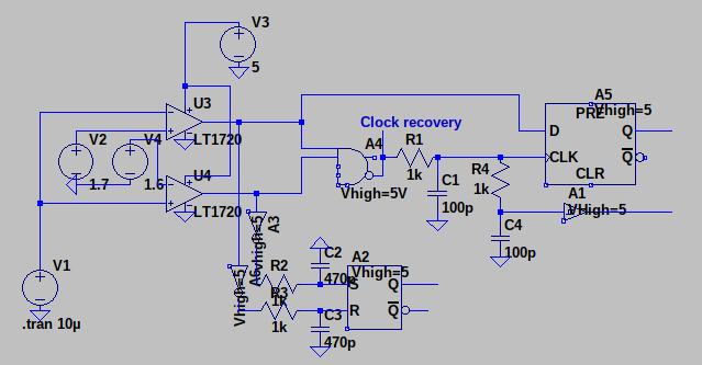

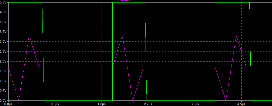

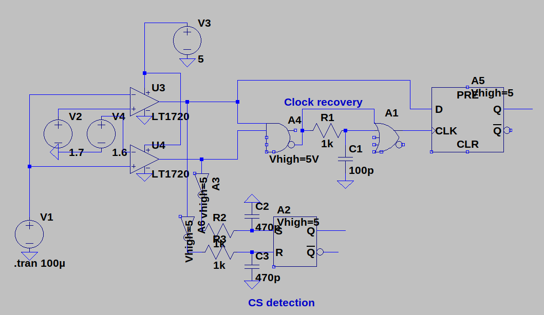

Am I late to the party?
Thought I'd post some ltspice goodness.
This should recover a true SPI data stream with clock, data and CS that can be processed by a standard SPI peripheral.
Been thanked: 1918 times
Delayed clock and removed OR gate
isospi.asc.zip
(1.03 KiB) Downloaded 494 times

Thanks Johannes. Building this will be fun:)

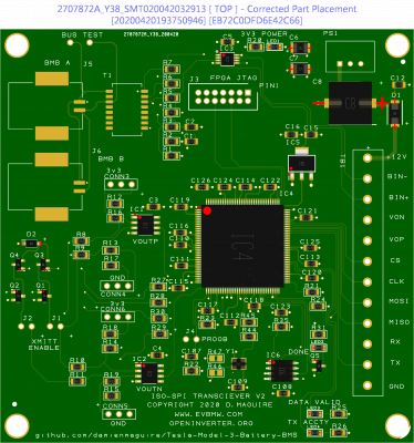

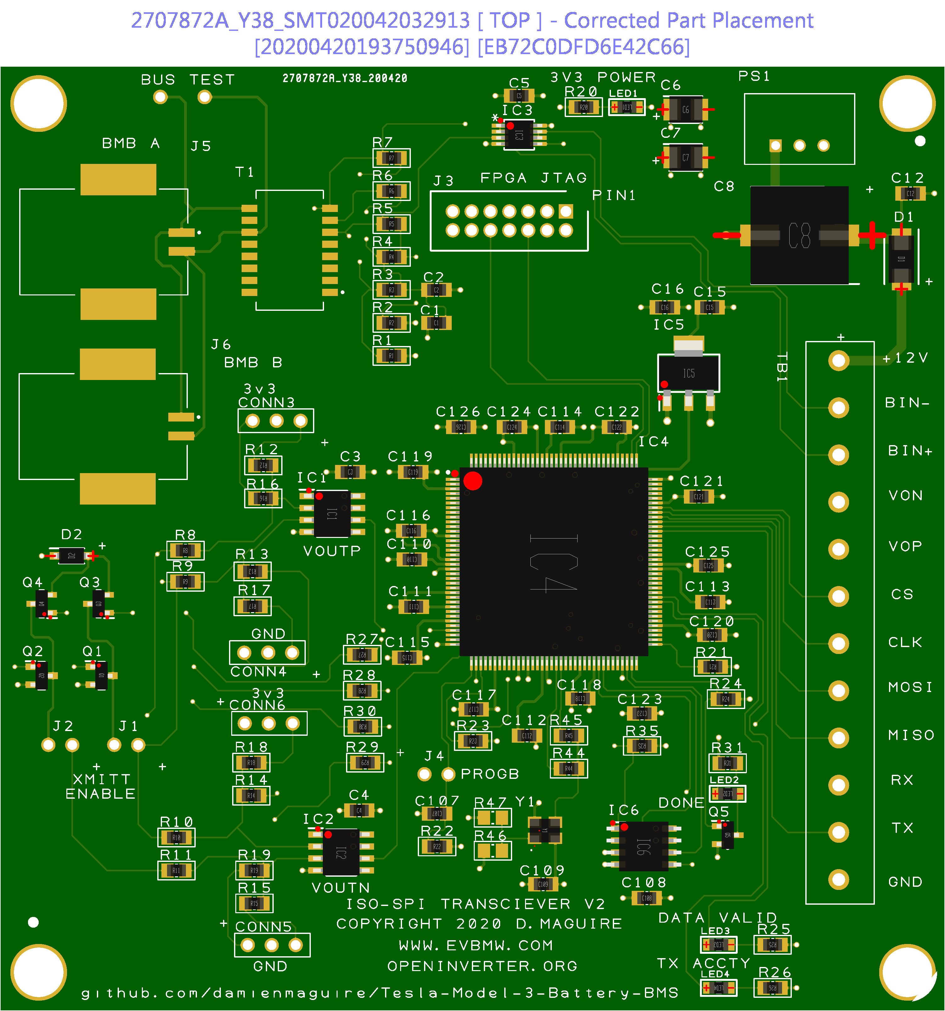

New design transciever board in production at JLC. Based on a Xilinx Spartan 6 FPGA running at 100MHz. Ultimately will provide receive and transmit with spi and uart interfaces. Couple this up to Simpbms and we should be good to go:)
....ok I was going to put a vga port on it but I stopped myself :twisted:

Jack Bauer wrote: Mon Apr 20, 2020 5:26 pm New design transciever board in production at JLC. Based on a Xilinx Spartan 6 FPGA running at 100MHz. Ultimately will provide receive and transmit with spi and uart interfaces. Couple this up to Simpbms and we should be good to go:)
Does this mean I can buy this product within a month?
Thank God! thank you!
retrEVnoc
Posts: 54
Joined: Sun Aug 11, 2019 8:22 pm
Location: CA & OR, USA
Post by retrEVnoc »
Well done JB / DM! Connects to the 2-wire connection from the module boards?
Posts: 4007
Yeah will plug into the existing harness. Of course it probably won't work so don't get too excited just yet:)
