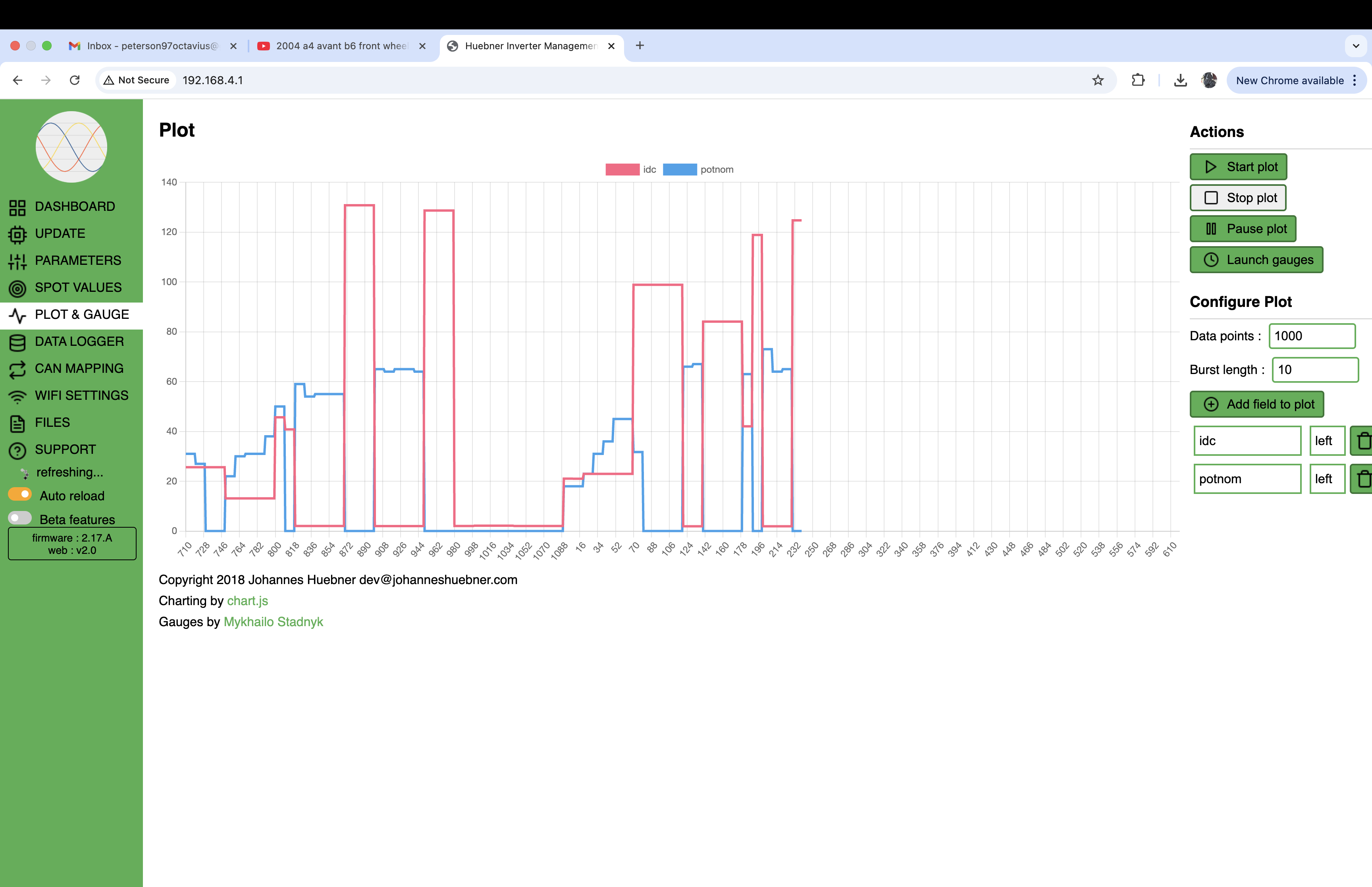

Make a map again of your potnom and idc.
The measurements do not really make alot of sense to me. potnom and idc do not look to be linked as you expect.

Re: GS450H gearbox with Camry inverter G9200-33171
As I taught, have a look at your idcmin and max.
Bump these to like -300 and 300 and test again.
Also charge Throtramp to 1 or 2.
I tried with lower idcmin and higher idcmax, i did have less judder. But it didnt disappear. Throtramp was set to 1, default was 100

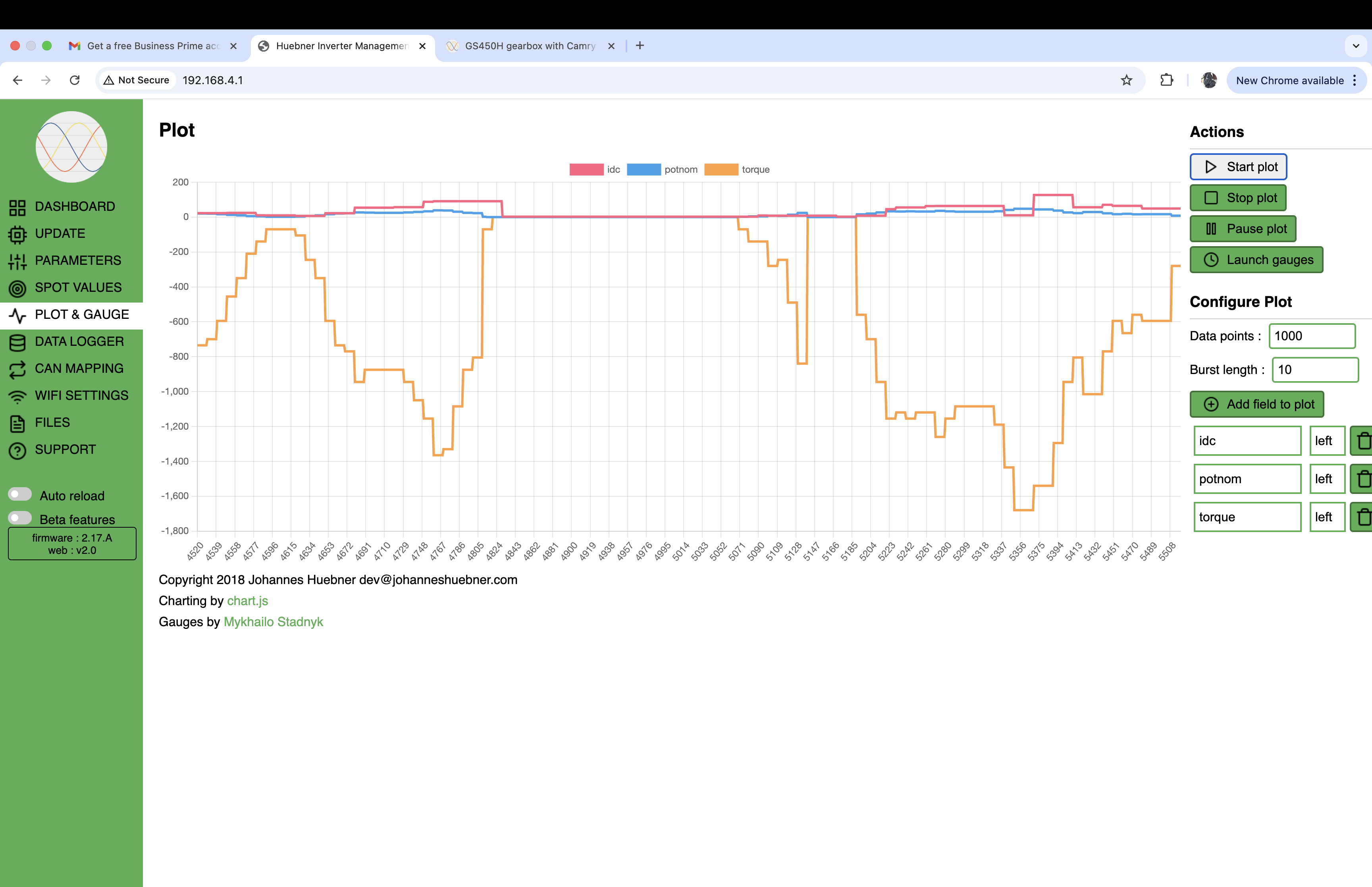

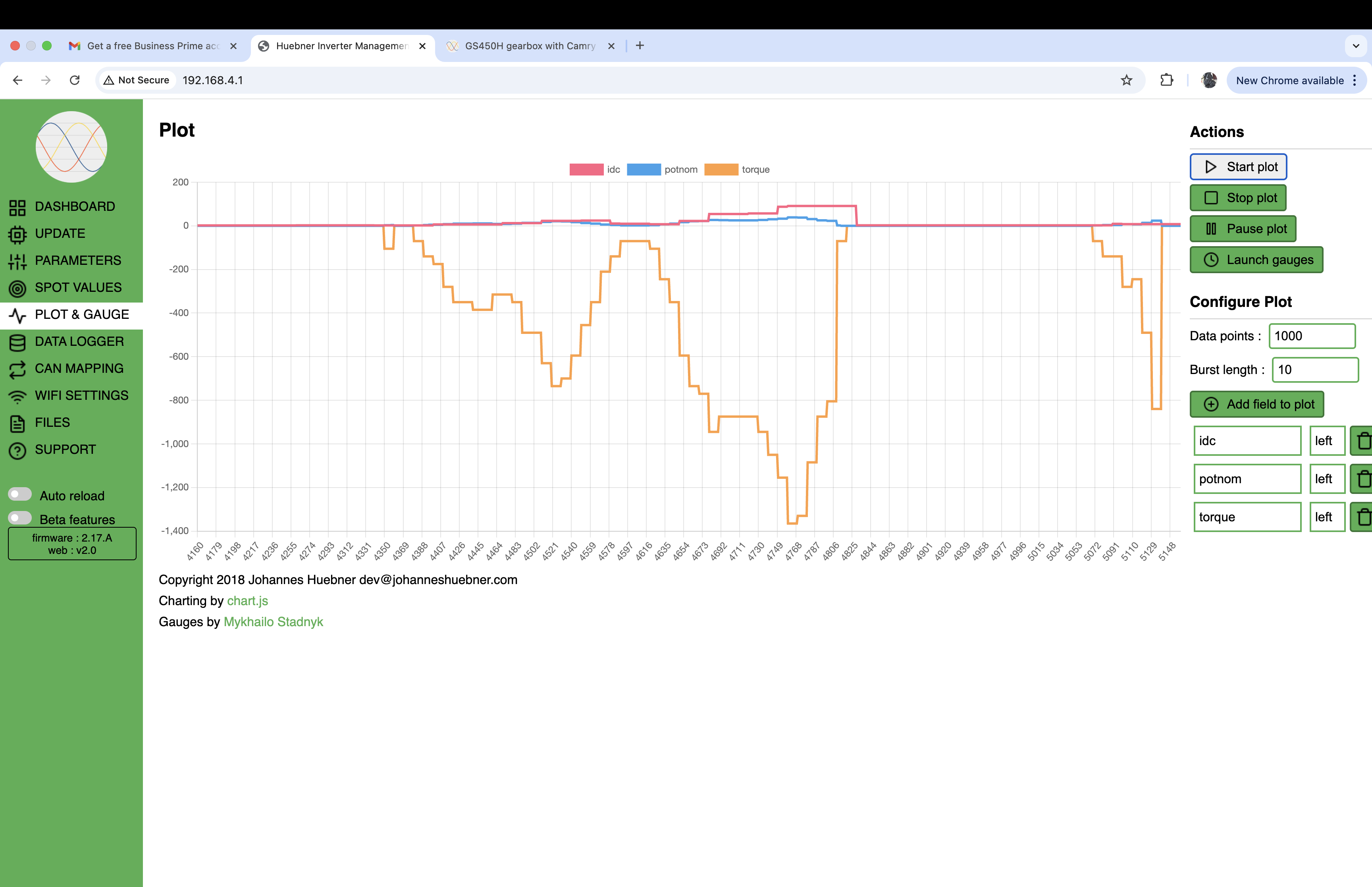

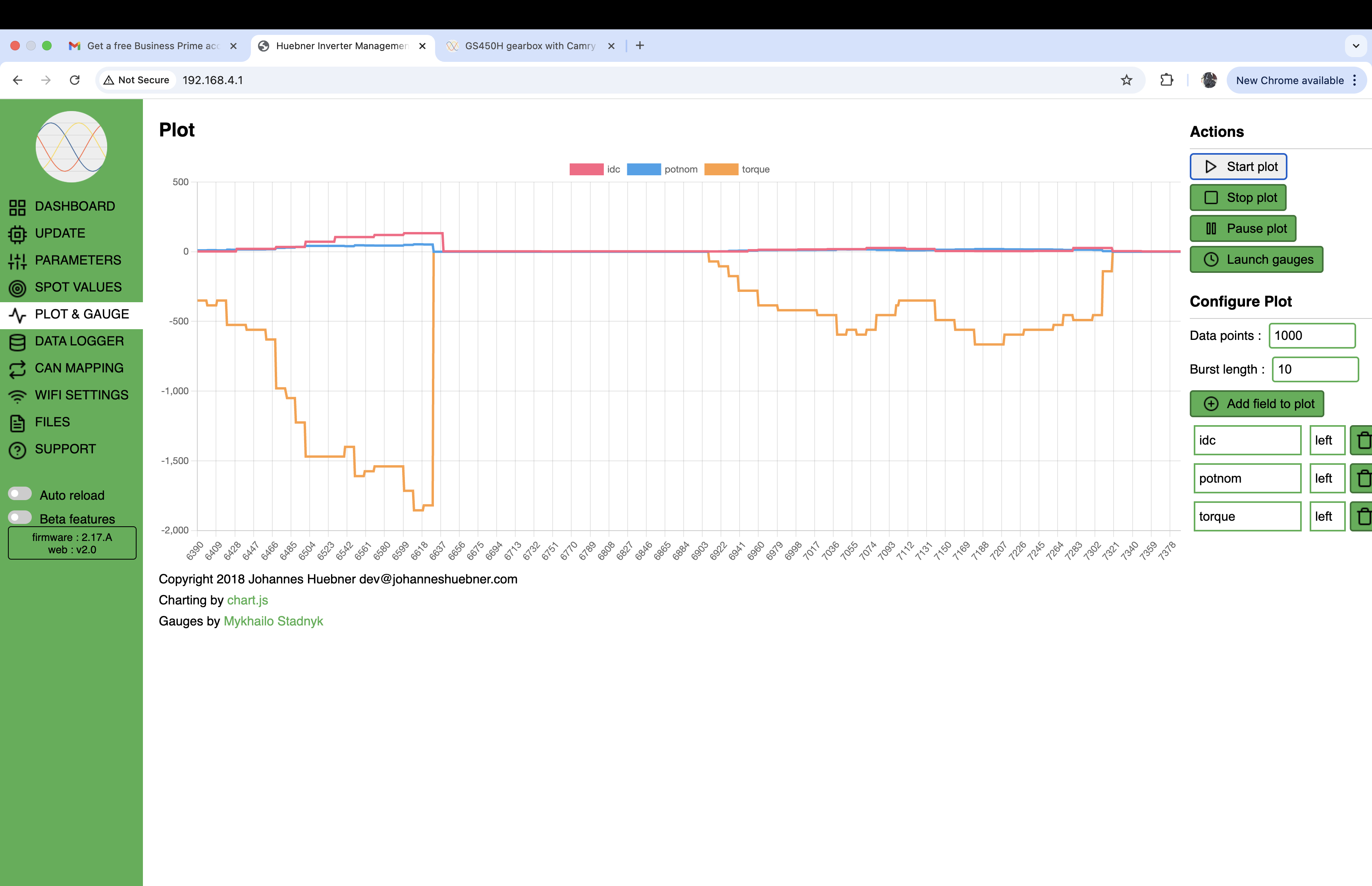

did couple of runs...judder getting less.. but still present
i also plotted torque this time around
negative torque cause the vcu is "in reverse" (wish i could change it)
- Posts: 2962
- Has thanked: 328 times
- Been thanked: 847 times
You need to review why Potnom gets limited. Are you running V2.20A ? This should show you why it delimits if you do not key off.
Try looking at just Potnom and idc again. I do not know the ESP32 CAN enough to tell you how to save graphs/logs from it.

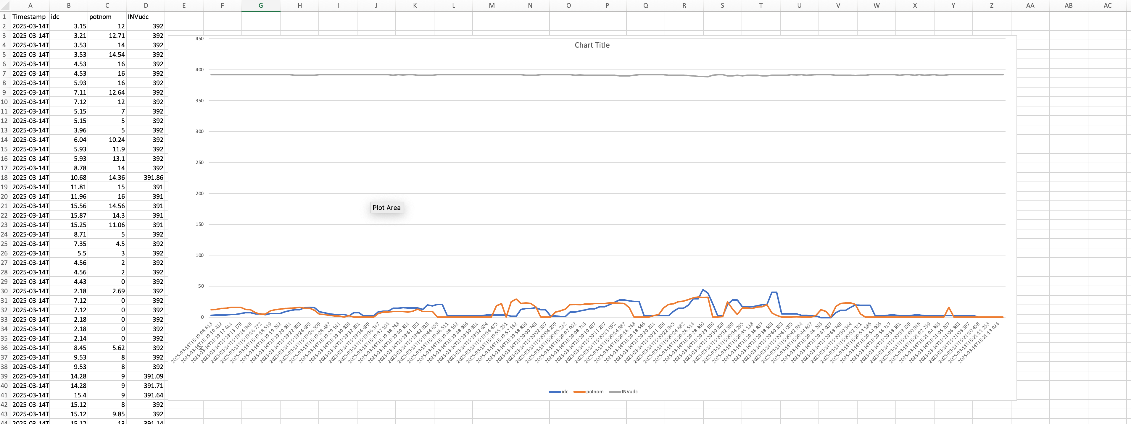

its been a while now, car was park waiting for some new wheel bearings.
i also installed a volvo S40 power steering pump, works right away, i use the cars fuel pump real to enable the pump when VCU runindicatioin i enabled.
went for some test drive today, still jittering...shakes the car pretty rough... i have to let go of the throttle pedal, then it drive fine again for a while. its unpredictable when the shaking will start.
did some data logging, this time with idc, potnom and INVudc.
i added the INVudc since it comes from the inverter, as a way to check if its a communication problem, i had jitters but INVudc was still there.

- log-idc-potnom-invudc.csv
- (6.64 KiB) Downloaded 490 times

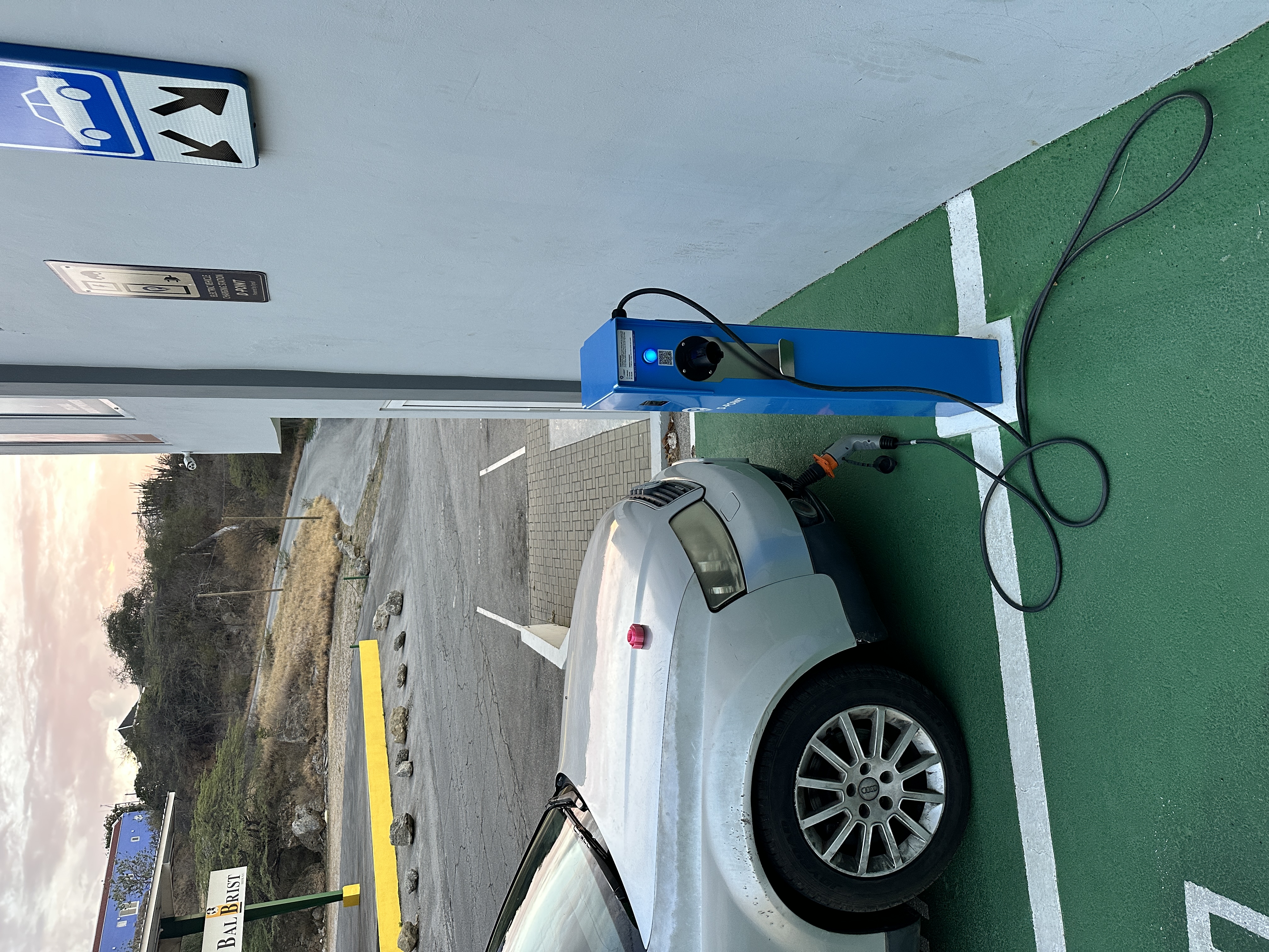

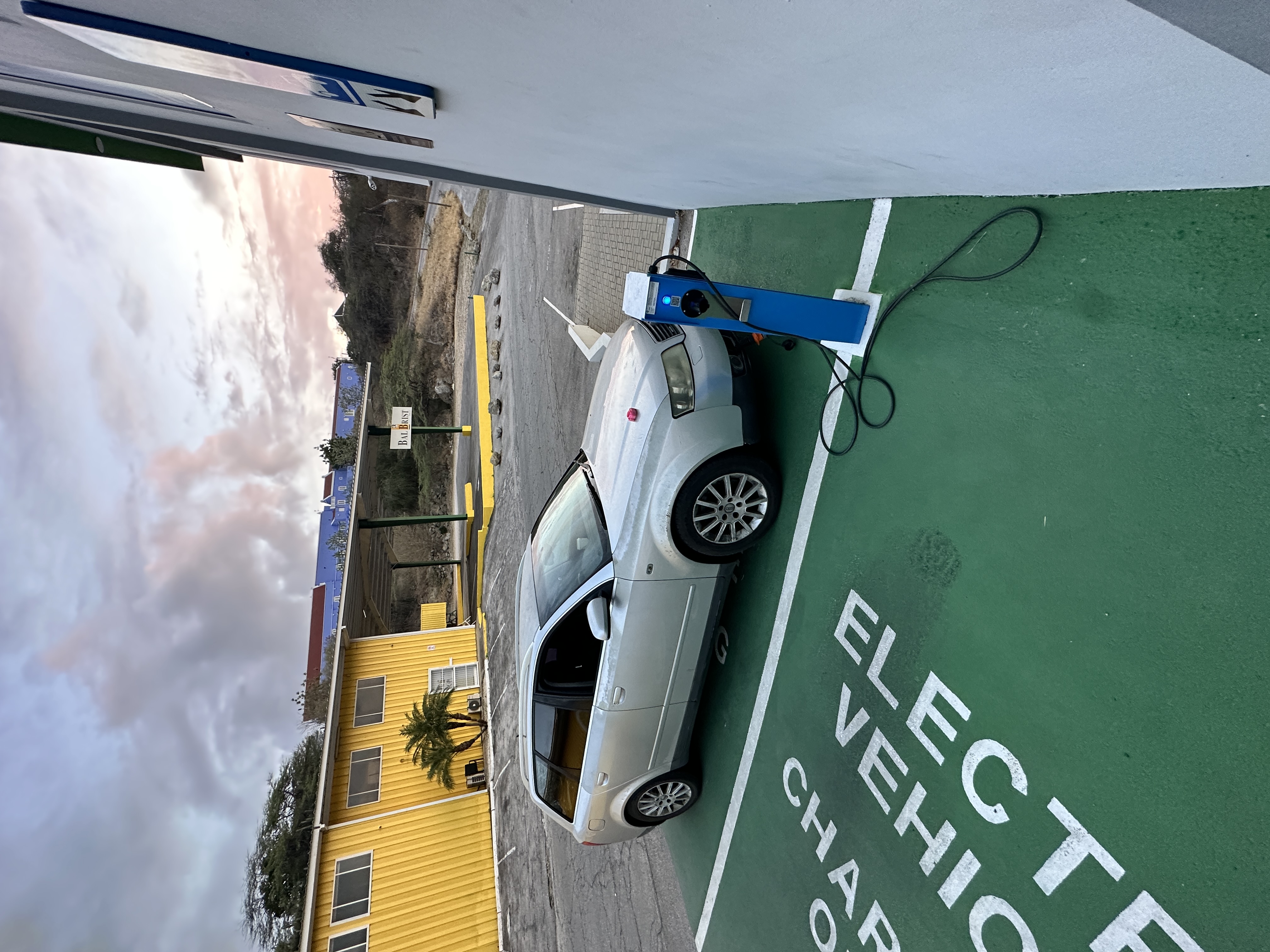

Drove my first 100km on the electric frankeinstein, it all went well.
i also did some public charging, tesla gen 2 charger with the evbmw board works like a charm.
soon i will let an A/C shop clean and fill up the system, then i ll try to get the compressor working.

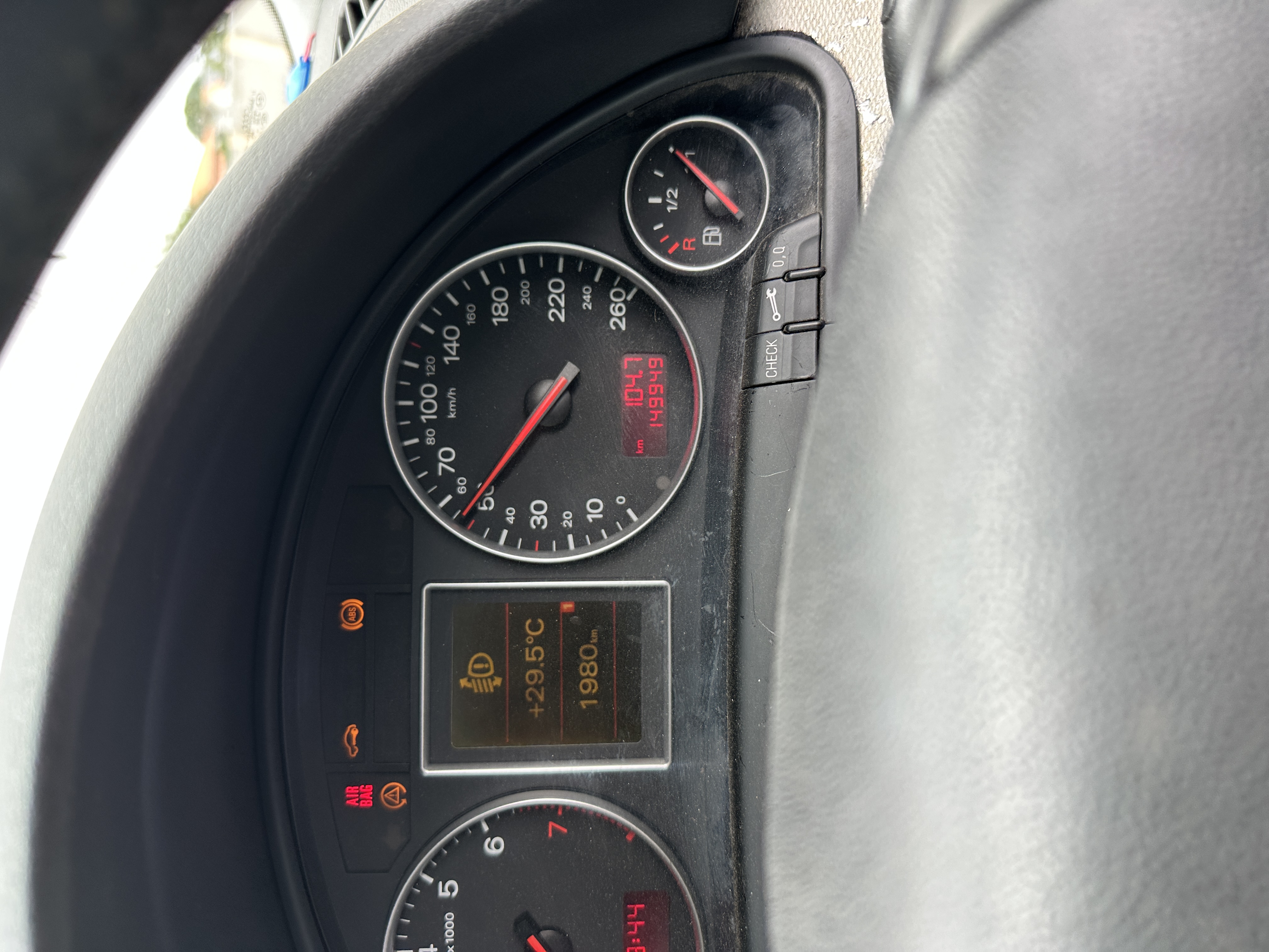

my fuel gauge has 2 input, both need the same resistance for the gauge to show fuel level. how do i make an electric variable resistor? can i use an arduino for that? i already have an ESP32 getting CAN messages and displaying it on a screen
- Been thanked: 1913 times
Great work!
It's probably the same fuel gauge as Touran. I use 2 BC547 transistors with 10k base resistor and 1uF low pass capacitor. I then PWM with 18 kHz.
You start out with both duty cycles at the same value until you reliably get the fuel gauge in middle position. Then as you increase one channel you decrease the other one by the same amount to move it around.
Once it detects invalid resistance it bottoms out and you have to power cycle the car
