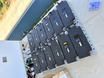

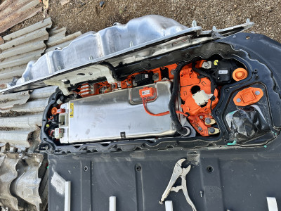

Happy new year all !!!

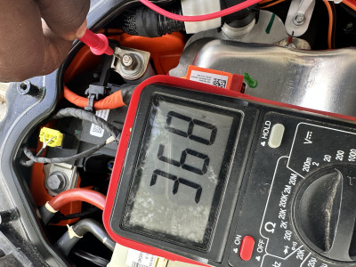

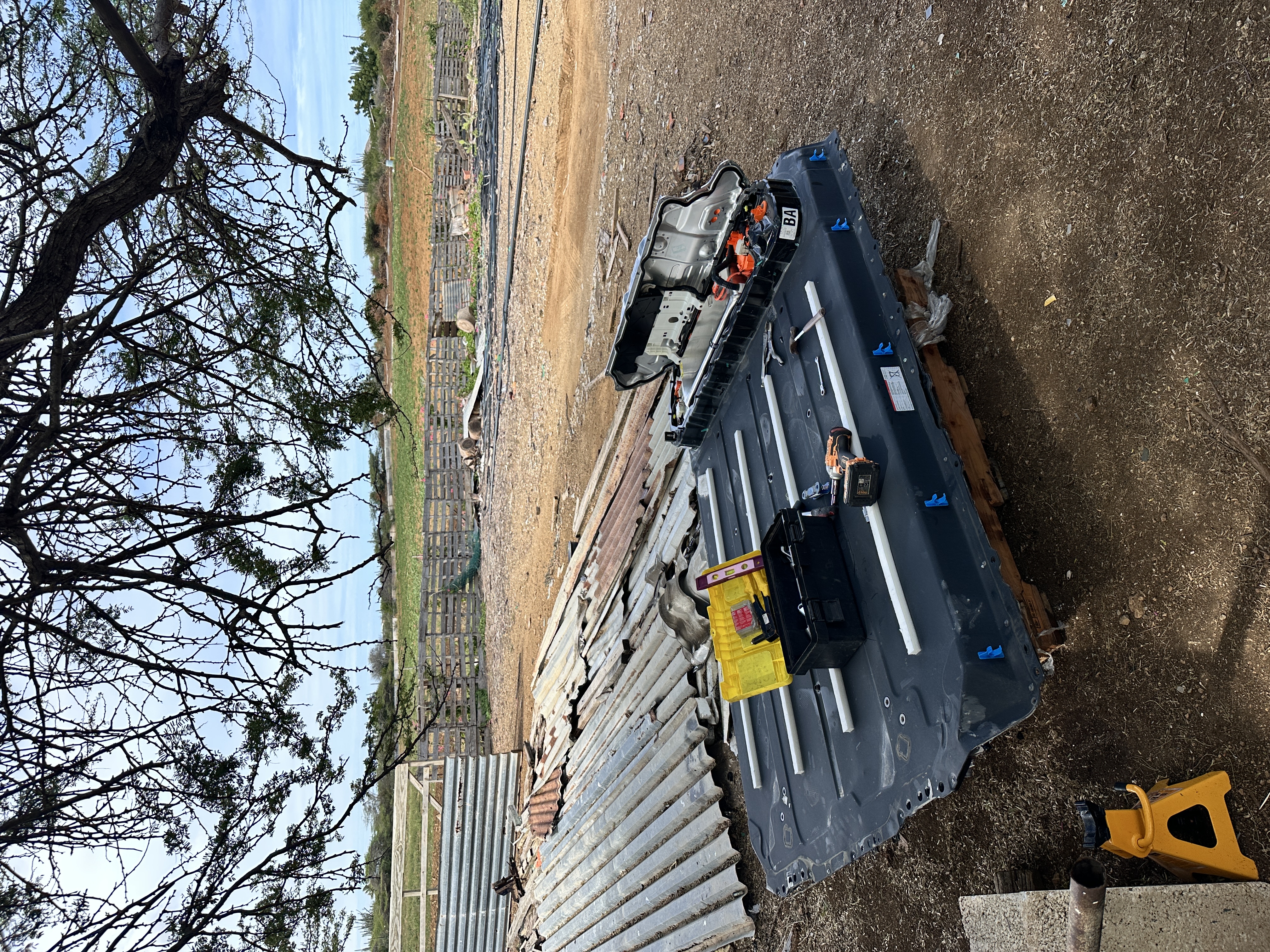

a friend of mine has a tesla model y, i think its from 2020. his battery pack would not charge anymore, due to imbalance of a cell i think.
he bought anothe full pack an replaced it. soo i bought the whole pack from him. for 2500 guilders, that s around 1375.00 usd. that s a steal if you ask me. but yeah no one on the island would know what to do with it.
sadly its a model y pack, soo long modules that wont fit in the car. i will try to rebuild the module and of course find the bad cell to remove it.
can i use the oem bms? battman? Damien's board is still in development i think. i read somewhere that you could talk or at least listen to the oem bms but i cant find the thread.
- Posts: 2753
- Location: Bristol
- Has thanked: 264 times
- Been thanked: 717 times
Re: GS450H gearbox with Camry inverter G9200-33171
good luck you will fail. You should have done more research before paying money for the pack that is fully glued together.
- Posts: 6968
- Has thanked: 454 times
- Been thanked: 1771 times
EV clinic do it but it looks like a process that needs a lot of practise

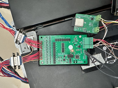

The car came with an electric brake vacuum pump, which i want to use of course.
the pump relay needs a ground connection to run. which i found in the diagram, pin 22. tested it, the pump runs.
however, there is a brake vacuum sensor attached to the master cylinder. it has 3 pins. according to the picture above:
pin 1 of the sensor goes to ground (not shown in the picture but i did test continuity in real life)
pin 3 goes to 5volts (D141 connection)
pin 4 goes to pin 18 on the oem ECU.
from the zombie, i connected 5v to pin 3 of the sensor and gnd to pin 1.
pin 4 i connected to GPA1 which i think is analog in, and the relay enable pin i connected to GPout3.
but i get no reading on the web interface.
did i think the sensor work too simple? so this is not a resistive sensor?
below i attached a picture of the sensor

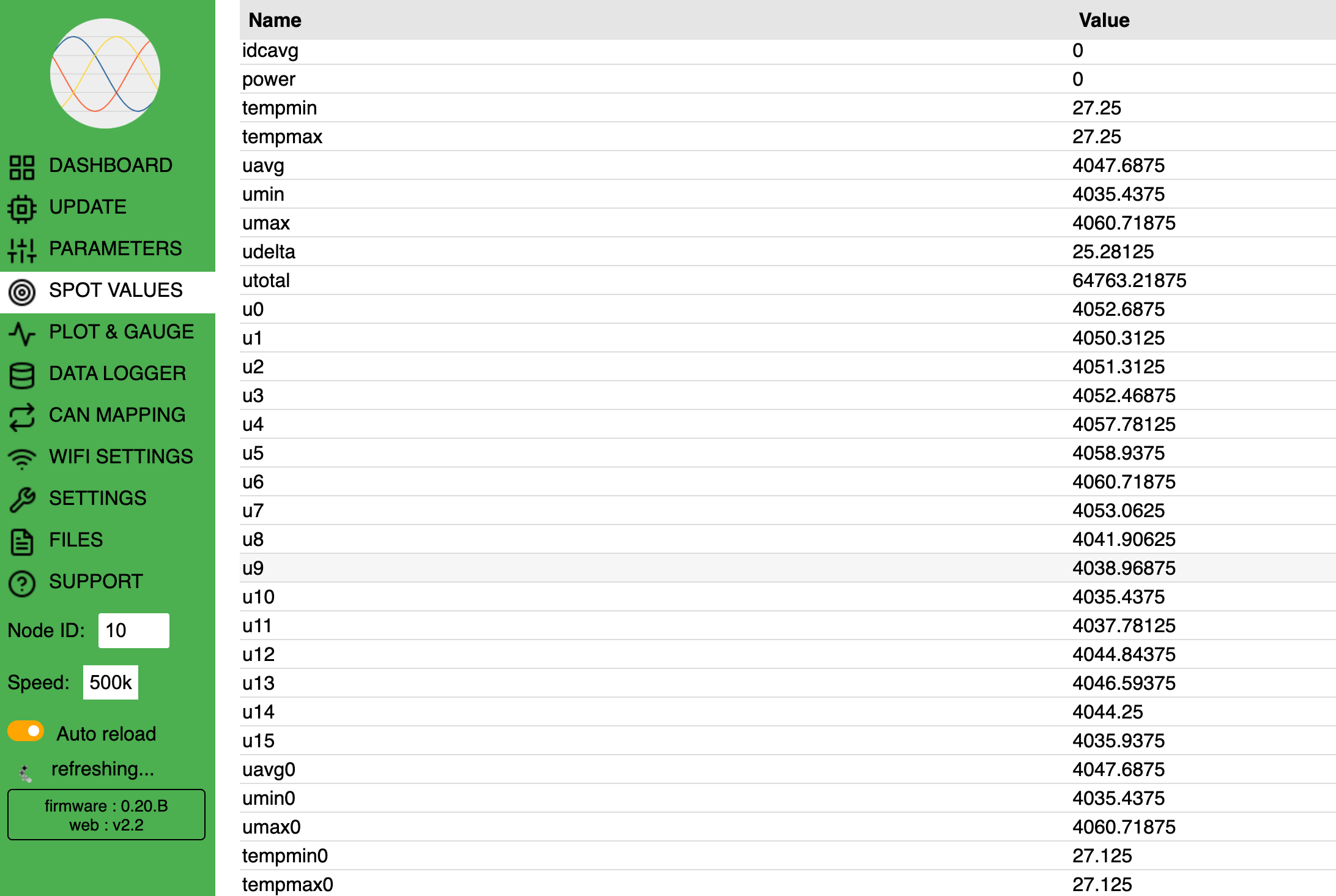

While working on the battery boxes, i'm also configuring my Flying ADC Bmses.
Im using Samsung SDI battery modules from battery hookup for now.
they a 67Ah cells, they come in modules of 8s. i have 12 of those module to make 96s1p. in theory 24kWh.
they are rated at 3c ...3 x 67 = 201A peak. im not going to the track so i will limit my idc max to 100A or even less.
i just need to be able to cruise at 80kmh (not mph). not many "highways" on the island.
lucky enough, they came with temperature sensors installed. each module has 4 sensors.
my configuration will be 2x8s modules per bms board. 1 temp sensor from each module as the bms only has 2 temperature sensor inputs.
i upgraded my bms boards from 0.16 to 0.20B, to my surprise the default setting of 10000 of for temperature sensing worked right away.
i could watch my tempMin go up on savvy can as i held a light to the temperature sensor's metal tab.
SDI modules : here's a screenshot from the web interface with some values showing my test setup : params:

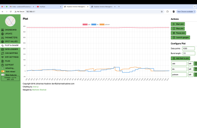

i did a test drive today with the full battery pack installed, went well. i can confirm that the zombie vcu can control a camry inverter with the GS300H settings, connected to a GS450H gearbox.
but in my case, the rear differential's direction is opposite.
when i put the zombie in drive it spins the gs450h, clockwise which is normal. but my rear differential spins the wheel backwards. so in a sense fwd is reverse and reverse is fwd. i tried changing the phase cables but then MG2 wouldnt spin.
so i was okay with the idea of the reverse and fwd mixed up.
in the settings i changed throtmaxRev from the default 30 to 100.
but when i put the zombie in reverse to go forward, i get jitters. when i plot potnom and idc i realized when 30% potnom is reached, it drops to 0, idc also drops.
im running version 2.17A because with 2.20 i get weird behaviours like gearbox spinning without pressing the throttle.
2.17A has issues with resets triggering on GS300h gearbox that cause a judder.
You are running the GS300h? code are you sure you oil pump runs when driving?
There are very many reasons why your throttle behaves that way, you need to provide more logs and check things like error spot values.
Things like calibrate your throttle and setup all the limits propperly based on your setup.
In 2.20A the GS300h inverter currently does not work so I am surprised your Camry inverter works.
Big unkown in all of this what are the communication differences between the GS300h and Camry inverter, could be none, small or big.
Yes, the oil pump starts on the inverter power trigger.
Its the loudest thing in the car right now, i don t know where to get new bearings for the pump. If i turn it off, the motor spins but the car doesnt move
My throttle is calibrated, i dont get no errors either. When in drive (the car moves in reverse) i dont get the sudden potnom drop
