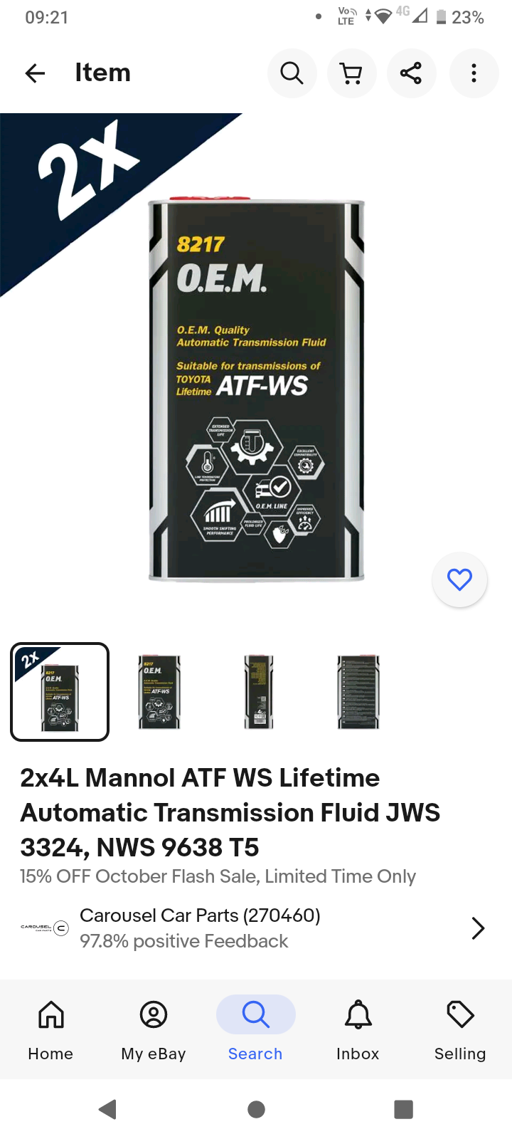

does anyone have a recommendation for transmission fluid to put into this lexus 300h drivetrain other than the silly expensive toyota one ?
fully synthetic Dextron VI seems to be an alternative and less than half the price

rstevens81
Posts: 377
Location: Bristol, UK
Has thanked: 29 times
Been thanked: 111 times
Re: [WIP] BMW Z3
Post by rstevens81 »
Just put ATF ws into you favourite online shop .. and Toyota hybrid ones sem to appear e.g.
https://www.ebay.co.uk/itm/303170596863 ... media=COPY
Added pic for future ref
Westway lubricants are quite good for specialist oils (British company.... But it's a toyota was comparable oil but not listed specifically for hybrids...
https://www.westwayoils.co.uk/products/ ... 4634&_ss=r

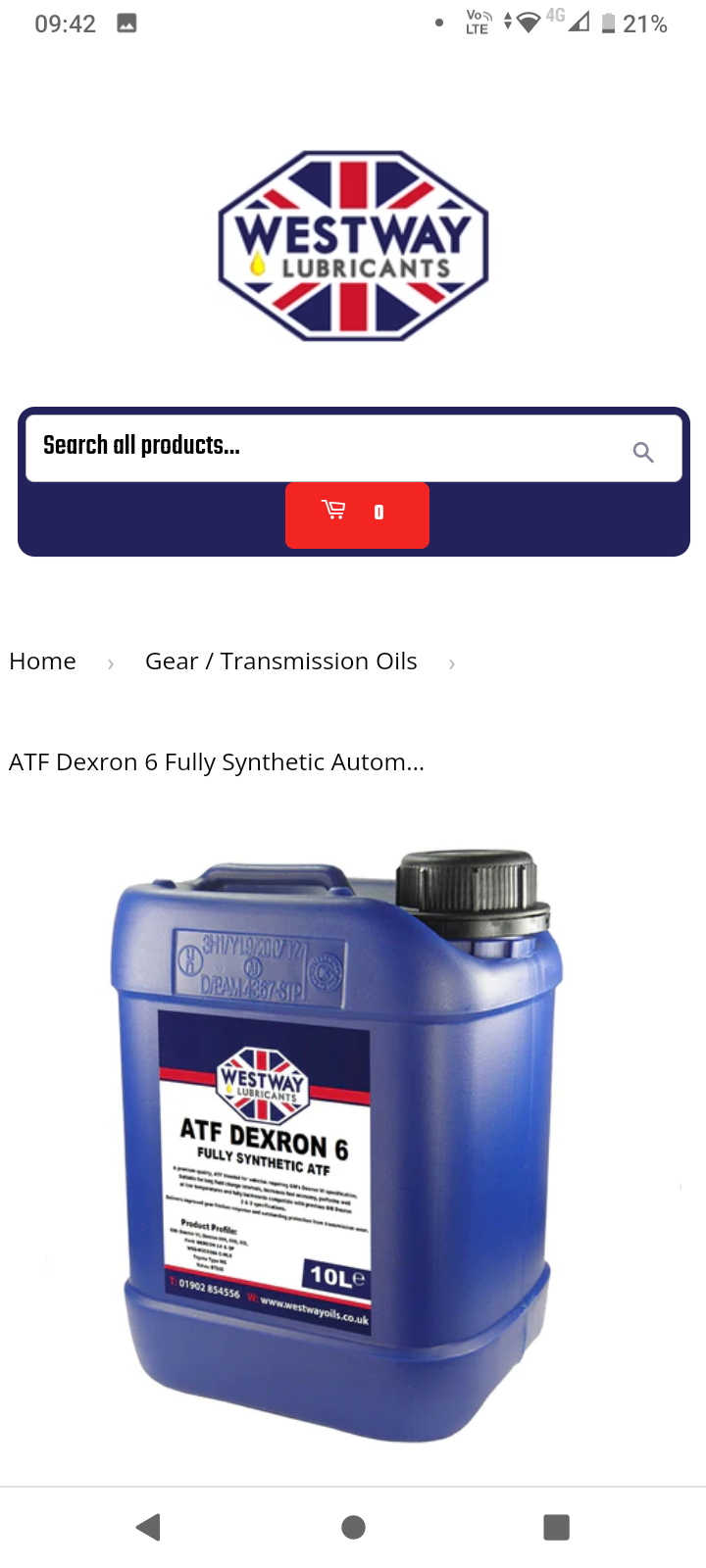

andybpowell
Posts: 333
Location: Southend,essex,uk
Has thanked: 217 times
Been thanked: 257 times
Re: [WIP] BMW Z3
Post by andybpowell »
rstevens81 wrote: Thu Oct 19, 2023 8:46 am Just put ATF ws into you favourite online shop .. and Toyota hybrid ones sem to appear e.g.
yes the westway one is the one I'm considering I was just seeing if anyone had a recommendation really :)

celeron55
Posts: 804
Has thanked: 38 times
Been thanked: 136 times
Re: [WIP] BMW Z3
Post by celeron55 »
What I did for my GS450H gearbox was I went to a parts store and asked for ATF for a Prius. They sold me some kind of aftermarket "WS compatible" fluid of their own brand. I mixed it in with whatever was in the gearbox. I think it's gonna be fine for a long time. I would do the same for the 300H.

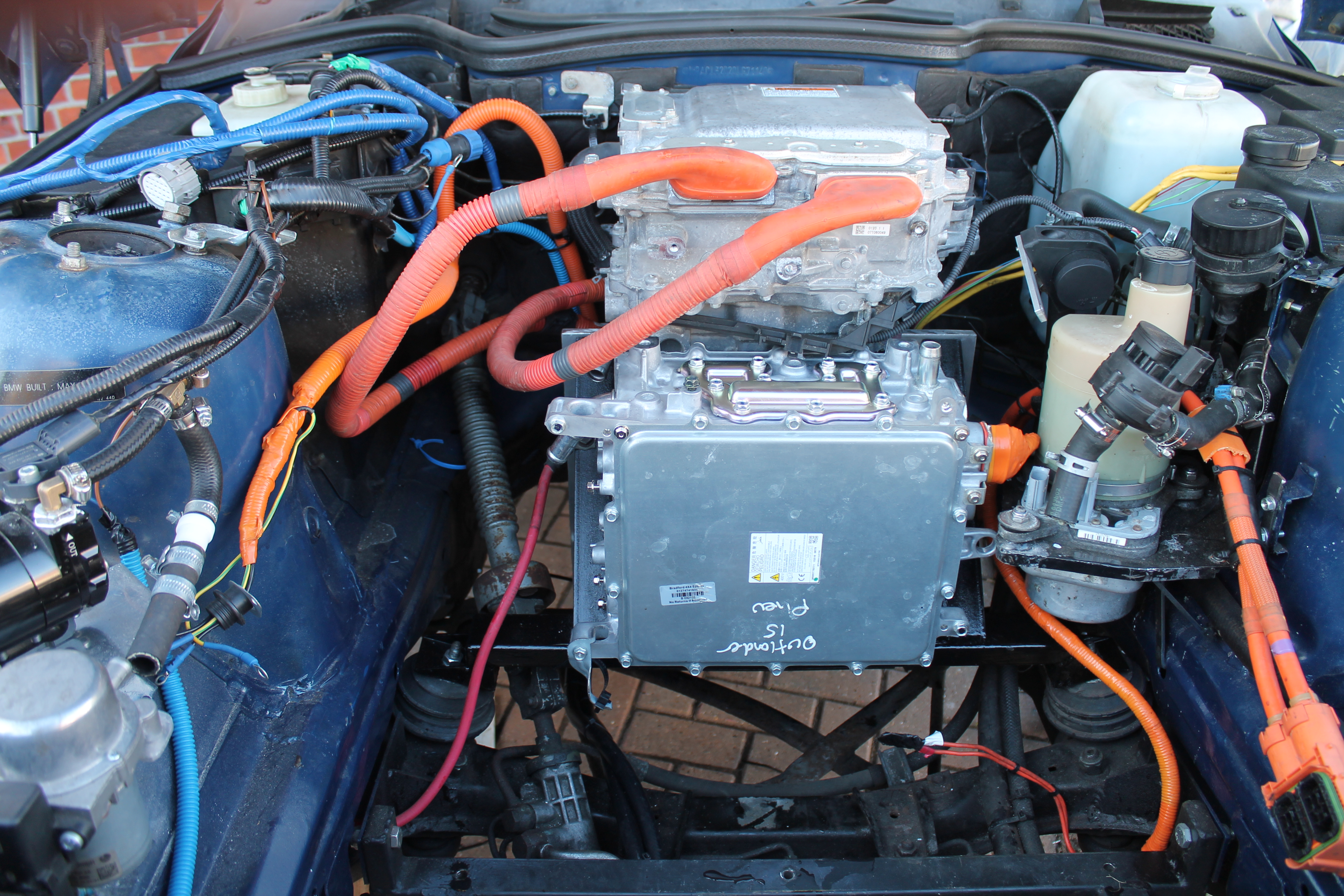

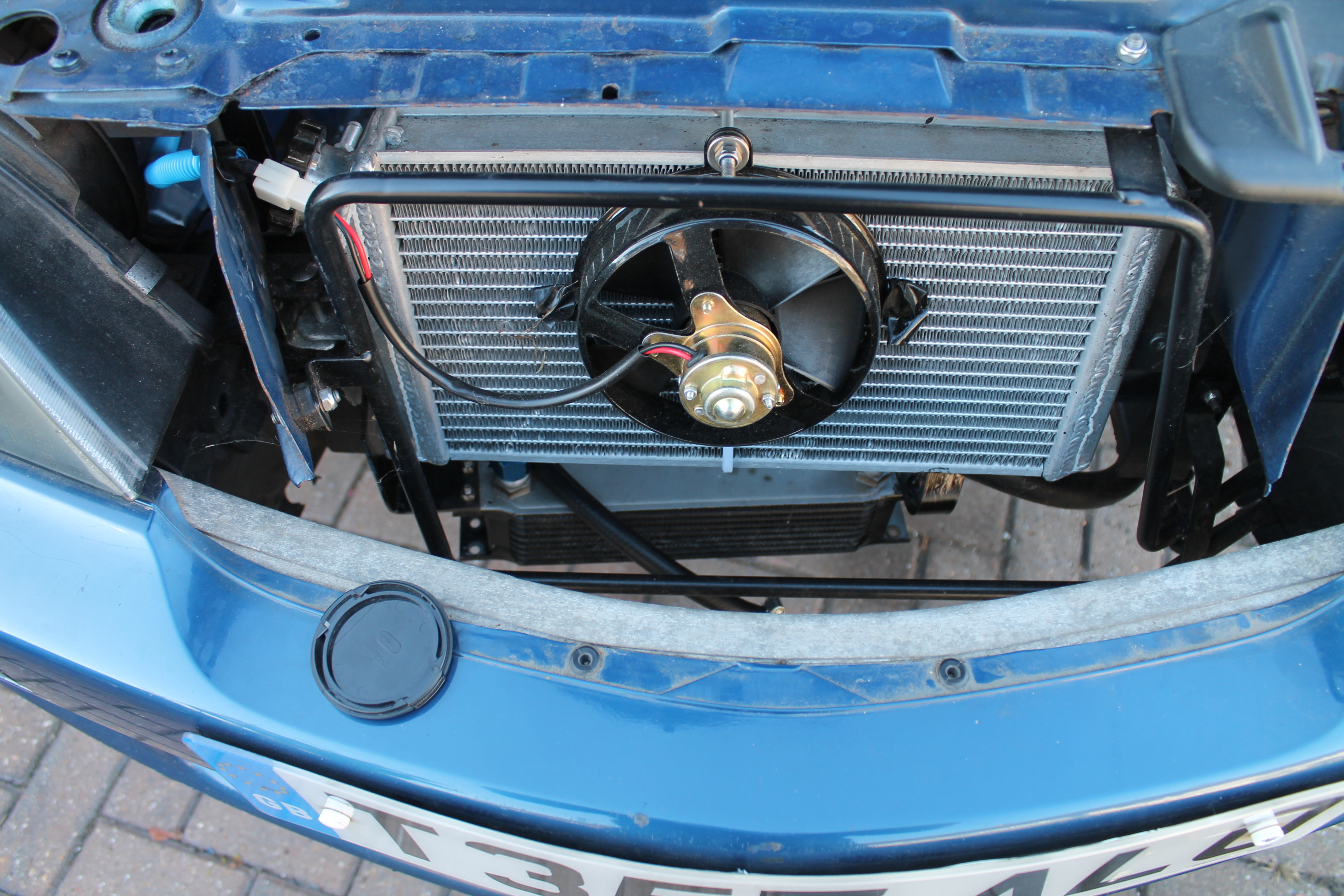

Got some more done today welded on some brackets to fit the oil cooler, run and connected the hoses to the transmission I can't finish connecting these to the cooler as I'm waiting for some an-6 to an-10 reducers
I've also decided on final locations for the inverter and outlander charger
but it's very slow going I spent 2 hrs just moving stuff around to make this decision :lol:
plumbing wise it's not ideal but I can make it work.
rstevens81
Posts: 377
Re: [WIP] BMW Z3
oh wow so much space your making me very jealous, you know you going have to buy a battery to fill the void (accidental drunken ebay purchase maybe)
My engine bay feel like a game of turbo tetris :)
