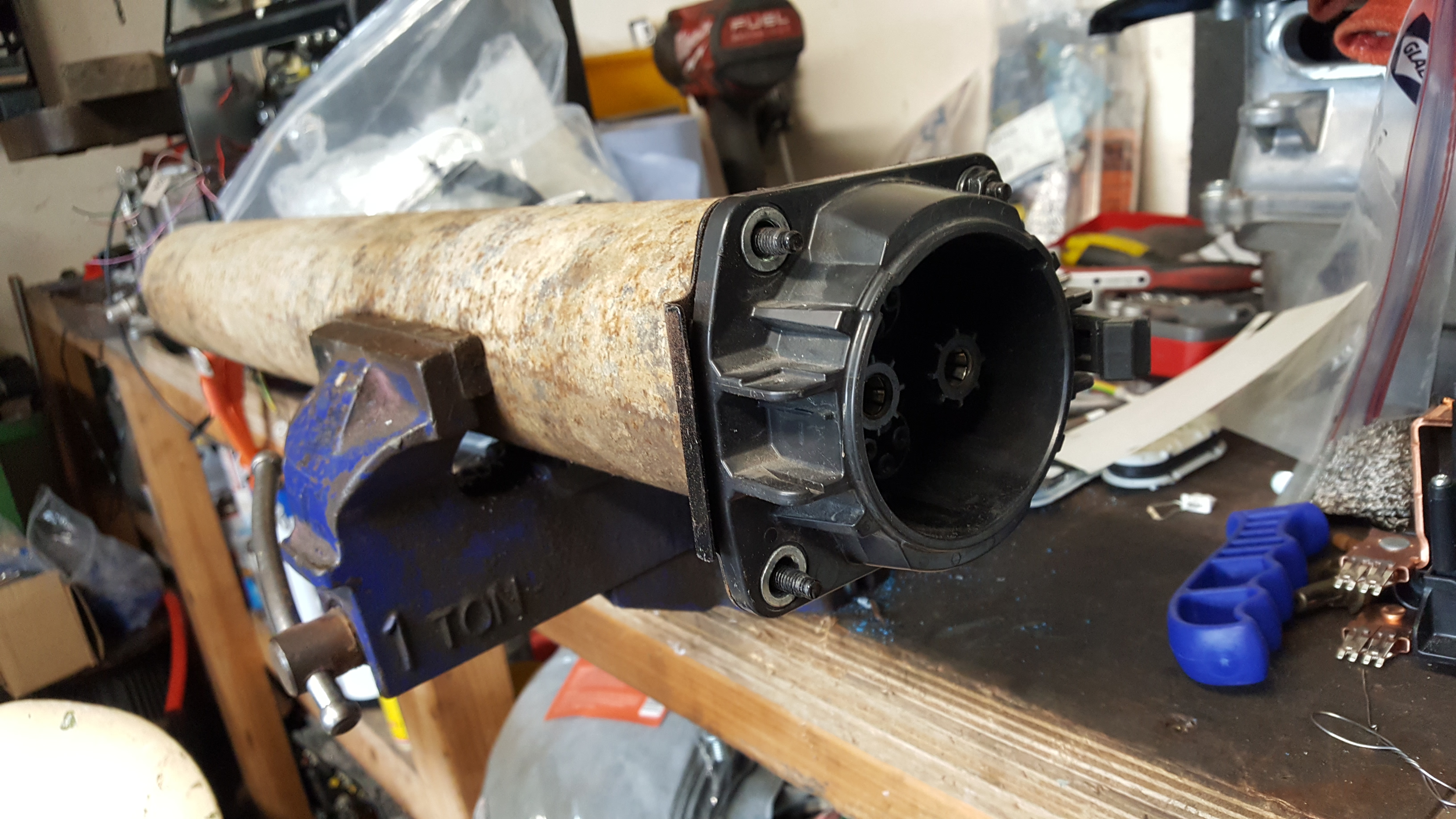

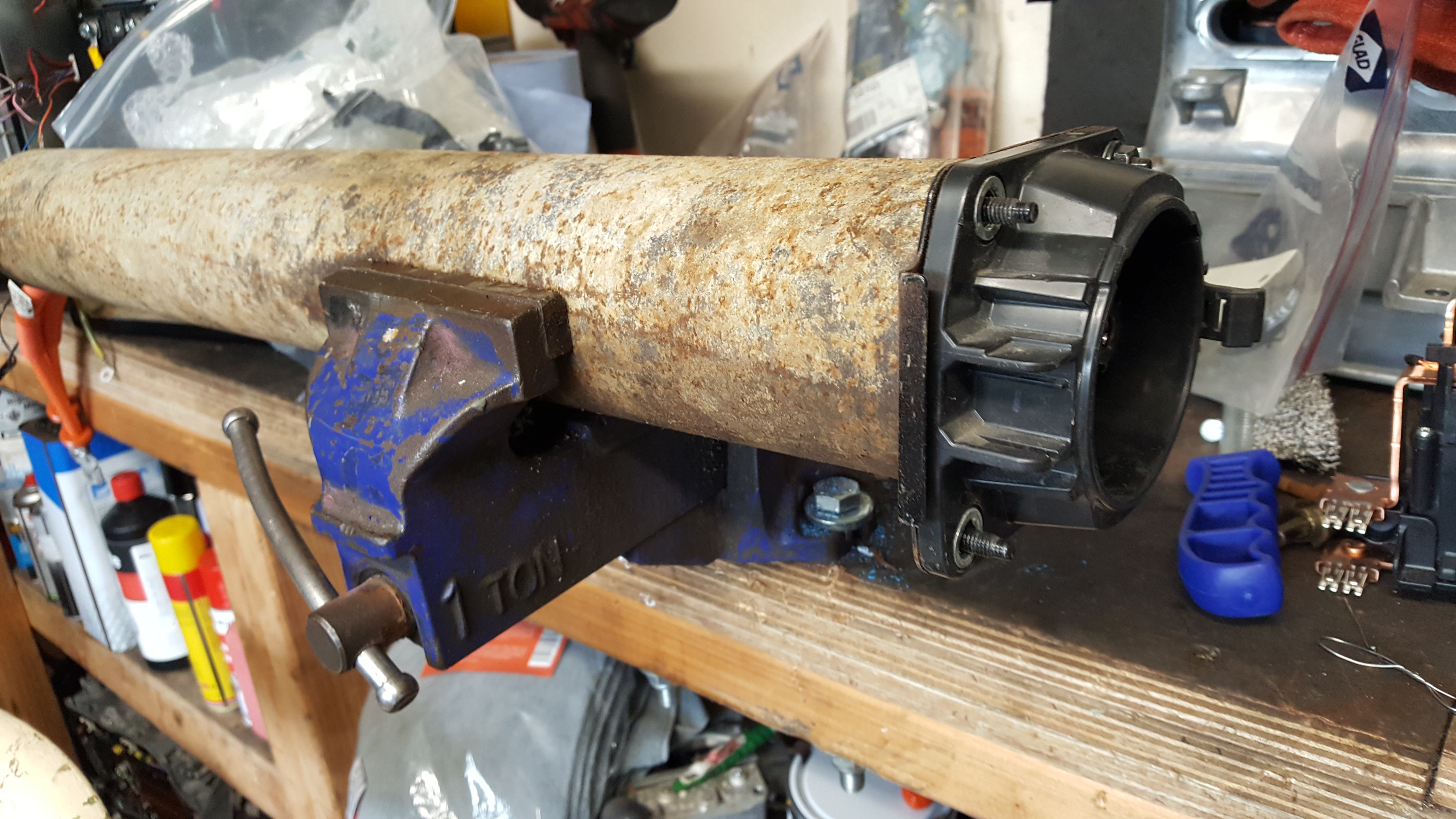

This piece of truck driveshaft tube will make an excellent "back box" for the E39 :)

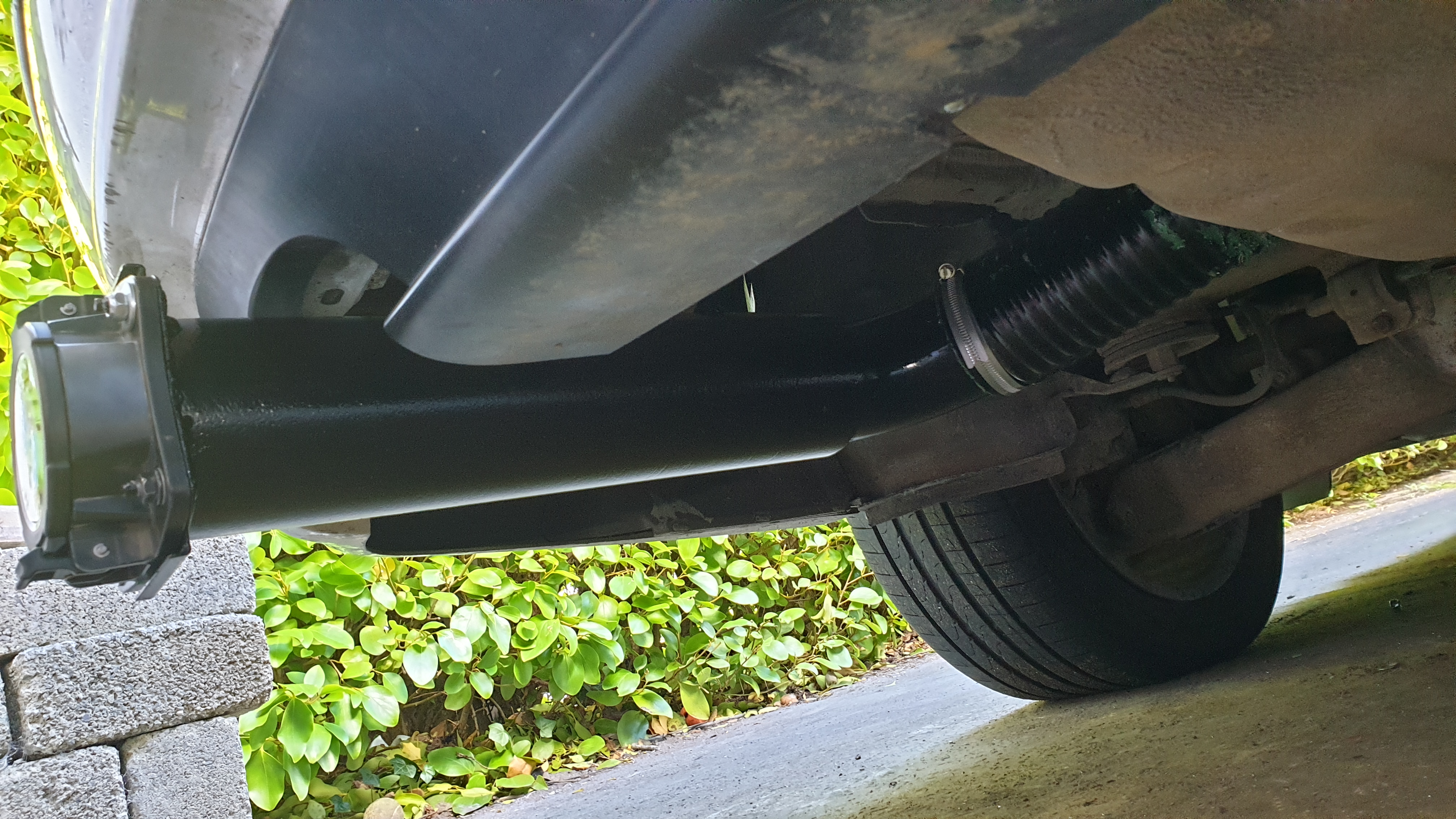

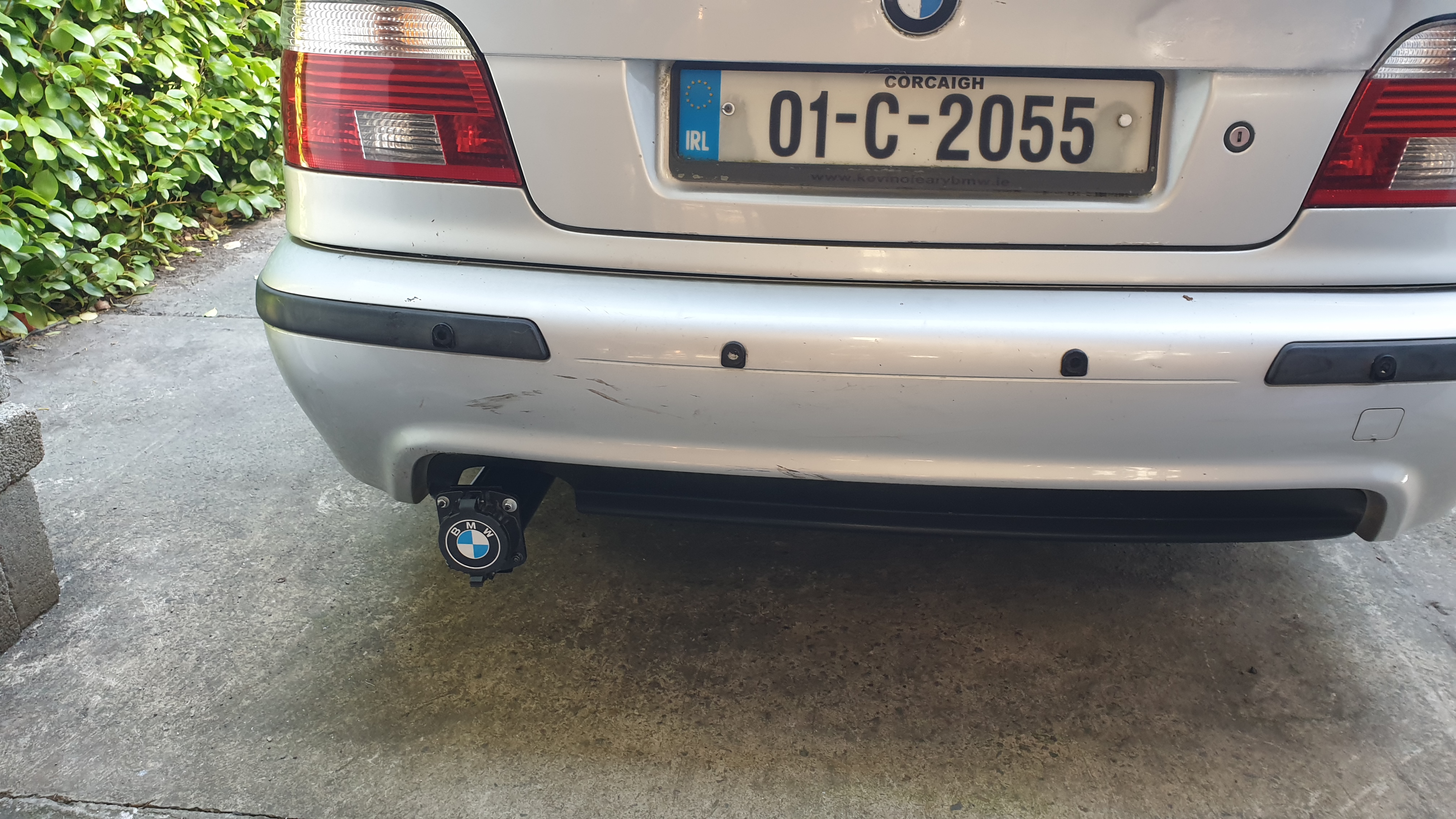

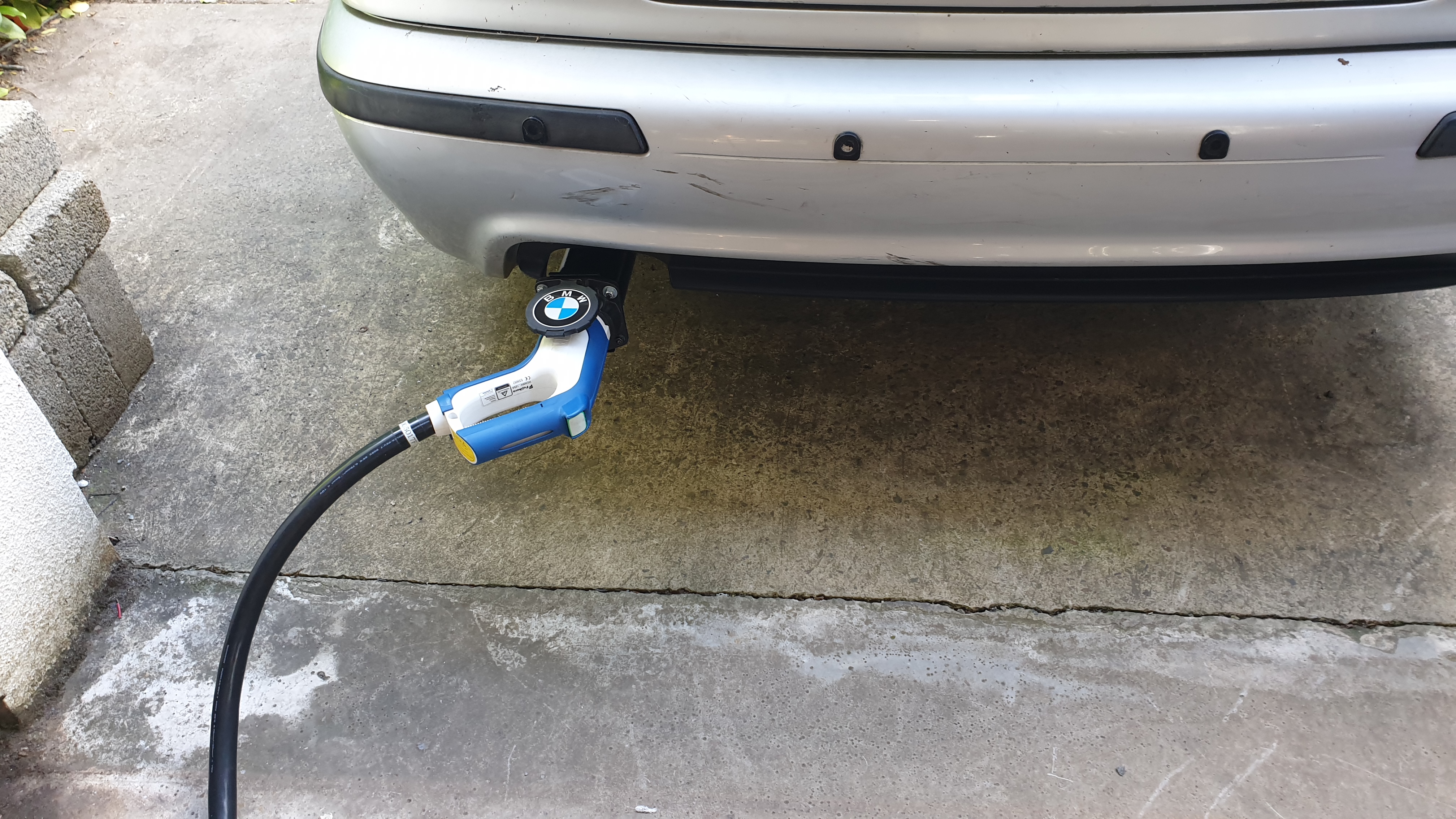

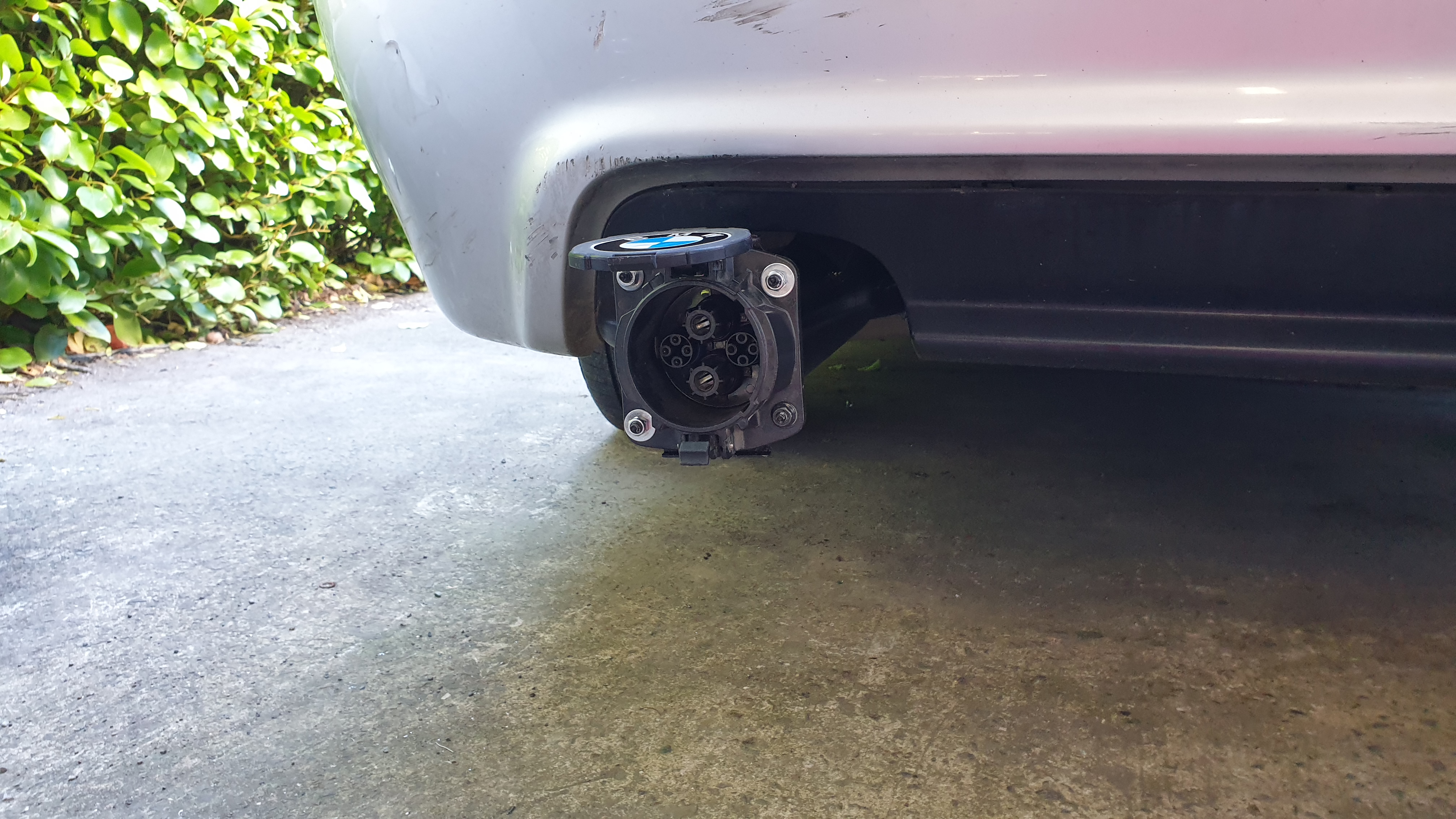

Well, long time no update. Spent the past few days fabricating a new chademo "back box" for the E39. Will be fitting the new ISA based chademo controller and doing some fast charging.

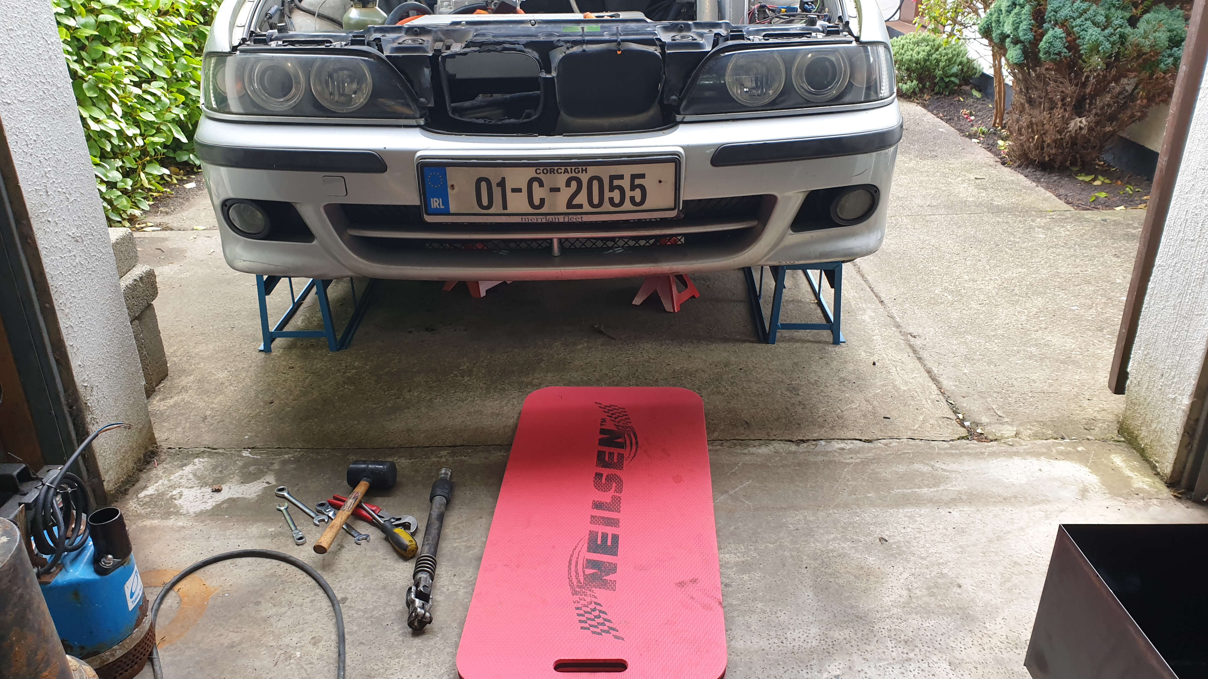

As a general update the Prius inverter / Siemens motor combo has been running flawlessly. Only issue has been replacing the lower steering column due to a siezed universal joint. Gotta love these maintenance free electric cars.

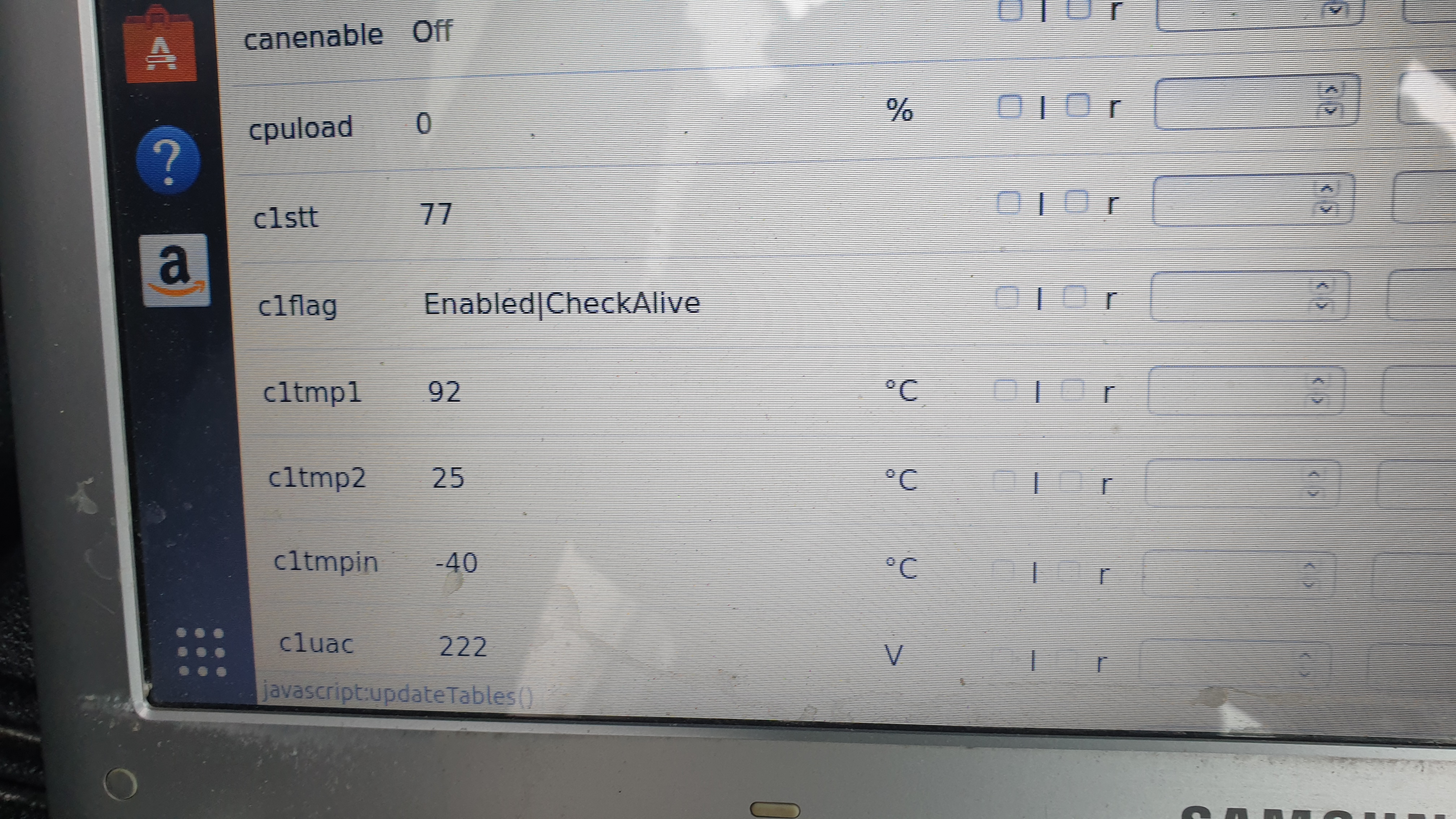

So there I was today. Not a happy camper at all. For some reason the Prius inverter would not let me accelerate very much despite my having the throttle pedal mashed into the floor. Generating lots of desat trips as well. Then I get where I'm going and light of the gen2 tesla charger for some nice 10kw 3 phase action with the new Johannes control software. Started off well but wasn't long until power started dropping off despite being nowhere near charged. Followed that with another frustrating drive home during which the dcdc converter in the prius inverter started dropping out and another slow charge session. Setup the laptop to view the charger info and was furiously texting Johannes when I noticed all 3 charger modules were at 92C.
So I popped the bonnet and all the cooling hoses were cold. Must be Johannes not reading the can info I surmised and had the phone in my hand for another message when I noticed the coolant pump making a weird sound. the sort of sound it makes when running dry. Opened the coolant bottle annnddd........its dry!!!!!!!
Just as I refilled it Johannes called and the temp dropped right down and the power ramped back up.
Lessons learned today :
1)It's always my fault.
2)You can drive a 2 ton E39 on the motroway at 60mph with no coolant in a Gen3 prius inverter and the Toyota engineers protect the transistors.
2)Tesla gen 2 chargers thermal limit at 92C.
4)The Siemens motor is very tough.
5) See item 1.
