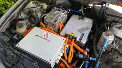

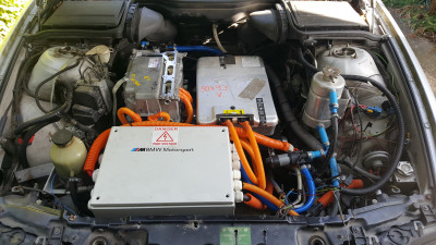

Siemens motor now spinning in the E39 using the Prius Gen 3 MG2 power stage.
So of course I selected 5th gear, pulled on the brakes and wound on the power. MG2 shuts down at 500amps peak. That's around 350amps rms. Even in 5th with a 530d drivetrain, brakes on and the wheels chocked she was creeping forward.

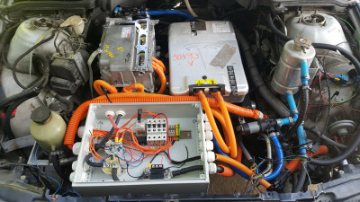

In other news got the Tesla charger and V5 logic board running today. Seems to be a few bugs in the code still but with an actual charger running in a car will make it easier to hunt down.

Drove 18 miles today mostly around town but some 60mph sections. Absolutely no problems and inverter stone cold after the drive. I have the temp gauge driven by the mg2 temp sensor over can with around 50c as the top of the "red" zone. It gets up there when using very low throttle say pullling out of a junction but as soon as you give it some pedal the temp drops right back. It also drops back very fast on release of throttle. When cruising at 60mph and using around 10kw it stays in the blue. Next up will be a motorway drive.

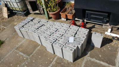

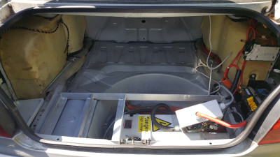

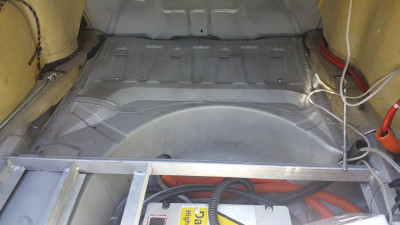

How is the single string of modules holding up under load and what sort of range are you estimating from the 9Kwh pack?
- Posts: 3661
- Has thanked: 10 times
- Been thanked: 334 times
Re: The LandYacht BMW E39 Saloon
Battery is having no problems so far. 11mv max difference in the cell voltages after the drive. No idea on range as yet but I've just done a day of errands including hauling 2 huge wheels from the deranged rover to get tyres so I really don't care
