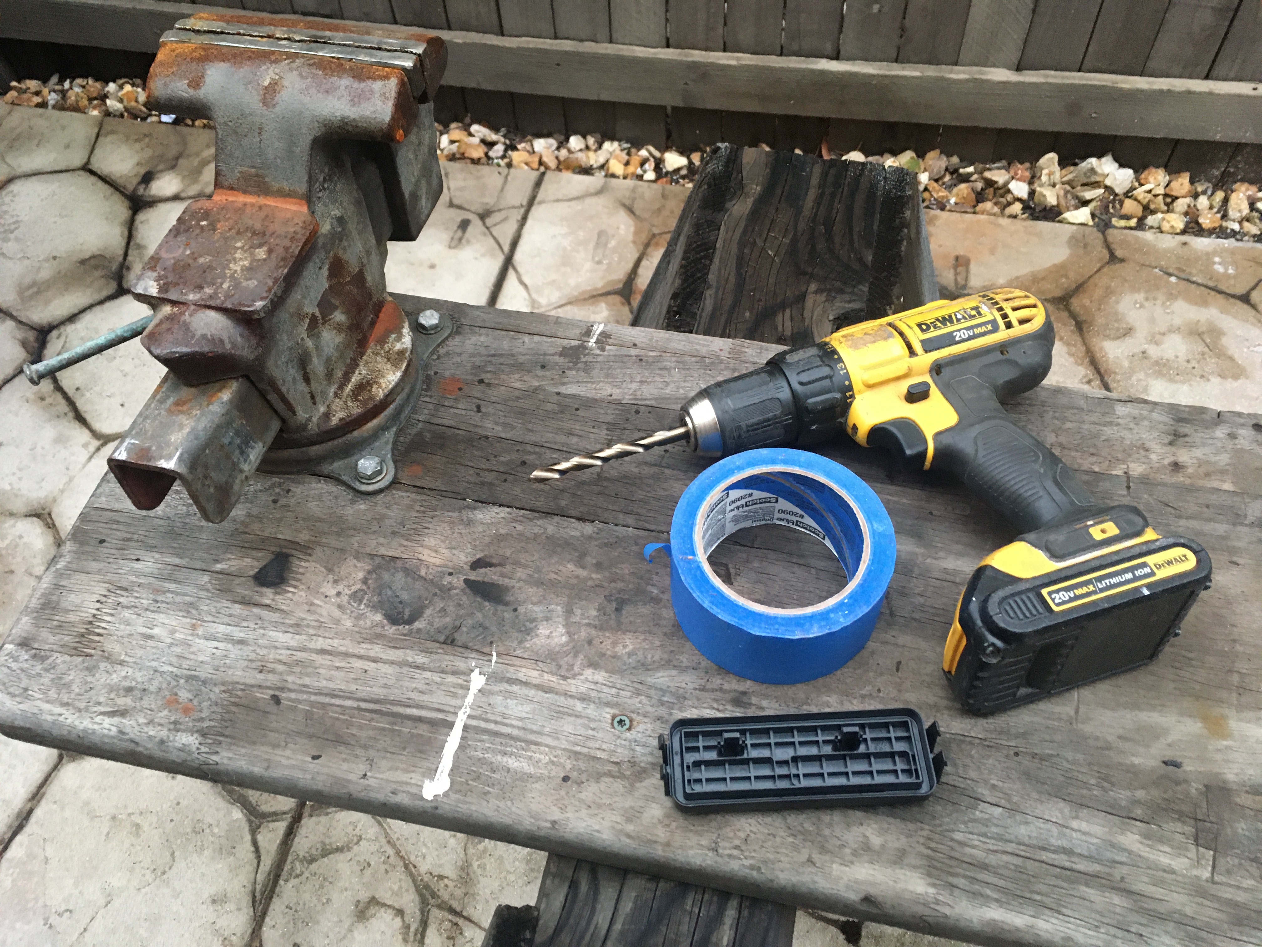

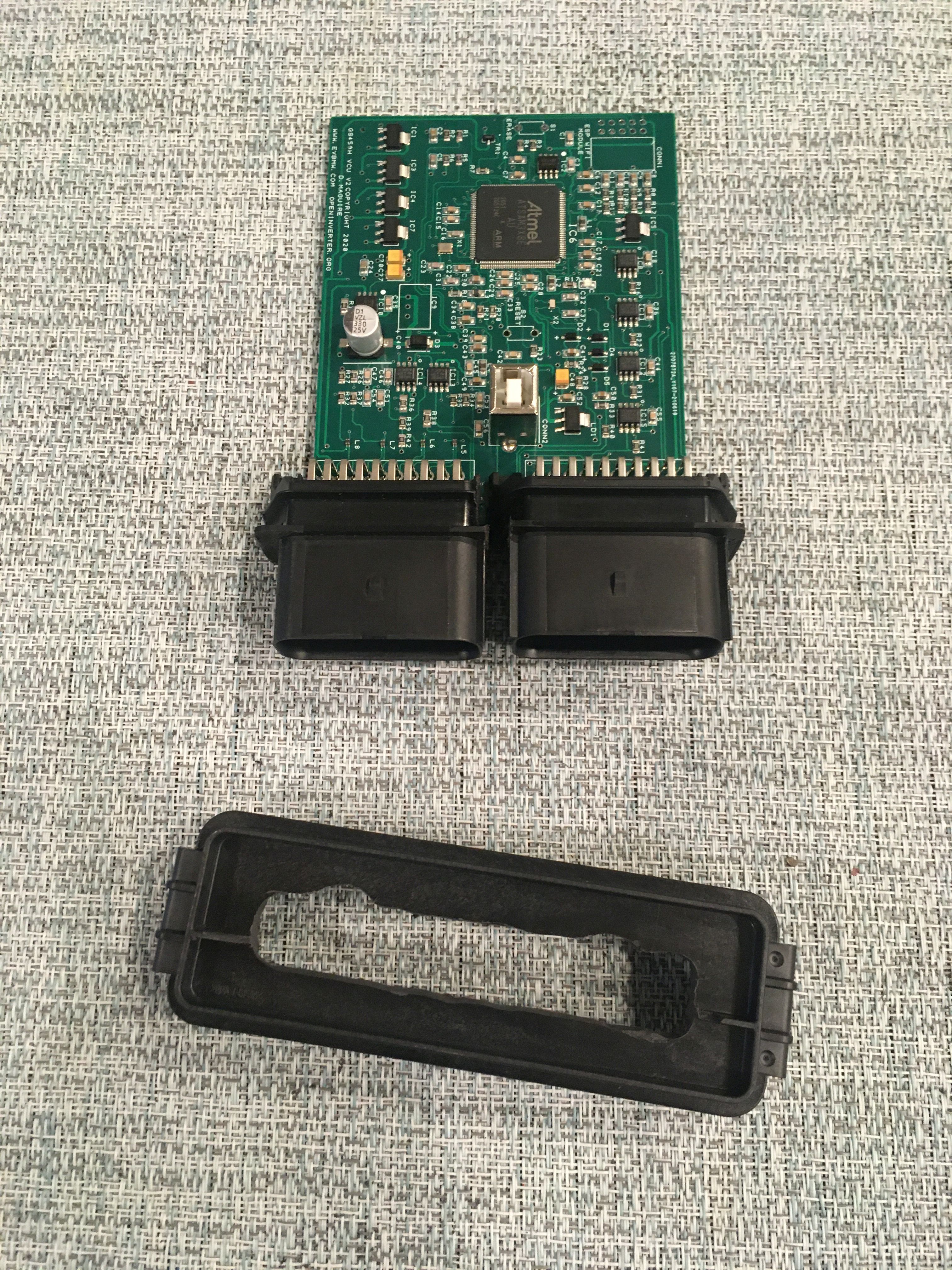

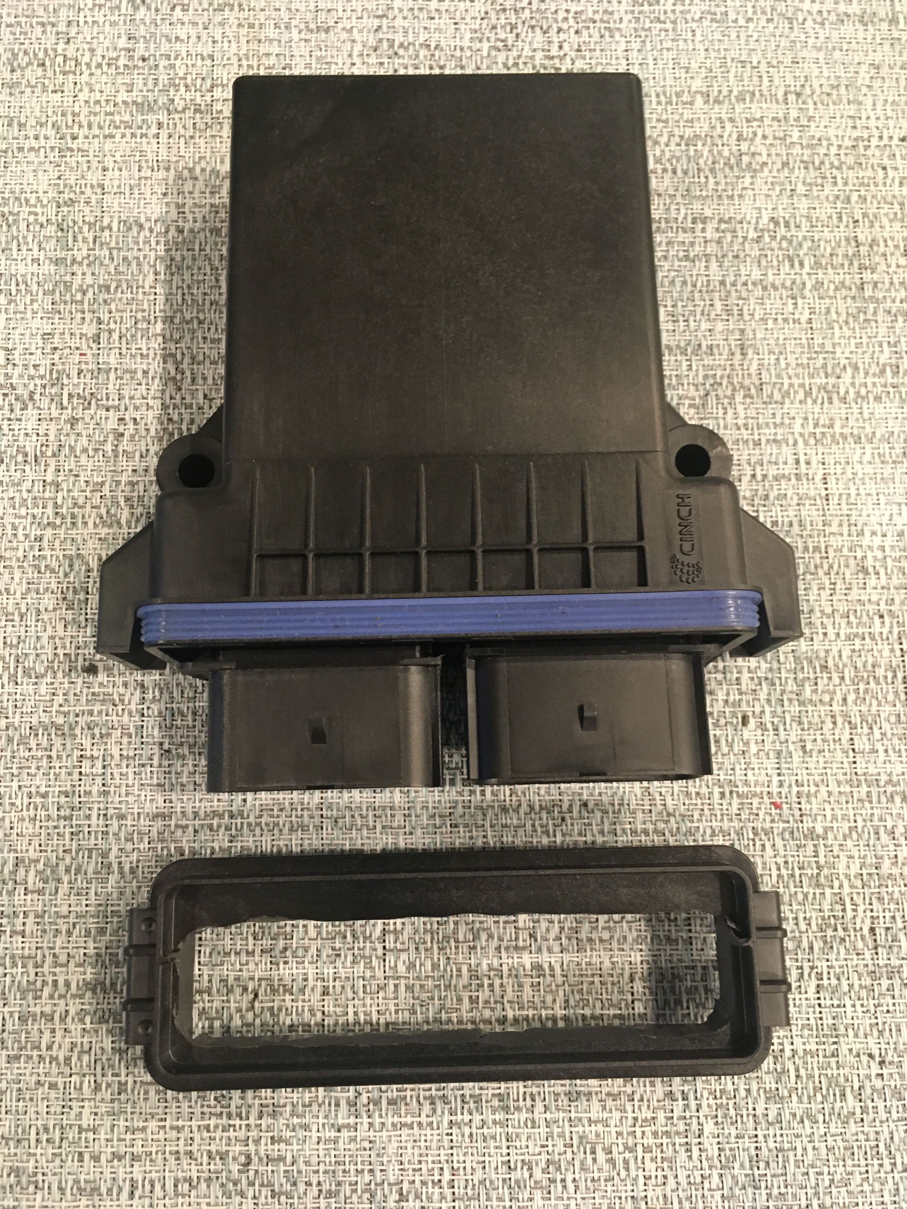

Cad files for all the mod ice stuff. I started cleaning up and making a header that you just print and epoxy the pins into
Gregski
Posts: 3158
Has thanked: 631 times
Been thanked: 1607 times
Post by Gregski »
Bratitude wrote: Mon Nov 08, 2021 12:46 am https://www.argenta-elektronik.com/wp/p ... e/?lang=en
Awesome? I am clueless when it comes to CAD or 3D printing, so would you be able to make some and sell them to us?
Please and Thank You
Posts: 1156
Has thanked: 246 times
Been thanked: 469 times
Gregski wrote: Mon Nov 08, 2021 1:29 am
I could, yes I’ll post some photos in a bit here with the files and more info

meanwhile back at the Good Enuff Garage nothing fits, lol
Gregski
Posts: 3158
Post by Gregski »

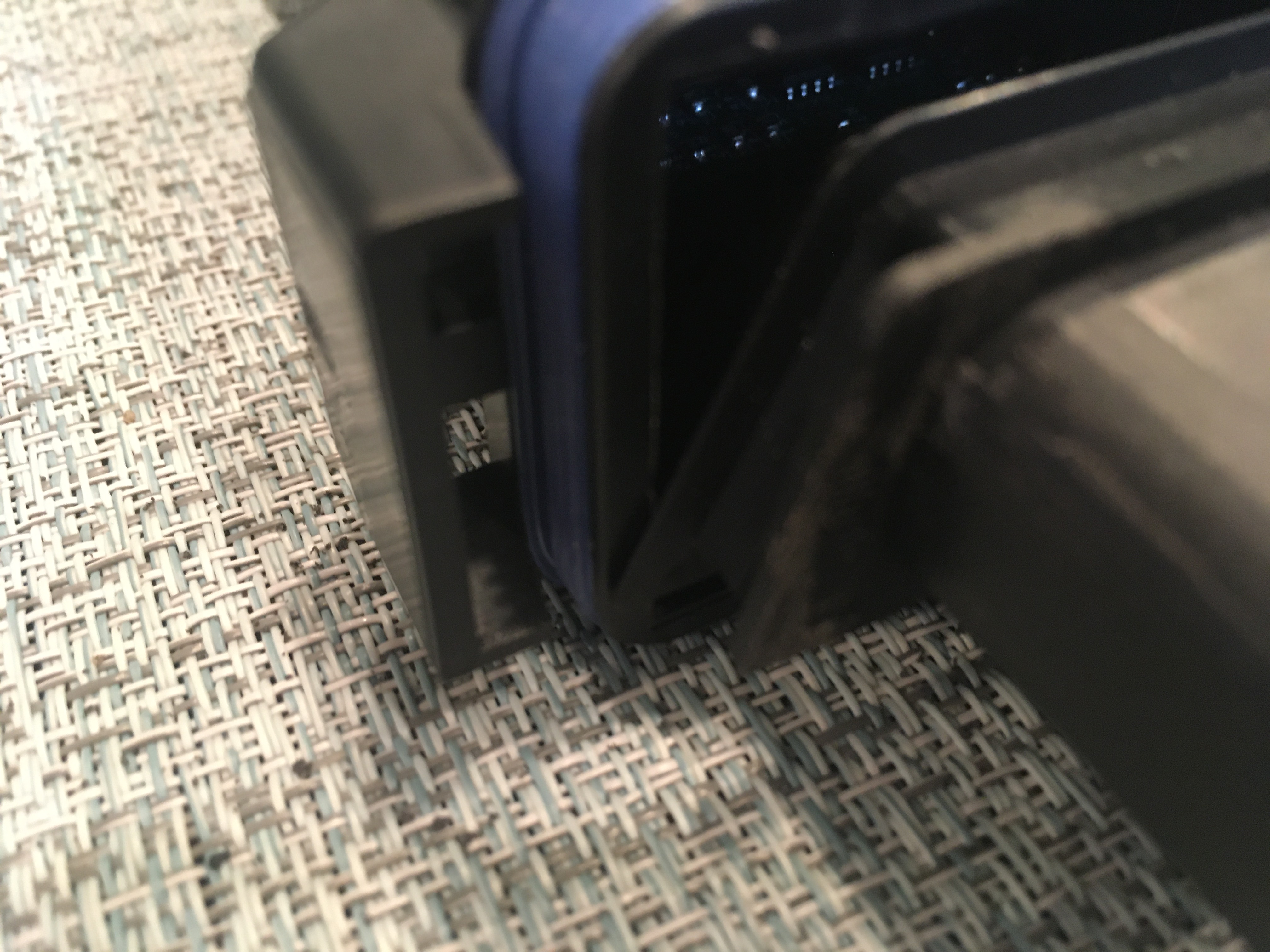

Nothing our 2D printer can't modify...
Gregski
Posts: 3158

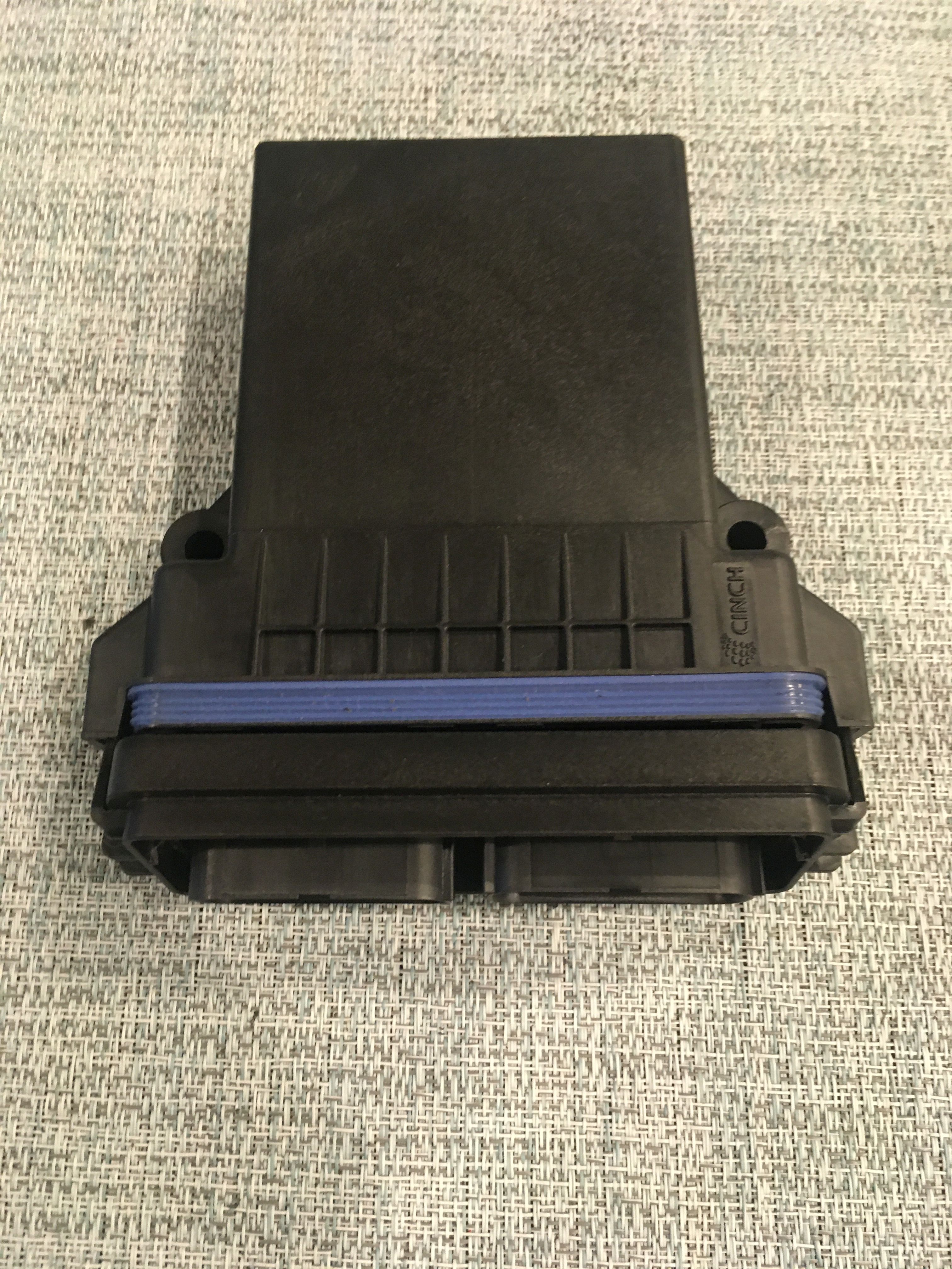

Post by Gregski »
that's better, hard to tell in the pics but the PCB sits all the way in now as the two 20 pin headers no longer hit the sides and slide 1/4" further back in
baby steps
Gregski
Posts: 3158
Post by Gregski »
oh you have got to be kidding me mate
Gregski
Posts: 3158
Post by Gregski »
we're not done yet, but we're getting there, had to stop for the night as it started to rain outside and it was getting dark

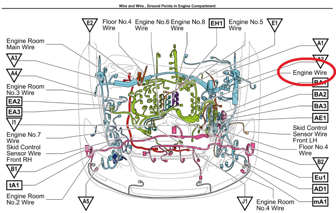

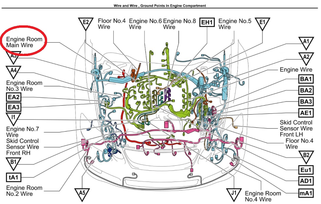

Post by Gregski »

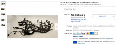

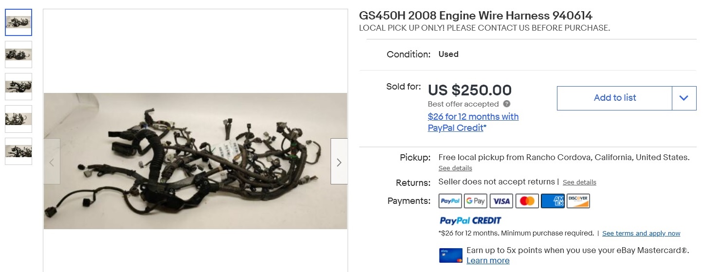

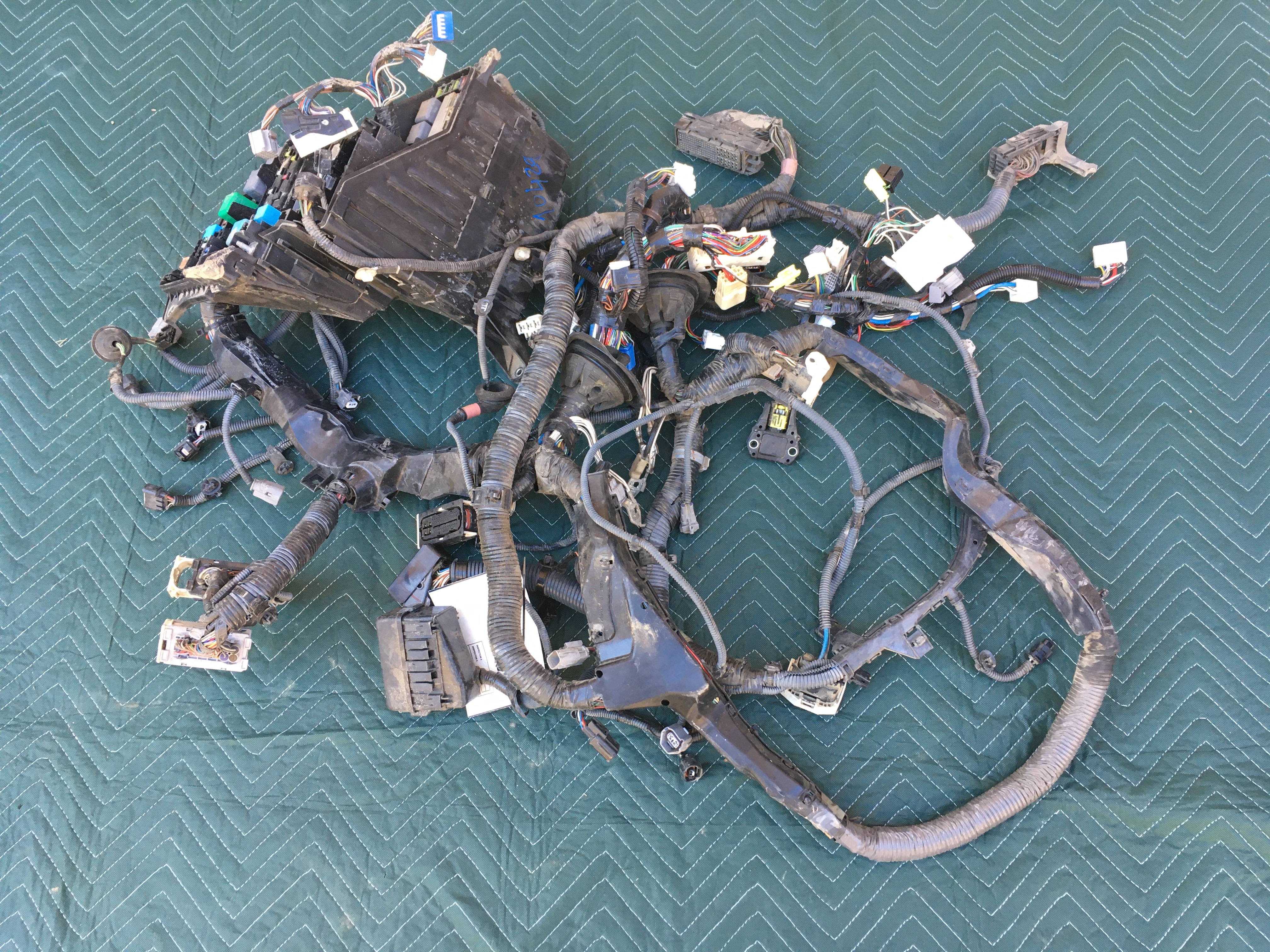

I decided to purchase the "Engine Wire" harness which is the technical name for what we call the Transmission Wiring Harness on eBay for $250 bucks, expensive - yes, needed - absolutely! It's the green aka olive one below (I know that schematic/diagram is horrible, but Lexus never breaks it up into individual diagrams, and all the wire harnesses are always shown together... Epic Fail!)
Note: This wire harness does NOT come with the Inverter plug!
Harness Part # 82121-30E21 is for 2007-2010 (this is the one I bought)​
$1,369 at the local Stealership​
Harness Part # 82121-30E22 is for 2009-2011​
$1,366 at the local Stealership​

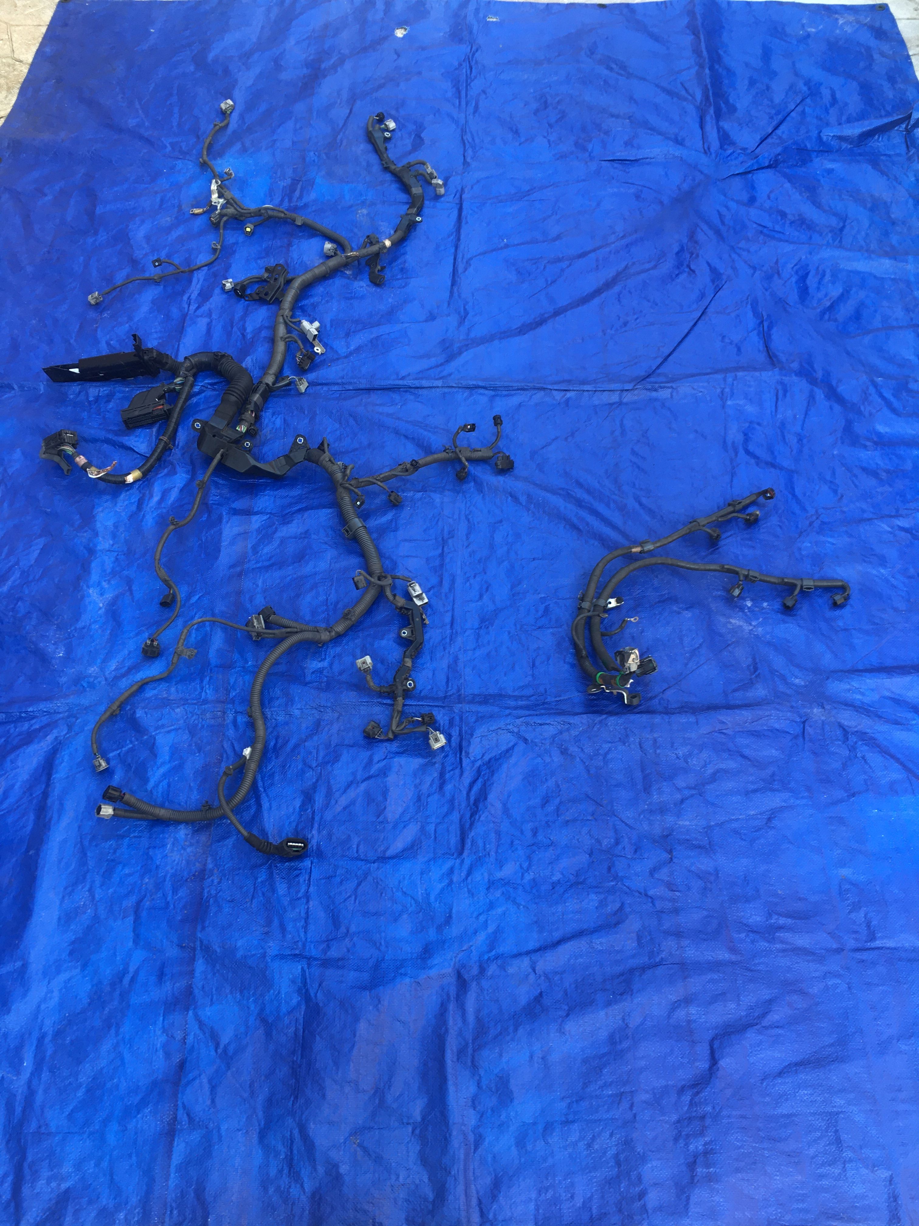

Post by Gregski »

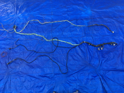

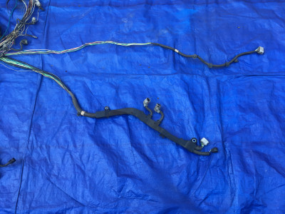

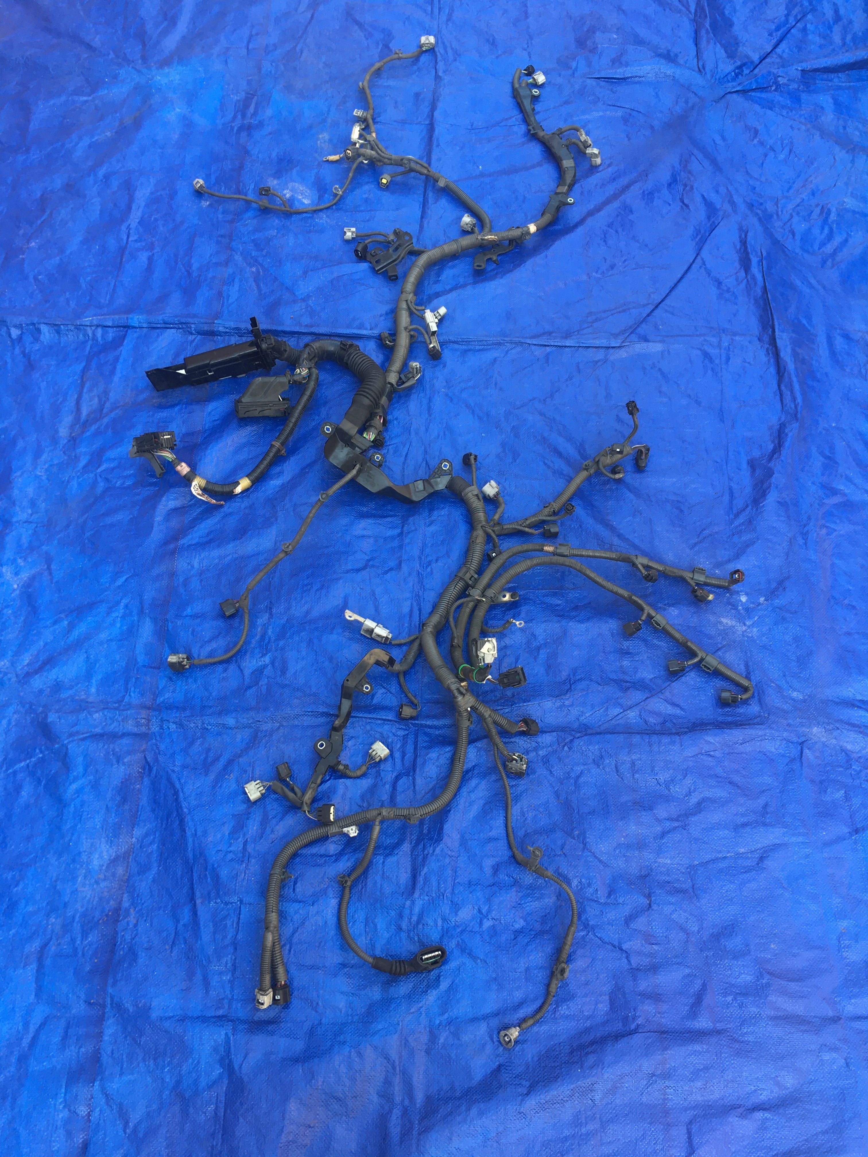

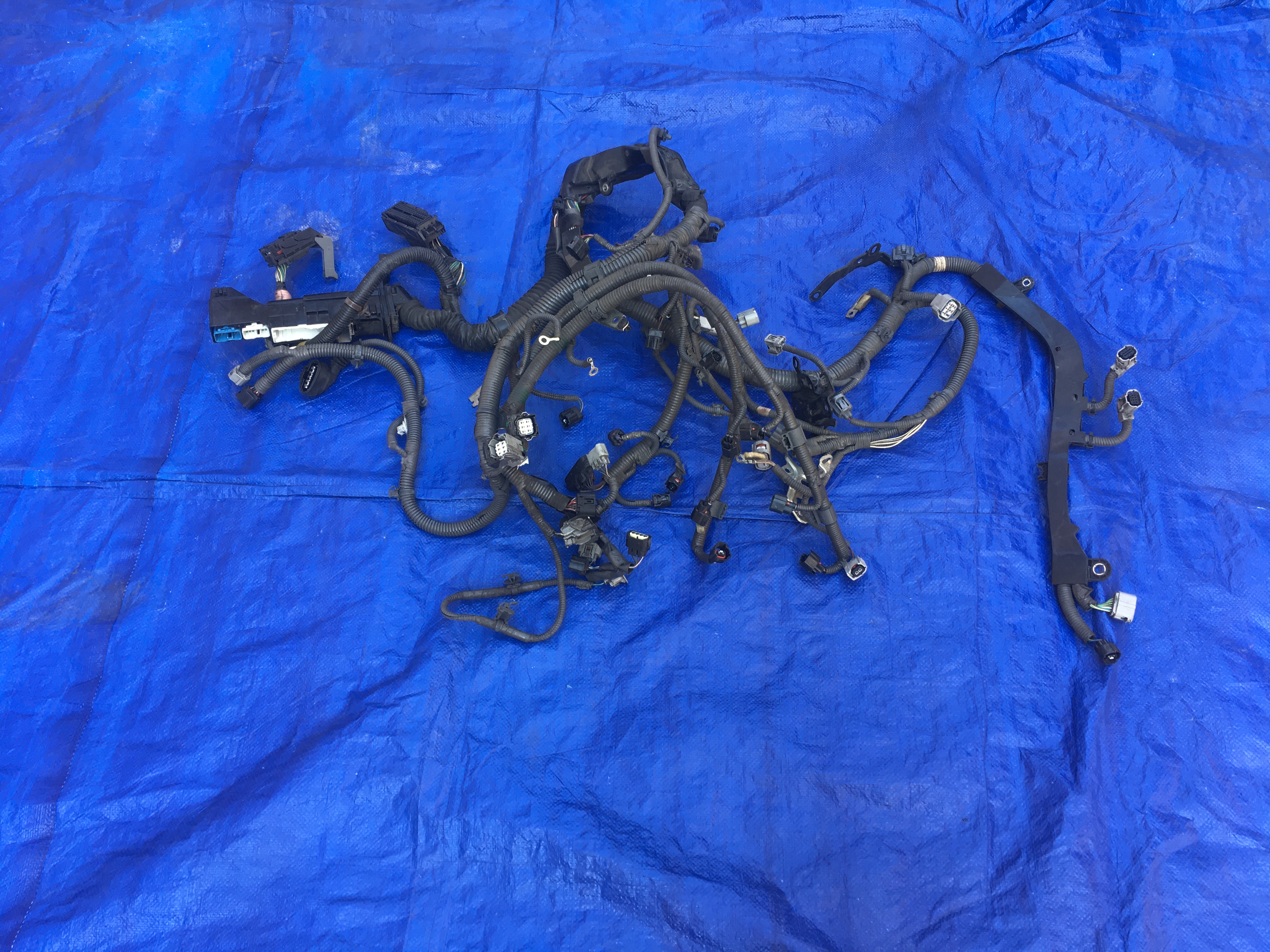

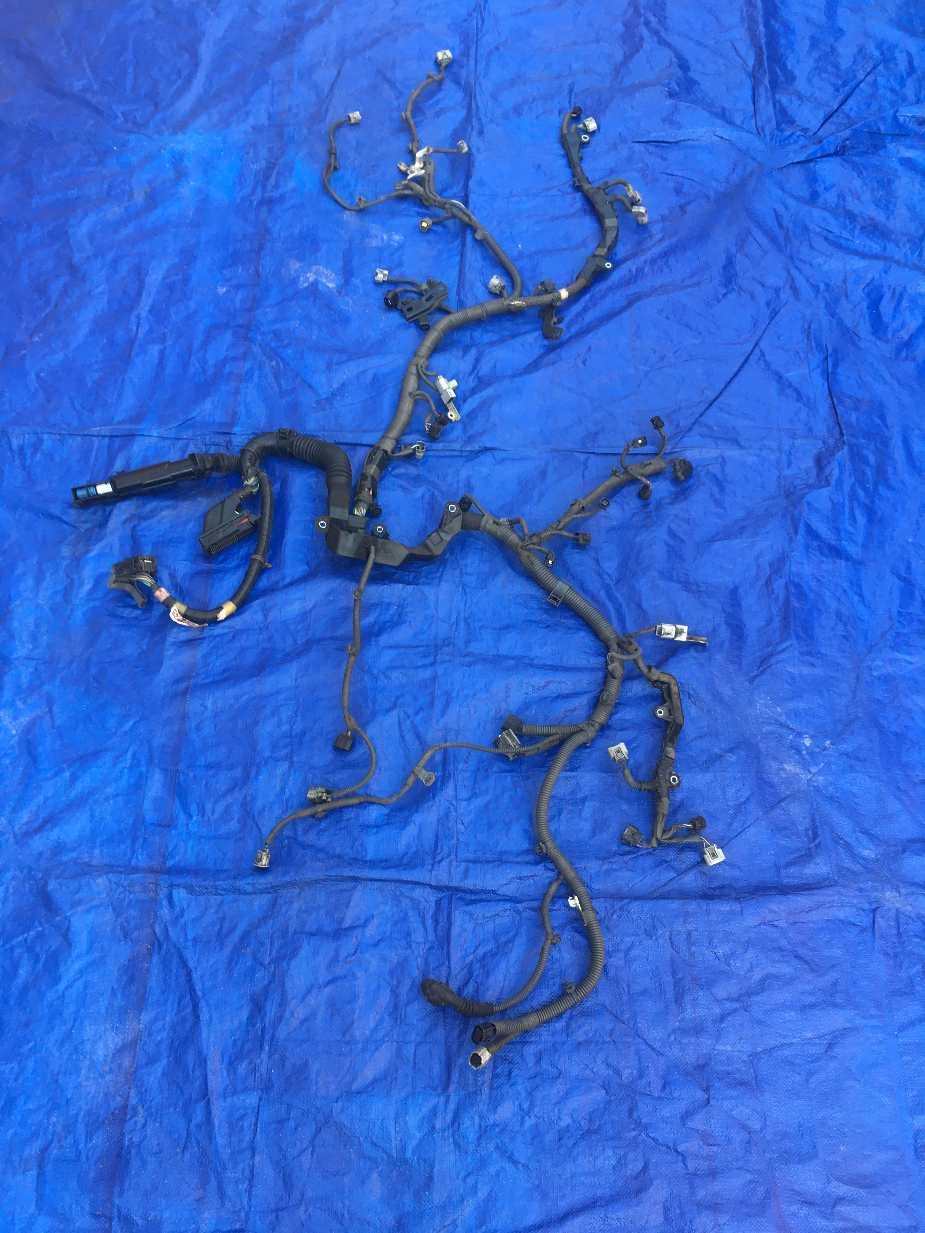

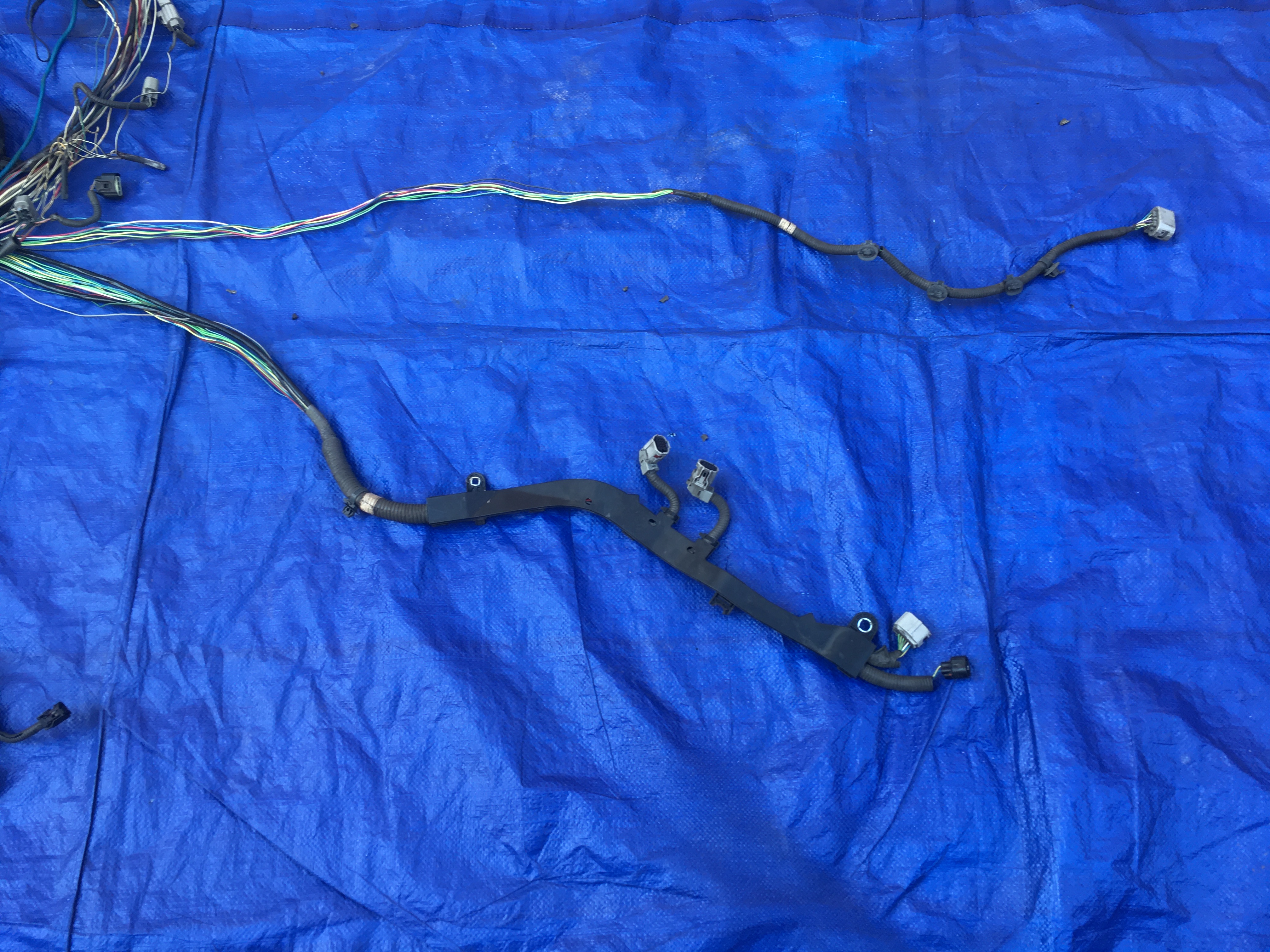

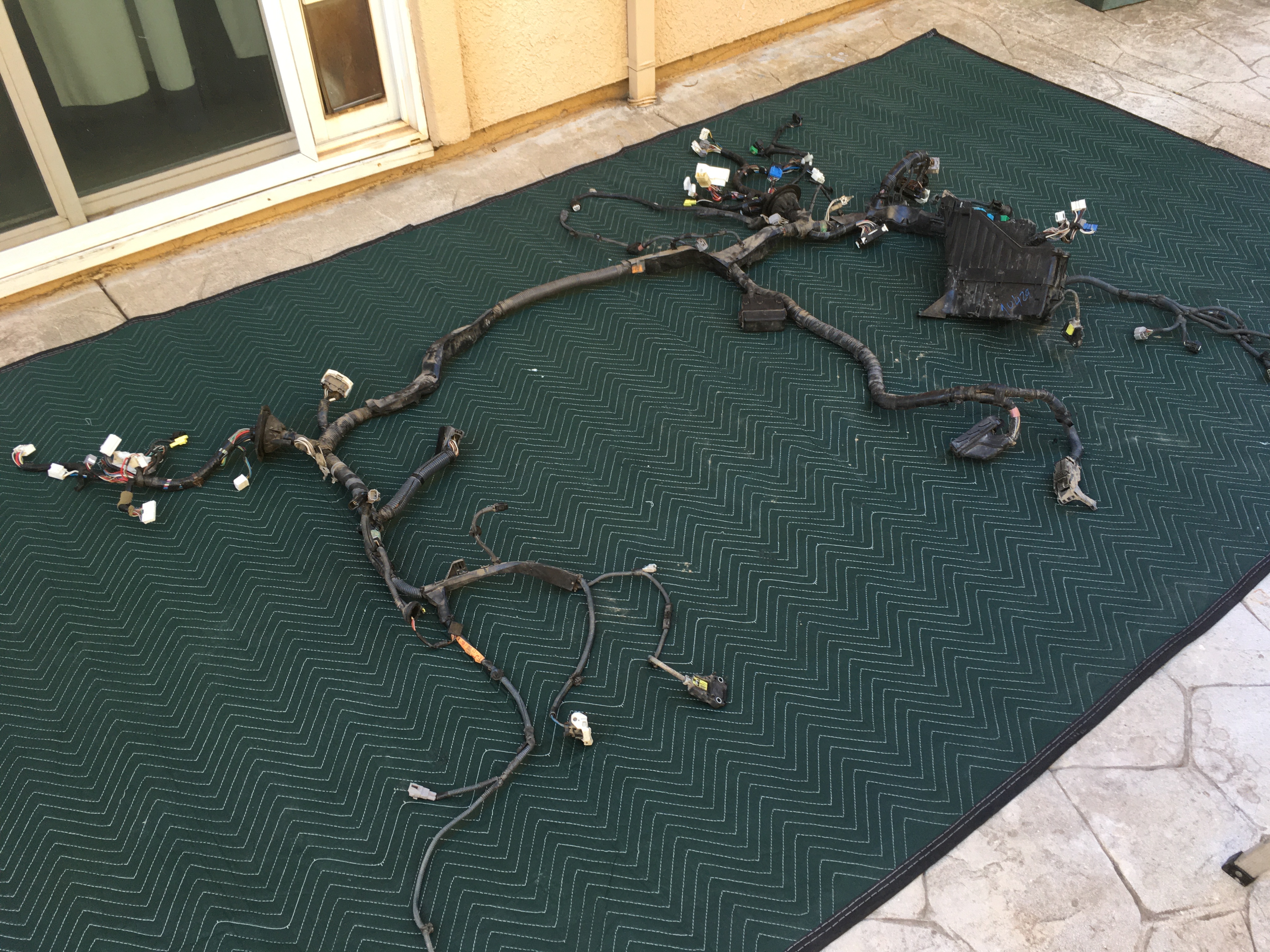

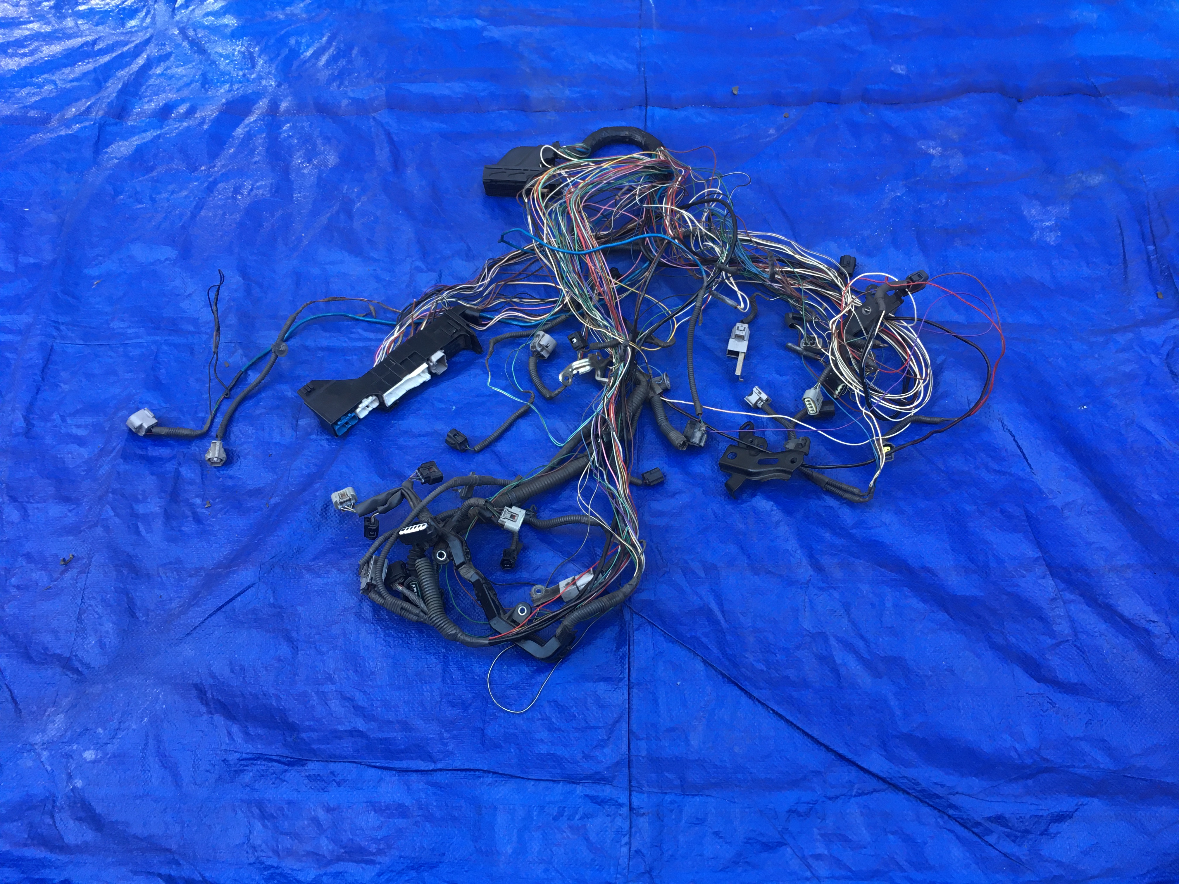

so first I laid it out and then I began to "thin" it out
this is as if you were standing in front of the vehicle looking down on the engine bay
part of this harness is a small completely separate Fuel Injector harness
so here it is again minus that Fuel Injector harness

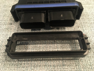

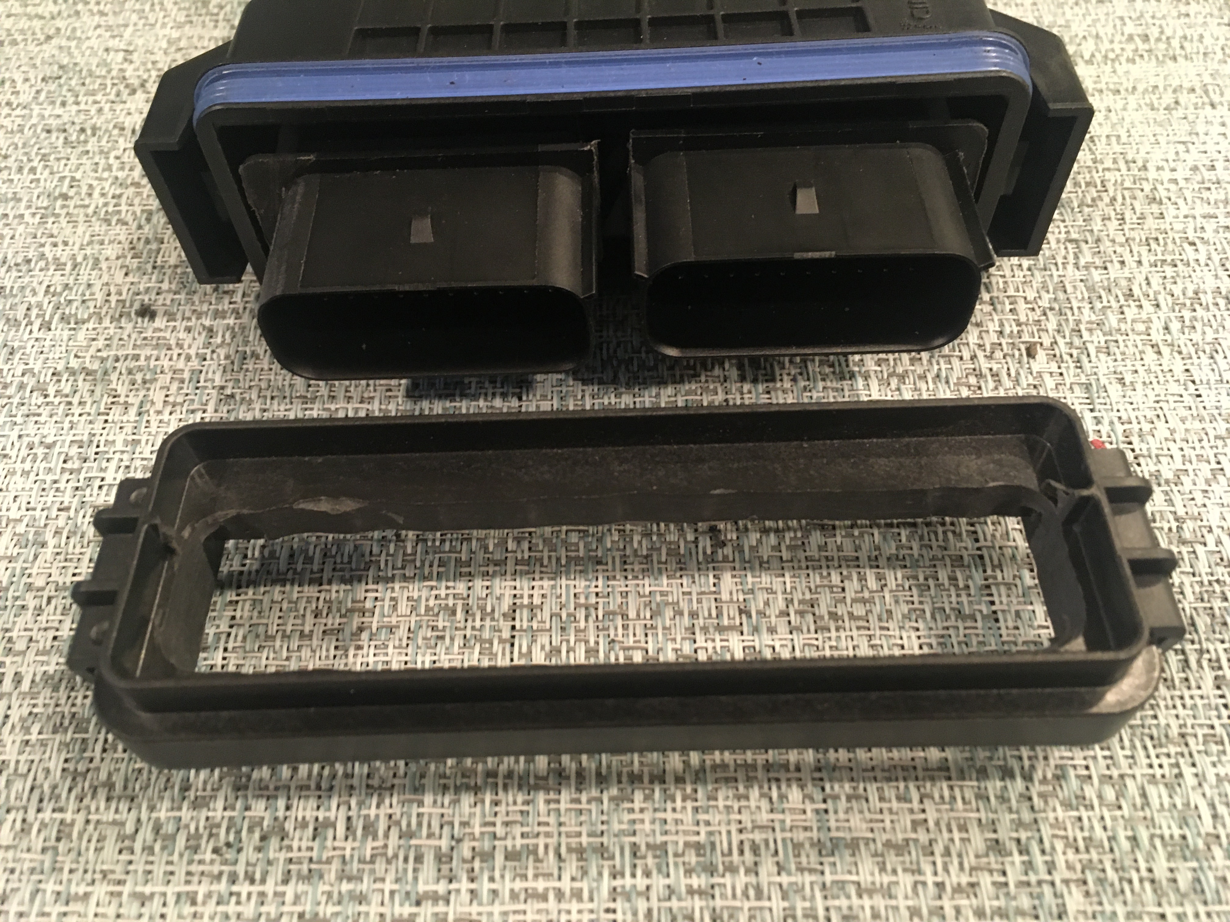

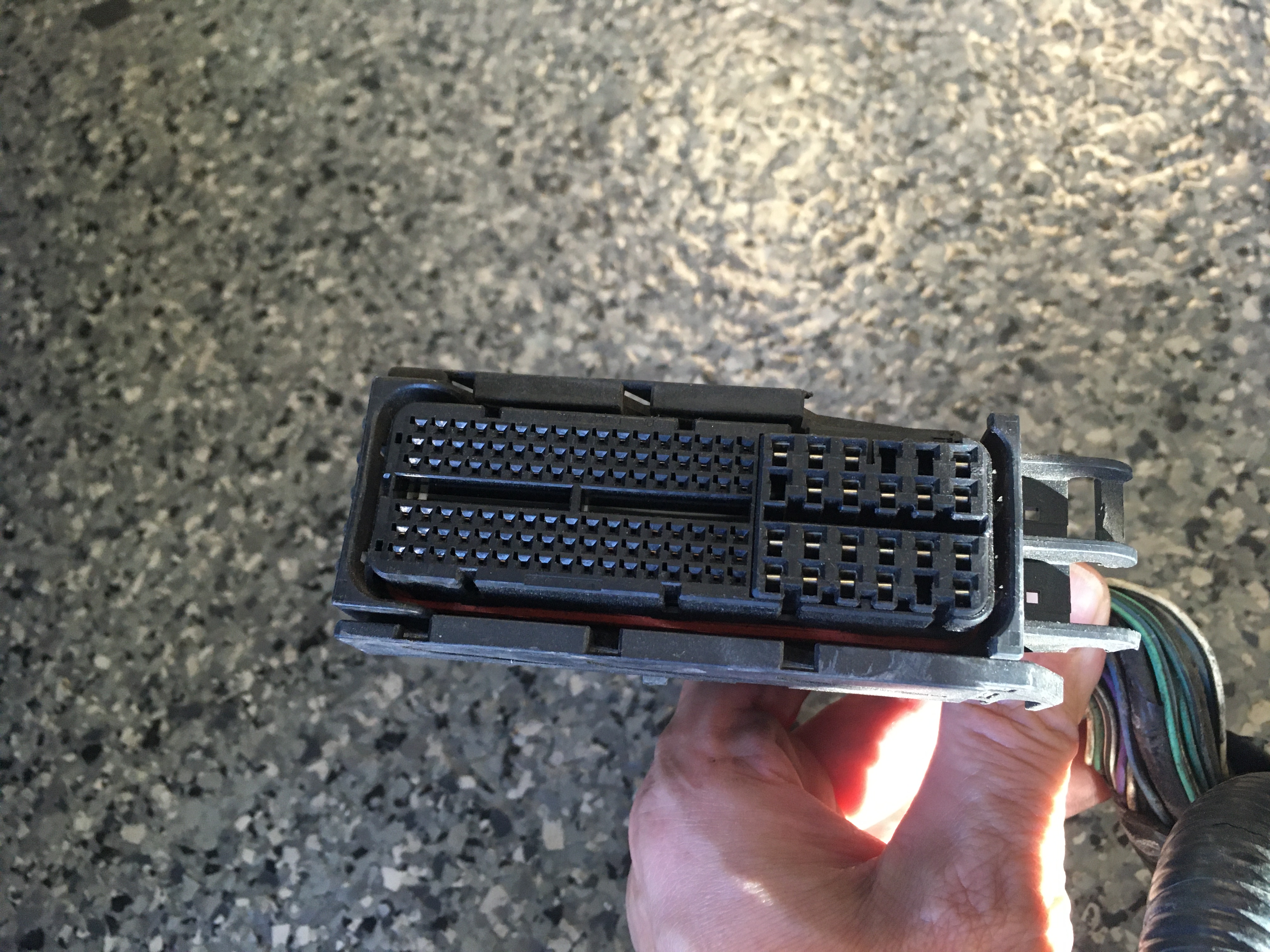

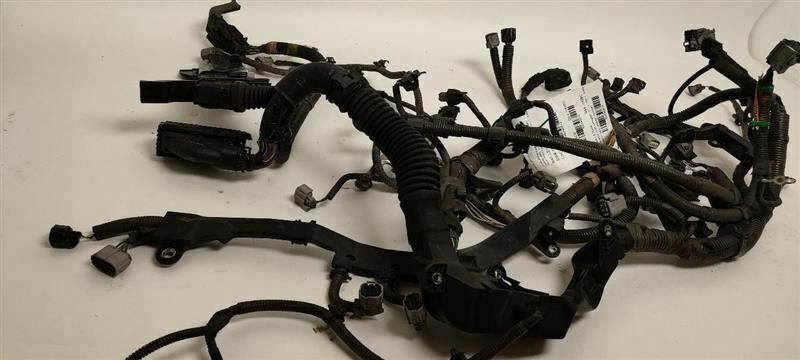

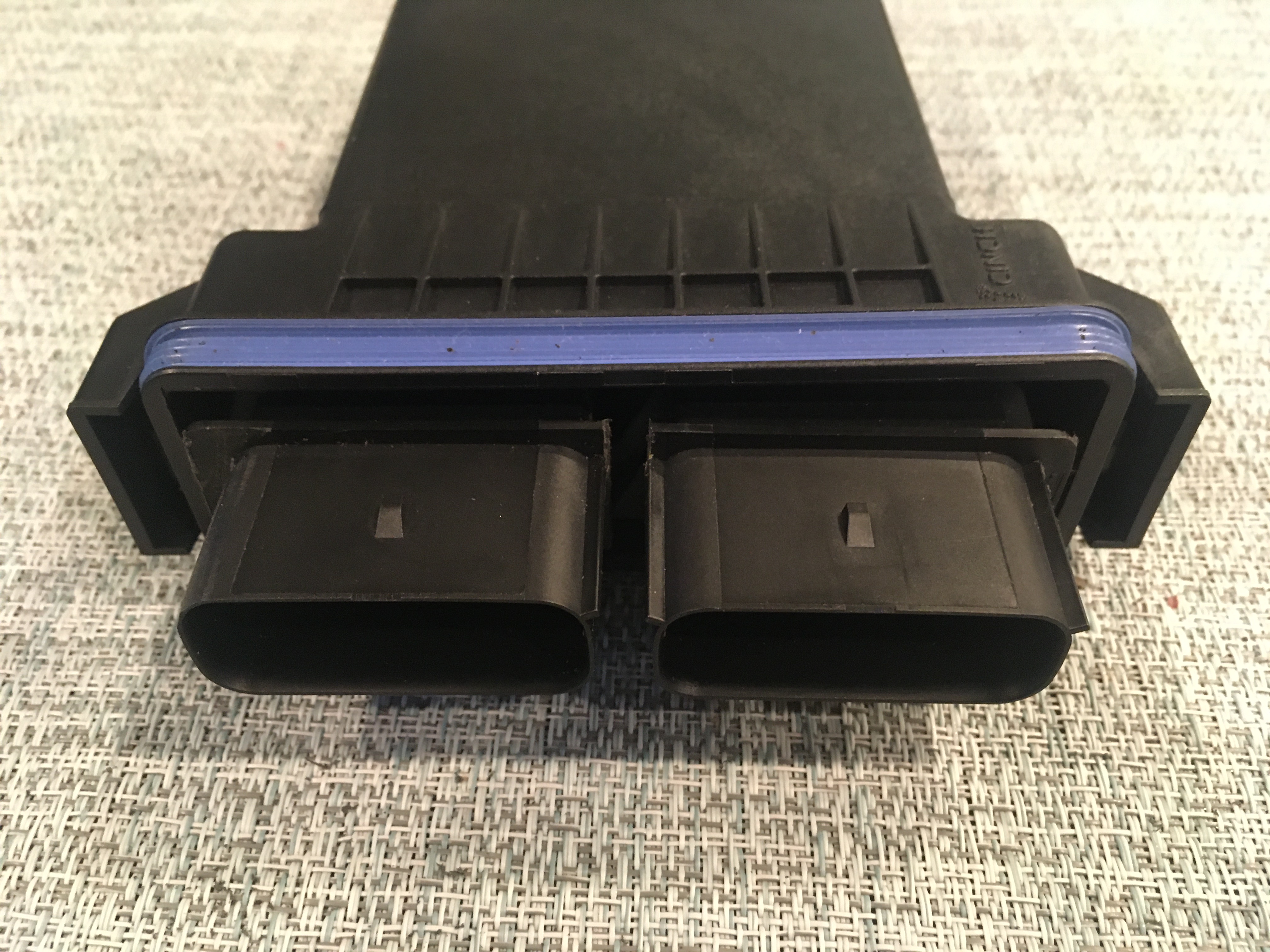

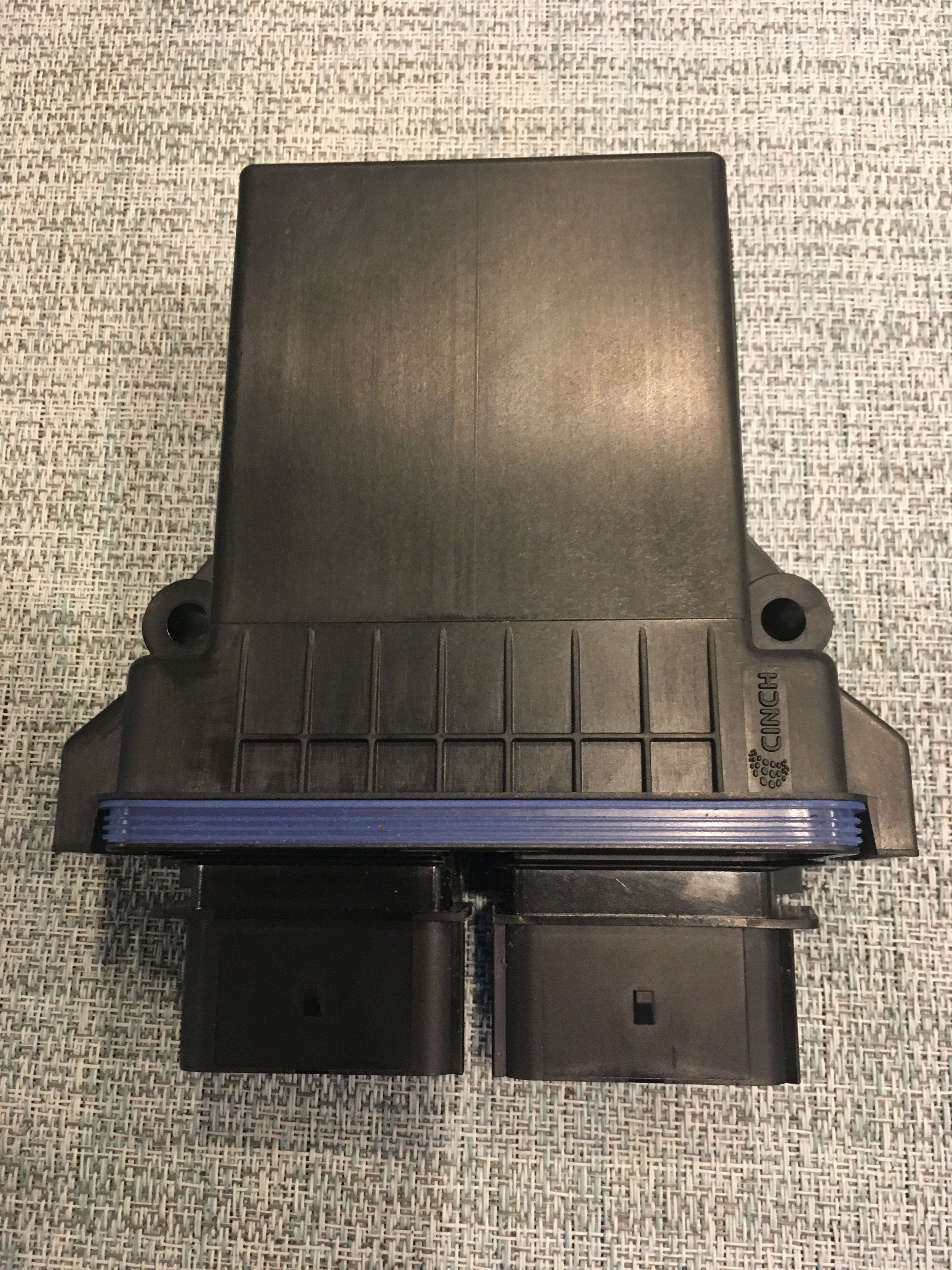

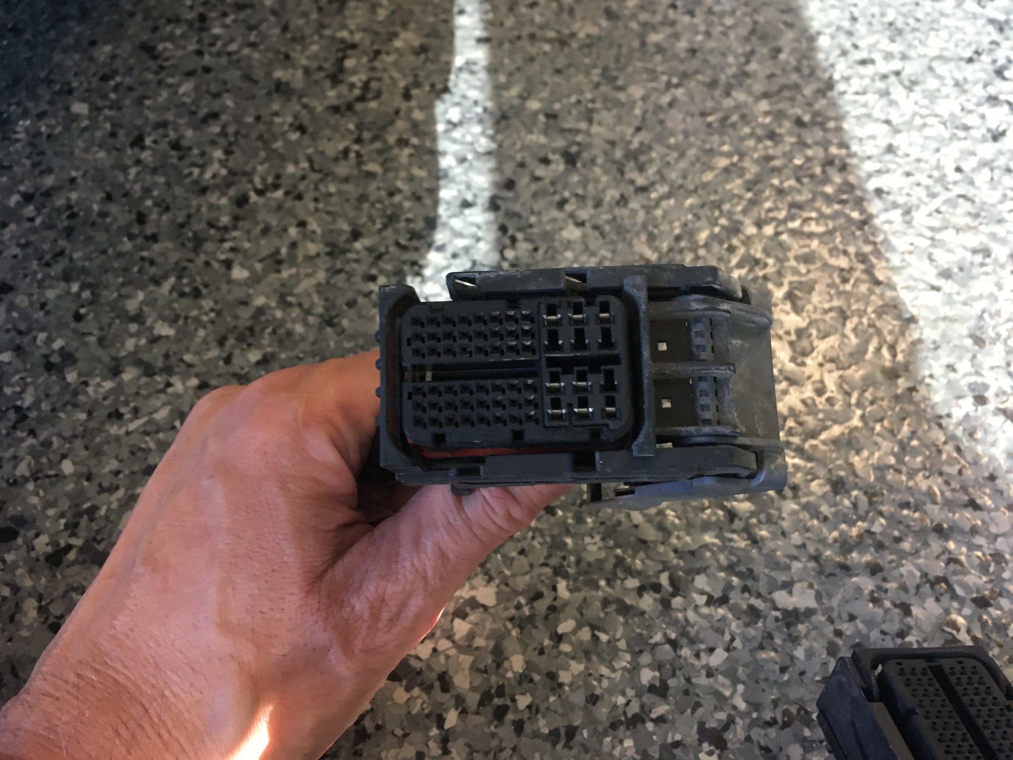

I made the mistake of looking for the Inverter plug in the low resolution pics of the eBay listing, and you can easily mistake the two ECM Engine Control Module plugs (one is larger than the other) for the Inverter plug

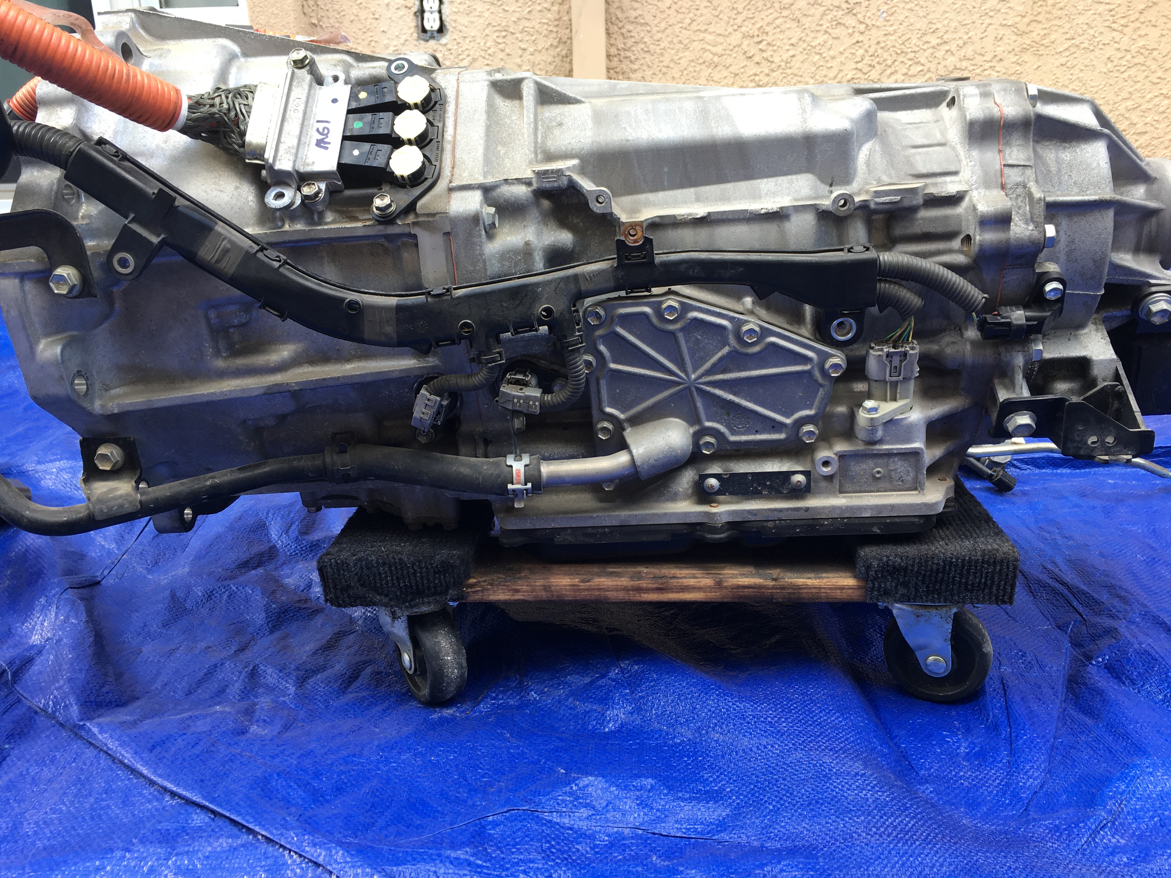

Post by Gregski »

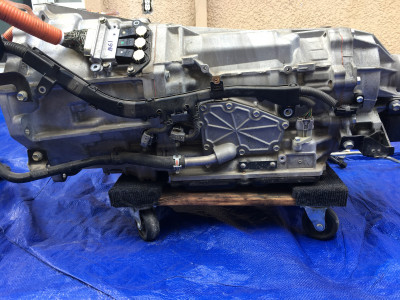

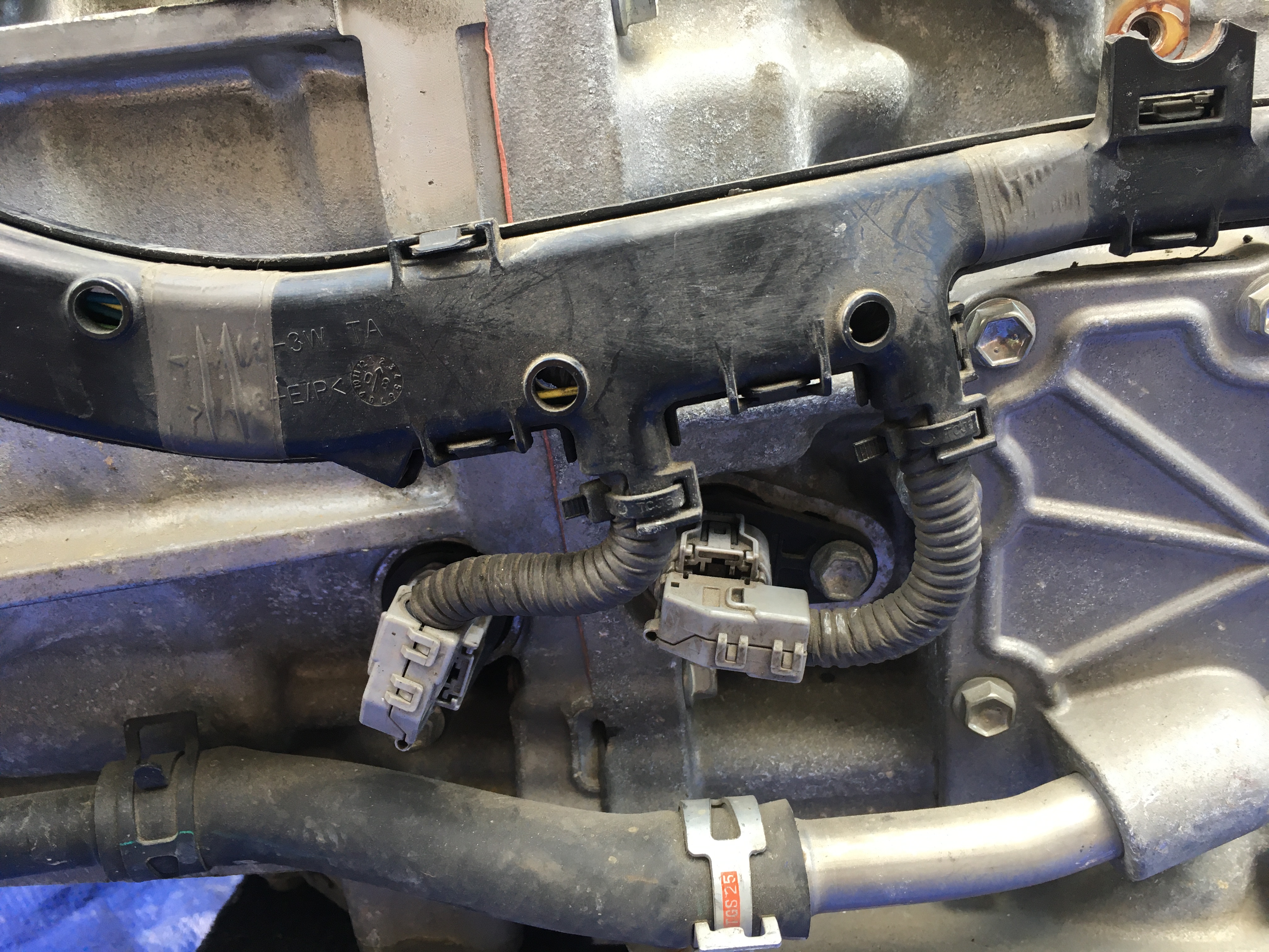

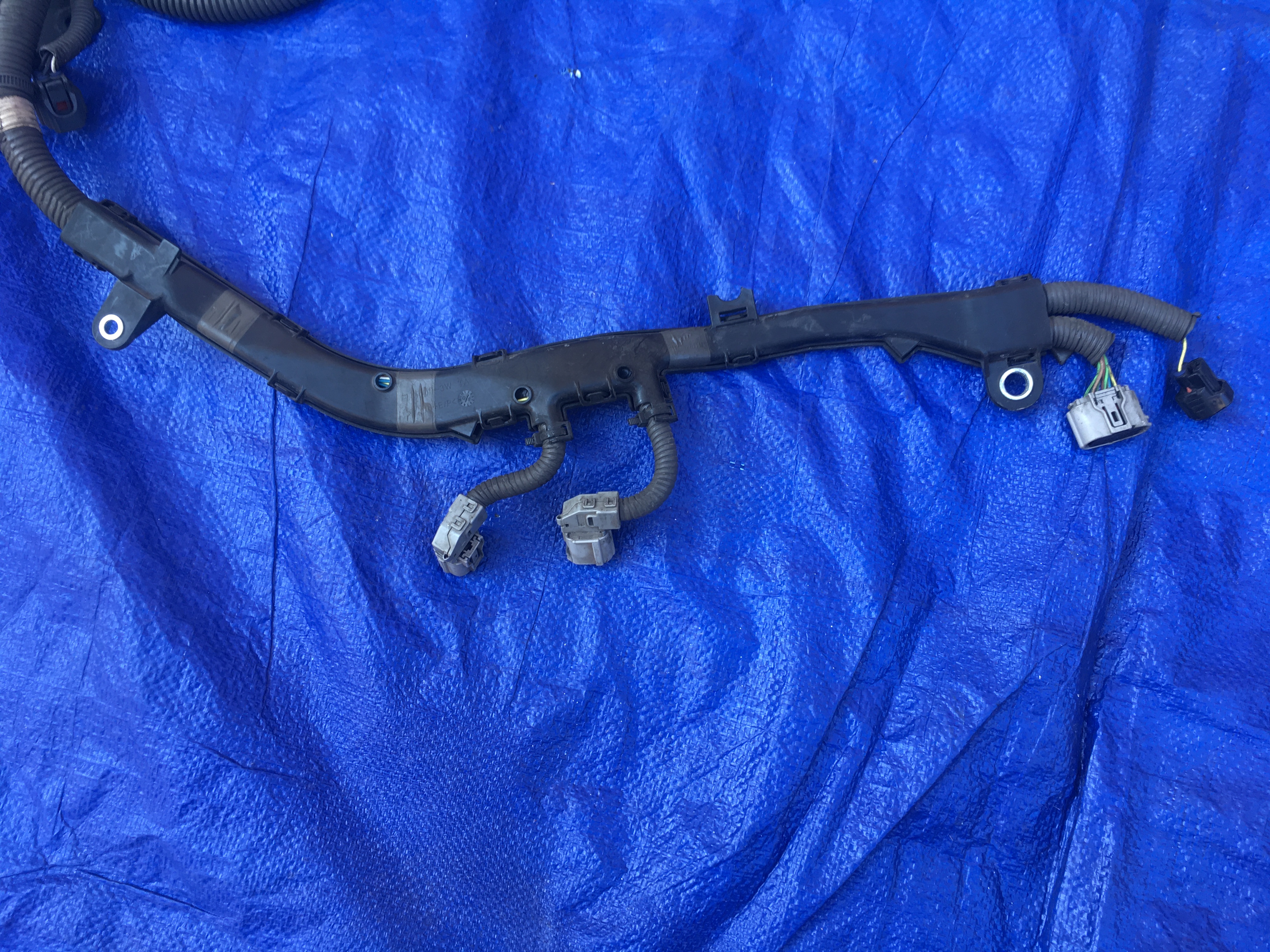

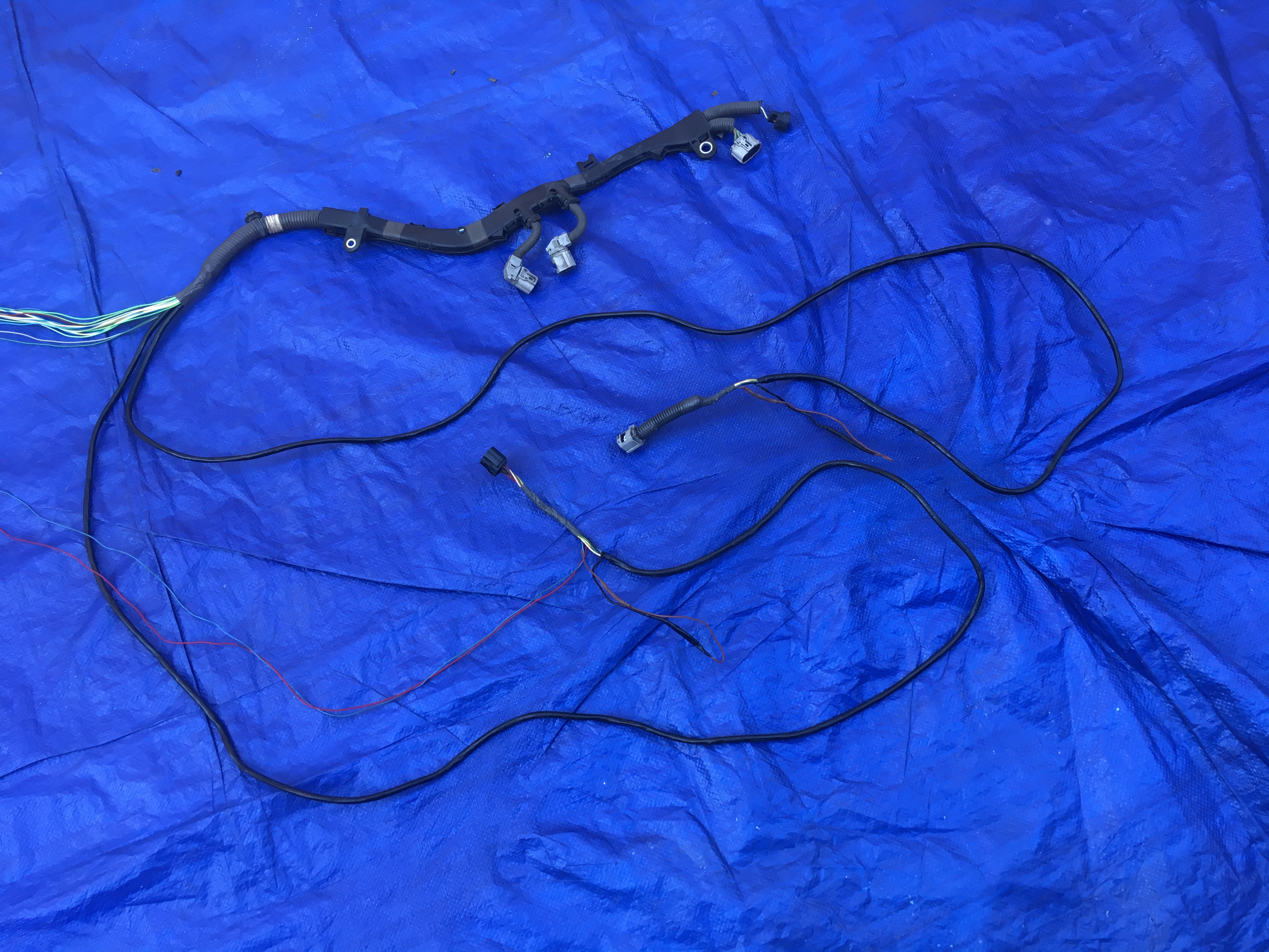

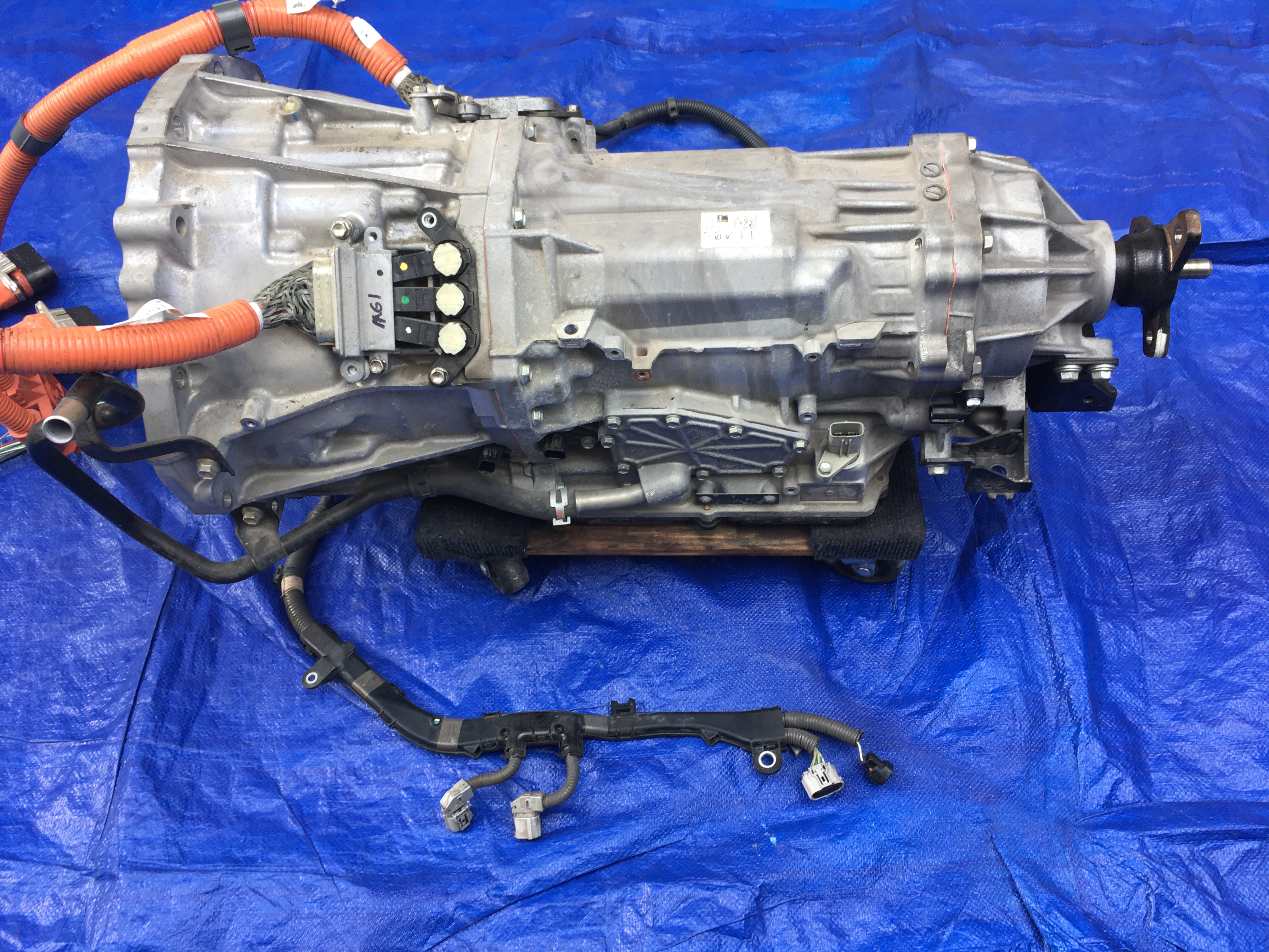

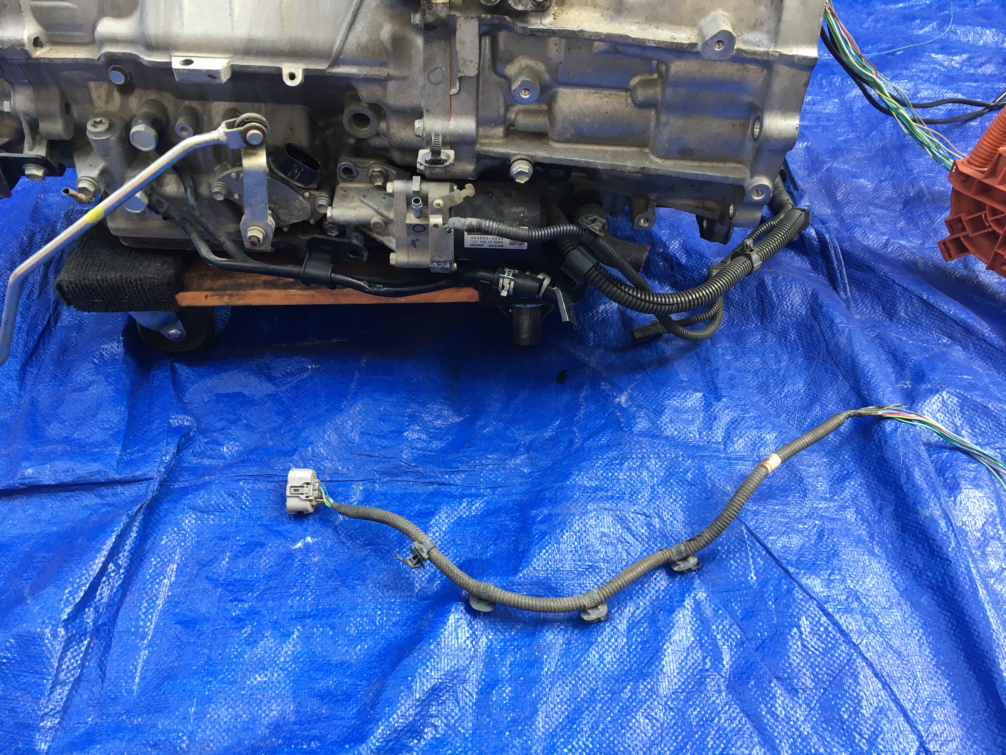

the best way to try and identify this transmission harness in crappy pics is to look for this squigly plastic harness section that runs along the driver side of the transmission, it contains 4 plugs
1. MG1 Resolver connector (gray)
2. MG2 Resolver connector (gray)
3. Shift Solenoids connector (gray)
4. VSS Vehicle Speed Sensor connector (black)
Gregski
Posts: 3158
Post by Gregski »

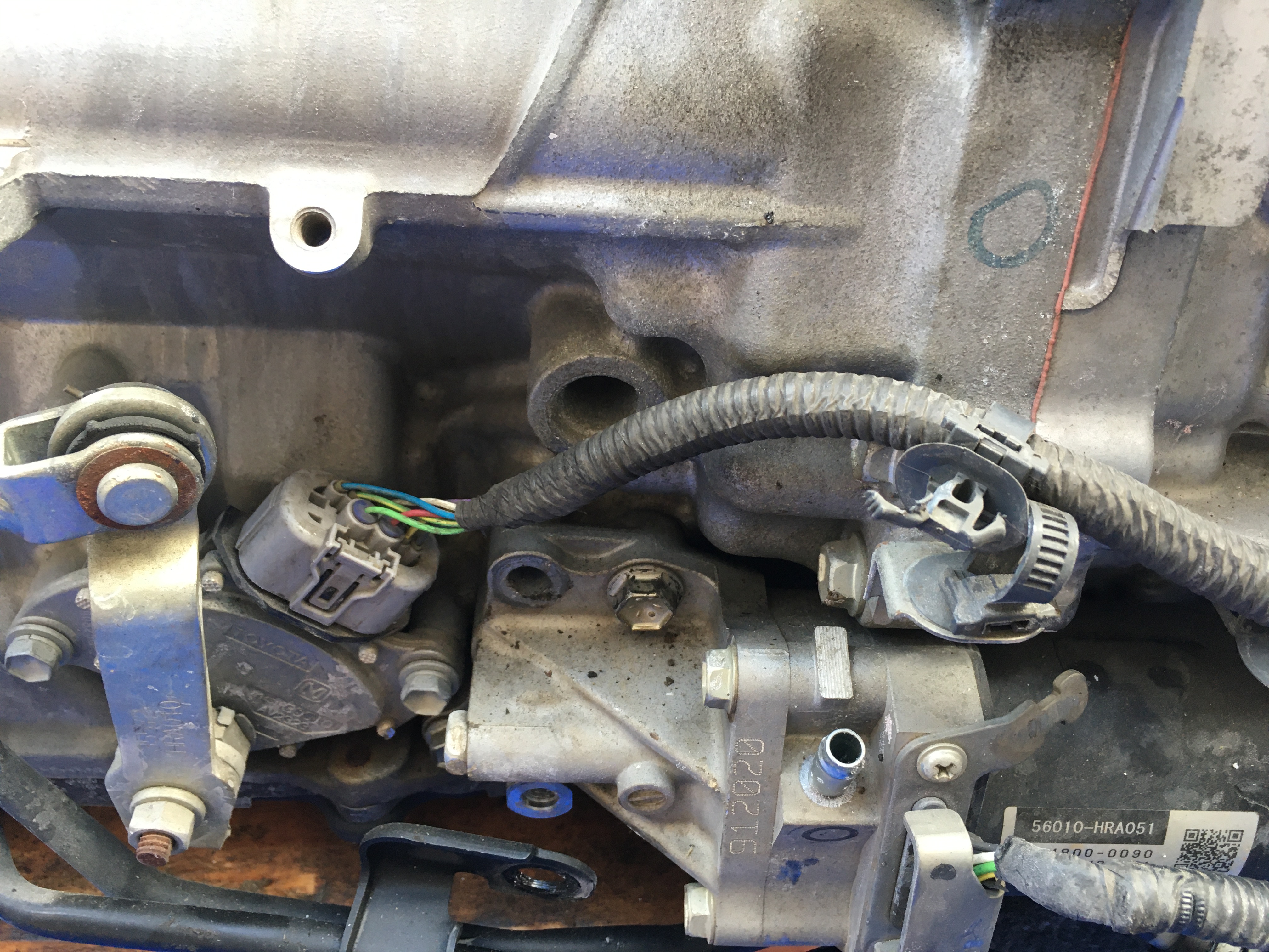

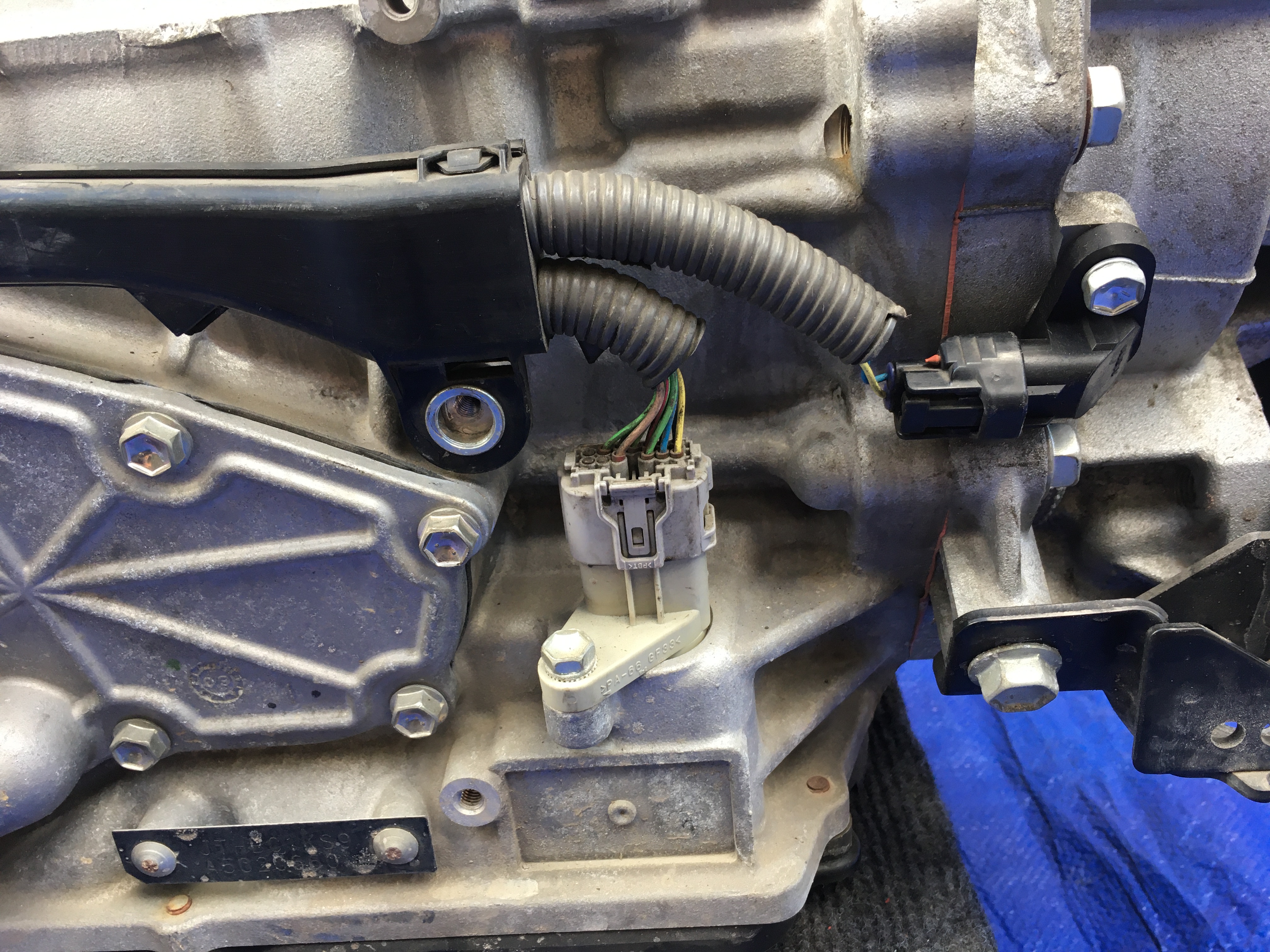

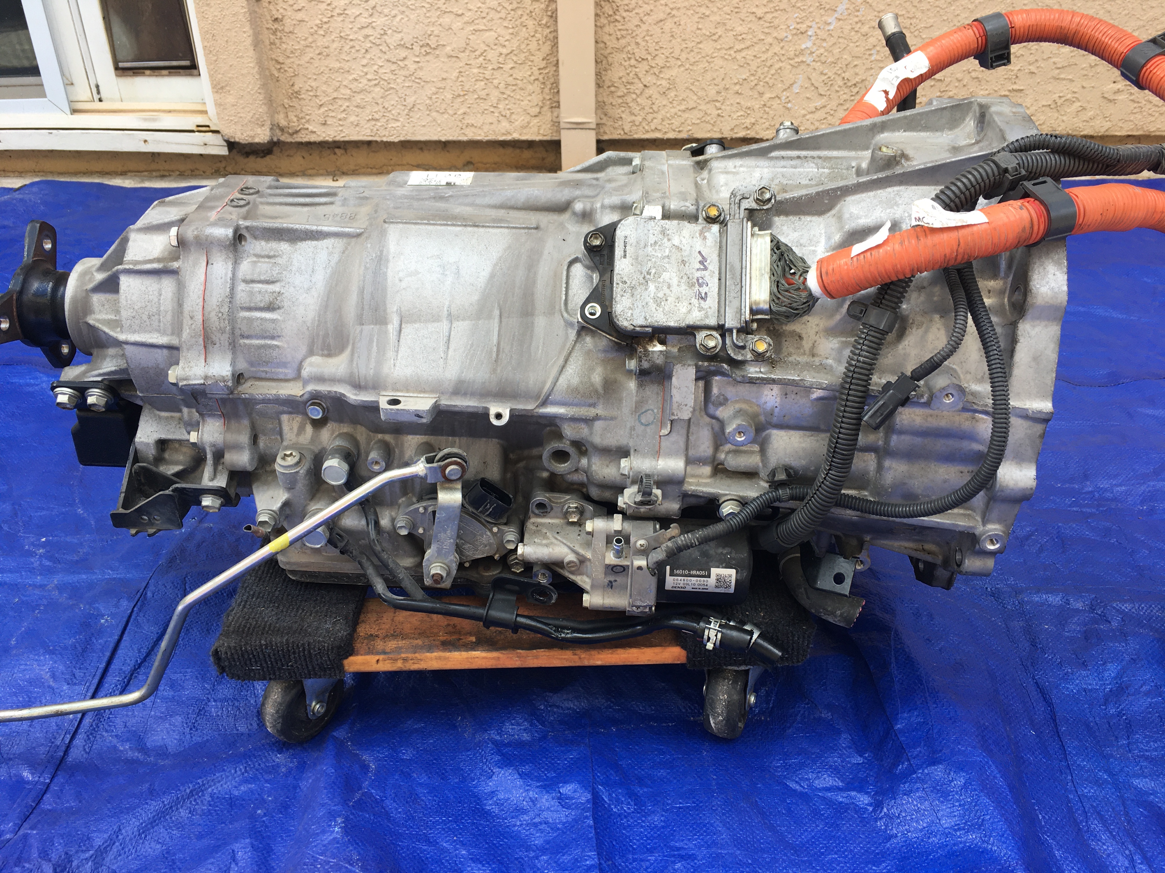

on the other side of the transmission lives the Safety Neutral Switch (gray) connector
so in total we get 5 transmission connectors with this harness

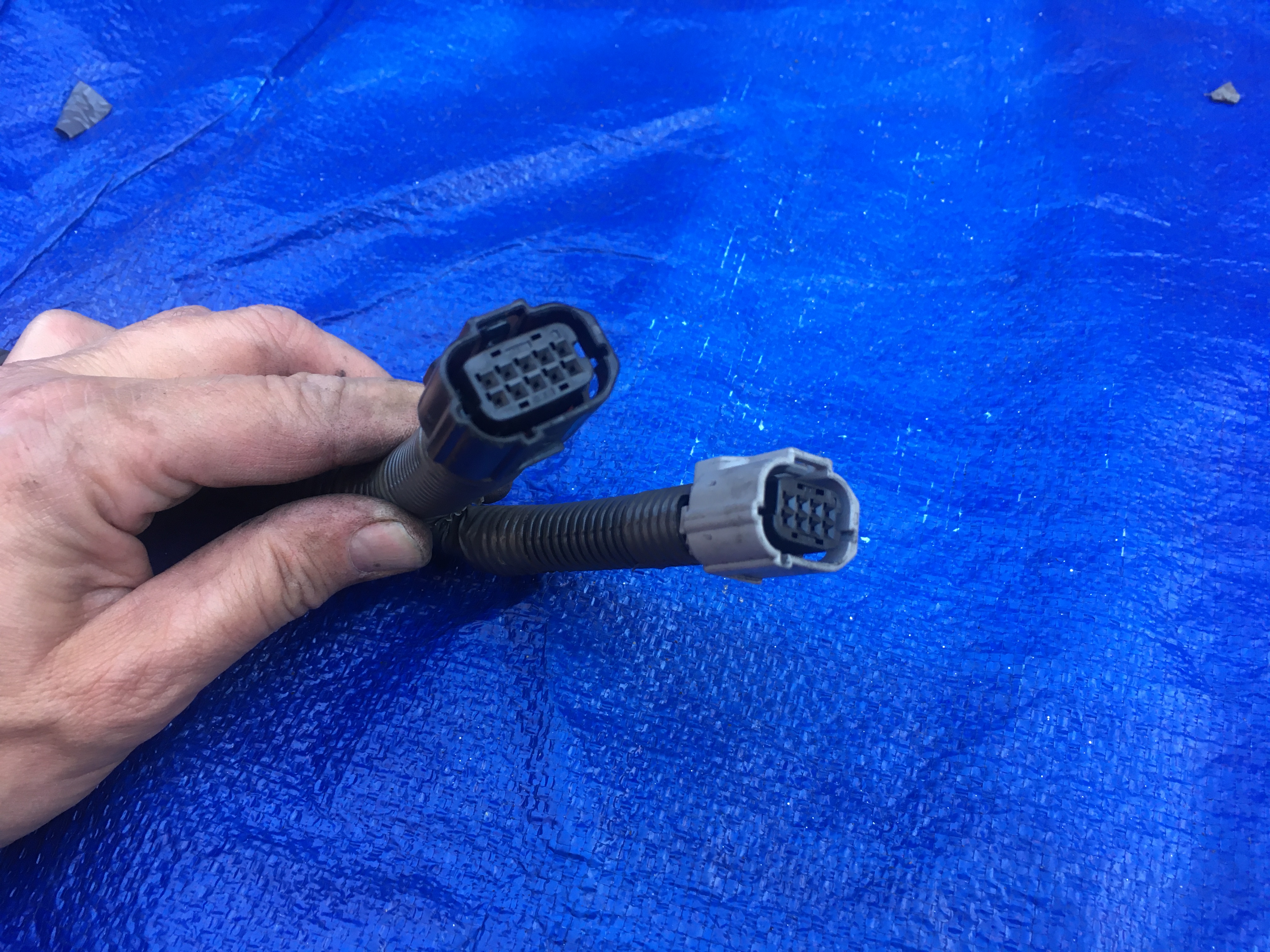

Gregski
Posts: 3158
Post by Gregski »

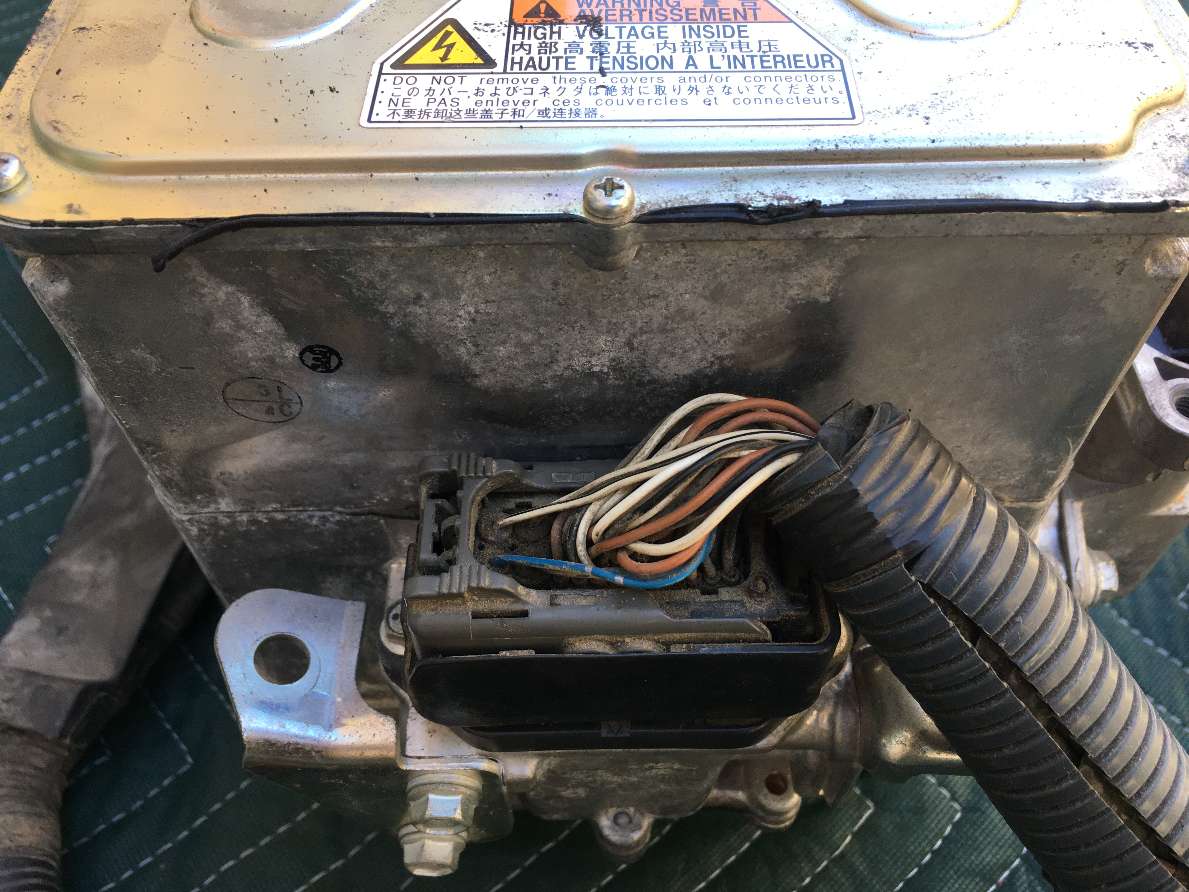

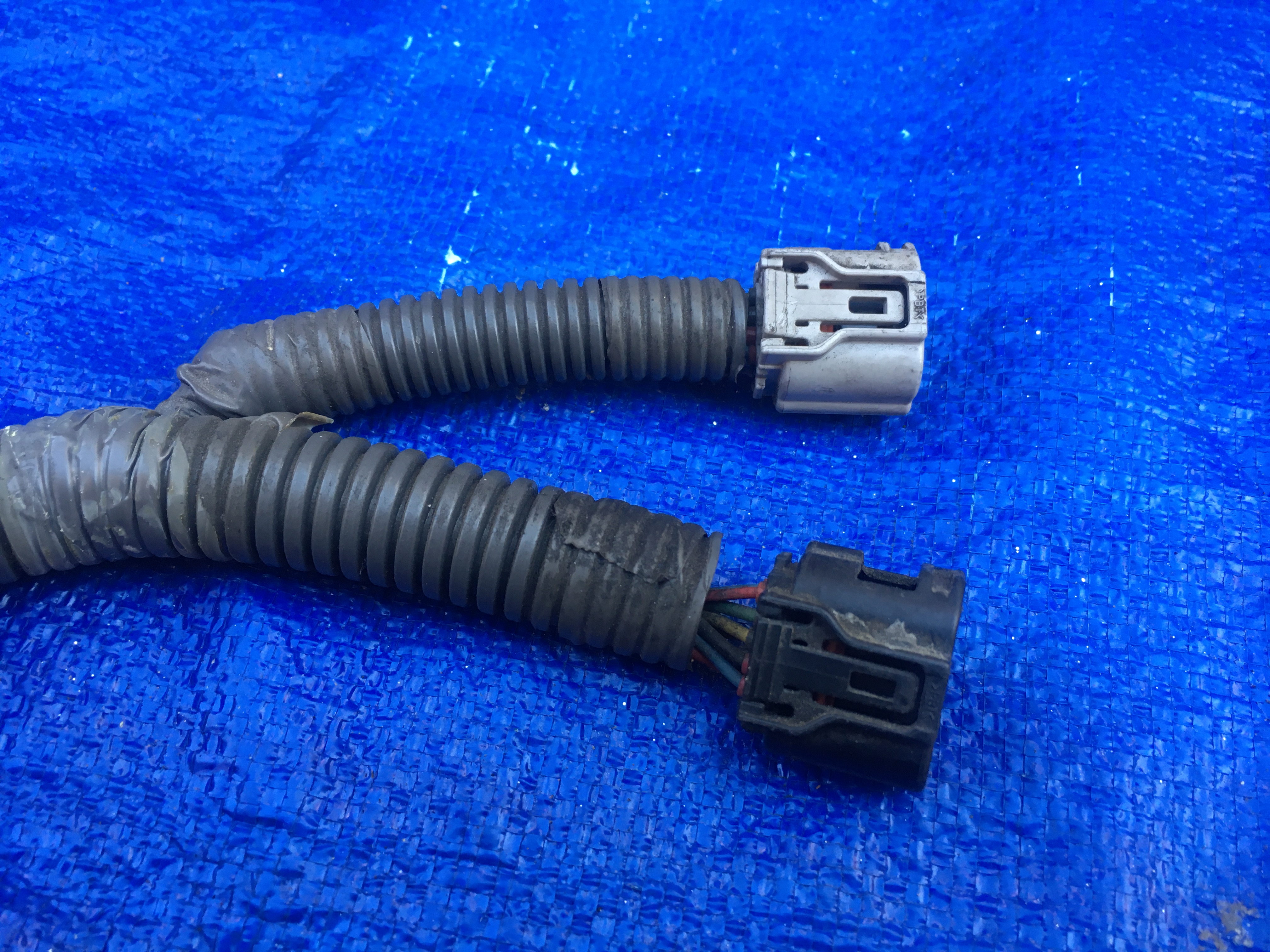

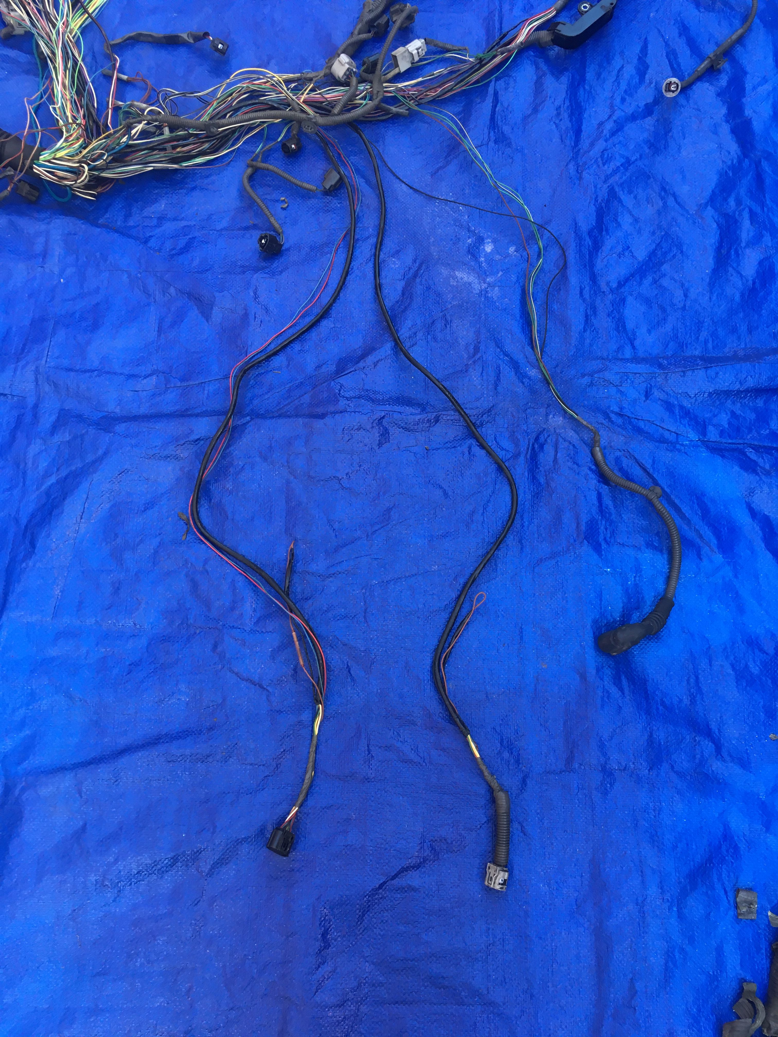

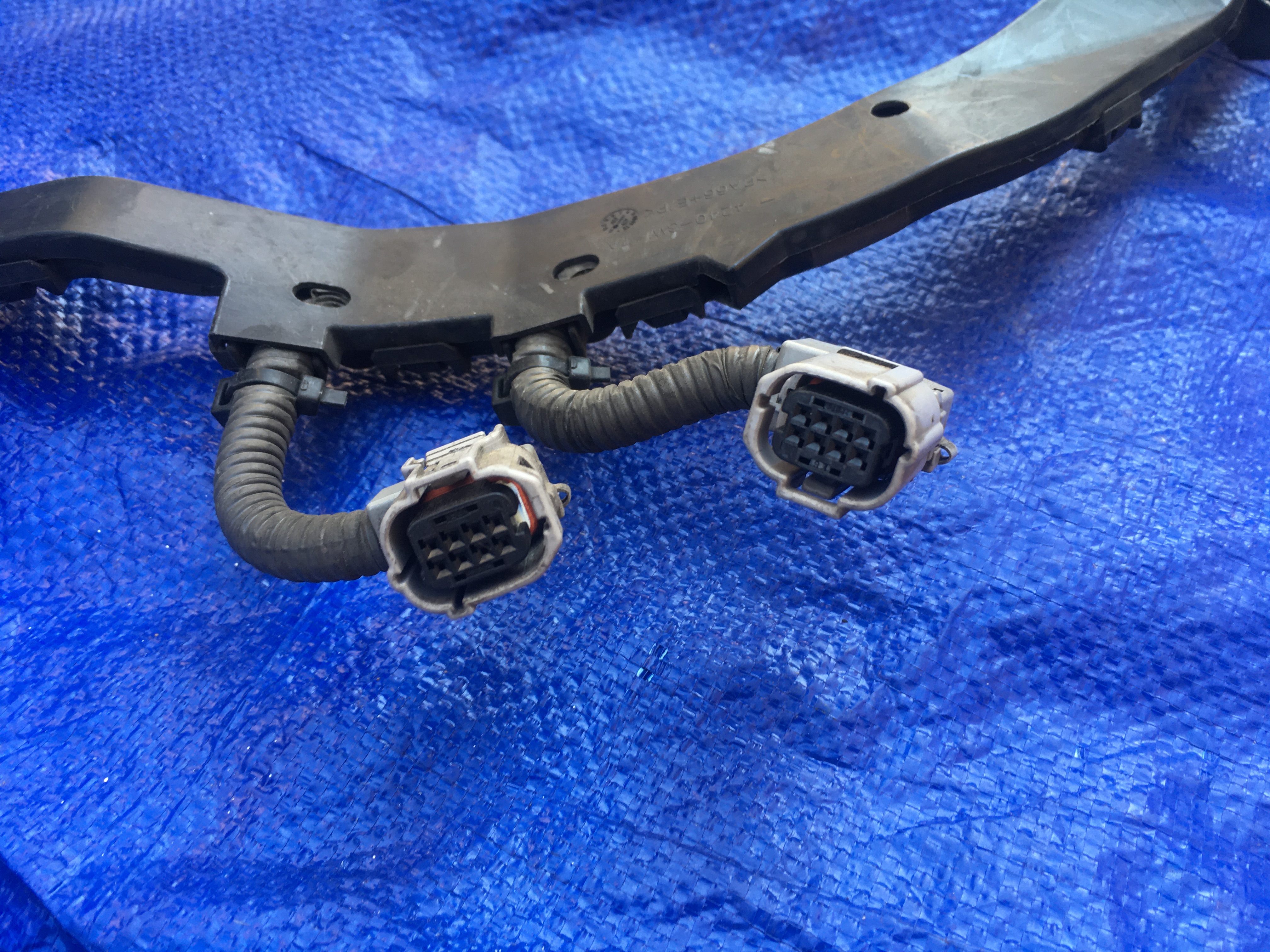

but at the heart of this wire harness are the two complete home runs of the Resolver cables, one per motor
this is the transmission end, each plug looks the same (8 pins each)
However on the other end MG2 (black plug) gets two extra pins, these are for positive power leads for the Inverter
Gregski
Posts: 3158
Post by Gregski »

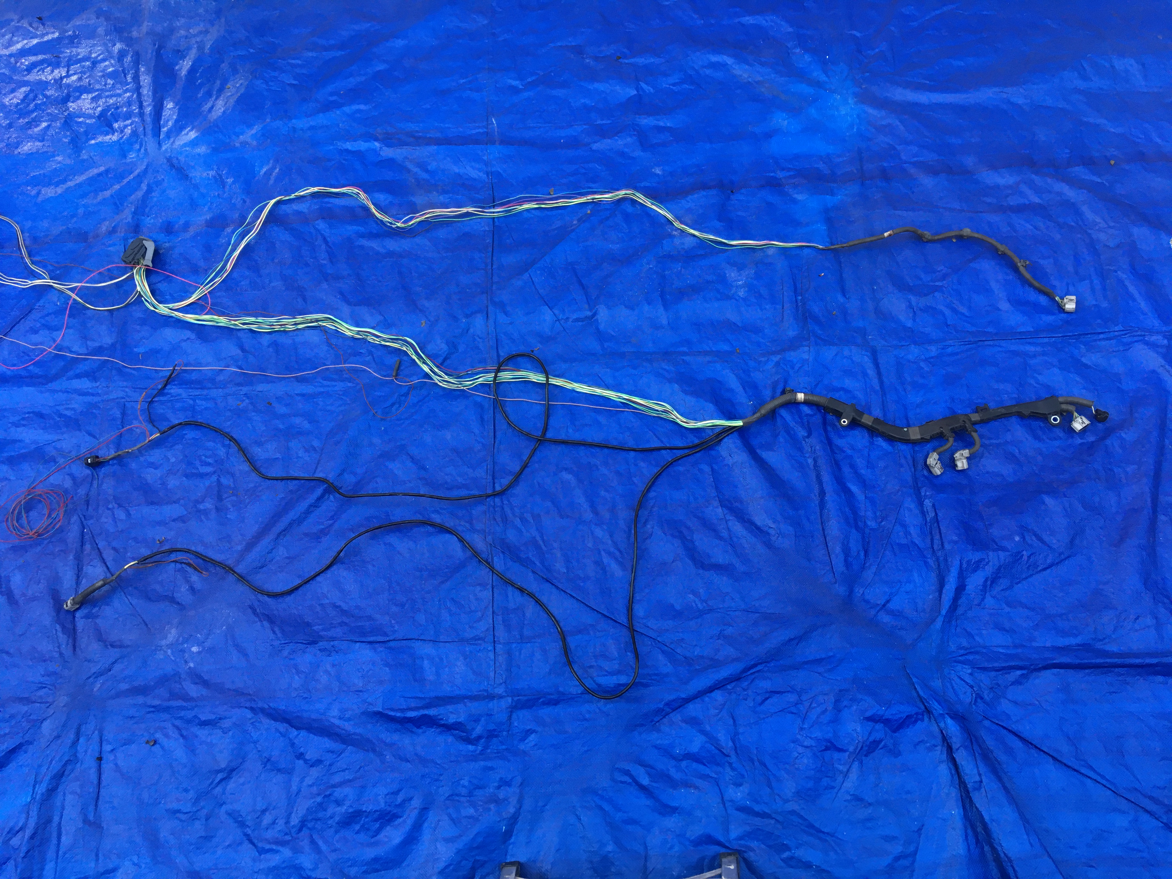

so here are those two Resolver cables separated from the Engine Wire aka transmission harness, this alone to me was worth $250 and you will understand once you attempt to crimp these to the plugs, ha ha
Gregski
Posts: 3158
Post by Gregski »
and here's all the crap we don't need from that Engine Wire harnesss
Gregski
Posts: 3158
Post by Gregski »
and here is all that we do need (we don't need that plug in upper left of the pic, I just kept it to keep everything together)

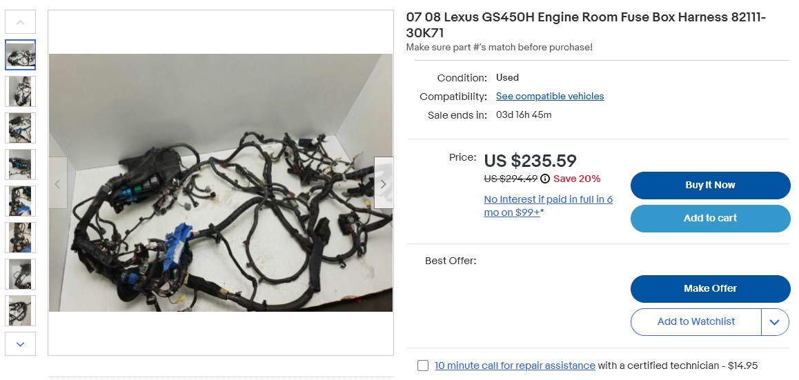

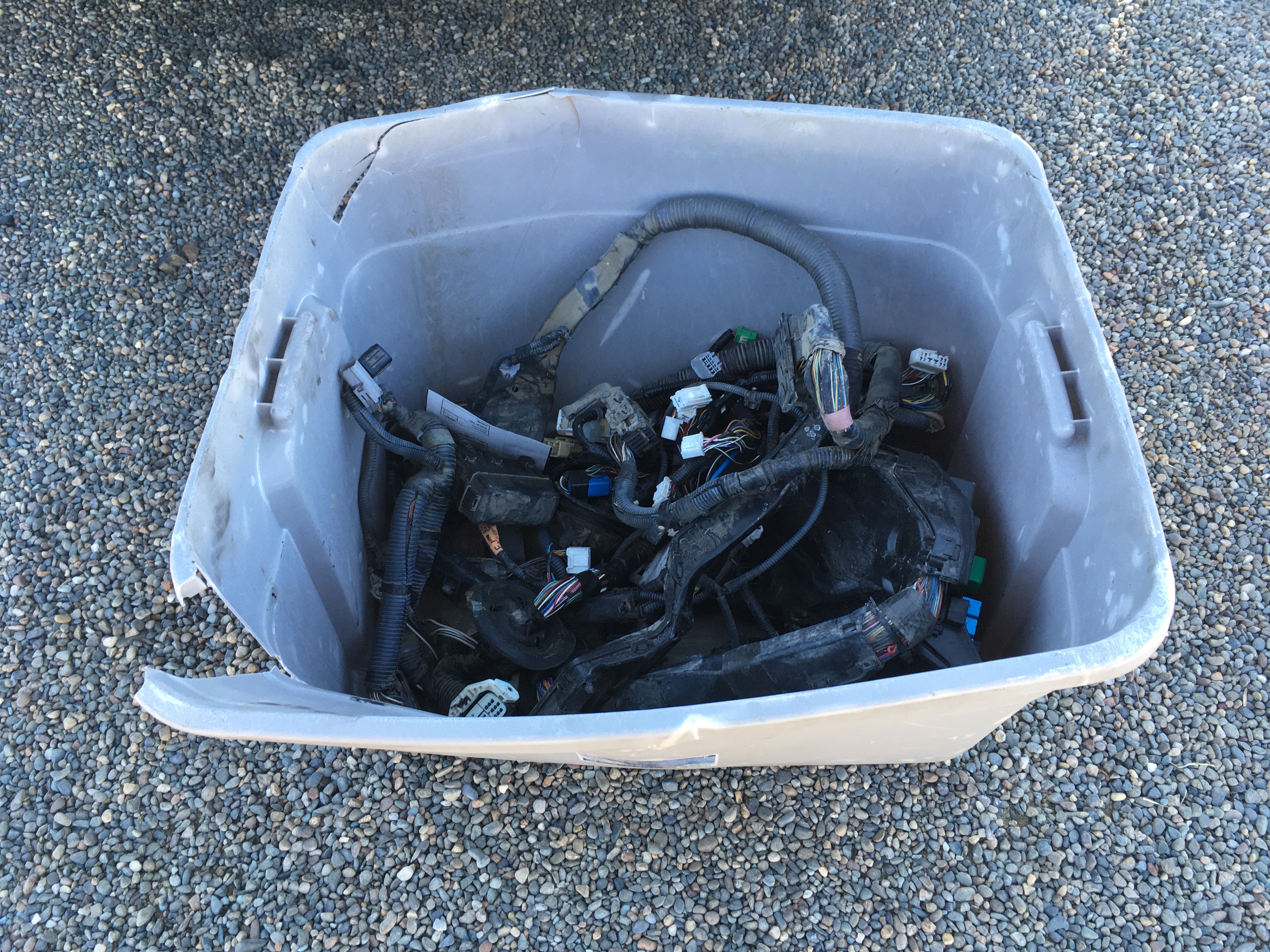

with the transmission harness thinned out I quickly realized it take Two To Tango so I went out and paid $300 dollars for a $235 dollar Inverter harness official name is Engine Room Main Wire
Part Numbers:
82111-30K62 fits 2008-2009 (this is the used one that I just bought)​
costs $7,144 new
82111-30K64 fits 2010​
costs $6,341 new
Part Number: 82111-30K71 fits 2007-08

don't get too hung up on the part numbers many different part numbers will work/fit, the difference in part numbers does not only depend on the year of your Lexus but the options on that vehicle like what kinds of headlights it is equipped with, I am not making this stuff up, I spoke to a parts rep at the stealership
when I lay awake at night I justify overpaying by telling myself mine came with this handsome carrying case

Post by Gregski »

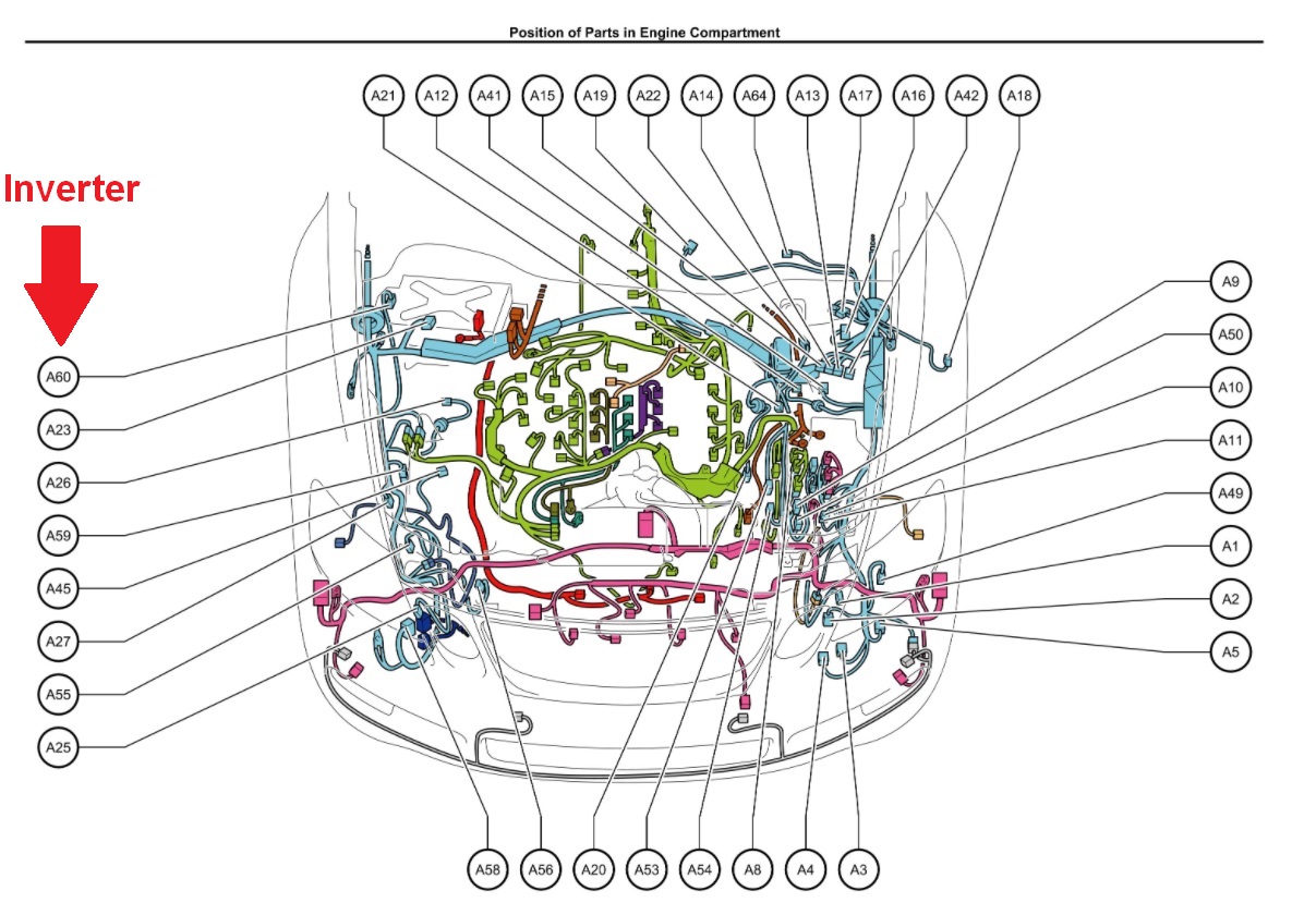

so once again we turn to the craptacular Lexus wire harness diagram to identify the Inverter Harness aka the Engine Room Main Wire
Note: everything points to the light blue inverter harness

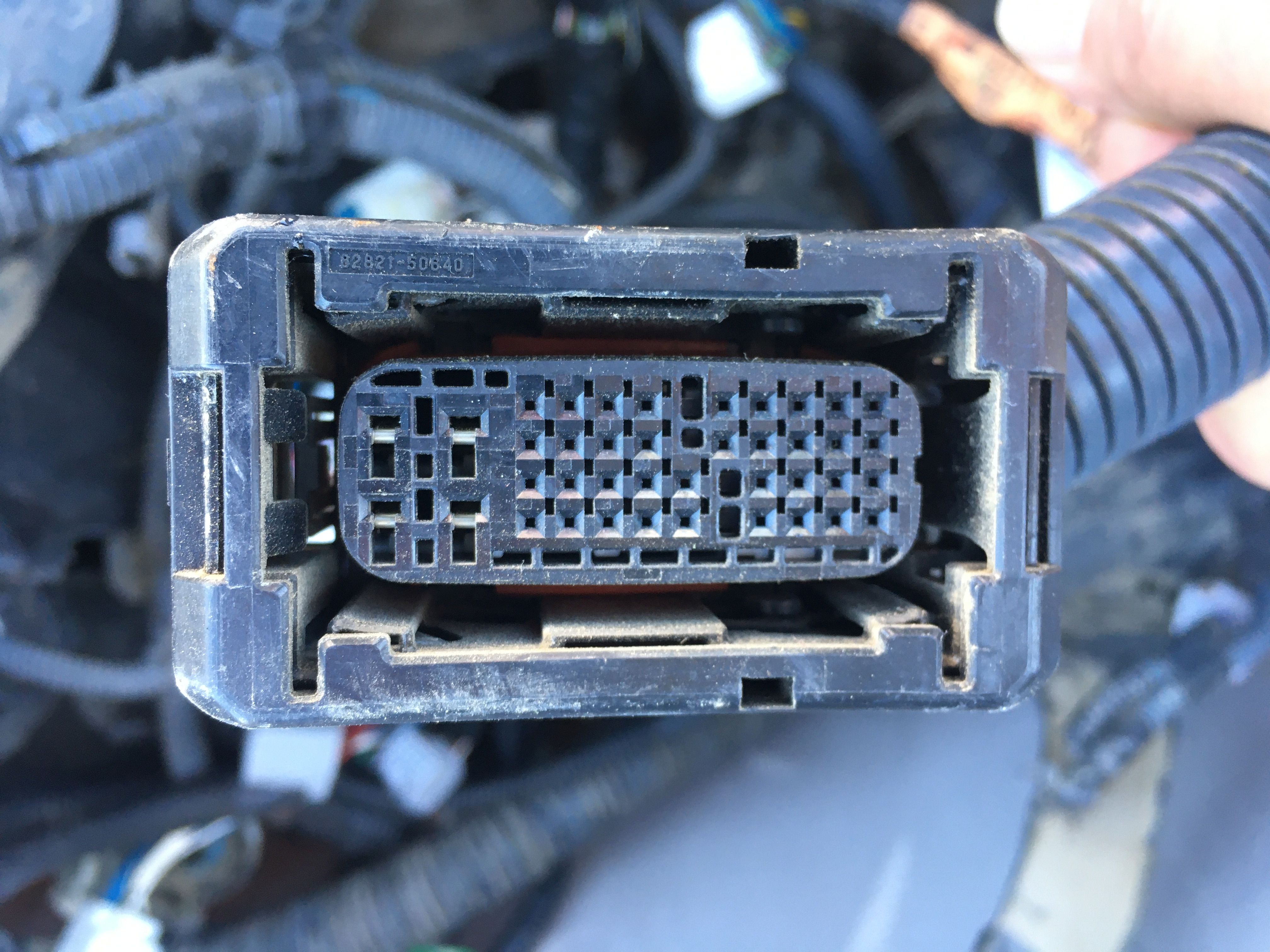

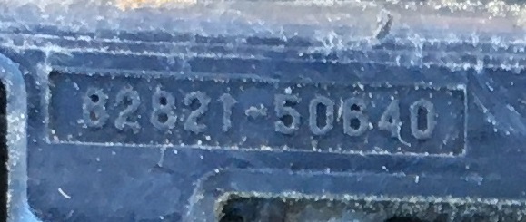

and yes this one comes with the coveted Inverter plug part number 82821-50640

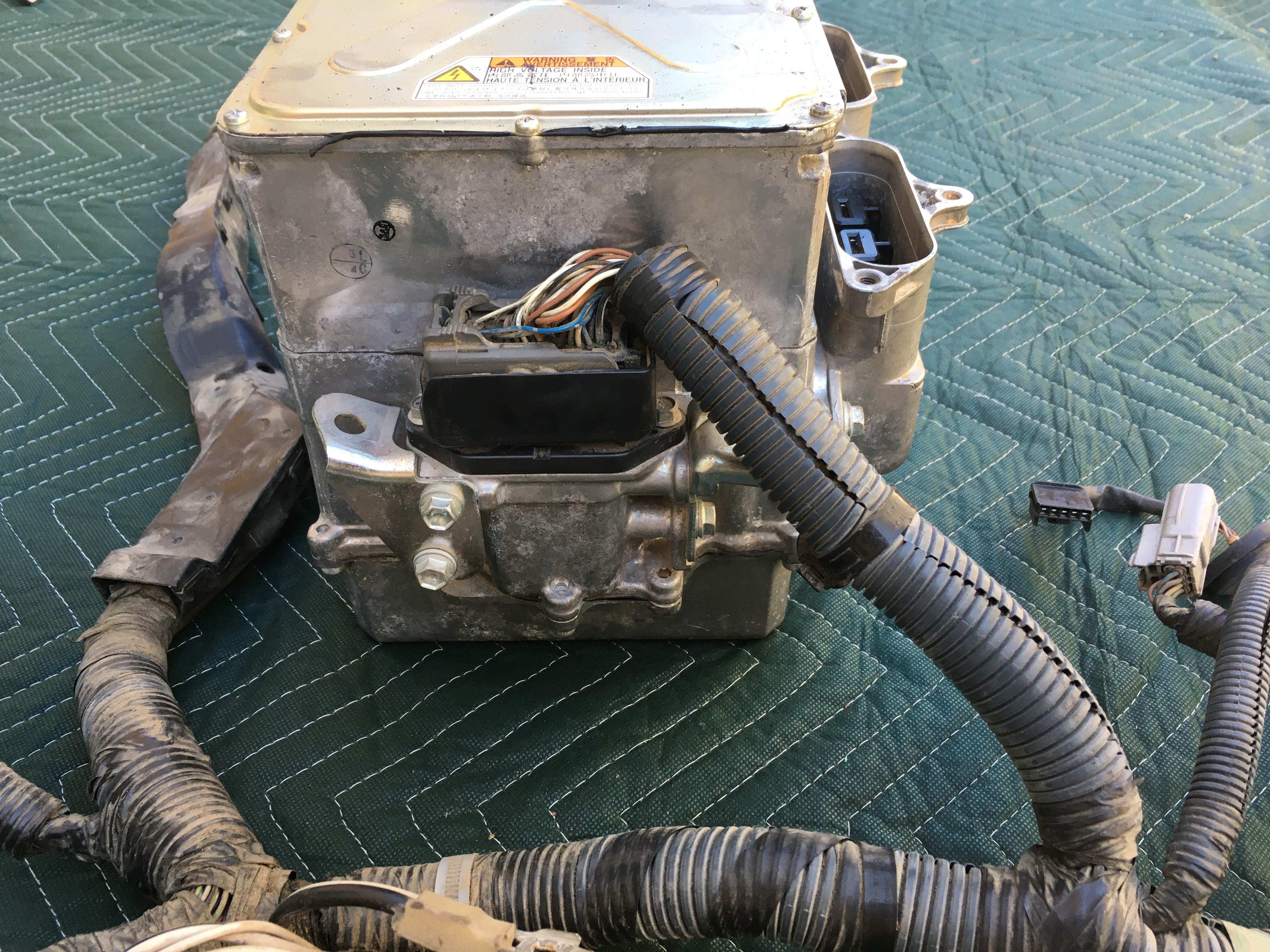

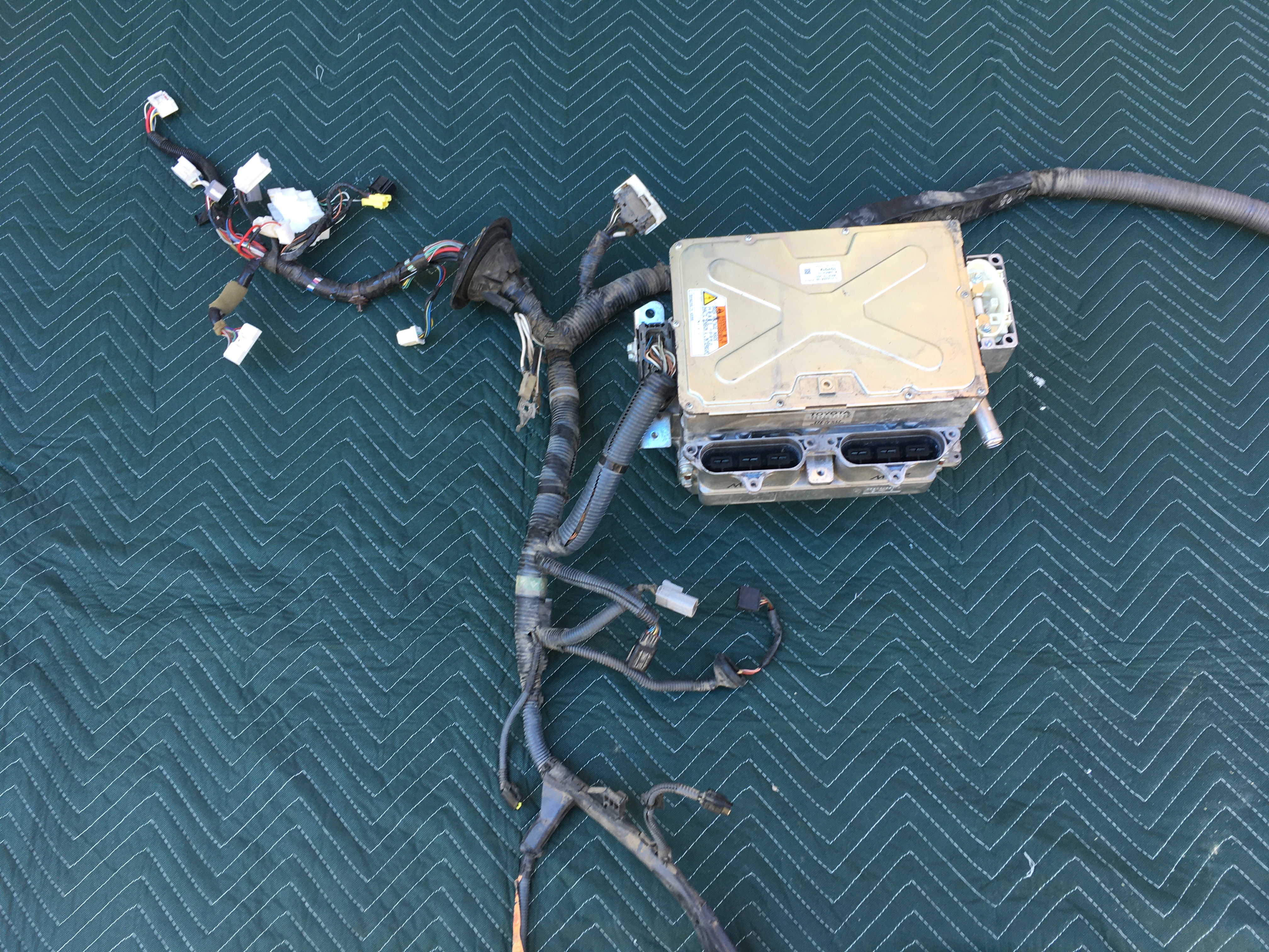

anatomy of the Lexus GS450h Inverter Harness
Gregski

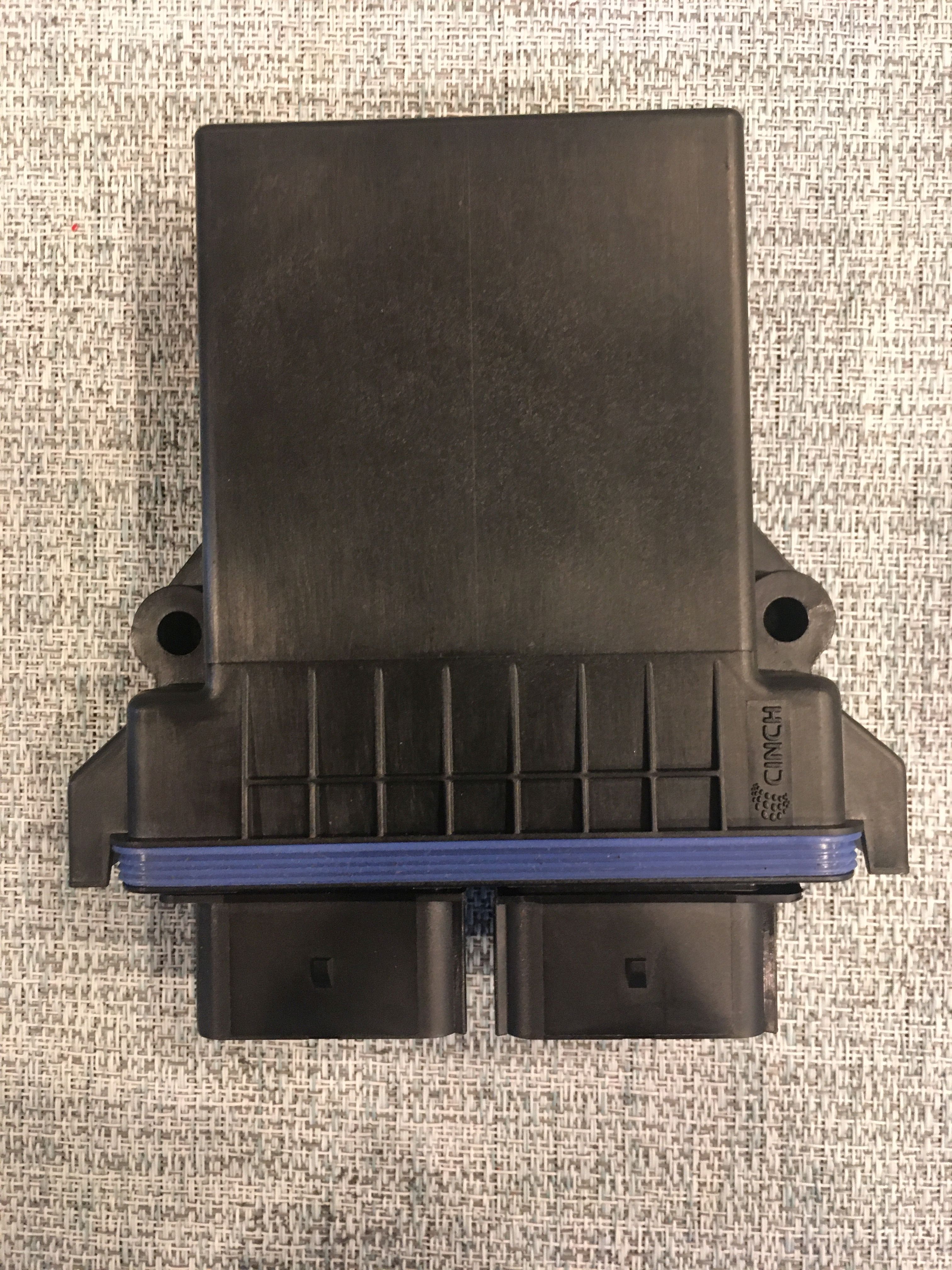

Posts: 3158
Post by Gregski »

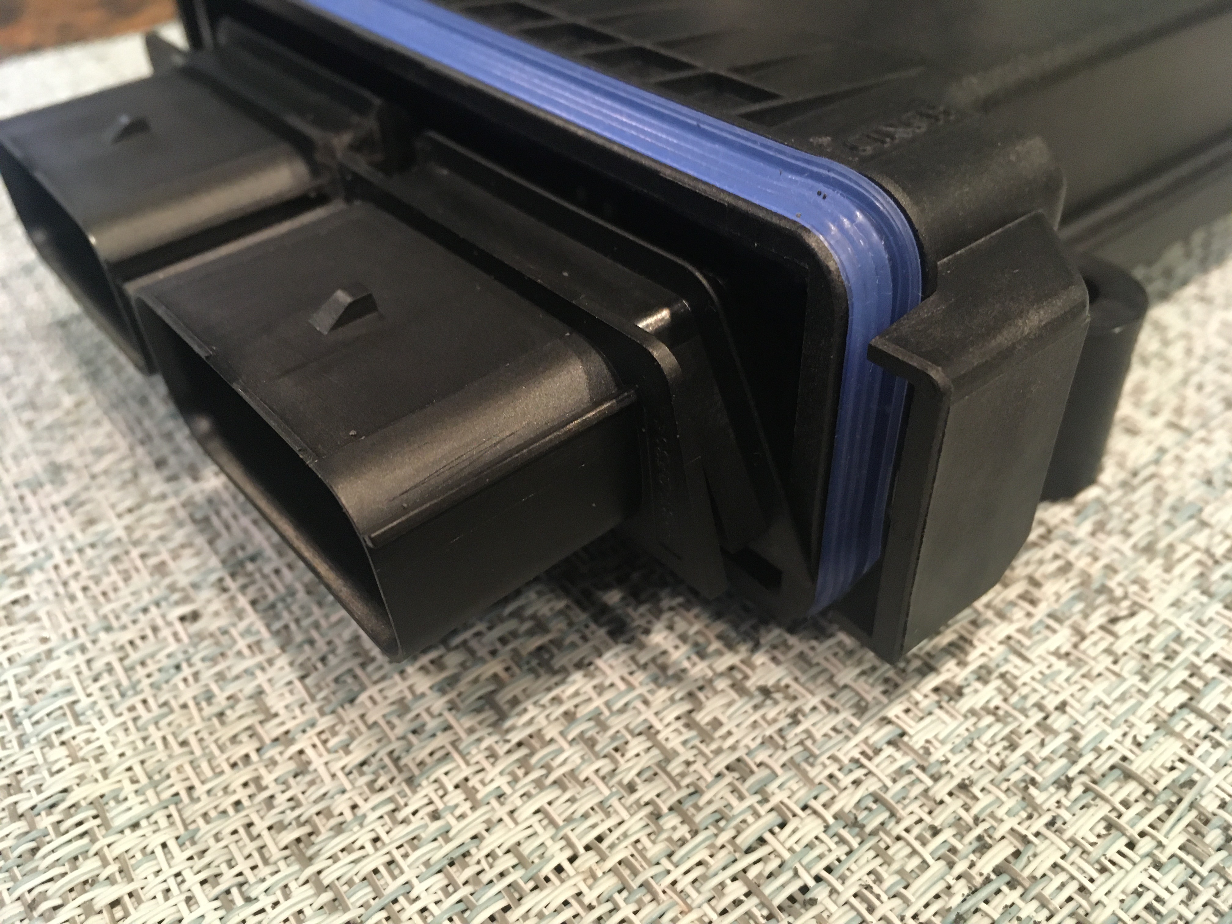

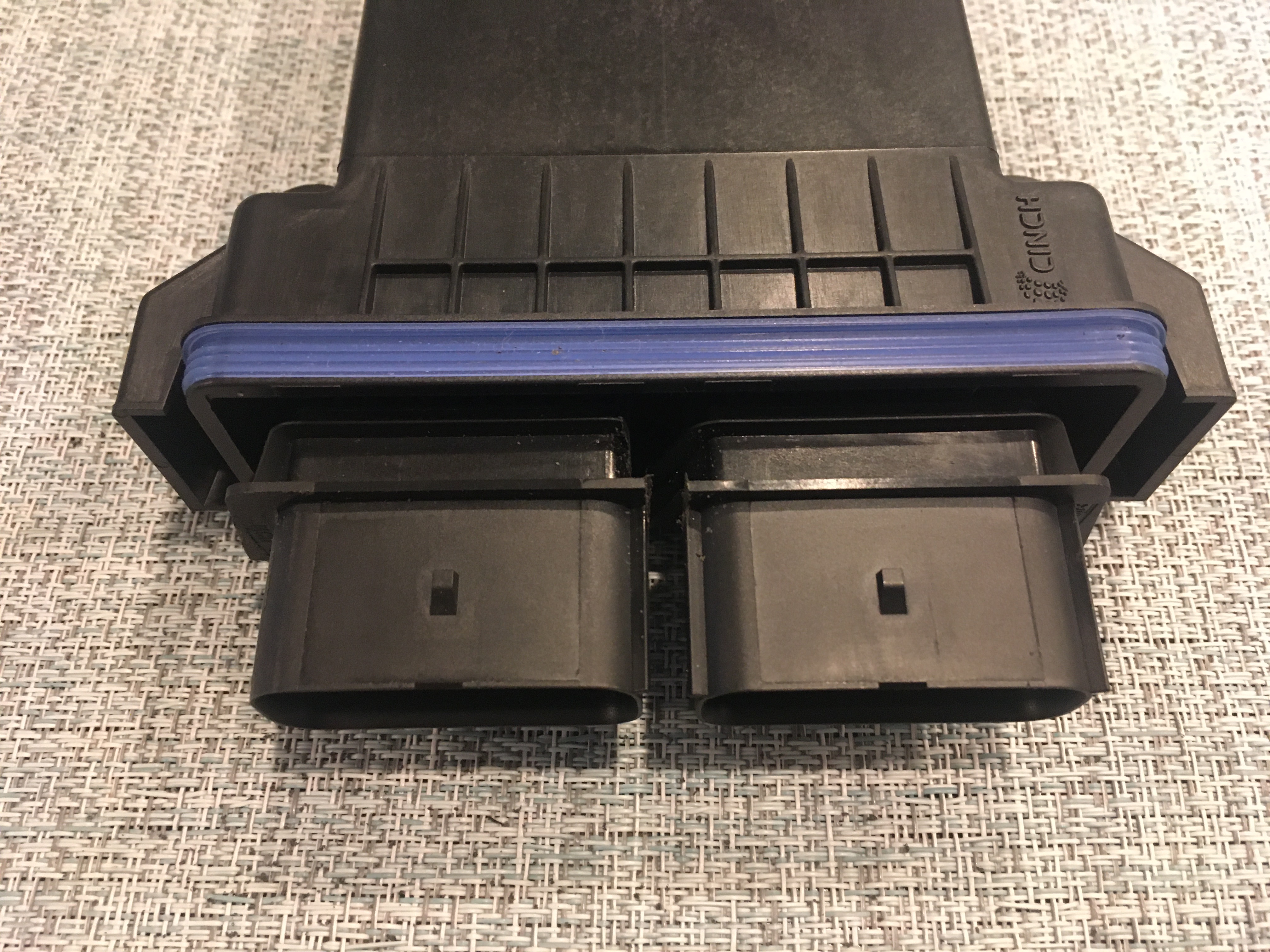

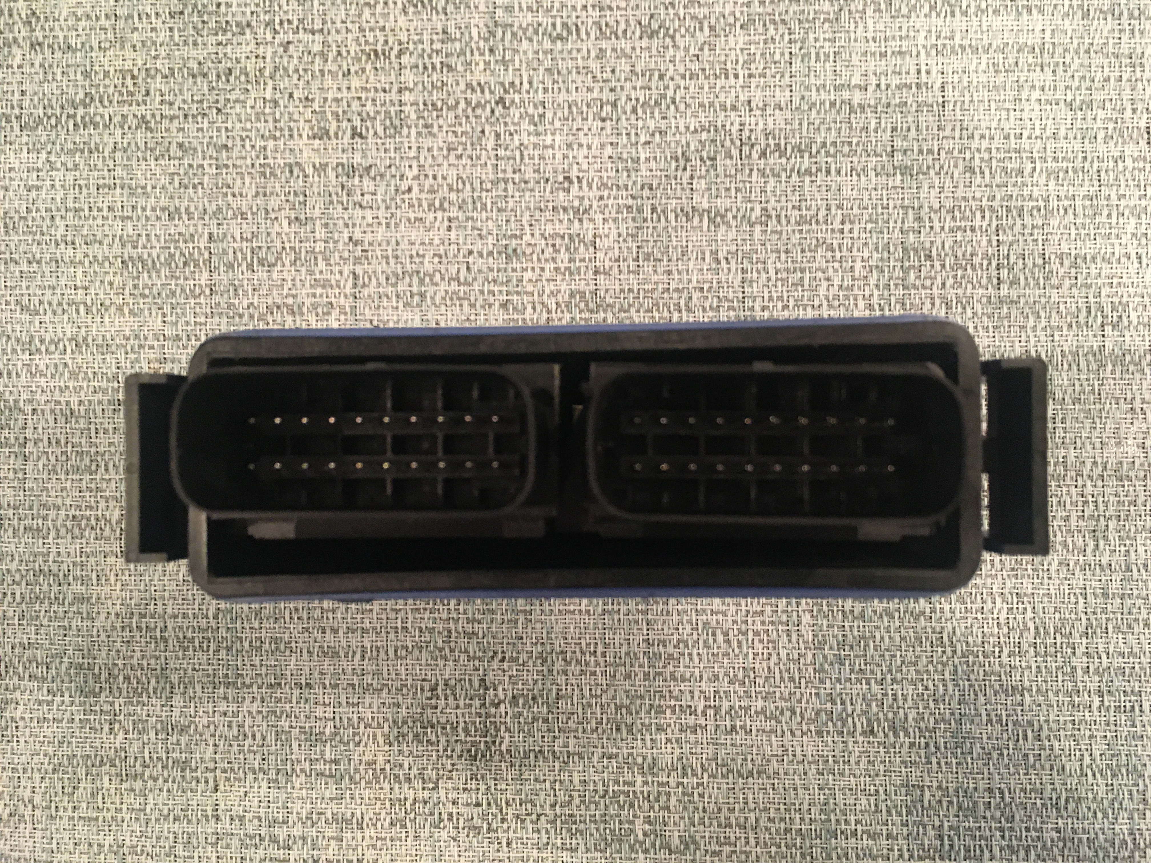

and here is the star of our show, Mr. Inverter himself
