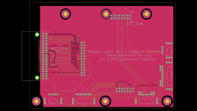

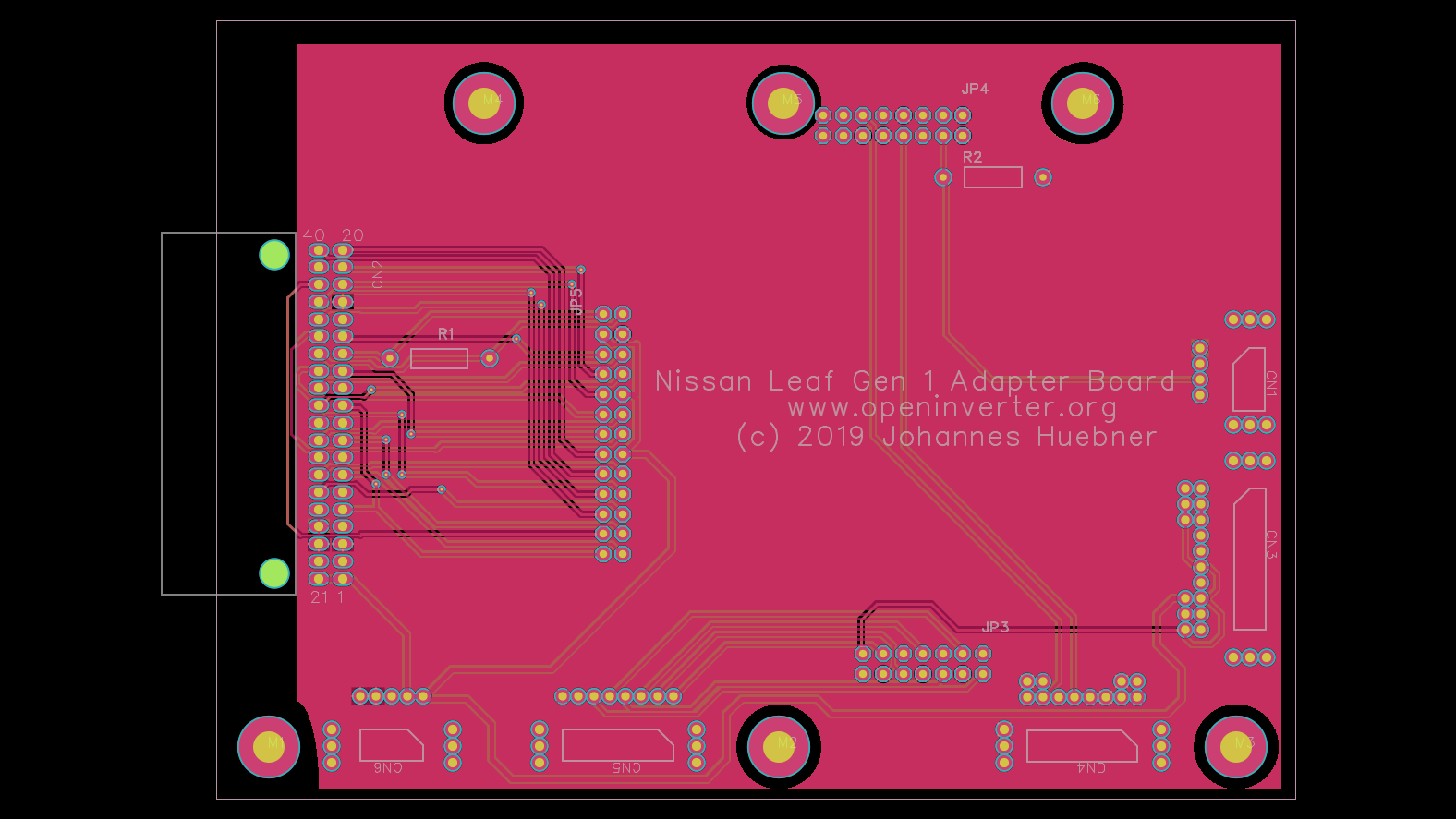

If possible keep power,ground and CAN lines the same as oem on the white connector that way I can just drop this straight into my inverter.

Yes thats what I tried to do. Please check if I succeeded. Any luck poking around?
Been thanked: 1918 times
Re: Leaf Gen 1 board
Mounting holes done. Now only bus voltage and general pin verification by someone with an original controller is missing

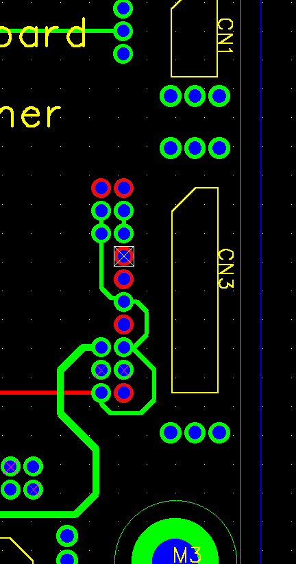

You would need to be able to vary your DC bus voltage and then check if one of the pins on CN3 changes proportionally. I have painted the unknown ones in red. Also measure in frequency mode to check if its a PWM signal (like on Gen2).
Measure with a clip and turn on power when the clip is secure to avoid shorting out anything

Ok, I added a 3-way jumper that lets you try out 3 possible inputs on CN3 for bus voltage. Also added possibility for pull-up or down resistor.
No, FOC doesn't really need the voltage, at least not per the current implementation.
So Gerber files attached, does anyone with a Gen1 Leaf want to get some boards made?
Mini BOM:
CN1: GT8E-4P-DS
CN2: TE AMP 1318384-4
CN3: GT8E-16DP-DS
CN4: GT8E-12DP-DS
CN5: GT8E-8P-DS
CN6: GT8E-5P-DS
R1: 120 (optional)
R2: 1k2
leaf-gen1-adapter.zip

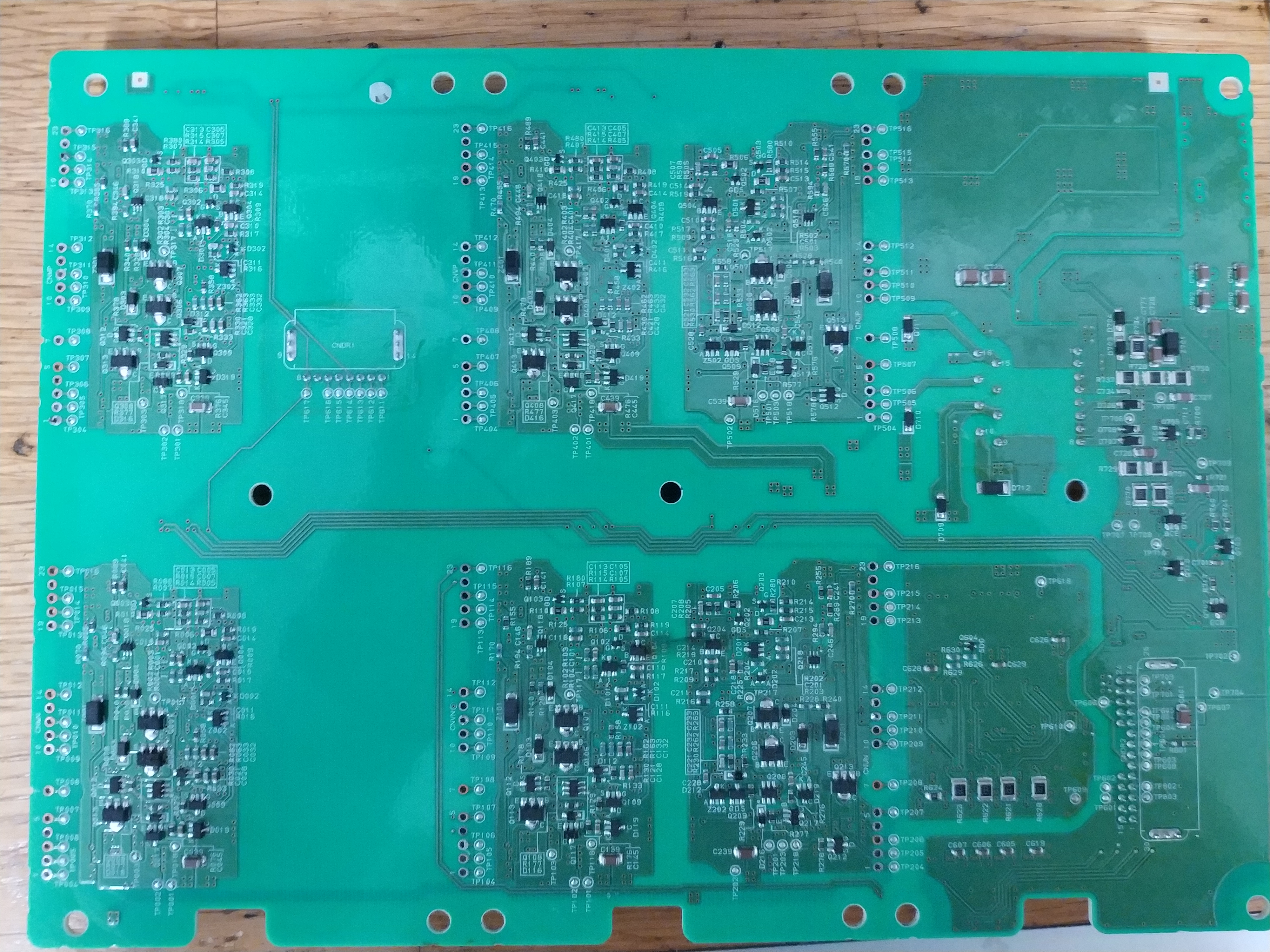

johu wrote: Fri Sep 06, 2019 6:11 pm Damn it.. I mean thanks for checking ;)
Even if it were PWM your multimeter would convert it to a voltage. So now I can either skip DC voltage which would disable meaningful precharge control or wire the remaining pins to a jumper link.

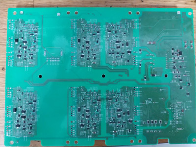

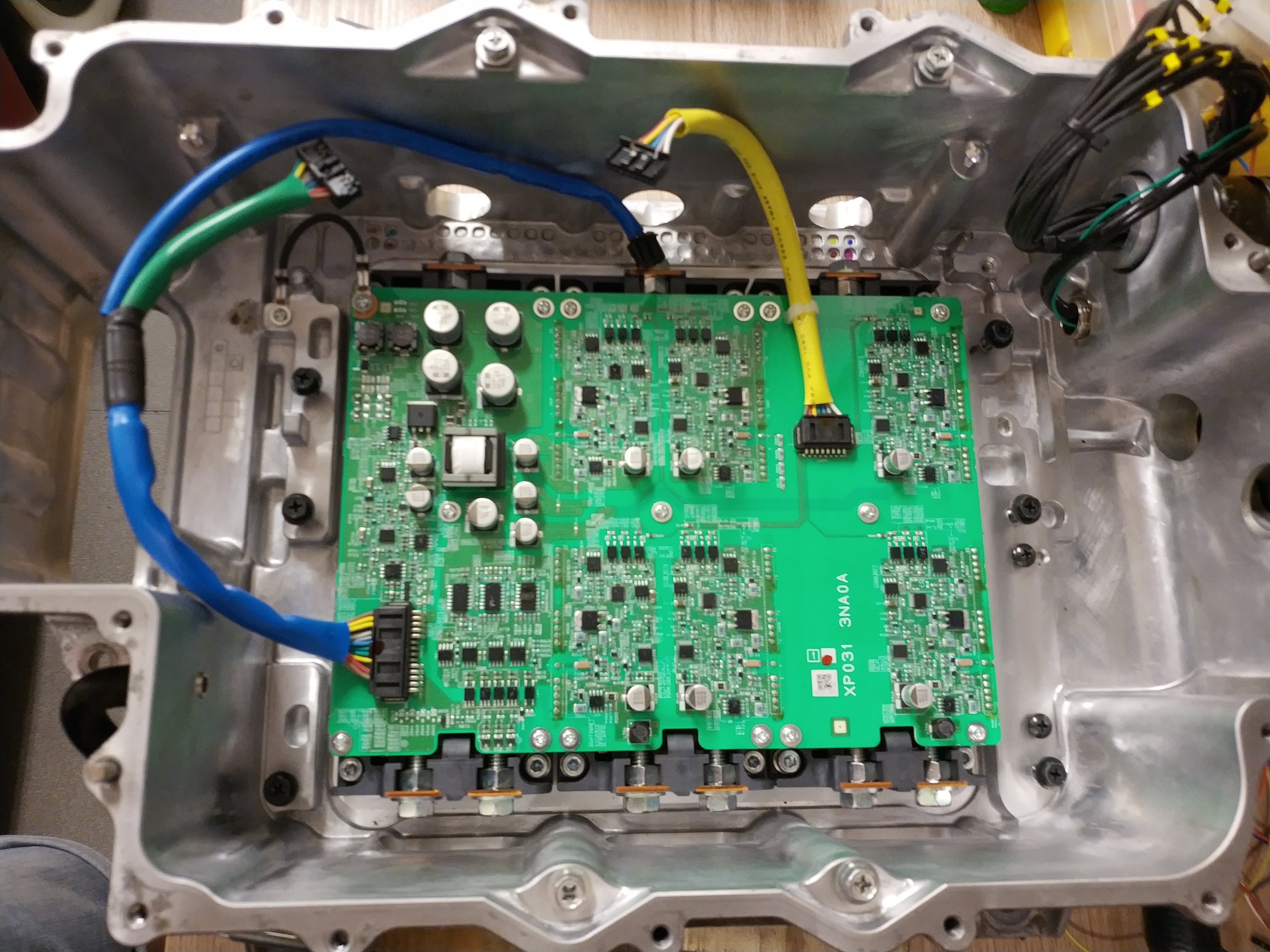

Over CAN-bus do we get the DC-voltage reading so some how is the logic board measuring it.
See my attachments.
This is the PCB that residents the IGBT:s, it looks like an array of resistors in the middle that goes somewhere on the board. I have measured it and there is contact with the incoming positive DC-voltage on that resistor array.
Robin Guldmyr
MR Electronics AB
That looks very similar to the gen2 driver board. Looks like the other end of those resistors bugger off to the logic section on an inner layer.
I'm sure it must show up somewhere.
Why does the connector have a different pin count to the one on the controller?

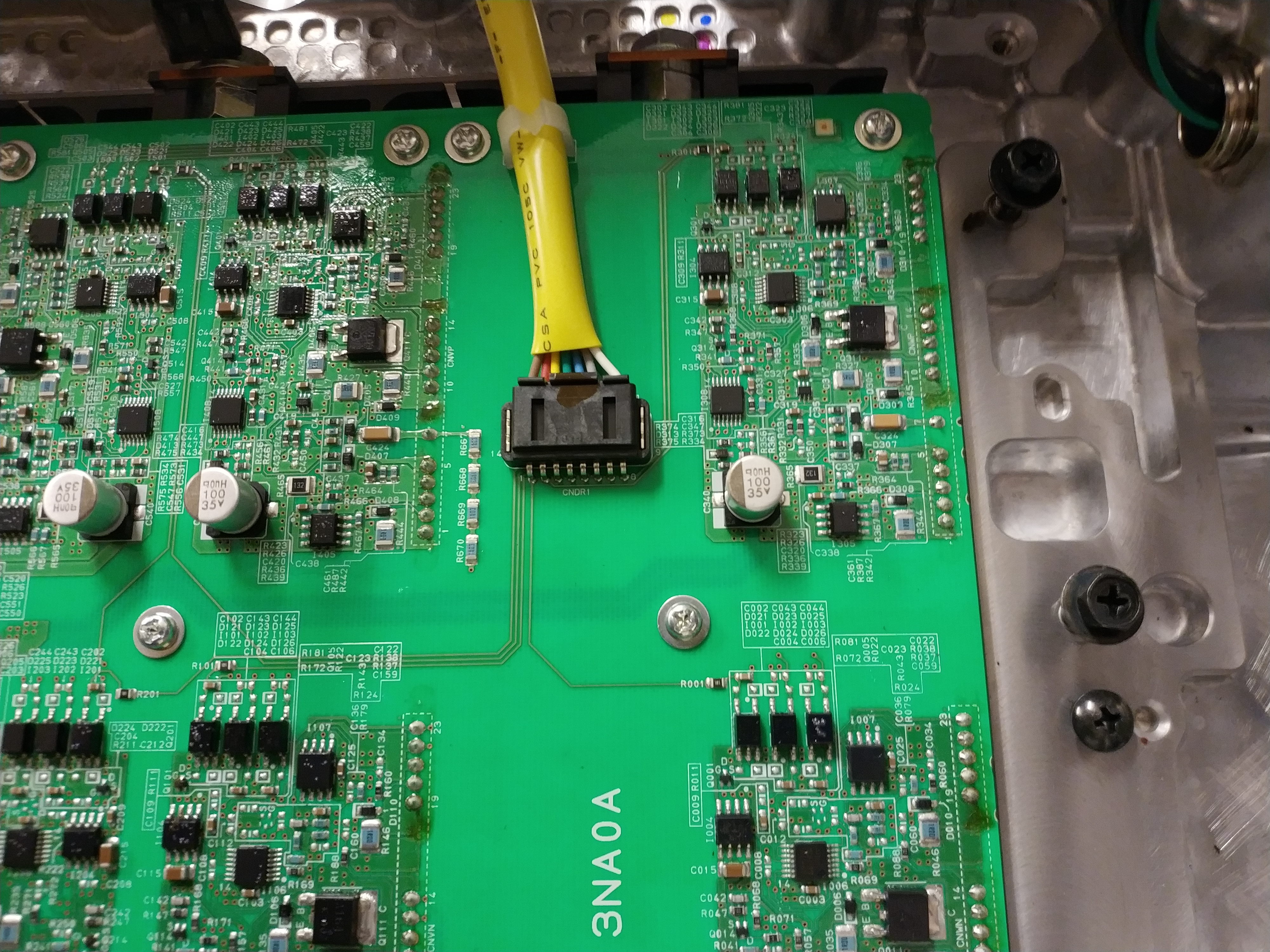

johu wrote: Fri Sep 06, 2019 10:13 pm That looks very similar to the gen2 driver board. Looks like the other end of those resistors bugger off to the logic section on an inner layer.

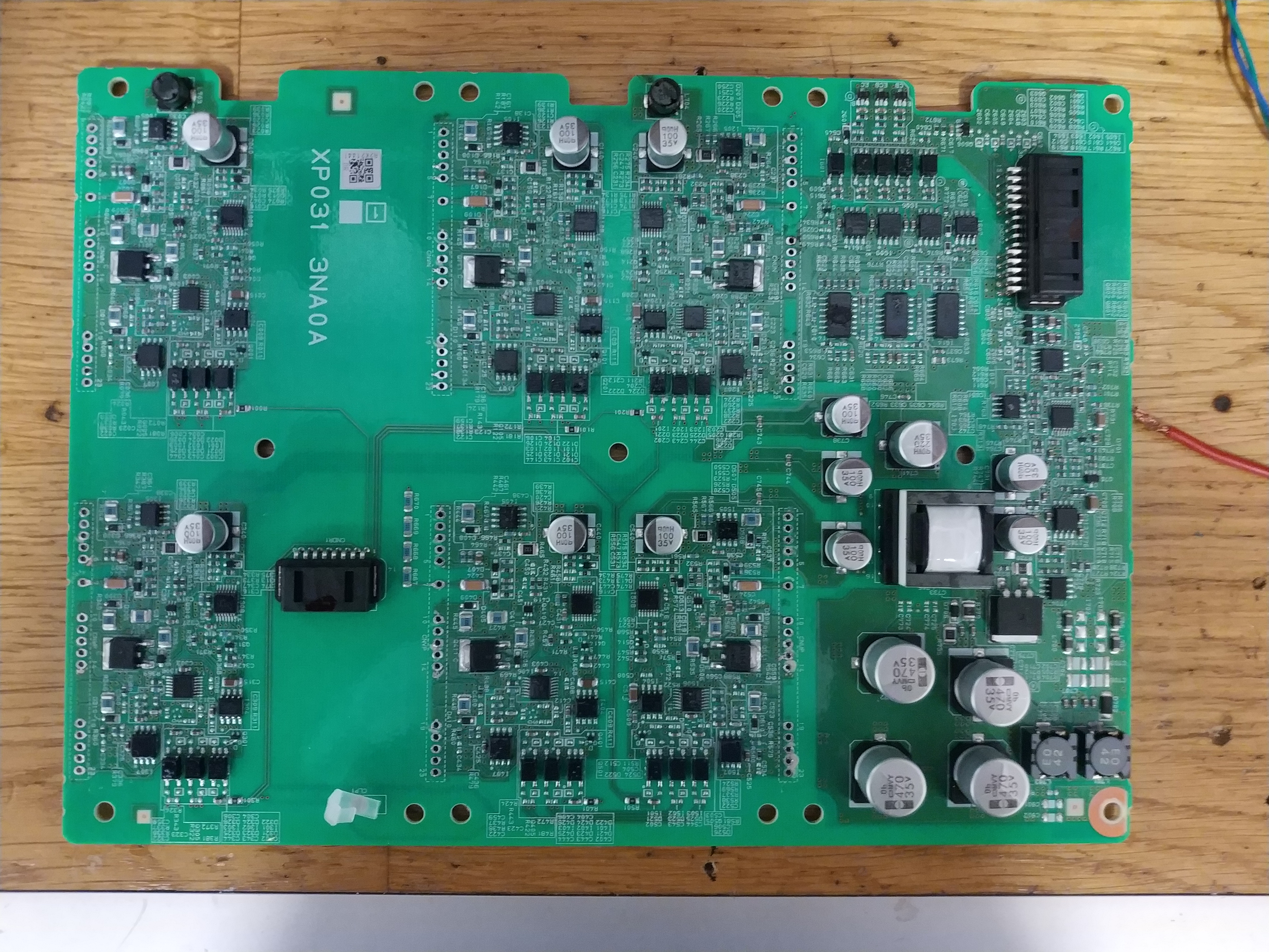

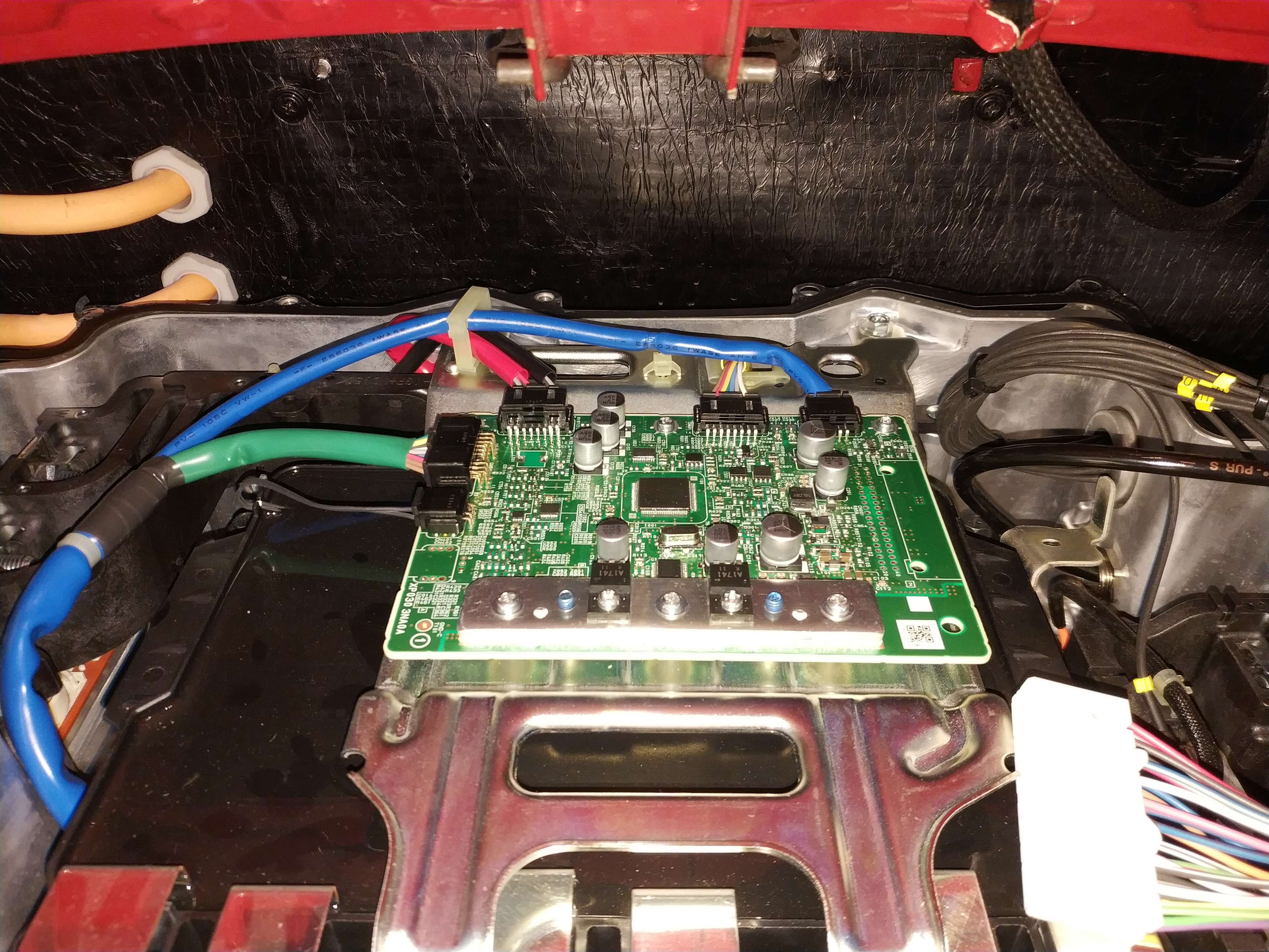

I attached an overview of the connectors/colours of the bottom PCB.
Best picture I have of the connectors on the logic board. Yellow is second from right.

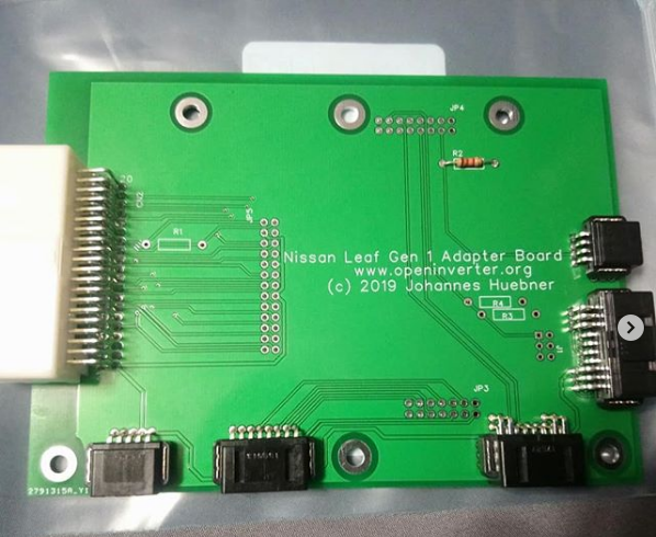

I ordered mine from JLCPCB, came with 5 in total. Image
Great, finally this got made.

Ok, so all the components from the BOM above have arrived and been put on (except for R1, was confused as to if that is a 120 Ohm resistor or not?) I'm guessing I'll need the Revision 3 brainboard on the webshop, just like with the Gen 2 inverter board? Please let me know if you can't see the image. Image
