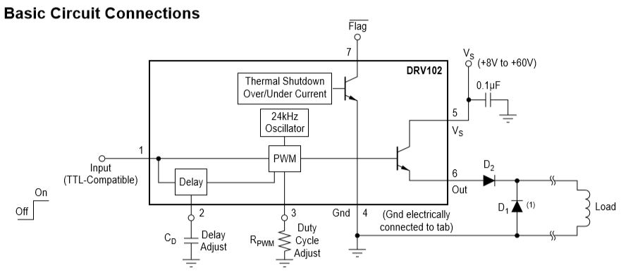

Johaljaswant wrote: Wed Nov 13, 2019 3:47 am I am using for Tesla large unit H.V contactor
iirc the Tesla contactors don't have an economiser and will burn up pretty fast.
joromy
Posts: 371
Re: Simp BMS
Post by joromy »
Kevin Sharpe wrote: Wed Nov 13, 2019 10:09 am iirc the Tesla contactors don't have an economiser and will burn up pretty fast.
I have used tesla contacors. But you need to use the PWM fuction in Simp BMS.
Another option I have tested with Tesla contactors is the DRV102:
You need a capacitor for timing and a resistor to set the hold PWM.
Kevin Sharpe
Posts: 1339
Location: Ireland and US
Been thanked: 10 times
Re: Simp BMS
Post by Kevin Sharpe »
joromy wrote: Wed Nov 13, 2019 12:55 pmI have used tesla contacors. But you need to use the PWM fuction in Simp BMS.
AFAIK the OP is planning on using the inverter for contactor control (which is also recommended practice from Damien), so...
joromy wrote: Wed Nov 13, 2019 12:55 pmAnother option I have tested with Tesla contactors is the DRV102
Looks good 8-) I've added that to GitHub as a wish list item for consideration on future versions of the inverter controller hardware.
joromy
Posts: 371
Re: Simp BMS
Post by joromy »
Kevin Sharpe wrote: Wed Nov 13, 2019 1:26 pm Looks good 8-) I've added that to GitHub as a wish list item for consideration on future versions of the inverter controller hardware.
It's not so good option if you have a microcontroller. Then you can do the timing in software.
Anyway you need one mircocontroller pin for the contactor, so you might as well use a PWM pin.
The DRV102 is intended to use with dumb systems that only have on/off. And in this kind of systems it works really well.

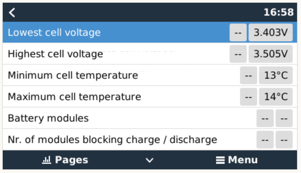

Serial console show low temp:18.85C and high temp:19.11C
CAN bus show same temp on high and low:
373 8 39 e 42 e 24 1 24 1
LOW_CELL 3.641
HI_CELL 3.650
MIN CELL TMP 18.85
MAX CELL TMP 18.85
Posts: 2962
Has thanked: 328 times
Been thanked: 847 times
Re: Simp BMS
joromy wrote: Thu Jan 16, 2020 9:47 pm Serial console show low temp:18.85C and high temp:19.11C
LOW_CELL 3.641
HI_CELL 3.650
MIN CELL TMP 18.85
MAX CELL TMP 18.85
I will make a test setup for this as the code makes this implausible really.
Wait, its only a difference of 0.26C, so due to it being a full number, no decimals it makes sense. So you need deltas of 1 degree to show up.
Victron screen, not the missing decimal
joromy
Posts: 371
Re: Simp BMS
Post by joromy »
Delta 1C is good enough for me, it's only for controlling the water pump.
Voltage is correct, that's what matters.
