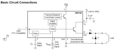

Kevin Sharpe wrote: Wed Nov 13, 2019 10:09 am iirc the Tesla contactors don't have an economiser and will burn up pretty fast.
I have used tesla contacors. But you need to use the PWM fuction in Simp BMS.
Another option I have tested with Tesla contactors is the DRV102:
You need a capacitor for timing and a resistor to set the hold PWM.

joromy wrote: Wed Nov 13, 2019 12:55 pmI have used tesla contacors. But you need to use the PWM fuction in Simp BMS.
AFAIK the OP is planning on using the inverter for contactor control (which is also recommended practice from Damien), so...
joromy wrote: Wed Nov 13, 2019 12:55 pmAnother option I have tested with Tesla contactors is the DRV102
Looks good 8-) I've added that to GitHub as a wish list item for consideration on future versions of the inverter controller hardware.

Kevin Sharpe wrote: Wed Nov 13, 2019 1:26 pm Looks good 8-) I've added that to GitHub as a wish list item for consideration on future versions of the inverter controller hardware.
It's not so good option if you have a microcontroller. Then you can do the timing in software.
Anyway you need one mircocontroller pin for the contactor, so you might as well use a PWM pin.
The DRV102 is intended to use with dumb systems that only have on/off. And in this kind of systems it works really well.
