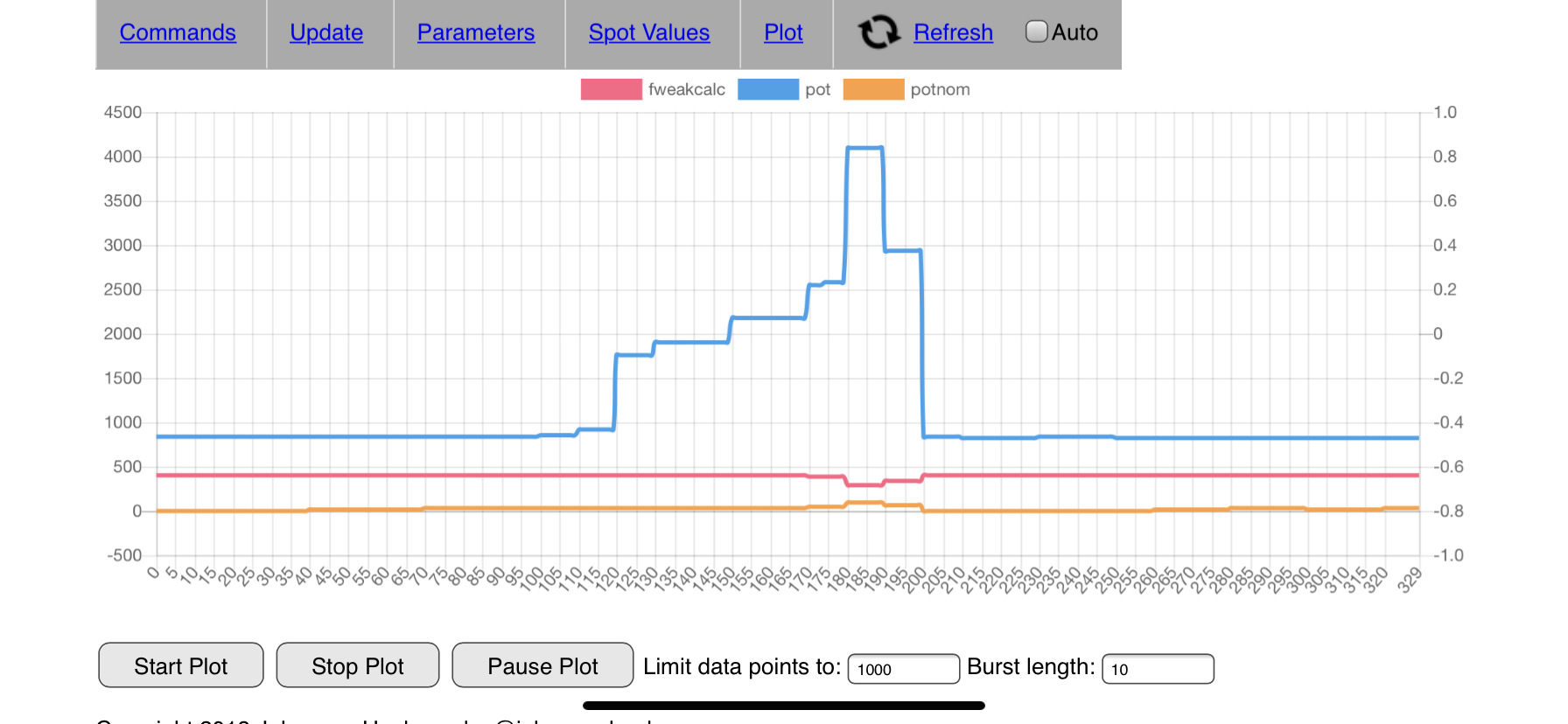

Alrightly folks....
Uploaded my latest changes and it seems to be working as intended. Nice smooth low throttle operation straight out of the firmware.
Below are my changes compared to the first draft I initially posted.
https://github.com/jonvolk/stm32-sine_L ... ...851f96c
https://github.com/jonvolk/stm32-sine_LDU
Unfortunately I will not get any prolonged seat time for a few days as its about to start raining for what appears to be an extended period.
Plot showing the reduction in fweakcalc with throttle application attached. Scaling is shit since I have raw pot on there. I have attached the compiled .bin if anyone wants to give it a try. Its based off the 4.97 release. The core of what this does is reduces throttle ramp to a very slow rate for lower throttle inputs. These eliminates any on/off throttle jerkiness. It also sets the default fweak value to 400 under 35% throttle. Over 35%, it will linearly ramp fweak down to the value you have in the parameter file at WOT. This gets rid of the low speed low throttle surging.
You should not have to change any of your standard parameters with these changes.
As always appreciate any insights or criticism.

It dried out last night so I was able to give the car a proper beating this morning. Everything appears to work as advertised. Smooth low throttle/speed operation and I can stomp the pedal as violently as possible and the throttle ramping keeps all changes under control without oc.
After living with a static lower fweak value for a few days prior, I also noticed that with the updated firmware the low throttle 400 fweak value also happens to make for very smooth onset of regen as well.
