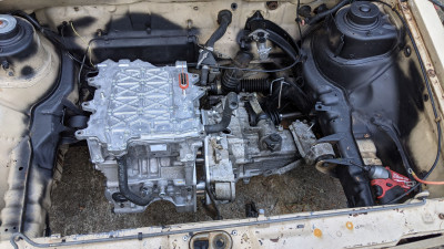

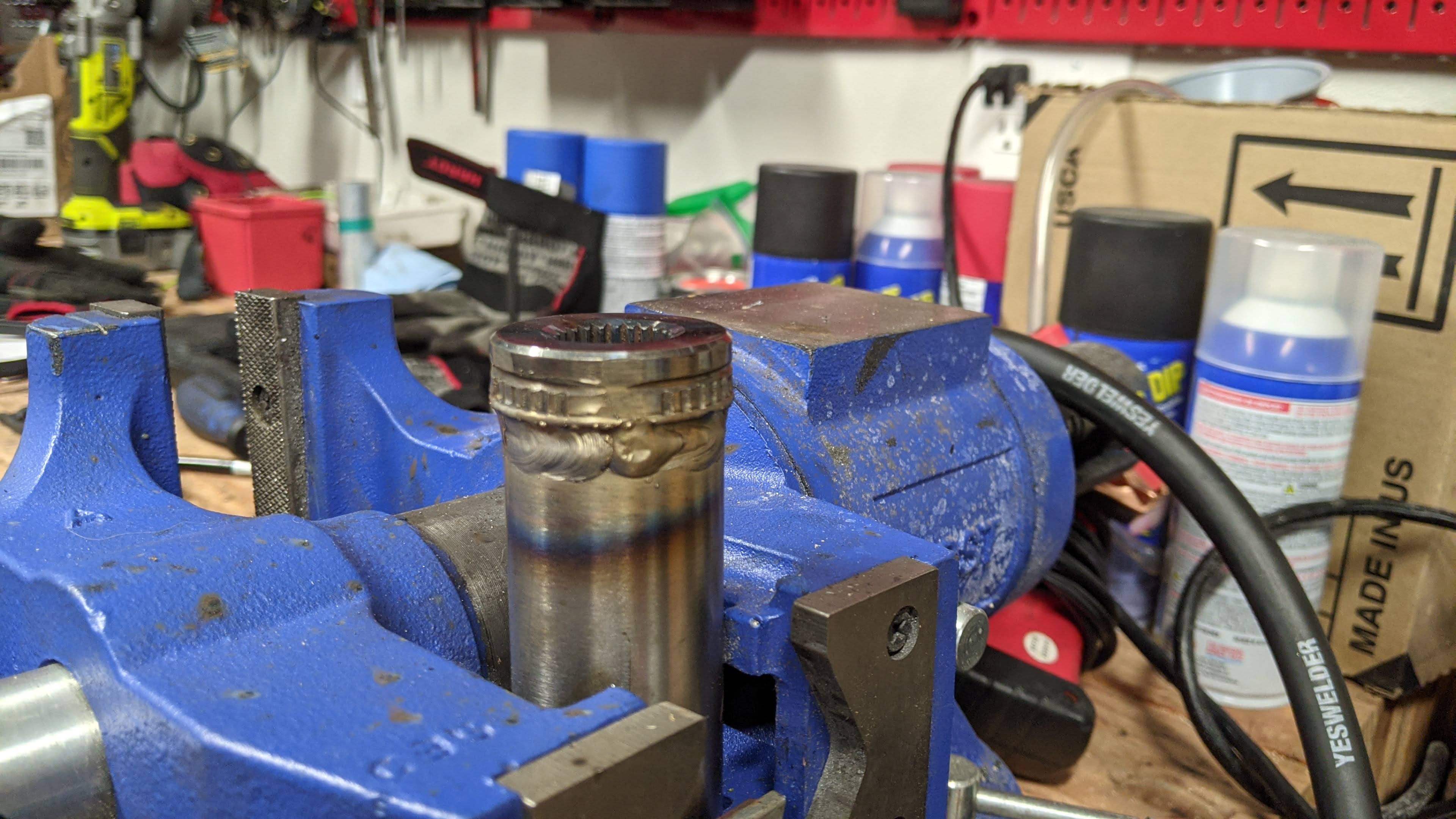

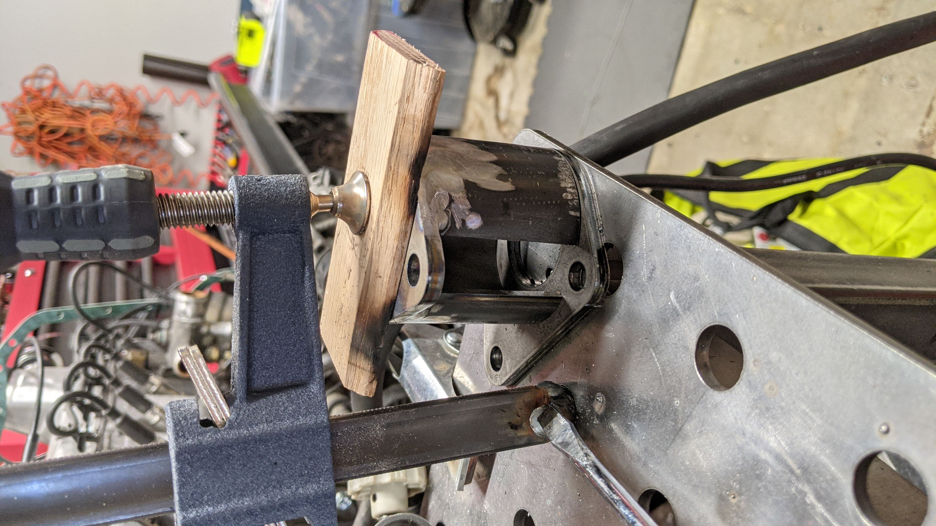

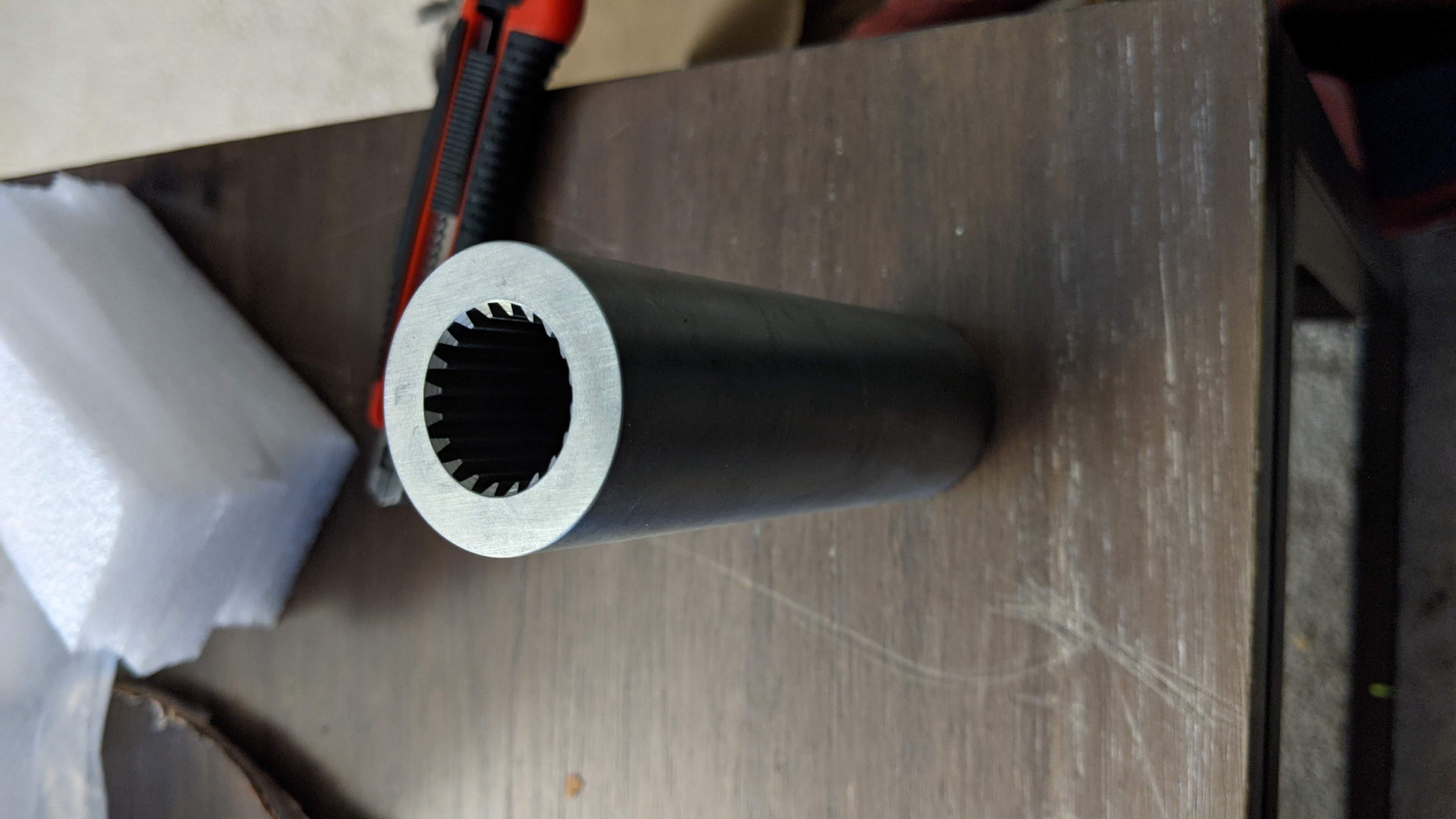

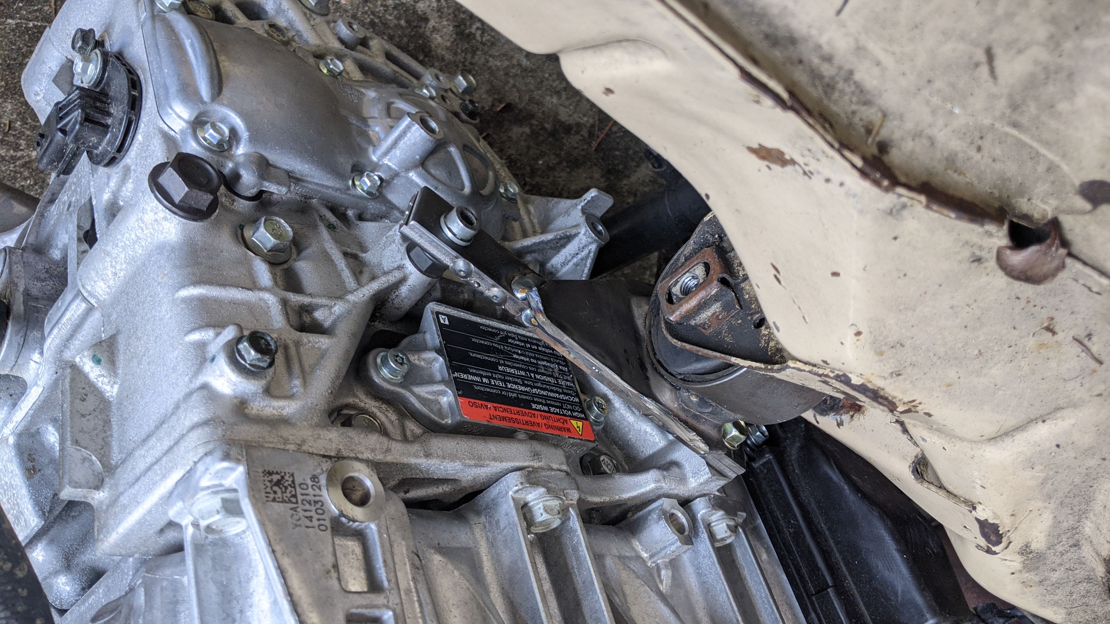

Received my long awaited coupler in the mail from 3dhubs and made a motor mount :)
coupler:
Motor official mounted in place!
Next step is to pull the motor back out and test the spline fit. Then clean up that mount and make it look a little more professional - and maybe add another pickup point to it on the bench.

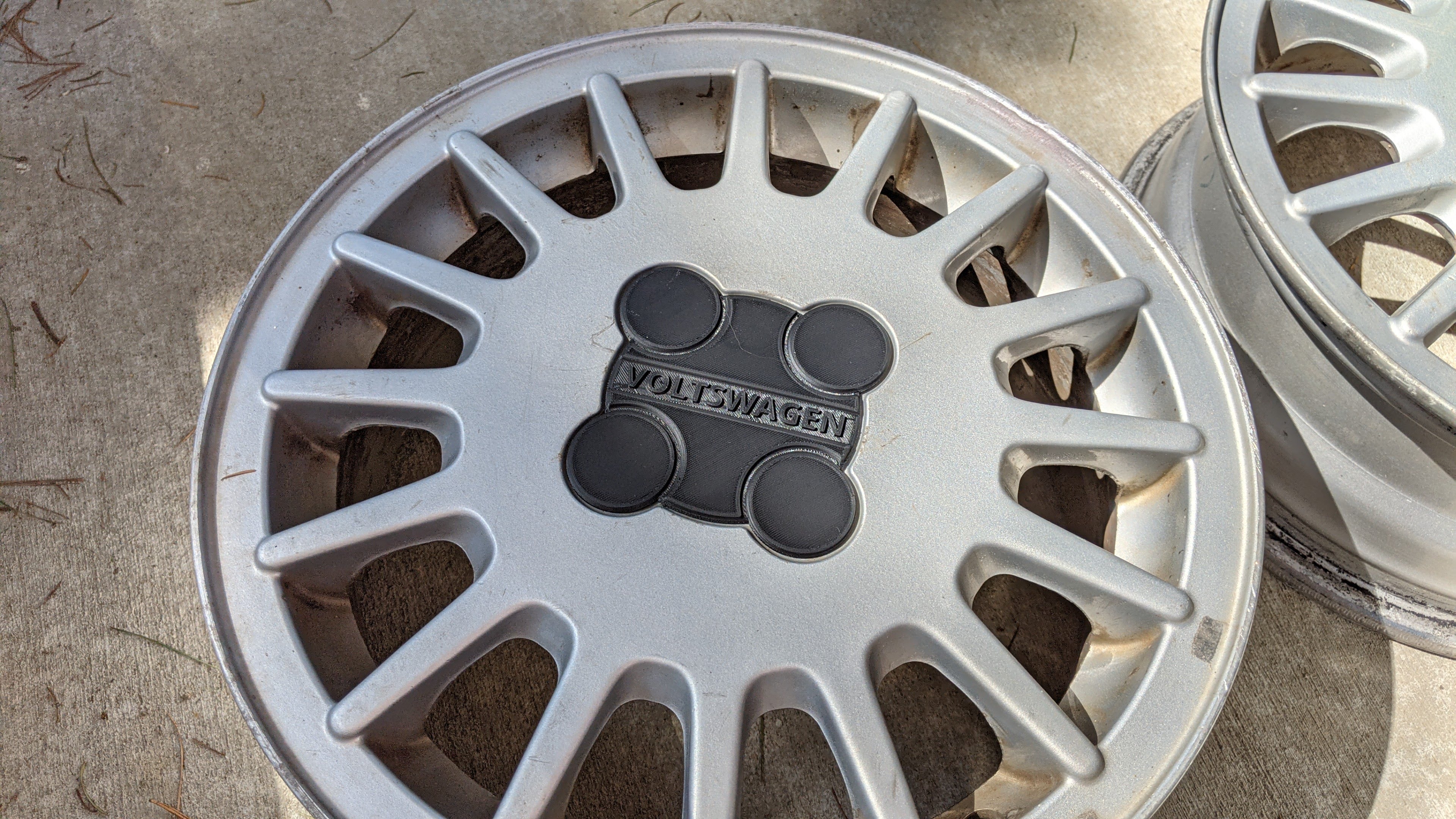

Some silly center caps for the Corrado wheels.
Been thanked: 1913 times
Re: Project VW Cadd-E
Nice! Who wants to design some openinverter center caps for my Touran? ;)

johu wrote: Tue Apr 20, 2021 3:56 pm Nice! Who wants to design some openinverter center caps for my Touran? ;)
I'd love to! Get me some measurements and i'll mock something up. Actually, the centerbore on your Touran is likely the same 57.1mm so the retention feature may be pretty much the same.

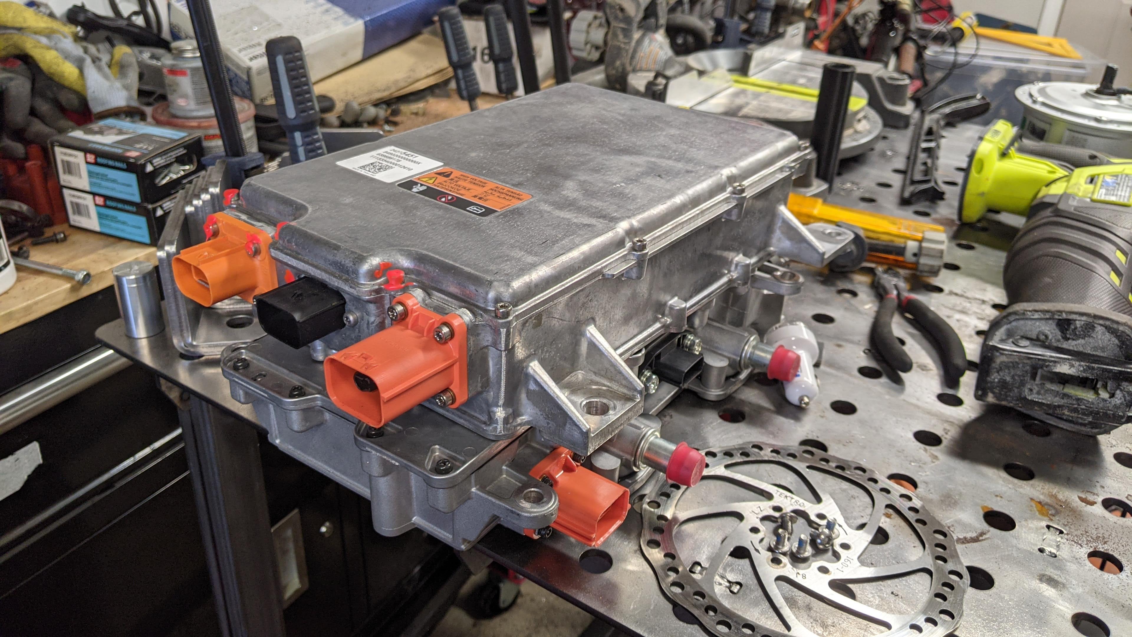

Update:
My wife and I are expecting a baby any day now, my normal job has been pretty demanding lately, im 90% done with a full bathroom remodel, and I'm about to tear into our i3 to get CAN logs from the CCS1 controller during DC charging. So, I've been a bit all over the place :)

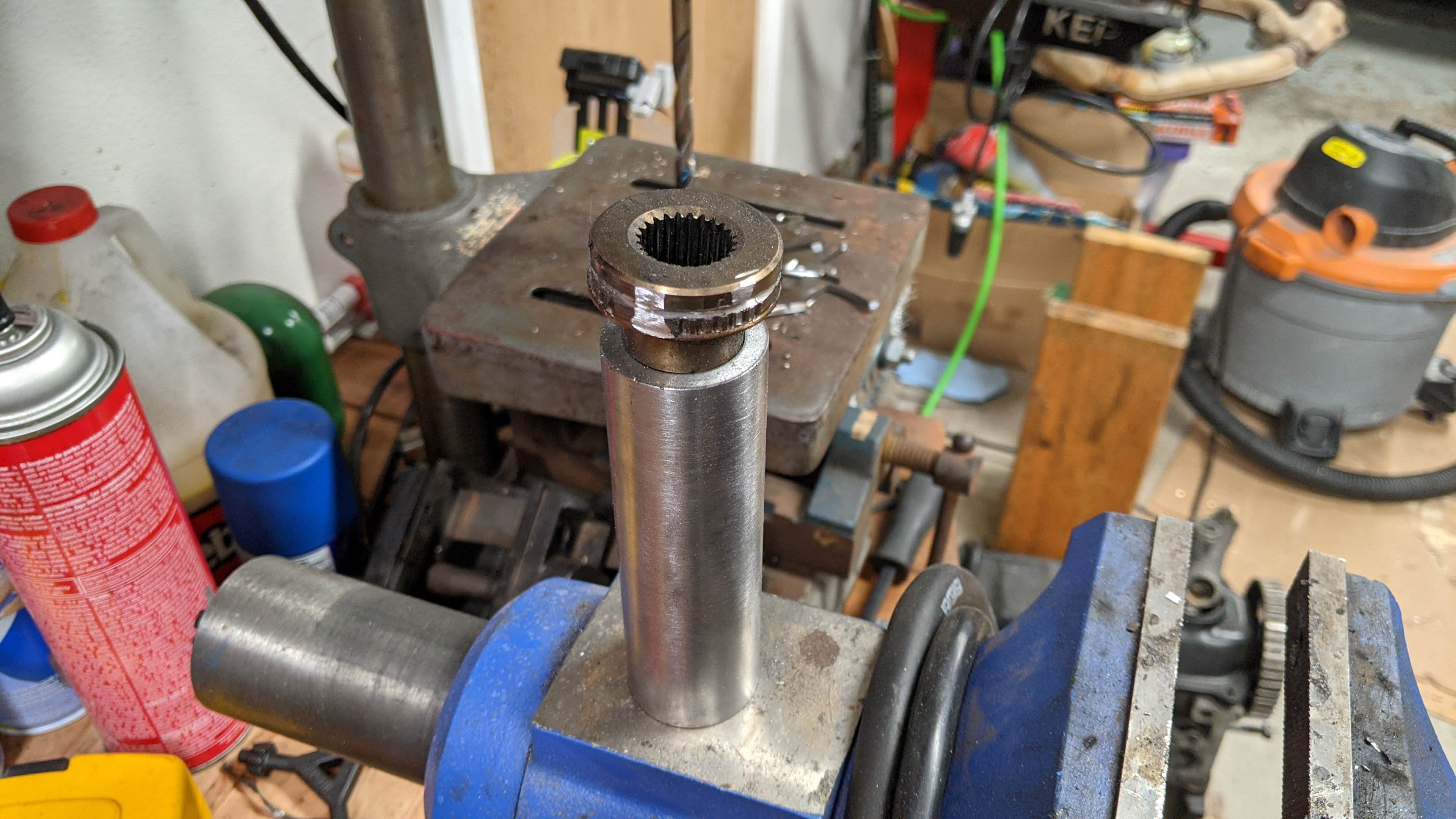

Here are some updates on the Caddy work.
Got my spline coupler finished, in and it spins mighty fine.
Ordered Volt Charger and DCDC, prior to realizing they're only good for 300V systems. Now I'm debating on whether or not to drop my system from 350 to 300 to make use of these components

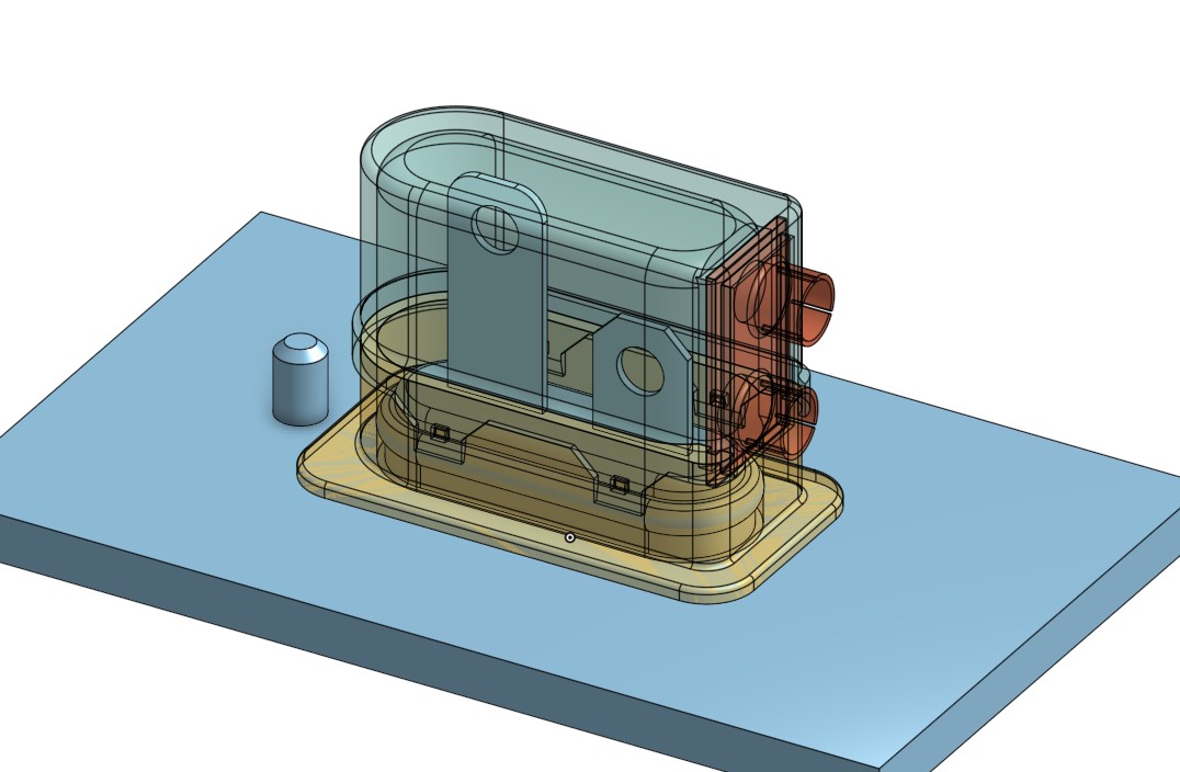

I've also been modeling a cover the the EM57 inverter DC in busbars:

vwbrady wrote: Tue May 11, 2021 2:18 pm Ordered Volt Charger and DCDC, prior to realizing they're only good for 300V systems. Now I'm debating on whether or not to drop my system from 350 to 300 to make use of these components
AFAIK, the Volt Gen2 is using a 96s pack, so both should be fine up to at least 400V.
Some em57 cover designs in this thread
viewtopic.php?t=1580

FJ3422 wrote: Tue May 11, 2021 8:16 pm AFAIK, the Volt Gen2 is using a 96s pack, so both should be fine up to at least 400V.
Interesting! I thought I determined it was a 300V nominal in my research. But now I can't find anything to support that.
thanks for pointing this out!

I had known others were working on this, i'll add mine to the thread when i get it verified.

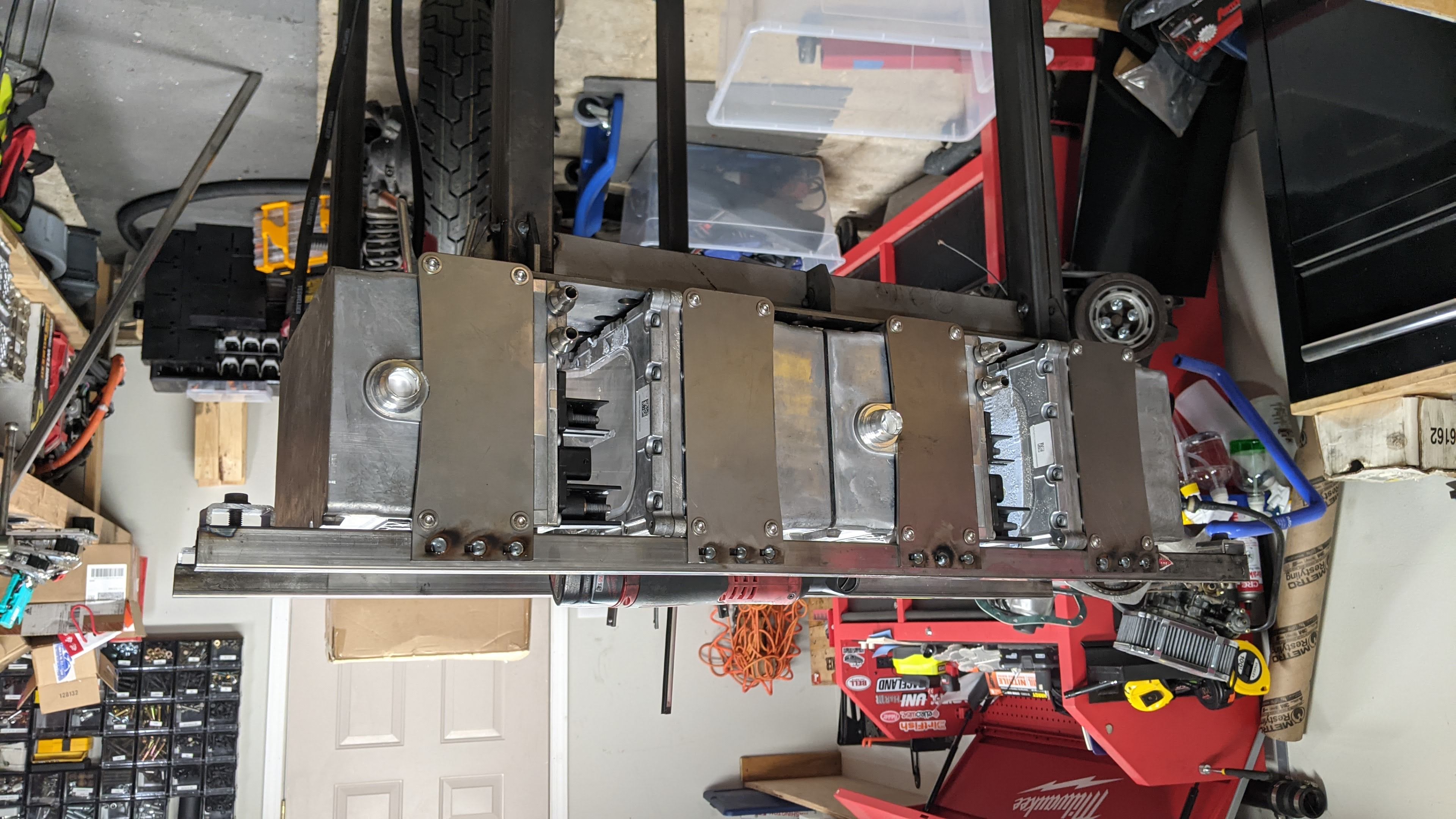

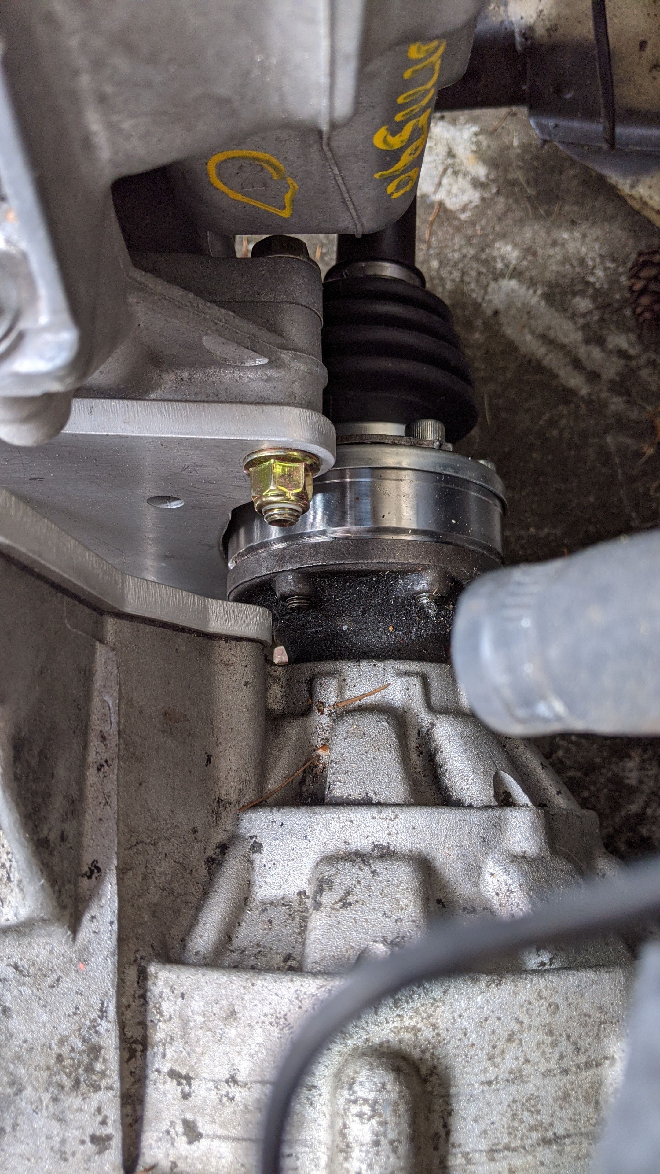

Post by vwbrady »

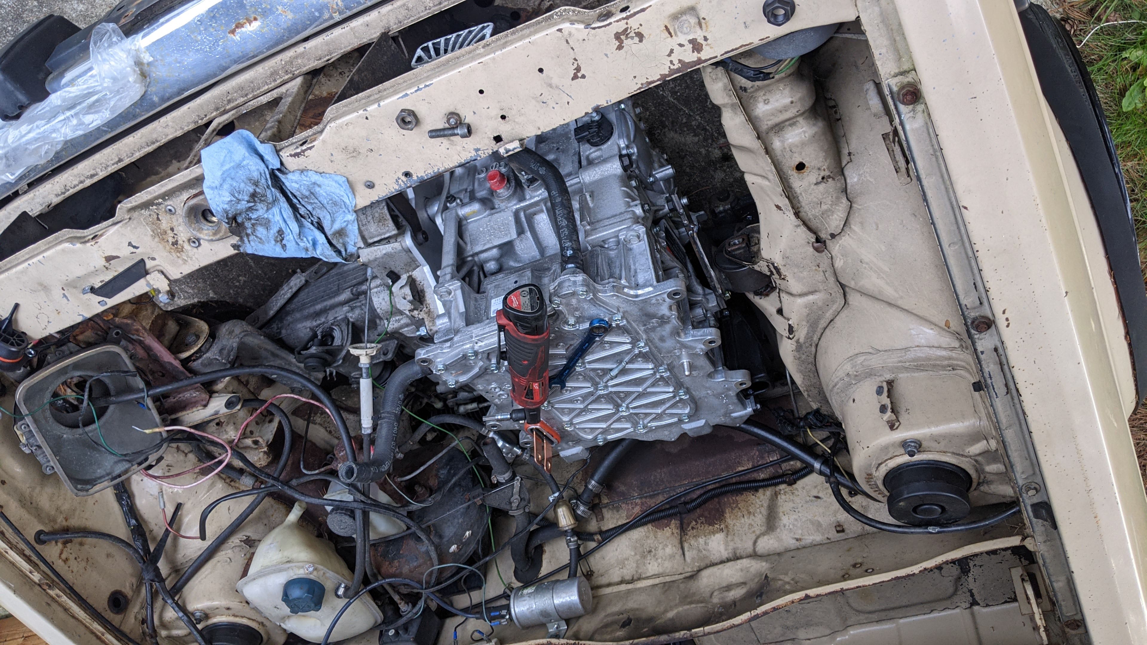

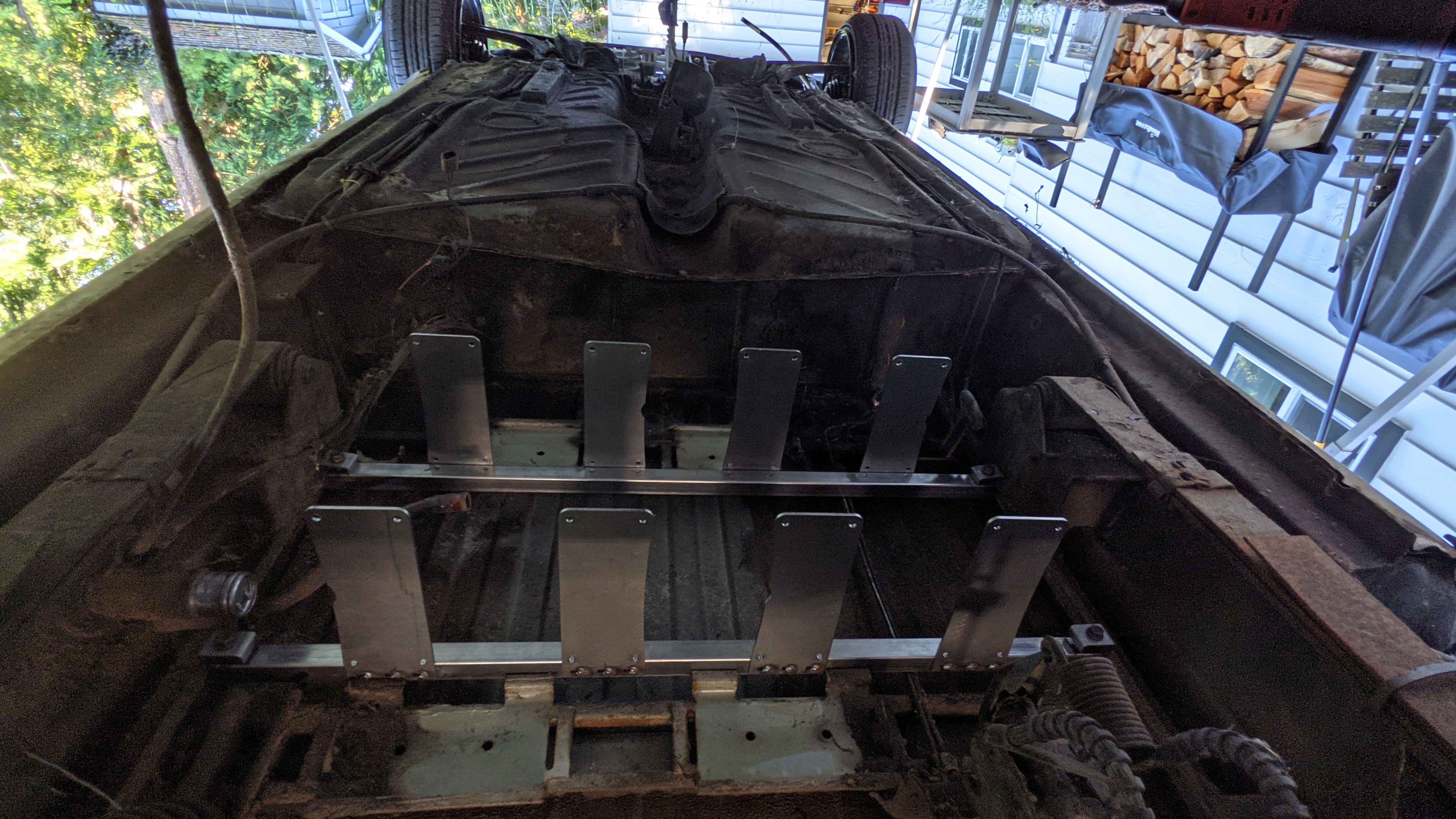

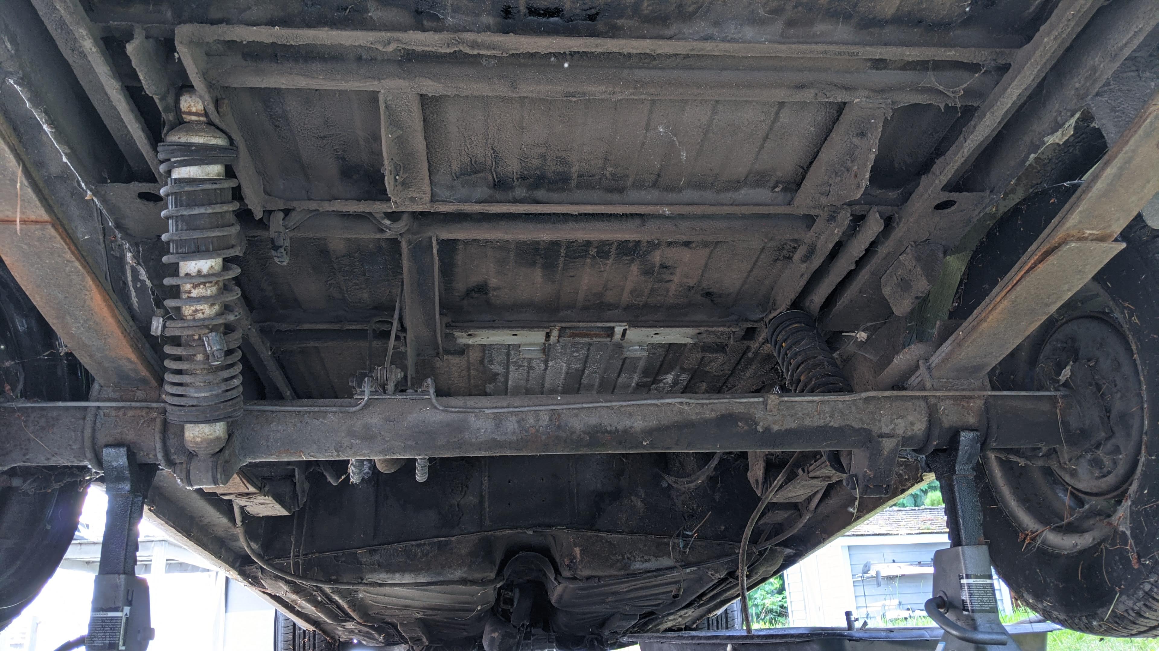

It's been slightly difficult to get out and work on the truck with a newborn in the house - being a new parent is one of the craziest things i've ever experienced.
some updates:
removed the gas tank, exhaust, and spare tire carrier to make TONS of space under the pickup bed available for batteries. Took some measurements and decided on a battery layout using laser cut brackets and simple box tubing.
the dark grey is the laser cut parts that are already on order
installed the powertrain for the final time after rust "converting" spots in the engine bay. Axles installed, all motor mounts installed.
axle clearance to the EM57 housing :o

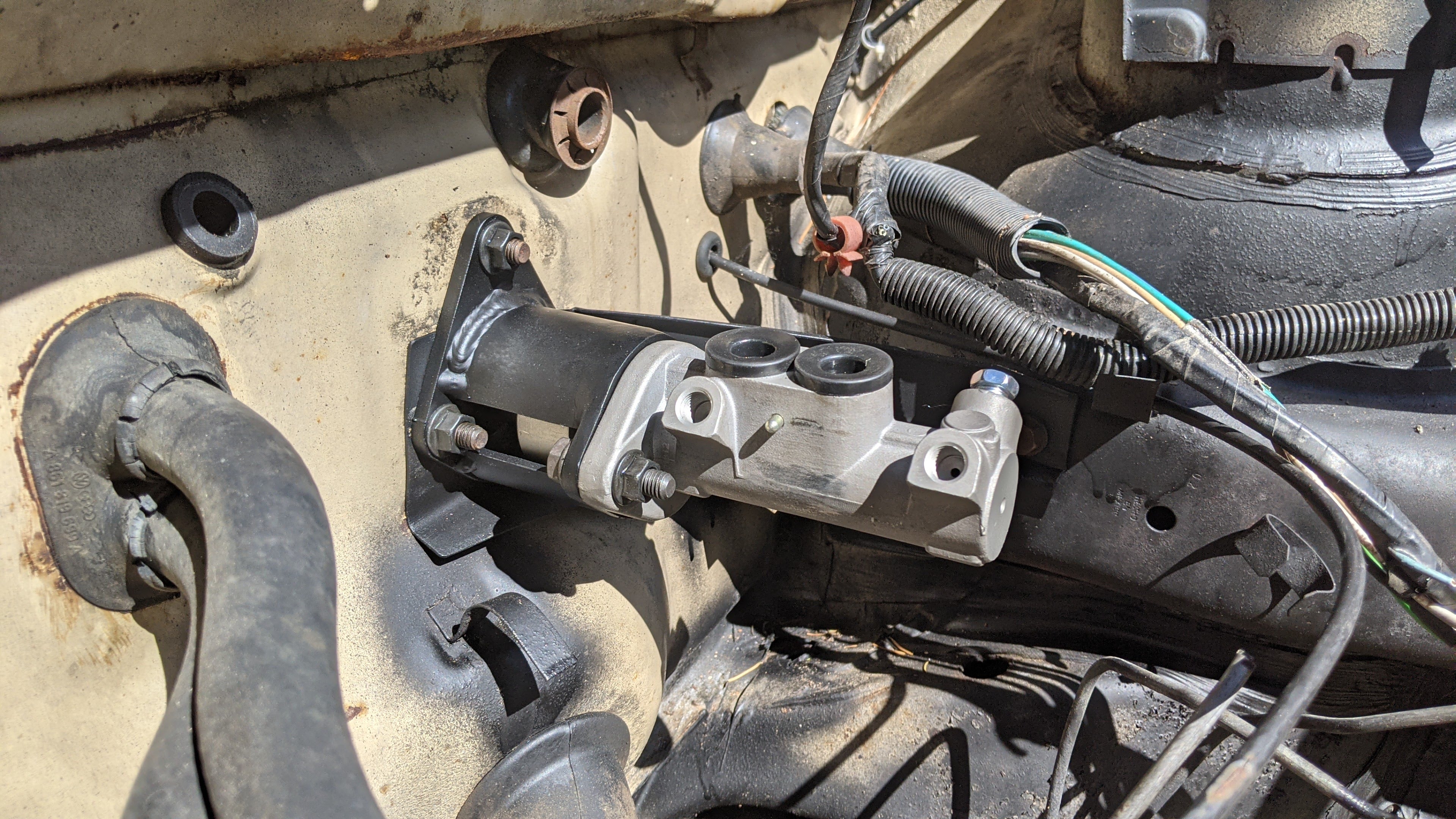

and in my quest to delete power brakes i fabricated a bracket to adapt a larger modern master cylinder directly to the firewall
Now it's time to re-route brake lines, work on wiring diagrams and a High Voltage Junction Box layout and wait for my parts from SendCutSend to arrive. :)
Why do you think Volt gen 2 Charger and DCDC are good for 300V only? I have reason to belive they work at least to 400Vdc
I am thinking of using them up to 420Vdc if they go that far. Will test both up to 420Vdc as soon as i get connectors...

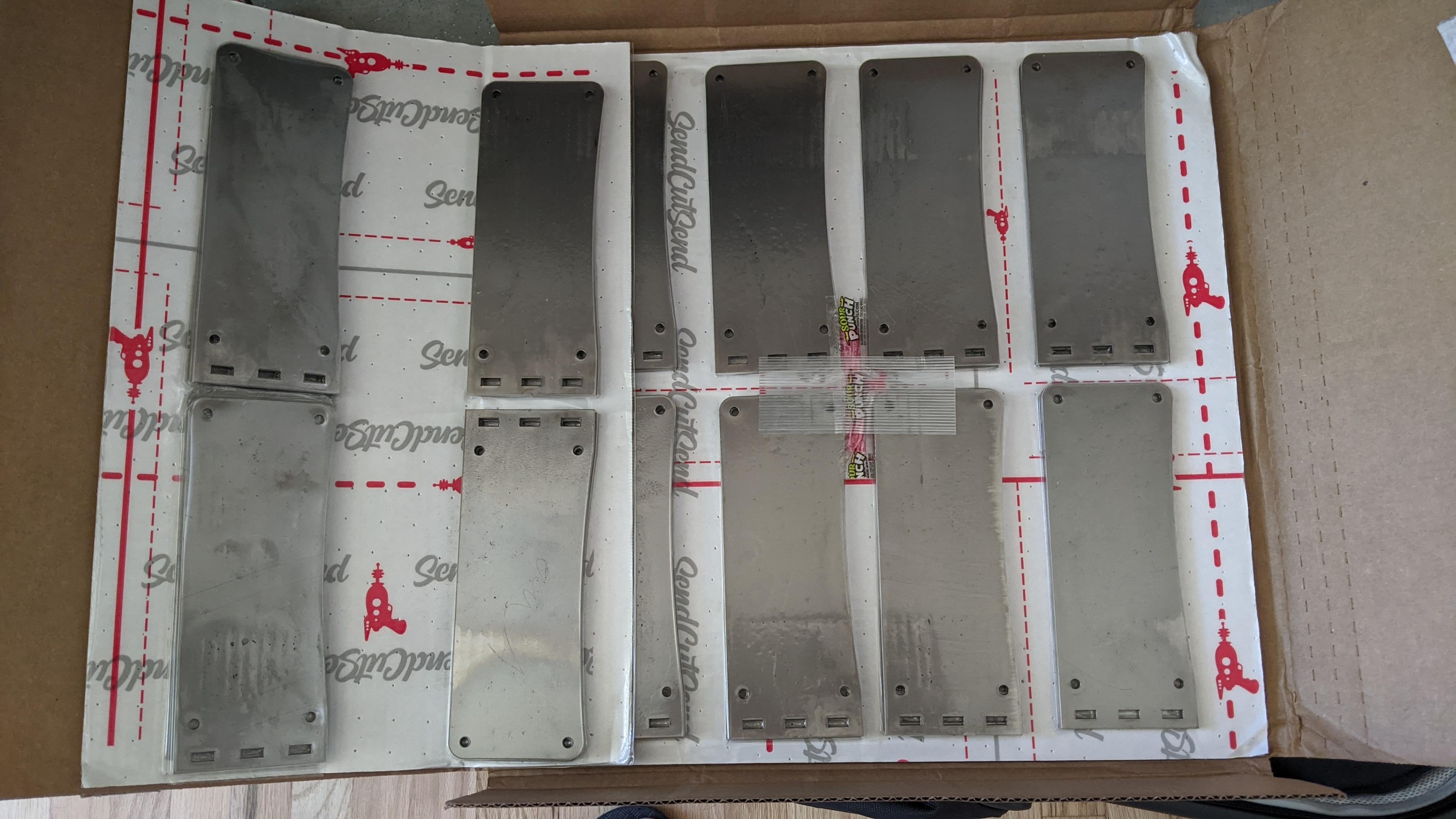

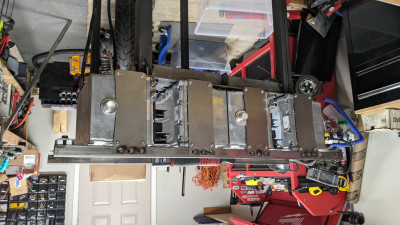

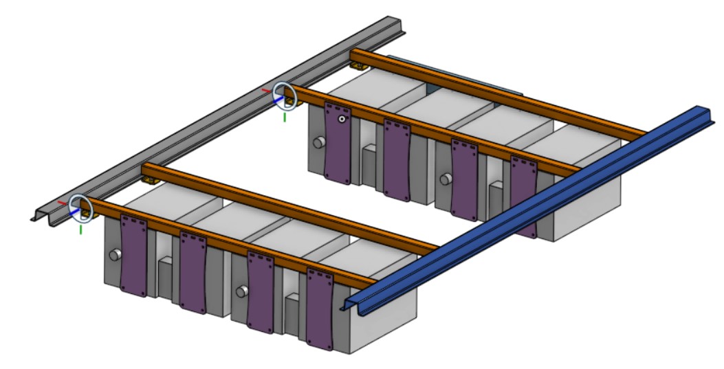

Post by vwbrady »

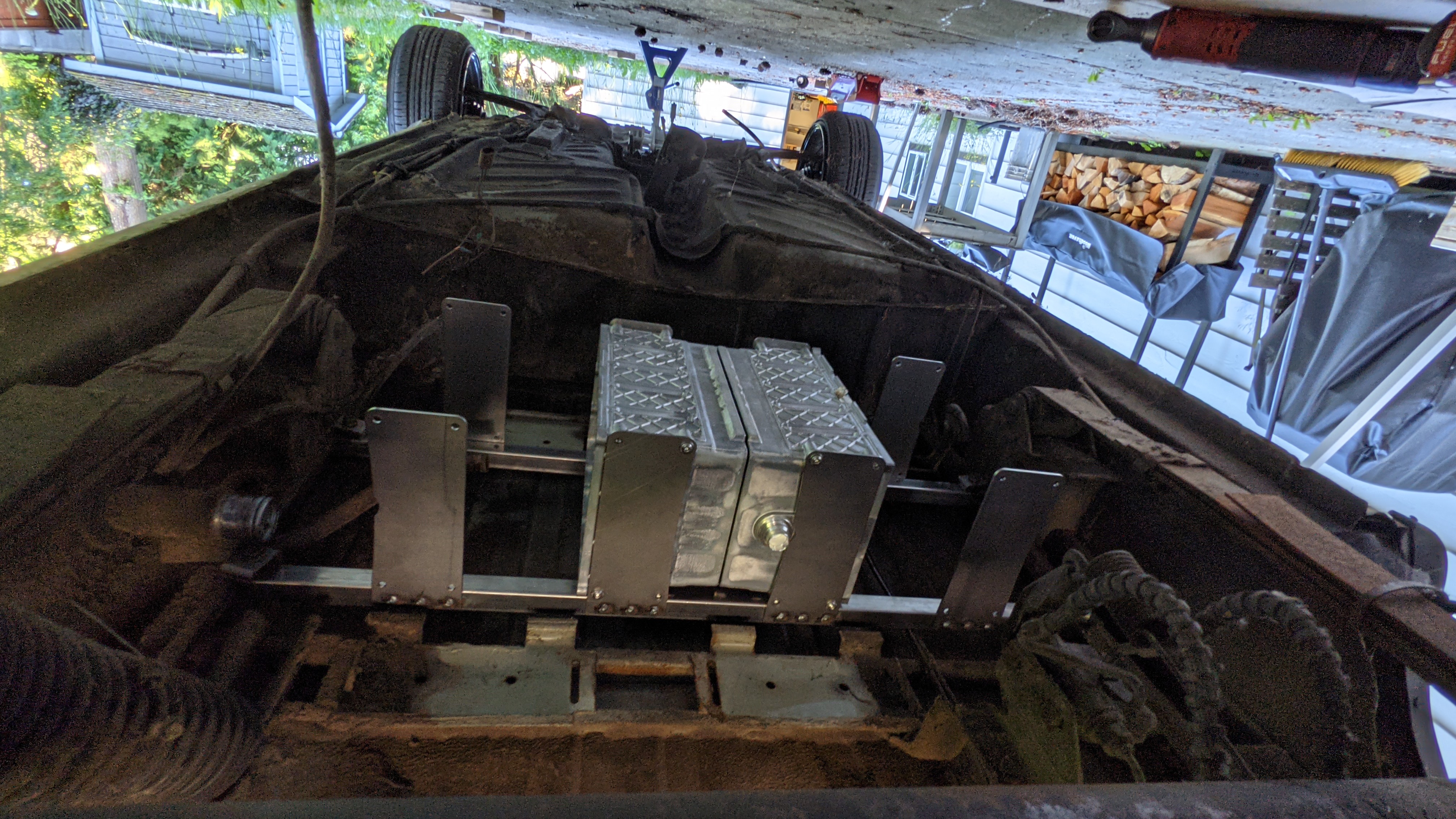

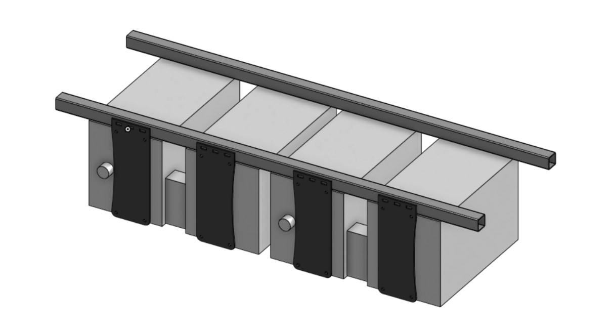

i love it when a CAD mockup comes together exactly as intended.
Battery mounting fabrication is well underway and the front row mounting is complete sans-paint.
as designed
lasercuts from SendCutSend
bench test assemble
test fitting in chassis
