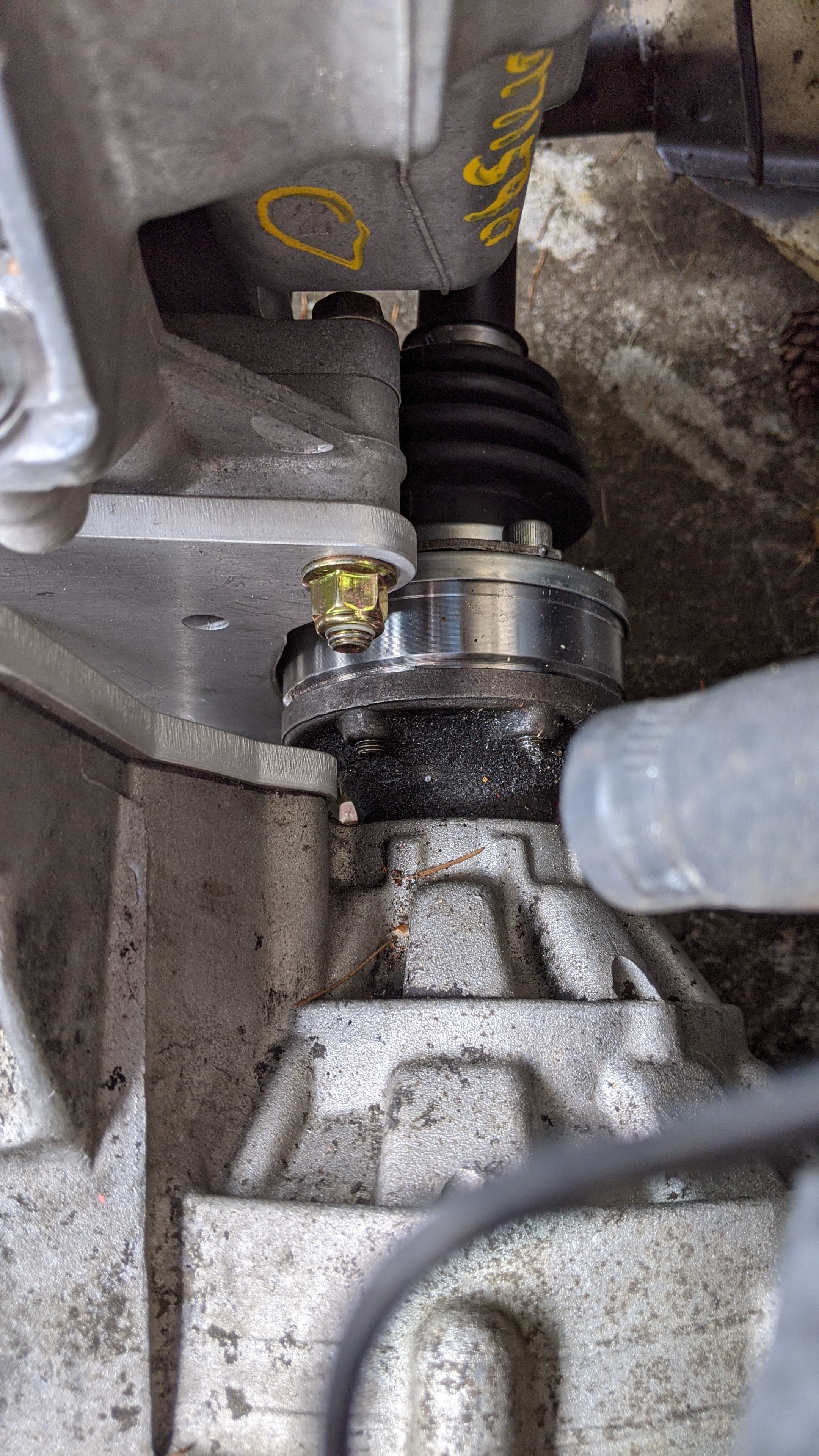

Received my long awaited coupler in the mail from 3dhubs and made a motor mount :)
coupler:
Motor official mounted in place!
Next step is to pull the motor back out and test the spline fit. Then clean up that mount and make it look a little more professional - and maybe add another pickup point to it on the bench.

Got my spline coupler finished, in and it spins mighty fine.

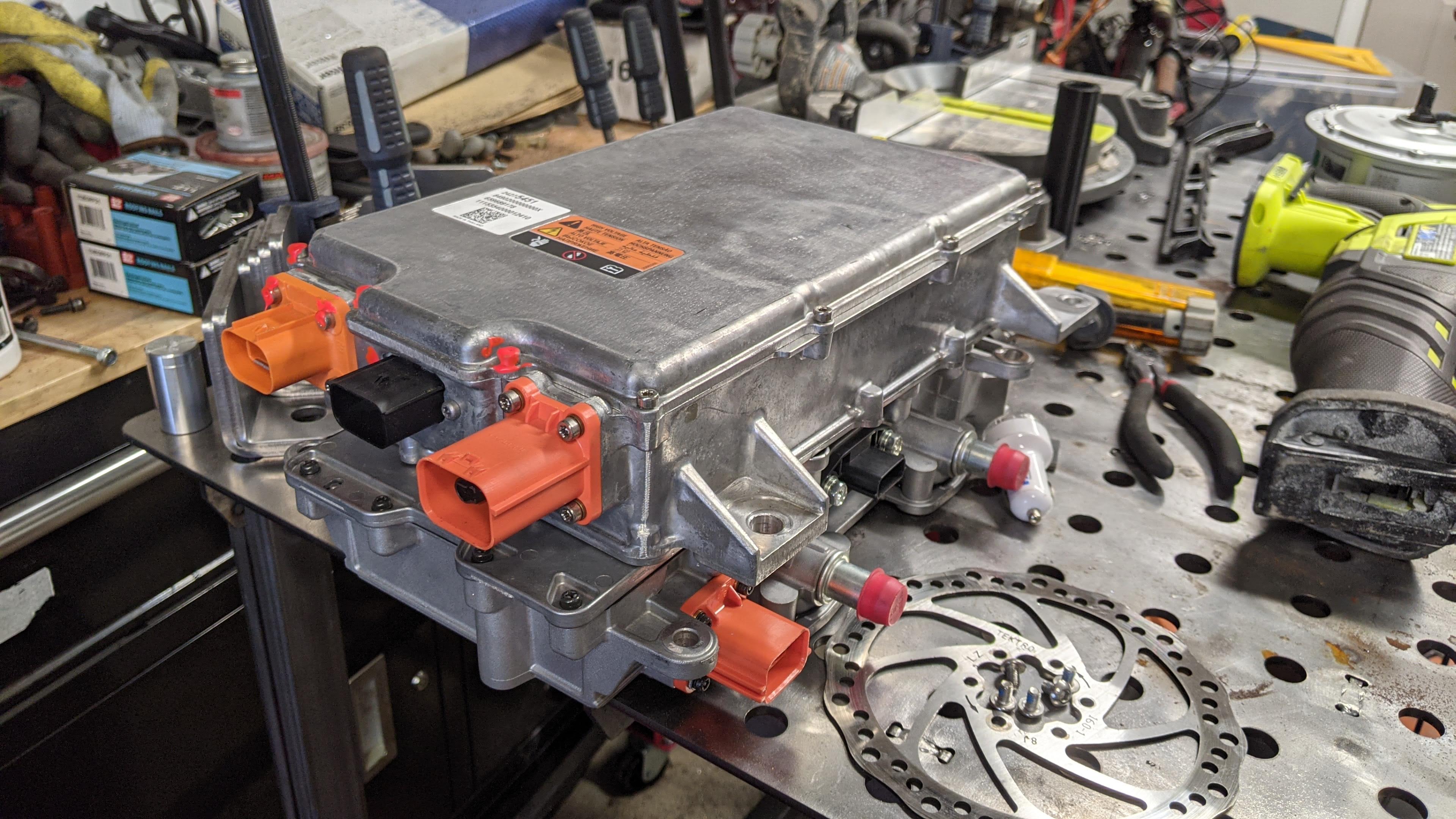

Ordered Volt Charger and DCDC, prior to realizing they're only good for 300V systems. Now I'm debating on whether or not to drop my system from 350 to 300 to make use of these components

vwbrady wrote: Tue May 11, 2021 2:18 pm Ordered Volt Charger and DCDC, prior to realizing they're only good for 300V systems. Now I'm debating on whether or not to drop my system from 350 to 300 to make use of these components
AFAIK, the Volt Gen2 is using a 96s pack, so both should be fine up to at least 400V.

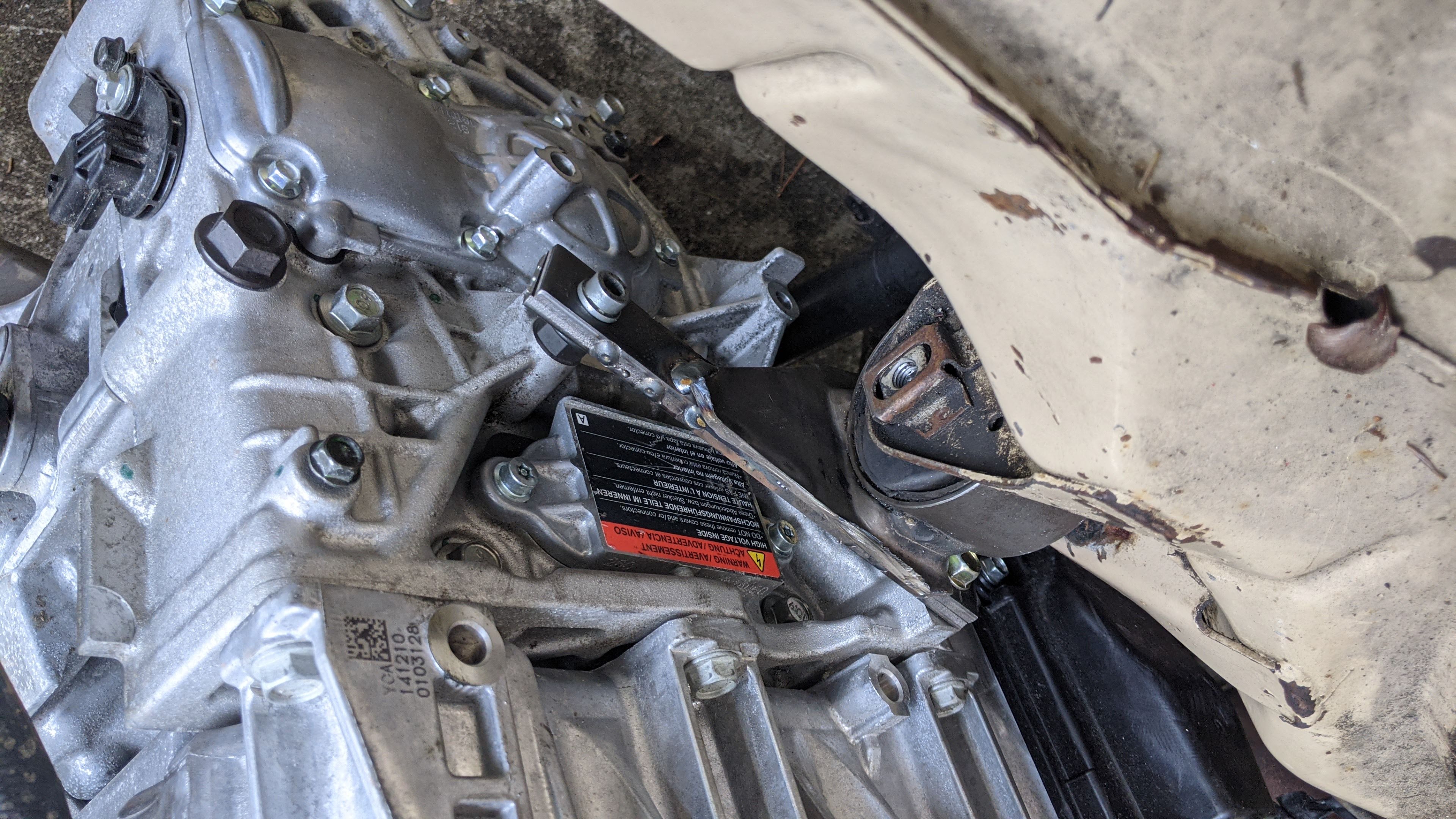

removed the gas tank, exhaust, and spare tire carrier to make TONS of space under the pickup bed available for batteries. Took some measurements and decided on a battery layout using laser cut brackets and simple box tubing.
the dark grey is the laser cut parts that are already on order
installed the powertrain for the final time after rust "converting" spots in the engine bay. Axles installed, all motor mounts installed.
axle clearance to the EM57 housing :o
and in my quest to delete power brakes i fabricated a bracket to adapt a larger modern master cylinder directly to the firewall
Why do you think Volt gen 2 Charger and DCDC are good for 300V only? I have reason to belive they work at least to 400Vdc
I am thinking of using them up to 420Vdc if they go that far. Will test both up to 420Vdc as soon as i get connectors...

honestly i should just delete that post. it was something i read somewhere else that was obviously wrong :|. luckily so, because i had already ordered both components.
I'm now in the process of sourcing wiring and will eventually attempt a bench test of both once i get my battery bank ready. I think we're both on the same path, so i expect we'll be sharing notes in the future.

vwbrady wrote: Tue Jun 15, 2021 5:32 am I'm now in the process of sourcing wiring and will eventually attempt a bench test of both once i get my battery bank ready. I think we're both on the same path, so i expect we'll be sharing notes in the future.
Will do :). I have already tried DCDC converter and it works.
viewtopic.php?f=25&t=978
Charger i hope to get correct AC connector any day now and we are in bussiness.

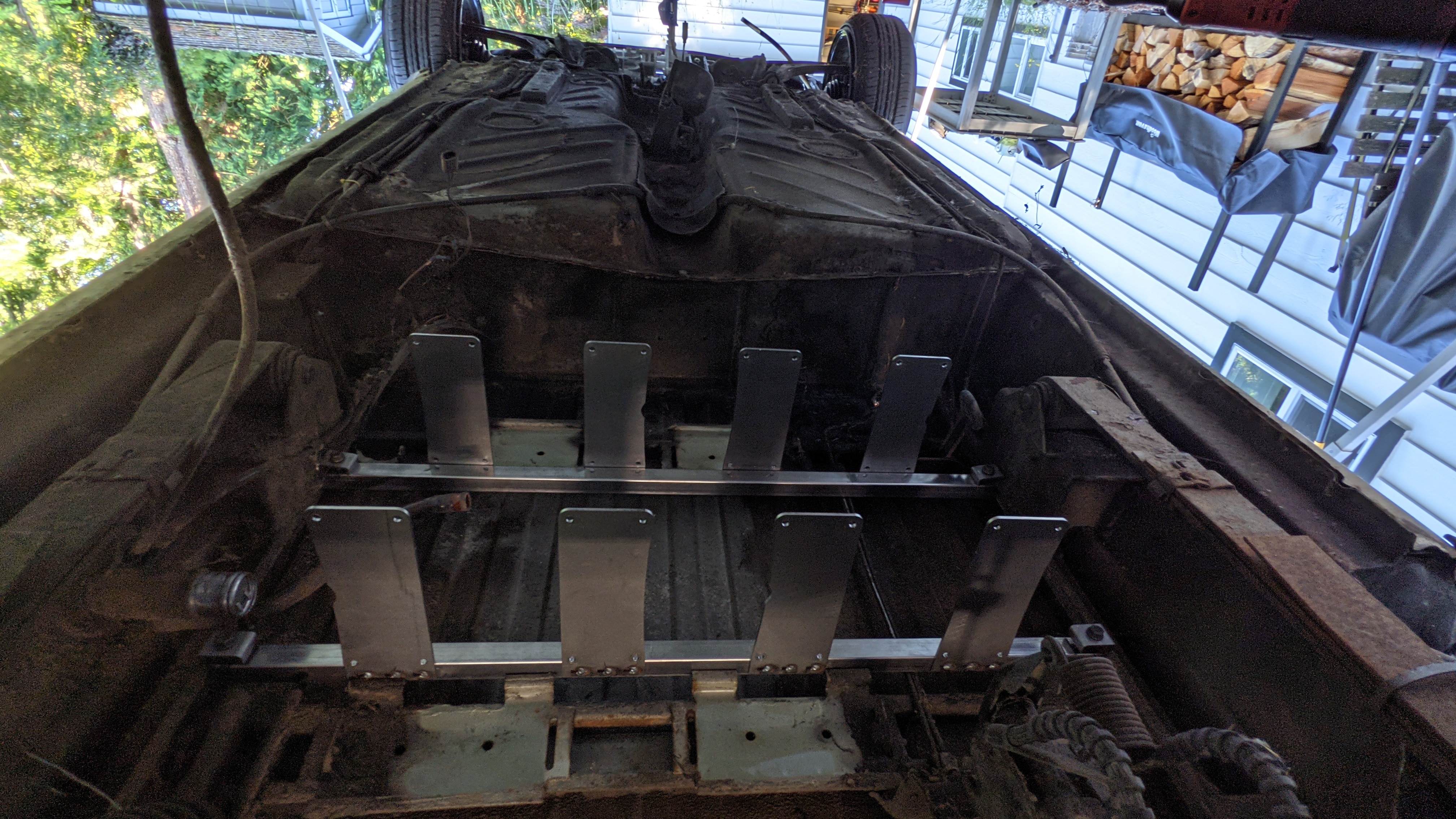

i love it when a CAD mockup comes together exactly as intended.
Battery mounting fabrication is well underway and the front row mounting is complete sans-paint.
as designed
lasercuts from SendCutSend
bench test assemble
test fitting in chassis
