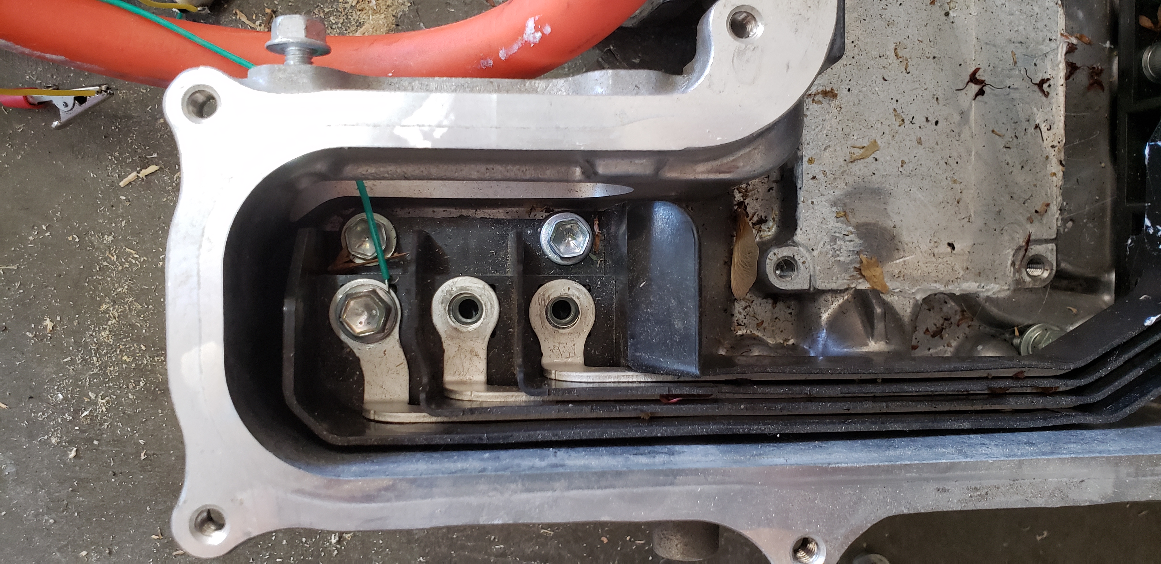

Connect your inidcator bulb between one of the phase terminals (U, V, or W) and HV+ on the bus supply.
Okay, so I think that's what I put in my diagram above, except you split the system 12v from the bus 12v.

Well, 0.26v on between 12+bus and any phase. -0.26v between Gndbus and any phase.
Connecting or disconnecting MSDN to 12+system has no effect on this voltage.
I even got paranoid and swapped my gator wires just to reconfirm.
Also swapped out a new Dupont wire on MSDN, just in case. No change.

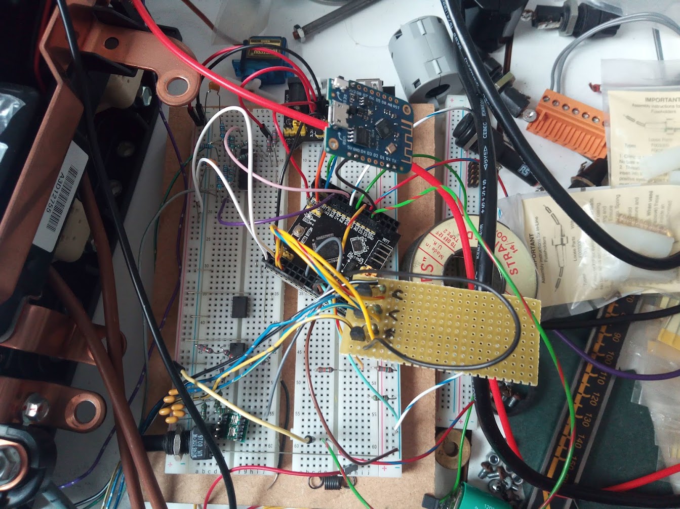

I haven't really touched the inverter since I got it to spin a motor and I have a 1990's Brusa/Solectria inverter blocking the workbench at the moment, but I'll try and replicate a test setup.

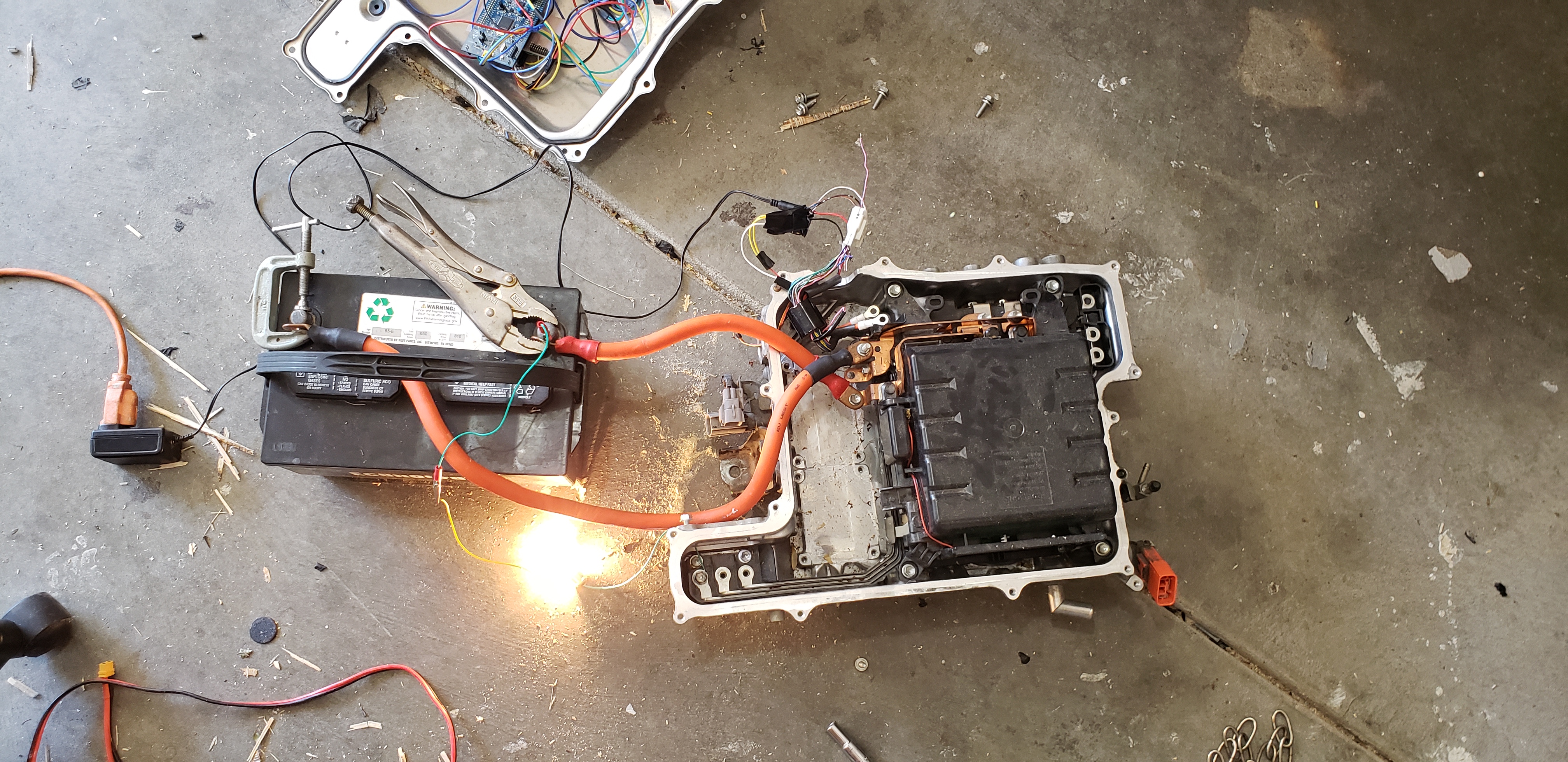

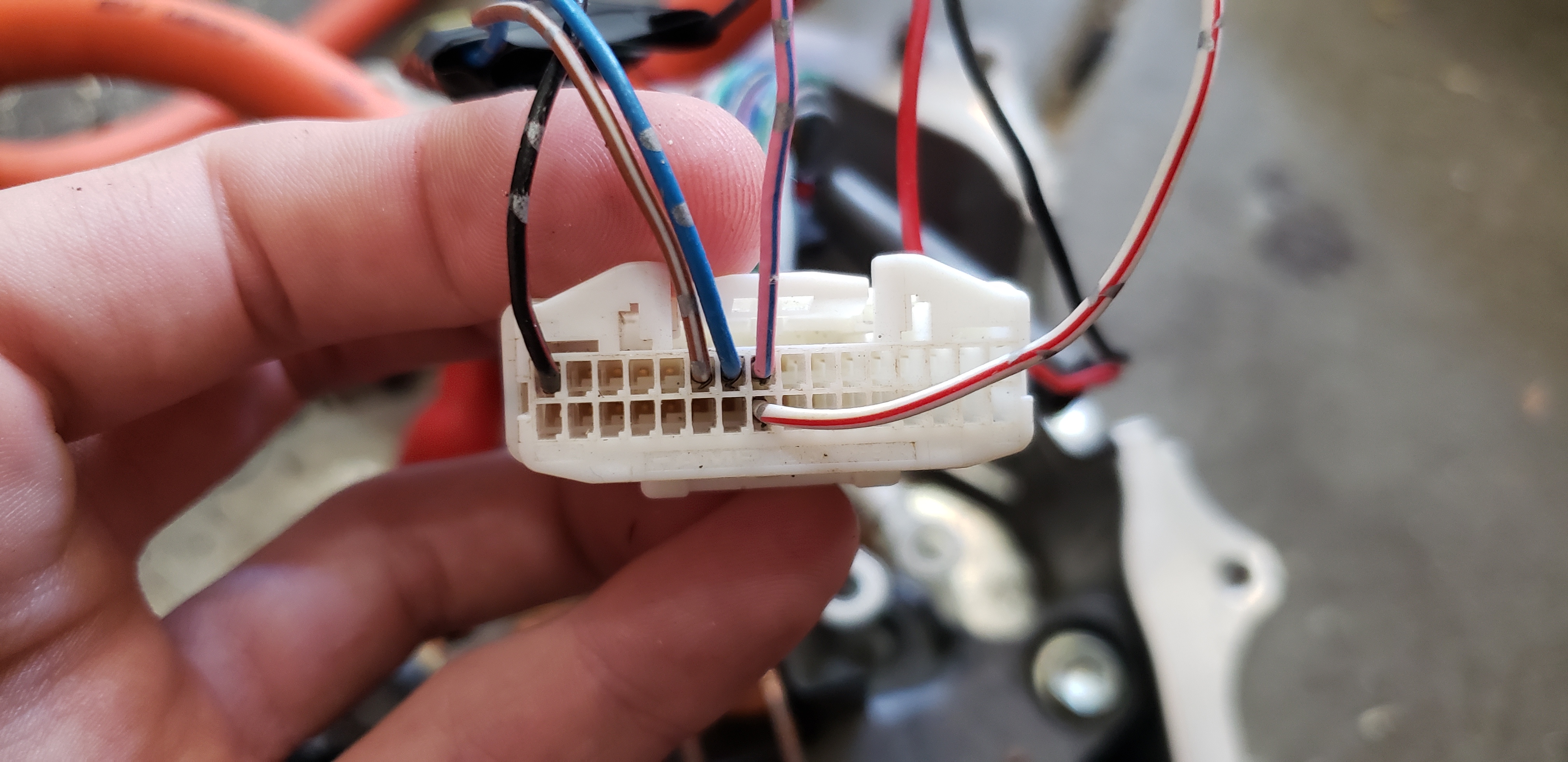

Here's a baseline test of inverter functionality that I ran today. I've used my inverter to drive small DC motors and it seems to be very functional.
Wiring as follows.
I9 gets 12v and ground.
HV into inverter (this being 12v at the moment).
On the white 32-pin: (I10 I think?)
Ground to pin 16 (black)
12V+ to pin 25 (red/white, MSDN) --- NOT GROUND!
And signal to pin 9 (pink/blue, MUU)
Default behavior. No signal, MUU floating.
Bulb does not light when between phase U and ground or phase U and HV+. So phase U is floating.
Then we ground MUU.
Bulb lights when between phase U and ground. Phase U is supplying HV+.
Now we let MUU float again.
Bulb lights when between phase U and HV+. So phase U is grounded.
So it seems that until you send a signal to a phase that phase is 'asleep' and will neither source nor sink current. Once it's received a single ground pulse it will then respond to signals.

Isaac96 wrote: Fri May 27, 2022 8:37 pmAnd signal to pin 9 (pink/blue, MUU)
Hmm, what are we calling "signal"?
Okay, this is the behavior I've been having that it's not supposed to have. No power.
Then we ground MUU.
... Well I'll be damned. Me too.
... indeed.
Thank you thank you thank you. That's an interesting tidbit.
And hurray, I got the same behavior!
I'm wondering what makes it reset other than powering down the inverter, because I'm sure I've done this before and never got a bulb to light no matter what. I guess, if I was expecting a bulb to go out, and it never lit in the first place, I might have missed it when swapping to the other side of the rail? But, that doesn't make sense, I definitely left it connected when I grounded the PWM phase, it should have come on the second I let go.
Perhaps, I know I was shutting down the inverter between every change to be as methodical as possible, and so that I didn't short anything out when clipping and unclipping leads. So when I tested each phase expecting it to light before grounding the PWM, none lit. And then powering down, clipping MUU/MVU/MWU to ground, changing my test points, and starting back up, none were working then either.
I guess at no point did I ever make changes after a wakeup signal that would've told me it was going to work.
So...
This is great news. I have now verified that the power transistors are not destroyed and, to some very limited degree the inverter is working.
Each phase works once woken up, conducting to Bus 12+ with the phase signal disconnected, and conducting to Bus Neg with the phase signal connected.
Also, just for note, *each* phase had to be woken up individually, even if the inverter stayed powered up the whole time. When I switched the bulb to the V or W phases, they were not illuminated until woken up.
SciroccoEV wrote: Fri May 13, 2022 8:47 am.
johu wrote: Fri May 13, 2022 8:22 am.
Backing up to what Scirocco and Johannes had me testing... what's the next step?
This quirk shouldn't have mattered, if the signal lines were being given PWM, they'd have their "wakeup" signal in a small fraction of a second from any PWM amount at all.

Does anyone have any suggestions of what to next pursue for diagnosing my problem?
Troubleshooting the problem from both ends (keyboard on one side, HVDC / systemDC on the other side) towards the middle...
From the OI software: Connection to wifi module seems to work. Interface loads. Settings save. Starts and stops.
From the Blue Pill/signal: PWM is being generated. Signal appears to be correct waveform (soundcard oscilloscope). Voltages appear correct before transistors and after transistors to the terminals.
From the connection to the inverter: Wires between control board and inverter seemed to connect correctly, PWM signal was getting to the inverter harness as judged by backstabbing the wires. Even removing harness and connecting directly to the inverter IPM resulted in no change.
Then: ??? one or several gaps here ???
From the inverter side: HVDC is getting into the inverter. System 12v is getting into the inverter. Power transistors all seem to be working, and conduct HVDC+ (after wakeup) to the motor phase terminals, and after powering PWM line, the transistors toggle to conducting to HVDC-.
I'm not really sure what could possibly be breaking down at this point, or, what could possibly be the missing link. If I understand correctly, my latest test of powering the PWM line and manually connecting it to 12+ and seeing the transistors invert... is just a really slow mechanical version of PWM. So why does an actual PWM signal not work, when it does the same thing to the same pins in the same way?
The discovery of a "wakeup" requirement is interesting in terms of theory, but, should not have any practical implications since a PWM signal is going to be giving it a wakeup many times a second. This is probably why neither Damien nor Johannes nor anyone else reverse engineering the inverter ever noticed it was "needed".
And, how does this relate to the inverter working when I tapped on the blue pill board to get it to work, but connecting the wires better somehow made it stop working?
