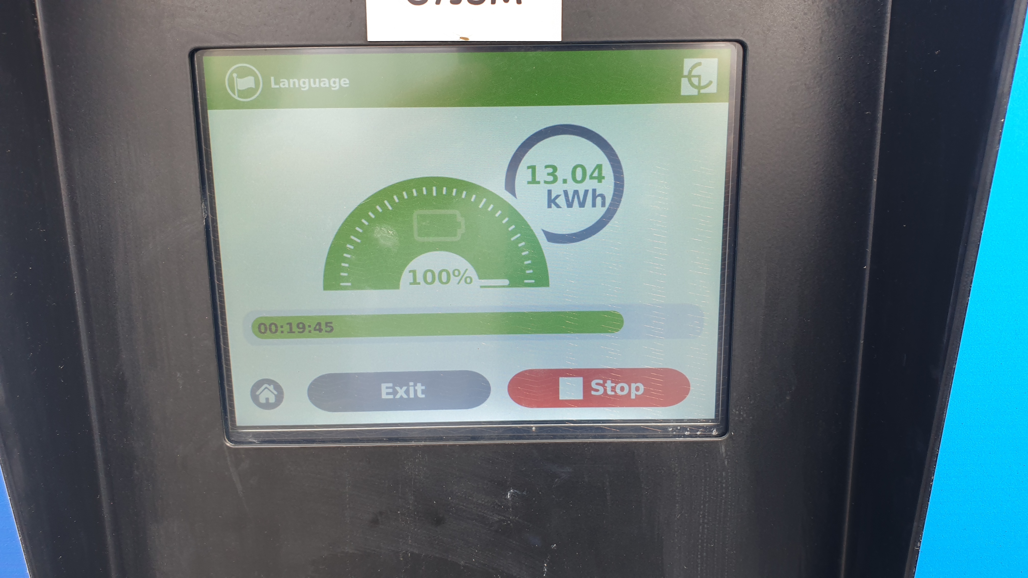

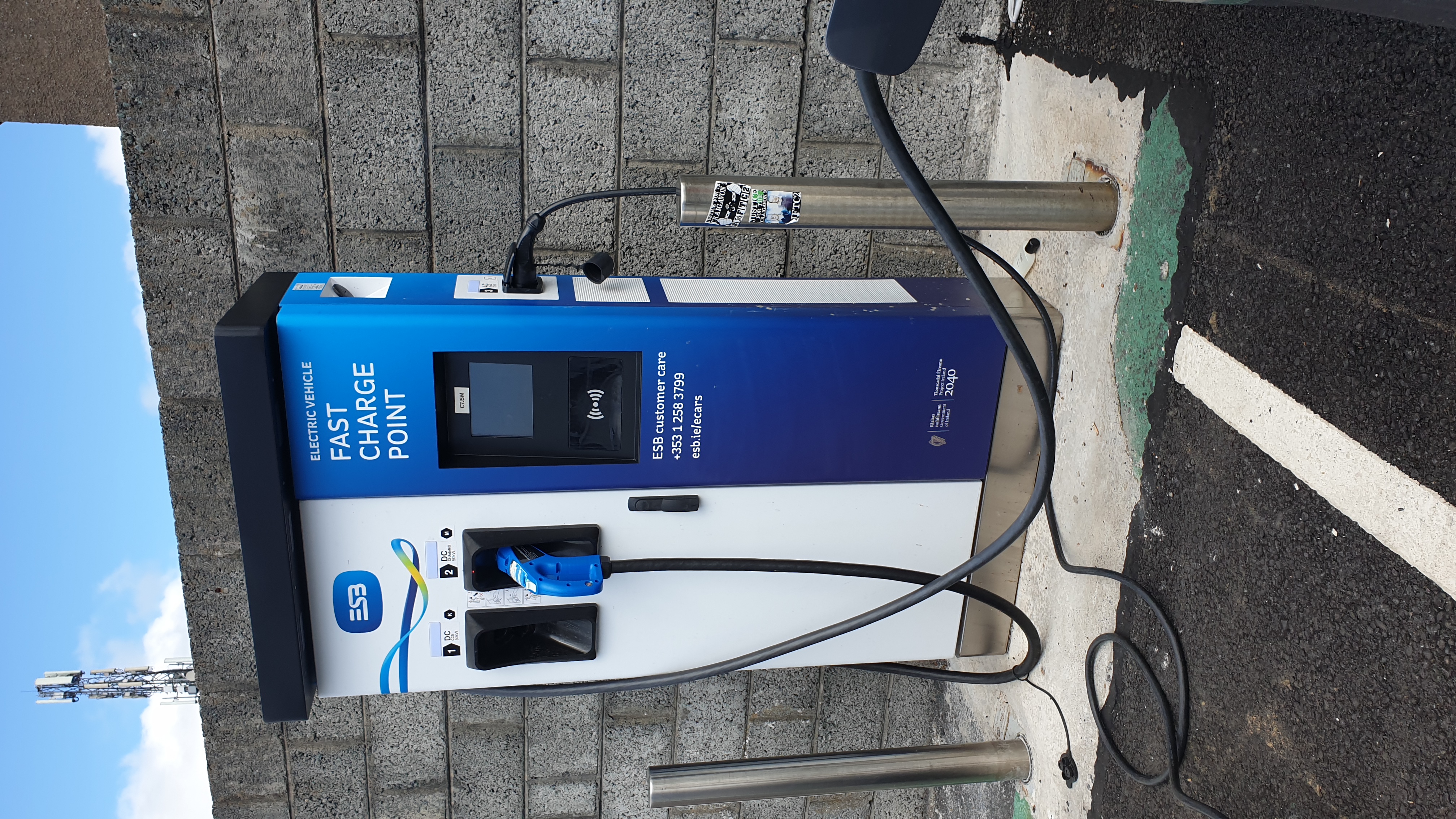

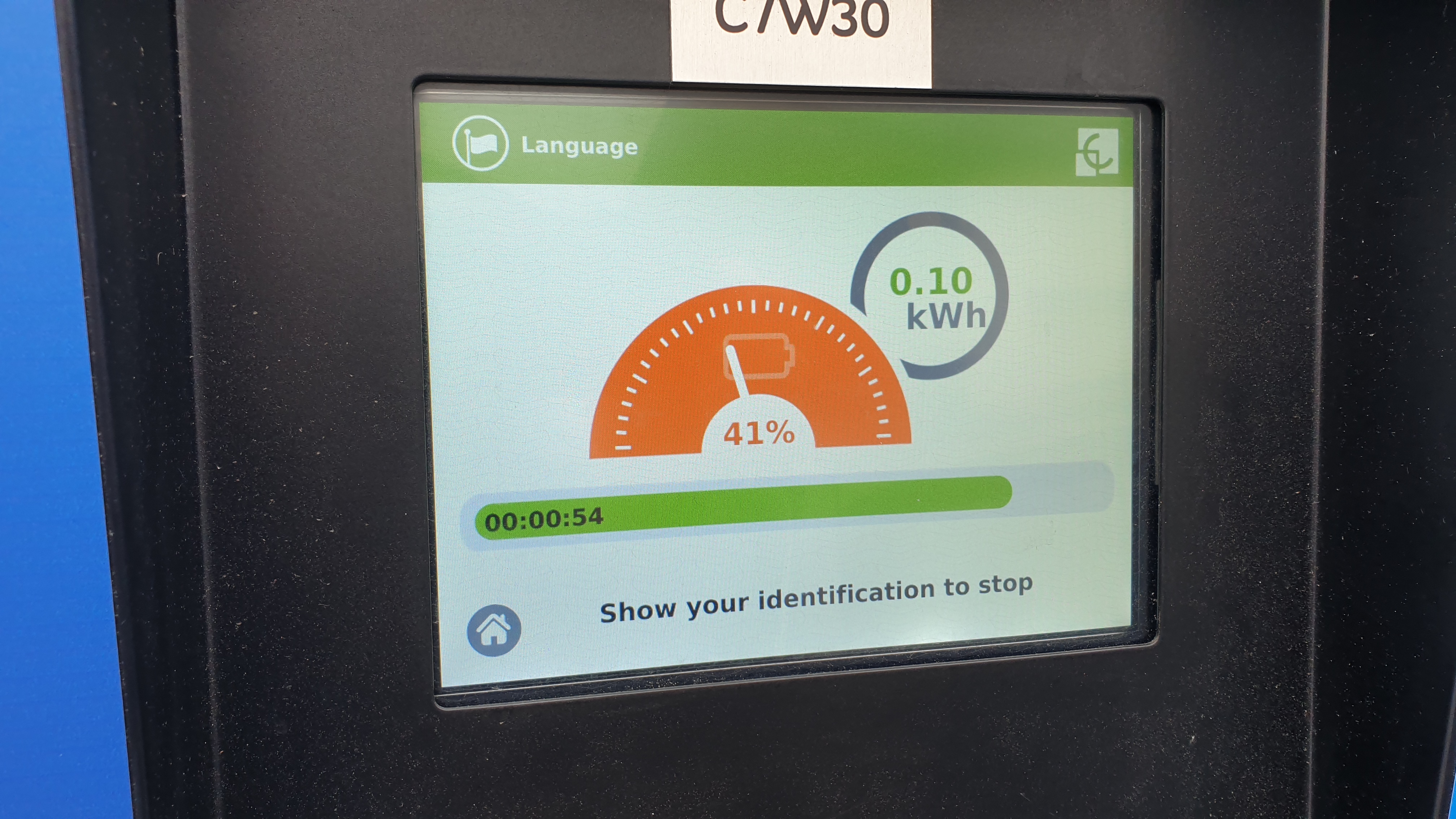

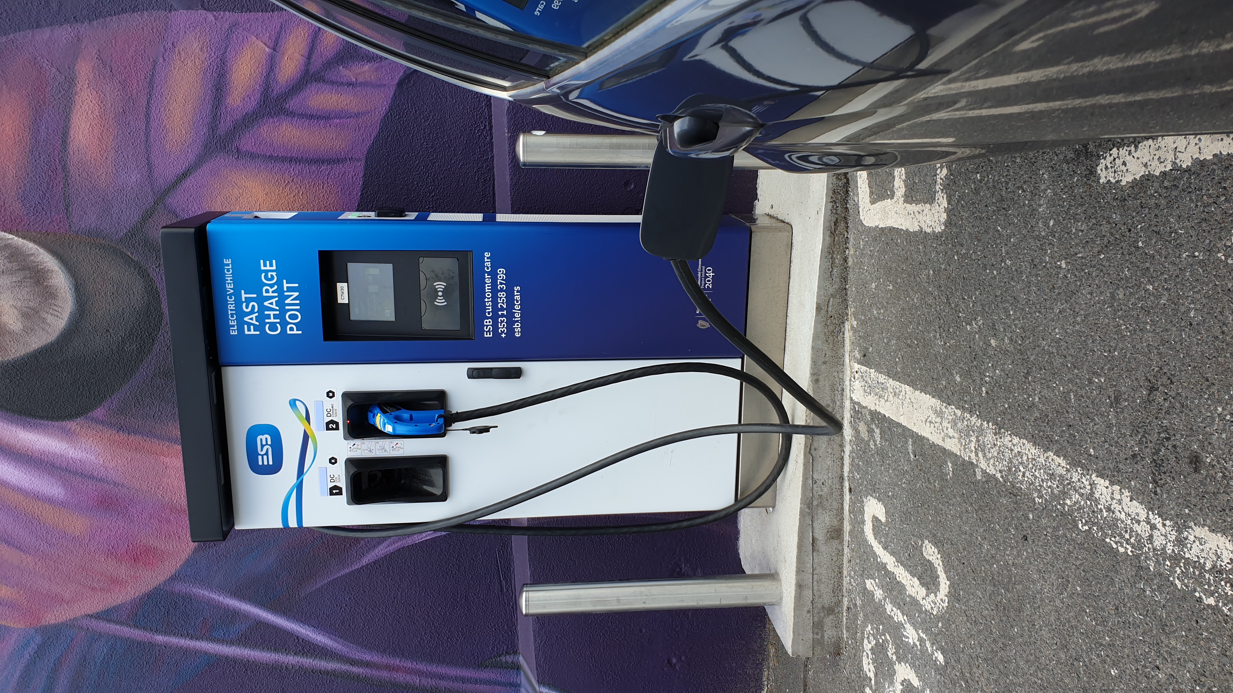

So am off on another road trip the past few days (house hunting) so lots of fast charges. Circontrol unit #1 and I were best buds. Gassed up to 91% , terminated perfectly from the station. #2 started up fine but when I hit 85% it decides to shutoff. Restarting causes it to hang in state 5 (contactors did close and confirm closed) but would not move to state 6 (energy transfer). The adventure continues today ....

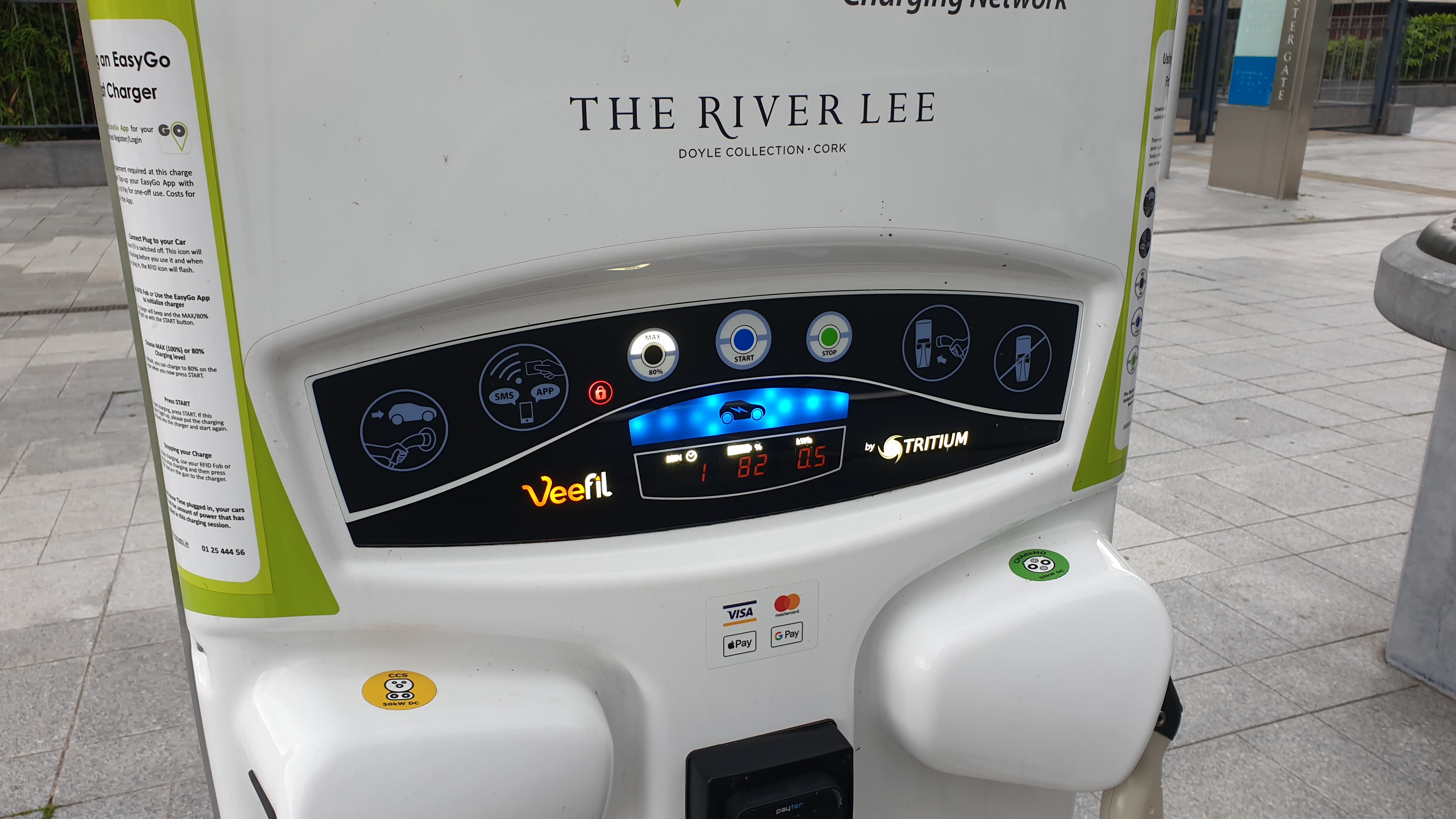

...aaaannnd same problem with a tritium. Hangs in state 5.

Might not be the cause , but esb have rolled out 80% charge limit on most ccs chargers. Session will terminate then but nearly sure you can restart.The tritiums have selectable mode on them to set max charge to 80 or 100%(some are changeable on unit others are locked)on Efacec units its changeable in the setting menu on unit.

Yep contactors report closed on the web interface but won't go to state 6. Seems to happen on the restart atempt. First time on the Tritium I had 80% selected on the station and car was at 82% so it went to state 6 then straight on to 7 etc and shutdown due to soc. Next time around I selected 100% and it hung in state 5 until the station times out. On both ocassions I heard contactors close and confirmed on web interface.

Sorry no can logs this time. I just commented out the contactor test at the end of state 5 so I could charge. Drove nearly 500miles over 3 days of house hunting lots of ccs sessions. Those 2 circontrol stations are located about 50 miles apart. #1 works fine. Charged all the way to 91% this morning and terminated the charge myself. Other one goes to 80% and when I try to restart drops from state 6 to 7 and shuts down. Tritium works fine with contactor test commented out. I will try and do some more logging but bigger fish to fry at the minute:)

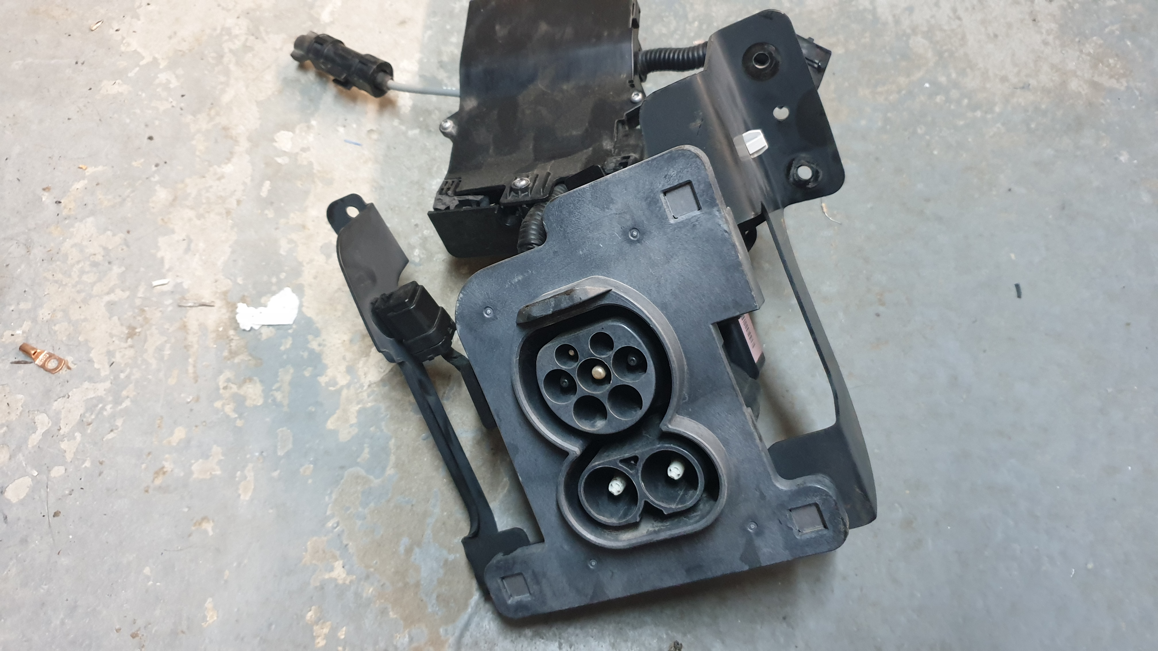

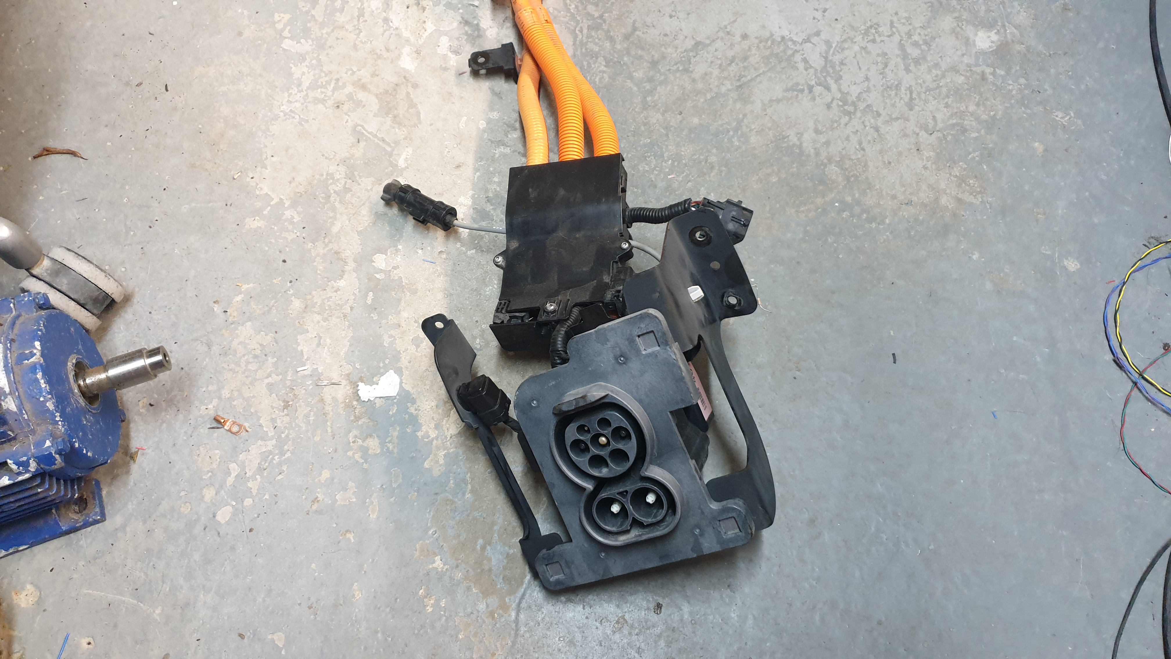

Just been donated an oem ccs port:) I think its from a Kia.

Post by EV_Builder »
If you mount it like you did don't forget to add two new drain holes to the plug. I was studying mine (from ID3; i wanted 3phase) and what seemed like a cooling thule is drain water hole. But mounted 90degrees you need 2 new ones...

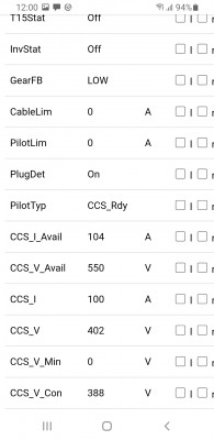

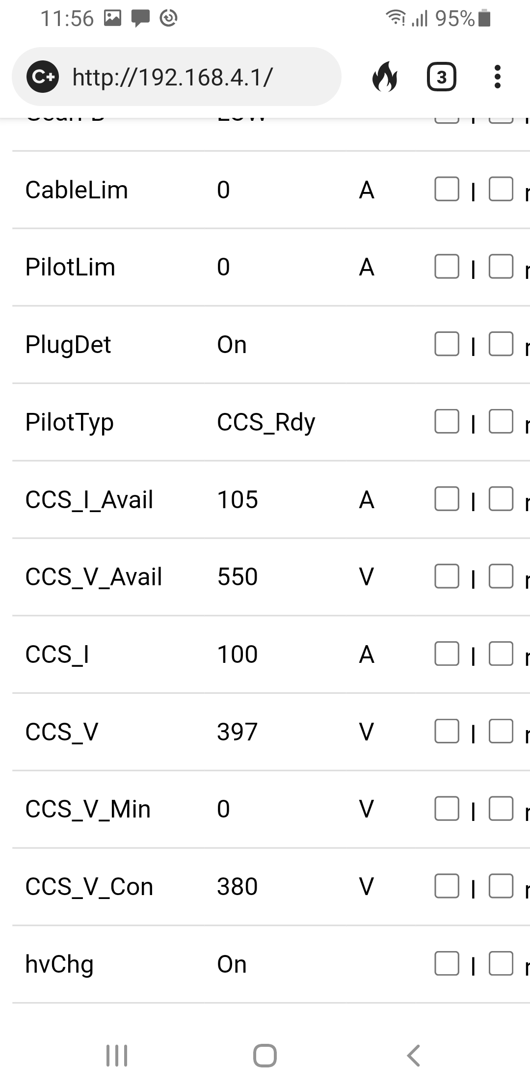

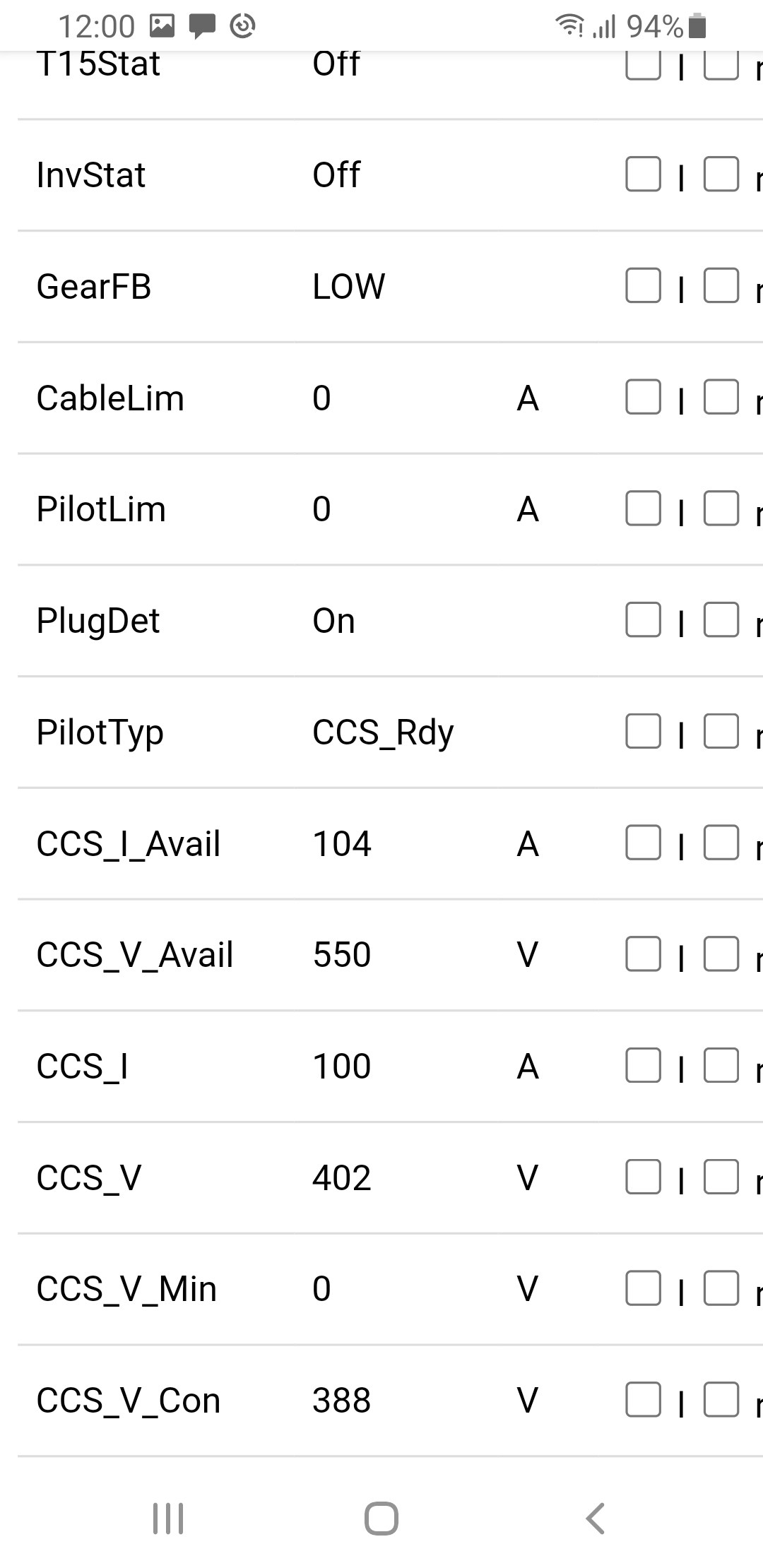

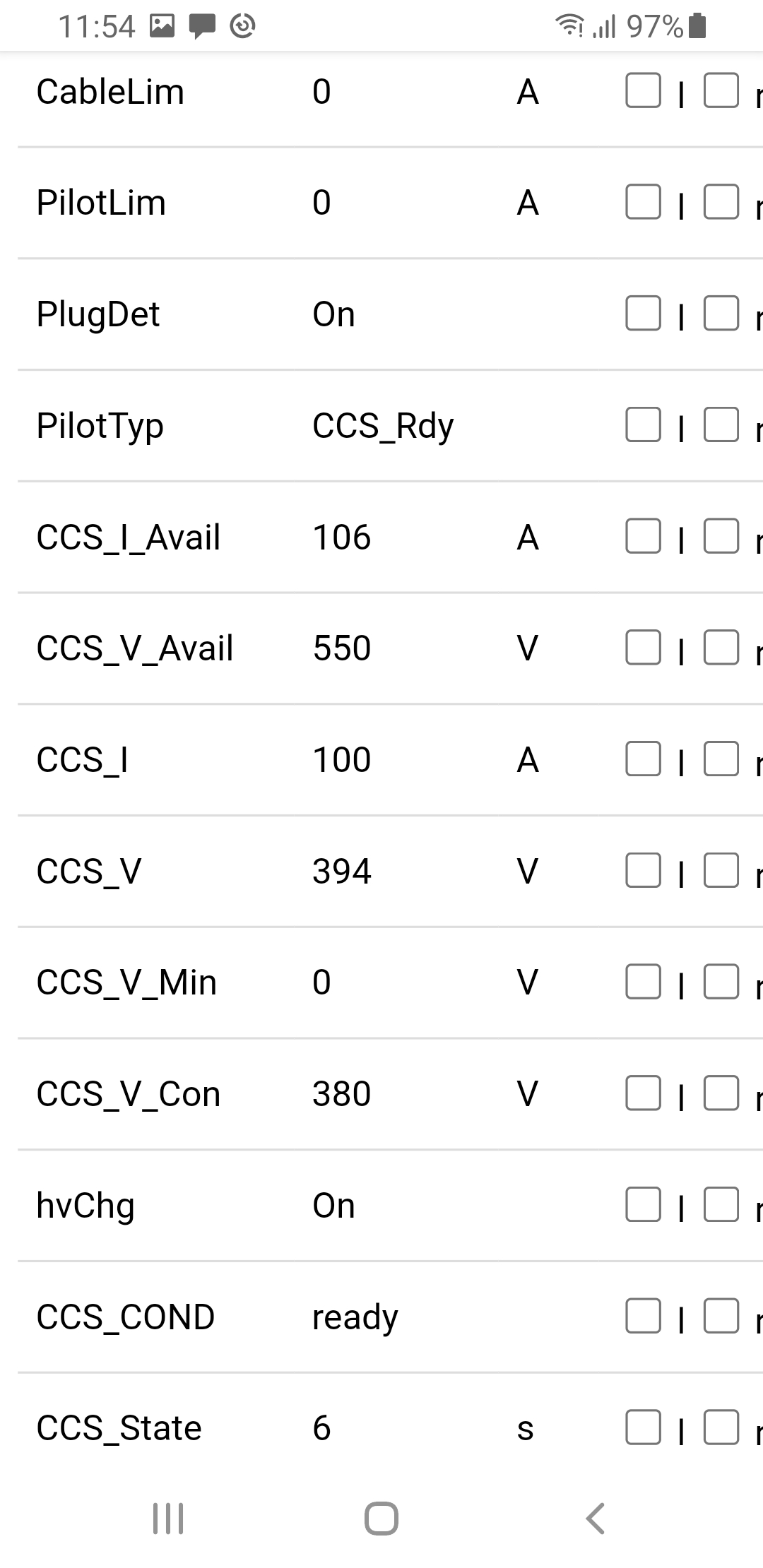

I call this one the mystery of the disappearing current. Two fast chargers 45 miles apart. Same make. Same model. Same company that runs them. One give me 125A all the time. The other.....

mikeselectricstuff
Posts: 120
Post by mikeselectricstuff »
Could it just be that they are limited based on their available grid supply?
paaa
Posts: 211
Been thanked: 13 times
Post by paaa »
Hi Mike is most likely correct , those circontrol units have only been installed to replace an existing 2x22kw ac charge point so far. As far as I know they are all subject to load balancing hence the 6kw 3 phase socket. Yes it does 2kw per phase I am not making this madness up.
