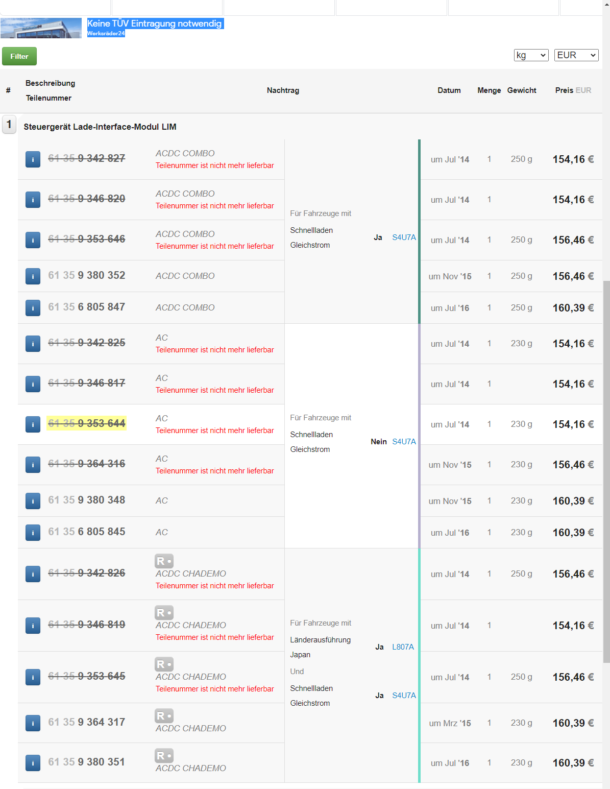

mikeselectricstuff wrote: Wed Nov 18, 2020 12:29 am Seem to be a few of these around :
The parts you've listed with ebay ads are PN: 6135-6828052 And the one at the start of the thread is PN: 6135-9380352
I've also spotted a third module on ebay with PN: 6135-6805847
Is there likely to be any difference between them?
I'm quite interested in this concept as I have a BMW i3 battery.

Who knows... Could be different generations,different regions, LHD/RHD, different firmware for different models/battery sizes perhaps.
Cross-referencing with car variants may give some clues.
jon volk
Posts: 574
Location: Connecticut
Post by jon volk »
Realoem.com for pn to model references.

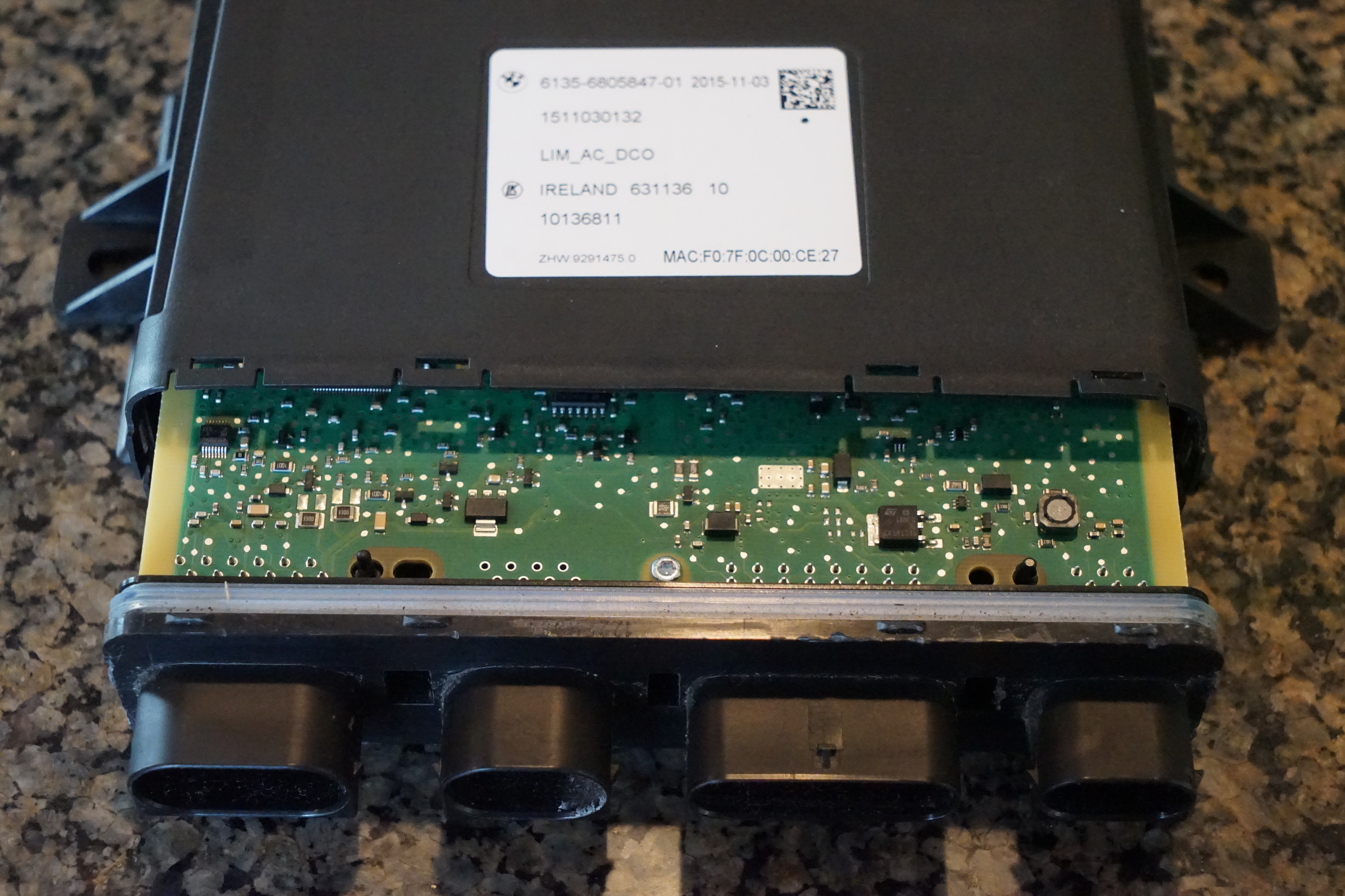

I got a package!
Ooh a 'chassis brain box' :D
To me it seems held together by those small tabs on the base. Haven't tried to open it yet. Will come back to this later.

Are you sure it's a DC (fast charge) version? Part numbers up to 2016!
mdrobnak
Posts: 692
Post by mdrobnak »
Mine is :) I have 61 35 6 805 847.
Ja mit Schnelladen. :)

Some shots:
A search for the CPU part number yields "NEC uPD70F3550 GCA V850E2/FG4 V850 Microcontroller"
https://en.wikipedia.org/wiki/V850
S/W float.
Dual instruction executing.
7-stage pipeline.
2.56 Dhrystone MIPS/MHz
1.5 mW/MIPS
Multi CPU core support.
Memory Protection.
https://www.renesas.com/sg/en/doc/Docum ... 00_FG4.pdf
Rear door actuator driver is the L9951XP chip.
Edit: Duh, this is all in the block diagram on the top. :: headdesk ::
And that's all I wrote for the moment. :D
-Matt

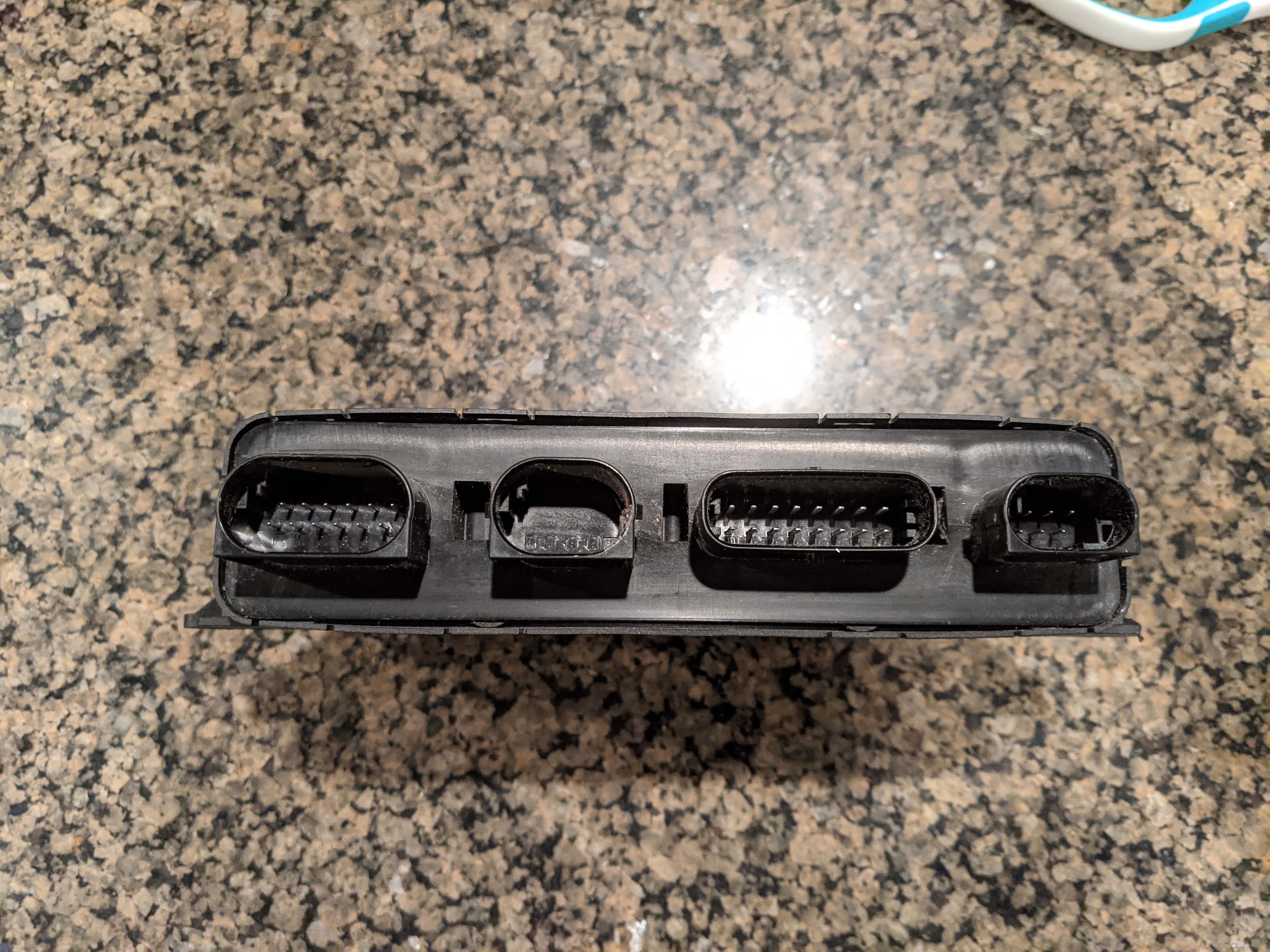

I was looking for plugs that could fit according to the photos.
16 pin: Hirschmann 805-587-545
12 pin: BMW 61138373632, Audi 4E0 972 713, TE 1534152-1
8 pin: BMW 61138364624, Audi 4F0 972 708, TE 1-1534229-1 (only on Chademo models)
6 pin: BMW 61138383300, Audi 7M0 973 119, TE 1-967616-1
All available at Auto-Click UK.
I am planning a stand-alone solution based on the LIM module. It seems that it controls the cunductors for DC, the locking and the LED for the CP. And of course control pilot, proximity and PLC.

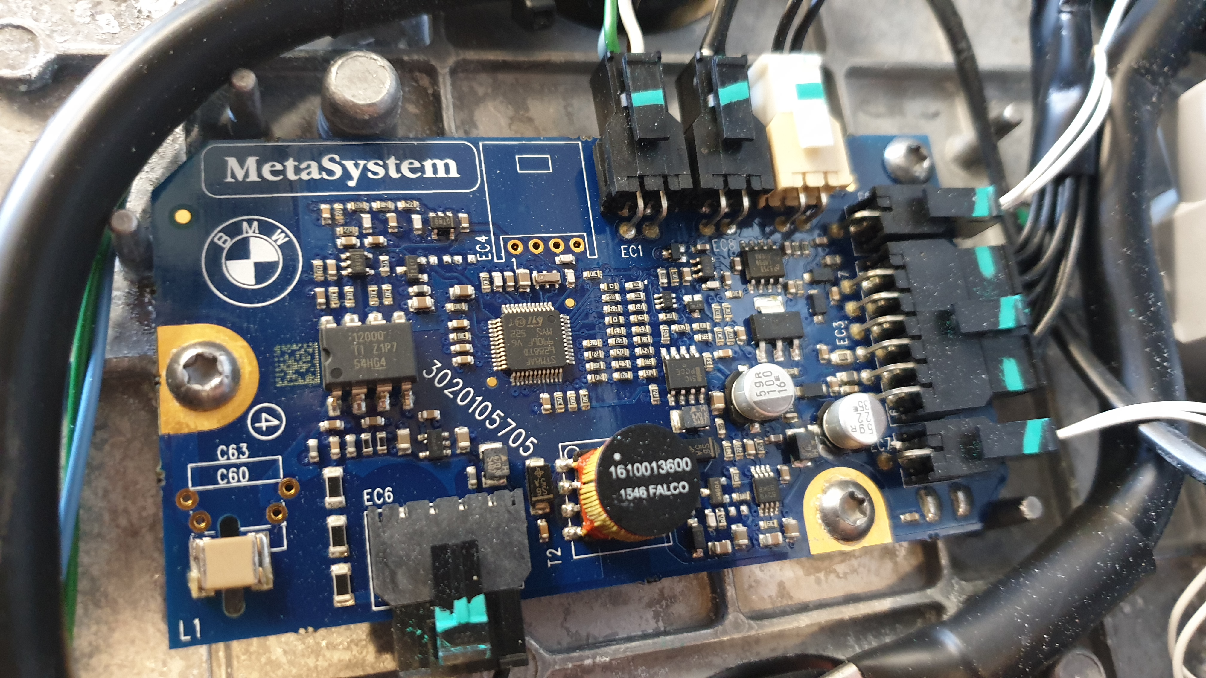

So did a little research. Our i3 charge port (X994a) dc lines go to A290 which is the kle module or onboard charger. By a stroke of luck I had one in my parts pile so pulled out a boatload of threadlocked fastners and roughly figured out it acts as a dc distribution block and has the fast charge contactors and what looks like a 3.3kw ac charger. Now in the diagram you will see the lim (charge controller) A250*4B pin 5 is called U_HV_DC which seems to be the measured hv on the charge port via that little extra board on the back cover. Anyhow, now that I have a ccs port in the grey goose it needs something to talk to so why not this.

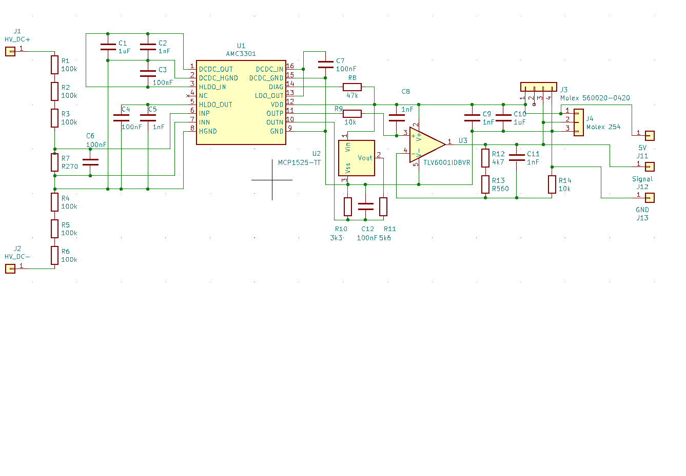

Jack Bauer wrote: Sun Feb 28, 2021 1:58 pm Now in the diagram you will see the lim (charge controller) A250*4B pin 5 is called U_HV_DC which seems to be the measured hv on the charge port via that little extra board on the back cover.
Yes that's right. I thought of a small circuit that takes over this voltage measurement. Maybe you can see if that works. It should make at 0V battery voltage 1.42V and at 500V 4.8V.
And the plugs that I specified in my previous post all fit.

So it doesnt look like the little board needs anything other than 12v then it outputs a voltage proportional to the hvdc on the charge port. I'll do some investigation to confirm. It also has some hvil pins that can be just shorted.
