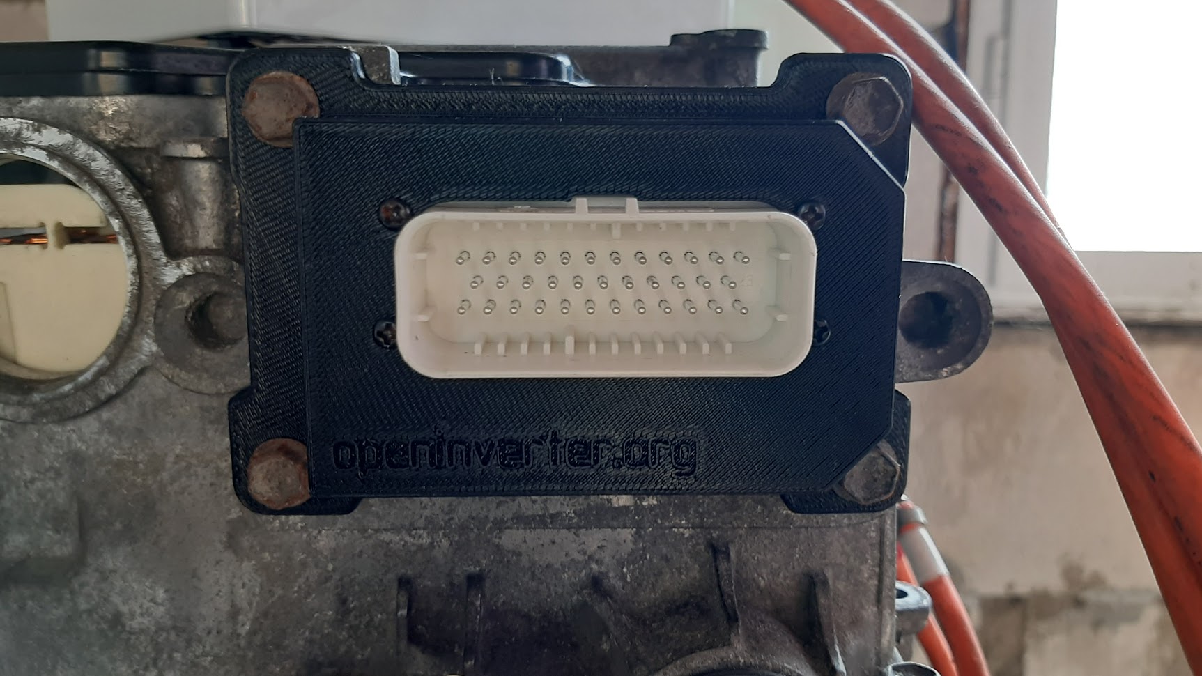

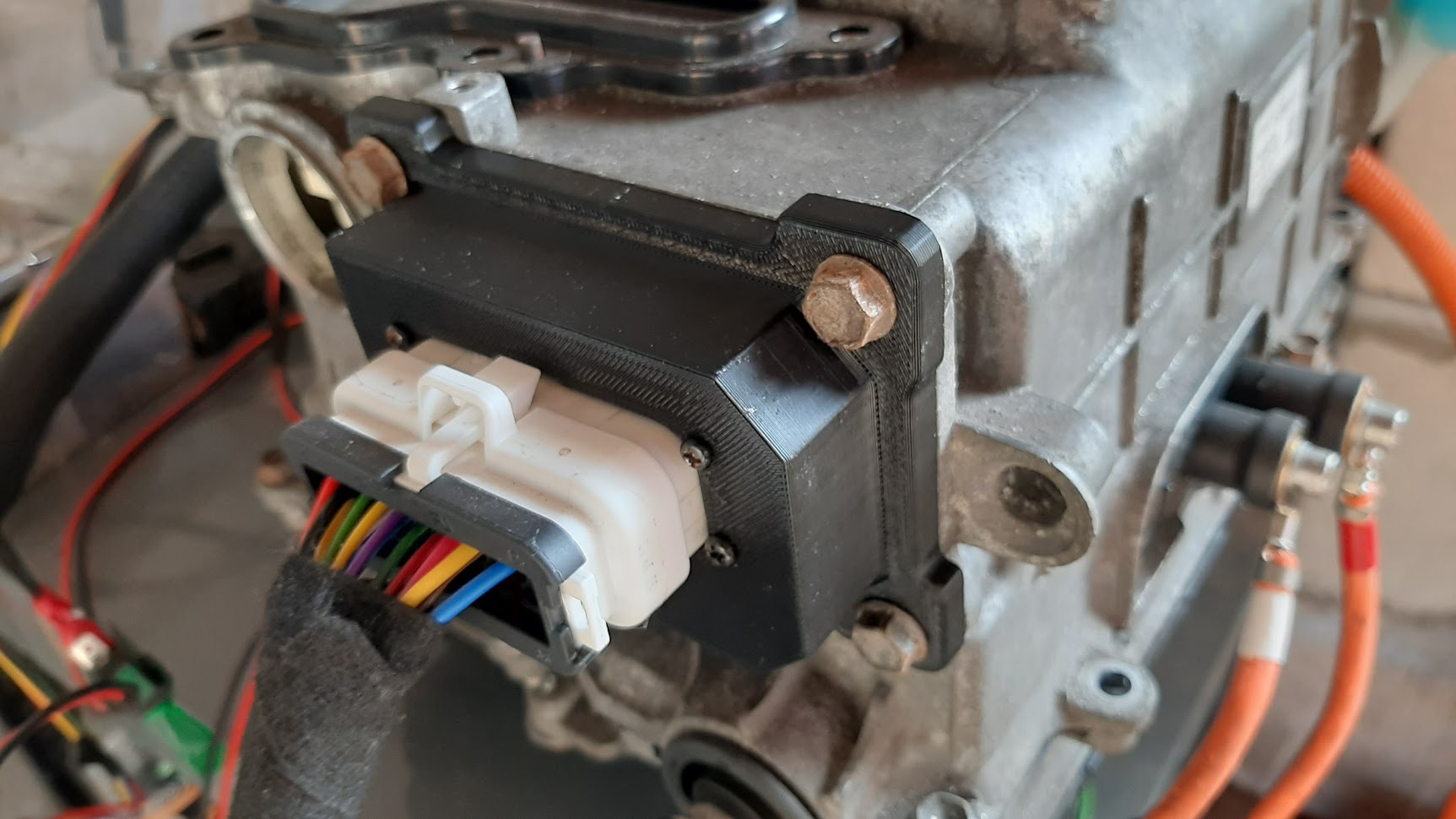

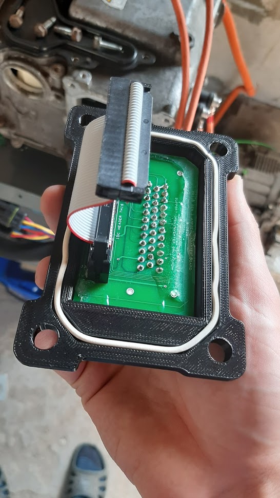

Little off-topic here:
The latest 35-way connector housing design fits perfectly to gen3 inverter: It is not utilising original red sealant, instead you can fit there any rubber band or air-cured silicone sealant. For the original adapter plate all you need to do is to grind off 5mm of two corners.
STL attached
STL attached

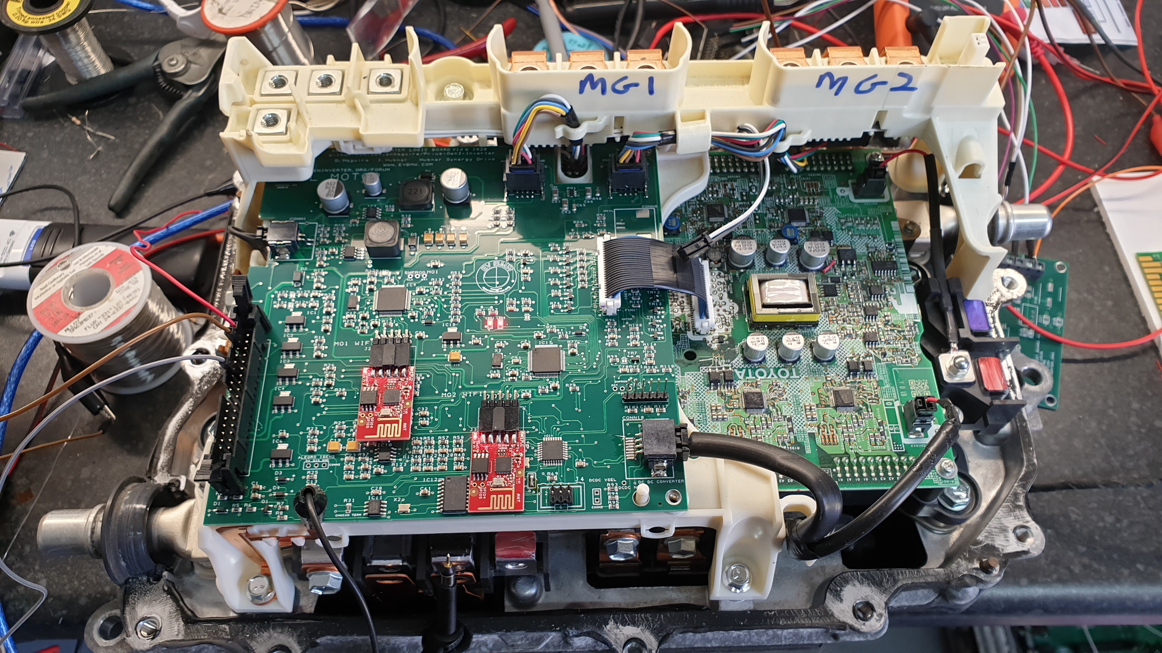

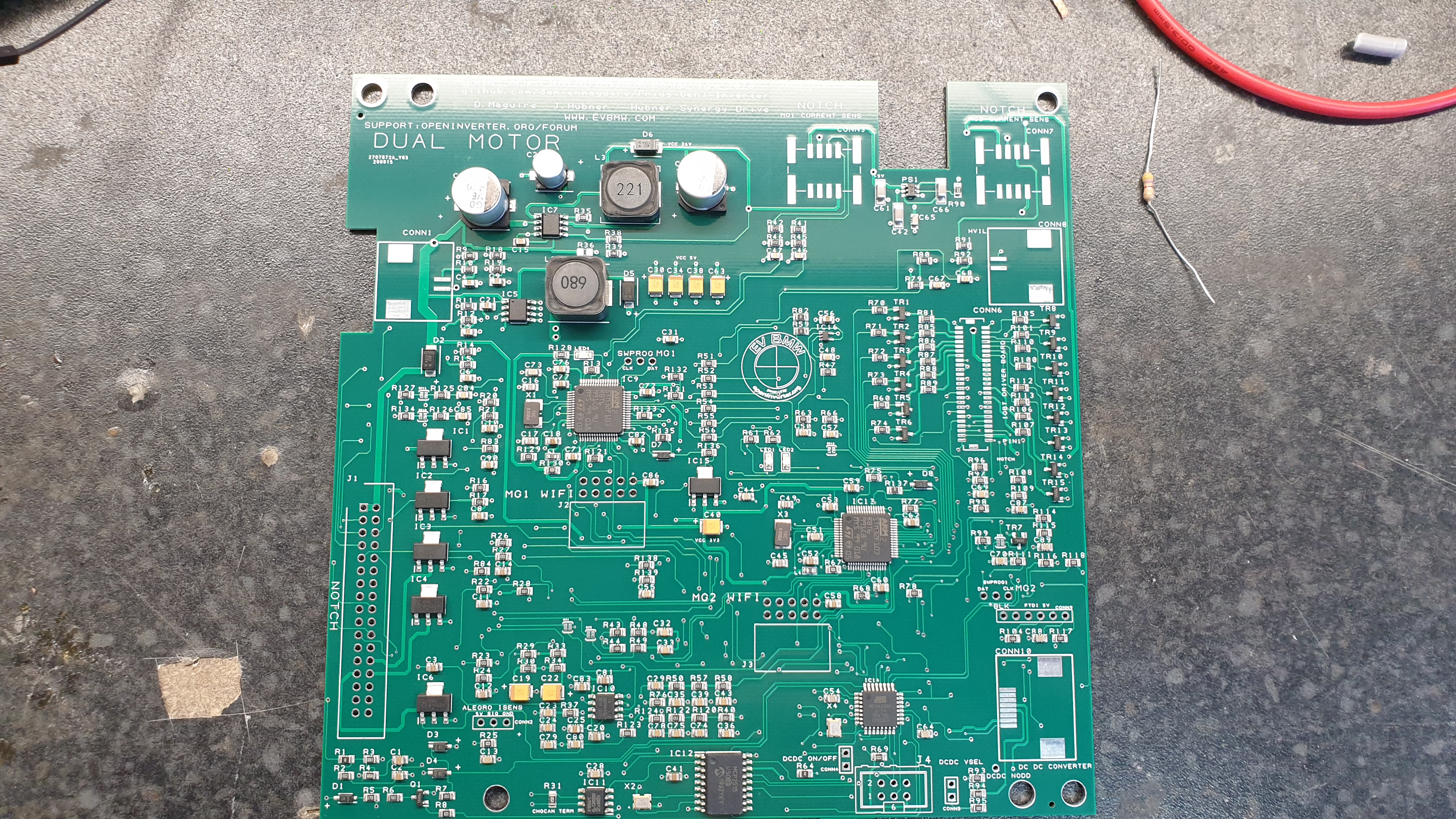

- Posts: 4000
- Been thanked: 1115 times
Sweet! Need to get a few of those made.
In other news the V1d boards have arrived:)

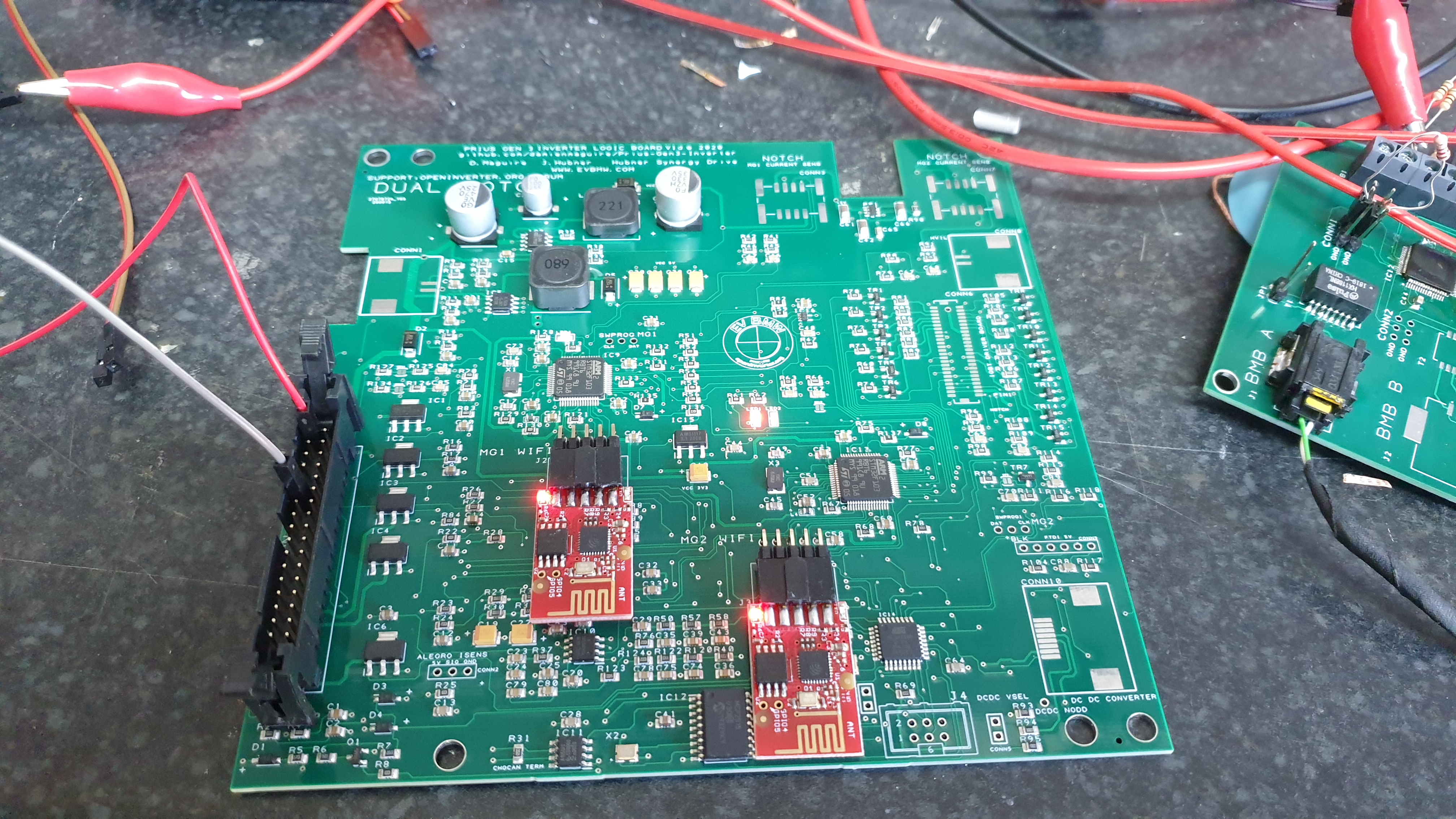

- bobby_come_lately
- Posts: 486
- Location: Manchester, UK
- Has thanked: 56 times
- Been thanked: 63 times
Updated this as I have slightly different readings than last night when I took them.
Morning all. Hoping to get some ideas about what might be going wrong.
After working fine for a while, my board has thrown a wobbly - though it may have been provoked.
The main symptom is that udc is now locked to 818.37v. Doesn't move at all. It has been working absolutely fine.
Checked the voltages around the board.
- Pin 10 (dcbus2) is at 2.29v
- 3v3 at C32 is now at 3.85v
- 5v at C20/C21/C22/C25 is now at 4.2v
- -5v at the via next to CONN7 is now at -2.89v
This started after I was trying to get wheels spinning. I may have (I did) get a little enthusiastic with putting current into the motor. And there may have been a short elsewhere in my 12v loom. But this problem didn't start immediately after either of those things.
Have done reset, updated firmware etc.
Any pointers very welcome.

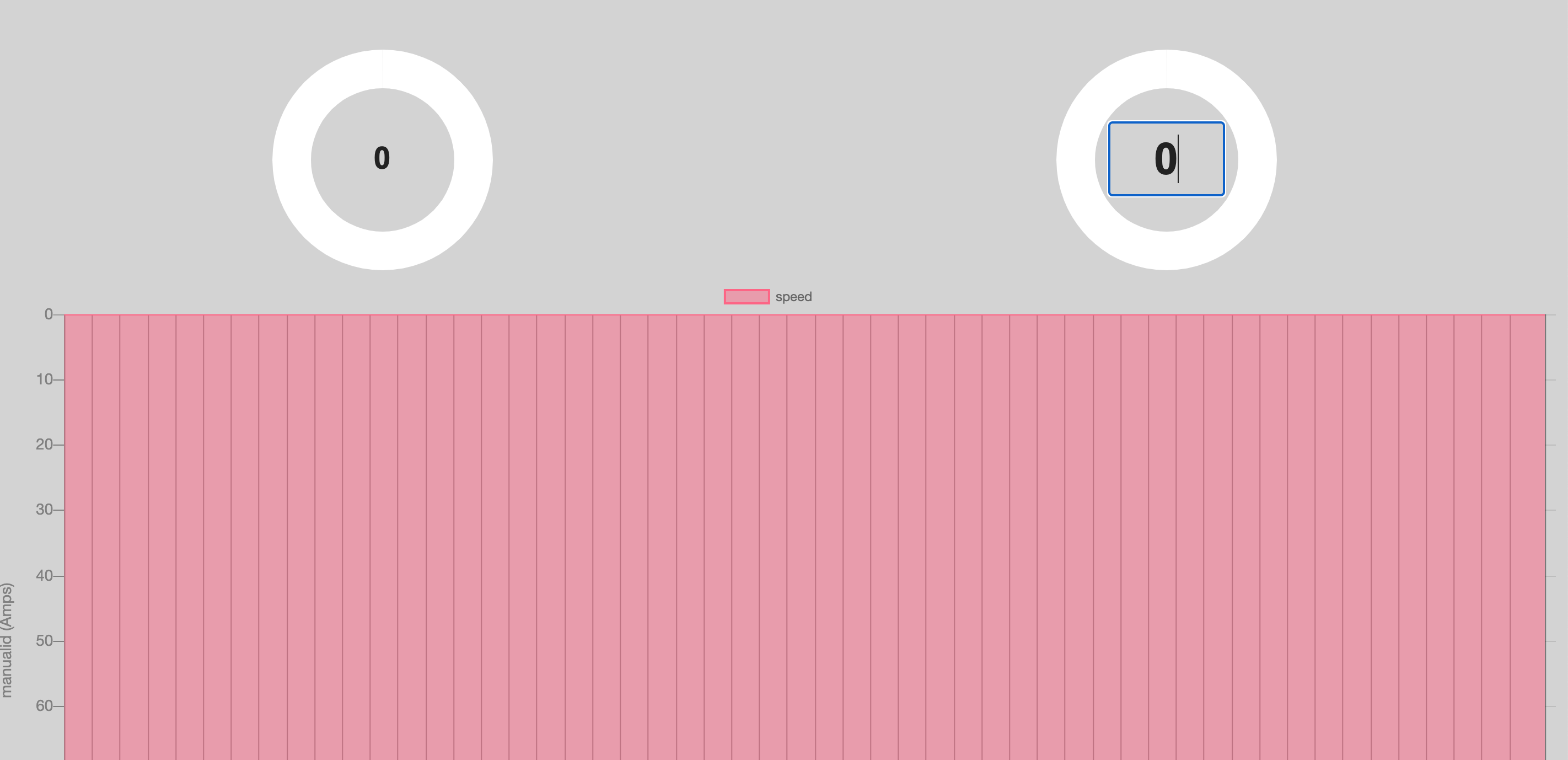

- Posts: 1884
- Has thanked: 91 times
- Been thanked: 517 times
I've just noticed there's some new files in the github repo for the web interface, upload these and go to syncofs.html
Looks like Dima has made a nice interface for tuning.
