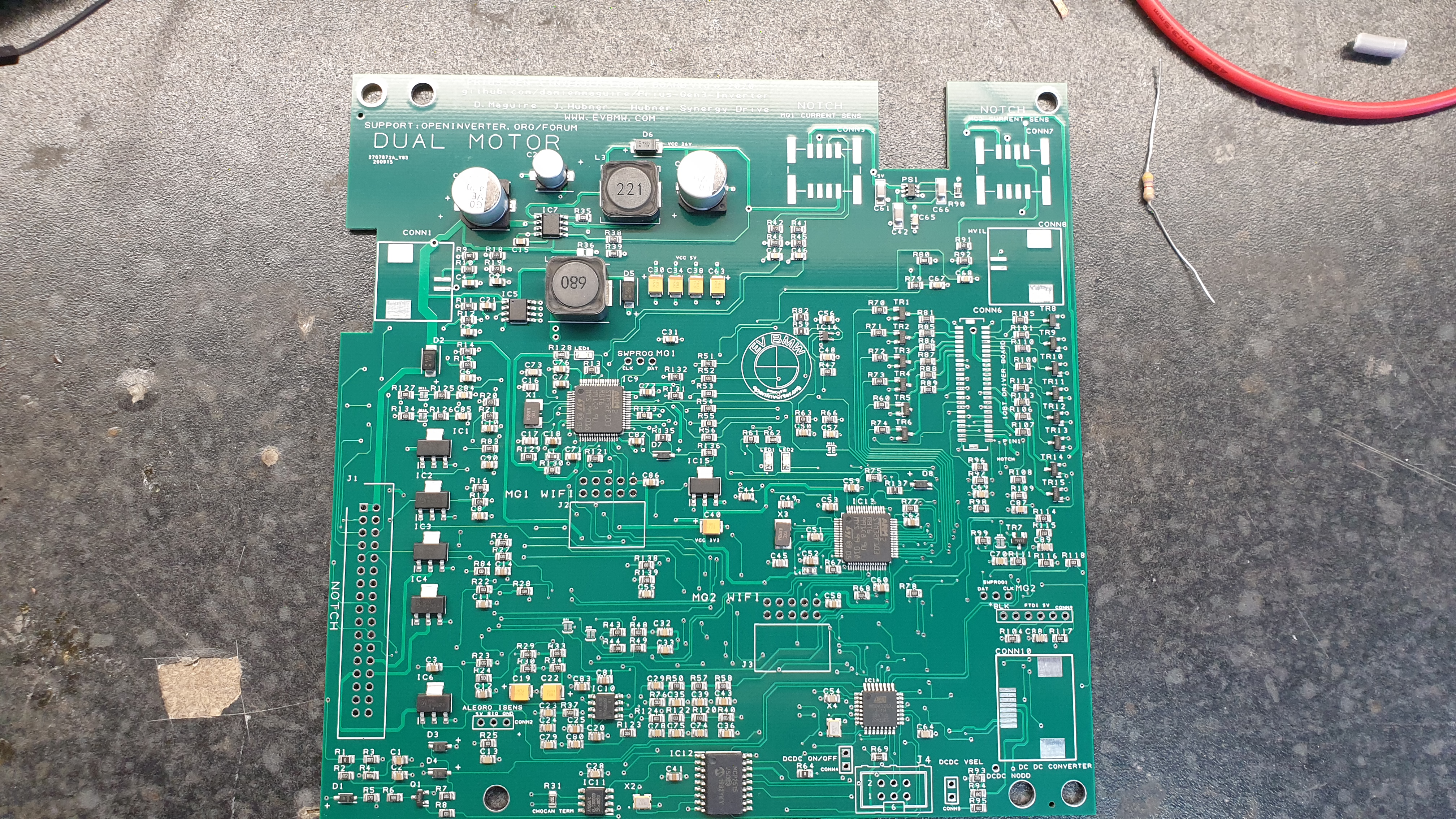

Morning all. Hoping to get some ideas about what might be going wrong.
After working fine for a while, my board has thrown a wobbly - though it may have been provoked.
The main symptom is that udc is now locked to 818.37v. Doesn't move at all. It has been working absolutely fine.
Checked the voltages around the board.
- Pin 10 (dcbus2) is at 2.29v
- 3v3 at C32 is now at 3.85v
- 5v at C20/C21/C22/C25 is now at 4.2v
- -5v at the via next to CONN7 is now at -2.89v
This started after I was trying to get wheels spinning. I may have (I did) get a little enthusiastic with putting current into the motor. And there may have been a short elsewhere in my 12v loom. But this problem didn't start immediately after either of those things.
Have done reset, updated firmware etc.
Any pointers very welcome.

- Posts: 3563
- Been thanked: 88 times
Answered in your build thread.
